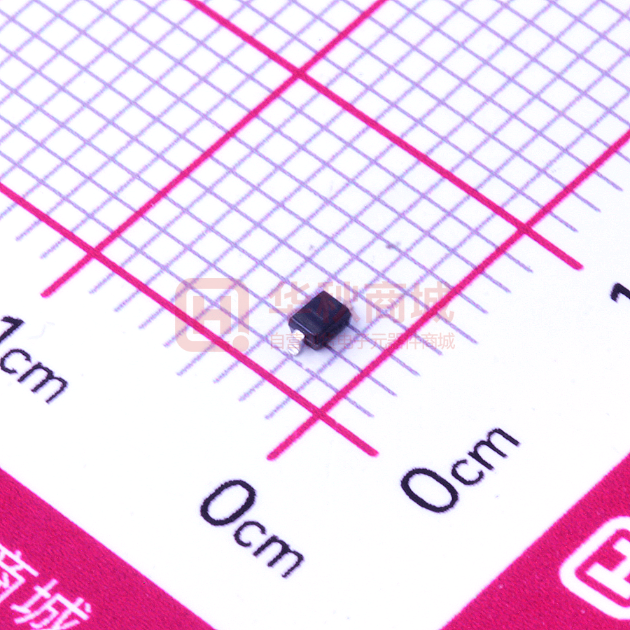

BAT54WS-E3-08
BAT54WS-E3-08
    TFUNK(威世)
    SOD-323
    特性:极低的开启电压。 快速开关。 采用PN结保护环,防止过电压,如静电放电。 可提供符合AEC-Q101标准的产品。 RoHS合规,有商业级和符合AEC-Q101标准的等级
BAT54WS-E3-08 数据手册
BAT54WS www.vishay.com Vishay Semiconductors Small Signal Schottky Diode FEATURES DESIGN SUPPORT TOOLS click logo to get started Models Available MECHANICAL DATA Case: SOD-323 Weight: approx. 4.3 mg Packaging codes/options: 18/10K per 13" reel (8 mm tape), 10K/box 08/3K per 7" reel (8 mm tape), 15K/box • These diodes feature very low turn-on voltage and fast switching • These devices are protected by a PN junction guard ring against excessive voltage, such as electrostatic discharges • AEC-Q101 qualified available • Base P/N-E3 - RoHS-compliant, commercial grade • Base P/N-HE3 - RoHS-compliant, AEC-Q101 qualified • Material categorization: for definitions of compliance please see www.vishay.com/doc?99912 PARTS TABLE PART BAT54WS ORDERING CODE CIRCUIT CONFIGURATION TYPE MARKING REMARKS Single L4 Tape and reel BAT54WS-E3-08 or BAT54WS-E3-18 BAT54WS-HE3-08 or BAT54WS-HE3-18 ABSOLUTE MAXIMUM RATINGS (Tamb = 25 °C, unless otherwise specified) PARAMETER Repetitive peak reverse voltage Forward continuous current (1) Repetitive peak forward current Surge forward current (1) Power dissipation (1) TEST CONDITION (1) tp < 1 s SYMBOL VRRM IF IFRM IFSM Ptot VALUE 30 200 300 600 150 UNIT V mA mA mA mW VALUE 650 125 -65 to +150 -55 to +125 UNIT K/W °C °C °C Note (1) Valid provided that electrodes are kept at ambient temperature THERMAL CHARACTERISTICS (Tamb = 25 °C, unless otherwise specified) PARAMETER Thermal resistance junction to ambient air Maximum junction temperature Storage temperature range Operating temperature range TEST CONDITION (1) SYMBOL RthJA Tj Tstg Top Note (1) Valid provided that electrodes are kept at ambient temperature ELECTRICAL CHARACTERISTICS (Tamb = 25 °C, unless otherwise specified) PARAMETER Reverse breakdown voltage Leakage current (1) Forward voltage (1) Diode capacitance Reserve recovery time TEST CONDITION Tested with 100 μA pulses VR = 25 V IF = 0.1 mA IF = 1 mA IF = 10 mA IF = 30 mA IF = 100 mA VR = 1 V, f = 1 MHz IF = 10 mA, IR = 10 mA, iR = 1 mA, RL = 100 Ω SYMBOL V(BR) IR VF VF VF VF VF CD trr MIN. 30 TYP. MAX. 2 240 320 400 500 800 10 UNIT V μA mV mV mV mV mV pF 5 ns Note (1) Pulse test; t < 300 μs, θ < 2 % p Rev. 2.0, 01-Jun-17 Document Number: 85667 1 For technical questions within your region: DiodesAmericas@vishay.com, DiodesAsia@vishay.com, DiodesEurope@vishay.com THIS DOCUMENT IS SUBJECT TO CHANGE WITHOUT NOTICE. THE PRODUCTS DESCRIBED HEREIN AND THIS DOCUMENT ARE SUBJECT TO SPECIFIC DISCLAIMERS, SET FORTH AT www.vishay.com/doc?91000 BAT54WS www.vishay.com Vishay Semiconductors TYPICAL CHARACTERISTICS (Tamb = 25 °C, unless otherwise specified) I F - Forward Current (mA) 1000 T j = 125 °C 100 - 40 °C 10 1 25 °C 0.1 0.01 0 0.2 18867 1.2 0.4 0.6 0.8 1 VF - Forward Voltage (V) 1.4 Fig. 1 - Typical Forward Current vs. Forward Voltage vs. Various Temperatures 14 C D - Typical Capacitance (pF) 12 10 8 6 4 2 0 0 4 18868 12 16 20 24 8 VR - Reverse Voltage (V) 28 Fig. 2 - Typical Capacitance vs. Reverse Applied Voltage 1000 I R - Reverse Current (µA) T j = 125 °C 100 100 °C 75 °C 10 50 °C 1 25 °C 0.1 0.01 0 18869 5 10 15 20 25 VR - Reverse Voltage (V) 30 Fig. 3 - Typical Reverse Current vs. Reverse Voltage vs. Various Temperatures Rev. 2.0, 01-Jun-17 Document Number: 85667 2 For technical questions within your region: DiodesAmericas@vishay.com, DiodesAsia@vishay.com, DiodesEurope@vishay.com THIS DOCUMENT IS SUBJECT TO CHANGE WITHOUT NOTICE. THE PRODUCTS DESCRIBED HEREIN AND THIS DOCUMENT ARE SUBJECT TO SPECIFIC DISCLAIMERS, SET FORTH AT www.vishay.com/doc?91000 BAT54WS www.vishay.com Vishay Semiconductors 0.1 [0.004] max. 0.15 [0.006] 0.10 [0.004] 0.2 [0.008] 0.8 [0.031] 1.15 [0.045] PACKAGE DIMENSIONS in millimeters (inches): SOD-323 0° - 8° 0.40 [0.016] 0.25 [0.010] 1.95 [0.077] 2.50 [0.098] 1.1 [0.043] 0.20 [0.008] 0.40 [0.016] 2.85 [0.112] 1.5 [0.059] 1.60 [0.063] Cathode bar Footprint recommendation: 1.6 [0.063] Document no.: S8-V-3910.02-001 (4) Created - Date: 24.August.2004 Rev. 6 - Date: 23.Sept.2016 17443 0.8 [0.031] 0.6 [0.024] 0.8 [0.031] Rev. 2.0, 01-Jun-17 Document Number: 85667 3 For technical questions within your region: DiodesAmericas@vishay.com, DiodesAsia@vishay.com, DiodesEurope@vishay.com THIS DOCUMENT IS SUBJECT TO CHANGE WITHOUT NOTICE. THE PRODUCTS DESCRIBED HEREIN AND THIS DOCUMENT ARE SUBJECT TO SPECIFIC DISCLAIMERS, SET FORTH AT www.vishay.com/doc?91000 Legal Disclaimer Notice www.vishay.com Vishay Disclaimer ALL PRODUCT, PRODUCT SPECIFICATIONS AND DATA ARE SUBJECT TO CHANGE WITHOUT NOTICE TO IMPROVE RELIABILITY, FUNCTION OR DESIGN OR OTHERWISE. Vishay Intertechnology, Inc., its affiliates, agents, and employees, and all persons acting on its or their behalf (collectively, “Vishay”), disclaim any and all liability for any errors, inaccuracies or incompleteness contained in any datasheet or in any other disclosure relating to any product. Vishay makes no warranty, representation or guarantee regarding the suitability of the products for any particular purpose or the continuing production of any product. To the maximum extent permitted by applicable law, Vishay disclaims (i) any and all liability arising out of the application or use of any product, (ii) any and all liability, including without limitation special, consequential or incidental damages, and (iii) any and all implied warranties, including warranties of fitness for particular purpose, non-infringement and merchantability. Statements regarding the suitability of products for certain types of applications are based on Vishay’s knowledge of typical requirements that are often placed on Vishay products in generic applications. Such statements are not binding statements about the suitability of products for a particular application. It is the customer’s responsibility to validate that a particular product with the properties described in the product specification is suitable for use in a particular application. Parameters provided in datasheets and / or specifications may vary in different applications and performance may vary over time. All operating parameters, including typical parameters, must be validated for each customer application by the customer’s technical experts. Product specifications do not expand or otherwise modify Vishay’s terms and conditions of purchase, including but not limited to the warranty expressed therein. Except as expressly indicated in writing, Vishay products are not designed for use in medical, life-saving, or life-sustaining applications or for any other application in which the failure of the Vishay product could result in personal injury or death. Customers using or selling Vishay products not expressly indicated for use in such applications do so at their own risk. Please contact authorized Vishay personnel to obtain written terms and conditions regarding products designed for such applications. No license, express or implied, by estoppel or otherwise, to any intellectual property rights is granted by this document or by any conduct of Vishay. Product names and markings noted herein may be trademarks of their respective owners. © 2019 VISHAY INTERTECHNOLOGY, INC. ALL RIGHTS RESERVED Revision: 01-Jan-2019 1 Document Number: 91000
