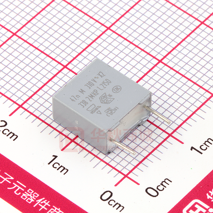

    薄膜电容 CAP_10X5MM_TM 47nF ±20% 10.00 x 5.00mm 310VAC
BFC233820473 数据手册
MKP338 2 X2 www.vishay.com Vishay BCcomponents Interference Suppression Film Capacitors MKP Radial Potted Type FEATURES • 7.5 mm to 27.5 mm lead pitch • Supplied loose in box, taped on reel • Material categorization: for definitions of compliance please see www.vishay.com/doc?99912 APPLICATIONS For standard across the line X2 applications See also application note: www.vishay.com/doc?28153 QUICK REFERENCE DATA Capacitance range (E12 series) 0.001 μF to 3.3 μF (preferred values acc. to E6) Capacitance tolerance ± 20 %; ± 10 %, ± 5 % Climatic testing class according to IEC 60068-1 55/110/56/B Rated AC voltage 310 VAC; 50 Hz to 60 Hz Permissible DC voltage 800 VDC at 85 °C, 630 VDC at 110 °C C  470 nF: 110 °C (125 °C for less than 1000 h), C > 470 nF: 110 °C Maximum application temperature IEC 60384-14 ed-4 (2013) and EN 60384-14 IEC 60065 requires pass. flamm. class B UL 60384-14; CSA-E384-14, CQC Reference standards Dielectric Polypropylene film Electrodes Metallized film Mono construction Construction Plastic case, epoxy resin sealed, flame retardant UL-class 94 V-0 Encapsulation Leads Tinned wire C-value; tolerance; rated voltage; sub-class; manufacturer’s type designation; code for dielectric material, manufacturer location; manufacturer’s logo; year and week; safety approvals Marking Note • For more detailed data and test requirements, contact: rfi@vishay.com DIMENSIONS l w h lt P Revision: 21-Sep-16 Ø dt Document Number: 28119 1 For technical questions, contact: rfi@vishay.com THIS DOCUMENT IS SUBJECT TO CHANGE WITHOUT NOTICE. THE PRODUCTS DESCRIBED HEREIN AND THIS DOCUMENT ARE SUBJECT TO SPECIFIC DISCLAIMERS, SET FORTH AT www.vishay.com/doc?91000 MKP338 2 X2 www.vishay.com Vishay BCcomponents COMPOSITION OF CATALOG NUMBER TYPE AND PITCHES 338 2 X2 MULTIPLIER (nF) CAPACITANCE 7.5 mm 10.0 mm 15.0 mm 22.5 mm 27.5 mm 0.1 1 10 100 (numerically) 2 3 4 5 Example: BFC2 338 2222(*) 338 2X 2X XX XX 104 = 10 x 10 = 100 nF X X (*) Old ordering code TYPE PACKAGING STANDARD DIMENSIONS Lead length 3.5 mm + 1 mm/- 0.5 mm; pitch ≤ 10.0 mm Lead length 3.5 mm ± 0.3 mm; pitch ≥ 15.0 mm Lead length 5.0 mm ± 1 mm Lead length 25.0 mm ± 2 mm C-TOL. Taped ammo (1) Pitch ≤ 15.0 mm; H = 18.5 mm; P0 = 12.7 mm Taped reel (1) Pitch 22.5 mm; H = 18.5 mm; P0 = 12.7 mm ± 20 % ± 10 % ±5% Loose in box MKP338 2 X2 TYPE MKP338 2 X2 PACKAGING Loose in box PREFERRED TYPES BFC2 338 20 BFC2 338 20 BFC2 338 22 BFC2 338 24 ± 20 % ALTERNATIVE PITCH SIZES AND TOLERANCES Packaging like 20 % and alternative pitch sizes C-TOL. ±5% ± 10 % ± 20 % See tables for details PREFERRED TYPES See tables for details Notes (1) Taped on reel and taped on ammo pitch = 27.5 mm is not available • For detailed tape specifications refer to packaging information: www.vishay.com/doc?28139 SPECIFIC REFERENCE DATA DESCRIPTION Rated AC voltage (URAC) Permisssible DC voltage (URDC) Tangent of loss angle: C 470 nF 470 nF < C 1 μF C > 1 μF Rated voltage pulse slope (dU/dt)R at 435 VDC Pitch = 7.5 mm Pitch = 10 mm Pitch = 15 mm and 7.5 mm (bent back) Pitch = 22.5 mm Pitch = 27.5 mm R between leads, for C  0.33 μF at 100 V; 1 min RC between leads, for C > 0.33 μF at 100 V; 1 min R between leads and case; 100 V; 1 min Withstanding (DC) voltage (cut off current 10 mA) (1); rise time  1000 V/s: C  1 μF C > 1 μF Withstanding (AC) voltage between leads and case Max. application temperature for 0.001 μF  C  0.47 μF Max. application temperature for C > 0.47 μF VALUE 310 V 630 V at 1 kHz 10 x 10-4 20 x 10-4 30 x 10-4 at 10 kHz 20 x 10-4 70 x 10-4 600 V/μs 600 V/μs 400 V/μs 150 V/μs 100 V/μs > 15 000 M > 5000 s > 30 000 M 2200 V; 1 min 1800 V; 1 min 2120 V; 1 min 110 °C (125 °C for less than 1000 h) 110 °C Note (1) See “Voltage Proof Test for Metalized Film Capacitors”: www.vishay.com/doc?28169 Revision: 21-Sep-16 Document Number: 28119 2 For technical questions, contact: rfi@vishay.com THIS DOCUMENT IS SUBJECT TO CHANGE WITHOUT NOTICE. THE PRODUCTS DESCRIBED HEREIN AND THIS DOCUMENT ARE SUBJECT TO SPECIFIC DISCLAIMERS, SET FORTH AT www.vishay.com/doc?91000 MKP338 2 X2 www.vishay.com Vishay BCcomponents ELECTRICAL DATA AND ORDERING CODE - PITCH 7.5 mm CATALOG NUMBER BFC2 338 ..... AND PACKAGING URAC (V) CAP. (μF) DIMENSIONS wxhxl (mm) AMMOPACK (1) LOOSE IN BOX MASS (g) (2) SHORT LEADS lt = 3.5 mm + 1 mm/- 0.5 mm lt = 5.0 mm ± 1.0 mm LONG LEADS SPQ lt = 25.0 mm ± 2.0 mm H = 18.5 mm P0 = 12.7 mm SPQ SPQ PITCH = 7.5 mm ± 0.4 mm; dt = 0.50 mm ± 0.05 mm; C-TOL. = ± 20 % 0.0010 20102 22102 24102 26102 0.0012 20122 22122 24122 26122 0.0015 20152 22152 24152 26152 0.0018 20182 22182 24182 26182 0.0022 20222 22222 24222 26222 0.0027 20272 22272 24272 26272 0.0033 20332 22332 24332 26332 0.0039 20392 22392 24392 0.0047 20472 22472 0.0056 0.4 24472 26392 1000 26472 20562 22562 24562 26562 0.0068 20682 22682 24682 26682 0.0082 20822 22822 24822 26822 0.010 20103 22103 24103 26103 0.012 20123 22123 24123 26123 0.015 20153 22153 24153 26153 0.018 20183 22183 24183 26183 0.022 20223 22223 24223 26223 0.027 20273 22273 0.033 20333 22333 0.039 310 4.0 x 9.0 x 10.0 1500 0.047 5.0 x 10.5 x 10.0 0.6 20393 22393 20473 22473 1000 750 24273 24333 24393 24473 1250 1000 26273 26333 26393 26473 1250 1000 750 PITCH = 7.5 mm ± 0.4 mm; dt = 0.50 mm ± 0.05 mm; C-TOL. = ± 10 % 0.0010 28101 28301 28501 28701 0.0012 28102 28302 28502 28702 0.0015 28103 28303 28503 28703 0.0018 28104 28304 28504 28704 0.0022 28105 28305 28505 28705 0.0027 28106 28306 28506 28706 0.0033 28107 28307 28507 28707 0.0039 28108 28308 28508 0.0047 28109 28309 28111 28311 28511 28711 28112 28312 28512 28712 0.0056 4.0 x 9.0 x 10.0 0.4 0.0068 1500 28509 28708 1000 28709 0.0082 28113 28313 28513 28713 0.010 28114 28314 28514 28714 0.012 28115 28315 28515 28715 0.015 28116 28316 28516 28716 0.018 28117 28317 28517 28717 0.022 28118 28318 28518 28718 0.027 28119 28319 28519 28719 28121 28321 0.033 0.039 0.047 Revision: 21-Sep-16 5.0 x 10.5 x 10.0 0.6 6.0 x 11.5 x 10.0 0.8 28122 28332 28123 28323 1000 750 28521 28522 28523 1250 1000 28721 28722 28723 1250 1000 750 Document Number: 28119 3 For technical questions, contact: rfi@vishay.com THIS DOCUMENT IS SUBJECT TO CHANGE WITHOUT NOTICE. THE PRODUCTS DESCRIBED HEREIN AND THIS DOCUMENT ARE SUBJECT TO SPECIFIC DISCLAIMERS, SET FORTH AT www.vishay.com/doc?91000 MKP338 2 X2 www.vishay.com Vishay BCcomponents ELECTRICAL DATA AND ORDERING CODE - PITCH 7.5 mm CATALOG NUMBER BFC2 338 ..... AND PACKAGING URAC (V) CAP. (μF) DIMENSIONS wxhxl (mm) AMMOPACK (1) LOOSE IN BOX MASS (g) (2) SHORT LEADS lt = 3.5 mm + 1 mm/- 0.5 mm lt = 5.0 mm ± 1.0 mm H = 18.5 mm P0 = 12.7 mm LONG LEADS SPQ lt = 25.0 mm ± 2.0 mm SPQ SPQ PITCH = 7.5 mm ± 0.4 mm; dt = 0.50 mm ± 0.05 mm; C-TOL. = ± 5 % 0.0010 28201 28401 28601 28801 0.0012 28202 28402 28602 28802 0.0015 28203 28403 28603 28803 0.0018 28204 28404 28604 28804 0.0022 28205 28405 28605 28805 0.0027 28206 28406 28606 28806 0.0033 28207 28407 28607 28807 0.0039 28208 28408 28608 0.0047 28209 28409 28211 28411 28611 28811 0.0068 28212 28412 28612 28812 0.0082 28213 28413 28613 28813 0.010 28214 28414 28614 28814 0.012 28215 28415 28615 28815 0.015 28216 28416 28616 28816 0.018 28217 28417 28617 28817 0.022 28218 28418 28618 0.027 28219 28419 1000 28619 1250 28819 1000 0.033 28221 28421 1000 28621 1250 28821 1000 28222 28422 750 28622 1000 28822 750 28223 28423 750 28623 1000 28823 750 0.0056 310 0.039 0.047 4.0 x 9.0 x 10.0 0.4 5.0 x 10.5 x 10.0 0.6 6.0 x 11.5 x 10.0 0.8 1500 28609 28808 1000 28809 1250 28818 Notes • SPQ = Standard Packing Quantity (1) H = In-tape height, P = Sprocket hole distance; for detailed specifications refer to packaging information: www.vishay.com/doc?28139 0 (2) Weight for short lead product only ELECTRICAL DATA AND ORDERING CODE - PITCH 10 mm CATALOG NUMBER BFC2 338 ..... AND PACKAGING URAC (V) CAP. (μF) DIMENSIONS wxhxl (mm) AMMOPACK (1) LOOSE IN BOX MASS (g) (2) SHORT LEADS lt = 3.5 mm + 1 mm/- 0.5 mm lt = 5.0 mm ± 1.0 mm LONG LEADS SPQ lt = 25.0 mm ± 2.0 mm SPQ H = 18.5 mm P0 = 12.7 mm SPQ PITCH = 10.0 mm ± 0.4 mm; dt = 0.60 mm ± 0.06 mm; C-TOL. = ± 20 % 310 0.0010 21102 23102 25102 0.0012 21122 23122 25122 0.0015 21152 23152 25152 0.0018 21182 23182 25182 21222 23222 21272 23272 0.0033 21332 23332 25332 0.0039 21392 23392 25392 0.0047 21472 23472 25472 0.0056 21562 23562 25562 0.0022 0.0027 Revision: 21-Sep-16 4.0 x 10.0 x 12.5 0.6 1000 1250 25222 Not available 25272 1000 Document Number: 28119 4 For technical questions, contact: rfi@vishay.com THIS DOCUMENT IS SUBJECT TO CHANGE WITHOUT NOTICE. THE PRODUCTS DESCRIBED HEREIN AND THIS DOCUMENT ARE SUBJECT TO SPECIFIC DISCLAIMERS, SET FORTH AT www.vishay.com/doc?91000 MKP338 2 X2 www.vishay.com Vishay BCcomponents ELECTRICAL DATA AND ORDERING CODE - PITCH 10 mm CATALOG NUMBER BFC2 338 ..... AND PACKAGING URAC (V) CAP. (μF) DIMENSIONS wxhxl (mm) MASS (g) (2) SHORT LEADS lt = 3.5 mm + 1 mm/- 0.5 mm 0.0068 0.0082 0.010 0.012 0.015 0.018 0.022 0.027 0.033 0.039 0.047 0.056 0.068 0.082 0.10 310 0.0010 0.0012 0.0015 0.0018 0.0022 0.0027 0.0033 0.0039 0.0047 0.0056 0.0068 0.0082 0.010 0.012 0.015 0.018 0.022 0.027 0.033 0.039 0.047 0.056 0.068 0.082 0.056 0.068 0.082 AMMOPACK (1) LOOSE IN BOX lt = 5.0 mm ± 1.0 mm LONG LEADS SPQ lt = 25.0 mm ± 2.0 mm PITCH = 10.0 mm ± 0.4 mm; dt = 0.60 mm ± 0.06 mm; C-TOL. = ± 20 % 21682 23682 25682 21822 23822 25822 21103 23103 25103 21123 23123 25123 21153 23153 25153 4.0 x 10.0 x 12.5 0.6 21183 23183 1000 25183 21223 23223 25223 21273 23273 25273 21333 23333 25333 21393 23393 25393 21473 23473 25473 20563 22563 24563 5.0 x 11.0 x 12.5 0.82 750 20683 22683 24683 20823 22823 24823 6.0 x 12.0 x 12.5 1.1 750 20104 22104 24104 PITCH = 10.0 mm ± 0.4 mm; dt = 0.60 mm ± 0.06 mm; C-TOL. = ± 10 % 29194 29217 29241 29195 29218 29242 29196 29219 29243 29197 29221 29244 29198 29222 29245 29199 29223 29246 29201 29224 29247 29202 29225 29248 29203 29226 29249 29204 29227 29251 29205 29228 29252 4.0 x 10.0 x 12.5 0.6 1000 29206 29229 29253 29207 29231 29254 29208 29232 29255 29209 29233 29256 29211 29234 29257 29212 29235 29258 29213 29236 29259 29214 29237 29261 29215 29238 29262 29216 29239 29263 28124 28324 28524 5.0 x 11.0 x 12.5 0.82 750 28125 28325 28525 6.0 x 12.0 x 12.5 1.1 28126 28326 750 28526 PITCH = 10.0 mm ± 0.4 mm; dt = 0.60 mm ± 0.06 mm; C-TOL. = ± 5 % 5.0 x 11.0 x 12.5 0.82 28224 28424 750 28624 28225 28425 28625 6.0 x 12.0 x 12.5 1.1 750 28226 28426 28626 H = 18.5 mm P0 = 12.7 mm SPQ 1000 750 750 SPQ Not available 27563 27683 27823 27104 500 500 1250 Not available 500 1000 750 750 750 750 28924 28925 28926 28944 28945 28946 500 500 Notes • SPQ = Standard Packing Quantity (1) H = In-tape height, P = Sprocket hole distance; for detailed specifications refer to packaging information: www.vishay.com/doc?28139 0 (2) Weight for short lead product only Revision: 21-Sep-16 Document Number: 28119 5 For technical questions, contact: rfi@vishay.com THIS DOCUMENT IS SUBJECT TO CHANGE WITHOUT NOTICE. THE PRODUCTS DESCRIBED HEREIN AND THIS DOCUMENT ARE SUBJECT TO SPECIFIC DISCLAIMERS, SET FORTH AT www.vishay.com/doc?91000 MKP338 2 X2 www.vishay.com Vishay BCcomponents ELECTRICAL DATA AND ORDERING CODE - PITCH 15 mm CATALOG NUMBER BFC2 338 ..... AND PACKAGING URAC (V) CAP. (μF) 0.010 0.012 0.015 0.018 0.022 0.027 0.033 0.039 0.047 0.056 0.068 0.082 0.10 0.12 0.15 0.18 0.22 0.27 0.33 310 0.010 0.012 0.015 0.018 0.022 0.027 0.033 0.039 0.047 0.056 0.068 0.082 0.10 0.12 0.15 0.18 0.22 0.27 0.33 0.10 0.12 0.15 0.18 0.22 0.27 DIMENSIONS wxhxl (mm) AMMOPACK (1) LOOSE IN BOX MASS (g) (2) SHORT LEADS LONG LEADS lt = 3.5 mm lt = 5.0 mm lt = 25.0 mm SPQ ± 0.3 mm ± 1.0 mm ± 2.0 mm PITCH = 15.0 mm ± 0.4 mm; dt = 0.60 mm ± 0.06 mm; C-TOL. = ± 20 % 29076 29096 29116 29077 29097 29117 29078 29098 29118 29079 29099 29119 29081 29101 29121 29082 29102 29122 29083 29103 29123 5.0 x 11.0 x 17.5 1.0 1000 29084 29104 29124 29085 29105 29125 21563 23563 25563 21683 23683 25683 21823 23823 25823 21104 23104 25104 20124 22124 24124 20154 22154 24154 6.0 x 12.0 x 17.5 1.4 750 20184 22184 24184 PITCH = 15.0 mm ± 0.4 mm; dt = 0.80 mm ± 0.08 mm; C-TOL. = ± 20 % 7.0 x 13.5 x 17.5 1.8 20224 22224 750 24224 20274 22274 750 24274 8.5 x 15.0 x 17.5 2.4 20334 22334 500 24334 PITCH = 15.0 mm ± 0.4 mm; dt = 0.60 mm ± 0.06 mm; C-TOL. = ± 10 % 29066 29086 29106 29067 29087 29107 29068 29088 29108 29069 29089 29109 29071 29091 29111 29072 29092 29112 1000 29073 29093 29113 5.0 x 11.0 x 17.5 1.0 29074 29094 29114 29075 29095 29115 29126 29131 29135 29127 29132 29136 29128 29133 29137 28127 28327 1000 28527 28128 28328 28528 6.0 x 12.0 x 17.5 1.4 750 28129 28329 28529 PITCH = 15.0 mm ± 0.4 mm; dt = 0.80 mm ± 0.08 mm; C-TOL. = ± 10 % 28131 28331 28531 7.0 x 13.5 x 17.5 1.8 750 28132 28332 28532 28133 28333 28533 8.5 x 15.0 x 17.5 2.4 500 29129 29134 29138 PITCH = 15.0 mm ± 0.4 mm; dt = 0.60 mm ± 0.06 mm; C-TOL. = ± 5 % 5.0 x 11.0 x 17.5 1.0 28227 28427 1000 28627 28228 28428 28628 6.0 x 12.0 x 17.5 1.4 750 28229 28429 28629 PITCH = 15.0 mm ± 0.4 mm; dt = 0.80 mm ± 0.08 mm; C-TOL. = ± 5 % 7.0 x 13.5 x 17.5 1.8 28231 28431 750 28631 28232 28432 750 28632 8.5 x 15.0 x 17.5 2.4 28233 28433 500 28633 H = 18.5 mm P0 = 12.7 mm SPQ 1000 500 500 500 450 1000 1000 500 500 450 1000 500 500 500 450 SPQ 29141 29143 29145 29147 29149 29152 29154 29156 29158 29161 29163 29165 29166 27124 27154 27184 27224 27274 27334 29139 29142 29144 29146 29148 29151 29153 29155 29157 29159 29162 29164 28927 28928 28929 28931 28932 28933 29167 1100 900 800 650 650 600 1100 900 800 650 600 28947 28948 28949 900 28951 28952 28953 650 650 600 800 Notes • SPQ = Standard Packing Quantity (1) H = In-tape height, P = Sprocket hole distance; for detailed specifications refer to packaging information: www.vishay.com/doc?28139 0 (2) Weight for short lead product only Revision: 21-Sep-16 Document Number: 28119 6 For technical questions, contact: rfi@vishay.com THIS DOCUMENT IS SUBJECT TO CHANGE WITHOUT NOTICE. THE PRODUCTS DESCRIBED HEREIN AND THIS DOCUMENT ARE SUBJECT TO SPECIFIC DISCLAIMERS, SET FORTH AT www.vishay.com/doc?91000 MKP338 2 X2 www.vishay.com Vishay BCcomponents ELECTRICAL DATA AND ORDERING CODE - PITCH 22.5 mm CATALOG NUMBER BFC2 338 ..... AND PACKAGING URAC (V) REEL (500 mm) (1) LOOSE IN BOX DIMENSIONS wxhxl (mm) CAP. (μF) MASS (g) (2) SHORT LEADS lt = 3.5 mm ± 0.3 mm lt = 5.0 mm ± 1.0 mm LONG LEADS SPQ lt = 25.0 mm ± 2.0 mm H = 18.5 mm P0 = 12.7 mm SPQ SPQ PITCH = 22.5 mm ± 0.4 mm; dt = 0.80 mm ± 0.08 mm; C-TOL. = ± 20 % 0.12 21124 23124 0.15 21154 23154 21184 23184 21224 23224 0.27 21274 23274 0.33 21334 23334 20394 22394 20474 22474 20564 22564 20684 22684 20824 22824 20105 22105 0.18 6.0 x 15.5 x 26.0 0.22 0.39 7.0 x 16.5 x 26.0 2.9 8.5 x 18.0 x 26.0 3.8 10.0 x 19.5 x 26.0 6.8 0.47 0.56 0.68 0.82 1.0 2.4 300 25124 25154 250 25184 200 25224 25274 200 150 24394 24474 24564 24684 24824 24105 29265 600 29266 250 25334 200 29264 29267 29268 500 29269 250 200 200 27394 27474 27564 27684 27824 27105 450 350 300 PITCH = 22.5 mm ± 0.4 mm; dt = 0.80 mm ± 0.08 mm; C-TOL. = ± 10 % 310 0.12 29169 29175 0.15 29171 29176 29172 29177 29183 29173 29178 29184 0.27 29174 29179 0.33 28134 28334 28534 28135 28335 28535 28136 28336 28137 28337 28138 28338 28139 28339 0.18 6.0 x 15.5 x 26.0 0.22 0.39 7.0 x 16.5 x 26.0 2.9 8.5 x 18.0 x 26.0 3.8 10.0 x 19.5 x 26.0 6.8 0.47 0.56 0.68 0.82 2.4 300 200 200 29181 29182 29185 28538 29271 29272 600 29273 250 250 28536 28537 150 250 29274 29275 28934 450 28935 450 28936 200 28539 500 28937 28938 28939 350 300 PITCH = 22.5 mm ± 0.4 mm; dt = 0.80 mm ± 0.08 mm; C-TOL. = ± 5 % 0.33 28234 28434 28235 28435 28236 28436 28237 28437 6.8 28238 28438 150 28638 200 28958 300 7.8 28239 28439 150 28639 200 28959 300 7.0 x 16.5 x 26.0 2.9 8.5 x 18.0 x 26.0 3.8 0.68 10.0 x 19.5 x 26.0 0.82 12.0 x 22.0 x 26.0 0.39 0.47 0.56 200 200 28634 28635 28636 28637 250 200 28954 28955 28956 28957 450 350 Notes • SPQ = Standard Packing Quantity (1) H = In-tape height, P = Sprocket hole distance; for detailed specifications refer to packaging information: www.vishay.com/doc?28139 0 (2) Weight for short lead product only Revision: 21-Sep-16 Document Number: 28119 7 For technical questions, contact: rfi@vishay.com THIS DOCUMENT IS SUBJECT TO CHANGE WITHOUT NOTICE. THE PRODUCTS DESCRIBED HEREIN AND THIS DOCUMENT ARE SUBJECT TO SPECIFIC DISCLAIMERS, SET FORTH AT www.vishay.com/doc?91000 MKP338 2 X2 www.vishay.com Vishay BCcomponents ELECTRICAL DATA AND ORDERING CODE - PITCH 27.5 mm CATALOG NUMBER BFC2 338 ..... AND PACKAGING URAC (V) CAP. (μF) DIMENSIONS wxhxl (mm) LOOSE IN BOX MASS (g) (1) SHORT LEADS lt = 3.5 mm ± 0.3 mm lt = 5.0 mm ± 1.0 mm LONG LEADS SPQ lt = 25.0 mm ± 2.0 mm SPQ PITCH = 27.5 mm ± 0.4 mm; dt = 0.80 mm ± 0.08 mm; C-TOL. = ± 20 % 0.39 21394 23394 25394 0.47 21474 23474 25474 21564 23564 25564 0.68 21684 23684 25684 0.82 21824 23824 1.0 21105 23105 0.56 1.2 1.5 1.8 2.2 2.7 3.3 9.0 x 19.0 x 31.5 11.0 x 21.0 x 31.0 5.5 7.4 13.0 x 23.0 x 31.0 9.2 15.0 x 25.0 x 31.5 12.3 18.0 x 28.0 x 31.5 16.1 100 25824 25105 20125 22125 24125 20155 22155 24155 20185 22185 24185 20225 22225 24225 20275 22275 20335 22335 50 24275 24335 150 125 100 75 PITCH = 27.5 mm ± 0.4 mm; dt = 0.80 mm ± 0.08 mm; C-TOL. = ± 10 % 310 1.0 11.0 x 21.0 x 31.0 7.4 13.0 x 23.0 x 31.0 9.2 15.0 x 25.0 x 31.5 12.3 2.7 18.0 x 28.0 x 31.5 16.1 1.0 11.0 x 21.0 x 31.0 7.4 13.0 x 23.0 x 31.0 9.2 15.0 x 25.0 x 31.5 12.3 18.0 x 28.0 x 31.5 16.1 1.2 1.5 1.8 2.2 28141 28341 28142 28342 28143 28343 28144 28344 28145 28345 28146 28346 28541 100 28542 28544 50 125 28543 28545 28546 100 75 PITCH = 27.5 mm ± 0.4 mm; dt = 0.80 mm ± 0.08 mm; C-TOL. = ± 5 % 1.2 1.5 1.8 2.2 2.7 28241 28441 28242 28442 28243 28443 28244 28444 28245 28445 28246 28446 100 100 100 50 28641 28642 28643 28644 28645 28646 125 125 100 75 Notes • SPQ = Standard Packing Quantity (1) Weight for short lead product only Revision: 21-Sep-16 Document Number: 28119 8 For technical questions, contact: rfi@vishay.com THIS DOCUMENT IS SUBJECT TO CHANGE WITHOUT NOTICE. THE PRODUCTS DESCRIBED HEREIN AND THIS DOCUMENT ARE SUBJECT TO SPECIFIC DISCLAIMERS, SET FORTH AT www.vishay.com/doc?91000 MKP338 2 X2 www.vishay.com Vishay BCcomponents APPROVALS SAFETY APPROVALS X2 VOLTAGE VALUE FILE NUMBERS LINKS 310 VAC 1 nF to 3.3 μF FI 2016052 www.vishay.com/doc?28179 310 VAC 310 VAC 1 nF to 3.3 μF 1 nF to 3.3 μF E354331 E354331 www.vishay.com/doc?28184 CQC 310 VAC 1 nF to 3.3 μF CQC07001018685 (F) www.vishay.com/doc?28227 CQC07001021279 (L) www.vishay.com/doc?28228 CB-test certificate 310 VAC 1 nF to 3.3 μF FI 9369 www.vishay.com/doc?28175 EN60384-14 (ENEC) (= IEC 60384-14 ed-4 (2013)) UL 60384-14 CSA-E384-14 The ENEC-approval together with the CB-certificate replace all national marks of the following countries (they have already signed the ENEC-agreement): Austria; Belgium; Czech. Republic; Denmark; Finland; France; Germany; Greece; Hungary; Ireland; Italy; Luxembourg; Netherlands; Norway; Portugal; Slovenian; Spain; Sweden; Switzerland; and United Kingdom. MOUNTING Normal Use The capacitors are designed for mounting on printed-circuit boards. The capacitors packed in bandoliers are designed for mounting in printed-circuit boards by means of automatic insertion machines. For detailed tape specifications refer to packaging information: www.vishay.com/doc?28139 Specific Method of Mounting to Withstand Vibration and Shock In order to withstand vibration and shock tests, it must be ensured that the stand-off pips are in good contact with the printed-circuit board: • For pitches  15 mm capacitors shall be mechanically fixed by the leads • For longer pitches the capacitors shall be mounted in the same way and the body clamped Space Requirements on Printed Circuit Board The maximum space for length (Imax.), width (wmax.) and height (hmax. ) of film capacitors to take in account on the printed circuit board is shown in the drawings. • For products with pitch  15 mm, w = l = 0.3 mm; h = 0.1 mm • For products with 15 mm < pitch  27.5 mm, w = l = 0.5 mm; h = 0.1 mm Eccentricity defined as in drawing. The maximum eccentricity is smaller than or equal to the lead diameter of the product concerned. wmax. = W + D Eccentricity Imax. = I + D hmax. = h + D Seating plane SOLDERING For general soldering conditions and wave soldering profile, we refer to the application note:  “Soldering Guidelines for Film Capacitors”: www.vishay.com/doc?28171 Storage Temperature Tstg = -25 °C to +35 °C with RH maximum 75 % without condensation Ratings and Characteristics Reference Conditions Unless otherwise specified, all electrical values apply to an ambient temperature of 23 °C ± 1 °C, an atmospheric pressure of 86 kPa to 106 kPa and a relative humidity of 50 % ± 2 %. For reference testing, a conditioning period shall be applied over 96 h ± 4 h by heating the products in a circulating air oven at the rated temperature and a relative humidity not exceeding 20 %. Revision: 21-Sep-16 Document Number: 28119 9 For technical questions, contact: rfi@vishay.com THIS DOCUMENT IS SUBJECT TO CHANGE WITHOUT NOTICE. THE PRODUCTS DESCRIBED HEREIN AND THIS DOCUMENT ARE SUBJECT TO SPECIFIC DISCLAIMERS, SET FORTH AT www.vishay.com/doc?91000 MKP338 2 X2 www.vishay.com Vishay BCcomponents CHARACTERISTICS 10 3 2 1n F 4.7 10 nF nF Impedance (Ω) ΔC/C (%) 4 typical 47 n 10 F 0n F 10 1 0 max. -2 10 -4 10 -1 47 0 10 nF 00 nF 33 00 nF 0 min. -6 - 50 0 10 -2 10 4 Tamb (°C) 100 50 10 6 10 7 f (Hz) 10 8 102 f (MHz) Dissipation factor (x 10-4) 103 101 102 F 1 µ µF > C C≤1 F F< 0n 0 n ≤ 22 22 C F n < nF ≤ 47 47 F < C F n 10 n 0 1 C≤ 101 X2 100 10-1 100 101 102 103 104 f (Hz) 105 1 10 100 1000 C (nF) 10 000 Resonant frequency as a function of capacitance (typical curve) Tangent of loss angle as a function of frequency (typical curve) 3 AC current (mA) 10 4 AC voltage (V) 10 5 Impedance as a function of frequency (typical curve) Capacitance as a function of ambient temperature (typical curve) 10 10 1000 nF 470 nF 10 2 100 nF 3300 nF 2 47 nF 10 1 10 nF 4.7 nF 10 10 1nF Tamb ≤ 110 °C Tamb ≤ 110 °C 10 1 1 10 0 2 10 3 10 4 f (Hz) Max. RMS voltage as a function of frequency (typical curve) Revision: 21-Sep-16 10 5 10 -1 1 10 10 2 10 3 10 4 f (Hz) 105 Max. RMS current as a function of frequency (typical curve) Document Number: 28119 10 For technical questions, contact: rfi@vishay.com THIS DOCUMENT IS SUBJECT TO CHANGE WITHOUT NOTICE. THE PRODUCTS DESCRIBED HEREIN AND THIS DOCUMENT ARE SUBJECT TO SPECIFIC DISCLAIMERS, SET FORTH AT www.vishay.com/doc?91000 MKP338 2 X2 www.vishay.com Vishay BCcomponents RC (s) 106 105 104 0 20 40 60 80 100 Tamb (°C) Insulation resistance APPLICATION NOTES • For X2 electromagnetics interference suppression in standard across the line applications (50 Hz/60 Hz) with a maximum mains voltage of 310 VAC. • For series impedance applications we refer to application note www.vishay.com/doc?28153 • For capacitors connected in parallel, normally the proof voltage and possibly the rated voltage must be reduced. For information depending of the capacitance value and the number of parallel connections contact: rfi@vishay.com • These capacitors are not intended for continuous pulse applications. For these situations, capacitors of the AC and pulse programs must be used. • The maximum ambient temperature must not exceed 105 °C (125 °C for less than 1000 h) for C  470 nF and 110 °C for C > 470 nF • Rated voltage pulse slope: If the pulse voltage is lower than the rated voltage, the values of the specific reference data can be multiplied by 435 VDC and divided by the applied voltage. INSPECTION REQUIREMENTS General Notes Sub-clause numbers of tests and performance requirements refer to the “Sectional Specification, IEC Publication IEC 60384-14 ed-4 (2013) and Specific Reference Data.” GROUP C INSPECTION REQUIREMENTS SUB-CLAUSE NUMBER AND TEST CONDITIONS PERFORMANCE REQUIREMENTS SUB-GROUP C1A PART OF SAMPLE OF SUB-GROUP C1 4.1 Dimensions (detail) As specified in chapters “General Data” of this specification Initial measurements Capacitance Tangent of loss angle: For C  1 μF at 10 kHz For C > 1 μF at 1 kHz 4.3 Robustness of terminations Tensile: Load 10 N; 10 s Bending: Load 5 N; 4 x 90° 4.4 Resistance to soldering heat No pre-drying Method: 1A Solder bath: 280 °C ± 5 °C Duration: 10 s Revision: 21-Sep-16 No visible damage Document Number: 28119 11 For technical questions, contact: rfi@vishay.com THIS DOCUMENT IS SUBJECT TO CHANGE WITHOUT NOTICE. THE PRODUCTS DESCRIBED HEREIN AND THIS DOCUMENT ARE SUBJECT TO SPECIFIC DISCLAIMERS, SET FORTH AT www.vishay.com/doc?91000 MKP338 2 X2 www.vishay.com Vishay BCcomponents GROUP C INSPECTION REQUIREMENTS SUB-CLAUSE NUMBER AND TEST SUB-GROUP C1A PART OF SAMPLE OF SUB-GROUP C1 4.19 Component solvent resistance 4.4.2 Final measurements SUB-GROUP C1B PART OF SAMPLE OF SUB-GROUP C1 Initial measurements CONDITIONS Isopropylalcohol at room temperature Method: 2 Immersion time: 5 min ± 0.5 min Recovery time: Min. 1 h, max. 2 h Visual examination No visible damage Legible marking Capacitance |C/C|  5 % of the value measured initially Tangent of loss angle Increase of tan :  0.008 for: C  1 μF or  0.005 for: C > 1 μF Compared to values measured initially Insulation resistance As specified in section “Insulation resistance” of this specification Capacitance Tangent of loss angle: For C  1 μF at 10 kHz For C > 1 μF at 1 kHz 4.20 Solvent resistance of the marking Isopropylalcohol at room temperature Method: 1 Rubbing material: Cotton wool Immersion time: 5 min ± 0.5 min 4.6 A = - 55 °C B = + 110 °C 5 cycles Duration t = 30 min Rapid change of temperature 4.6.1 Inspection Visual examination 4.7 Mounting: See section “Mounting” of this specification Procedure B4 Frequency range: 10 Hz to 55 Hz. Amplitude: 0.75 mm or Acceleration 98 m/s2 (whichever is less severe) Total duration 6 h Vibration (see note 3.1) 4.7.2 Final inspection Visual examination 4.9 Mounting: See section “Mounting” for more information Pulse shape: Half sine Acceleration: 490 m/s2 Duration of pulse: 11 ms Shock (see note 3) 4.9.2 Final measurements Revision: 21-Sep-16 PERFORMANCE REQUIREMENTS No visible damage Legible marking No visible damage No visible damage Visual examination No visible damage Capacitance |C/C|  5 % of the value measured initially Tangent of loss angle Increase of tan :  0.008 for: C  1 μF or  0.005 for: C > 1 μF Compared to values measured initially Insulation resistance As specified in section “Insulation resistance” of this specification Document Number: 28119 12 For technical questions, contact: rfi@vishay.com THIS DOCUMENT IS SUBJECT TO CHANGE WITHOUT NOTICE. THE PRODUCTS DESCRIBED HEREIN AND THIS DOCUMENT ARE SUBJECT TO SPECIFIC DISCLAIMERS, SET FORTH AT www.vishay.com/doc?91000 MKP338 2 X2 www.vishay.com Vishay BCcomponents GROUP C INSPECTION REQUIREMENTS SUB-CLAUSE NUMBER AND TEST CONDITIONS PERFORMANCE REQUIREMENTS SUB-GROUP C1  COMBINED SAMPLE OF SPECIMENS OF SUB-GROUPS C1A AND C1B 4.11 Climatic sequence 4.11.1 Initial measurements Capacitance Measured in 4.4.2 and 4.9.2 Tangent of loss angle: Measured initially in C1A and C1B 4.11.2 Dry heat Temperature: 110 °C 4.11.3 Damp heat cyclic Test Db First cycle Duration: 16 h 4.11.4 Cold Temperature: - 55 °C 4.11.5 Damp heat cyclic Test Db Remaining cycles Duration: 2 h 4.11.6 Final measurements Visual examination No visible damage Legible marking Capacitance |C/C|  5 % of the value measured in 4.11.1. Tangent of loss angle Increase of tan :  0.008 for: C  1 μF or  0.005 for: C > 1 μF Compared to values measured in 4.11.1. Voltage proof 1350 VDC; 1 min between terminations No permanent breakdown or flash-over Insulation resistance  50 % of values specified in section “Insulation resistance” of this specification SUB GROUP C2 4.12 Damp heat steady state 56 days; 40 °C; 90 % to 95 % RH no load 4.12.1 Initial measurements Capacitance Tangent of loss angle: at 1 kHz 4.12.3 Final measurements Visual examination No visible damage Legible marking Capacitance |C/C|  5 % of the value measured in 4.12.1. Tangent of loss angle Increase of tan :  0.008 for: C  1 μF or  0.005 for: C > 1 μF Compared to values measured in 4.12.1. Voltage proof 1350 VDC; 1 min between term. No permanent breakdown or flash-over Insulation resistance  50 % of values specified in section “Insulation Resistance” of this specification Revision: 21-Sep-16 Document Number: 28119 13 For technical questions, contact: rfi@vishay.com THIS DOCUMENT IS SUBJECT TO CHANGE WITHOUT NOTICE. THE PRODUCTS DESCRIBED HEREIN AND THIS DOCUMENT ARE SUBJECT TO SPECIFIC DISCLAIMERS, SET FORTH AT www.vishay.com/doc?91000 MKP338 2 X2 www.vishay.com Vishay BCcomponents GROUP C INSPECTION REQUIREMENTS SUB-CLAUSE NUMBER AND TEST CONDITIONS PERFORMANCE REQUIREMENTS SUB-GROUP C3 4.13.1 Initial measurements Capacitance Tangent of loss angle: For C  1 μF at 10 kHz For C > 1 μF at 1 kHz 4.13 Impulse voltage 3 successive impulses, full wave, peak voltage: X2: 2.5 kV for C  1 μF X2: 2.5 kV/C for C > 1 μF Max. 24 pulses 4.14 Endurance Duration: 1000 h 1.25 x URAC at 110 °C Once in every hour the voltage is increased to 1000 VRMS for 0.1 s via resistor of 47  ± 5 %  4.14.7 Final measurements No selfhealing breakdowns or flashover Visual examination No visible damage Legible marking Capacitance |C/C|  10 % compared to values measured in 4.13.1. Tangent of loss angle Increase of tan :  0.008 for: C  1 μF or  0.005 for: C > 1 μF Compared to values measured in 4.13.1. Voltage proof 1350 VDC; 1 min between terminations. 2120 VAC; 1 min between terminations and case No permanent breakdown or flash-over Insulation resistance  50 % of values specified in section “Insulation resistance” of this specification SUB-GROUP C4 4.15 Charge and discharge 10 000 cycles Charge to 435 VDC Discharge resistance:  435 V DC R = -------------------------------------------------1.25 x C  dU  dt   4.15.1 Initial measurements Capacitance Tangent of loss angle: For C  1 μF at 10 kHz For C > 1 μF at 1 kHz 4.15.3 Final measurements Capacitance |C/C|  10 % compared to values measured in 4.15.1. Tangent of loss angle Increase of tan :  0.008 for: C  1 μF or  0.005 for: C > 1 μF Compared to values measured in 4.15.1. Insulation resistance  50 % of values specified in section “Insulation Resistance” of this specification Revision: 21-Sep-16 Document Number: 28119 14 For technical questions, contact: rfi@vishay.com THIS DOCUMENT IS SUBJECT TO CHANGE WITHOUT NOTICE. THE PRODUCTS DESCRIBED HEREIN AND THIS DOCUMENT ARE SUBJECT TO SPECIFIC DISCLAIMERS, SET FORTH AT www.vishay.com/doc?91000 MKP338 2 X2 www.vishay.com Vishay BCcomponents GROUP C INSPECTION REQUIREMENTS SUB-CLAUSE NUMBER AND TEST CONDITIONS PERFORMANCE REQUIREMENTS SUB-GROUP C5 4.16 Radio frequency characteristic Resonance frequency  0.9 times the value as specified in section “Resonant frequency” of this specification Bore of gas jet: Ø 0.5 mm Fuel: Butane Test duration for actual volume V in mm3: V  250: 10 s 250 < V  500: 20 s 500 < V  1750: 30 s V > 1750: 60 s One flame application        12 mm  ~ 8 mm    45°  After removing test flame from capacitor, the capacitor must not continue to burn for more than 10 s. No burning particle must drop from the sample. SUB-GROUP C6 4.17 Passive flammability Class B  SUB-GROUP C7 4.18 Active flammability Revision: 21-Sep-16 20 cycles of 2.5 kV discharges on the test capacitor connected to URAC The cheese cloth around the capacitors shall not burn with a flame. No electrical measurements are required. Document Number: 28119 15 For technical questions, contact: rfi@vishay.com THIS DOCUMENT IS SUBJECT TO CHANGE WITHOUT NOTICE. THE PRODUCTS DESCRIBED HEREIN AND THIS DOCUMENT ARE SUBJECT TO SPECIFIC DISCLAIMERS, SET FORTH AT www.vishay.com/doc?91000 Legal Disclaimer Notice www.vishay.com Vishay Disclaimer  ALL PRODUCT, PRODUCT SPECIFICATIONS AND DATA ARE SUBJECT TO CHANGE WITHOUT NOTICE TO IMPROVE RELIABILITY, FUNCTION OR DESIGN OR OTHERWISE. Vishay Intertechnology, Inc., its affiliates, agents, and employees, and all persons acting on its or their behalf (collectively, “Vishay”), disclaim any and all liability for any errors, inaccuracies or incompleteness contained in any datasheet or in any other disclosure relating to any product. Vishay makes no warranty, representation or guarantee regarding the suitability of the products for any particular purpose or the continuing production of any product. To the maximum extent permitted by applicable law, Vishay disclaims (i) any and all liability arising out of the application or use of any product, (ii) any and all liability, including without limitation special, consequential or incidental damages, and (iii) any and all implied warranties, including warranties of fitness for particular purpose, non-infringement and merchantability. Statements regarding the suitability of products for certain types of applications are based on Vishay’s knowledge of typical requirements that are often placed on Vishay products in generic applications. Such statements are not binding statements about the suitability of products for a particular application. It is the customer’s responsibility to validate that a particular product with the properties described in the product specification is suitable for use in a particular application. Parameters provided in datasheets and / or specifications may vary in different applications and performance may vary over time. All operating parameters, including typical parameters, must be validated for each customer application by the customer’s technical experts. Product specifications do not expand or otherwise modify Vishay’s terms and conditions of purchase, including but not limited to the warranty expressed therein. Except as expressly indicated in writing, Vishay products are not designed for use in medical, life-saving, or life-sustaining applications or for any other application in which the failure of the Vishay product could result in personal injury or death. Customers using or selling Vishay products not expressly indicated for use in such applications do so at their own risk. Please contact authorized Vishay personnel to obtain written terms and conditions regarding products designed for such applications. No license, express or implied, by estoppel or otherwise, to any intellectual property rights is granted by this document or by any conduct of Vishay. Product names and markings noted herein may be trademarks of their respective owners. © 2017 VISHAY INTERTECHNOLOGY, INC. ALL RIGHTS RESERVED Revision: 08-Feb-17 1 Document Number: 91000
