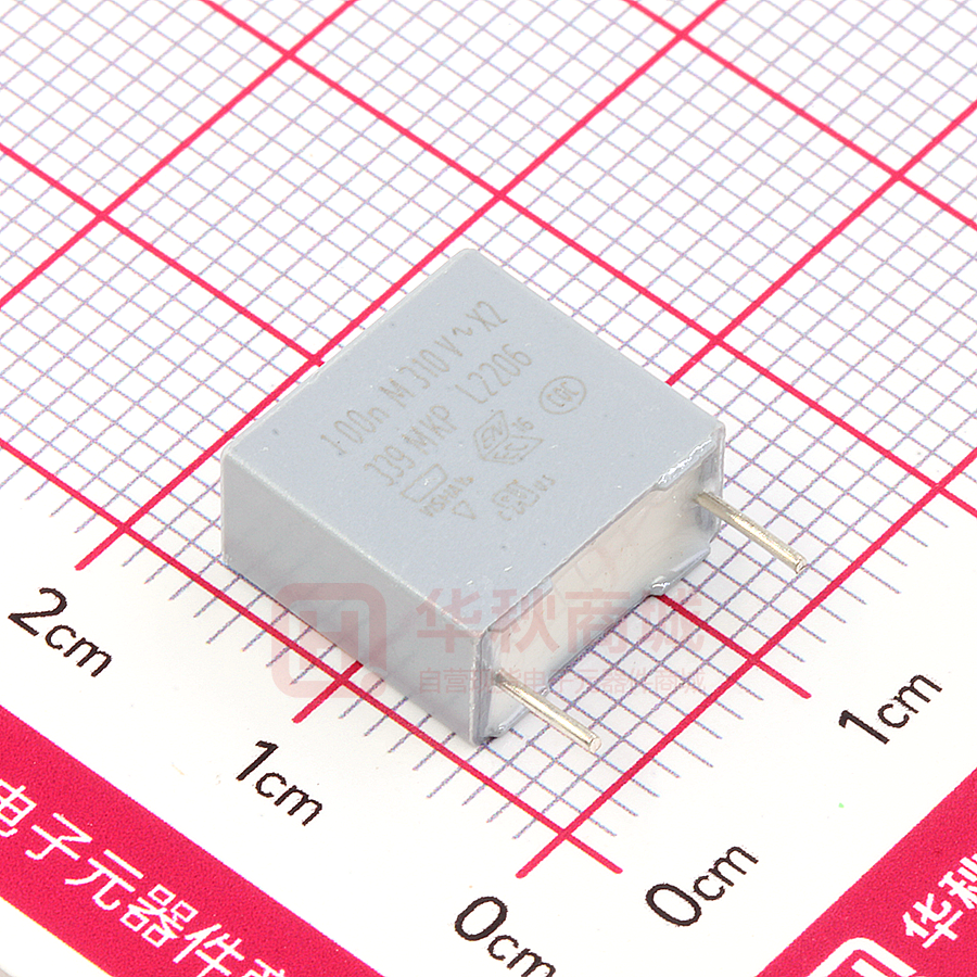

    薄膜电容 CAP_12.5X6MM_TM 100nF ±20% 12.50 x 6.00mm 310VAC
BFC233920104 数据手册
MKP339 X2 www.vishay.com Vishay BCcomponents Interference Suppression Film Capacitors MKP Radial Potted Type FEATURES • AEC-Q200 qualified (rev. C) • THB: 40 °C / 93 % RH for 1000 h at rated voltage, in compliance with AEC-Q200 • Compliant with IEC 60381-14: AMD1 grade IA • High temperature capabilities, up to 125 °C • Material categorization: for definitions of compliance please see www.vishay.com/doc?99912 APPLICATIONS For standard across the line X2 applications. See also application note: www.vishay.com/doc?28153 QUICK REFERENCE DATA Rated capacitance range (E12 series) Capacitance tolerance 0.001 μF to 4.7 μF (preferred values acc. to E6) ± 20 %; ± 10 %; ± 5 % 310 VAC; 50 Hz to 60 Hz Rated voltage range, URAC 800 VDC at 85 °C 630 VDC at 110 °C Permissible DC voltage 55/110/56/C for product volumes ≤ 1750 mm3 55/110/56/B for product volumes > 1750 mm3 110 °C 125 °C for limited time Climatic testing class Rated temperature Maximum application temperature IEC 60384-14:2013 IEC 60384-14:2013 / AMD1:2016 EN 60384-14:2013 + AMD1:2016 IEC 60065 requires pass. flamm. class B for volumes > 1750 mm3 UL 60384-14 CSA-E384-14 CQC Reference standards Dielectric Electrodes Polypropylene film Metallized Mono construction Construction Encapsulation Leads Plastic case, epoxy resin sealed, flame retardant UL-class 94 V-0 Tinned wire C-value; tolerance; rated voltage; sub-class; manufacturer’s type; code for dielectric material, manufacturer location; manufacturer’s logo; year and week; safety approvals Marking Note • For more detailed data and test requirements, contact rfi@vishay.com DIMENSIONS in millimeters l w h lt P Revision: 17-Jan-2024 Ø dt Document Number: 28138 1 For technical questions, contact: rfi@vishay.com THIS DOCUMENT IS SUBJECT TO CHANGE WITHOUT NOTICE. THE PRODUCTS DESCRIBED HEREIN AND THIS DOCUMENT ARE SUBJECT TO SPECIFIC DISCLAIMERS, SET FORTH AT www.vishay.com/doc?91000 MKP339 X2 www.vishay.com Vishay BCcomponents COMPOSITION OF CATALOG NUMBER TYPE AND PITCHES MULTIPLIER (nF) 7.5 mm CAPACITANCE (numerically) 0.1 2 1 3 22.5 mm 10 4 27.5 mm 100 5 10.0 mm 339 15.0 mm X2 Example: 104 = 10 x 10 = 100 nF BFC2 TYPE PACKAGING Loose in box Taped (1) Loose in box Taped (1) Loose in box 339 X2 Taped (1) PACKAGING Loose in box Taped (1)(2) Loose in box Taped (1)(2) Loose in box Taped (1)(2) 339 XX XX X STANDARD DIMENSIONS Lead length 3.5 mm + 1 mm/- 0.5 mm or 3.5 mm ± 0.3 mm Le ad length 5.0 mm ± 1.0 m m Le ad length 25 .0 mm ± 2.0 m m Reel: H = 18.5 mm; P0 = 12.7 mm or 15.0 mm Ammopack: H = 18.5 mm; P0 = 12.7 mm Lead length 3.5 mm + 1 mm/- 0.5 mm or 3.5 mm ± 0.3 mm Lead length 5.0 mm ± 1.0 m m Lead length 25.0 mm ± 2.0 mm Reel: H = 18.5 mm; P0 = 12.7 mm or 15.0 mm Ammopack: H = 18.5 mm; P0 = 12.7 mm Lead length 3.5 mm + 1 mm/- 0.5 mm or 3.5 mm ± 0.3 mm Lead l ength 5. 0 mm ± 1. 0 m m L l e a d le n g t h 2 5 . 0 mm ± 2 . 0 m m Reel: H = 18.5 mm; P0 = 12.7 mm or 15.0 mm Ammopack: H = 18.5 mm; P0 = 12.7 mm ALTERNATIVE LARGER PITCH SIZES Lead length 3.5 mm + 1 mm/- 0.5 mm or 3.5 mm ± 0.3 mm Lead length 5.0 mm ± 1.0 m m Lead length 25.0 mm ± 2.0 mm Reel or ammopack: H = 18.5 mm; P0 = 12.7 mm Lead length 3.5 mm + 1 mm/- 0.5 mm or 3.5 mm ± 0.3 mm Le ad length 5.0 mm ± 1.0 m m Lead length 25 .0 mm ± 2.0 m m Reel or ammopack: H = 18.5 mm; P0 = 12.7 mm Lead length 3.5 mm + 1 mm/- 0.5 mm or 3.5 mm ± 0.3 mm Lead length 5. 0 mm ± 1. 0 m m Lea d length 25 .0 mm ± 2.0 m m Reel: H = 18.5 mm; P0 = 12.7 mm or 15.0 mm Ammopack: H = 18.5 mm; P0 = 12.7 mm C-TOL. ± 20 % ± 10 % ±5% C-TOL. ± 20 % ± 10 % ±5% CODE NUMBER BFC2 339 20... BFC2 339 22... BFC2 339 24... B F C 2 3 3 9 2 6. . . B F C 2 3 3 9 2 8. . . BFC2 339 10... BFC2 339 12... BFC2 339 14... B F C 2 3 3 9 1 6. . . B F C 2 3 3 9 1 8. . . BFC2 339 50... BFC2 339 52... BFC2 339 54... B F C 2 3 3 9 3 6. . . B F C 2 3 3 9 3 8. . . CODE NUMBER BFC2 339 21... BFC2 339 23... BFC2 339 25... BFC2 339 27... BFC2 339 11... BFC2 339 13... BFC2 339 15... BFC2 339 17... BFC2 339 51... BFC2 339 53... BFC2 339 55... B F C 2 3 3 9 4 6. . . B F C 2 3 3 9 4 8. . . Notes (1) For detailed tape specification refer to “Packaging Information”: www.vishay.com/doc?28139 (2) Taped on reel pitch = 27.5 mm is not available Revision: 17-Jan-2024 Document Number: 28138 2 For technical questions, contact: rfi@vishay.com THIS DOCUMENT IS SUBJECT TO CHANGE WITHOUT NOTICE. THE PRODUCTS DESCRIBED HEREIN AND THIS DOCUMENT ARE SUBJECT TO SPECIFIC DISCLAIMERS, SET FORTH AT www.vishay.com/doc?91000 MKP339 X2 www.vishay.com Vishay BCcomponents SPECIFIC REFERENCE DATA DESCRIPTION VALUE Rated AC voltage (URAC) 310 V Permissible DC voltage (URDC) 630 V Tangent of loss angle: at 1 kHz at 10 kHz C < 470 nF ≤ 10 x 10-4 ≤ 20 x 10-4 470 nF ≤ C ≤ 1 μF ≤ 20 x 10-4 ≤ 70 x 10-4 C > 1 μF ≤ 30 x 10-4 - Rated voltage pulse slope (dU/dt)R at 435 VDC: Pitch = 7.5 mm 600 V/μs Pitch = 10 mm 600 V/μs Pitch = 15 mm 400 V/μs Pitch = 22.5 mm 150 V/μs Pitch = 27.5 mm 100 V/μs R between leads, for C ≤ 0.33 μF at 100 V; 1 min > 15 000 MΩ RC between leads, for C > 0.33 μF at 100 V; 1 min > 5000 s R between leads and case; 100 V; 1 min > 30 000 MΩ Withstanding (DC) voltage (cut off current 10 mA) (1); rise time ≤ 1000 V/s: C ≤ 1 μF 2200 V; 1 min C > 1 μF 1800 V; 1 min Withstanding (AC) voltage between leads and case 2120 V; 1 min Max. application temperature for 0.001 μF ≤ C ≤ 0.47 μF 125 °C up to 1000 h Max. application temperature for C > 0.47 μF 125 °C up to 500 h Note (1) See “Voltage Proof Test for Metalized Film Capacitors”: www.vishay.com/doc?28169 ELECTRICAL DATA AND ORDERING INFORMATION - PITCH: 7.5 mm CATALOG NUMBER BFC2 339 XXXXX AND PACKAGING URAC (V) CAP. (μF) DIMENSIONS wxhxl (mm) AMMOPACK (1) LOOSE IN BOX MASS (g) (2) SHORT LEADS It = 3.5 mm + 1 mm/- 0.5 mm It = 5.0 mm ± 1.0 mm LONG LEADS SPQ It = 25.0 mm ± 2.0 mm H = 18.5 mm P0 = 12.7 mm SPQ SPQ PITCH = 7.5 mm ± 0.4 mm; dt = 0.50 mm ± 0.05 mm; C-TOL. = ± 20 % 0.0010 20102 22102 24102 28102 0.0015 20152 22152 24152 28152 0.0022 20222 22222 24222 28222 0.0033 20332 22332 24332 28332 0.0047 310 20472 22472 20682 22682 0.010 20103 22103 24103 28103 0.015 20153 22153 24153 28153 0.022 20223 22223 24223 28223 0.033 20333 22333 24333 28333 0.0068 4.0 x 9.0 x 10.0 0.4 1500 24472 24682 1000 28472 28682 1250 0.047 5.0 x 10.5 x 10.0 0.4 20473 22473 1000 24473 1250 28473 1000 0.068 6.0 x 11.5 x 10.0 0.8 20683 22683 750 24683 1000 28683 750 Revision: 17-Jan-2024 Document Number: 28138 3 For technical questions, contact: rfi@vishay.com THIS DOCUMENT IS SUBJECT TO CHANGE WITHOUT NOTICE. THE PRODUCTS DESCRIBED HEREIN AND THIS DOCUMENT ARE SUBJECT TO SPECIFIC DISCLAIMERS, SET FORTH AT www.vishay.com/doc?91000 MKP339 X2 www.vishay.com Vishay BCcomponents ELECTRICAL DATA AND ORDERING INFORMATION - PITCH: 7.5 mm CATALOG NUMBER BFC2 339 XXXXX AND PACKAGING URAC (V) 310 CAP. (μF) DIMENSIONS wxhxl (mm) AMMOPACK (1) LOOSE IN BOX MASS (g) (2) SHORT LEADS It = 3.5 mm It = 5.0 mm + 1 mm/- 0.5 mm ± 1.0 mm PITCH = 7.5 mm ± 0.4 mm; dt = 0.50 mm ± 0.05 mm; C-TOL. = ± 10 % 0.0010 10102 12102 0.0012 10122 12122 0.0015 10152 12152 0.0018 10182 12182 0.0022 10222 12222 0.0027 10272 12272 0.0033 10332 12332 0.0039 10392 12392 0.0047 10472 12472 4.0 x 9.0 x 10.0 0.45 0.0056 10562 12562 0.0068 10682 12682 0.0082 10822 12822 0.010 10103 12103 0.012 10123 12123 0.015 10153 12153 0.018 10183 12183 0.022 10223 12223 0.027 10273 12273 0.033 10333 12333 0.039 5.0 x 10.5 x 10.0 0.6 10393 12393 0.047 10473 12473 0.056 6.0 x 11.5 x 10.0 0.8 10563 12563 PITCH = 7.5 mm ± 0.4 mm; dt = 0.50 mm ± 0.05 mm; C-TOL. = ± 5 % 0.0010 50102 52102 0.0012 50122 52122 0.0015 50152 52152 0.0018 50182 52182 0.0022 50222 52222 0.0027 50272 52272 0.0033 50332 52332 0.0039 50392 52392 0.0047 50472 52472 4.0 x 9.0 x 10.0 0.45 0.0056 50562 52562 0.0068 50682 52682 0.0082 50822 52822 0.010 50103 52103 0.012 50123 52123 0.015 50153 52153 0.018 50183 52183 0.022 50223 52223 0.027 50273 52273 0.033 50333 52333 5.0 x 10.5 x 10.0 0.6 0.039 50393 52393 0.047 50473 52473 6.0 x 11.5 x 10.0 0.8 0.056 50563 52563 LONG LEADS SPQ 1500 1000 750 1500 1000 750 It = 25.0 mm ± 2.0 mm 14102 14122 14152 14182 14222 14272 14332 14392 14472 14562 14682 14822 14103 14123 14153 14183 14223 14273 14333 14393 14473 14563 54102 54122 54152 54182 54222 54272 54332 54392 54472 54562 54682 54822 54103 54123 54153 54183 54223 54273 54333 54393 54473 54563 H = 18.5 mm P0 = 12.7 mm SPQ 1000 1250 1000 1000 1250 1000 SPQ 18102 18122 18152 18182 18222 18272 18332 18392 18472 18562 18682 18822 18103 18123 18153 18183 18223 18273 18333 18393 18473 18563 38102 38122 38152 38182 38222 38272 38332 38392 38472 38562 38682 38822 38103 38123 38153 38183 38223 38273 38333 38393 38473 38563 1250 1000 750 1250 1000 750 Notes • SPQ = Standard Packing Quantity (1) H = in-tape height; P = sprocket hole distance; for detailed specifications refer to packaging information 0 (2) Weight for short lead product only Revision: 17-Jan-2024 Document Number: 28138 4 For technical questions, contact: rfi@vishay.com THIS DOCUMENT IS SUBJECT TO CHANGE WITHOUT NOTICE. THE PRODUCTS DESCRIBED HEREIN AND THIS DOCUMENT ARE SUBJECT TO SPECIFIC DISCLAIMERS, SET FORTH AT www.vishay.com/doc?91000 MKP339 X2 www.vishay.com Vishay BCcomponents ELECTRICAL DATA AND ORDERING INFORMATION - PITCH: 10 mm CATALOG NUMBER BFC2 339 XXXXX AND PACKAGING URAC (V) CAP. (μF) DIMENSIONS wxhxl (mm) LOOSE IN BOX MASS (g) (3) SHORT LEADS LONG LEADS AMMOPACK (1) LARGE REEL (500 mm) (1)(2) H = 18.5 mm P0 = 12.7 mm H = 18.5.mm P0 = 15.0 mm It = 3.5 mm It = 5.0 mm I = 25.0 mm SPQ t SPQ + 1 mm/- 0.5 mm ± 1.0 mm ± 2.0 mm SPQ SPQ PITCH = 10.0 mm ± 0.4 mm; dt = 0.60 mm ± 0.06 mm; C-TOL. = ± 20 % 0.0010 21102 23102 25102 27102 0.0015 21152 23152 25152 27152 0.0022 21222 23222 25222 27222 0.0033 21332 23332 25332 27332 21472 23472 21682 23682 0.010 21103 23103 25103 27103 0.015 21153 23153 25153 27153 0.022 21223 23223 25223 27223 0.033 21333 23333 25333 27333 0.047 21473 23473 25473 27473 0.0047 0.0068 4.0 x 10.0 x 12.5 0.6 25472 1000 25682 27472 1250 27682 950 - - 0.068 5.0 x 11.0 x 12.5 0.82 21683 23683 1000 25683 1000 27683 750 - - 0.100 6.0 x 12.0 x 12.5 1.1 20104 22104 750 24104 750 28104 600 26104 1500 950 - - PITCH = 10.0 mm ± 0.4 mm; dt = 0.60 mm ± 0.06 mm; C-TOL. = ± 10 % 310 0.0010 11102 13102 15102 17102 0.0012 11122 13122 15122 17122 0.0015 11152 13152 15152 17152 0.0018 11182 13182 15182 17182 0.0022 11222 13222 15222 17222 0.0027 11272 13272 15272 17272 0.0033 11332 13332 15332 17332 0.0039 11392 13392 15392 17392 0.0047 11472 13472 15472 17472 0.0056 11562 13562 15562 11682 13682 0.0068 4.0 x 10.0 x 12.5 0.6 1000 15682 17562 1250 17682 0.0082 11822 13822 15822 17822 0.010 11103 13103 15103 17103 0.012 11123 13123 15123 17123 0.015 11153 13153 15153 17153 0.018 11183 13183 15183 17183 0.022 11223 13223 15223 17223 0.027 11273 13273 15273 17273 0.033 11333 13333 15333 17333 0.039 11393 13393 15393 17393 0.047 11473 13473 15473 17473 0.056 11563 13563 15563 17563 10683 12683 0.068 0.082 0.100 5.0 x 11.0 x 12.5 0.82 6.0 x 12.0 x 12.5 1.1 Revision: 17-Jan-2024 10823 12823 10104 12104 1000 750 14683 14823 14104 1000 750 18683 18823 18104 750 600 - - 16683 1900 16823 16104 1500 Document Number: 28138 5 For technical questions, contact: rfi@vishay.com THIS DOCUMENT IS SUBJECT TO CHANGE WITHOUT NOTICE. THE PRODUCTS DESCRIBED HEREIN AND THIS DOCUMENT ARE SUBJECT TO SPECIFIC DISCLAIMERS, SET FORTH AT www.vishay.com/doc?91000 MKP339 X2 www.vishay.com Vishay BCcomponents ELECTRICAL DATA AND ORDERING INFORMATION - PITCH: 10 mm CATALOG NUMBER BFC2 339 XXXXX AND PACKAGING URAC (V) CAP. (μF) DIMENSIONS wxhxl (mm) LOOSE IN BOX MASS (g) (3) SHORT LEADS AMMOPACK (1) LARGE REEL (500 mm) (1)(2) H = 18.5 mm P0 = 12.7 mm H = 18.5.mm P0 = 15.0 mm LONG LEADS It = 3.5 mm It = 5.0 mm I = 25.0 mm SPQ t SPQ + 1 mm/- 0.5 mm ± 1.0 mm ± 2.0 mm SPQ SPQ PITCH = 10.0 mm ± 0.4 mm; dt = 0.60 mm ± 0.06 mm; C-TOL. = ± 5 % 0.0010 51102 53102 55102 48102 0.0012 51122 53122 55122 48122 0.0015 51152 53152 55152 48152 0.0018 51182 53182 55182 48182 0.0022 51222 53222 55222 48222 0.0027 51272 53272 55272 48272 0.0033 51332 53332 55332 48332 0.0039 51392 53392 55392 48392 0.0047 51472 53472 55472 48472 51562 53562 51682 53682 0.0056 0.0068 310 4.0 x 10.0 x 12.5 0.6 55562 1000 55682 48562 1250 48682 0.0082 51822 53822 55822 48822 0.010 51103 53103 55103 48103 0.012 51123 53123 55123 48123 0.015 51153 53153 55153 48153 0.018 51183 53183 55183 48183 0.022 51223 53223 55223 48223 0.027 51273 53273 55273 48273 0.033 51333 53333 55333 48333 0.039 51393 53393 55393 48393 0.047 51473 53473 55473 48473 51563 53563 50683 52683 50823 52823 0.056 0.068 0.082 5.0 x 11.0 x 12.5 0.82 6.0 x 12.0 x 12.5 1.1 1000 750 55563 54683 54823 1000 750 48563 38683 38823 950 750 600 - 46563 36683 36823 - 1900 1500 Notes • SPQ = Standard Packing Quantity (1) H = in-tape height; P0 = sprocket hole distance; for detailed specifications refer to packaging information (2) Reel diameter = 356 mm is available on request (3) Weight for short lead product only Revision: 17-Jan-2024 Document Number: 28138 6 For technical questions, contact: rfi@vishay.com THIS DOCUMENT IS SUBJECT TO CHANGE WITHOUT NOTICE. THE PRODUCTS DESCRIBED HEREIN AND THIS DOCUMENT ARE SUBJECT TO SPECIFIC DISCLAIMERS, SET FORTH AT www.vishay.com/doc?91000 MKP339 X2 www.vishay.com Vishay BCcomponents ELECTRICAL DATA AND ORDERING INFORMATION - PITCH: 15 mm CATALOG NUMBER BFC2 339 XXXXX AND PACKAGING URAC (V) DIMENSIONS wxhxl (mm) CAP. (μF) LARGE REEL (500 mm) (1)(2) LOOSE IN BOX MASS (g) (3) SHORT LEADS It = 3.5 mm ± 0.3 mm It = 5.0 mm ± 1.0 mm LONG LEADS SPQ It = 25.0 mm ± 2.0 mm H = 18.5 mm P0 = 12.7 mm SPQ SPQ PITCH = 15 mm ± 0.4 mm; dt = 0.60 mm ± 0.06 mm; C-TOL. = ± 20 % 0.010 90001 90007 90014 90021 0.015 90002 90008 90015 90022 90003 90009 90004 90011 90005 90012 0.022 0.033 5.0 x 11.0 x 17.5 1 0.047 90016 1250 90017 90023 1000 90018 90024 0.068 90006 90013 90019 90026 0.10 21104 23104 25104 27104 20154 22154 0.15 6.0 x 12.0 x 17.5 1.4 1100 90025 1000 24154 1000 26154 900 PITCH = 15 mm ± 0.4 mm; dt = 0.80 mm ± 0.08 mm; C-TOL. = ± 20 % 0.22 7.0 x 13.5 x 17.5 1.8 20224 22224 750 24224 500 26224 800 0.33 8.5 x 15.0 x 17.5 2.4 20334 22334 750 24334 500 26334 650 10.0 x 16.5 x 17.5 3.0 20474 22474 500 24474 450 26474 600 8.5 x 17.5 x 18.0 3.1 90165 90166 300 90143 500 - - 0.56 11.0 x 18.5 x 18.0 4.3 90174 90175 225 90176 350 - - 0.68 11.0 x 18.5 x 18.0 5.5 90168 90169 225 90145 350 - - 0.47 PITCH = 15 mm ± 0.4 mm; dt = 0.60 mm ± 0.06 mm; C-TOL. = ± 10 % 310 0.010 90027 90039 90052 90064 0.012 90028 90041 90053 90065 0.015 90029 90042 90054 90066 0.018 90031 90043 90055 90067 0.022 90032 90044 90056 90068 0.027 90033 90045 90057 90034 90046 0.039 90035 90047 90059 90072 0.047 90036 90048 90061 90073 0.056 90037 90049 90062 90074 0.068 11683 13683 15683 17683 0.082 11823 13823 15823 17823 0.100 11104 13104 15104 17104 0.12 10124 12124 14124 16124 10154 12154 0.033 0.15 5.0 x 11.0 x 17.5 6.0 x 12.0 x 17.5 1.0 1.4 1250 1000 90058 14154 90069 1000 1000 90071 16154 1100 900 PITCH = 15 mm ± 0.4 mm; dt = 0.80 mm ± 0.08 mm; C-TOL. = ± 10 % 0.18 0.22 0.27 0.33 0.39 0.47 0.56 7.0 x 13.5 x 17.5 1.8 8.5 x 15.0 x 17.5 2.4 10.0 x 16.5 x 17.5 3.0 11.0 x 18.5 x 18.0 4.3 Revision: 17-Jan-2024 10184 12184 10224 12224 10274 12274 10334 12334 10394 12394 10474 12474 90167 90157 750 750 500 225 14184 14224 14274 14334 14394 14474 90144 500 500 450 400 16184 16224 16274 16334 16394 16474 - 800 650 600 - Document Number: 28138 7 For technical questions, contact: rfi@vishay.com THIS DOCUMENT IS SUBJECT TO CHANGE WITHOUT NOTICE. THE PRODUCTS DESCRIBED HEREIN AND THIS DOCUMENT ARE SUBJECT TO SPECIFIC DISCLAIMERS, SET FORTH AT www.vishay.com/doc?91000 MKP339 X2 www.vishay.com Vishay BCcomponents ELECTRICAL DATA AND ORDERING INFORMATION - PITCH: 15 mm CATALOG NUMBER BFC2 339 XXXXX AND PACKAGING URAC (V) DIMENSIONS wxhxl (mm) CAP. (μF) LARGE REEL (500 mm) (1)(2) LOOSE IN BOX MASS (g) (3) SHORT LEADS It = 3.5 mm ± 0.3 mm It = 5.0 mm ± 1.0 mm LONG LEADS SPQ It = 25.0 mm ± 2.0 mm H = 18.5 mm P0 = 12.7 mm SPQ SPQ PITCH = 15 mm ± 0.4 mm; dt = 0.60 mm ± 0.06 mm; C-TOL. = ± 5 % 0.010 90221 90232 90243 90254 0.012 90222 90233 90244 90255 0.015 90223 90234 90245 90256 0.018 90224 90235 90246 90257 0.022 90225 90236 90247 90258 90226 90237 90227 90238 0.039 90228 90239 90251 90262 0.047 90229 90241 90252 90263 0.056 90231 90242 90253 90264 0.068 51683 53683 55683 46683 0.082 51823 53823 55823 46823 0.10 50104 52104 54104 36104 50124 52124 50154 52154 0.027 0.033 310 0.12 0.15 5.0 x 11.0 x 17.5 6.0 x 12.0 x 17.5 1.0 1.4 90248 1250 1000 90249 54124 54154 90259 1000 1000 90261 36124 36154 1100 900 PITCH = 15 mm ± 0.4 mm; dt = 0.80 mm ± 0.08 mm; C-TOL. = ± 5 % 0.18 7.0 x 13.5 x 17.5 1.8 0.22 0.27 52184 52224 52274 8.5 x 15.0 x 17.5 2.4 50274 50334 52334 10.0 x 16.5 x 17.5 3.0 50394 52394 0.33 0.39 50184 50224 750 54184 500 54224 750 54274 500 54394 36184 800 36224 500 36274 450 36394 54334 650 36334 600 Notes • SPQ = Standard Packing Quantity (1) H = in-tape height; P = sprocket hole distance; for detailed specifications refer to packaging information 0 (2) Reel diameter = 356 mm is available on request (3) Weight for short lead product only ELECTRICAL DATA AND ORDERING INFORMATION - PITCH: 22.5 mm CATALOG NUMBER BFC2 339 XXXXX AND PACKAGING URAC (V) CAP. (μF) DIMENSIONS wxhxl (mm) LARGE REEL (500 mm) (1)(2) LOOSE IN BOX MASS (g) (3) SHORT LEADS It = 3.5 mm ± 0.3 mm It = 5.0 mm ± 1.0 mm H = 18.5 mm P0 = 12.7 mm LONG LEADS SPQ It = 25.0 mm ± 2.0 mm SPQ SPQ PITCH = 22.5 mm ± 0.4 mm; dt = 0.80 mm ± 0.08 mm; C-TOL. = ± 20 % 0.15 0.22 310 6.0 x 15.5 x 26.0 2.4 0.33 0.47 7.0 x 16.5 x 26.0 2.9 21154 23154 21224 23224 21334 23334 21474 23474 25154 300 25224 27154 250 25334 200 25474 27224 600 27334 250 27474 500 0.68 8.5 x 18.0 x 26.0 3.8 20684 22684 200 24684 250 26684 450 1.0 10.0 x 19.5 x 26.0 6.8 20105 22105 200 24105 200 26105 350 1.5 12.5 x 22.5 x 26.5 10 90103 90138 140 90139 400 90141 300 Revision: 17-Jan-2024 Document Number: 28138 8 For technical questions, contact: rfi@vishay.com THIS DOCUMENT IS SUBJECT TO CHANGE WITHOUT NOTICE. THE PRODUCTS DESCRIBED HEREIN AND THIS DOCUMENT ARE SUBJECT TO SPECIFIC DISCLAIMERS, SET FORTH AT www.vishay.com/doc?91000 MKP339 X2 www.vishay.com Vishay BCcomponents ELECTRICAL DATA AND ORDERING INFORMATION - PITCH: 22.5 mm CATALOG NUMBER BFC2 339 XXXXX AND PACKAGING URAC (V) CAP. (μF) DIMENSIONS wxhxl (mm) LARGE REEL (500 mm) (1)(2) LOOSE IN BOX MASS (g) (3) SHORT LEADS It = 3.5 mm ± 0.3 mm It = 5.0 mm ± 1.0 mm H = 18.5 mm P0 = 12.7 mm LONG LEADS SPQ It = 25.0 mm ± 2.0 mm SPQ SPQ PITCH = 22.5 mm ± 0.4 mm; dt = 0.80 mm ± 0.08 mm; C-TOL. = ± 10 % 0.12 11124 13124 15124 17124 0.15 11154 13154 15154 17154 11184 13184 0.18 6.0 x 15.5 x 26.0 2.4 15184 300 17184 250 600 0.22 11224 13224 15224 17224 0.27 11274 13274 15274 17274 0.33 11334 13334 15334 17334 0.33 8.5 x 14.0 x 26.5 3.6 0.39 7.0 x 16.5 x 26.0 - - 11394 13394 11474 13474 2.9 0.47 - 75334 800 15394 200 - - 17394 250 15474 500 17474 0.47 8.5 x 14.0 x 26.5 3.6 - - - 75474 800 - - 0.56 8.5 x 18.0 x 26.0 3.8 10564 12564 200 14564 250 16564 450 10684 12684 10.0 x 19.5 x 26.0 6.8 0.68 0.82 14684 200 10824 12824 10105 12105 16684 200 14824 350 16824 310 1.0 12.0 x 22.0 x 26.0 7.8 150 14105 200 16105 300 PITCH = 22.5 mm ± 0.4 mm; dt = 0.80 mm ± 0.08 mm; C-TOL. = ± 5 % 0.12 51124 53124 55124 46124 0.15 51154 53154 55154 46154 51184 53184 0.22 51224 53224 55224 46224 0.27 51274 53274 55274 46274 51334 53334 0.18 6.0 x 15.5 x 26.0 2.4 0.33 7.0 x 16.5 x 26.0 2.9 0.39 0.47 8.5 x 18.0 x 26.0 0.68 10.0 x 19.5 x 26.0 1.0 12.0 x 22.0 x 26.0 51394 53394 51474 53474 50564 52564 50684 52684 7.8 52824 50105 52105 500 46394 55474 46474 250 54564 450 36564 54684 36684 200 54824 54105 600 46334 55394 150 46184 250 200 50824 250 55334 200 6.8 0.82 55184 200 3.8 0.56 300 350 36824 200 36105 300 Notes • SPQ = Standard Packing Quantity (1) H = in-tape height; P = sprocket hole distance; for detailed specifications refer to packaging information 0 (2) Reel diameter = 356 mm is available on request (3) Weight for short lead product only Revision: 17-Jan-2024 Document Number: 28138 9 For technical questions, contact: rfi@vishay.com THIS DOCUMENT IS SUBJECT TO CHANGE WITHOUT NOTICE. THE PRODUCTS DESCRIBED HEREIN AND THIS DOCUMENT ARE SUBJECT TO SPECIFIC DISCLAIMERS, SET FORTH AT www.vishay.com/doc?91000 MKP339 X2 www.vishay.com Vishay BCcomponents ELECTRICAL DATA AND ORDERING INFORMATION - PITCH: 27.5 mm CATALOG NUMBER BFC2 339 XXXXX AND PACKAGING URAC (V) CAP. (μF) DIMENSIONS wxhxl (mm) LOOSE IN BOX MASS (g) (1) SHORT LEADS It = 3.5 mm ± 0.3 mm It = 5.0 mm ± 1.0 mm LONG LEADS SPQ It = 25.0 mm ± 2.0 mm SPQ PITCH = 27.5 mm ± 0.4 mm; dt = 0.80 mm ± 0.08 mm; C-TOL. = ± 20 % 0.47 90076 9.0 x 19.0 x 31.5 90078 5.5 0.68 90081 100 21684 23684 150 25684 1.0 11.0 x 21.0 x 31.0 7.4 21105 23105 100 25105 125 1.5 13.0 x 23.0 x 31.0 9.2 20155 22155 100 24155 125 2.2 15.0 x 25.0 x 31.5 12.3 20225 22225 100 24225 125 3.3 18.0 x 28.0 x 31.5 16.1 20335 22335 100 24335 100 4.7 21.0 x 31.0 x 31.0 20.3 20475 22475 50 24475 75 100 15684 150 PITCH = 27.5 mm ± 0.4 mm; dt = 0.80 mm ± 0.08 mm; C-TOL. = ± 10 % 0.68 9.0 x 19.0 x 31.5 5.5 0.82 1.0 11.0 x 21.0 x 31.0 7.4 1.2 1.5 310 13.0 x 23.0 x 31.0 9.2 15.0 x 25.0 x 31.5 12.3 1.8 2.2 2.7 18.0 x 28.0 x 31.5 16.1 21.0 x 31.0 x 31.0 20.3 3.3 3.9 11684 13684 11824 13824 11105 13105 10125 12125 10155 12155 10185 12185 15824 100 15105 14125 100 14155 12225 10275 12275 10335 12335 125 14225 100 14275 100 14335 50 10395 125 14185 100 10225 125 12395 75 14395 PITCH = 27.5 mm ± 0.4 mm; dt = 0.80 mm ± 0.08 mm; C-TOL. = ± 5 % 0.68 9.0 x 19.0 x 31.5 5.5 11.0 x 21.0 x 31.0 7.4 0.82 1.0 1.2 13.0 x 23.0 x 31.0 15.0 x 25.0 x 31.5 12.3 18.0 x 28.0 x 31.5 16.1 2.2 2.7 3.3 21.0 x 31.0 x 31.0 53684 51824 53824 20.3 100 55684 51105 53105 50125 52125 125 55105 54125 100 50155 52155 50185 52185 50225 52225 125 54155 100 54185 52275 50335 52335 125 54225 100 50275 150 55824 100 9.2 1.5 1.8 51684 100 54275 50 54335 75 Notes • SPQ = Standard Packing Quantity (1) Weight for short lead product only Revision: 17-Jan-2024 Document Number: 28138 10 For technical questions, contact: rfi@vishay.com THIS DOCUMENT IS SUBJECT TO CHANGE WITHOUT NOTICE. THE PRODUCTS DESCRIBED HEREIN AND THIS DOCUMENT ARE SUBJECT TO SPECIFIC DISCLAIMERS, SET FORTH AT www.vishay.com/doc?91000 MKP339 X2 www.vishay.com Vishay BCcomponents APPROVALS SAFETY APPROVALS X2 EN 60384-14 (ENEC) (= IEC 60384-14 ed-4 (2013)) UL 60384-14 CSA-E384-14 CQC VOLTAGE VALUE FILE NUMBERS LINK 310 VAC 1 nF to 4.7 μF ENEC16/FI/21/01054/A2 www.vishay.com/doc?28179 310 VAC 310 VAC 1 nF to 4.7 μF 1 nF to 4.7 μF 310 VAC 1 nF to 4.7 μF E354331 E354331 CQC 07001021281 (L) CQC 06001018290 (F) www.vishay.com/doc?28184 www.vishay.com/doc?28180 www.vishay.com/doc?28181 CB test certificate 310 VAC 1 nF to 4.7 μF FI-39827/A1 www.vishay.com/doc?28175 The ENEC-approval together with the CB-certificate replace all national marks of the following countries (they have already signed the ENEC-agreement): Austria; Belgium; Czech. Republic; Denmark; Finland; France; Germany; Greece; Hungary; Ireland; Italy; Luxembourg; Netherlands; Norway; Portugal; Slovenian; Spain; Sweden; Switzerland and United Kingdom. MOUNTING Normal Use The capacitors are designed for mounting on printed circuit boards. The capacitors packed in bandoliers are designed for mounting in printed-circuit boards by means of automatic insertion machines. For detailed tape specifications refer to “Packaging Information” www.vishay.com/doc?28139 or end of catalog. Specific Method of Mounting to Withstand Vibration and Shock In order to withstand vibration and shock tests, it must be insured that the stand-off pips are in good contact with the printed-circuit board: • For pitches ≤ 15 mm capacitors shall be mechanically fixed by the leads. • For larger pitches the capacitors shall be mounted in the same way and the body clamped. Space Requirements on Printed Circuit-Board The maximum space for length (Imax.), width (wmax.), and height (hmax.) of film capacitors to take in account on the printed circuit board is shown in the drawings: • For products with pitch ≤ 15 mm, Δw = Δl = 0.3 mm, Δh = 0.1 mm • For products with 15 mm < pitch ≤ 27.5 mm, Δw = Δl = 0.5 mm, Δh = 0.1 mm Eccentricity defined as in drawing. The maximum eccentricity is smaller than or equal to the lead diameter of the product concerned. wmax. = W + Δ Eccentricity Imax. = I + Δ CBA116 hmax. = h + Δ Seating plane SOLDERING For general soldering conditions and wave soldering profile, we refer to the application note: “Soldering Guidelines for Film Capacitors”: www.vishay.com/doc?28171 Storage Temperature Tstg = -25 °C to +35 °C, RH maximum 75 % without condensation Ratings and Characteristics Reference Conditions Unless otherwise specified, all electrical values apply to an ambient temperature of 23 °C ± 1 °C, an atmospheric pressure of 86 kPa to 106 kPa and a relative humidity of 50 % ± 2 %. For reference testing, a conditioning period shall be applied over 96 h ± 4 h by heating the products in a circulating air oven at the rated temperature and a relative humidity not exceeding 20 %. Revision: 17-Jan-2024 Document Number: 28138 11 For technical questions, contact: rfi@vishay.com THIS DOCUMENT IS SUBJECT TO CHANGE WITHOUT NOTICE. THE PRODUCTS DESCRIBED HEREIN AND THIS DOCUMENT ARE SUBJECT TO SPECIFIC DISCLAIMERS, SET FORTH AT www.vishay.com/doc?91000 MKP339 X2 www.vishay.com Vishay BCcomponents CHARACTERISTICS Axis Title Axis Title 10000 4 10000 1000 1 nF 2 4.7 nF 10 nF 47 nF 100 nF 100 Typical -2 1 470 nF 1000 nF 4700 nF 100 -4 1000 10 1st line 2nd line Maximum 2nd line Z (Ω) 1st line 2nd line 2nd line ΔC/C (%) 1000 0 0.1 100 Minimum 10 -6 -50 0 50 0.01 10 000 100 100 000 f (Hz) Capacitance as a function of ambient temperature (typical curve) Impedance as a function of frequency (typical curve) Axis Title Axis Title 1000 C > 1 μF 220 nF < C ≤ 1 μF 47 nF < C ≤ 220 nF 10 100 10 nF < C ≤ 47 nF 100 10000 10 1000 1st line 2nd line 100 2nd line Frequency (MHz) 10000 1st line 2nd line X2 100 1 C ≤ 10 nF 1 10 100 1000 10 000 10 100 000 0.1 1 10 100 1000 10 10 000 Frequency (Hz) Capacitance (nF) Tangent of loss angle as a function of frequency (typical curve) Resonant frequency as a function of capacitance (typical curve) Axis Title Axis Title 10000 1000 4.7 μF 2.2 μF 1 μF 10 1st line 2nd line 1000 1 0.1 470 nF 100 nF 47 nF 10 nF 4.7 nF 1 nF 0.01 0.001 0.0001 1 10 100 100 10 1000 10000 2nd line Maximum RMS Voltage (V) 100 1000 1st line 2nd line 2nd line Dissipation Factor (x 10-4) 10 100M 10M Ambient Temperature (°C) 1000 2nd line Maximum RMS Ripple Current (A) 1M < 4.7 μF 4.7 μF 100 10 100 100 10 1000 Frequency (kHz) Frequency (Hz) Maximum RMS current as a function of frequency Maximum RMS voltage as a function of frequency Revision: 17-Jan-2024 Document Number: 28138 12 For technical questions, contact: rfi@vishay.com THIS DOCUMENT IS SUBJECT TO CHANGE WITHOUT NOTICE. THE PRODUCTS DESCRIBED HEREIN AND THIS DOCUMENT ARE SUBJECT TO SPECIFIC DISCLAIMERS, SET FORTH AT www.vishay.com/doc?91000 MKP339 X2 www.vishay.com Vishay BCcomponents Axis Title 1 000 000 10000 RC (s) 2nd line 1st line 2nd line 1000 100 000 100 10 10 000 0 20 40 60 80 100 Tamb (°C) Insulation resistance as a function of ambient temperature (typical curve) APPLICATION NOTES • For X2 electromagnetic interference suppression in standard across the line applications (50 Hz / 60 Hz) with a maximum mains voltage of 310 VAC • For series impedance applications we refer to application note www.vishay.com/doc?28153 • For capacitors connected in parallel, normally the proof voltage and possibly the rated voltage must be reduced. For information depending of the capacitance value and the number of parallel connections contact: rfi@vishay.com • These capacitors are not intended for continuous pulse application. For these situations capacitors of the AC and pulse programs must be used • The maximum ambient temperature must not exceed 110 °C (125 °C for less than 1000 h) for C ≤ 470 nF and 110 °C for C > 470 nF • Rated voltage pulse slope: If the pulse voltage is lower than the rated voltage, the values of the specific reference data can be multiplied by 435 VDC and divided by the applied voltage INSPECTION REQUIREMENTS General Notes Sub-clause numbers of tests and performance requirements refer to the “Sectional Specification, publication IEC 60384-14 ed-4 (2013) and Specific Reference Data. GROUP C INSPECTION REQUIREMENTS SUB-CLAUSE NUMBER AND TEST CONDITIONS PERFORMANCE REQUIREMENTS SUB-GROUP C1A PART OF SAMPLE OF SUB-GROUP C1 4.1 Dimensions (detail) Initial measurements 4.3 Robustness of terminations As specified in section “General data” of this specification Capacitance Tangent of loss angle: For C ≤ 1 μF at 10 kHz For C > 1 μF at 1 kHz Tensile: Load 10 N; 10 s No visible damage Bending: Load 5 N; 4 x 90° Revision: 17-Jan-2024 Document Number: 28138 13 For technical questions, contact: rfi@vishay.com THIS DOCUMENT IS SUBJECT TO CHANGE WITHOUT NOTICE. THE PRODUCTS DESCRIBED HEREIN AND THIS DOCUMENT ARE SUBJECT TO SPECIFIC DISCLAIMERS, SET FORTH AT www.vishay.com/doc?91000 MKP339 X2 www.vishay.com Vishay BCcomponents GROUP C INSPECTION REQUIREMENTS SUB-CLAUSE NUMBER AND TEST CONDITIONS PERFORMANCE REQUIREMENTS SUB-GROUP C1A PART OF SAMPLE OF SUB-GROUP C1 4.4 Resistance to soldering heat No pre-drying Method: 1A Solder bath: 280 °C ± 5 °C Duration: 10 s 4.19 Component solvent resistance Isopropylalcohol at room temperature Method: 2 Immersion time: 5 min ± 0.5 min Recovery time: Min. 1 h, max. 2 h 4.4.2 Final measurements Visual examination No visible damage Legible marking Capacitance |ΔC/C| ≤ 5 % of the value measured initially. Tangent of loss angle Increase of tan δ: ≤ 0.008 for: C ≤ 1 μF or ≤ 0.005 for: C > 1 μF Compared to values measured initially Insulation resistance As specified in section “Insulation Resistance” of this specification SUB-GROUP C1B PART OF SAMPLE OF SUB-GROUP C1 Initial measurements Capacitance Tangent of loss angle: For C ≤ 1 μF at 10 kHz For C > 1 μF at 1 kHz 4.20 Solvent resistance of the marking Isopropylalcohol at room temperature Method: 1 Rubbing material: Cotton wool Immersion time: 5 min ± 0.5 min 4.6 θA = -55 °C θB = +110 °C 5 cycles Duration t = 30 min Rapid change of temperature 4.6.1 Inspection Visual examination 4.7 Mounting: see section “Mounting” of this specification Procedure B4 Frequency range: 10 Hz to 55 Hz Amplitude: 0.75 mm or acceleration 98 m/s2 (whichever is less severe) Total duration 6 h Vibration 4.7.2 Final inspection Visual examination 4.9 Mounting: see section “Mounting” for more information Pulse shape: half sine Acceleration: 490 m/s2 Duration of pulse: 11 ms Shock Revision: 17-Jan-2024 No visible damage Legible marking No visible damage No visible damage Document Number: 28138 14 For technical questions, contact: rfi@vishay.com THIS DOCUMENT IS SUBJECT TO CHANGE WITHOUT NOTICE. THE PRODUCTS DESCRIBED HEREIN AND THIS DOCUMENT ARE SUBJECT TO SPECIFIC DISCLAIMERS, SET FORTH AT www.vishay.com/doc?91000 MKP339 X2 www.vishay.com Vishay BCcomponents GROUP C INSPECTION REQUIREMENTS SUB-CLAUSE NUMBER AND TEST CONDITIONS PERFORMANCE REQUIREMENTS SUB-GROUP C1B PART OF SAMPLE OF SUB-GROUP C1 4.9.2 Final measurements Visual examination No visible damage Capacitance |ΔC/C| ≤ 5 % of the value measured initially. Tangent of loss angle Increase of tan δ: ≤ 0.008 for: C ≤ 1 μF or ≤ 0.005 for: C > 1 μF Compared to values measured initially Insulation resistance As specified in section “Insulation Resistance” of this specification SUB-GROUP C1 COMBINED SAMPLE OF SPECIMENS OF SUB-GROUPS C1A AND C1B 4.11 Climatic sequence 4.11.1 Initial measurements Capacitance Measured in 4.4.2 and 4.9.2 Tangent of loss angle: Measured initially in C1A and C1B 4.11.2 Dry heat Temperature: 110 °C 4.11.3 Damp heat cyclic Test Db First cycle Duration: 16 h 4.11.4 Cold Temperature: -55 °C 4.11.5 Damp heat cyclic Test Db remaining cycles Duration: 2 h 4.11.6 Final measurements Visual examination No visible damage Legible marking Capacitance |ΔC/C| ≤ 5 % of the value measured in 4.11.1. Tangent of loss angle Increase of tan δ: ≤ 0.008 for: C ≤ 1 μF or ≤ 0.005 for: C > 1 μF Compared to values measured in 4.11.1. Voltage proof 1350 VDC; 1 min between terminations No permanent breakdown or flash-over Insulation resistance ≥ 50 % of values specified in section “Insulation Resistance” of this specification SUB-GROUP C2 4.12 Damp heat steady state 4.12.1 Initial measurements Revision: 17-Jan-2024 56 days; 40 °C; 90 % to 95 % RH no load Capacitance Tangent of loss angle: at 1 kHz Document Number: 28138 15 For technical questions, contact: rfi@vishay.com THIS DOCUMENT IS SUBJECT TO CHANGE WITHOUT NOTICE. THE PRODUCTS DESCRIBED HEREIN AND THIS DOCUMENT ARE SUBJECT TO SPECIFIC DISCLAIMERS, SET FORTH AT www.vishay.com/doc?91000 MKP339 X2 www.vishay.com Vishay BCcomponents GROUP C INSPECTION REQUIREMENTS SUB-CLAUSE NUMBER AND TEST CONDITIONS PERFORMANCE REQUIREMENTS SUB-GROUP C2 4.12.3 Final measurements Visual examination No visible damage Legible marking Capacitance |ΔC/C| ≤ 5 % of the value measured in 4.12.1 Tangent of loss angle Increase of tan δ: ≤ 0.008 for: C ≤ 1 μF or ≤ 0.005 for: C > 1 μF Compared to values measured in 4.12.1 Voltage proof 1350 VDC; 1 min between terminations No permanent breakdown or flash-over Insulation resistance ≥ 50 % of values specified in section “Insulation Resistance” of this specification SUB-GROUP C3 4.13.1 Initial measurements Capacitance Tangent of loss angle: For C ≤ 1 μF at 10 kHz For C > 1 μF at 1 kHz 4.13 Impulse voltage 3 successive impulses, full wave, peak voltage: X2: 2.5 kV for C ≤ 1 μF X2: 2.5 kV/√C for C > 1 μF Max. 24 pulses 4.14 Endurance Duration: 1000 h 1.25 x URAC at 110 °C Once in every hour the voltage is increased to 1000 VRMS for 0.1 s via resistor of 47 Ω ± 5 % 4.14.7 Final measurements Revision: 17-Jan-2024 No self healing breakdowns or flash-over Visual examination No visible damage Legible marking Capacitance |ΔC/C| ≤ 10 % compared to values measured in 4.13.1 Tangent of loss angle Increase of tan δ: ≤ 0.008 for: C ≤ 1 μF or ≤ 0.005 for: C > 1 μF Compared to values measured in 4.13.1 Voltage proof 1350 VDC; 1 min between terminations 2120 VAC; 1 min between terminations and case No permanent breakdown or flash-over Insulation resistance ≥ 50 % of values specified in section “Insulation Resistance” of this specification Document Number: 28138 16 For technical questions, contact: rfi@vishay.com THIS DOCUMENT IS SUBJECT TO CHANGE WITHOUT NOTICE. THE PRODUCTS DESCRIBED HEREIN AND THIS DOCUMENT ARE SUBJECT TO SPECIFIC DISCLAIMERS, SET FORTH AT www.vishay.com/doc?91000 MKP339 X2 www.vishay.com Vishay BCcomponents GROUP C INSPECTION REQUIREMENTS SUB-CLAUSE NUMBER AND TEST CONDITIONS PERFORMANCE REQUIREMENTS SUB-GROUP C4 4.15 Charge and discharge 10 000 cycles charged to 435 VDC Discharge resistance: 435 V DC R = -----------------------------------------------1.25 x C ( dU ⁄ dt ) 4.15.1 Initial measurements Capacitance Tangent of loss angle: For C ≤ 1 μF at 10 kHz For C > 1 μF at 1 kHz 4.15.3 Final measurements Capacitance |ΔC/C| ≤ 10 % compared to values measured in 4.15.1. Tangent of loss angle Increase of tan δ: ≤ 0.008 for: C ≤ 1 μF or ≤ 0.005 for: C > 1 μF Compared to values measured in 4.15.1 Insulation resistance ≥ 50 % of values specified in section “Insulation Resistance” of this specification Resonance frequency ≥ 0.9 times the value as specified in section “Resonant Frequency” of this specification. Bore of gas jet: Ø 0.5 mm Fuel: butane Test duration for actual volume V in mm3: V ≤ 250: 10 s 250 < V ≤ 500: 20 s 500 < V ≤ 1750: 30 s V > 1750: 60 s One flame application After removing test flame from capacitor, the capacitor must not continue to burn for more than 10 s. No burning particle must drop from the sample. SUB-GROUP C5 4.16 Radio frequency characteristic SUB-GROUP C6 4.17 Passive flammability Class B 12 mm ~ 8 mm 45.0° SUB-GROUP C7 4.18 Active flammability Revision: 17-Jan-2024 20 cycles of 2.5 kV discharges on the test capacitor connected to URAC The cheese cloth around the capacitors shall not burn with a flame. No electrical measurements are required. Document Number: 28138 17 For technical questions, contact: rfi@vishay.com THIS DOCUMENT IS SUBJECT TO CHANGE WITHOUT NOTICE. THE PRODUCTS DESCRIBED HEREIN AND THIS DOCUMENT ARE SUBJECT TO SPECIFIC DISCLAIMERS, SET FORTH AT www.vishay.com/doc?91000 MKP339 X2 www.vishay.com Vishay BCcomponents GROUP C INSPECTION REQUIREMENTS SUB-CLAUSE NUMBER AND TEST CONDITIONS PERFORMANCE REQUIREMENTS SUB-GROUP ADD 6 A.6 Endurance Duration: 1000 h for C ≤ 0.47 μF 500 h for C > 0.47 μF 1.0 x URAC at 125 °C A.6.1 Initial measurements Capacitance Tangent of loss angle: for C ≤ 1 μF at 10 kHz for C > 1 μF at 1 kHz A.6.2 Final measurements Visual examination No visible damage Legible marking Capacitance |ΔC/C| ≤ 10 % of the value measured in A.6.1 Tangent of loss angle Increase of tan δ: ≤ 0.008 for: C ≤ 1 μF or ≤ 0.005 for: C > 1 μF Insulation resistance. Compared to values measured in A.6.1 ≥ 50 % of values specified in section “Insulation resistance” of this specification SUB-GROUP ADD 7 A.7 Endurance Duration: 500 h 0.625 x URDC at 125 °C A.7.1 Initial measurements Capacitance Tangent of loss angle: for C ≤ 1 μF at 10 kHz for C > 1 μF at 1 kHz A.7.2 Final measurements Visual examination No visible damage Legible marking Capacitance |ΔC/C| ≤ 10 % of the value measured in A.7.1 Tangent of loss angle Increase of tan δ: ≤ 0.008 for: C ≤ 1 μF or ≤ 0.005 for: C > 1 μF Insulation resistance Compared to values measured in A.7.1 ≥ 50 % of values specified in section “Insulation resistance” of this specification SUB-GROUP ADD8 A.8 Damp heat steady state with voltage RH: 40 %; temp.: 93 °C, voltage: 310 VAC Duration: 21 days A.8.1 Initial measurements Capacitance Tangent of loss angle: at 10 kHz A.8.2 Final measurements Visual examination No visible damage Legible marking Capacitance |ΔC/C| ≤ 10 % of the value with initial measurement A.8.1 Tangent of loss angle Increase of tan δ ≤ 0.024 Compared to values with initial measurement A.8.1 Insulation resistance ≥ 50 % of values specified in section “Insulation Resistance” of this specification Revision: 17-Jan-2024 Document Number: 28138 18 For technical questions, contact: rfi@vishay.com THIS DOCUMENT IS SUBJECT TO CHANGE WITHOUT NOTICE. THE PRODUCTS DESCRIBED HEREIN AND THIS DOCUMENT ARE SUBJECT TO SPECIFIC DISCLAIMERS, SET FORTH AT www.vishay.com/doc?91000 MKP339 X2 www.vishay.com Vishay BCcomponents TEST CONDITIONS AND REQUIREMENTS ACCORDING AEC-Q200 REVISION C NO. TEST NAME REFERENCE 1 Pre- and post-stress electrical test User spec. 3 High temperature exposure (storage) 4 Temperature cycling JESD22 method JA-104 Moisture resistance MIL-STD 202 method 106 6 7 8 Biased humidity Operational life MIL-STD 202 method 108 MIL-STD 202 method 103 MIL-STD 202 method 108 TEST CONDITIONS PERFORMANCE REQUIREMENTS - - 1000 h; 110 °C; unpowered |ΔC/C| ≤ ± 5 % Increase of tan δ 0.008 for C ≤ 1 μF at 10 kHz or 0.005 for C > 1 μF at 1 kHz IR ≥ 50 % of initial requirement 1000 cycles: -55 °C to +110 °C 10 min. dwell time each |ΔC/C| ≤ ± 5 % Increase of tan δ = 0.008 at 10 kHz IR ≥ 50 % of initial requirement 10 cycles at 24 h/cycle unpowered |ΔC/C| ≤ ± 5 % Increase of tan δ 0.008 for C ≤ 1 μF at 10 kHz or 0.005 for C > 1 μF at 1 kHz IR ≥ 50 % of initial requirement 1000 h; 40 °C; 93 % RH with URAC |ΔC/C| ≤ ± 10 % Increase of tan δ 0.008 for C ≤ 1 μF at 10 kHz or 0.005 for C > 1 μF at 1 kHz IR ≥ 50 % of initial requirement Tamb = 110 °C; 1000 h; Utest = 1 x URAC |ΔC/C| ≤ ± 10 % Increase of tan δ 0.008 for C ≤ 1 μF at 10 kHz or 0.005 for C > 1 μF at 1 kHz IR ≥ 50 % of initial requirement Leaded device lead integrity only. |ΔC/C| ≤ ± 5 % Increase of tan δ 0.008 for C ≤ 1 μF at 10 kHz or 0.005 for C > 1 μF at 1 kHz IR = initial requirement 11 Terminal strength (leaded) MIL-STD 202 method 211 12 Resistance to solvents MIL-STD 202 method 215 13 Mechanical shock MIL-STD 202 method 213 Figure a of method 213, condition C No visual damage 14 Vibration MIL-STD 202 method 204 5 g's for 20 min; 12 cycles, 3 orientations No visual damage 15 Resistance to soldering heat MIL-STD 202 method 210 260 °C; 10 s |ΔC/C| ≤ ± 5 % Increase of tan δ 0.008 for C ≤ 1 μF at 10 kHz or 0.005 for C > 1 μF at 1 kHz IR = initial requirement 18 Solderability J-STD-002 235 °C / 5 s Good tinning as evidence by free flowing of the solder with wetting of terminations > 95 % 19 Electrical characterization User spec. - - 20 Flammability Electrical test not required Maximum permitted burning time < 10 s Revision: 17-Jan-2024 UL 94 No visual damage Legible marking Document Number: 28138 19 For technical questions, contact: rfi@vishay.com THIS DOCUMENT IS SUBJECT TO CHANGE WITHOUT NOTICE. THE PRODUCTS DESCRIBED HEREIN AND THIS DOCUMENT ARE SUBJECT TO SPECIFIC DISCLAIMERS, SET FORTH AT www.vishay.com/doc?91000 Legal Disclaimer Notice www.vishay.com Vishay Disclaimer ALL PRODUCT, PRODUCT SPECIFICATIONS AND DATA ARE SUBJECT TO CHANGE WITHOUT NOTICE TO IMPROVE RELIABILITY, FUNCTION OR DESIGN OR OTHERWISE. Vishay Intertechnology, Inc., its affiliates, agents, and employees, and all persons acting on its or their behalf (collectively, “Vishay”), disclaim any and all liability for any errors, inaccuracies or incompleteness contained in any datasheet or in any other disclosure relating to any product. Vishay makes no warranty, representation or guarantee regarding the suitability of the products for any particular purpose or the continuing production of any product. To the maximum extent permitted by applicable law, Vishay disclaims (i) any and all liability arising out of the application or use of any product, (ii) any and all liability, including without limitation special, consequential or incidental damages, and (iii) any and all implied warranties, including warranties of fitness for particular purpose, non-infringement and merchantability. Statements regarding the suitability of products for certain types of applications are based on Vishay's knowledge of typical requirements that are often placed on Vishay products in generic applications. Such statements are not binding statements about the suitability of products for a particular application. It is the customer's responsibility to validate that a particular product with the properties described in the product specification is suitable for use in a particular application. Parameters provided in datasheets and / or specifications may vary in different applications and performance may vary over time. All operating parameters, including typical parameters, must be validated for each customer application by the customer's technical experts. Product specifications do not expand or otherwise modify Vishay's terms and conditions of purchase, including but not limited to the warranty expressed therein. Hyperlinks included in this datasheet may direct users to third-party websites. These links are provided as a convenience and for informational purposes only. Inclusion of these hyperlinks does not constitute an endorsement or an approval by Vishay of any of the products, services or opinions of the corporation, organization or individual associated with the third-party website. Vishay disclaims any and all liability and bears no responsibility for the accuracy, legality or content of the third-party website or for that of subsequent links. Except as expressly indicated in writing, Vishay products are not designed for use in medical, life-saving, or life-sustaining applications or for any other application in which the failure of the Vishay product could result in personal injury or death. Customers using or selling Vishay products not expressly indicated for use in such applications do so at their own risk. Please contact authorized Vishay personnel to obtain written terms and conditions regarding products designed for such applications. No license, express or implied, by estoppel or otherwise, to any intellectual property rights is granted by this document or by any conduct of Vishay. Product names and markings noted herein may be trademarks of their respective owners. © 2024 VISHAY INTERTECHNOLOGY, INC. ALL RIGHTS RESERVED Document Number: 91000 1 For technical questions, contact: THIS DOCUMENT IS SUBJECT TO CHANGE WITHOUT NOTICE. THE PRODUCTS DESCRIBED HEREIN AND THIS DOCUMENT ARE SUBJECT TO SPECIFIC DISCLAIMERS, SET FORTH AT www.vishay.com/doc?91000 Revision: 01-Jan-2024

物料型号:VISHAY MKP339 X2
器件简介: - 该器件是Vishay BCcomponents生产的MKP Radial Potted Type干扰抑制薄膜电容器。 - 符合AEC-Q200标准(修订版C)。 - 符合IEC 60381-14标准,AMD1等级IA。 - 适合汽车应用,符合RoHS标准。
引脚分配: - 引脚长度有不同选项,例如3.5mm+1mm/-0.5mm或3.5mm+0.3mm,5.0mm+1.0mm,25.0mm+2.0mm等。 - 引脚类型包括短引脚、长引脚。
参数特性: - 额定电容范围:0.001μF至4.7μF(E12系列)。 - 电容公差:±20%,±10%,±5%。 - 额定电压范围:310VAc(50Hz至60Hz)。 - 允许的直流电压:85°C时800Vpc,110°C时630Vpc。 - 额定温度:110°C。 - 最大应用温度:有限时间内可达125°C。
功能详解: - 用于标准跨线X2应用。 - 电容器的介电材料为聚丙烯薄膜,电极为金属化处理。 - 构造为单体构造,封装为塑料外壳,环氧树脂密封,阻燃UL-94 V-0级。
应用信息: - 适用于标准跨线X2应用,例如在50Hz或60Hz下的电磁干扰抑制。
封装信息: - 封装类型包括散装盒装、带状包装、Ammopack等。 - 封装尺寸和标记信息包括C值、公差、额定电压、子类别、制造商型号、电介质材料代码、制造商位置、制造商标志、年份和周次、安全认证等。
