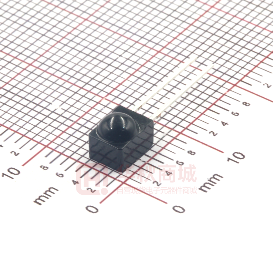

    峰值波长:940nm 响应范围:790nm~1050nm 反向电压:60V 暗电流:2nA 接收角:±60° 工作温度:-40℃~+100℃ Photodiode 940nm 120° Radial,...
BPV22NF 数据手册
BPV22NF, BPV22NFL www.vishay.com Vishay Semiconductors Silicon PIN Photodiode FEATURES • Package type: leaded • Package form: side view • Dimensions (in mm): 4.5 x 5 x 6 • Radiant sensitive area (in mm2): 7.5 • High radiant sensitivity • Daylight blocking filter matched with 870 nm to 950 nm emitters • Fast response times 94 8633 • Angle of half sensitivity: ϕ = ± 60° • Compliant to RoHS Directive 2011/65/EU and in accordance to WEEE 2002/96/EC Note ** Please see document “Vishay Material Category Policy”: www.vishay.com/doc?99902 DESCRIPTION BPV22NF is a PIN photodiode with high speed and high radiant sensitivity in a black, plastic package with side view lens and daylight blocking filter. Filter bandwidth is matched with 870 nm to 950 nm IR emitters. The lens achieves 80 % of sensitivity improvement in comparison with flat package. BPV22NFL has long leads, other specifications like BPV22NF. APPLICATIONS • High speed detector for infrared radiation • Infrared remote control and free air data transmission systems, e.g. in combination with TSFFxxxx series IR emitters PRODUCT SUMMARY Ira (μA) ϕ (deg) λ0.5 (nm) BPV22NF 85 ± 60 790 to 1050 BPV22NFL 85 ± 60 790 to 1050 PACKAGE FORM COMPONENT Note • Test condition see table “Basic Characteristics” ORDERING INFORMATION PACKAGING REMARKS BPV22NF Bulk MOQ: 4000 pcs, 4000 pcs/bulk Side view BPV22NFL Bulk MOQ: 4000 pcs, 4000 pcs/bulk Side view, long leads ORDERING CODE Note • MOQ: minimum order quantity ABSOLUTE MAXIMUM RATINGS (Tamb = 25 °C, unless otherwise specified) PARAMETER TEST CONDITION Reverse voltage Power dissipation Tamb ≤ 25 °C Junction temperature Operating temperature range Thermal resistance junction/ambient Rev. 1.9, 21-Feb-12 VALUE VR 60 UNIT V PV 215 mW Tj 100 °C Tamb - 40 to + 100 °C °C Tstg - 40 to + 100 t≤5s Tsd 260 °C Connected with Cu wire, 0.14 mm2 RthJA 350 K/W Storage temperature range Soldering temperature SYMBOL Document Number: 81509 1 For technical questions, contact: detectortechsupport@vishay.com THIS DOCUMENT IS SUBJECT TO CHANGE WITHOUT NOTICE. THE PRODUCTS DESCRIBED HEREIN AND THIS DOCUMENT ARE SUBJECT TO SPECIFIC DISCLAIMERS, SET FORTH AT www.vishay.com/doc?91000 BPV22NF, BPV22NFL www.vishay.com Vishay Semiconductors BASIC CHARACTERISTICS (Tamb = 25 °C, unless otherwise specified) TEST CONDITION PARAMETER IF = 50 mA VF IR = 100 μA, E = 0 V(BR) Forward voltage Breakdown voltage MIN. TYP. MAX. UNIT 1 1.3 V 60 V VR = 10 V, E = 0 Iro 2 VR= 0 V, f = 1 MHz, E = 0 CD 70 pF VR= 12 V, f = 1 MHz RS 400 Ω Reverse dark current Diode capacitance SYMBOL Serial resistance mW/cm2, λ = 950 nm 30 nA Open circuit voltage Ee = 1 Vo 370 mV Temperature coefficient of Vo Ee = 1 mW/cm2, λ = 950 nm TKVo - 2.6 mV/K Short circuit current Ee = 1 mW/cm2, λ = 950 nm Ik 80 μA Reverse light current Ee = 1 mW/cm2, λ = 870 nm, 85 μA Temperature coefficient of Ira Ee = 1 mW/cm2, λ = 950 nm, VR = 10 V TKIra 0.1 %/K VR = 5 V, λ = 870 nm s(λ) 0.57 A/W VR = 5 V, λ = 950 nm s(λ) 0.6 A/W Angle of half sensitivity ϕ ± 60 deg Wavelength of peak sensitivity λp 940 nm λ0.5 790 to 1050 nm η 90 % VR = 5 V Absolute spectral sensitivity Range of spectral bandwidth λ = 950 nm Quantum efficiency 55 Ira Noise equivalent power VR = 10 V, λ = 950 nm NEP Detectivity VR = 10 V, λ = 950 nm D* 6 x 1012 cm√Hz/W Rise time VR = 10 V, RL = 1 kΩ, λ = 820 nm tr 100 ns Fall time VR = 10 V, RL = 1 kΩ, λ = 820 nm tf 100 ns VR = 12 V, RL = 1 kΩ, λ = 870 nm fc 4 MHz VR = 12 V, RL = 1 kΩ, λ = 950 nm fc 1 MHz Cut-off frequency 4x 10-14 W/√ Hz BASIC CHARACTERISTICS (Tamb = 25 °C, unless otherwise specified) I ra rel - Relative Reverse Light Current Iro - Reverse Dark Current (nA) 1000 100 10 VR = 10 V 1 20 94 8403 40 60 80 Tamb - Ambient Temperature (°C) VR = 5 V λ = 950 nm 1.2 1.0 0.8 0.6 0 100 Fig. 1 - Reverse Dark Current vs. Ambient Temperature Rev. 1.9, 21-Feb-12 1.4 94 8409 20 40 60 80 100 Tamb - Ambient Temperature (°C) Fig. 2 - Relative Reverse Light Current vs. Ambient Temperature Document Number: 81509 2 For technical questions, contact: detectortechsupport@vishay.com THIS DOCUMENT IS SUBJECT TO CHANGE WITHOUT NOTICE. THE PRODUCTS DESCRIBED HEREIN AND THIS DOCUMENT ARE SUBJECT TO SPECIFIC DISCLAIMERS, SET FORTH AT www.vishay.com/doc?91000 BPV22NF, BPV22NFL www.vishay.com Vishay Semiconductors 1.2 S(λ)rel - Relative Spectral Sensivity I ra - Reverse Light Current (µA) 1000 100 10 VR = 5 V λ = 950 nm 1 0.1 0.01 0.1 0.8 0.6 0.4 0.2 0.0 750 10 1 850 Fig. 3 - Reverse Light Current vs. Irradiance 950 1050 1150 λ - Wavelength (nm) 94 8426 E e - Irradiance (mW/cm2) 94 8411 1.0 Fig. 6 - Relative Spectral Sensitivity vs. Wavelength 0° 100 10 ° 20 ° 30° 0.5 mW/cm2 λ = 950 nm 2 0.2 mW/cm 10 0.1 mW/cm2 0.05 mW/cm2 40° 1.0 0.9 50° 0.8 60° 70° 0.7 80° 0.02 mW/cm2 1 0.1 1 10 100 VR - Reverse Voltage (V) 94 8412 ϕ - Angular Displacement Srel - Relative Sensitivity I ra - Reverse Light Current (µA) 1 mW/cm2 0.6 0.4 0.2 0 94 8413 Fig. 4 - Reverse Light Current vs. Reverse Voltage Fig. 7 - Relative Radiant Sensitivity vs. Angular Displacement CD - Diode Capacitance (pF) 80 E=0 f = 1 MHz 60 40 20 0 0.1 948407 1 10 100 VR - Reverse Voltage (V) Fig. 5 - Diode Capacitance vs. Reverse Voltage Rev. 1.9, 21-Feb-12 Document Number: 81509 3 For technical questions, contact: detectortechsupport@vishay.com THIS DOCUMENT IS SUBJECT TO CHANGE WITHOUT NOTICE. THE PRODUCTS DESCRIBED HEREIN AND THIS DOCUMENT ARE SUBJECT TO SPECIFIC DISCLAIMERS, SET FORTH AT www.vishay.com/doc?91000 BPV22NF, BPV22NFL www.vishay.com Vishay Semiconductors PACKAGE DIMENSIONS in millimeters: BPV22NF 5 ± 0.15 3.2 ± 0.2 (2.4) ± 0.2 ± 0.3 6 R 2.25 (sphere) 18.8 ± 0.5 8.6 ± 0.3 < 0.7 2.5 4.5 + 0.1 - 0.3 0.65 + 0.1 - 0.2 0.1 3.4 +- 0.3 Area not plane A C 0.45 + 0.2 - 0.1 0.4 + 0.15 2.54 nom. 1.1 technical drawings according to DIN specifications ± 0.2 Drawing-No.: 6.544-5199.01-4 Issue: 2; 19.06.01 95 11475 PACKAGE DIMENSIONS in millimeters: BPV22NFL 5 3.2 ± 0.2 (2.4) 4.5 ± 0.2 ± 0.3 R 2.2 here ) 10.8 6 5 (sp 32.5 ± 0.5 ± 0.3 < 0.7 2.5 ± 0.15 + 0.1 - 0.3 0.75 - 0.12 0.1 3.4 +- 0.3 Area not plane A C 0.63 ± 0.1 2.54 nom. 0.4 ± 0.1 1.1 ± 0.2 technical drawings according to DIN specifications Drawing-No.: 6.544-5236.01-4 Issue: 2; 07.07.97 96 12205 Rev. 1.9, 21-Feb-12 Document Number: 81509 4 For technical questions, contact: detectortechsupport@vishay.com THIS DOCUMENT IS SUBJECT TO CHANGE WITHOUT NOTICE. THE PRODUCTS DESCRIBED HEREIN AND THIS DOCUMENT ARE SUBJECT TO SPECIFIC DISCLAIMERS, SET FORTH AT www.vishay.com/doc?91000 Legal Disclaimer Notice www.vishay.com Vishay Disclaimer ALL PRODUCT, PRODUCT SPECIFICATIONS AND DATA ARE SUBJECT TO CHANGE WITHOUT NOTICE TO IMPROVE RELIABILITY, FUNCTION OR DESIGN OR OTHERWISE. Vishay Intertechnology, Inc., its affiliates, agents, and employees, and all persons acting on its or their behalf (collectively, “Vishay”), disclaim any and all liability for any errors, inaccuracies or incompleteness contained in any datasheet or in any other disclosure relating to any product. Vishay makes no warranty, representation or guarantee regarding the suitability of the products for any particular purpose or the continuing production of any product. To the maximum extent permitted by applicable law, Vishay disclaims (i) any and all liability arising out of the application or use of any product, (ii) any and all liability, including without limitation special, consequential or incidental damages, and (iii) any and all implied warranties, including warranties of fitness for particular purpose, non-infringement and merchantability. Statements regarding the suitability of products for certain types of applications are based on Vishay's knowledge of typical requirements that are often placed on Vishay products in generic applications. Such statements are not binding statements about the suitability of products for a particular application. It is the customer's responsibility to validate that a particular product with the properties described in the product specification is suitable for use in a particular application. Parameters provided in datasheets and / or specifications may vary in different applications and performance may vary over time. All operating parameters, including typical parameters, must be validated for each customer application by the customer's technical experts. Product specifications do not expand or otherwise modify Vishay's terms and conditions of purchase, including but not limited to the warranty expressed therein. Hyperlinks included in this datasheet may direct users to third-party websites. These links are provided as a convenience and for informational purposes only. Inclusion of these hyperlinks does not constitute an endorsement or an approval by Vishay of any of the products, services or opinions of the corporation, organization or individual associated with the third-party website. Vishay disclaims any and all liability and bears no responsibility for the accuracy, legality or content of the third-party website or for that of subsequent links. Except as expressly indicated in writing, Vishay products are not designed for use in medical, life-saving, or life-sustaining applications or for any other application in which the failure of the Vishay product could result in personal injury or death. Customers using or selling Vishay products not expressly indicated for use in such applications do so at their own risk. Please contact authorized Vishay personnel to obtain written terms and conditions regarding products designed for such applications. No license, express or implied, by estoppel or otherwise, to any intellectual property rights is granted by this document or by any conduct of Vishay. Product names and markings noted herein may be trademarks of their respective owners. © 2022 VISHAY INTERTECHNOLOGY, INC. ALL RIGHTS RESERVED Revision: 01-Jan-2022 1 Document Number: 91000
