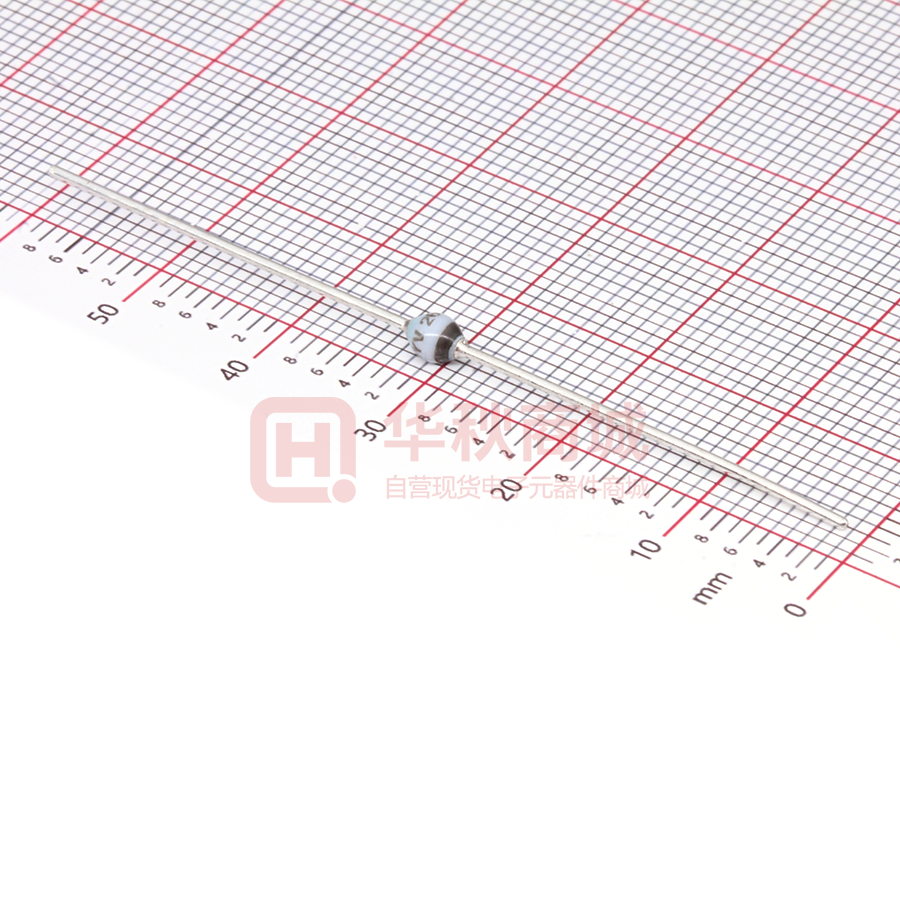

BYV26A, BYV26B, BYV26C, BYV26D, BYV26E www.vishay.com Vishay Semiconductors Ultra-Fast Avalanche Sinterglass Diode FEATURES • Glass passivated junction • Hermetically sealed package • Very low switching losses • Low reverse current • High reverse voltage • Material categorization: for definitions of compliance please see www.vishay.com/doc?99912 949539 DESIGN SUPPORT TOOLS click logo to get started APPLICATIONS • Switched mode power supplies Models Available MECHANICAL DATA Case: SOD-57 Terminals: plated axial leads, solderable per MIL-STD-750, method 2026 Polarity: color band denotes cathode end • High-frequency inverter circuits         Mounting position: any Weight: approx. 369 mg ORDERING INFORMATION (Example) DEVICE NAME ORDERING CODE TAPED UNITS MINIMUM ORDER QUANTITY BYV26E BYV26E-TR 5000 per 10" tape and reel 25 000 BYV26E BYV26E-TAP 5000 per ammopack 25 000 PARTS TABLE PART TYPE DIFFERENTIATION PACKAGE BYV26A VR = 200 V; IF(AV) = 1 A SOD-57 BYV26B VR = 400 V; IF(AV) = 1 A SOD-57 BYV26C VR = 600 V; IF(AV) = 1 A SOD-57 BYV26D VR = 800 V; IF(AV) = 1 A SOD-57 BYV26E VR = 1000 V; IF(AV) = 1 A SOD-57 ABSOLUTE MAXIMUM RATINGS (Tamb = 25 °C, unless otherwise specified) PARAMETER Reverse voltage = repetitive peak reverse voltage Peak forward surge current TEST CONDITION See electrical characteristics tp = 10 ms, half sine wave Average forward current Non repetitive reverse avalanche energy Junction and storage temperature range I(BR)R = 1 A, inductive load PART SYMBOL VALUE UNIT BYV26A VR = VRRM 200 V BYV26B VR = VRRM 400 V BYV26C VR = VRRM 600 V BYV26D VR = VRRM 800 V BYV26E VR = VRRM 1000 V IFSM 30 A IF(AV) 1 A ER 10 mJ Tj = Tstg -55 to +175 °C Rev. 1.8, 21-Feb-18 Document Number: 86040 1 For technical questions within your region: DiodesAmericas@vishay.com, DiodesAsia@vishay.com, DiodesEurope@vishay.com THIS DOCUMENT IS SUBJECT TO CHANGE WITHOUT NOTICE. THE PRODUCTS DESCRIBED HEREIN AND THIS DOCUMENT ARE SUBJECT TO SPECIFIC DISCLAIMERS, SET FORTH AT www.vishay.com/doc?91000 BYV26A, BYV26B, BYV26C, BYV26D, BYV26E www.vishay.com Vishay Semiconductors MAXIMUM THERMAL RESISTANCE (Tamb = 25 °C, unless otherwise specified) PARAMETER Junction ambient TEST CONDITION SYMBOL VALUE UNIT l = 10 mm, TL = constant RthJA 45 K/W ELECTRICAL CHARACTERISTICS (Tamb = 25 °C, unless otherwise specified) PARAMETER TEST CONDITION Forward voltage Reverse current SYMBOL MIN. TYP. MAX. UNIT IF = 1 A PART VF - - 2.5 V IF = 1 A, Tj = 175 °C VF - - 1.3 V VR = VRRM IR - - 5 μA VR = VRRM, Tj = 150 °C IR = 100 μA Reverse breakdown voltage IF = 0.5 A, IR = 1 A, iR = 0.25 A Reverse recovery time IR - - 100 μA BYV26A V(BR)R 300 - - V BYV26B V(BR)R 500 - - V BYV26C V(BR)R 700 - - V BYV26D V(BR)R 900 - - V BYV26E V(BR)R 1100 - - V BYV26A trr - - 30 ns BYV26B trr - - 30 ns BYV26C trr - - 30 ns BYV26D trr - - 75 ns BYV26E trr - - 75 ns 1000 600 VR = VRRM VR = VRRM RthJA = 45 K/W 500 RthJA = 100 K/W 200 V 400 400 V 300 600 V 200 800 V 100 IR - Reverse Current (μA) PR - Max. Reverse Power Dissipation (mW) TYPICAL CHARACTERISTICS (Tamb = 25 C, unless otherwise specified) 100 10 1 1000 V 0 959728 0.1 0 40 80 120 160 200 Tj - Junction Temperature (°C) Fig. 1 - Max. Reverse Power Dissipation vs. Junction Temperature 0 959729 40 80 120 160 200 Tj - Junction Temperature (°C) Fig. 2 - Max. Reverse Current vs. Junction Temperature Rev. 1.8, 21-Feb-18 Document Number: 86040 2 For technical questions within your region: DiodesAmericas@vishay.com, DiodesAsia@vishay.com, DiodesEurope@vishay.com THIS DOCUMENT IS SUBJECT TO CHANGE WITHOUT NOTICE. THE PRODUCTS DESCRIBED HEREIN AND THIS DOCUMENT ARE SUBJECT TO SPECIFIC DISCLAIMERS, SET FORTH AT www.vishay.com/doc?91000 BYV26A, BYV26B, BYV26C, BYV26D, BYV26E www.vishay.com Vishay Semiconductors 40 f = 1 MHz CD - DiodeCapacitance (pF) IFAV - Average Forward Current (A) 1.2 1.0 RthJA = 45 K/W 0.8 0.6 0.4 RthJA = 100 K/W 0.2 30 BYV26C 25 20 15 10 5 0 0 0 40 80 120 160 0.1 200 Tamb - Ambient Temperature (°C) 959730 16380 Fig. 3 - Max. Average Forward Current vs. Ambient Temperature 1 10 100 VR - Reverse Voltage (V) Fig. 5 - Diode Capacitance vs. Reverse Voltage 40 10 f = 1 MHz CD - Diode Capacitance (pF) Tj = 175 °C IF - Forward Current (A) 35 1 Tj = 25 °C 0.1 0.01 35 30 BYV26E 25 20 15 10 5 0.001 0 0 1 2 3 4 5 6 7 0.1 VF - Forward Voltage (V) 959731 16381 Fig. 4 - Max. Reverse Current vs. Junction Temperature 1 10 100 VR - Reverse Voltage (V) Fig. 6 - Diode Capacitance vs. Reverse Voltage 3.6 (0.142) max. 0.82 (0.032) max. PACKAGE DIMENSIONS in millimeters (inches): SOD-57 26 (1.024) min. 4 (0.157) max. 26 (1.024) min. 20543 Rev. 1.8, 21-Feb-18 Document Number: 86040 3 For technical questions within your region: DiodesAmericas@vishay.com, DiodesAsia@vishay.com, DiodesEurope@vishay.com THIS DOCUMENT IS SUBJECT TO CHANGE WITHOUT NOTICE. THE PRODUCTS DESCRIBED HEREIN AND THIS DOCUMENT ARE SUBJECT TO SPECIFIC DISCLAIMERS, SET FORTH AT www.vishay.com/doc?91000 Legal Disclaimer Notice www.vishay.com Vishay Disclaimer ALL PRODUCT, PRODUCT SPECIFICATIONS AND DATA ARE SUBJECT TO CHANGE WITHOUT NOTICE TO IMPROVE RELIABILITY, FUNCTION OR DESIGN OR OTHERWISE. Vishay Intertechnology, Inc., its affiliates, agents, and employees, and all persons acting on its or their behalf (collectively, “Vishay”), disclaim any and all liability for any errors, inaccuracies or incompleteness contained in any datasheet or in any other disclosure relating to any product. Vishay makes no warranty, representation or guarantee regarding the suitability of the products for any particular purpose or the continuing production of any product. To the maximum extent permitted by applicable law, Vishay disclaims (i) any and all liability arising out of the application or use of any product, (ii) any and all liability, including without limitation special, consequential or incidental damages, and (iii) any and all implied warranties, including warranties of fitness for particular purpose, non-infringement and merchantability. Statements regarding the suitability of products for certain types of applications are based on Vishay's knowledge of typical requirements that are often placed on Vishay products in generic applications. Such statements are not binding statements about the suitability of products for a particular application. It is the customer's responsibility to validate that a particular product with the properties described in the product specification is suitable for use in a particular application. Parameters provided in datasheets and / or specifications may vary in different applications and performance may vary over time. All operating parameters, including typical parameters, must be validated for each customer application by the customer's technical experts. Product specifications do not expand or otherwise modify Vishay's terms and conditions of purchase, including but not limited to the warranty expressed therein. Hyperlinks included in this datasheet may direct users to third-party websites. These links are provided as a convenience and for informational purposes only. Inclusion of these hyperlinks does not constitute an endorsement or an approval by Vishay of any of the products, services or opinions of the corporation, organization or individual associated with the third-party website. Vishay disclaims any and all liability and bears no responsibility for the accuracy, legality or content of the third-party website or for that of subsequent links. Except as expressly indicated in writing, Vishay products are not designed for use in medical, life-saving, or life-sustaining applications or for any other application in which the failure of the Vishay product could result in personal injury or death. Customers using or selling Vishay products not expressly indicated for use in such applications do so at their own risk. Please contact authorized Vishay personnel to obtain written terms and conditions regarding products designed for such applications. No license, express or implied, by estoppel or otherwise, to any intellectual property rights is granted by this document or by any conduct of Vishay. Product names and markings noted herein may be trademarks of their respective owners. © 2024 VISHAY INTERTECHNOLOGY, INC. ALL RIGHTS RESERVED Document Number: 91000 1 For technical questions, contact: THIS DOCUMENT IS SUBJECT TO CHANGE WITHOUT NOTICE. THE PRODUCTS DESCRIBED HEREIN AND THIS DOCUMENT ARE SUBJECT TO SPECIFIC DISCLAIMERS, SET FORTH AT www.vishay.com/doc?91000 Revision: 01-Jan-2024
