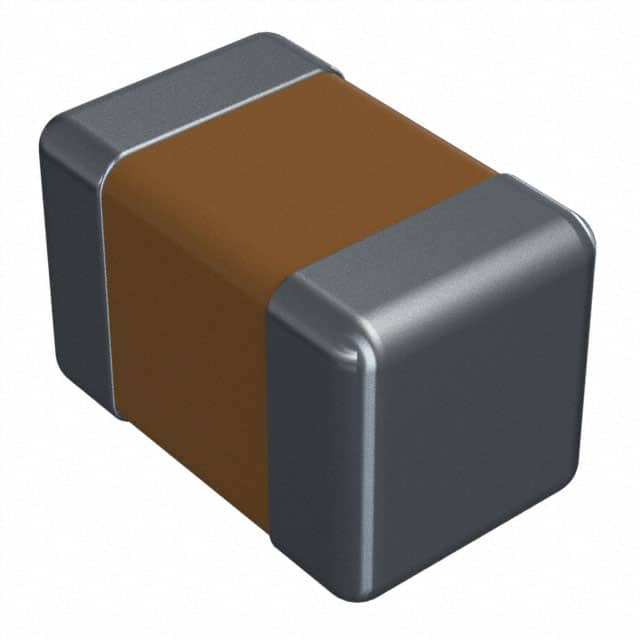

    贴片电容(MLCC) 0805 100pF ±1% 100V BP
CDR31BP101BFWSAT 数据手册
CDR-MIL-PRF-55681 www.vishay.com Vishay Vitramon Surface Mount Multilayer Ceramic Chip Capacitors MIL Qualified, Type CDR FEATURES • Military qualified products • Federal stock control number, CAGE CODE 2770A Available Available • High reliability tested per MIL-PRF-55681 • Tin / lead termination codes “W”, “Z”, and “U” • Lead (Pb)-free termination codes “Y” and “M” • Wet build process • Reliable Noble Metal Electrode (NME) system • Material categorization: for definitions of compliance please see www.vishay.com/doc?99912 Note * This datasheet provides information about parts that are RoHS-compliant and / or parts that are non RoHS-compliant. For example, parts with lead (Pb) terminations are not RoHS-compliant. Please see the information / tables in this datasheet for details APPLICATIONS • Avionic systems • Sonar systems • Satellite systems • Missiles applications • Geographical information systems • Global positioning systems ELECTRICAL SPECIFICATIONS Note • Electrical characteristics at +25 °C unless otherwise specified Operating Temperature: -55 °C to +125 °C Capacitance Range: 1.0 pF to 470 nF Voltage Range: 6.3 VDC to 100 VDC Temperature Coefficient of Capacitance (TCC): BP: 0 ppm/°C ± 30 ppm/°C from -55 °C to +125 °C, with 0 VDC applied 0 ppm/°C ± 30 ppm/°C from -55 °C to +125 °C, with 100 % rated VDC applied BX: ± 15 % from -55 °C to +125 °C, with 0 VDC applied BX: +15 %, -25 % from -55 °C to +125 °C, with 100 % rated VDC applied BR: ± 15 % from -55 °C to +125 °C, with 0 VDC applied +15 %, -40 % -55 °C to +125 °C, with 100 % rated VDC applied Dissipation Factor (DF): BP: 0.15 % maximum BX: 2.50 % maximum BR: ≤ 25 V: 3.5 % maximum > 25 V: 2.5 % maximum Test frequency: 1 MHz ± 50 kHz for BP capacitors ≤ 1000 pF and for BX capacitors ≤ 100 pF All other BP, BX, and BR at 1 kHz ± 50 Hz Aging Rate: BP: 0 % maximum per decade BX, BR: 1 % maximum per decade Insulation Resistance (IR): at +25 °C and rated voltage 100 000 MΩ minimum or 1000 ΩF, whichever is less Dielectric Strength Test: performed per method 103 of EIA-198-2-E. Applied test voltages: ≤ 100 VDC-rated: 250 % of rated voltage Revision: 10-Aug-2020 Document Number: 45026 1 For technical questions, contact: mlcc@vishay.com THIS DOCUMENT IS SUBJECT TO CHANGE WITHOUT NOTICE. THE PRODUCTS DESCRIBED HEREIN AND THIS DOCUMENT ARE SUBJECT TO SPECIFIC DISCLAIMERS, SET FORTH AT www.vishay.com/doc?91000 CDR-MIL-PRF-55681 www.vishay.com Vishay Vitramon QUICK REFERENCE DATA CAPACITANCE DIELECTRIC STYLE (CASE) MAXIMUM VOLTAGE (V) MINIMUM MAXIMUM BP CDR01 (0805) 100 10 pF 180 pF BX CDR01 (0805) 100 120 pF 4.7 nF BP CDR02 (1805) 100 220 pF 270 pF BX CDR02 (1805) 100 3.9 nF 22 nF BP CDR03 (1808) 100 330 pF 1.0 nF BX CDR03 (1808) 100 12 nF 68 nF BP CDR04 (1812) 100 1.2 nF 3.3 nF BX CDR04 (1812) 100 39 nF 180 nF BX CDR06 (2225) 50 390 nF 470 nF BP CDR31 (0805) 100 1.0 pF 680 pF BX CDR31 (0805) 100 470 pF 18 nF BP CDR32 (1206) 100 1.0 pF 2.2 nF BX CDR32 (1206) 100 4.7 nF 39 nF BP CDR33 (1210) 100 1.0 nF 3.3 nF 100 nF BX CDR33 (1210) 100 15 nF BP CDR34 (1812) 100 2.2 nF 10 nF BX CDR34 (1812) 100 27 nF 180 nF BP CDR35 (1825) 100 4.7 nF 22 nF BX CDR35 (1825) 100 56 nF 470 nF BP CDR36 (0603) 100 51 pF 1000 pF 56 nF BX CDR36 (0603) 100 100 pF BR CDR36 (0603) 100 100 pF 56 nF BP CDR37 (0402) 100 22 pF 150 pF BX CDR37 (0402) 50 100 pF 8.2 nF BR CDR37 (0402) 50 100 pF 10 nF Note • Detail ratings see selection chart ORDERING INFORMATION - MILITARY CDR31 BX 102 MILITARY DIELECTRIC CAPACITANCE STYLE NOMINAL CODE CDR01 CDR02 CDR03 CDR04 CDR06 CDR31 CDR32 CDR33 CDR34 CDR35 CDR36 CDR37 BP BR BX Expressed in picofarads (pF). The first two digits are significant, the third is a multiplier. Examples: 102 = 1000 pF 1R8 = 1.8 pF A K DC CAPACITANCE VOLTAGE TOLERANCE (2) RATING (1) W = 6.3 V X = 10 V Y = 16 V Z = 25 V A = 50 V B = 100 V C = ± 0.25 pF D = ± 0.5 pF F=±1% G=±2% J=±5% K = ± 10 % M = ± 20 % Y S A T TERMINATION FAILURE RATE MARKING PACKAGING M = silver palladium (3) Y = Ni barrier with 100 % tin W, Z = Ni barrier with tin / lead plate min. 4 % lead U = Ni barrier solder coated (min. of 4 % lead) M = 1.0 % P = 0.1 % R = 0.01 % S = 0.001 % Consult factory for failure rate status A= unmarked T = 7" reel / plastic tape J = 7" reel (low quantity) C = 7" reel / paper tape R = 11 1/4" / 13" reel / plastic tape P = 11 1/4" / 13" reel / paper tape B = bulk Notes (1) DC voltage rating should not be exceeded in application. Other application factors may affect the MLCC performance. Consult for questions: mlcc@vishay.com (2) Available tolerances please see rating chart (3) M termination not available for CDR36 and CDR37 parts Revision: 10-Aug-2020 Document Number: 45026 2 For technical questions, contact: mlcc@vishay.com THIS DOCUMENT IS SUBJECT TO CHANGE WITHOUT NOTICE. THE PRODUCTS DESCRIBED HEREIN AND THIS DOCUMENT ARE SUBJECT TO SPECIFIC DISCLAIMERS, SET FORTH AT www.vishay.com/doc?91000 CDR-MIL-PRF-55681 www.vishay.com Vishay Vitramon DIMENSIONS in inches (millimeters) W L T MAX. P MIL-PRF-55681 /1 /3 /7 /8 /9 /10 /11 /12 /13 STYLE LENGTH (L) WIDTH (W) MAXIMUM THICKNESS (T) CDR01 CDR02 CDR03 CDR04 CDR06 CDR31 CDR32 CDR33 CDR34 CDR35 CDR36 CDR37 0.080 ± 0.015 (2.03 ± 0.38) 0.180 ± 0.015 (4.57 ± 0.38) 0.180 ± 0.015 (4.57 ± 0.38) 0.180 ± 0.015 (4.57 ± 0.38) 0.225 ± 0.020 (5.72 ± 0.51) 0.078 ± 0.008 (2.00 ± 0.20) 0.125 ± 0.008 (3.20 ± 0.20) 0.125 ± 0.010 (3.20 ± 0.25) 0.176 ± 0.010 (4.50 ± 0.25) 0.176 ± 0.012 (4.50 ± 0.30) 0.063 ± 0.006 (1.60 ± 0.15) 0.040 ± 0.004 (1.02 ± 0.10) 0.050 ± 0.015 (1.27 ± 0.38) 0.050 ± 0.015 (1.27 ± 0.38) 0.080 ± 0.015 (2.03 ± 0.38) 0.125 ± 0.015 (3.20 ± 0.38) 0.250 ± 0.020 (6.35 ± 0.51) 0.049 ± 0.008 (1.25 ± 0.20) 0.062 ± 0.008 (1.60 ± 0.20) 0.098 ± 0.010 (2.50 ± 0.25) 0.125 ± 0.010 (3.20 ± 0.25) 0.250 ± 0.012 (6.40 ± 0.30) 0.032 ± 0.006 (0.81 ± 0.15) 0.020 ± 0.004 (0.51 ± 0.10) 0.055 (1.40) 0.055 (1.40) 0.080 (2.03) 0.080 (2.03) 0.080 (2.03) 0.051 (1.30) 0.051 (1.30) 0.049 (1.25) 0.059 (1.50) 0.059 (1.50) 0.036 (0.91) 0.024 (0.61) TERM. (P) MINIMUM MAXIMUM 0.010 (0.25) 0.030 (0.75) 0.010 (0.25) 0.030 (0.75) 0.010 (0.25) 0.030 (0.75) 0.010 (0.25) 0.030 (0.75) 0.010 (0.25) 0.030 (0.75) 0.012 (0.30) 0.028 (0.70) 0.012 (0.30) 0.028 (0.70) 0.010 (0.25) 0.030 (0.75) 0.010 (0.25) 0.030 (0.75) 0.008 (0.20) 0.032 (0.80) 0.008 (0.20) 0.020 (0.51) 0.004 (0.10) 0.016 (0.41) SELECTION CHART DIELECTRIC STYLE SLASH SHEET CASE CODE VOLTAGE (VDC) VOLTAGE CODE CAP. CODE 220 240 270 300 330 360 390 430 470 510 560 620 680 750 820 910 101 121 151 CAPACITANCE 22 24 27 30 33 36 39 43 47 51 56 62 68 75 82 91 100 120 150 10 X 16 Y BP CDR37 /13 0402 25 Z • (F, G, J) • (F, G, J) • (F, G, J) • (F, G, J) • (F, G, J) • (F, G, J) • (F, G, J) • (F, G, J) • (F, G, J) • (F, G, J) • (F, G, J) • (F, G, J) • (F, G, J) • (F, G, J) • (F, G, J) • (F, G, J) • (F, G, J) • (F, G, J) • (F, G, J) • (F, G, J) • (F, G, J) • (F, G, J) • (F, G, J) • (F, G, J) • (F, G, J) • (F, G, J) • (F, G, J) • (F, G, J) • (F, G, J) • (F, G, J) • (F, G, J) • (F, G, J) • (F, G, J) • (F, G, J) • (F, G, J) • (F, G, J) • (F, G, J) • (F, G, J) • (F, G, J) • (F, G, J) • (F, G, J) • (F, G, J) • (F, G, J) • (F, G, J) • (F, G, J) • (F, G, J) • (F, G, J) • (F, G, J) • (F, G, J) • (F, G, J) • (F, G, J) • (F, G, J) • (F, G, J) • (F, G, J) • (F, G, J) • (F, G, J) • (F, G, J) 50 A 100 B • (F, G, J) • (F, G, J) • (F, G, J) • (F, G, J) • (F, G, J) • (F, G, J) • (F, G, J) • (F, G, J) • (F, G, J) • (F, G, J) • (F, G, J) • (F, G, J) • (F, G, J) • (F, G, J) • (F, G, J) • (F, G, J) • (F, G, J) • (F, G, J) • (F, G, J) • (F, G, J) • (F, G, J) • (F, G, J) • (F, G, J) • (F, G, J) • (F, G, J) • (F, G, J) • (F, G, J) • (F, G, J) • (F, G, J) • (F, G, J) • (F, G, J) • (F, G, J) • (F, G, J) • (F, G, J) • (F, G, J) • (F, G, J) • (F, G, J) • (F, G, J) Notes RoHS-compliant except when supplied with lead (Pb)-containing terminations, codes “W”, “Z”, and “U” Not RoHS-compliant Revision: 10-Aug-2020 Document Number: 45026 3 For technical questions, contact: mlcc@vishay.com THIS DOCUMENT IS SUBJECT TO CHANGE WITHOUT NOTICE. THE PRODUCTS DESCRIBED HEREIN AND THIS DOCUMENT ARE SUBJECT TO SPECIFIC DISCLAIMERS, SET FORTH AT www.vishay.com/doc?91000 CDR-MIL-PRF-55681 www.vishay.com Vishay Vitramon SELECTION CHART DIELECTRIC STYLE SLASH SHEET CASE CODE BR BX CDR37 CDR37 /13 /13 0402 0402 VOLTAGE (VDC) 6.3 10 16 25 50 6.3 10 16 25 50 VOLTAGE CODE W X Y Z A W X Y Z A CAP. CODE CAP. 101 100 • (J, K, M) • (J, K, M) • (J, K, M) • (J, K, M) • (J, K, M) • (J, K, M) • (J, K, M) • (J, K, M) • (J, K, M) • (J, K, M) 121 120 • (J, K, M) • (J, K, M) • (J, K, M) • (J, K, M) • (J, K, M) • (J, K, M) • (J, K, M) • (J, K, M) • (J, K, M) • (J, K, M) 151 150 • (J, K, M) • (J, K, M) • (J, K, M) • (J, K, M) • (J, K, M) • (J, K, M) • (J, K, M) • (J, K, M) • (J, K, M) • (J, K, M) 181 180 • (J, K, M) • (J, K, M) • (J, K, M) • (J, K, M) • (J, K, M) • (J, K, M) • (J, K, M) • (J, K, M) • (J, K, M) • (J, K, M) 221 220 • (J, K, M) • (J, K, M) • (J, K, M) • (J, K, M) • (J, K, M) • (J, K, M) • (J, K, M) • (J, K, M) • (J, K, M) • (J, K, M) 271 270 • (J, K, M) • (J, K, M) • (J, K, M) • (J, K, M) • (J, K, M) • (J, K, M) • (J, K, M) • (J, K, M) • (J, K, M) • (J, K, M) 331 330 • (J, K, M) • (J, K, M) • (J, K, M) • (J, K, M) • (J, K, M) • (J, K, M) • (J, K, M) • (J, K, M) • (J, K, M) • (J, K, M) 391 390 • (J, K, M) • (J, K, M) • (J, K, M) • (J, K, M) • (J, K, M) • (J, K, M) • (J, K, M) • (J, K, M) • (J, K, M) • (J, K, M) 471 470 • (J, K, M) • (J, K, M) • (J, K, M) • (J, K, M) • (J, K, M) • (J, K, M) • (J, K, M) • (J, K, M) • (J, K, M) • (J, K, M) 561 560 • (J, K, M) • (J, K, M) • (J, K, M) • (J, K, M) • (J, K, M) • (J, K, M) • (J, K, M) • (J, K, M) • (J, K, M) • (J, K, M) 681 680 • (J, K, M) • (J, K, M) • (J, K, M) • (J, K, M) • (J, K, M) • (J, K, M) • (J, K, M) • (J, K, M) • (J, K, M) • (J, K, M) 821 820 • (J, K, M) • (J, K, M) • (J, K, M) • (J, K, M) • (J, K, M) • (J, K, M) • (J, K, M) • (J, K, M) • (J, K, M) • (J, K, M) 102 1000 • (J, K, M) • (J, K, M) • (J, K, M) • (J, K, M) • (J, K, M) • (J, K, M) • (J, K, M) • (J, K, M) • (J, K, M) • (J, K, M) 122 1200 • (J, K, M) • (J, K, M) • (J, K, M) • (J, K, M) • (J, K, M) • (J, K, M) • (J, K, M) • (J, K, M) • (J, K, M) • (J, K, M) 152 1500 • (J, K, M) • (J, K, M) • (J, K, M) • (J, K, M) • (J, K, M) • (J, K, M) • (J, K, M) • (J, K, M) • (J, K, M) • (J, K, M) 182 1800 • (J, K, M) • (J, K, M) • (J, K, M) • (J, K, M) • (J, K, M) • (J, K, M) • (J, K, M) • (J, K, M) • (J, K, M) 222 2200 • (J, K, M) • (J, K, M) • (J, K, M) • (J, K, M) • (J, K, M) • (J, K, M) • (J, K, M) • (J, K, M) • (J, K, M) 272 2700 • (J, K, M) • (J, K, M) • (J, K, M) • (J, K, M) • (J, K, M) • (J, K, M) • (J, K, M) • (J, K, M) • (J, K, M) 332 3300 • (J, K, M) • (J, K, M) • (J, K, M) • (J, K, M) • (J, K, M) • (J, K, M) • (J, K, M) • (J, K, M) • (J, K, M) 392 3900 • (J, K, M) • (J, K, M) • (J, K, M) • (J, K, M) • (J, K, M) • (J, K, M) • (J, K, M) • (J, K, M) • (J, K, M) 472 4700 • (J, K, M) • (J, K, M) • (J, K, M) • (J, K, M) • (J, K, M) • (J, K, M) 562 5600 • (J, K, M) • (J, K, M) • (J, K, M) • (J, K, M) • (J, K, M) • (J, K, M) 682 6800 • (J, K, M) • (J, K, M) • (J, K, M) • (J, K, M) • (J, K, M) • (J, K, M) 822 8200 • (J, K, M) • (J, K, M) • (J, K, M) • (J, K, M) • (J, K, M) • (J, K, M) 103 10 000 • (J, K, M) • (J, K, M) • (J, K, M) Notes RoHS-compliant except when supplied with lead (Pb)-containing terminations, codes “W”, “Z”, and “U” Not RoHS-compliant Revision: 10-Aug-2020 Document Number: 45026 4 For technical questions, contact: mlcc@vishay.com THIS DOCUMENT IS SUBJECT TO CHANGE WITHOUT NOTICE. THE PRODUCTS DESCRIBED HEREIN AND THIS DOCUMENT ARE SUBJECT TO SPECIFIC DISCLAIMERS, SET FORTH AT www.vishay.com/doc?91000 CDR-MIL-PRF-55681 www.vishay.com Vishay Vitramon SELECTION CHART DIELECTRIC BP STYLE CDR36 SLASH SHEET /12 CASE CODE 0603 VOLTAGE (VDC) 10 16 25 50 100 VOLTAGE CODE X Y Z A B CAP. CODE CAPACITANCE 510 51 • (F, G, J) • (F, G, J) • (F, G, J) • (F, G, J) • (F, G, J) 560 56 • (F, G, J) • (F, G, J) • (F, G, J) • (F, G, J) • (F, G, J) 620 62 • (F, G, J) • (F, G, J) • (F, G, J) • (F, G, J) • (F, G, J) 680 68 • (F, G, J) • (F, G, J) • (F, G, J) • (F, G, J) • (F, G, J) 750 75 • (F, G, J) • (F, G, J) • (F, G, J) • (F, G, J) • (F, G, J) 820 82 • (F, G, J) • (F, G, J) • (F, G, J) • (F, G, J) • (F, G, J) 910 91 • (F, G, J) • (F, G, J) • (F, G, J) • (F, G, J) • (F, G, J) 101 100 • (F, G, J) • (F, G, J) • (F, G, J) • (F, G, J) • (F, G, J) 121 120 • (F, G, J) • (F, G, J) • (F, G, J) • (F, G, J) • (F, G, J) 151 150 • (F, G, J) • (F, G, J) • (F, G, J) • (F, G, J) • (F, G, J) 181 180 • (F, G, J) • (F, G, J) • (F, G, J) • (F, G, J) • (F, G, J) 221 220 • (F, G, J) • (F, G, J) • (F, G, J) • (F, G, J) • (F, G, J) 271 270 • (F, G, J) • (F, G, J) • (F, G, J) • (F, G, J) • (F, G, J) 331 330 • (F, G, J) • (F, G, J) • (F, G, J) • (F, G, J) • (F, G, J) 391 390 • (F, G, J) • (F, G, J) • (F, G, J) • (F, G, J) 471 470 • (F, G, J) • (F, G, J) • (F, G, J) • (F, G, J) 561 560 • (F, G, J) • (F, G, J) • (F, G, J) • (F, G, J) 681 680 • (F, G, J) • (F, G, J) • (F, G, J) • (F, G, J) 821 820 • (F, G, J) • (F, G, J) • (F, G, J) 102 1000 • (F, G, J) • (F, G, J) • (F, G, J) Notes RoHS-compliant except when supplied with lead (Pb)-containing terminations, codes “W”, “Z”, and “U” Not RoHS-compliant Revision: 10-Aug-2020 Document Number: 45026 5 For technical questions, contact: mlcc@vishay.com THIS DOCUMENT IS SUBJECT TO CHANGE WITHOUT NOTICE. THE PRODUCTS DESCRIBED HEREIN AND THIS DOCUMENT ARE SUBJECT TO SPECIFIC DISCLAIMERS, SET FORTH AT www.vishay.com/doc?91000 CDR-MIL-PRF-55681 www.vishay.com Vishay Vitramon SELECTION CHART DIELECTRIC STYLE SLASH SHEET CASE CODE BR BX CDR36 CDR36 /12 /12 0603 0603 VOLTAGE (VDC) 6.3 10 16 25 50 100 6.3 10 16 25 50 100 VOLTAGE CODE W X Y Z A B W X Y Z A B CAP. CODE CAP. 101 100 • (J, K, M)• (J, K, M)• (J, K, M)• (J, K, M)• (J, K, M)• (J, K, M)• (J, K, M)• (J, K, M)• (J, K, M)• (J, K, M)• (J, K, M)• (J, K, M) 121 120 • (J, K, M)• (J, K, M)• (J, K, M)• (J, K, M)• (J, K, M)• (J, K, M)• (J, K, M)• (J, K, M)• (J, K, M)• (J, K, M)• (J, K, M)• (J, K, M) 151 150 • (J, K, M)• (J, K, M)• (J, K, M)• (J, K, M)• (J, K, M)• (J, K, M)• (J, K, M)• (J, K, M)• (J, K, M)• (J, K, M)• (J, K, M)• (J, K, M) 181 180 • (J, K, M)• (J, K, M)• (J, K, M)• (J, K, M)• (J, K, M)• (J, K, M)• (J, K, M)• (J, K, M)• (J, K, M)• (J, K, M)• (J, K, M)• (J, K, M) 221 220 • (J, K, M)• (J, K, M)• (J, K, M)• (J, K, M)• (J, K, M)• (J, K, M)• (J, K, M)• (J, K, M)• (J, K, M)• (J, K, M)• (J, K, M)• (J, K, M) 271 270 • (J, K, M)• (J, K, M)• (J, K, M)• (J, K, M)• (J, K, M)• (J, K, M)• (J, K, M)• (J, K, M)• (J, K, M)• (J, K, M)• (J, K, M)• (J, K, M) 331 330 • (J, K, M)• (J, K, M)• (J, K, M)• (J, K, M)• (J, K, M)• (J, K, M)• (J, K, M)• (J, K, M)• (J, K, M)• (J, K, M)• (J, K, M)• (J, K, M) 391 390 • (J, K, M)• (J, K, M)• (J, K, M)• (J, K, M)• (J, K, M)• (J, K, M)• (J, K, M)• (J, K, M)• (J, K, M)• (J, K, M)• (J, K, M)• (J, K, M) 471 470 • (J, K, M)• (J, K, M)• (J, K, M)• (J, K, M)• (J, K, M)• (J, K, M)• (J, K, M)• (J, K, M)• (J, K, M)• (J, K, M)• (J, K, M)• (J, K, M) 561 560 • (J, K, M)• (J, K, M)• (J, K, M)• (J, K, M)• (J, K, M)• (J, K, M)• (J, K, M)• (J, K, M)• (J, K, M)• (J, K, M)• (J, K, M)• (J, K, M) 681 680 • (J, K, M)• (J, K, M)• (J, K, M)• (J, K, M)• (J, K, M)• (J, K, M)• (J, K, M)• (J, K, M)• (J, K, M)• (J, K, M)• (J, K, M)• (J, K, M) 821 820 • (J, K, M)• (J, K, M)• (J, K, M)• (J, K, M)• (J, K, M)• (J, K, M)• (J, K, M)• (J, K, M)• (J, K, M)• (J, K, M)• (J, K, M)• (J, K, M) 102 1000 • (J, K, M)• (J, K, M)• (J, K, M)• (J, K, M)• (J, K, M)• (J, K, M)• (J, K, M)• (J, K, M)• (J, K, M)• (J, K, M)• (J, K, M)• (J, K, M) 122 1200 • (J, K, M)• (J, K, M)• (J, K, M)• (J, K, M)• (J, K, M)• (J, K, M)• (J, K, M)• (J, K, M)• (J, K, M)• (J, K, M)• (J, K, M)• (J, K, M) 152 1500 • (J, K, M)• (J, K, M)• (J, K, M)• (J, K, M)• (J, K, M)• (J, K, M)• (J, K, M)• (J, K, M)• (J, K, M)• (J, K, M)• (J, K, M)• (J, K, M) 182 1800 • (J, K, M)• (J, K, M)• (J, K, M)• (J, K, M)• (J, K, M)• (J, K, M)• (J, K, M)• (J, K, M)• (J, K, M)• (J, K, M)• (J, K, M)• (J, K, M) 222 2200 • (J, K, M)• (J, K, M)• (J, K, M)• (J, K, M)• (J, K, M)• (J, K, M)• (J, K, M)• (J, K, M)• (J, K, M)• (J, K, M)• (J, K, M)• (J, K, M) 272 2700 • (J, K, M)• (J, K, M)• (J, K, M)• (J, K, M)• (J, K, M)• (J, K, M)• (J, K, M)• (J, K, M)• (J, K, M)• (J, K, M)• (J, K, M)• (J, K, M) 332 3300 • (J, K, M)• (J, K, M)• (J, K, M)• (J, K, M)• (J, K, M)• (J, K, M)• (J, K, M)• (J, K, M)• (J, K, M)• (J, K, M)• (J, K, M) 392 3900 • (J, K, M)• (J, K, M)• (J, K, M)• (J, K, M)• (J, K, M)• (J, K, M)• (J, K, M)• (J, K, M)• (J, K, M)• (J, K, M)• (J, K, M) 472 4700 • (J, K, M)• (J, K, M)• (J, K, M)• (J, K, M)• (J, K, M)• (J, K, M)• (J, K, M)• (J, K, M)• (J, K, M)• (J, K, M)• (J, K, M) 562 5600 • (J, K, M)• (J, K, M)• (J, K, M)• (J, K, M)• (J, K, M)• (J, K, M)• (J, K, M)• (J, K, M)• (J, K, M)• (J, K, M)• (J, K, M) 682 6800 • (J, K, M)• (J, K, M)• (J, K, M)• (J, K, M)• (J, K, M)• (J, K, M)• (J, K, M)• (J, K, M)• (J, K, M)• (J, K, M)• (J, K, M) 822 8200 • (J, K, M)• (J, K, M)• (J, K, M)• (J, K, M)• (J, K, M)• (J, K, M)• (J, K, M)• (J, K, M)• (J, K, M)• (J, K, M)• (J, K, M) 103 10 000 • (J, K, M)• (J, K, M)• (J, K, M)• (J, K, M)• (J, K, M) • (J, K, M)• (J, K, M)• (J, K, M)• (J, K, M)• (J, K, M) 123 12 000 • (J, K, M)• (J, K, M)• (J, K, M)• (J, K, M)• (J, K, M) • (J, K, M)• (J, K, M)• (J, K, M)• (J, K, M) 153 15 000 • (J, K, M)• (J, K, M)• (J, K, M)• (J, K, M)• (J, K, M) • (J, K, M)• (J, K, M)• (J, K, M)• (J, K, M) 183 18 000 • (J, K, M)• (J, K, M)• (J, K, M)• (J, K, M)• (J, K, M) • (J, K, M)• (J, K, M)• (J, K, M)• (J, K, M) 223 22 000 • (J, K, M)• (J, K, M)• (J, K, M)• (J, K, M)• (J, K, M) • (J, K, M)• (J, K, M)• (J, K, M)• (J, K, M) 273 27 000 • (J, K, M)• (J, K, M)• (J, K, M)• (J, K, M)• (J, K, M) • (J, K, M)• (J, K, M)• (J, K, M)• (J, K, M) 333 33 000 • (J, K, M)• (J, K, M)• (J, K, M)• (J, K, M) • (J, K, M)• (J, K, M)• (J, K, M) 393 39 000 • (J, K, M)• (J, K, M)• (J, K, M)• (J, K, M) • (J, K, M)• (J, K, M)• (J, K, M) 473 47 000 • (J, K, M)• (J, K, M)• (J, K, M)• (J, K, M) • (J, K, M)• (J, K, M)• (J, K, M) 563 56 000 • (J, K, M)• (J, K, M)• (J, K, M)• (J, K, M) • (J, K, M)• (J, K, M)• (J, K, M) 683 68 000 • (J, K, M)• (J, K, M) 823 82 000 • (J, K, M)• (J, K, M) 104 100 000 • (J, K, M)• (J, K, M) Notes RoHS-compliant except when supplied with lead (Pb)-containing terminations, codes “W”, “Z”, and “U” Not RoHS-compliant Revision: 10-Aug-2020 Document Number: 45026 6 For technical questions, contact: mlcc@vishay.com THIS DOCUMENT IS SUBJECT TO CHANGE WITHOUT NOTICE. THE PRODUCTS DESCRIBED HEREIN AND THIS DOCUMENT ARE SUBJECT TO SPECIFIC DISCLAIMERS, SET FORTH AT www.vishay.com/doc?91000 CDR-MIL-PRF-55681 www.vishay.com Vishay Vitramon SELECTION CHART DIELECTRIC BP STYLE CDR31 CDR01 SLASH SHEET /7 /1 CASE CODE 0805 0805 VOLTAGE (VDC) 50 100 VOLTAGE CODE A B CAP. CODE CAPACITANCE 1R0 1 1R1 1.1 1R2 1.2 1R3 1.3 1R5 1.5 1R6 1.6 1R8 1.8 2R0 2 2R2 2.2 2R4 2.4 2R7 2.7 3R0 3 3R3 3.3 3R6 3.6 3R9 3.9 4R3 4.3 4R7 4.7 5R1 5.1 5R6 5.6 6R2 6.2 6R8 6.8 7R5 7.5 8R2 8.2 9R1 9.1 • (J, K) 100 10 110 11 • (J) 120 12 130 13 150 15 • (J, K) 160 16 • (J) 180 18 200 20 220 22 • (J, K) 240 24 270 27 • (J) 300 30 • (J, K) 330 33 360 36 • (J) 390 39 430 43 470 47 • (J, K) 510 51 560 56 • (J) 620 62 • (J, K) 680 68 750 75 820 82 • (J) 910 91 Notes RoHS-compliant except when supplied with lead (Pb)-containing terminations, codes “W”, “Z”, and “U” Not RoHS-compliant Revision: 10-Aug-2020 CDR31 /7 0805 100 B • (C) • (C) • (C) • (C) • (C) • (C) • (C) • (C) • (C) • (C) • (C, D) • (C, D) • (C, D) • (C, D) • (C, D) • (C, D) • (C, D) • (C, D) • (C, D) • (C, D) • (C, D) • (C, D) • (C, D) • (C, D) • (F, J, K) • (F, J, K) • (F, J, K) • (F, J, K) • (F, J, K) • (F, J, K) • (F, J, K) • (F, J, K) • (F, J, K) • (F, J, K) • (F, J, K) • (F, J, K) • (F, J, K) • (F, J, K) • (F, J, K) • (F, J, K) • (F, J, K) • (F, J, K) • (F, J, K) • (F, J, K) • (F, J, K) • (F, J, K) • (F, J, K) • (F, J, K) Document Number: 45026 7 For technical questions, contact: mlcc@vishay.com THIS DOCUMENT IS SUBJECT TO CHANGE WITHOUT NOTICE. THE PRODUCTS DESCRIBED HEREIN AND THIS DOCUMENT ARE SUBJECT TO SPECIFIC DISCLAIMERS, SET FORTH AT www.vishay.com/doc?91000 CDR-MIL-PRF-55681 www.vishay.com Vishay Vitramon SELECTION CHART DIELECTRIC BP STYLE CDR31 CDR01 SLASH SHEET /7 /1 CASE CODE 0805 0805 VOLTAGE (VDC) 50 100 VOLTAGE CODE A B CAP. CODE CAPACITANCE 101 100 • (J, K) 111 110 121 120 • (J, K) 131 130 151 150 • (J, K) 161 160 • (J, K) 181 180 201 200 221 220 241 240 271 270 301 300 331 330 361 360 391 390 431 430 471 470 511 510 • (F, J, K) • (F, J, K) 561 560 621 620 • (F, J, K) 681 680 • (F, J, K) Notes RoHS-compliant except when supplied with lead (Pb)-containing terminations, codes “W”, “Z”, and “U” Not RoHS-compliant CDR31 /7 0805 100 B • (F, J, K) • (F, J, K) • (F, J, K) • (F, J, K) • (F, J, K) • (F, J, K) • (F, J, K) • (F, J, K) • (F, J, K) • (F, J, K) • (F, J, K) • (F, J, K) • (F, J, K) • (F, J, K) • (F, J, K) • (F, J, K) • (F, J, K) SELECTION CHART DIELECTRIC BX STYLE CDR01 CDR31 CDR01 SLASH SHEET /1 /7 /1 CASE CODE 0805 0805 0805 VOLTAGE (VDC) 50 50 100 VOLTAGE CODE A A B CAP. CODE CAPACITANCE 121 120 • (J, K) • (J, K) 151 150 181 180 • (J, K) 221 220 • (K, M) • (K) 271 270 331 330 • (K, M) 391 390 • (K) • (K, M) 471 470 561 560 • (K) 681 680 • (K, M) • (K) 821 820 102 1000 • (K, M) 122 1200 • (K) • (K, M) 152 1500 Notes RoHS-compliant except when supplied with lead (Pb)-containing terminations, codes “W”, “Z”, and “U” Not RoHS-compliant Revision: 10-Aug-2020 CDR31 /7 0805 100 B • (K, M) • (K, M) • (K, M) • (K, M) • (K, M) • (K, M) • (K, M) Document Number: 45026 8 For technical questions, contact: mlcc@vishay.com THIS DOCUMENT IS SUBJECT TO CHANGE WITHOUT NOTICE. THE PRODUCTS DESCRIBED HEREIN AND THIS DOCUMENT ARE SUBJECT TO SPECIFIC DISCLAIMERS, SET FORTH AT www.vishay.com/doc?91000 CDR-MIL-PRF-55681 www.vishay.com Vishay Vitramon SELECTION CHART DIELECTRIC BX STYLE CDR01 CDR31 CDR01 SLASH SHEET /1 /7 /1 CASE CODE 0805 0805 0805 VOLTAGE (VDC) 50 50 100 VOLTAGE CODE A A B CAP. CODE CAPACITANCE 182 1800 • (K) • (K, M) 222 2200 272 2700 • (K) • (K, M) 332 3300 392 3900 • (K) 472 4700 • (K, M) • (K, M) 562 5600 682 6800 • (K, M) 822 8200 • (K, M) • (K, M) 103 10 000 123 12 000 • (K, M) 153 15 000 • (K, M) • (K, M) 183 18 000 Notes RoHS-compliant except when supplied with lead (Pb)-containing terminations, codes “W”, “Z”, and “U” Not RoHS-compliant CDR31 /7 0805 100 B • (K, M) • (K, M) • (K, M) • (K, M) • (K, M) • (K, M) SELECTION CHART DIELECTRIC BP STYLE CDR32 SLASH SHEET /8 CASE CODE 1206 VOLTAGE (VDC) 50 VOLTAGE CODE A CAP. CODE CAPACITANCE 1R0 1 1R1 1.1 1R2 1.2 1R3 1.3 1R5 1.5 1R6 1.6 1R8 1.8 2R0 2 2R2 2.2 2R4 2.4 2R7 2.7 3R0 3 3R3 3.3 3R6 3.6 3R9 3.9 4R3 4.3 4R7 4.7 5R1 5.1 5R6 5.6 6R2 6.2 6R8 6.8 7R5 7.5 Notes RoHS-compliant except when supplied with lead (Pb)-containing terminations, codes “W”, “Z”, and “U” Not RoHS-compliant Revision: 10-Aug-2020 100 B • (C) • (C) • (C) • (C) • (C) • (C) • (C) • (C) • (C) • (C) • (C, D) • (C, D) • (C, D) • (C, D) • (C, D) • (C, D) • (C, D) • (C, D) • (C, D) • (C, D) • (C, D) • (C, D) Document Number: 45026 9 For technical questions, contact: mlcc@vishay.com THIS DOCUMENT IS SUBJECT TO CHANGE WITHOUT NOTICE. THE PRODUCTS DESCRIBED HEREIN AND THIS DOCUMENT ARE SUBJECT TO SPECIFIC DISCLAIMERS, SET FORTH AT www.vishay.com/doc?91000 CDR-MIL-PRF-55681 www.vishay.com Vishay Vitramon SELECTION CHART DIELECTRIC BP STYLE CDR32 SLASH SHEET /8 CASE CODE 1206 VOLTAGE (VDC) 50 VOLTAGE CODE A CAP. CODE CAPACITANCE 8R2 8.2 9R1 9.1 100 10 110 11 120 12 150 15 160 16 180 18 200 20 220 22 240 24 270 27 300 30 330 33 360 36 390 39 430 43 470 47 510 51 560 56 620 62 680 68 750 75 820 82 910 91 101 100 111 110 121 120 131 130 151 150 161 160 181 180 201 200 221 220 241 240 271 270 301 300 331 330 361 360 391 390 431 430 471 470 511 510 561 560 621 620 681 680 751 750 821 820 911 910 102 1000 Notes RoHS-compliant except when supplied with lead (Pb)-containing terminations, codes “W”, “Z”, and “U” Not RoHS-compliant Revision: 10-Aug-2020 100 B • (C, D) • (C, D) • (F, J, K) • (F, J, K) • (F, J, K) • (F, J, K) • (F, J, K) • (F, J, K) • (F, J, K) • (F, J, K) • (F, J, K) • (F, J, K) • (F, J, K) • (F, J, K) • (F, J, K) • (F, J, K) • (F, J, K) • (F, J, K) • (F, J, K) • (F, J, K) • (F, J, K) • (F, J, K) • (F, J, K) • (F, J, K) • (F, J, K) • (F, J, K) • (F, J, K) • (F, J, K) • (F, J, K) • (F, J, K) • (F, J, K) • (F, J, K) • (F, J, K) • (F, J, K) • (F, J, K) • (F, J, K) • (F, J, K) • (F, J, K) • (F, J, K) • (F, J, K) • (F, J, K) • (F, J, K) • (F, J, K) • (F, J, K) • (F, J, K) • (F, J, K) • (F, J, K) • (F, J, K) • (F, J, K) • (F, J, K) Document Number: 45026 10 For technical questions, contact: mlcc@vishay.com THIS DOCUMENT IS SUBJECT TO CHANGE WITHOUT NOTICE. THE PRODUCTS DESCRIBED HEREIN AND THIS DOCUMENT ARE SUBJECT TO SPECIFIC DISCLAIMERS, SET FORTH AT www.vishay.com/doc?91000 CDR-MIL-PRF-55681 www.vishay.com Vishay Vitramon SELECTION CHART DIELECTRIC STYLE SLASH SHEET CASE CODE VOLTAGE (VDC) VOLTAGE CODE CAP. CODE 112 BP CDR32 /8 1206 50 A CAPACITANCE 1100 • (F, J, K) 122 1200 • (F, J, K) 132 1300 • (F, J, K) 152 1500 • (F, J, K) 162 1600 • (F, J, K) 182 1800 • (F, J, K) 202 2000 • (F, J, K) 222 2200 • (F, J, K) 100 B Notes RoHS-compliant except when supplied with lead (Pb)-containing terminations, codes “W”, “Z”, and “U” Not RoHS-compliant SELECTION CHART DIELECTRIC BX STYLE CDR32 SLASH SHEET /8 CASE CODE 1206 VOLTAGE (VDC) 50 100 VOLTAGE CODE A B CAP. CODE CAPACITANCE 472 4700 • (K, M) 562 5600 • (K, M) 682 6800 • (K, M) 822 8200 • (K, M) 103 10 000 • (K, M) 123 12 000 • (K, M) 153 15 000 183 18 000 • (K, M) 223 22 000 • (K, M) 273 27 000 • (K, M) 333 33 000 • (K, M) 393 39 000 • (K, M) • (K, M) Notes RoHS-compliant except when supplied with lead (Pb)-containing terminations, codes “W”, “Z”, and “U” Not RoHS-compliant Revision: 10-Aug-2020 Document Number: 45026 11 For technical questions, contact: mlcc@vishay.com THIS DOCUMENT IS SUBJECT TO CHANGE WITHOUT NOTICE. THE PRODUCTS DESCRIBED HEREIN AND THIS DOCUMENT ARE SUBJECT TO SPECIFIC DISCLAIMERS, SET FORTH AT www.vishay.com/doc?91000 CDR-MIL-PRF-55681 www.vishay.com Vishay Vitramon SELECTION CHART DIELECTRIC BP STYLE CDR33 SLASH SHEET /9 CASE CODE 1210 VOLTAGE (VDC) 50 100 VOLTAGE CODE A B CAP. CODE CAPACITANCE 102 1000 • (F, J, K) 112 1100 • (F, J, K) 122 1200 • (F, J, K) 132 1300 • (F, J, K) 152 1500 • (F, J, K) 162 1600 • (F, J, K) 182 1800 • (F, J, K) 202 2000 • (F, J, K) 222 2200 242 2400 • (F, J, K) 272 2700 • (F, J, K) 302 3000 • (F, J, K) 332 3300 • (F, J, K) • (F, J, K) Notes RoHS-compliant except when supplied with lead (Pb)-containing terminations, codes “W”, “Z”, and “U” Not RoHS-compliant SELECTION CHART DIELECTRIC BX STYLE CDR33 SLASH SHEET /9 CASE CODE 1210 VOLTAGE (VDC) 50 100 VOLTAGE CODE A B CAP. CODE CAPACITANCE 153 15 000 • (K, M) 183 18 000 • (K, M) 223 22 000 • (K, M) 273 27 000 • (K, M) 333 33 000 393 39 000 • (K, M) 473 47 000 • (K, M) 563 56 000 • (K, M) 683 68 000 • (K, M) 823 82 000 • (K, M) 104 100 000 • (K, M) Notes RoHS-compliant except when supplied with lead (Pb)-containing terminations, codes “W”, “Z”, and “U” Not RoHS-compliant Revision: 10-Aug-2020 Document Number: 45026 12 For technical questions, contact: mlcc@vishay.com THIS DOCUMENT IS SUBJECT TO CHANGE WITHOUT NOTICE. THE PRODUCTS DESCRIBED HEREIN AND THIS DOCUMENT ARE SUBJECT TO SPECIFIC DISCLAIMERS, SET FORTH AT www.vishay.com/doc?91000 CDR-MIL-PRF-55681 www.vishay.com Vishay Vitramon SELECTION CHART DIELECTRIC STYLE SLASH SHEET CASE CODE VOLTAGE (VDC) VOLTAGE CODE CAP. CODE 122 152 182 222 242 272 302 332 362 392 432 472 512 562 622 682 752 822 912 103 113 123 133 153 163 183 203 223 273 333 393 473 563 683 823 104 124 154 184 224 274 334 394 474 /10 1812 50 A CAPACITANCE 1200 1500 1800 2200 2400 2700 3000 3300 3600 3900 4300 4700 5100 5600 6200 6800 7500 8200 9100 10 000 11 000 12 000 13 000 15 000 16 000 18 000 20 000 22 000 27 000 33 000 39 000 47 000 56 000 68 000 82 000 100 000 120 000 150 000 180 000 220 000 270 000 330 000 390 000 470 000 BP CDR34 /1 1812 100 B • (J) • (J, K) • (J) • (J, K) • (J) • (J, K) BX CDR04 /10 1812 100 B /1 1812 50 A /10 1812 50 A /1 1812 100 B /10 1812 100 B • (K) • (K, M) • (K) • (K, M) • (K, M) • (K, M) • (K, M) • (K, M) • (F, J, K) • (F, J, K) • (F, J, K) • (F, J, K) • (F, J, K) • (F, J, K) • (F, J, K) • (F, J, K) • (F, J, K) • (F, J, K) • (F, J, K) • (F, J, K) • (F, J, K) • (F, J, K) • (F, J, K) • (F, J, K) • (F, J, K) • (K) • (K, M) • (K) • (K, M) • (K) • (K, M) • (K, M) • (K, M) • (K, M) Notes RoHS-compliant except when supplied with lead (Pb)-containing terminations, codes “W”, “Z”, and “U” Not RoHS-compliant Revision: 10-Aug-2020 Document Number: 45026 13 For technical questions, contact: mlcc@vishay.com THIS DOCUMENT IS SUBJECT TO CHANGE WITHOUT NOTICE. THE PRODUCTS DESCRIBED HEREIN AND THIS DOCUMENT ARE SUBJECT TO SPECIFIC DISCLAIMERS, SET FORTH AT www.vishay.com/doc?91000 CDR-MIL-PRF-55681 www.vishay.com Vishay Vitramon SELECTION CHART DIELECTRIC STYLE SLASH SHEET CASE CODE BP BX CDR35 CDR35 /11 /11 1825 1825 VOLTAGE (VDC) 50 100 50 100 VOLTAGE CODE A B A B CAP. CODE CAPACITANCE 472 4700 • (F, J, K) 512 5100 • (F, J, K) 562 5600 • (F, J, K) 622 6200 • (F, J, K) 682 6800 • (F, J, K) 752 7500 • (F, J, K) 822 8200 • (F, J, K) 912 9100 • (F, J, K) 103 10 000 • (F, J, K) 113 11 000 • (F, J, K) 123 12 000 • (F, J, K) 133 13 000 • (F, J, K) 153 15 000 • (F, J, K) 163 16 000 • (F, J, K) 183 18 000 • (F, J, K) 203 20 000 • (F, J, K) 223 22 000 • (F, J, K) 273 27 000 333 33 000 393 39 000 473 47 000 563 56 000 • (K, M) 683 68 000 • (K, M) 823 82 000 • (K, M) 104 100 000 • (K, M) 124 120 000 • (K, M) 154 150 000 184 180 000 • (K, M) 224 220 000 • (K, M) 274 270 000 • (K, M) 334 330 000 • (K, M) 394 390 000 • (K, M) 474 470 000 • (K, M) • (K, M) Notes RoHS-compliant except when supplied with lead (Pb)-containing terminations, codes “W”, “Z”, and “U” Not RoHS-compliant Revision: 10-Aug-2020 Document Number: 45026 14 For technical questions, contact: mlcc@vishay.com THIS DOCUMENT IS SUBJECT TO CHANGE WITHOUT NOTICE. THE PRODUCTS DESCRIBED HEREIN AND THIS DOCUMENT ARE SUBJECT TO SPECIFIC DISCLAIMERS, SET FORTH AT www.vishay.com/doc?91000 CDR-MIL-PRF-55681 www.vishay.com Vishay Vitramon SELECTION CHART DIELECTRIC STYLE SLASH SHEET CASE CODE VOLTAGE (VDC) VOLTAGE CODE CAP. CODE 221 271 392 472 562 682 822 103 123 153 183 223 BP CDR02 /1 1805 100 B CAPACITANCE 220 270 3900 4700 5600 6800 8200 10 000 12 000 15 000 18 000 22 000 BX CDR02 /1 1805 50 A 100 B • (J, K) • (J) • (K) • (K, M) • (K) • (K, M) • (K) • (K, M) • (K) • (K, M) • (K) • (K, M) Notes RoHS-compliant except when supplied with lead (Pb)-containing terminations, codes “W”, “Z”, and “U” Not RoHS-compliant SELECTION CHART DIELECTRIC STYLE SLASH SHEET CASE CODE VOLTAGE (VDC) VOLTAGE CODE CAP. CODE 331 391 471 561 681 821 102 123 153 183 223 273 333 393 473 563 683 394 474 BP CDR03 /1 1808 100 B CAPACITANCE 330 390 470 560 680 820 1000 12 000 15 000 18 000 22 000 27 000 33 000 39 000 47 000 56 000 68 000 390 000 470 000 BX CDR03 /1 1808 50 A 100 B CDR06 /3 2225 50 A • (J, K) • (J) • (J, K) • (J) • (J, K) • (J) • (J, K) • (K) • (K, M) • (K) • (K, M) • (K) • (K, M) • (K) • (K, M) • (K) • (K, M) • (K) • (K, M) Notes RoHS-compliant except when supplied with lead (Pb)-containing terminations, codes “W”, “Z”, and “U” Not RoHS-compliant Revision: 10-Aug-2020 Document Number: 45026 15 For technical questions, contact: mlcc@vishay.com THIS DOCUMENT IS SUBJECT TO CHANGE WITHOUT NOTICE. THE PRODUCTS DESCRIBED HEREIN AND THIS DOCUMENT ARE SUBJECT TO SPECIFIC DISCLAIMERS, SET FORTH AT www.vishay.com/doc?91000 CDR-MIL-PRF-55681 www.vishay.com Vishay Vitramon TAPE AND REEL QUANTITIES (1)(2)(3) STYLES BODY SIZE TAPE SIZE 7" REEL QUANTITIES 11 1/4" AND 13" REEL QUANTITIES PACKAGING CODE PACKAGING CODE BULK “C” “T” “J” “P” “R” “B” CDR37 0402 8 mm 5000 n/a 1000 10 000 n/a 100 CDR36 0603 8 mm 4000 n/a 1000 10 000 n/a 100 CDR01, CDR31 0805 8 mm 3000 3000 1000 10 000 10 000 100 CDR32 1206 8 mm n/a 3000 1000 n/a 10 000 100 CDR33 1210 8 mm n/a 3000 1000 n/a 10 000 100 CDR02 1805 12 mm n/a 2000 500 n/a 10 000 100 CDR03 1808 12 mm n/a 2000 500 n/a 10 000 100 CDR04, CDR34 1812 12 mm n/a 1000 500 n/a 4000 100 CDR35 1825 12 mm n/a 1000 500 n/a 4000 100 CDR06 2225 12 mm n/a 500 250 n/a 4000 100 Notes (1) Vishay Vitramon uses embossed plastic carrier tape and punched paper carrier tape (2) Paper tape is not available for case sizes > 1206 or for component thickness > 0.035" (0.89 mm) (3) DC voltage rating should not be exceeded in application STORAGE AND HANDLING CONDITIONS (1) Store the components at 5 °C to +40 °C ambient temperature and ≤ 70 % related humidity conditions (2) The product is recommended to be used within a time-frame of 2 years after shipment. Check solderability in case extended shelf life beyond the expiry date is needed Precautions: a. Do not store products in an environment containing corrosive elements, especially where chloride gas, sulfide gas, acid, alkali, salt or the like are present. This may cause corrosion or oxidization of the terminations, which can easily lead to poor soldering b. Store products on the shelf and avoid exposure to moisture or dust c. Do not expose products to excessive shock, vibration, direct sunlight and so on Revision: 10-Aug-2020 Document Number: 45026 16 For technical questions, contact: mlcc@vishay.com THIS DOCUMENT IS SUBJECT TO CHANGE WITHOUT NOTICE. THE PRODUCTS DESCRIBED HEREIN AND THIS DOCUMENT ARE SUBJECT TO SPECIFIC DISCLAIMERS, SET FORTH AT www.vishay.com/doc?91000 Legal Disclaimer Notice www.vishay.com Vishay Disclaimer ALL PRODUCT, PRODUCT SPECIFICATIONS AND DATA ARE SUBJECT TO CHANGE WITHOUT NOTICE TO IMPROVE RELIABILITY, FUNCTION OR DESIGN OR OTHERWISE. Vishay Intertechnology, Inc., its affiliates, agents, and employees, and all persons acting on its or their behalf (collectively, “Vishay”), disclaim any and all liability for any errors, inaccuracies or incompleteness contained in any datasheet or in any other disclosure relating to any product. Vishay makes no warranty, representation or guarantee regarding the suitability of the products for any particular purpose or the continuing production of any product. To the maximum extent permitted by applicable law, Vishay disclaims (i) any and all liability arising out of the application or use of any product, (ii) any and all liability, including without limitation special, consequential or incidental damages, and (iii) any and all implied warranties, including warranties of fitness for particular purpose, non-infringement and merchantability. Statements regarding the suitability of products for certain types of applications are based on Vishay’s knowledge of typical requirements that are often placed on Vishay products in generic applications. Such statements are not binding statements about the suitability of products for a particular application. It is the customer’s responsibility to validate that a particular product with the properties described in the product specification is suitable for use in a particular application. Parameters provided in datasheets and / or specifications may vary in different applications and performance may vary over time. All operating parameters, including typical parameters, must be validated for each customer application by the customer’s technical experts. Product specifications do not expand or otherwise modify Vishay’s terms and conditions of purchase, including but not limited to the warranty expressed therein. Except as expressly indicated in writing, Vishay products are not designed for use in medical, life-saving, or life-sustaining applications or for any other application in which the failure of the Vishay product could result in personal injury or death. Customers using or selling Vishay products not expressly indicated for use in such applications do so at their own risk. Please contact authorized Vishay personnel to obtain written terms and conditions regarding products designed for such applications. No license, express or implied, by estoppel or otherwise, to any intellectual property rights is granted by this document or by any conduct of Vishay. Product names and markings noted herein may be trademarks of their respective owners. © 2021 VISHAY INTERTECHNOLOGY, INC. ALL RIGHTS RESERVED Revision: 01-Jan-2021 1 Document Number: 91000
