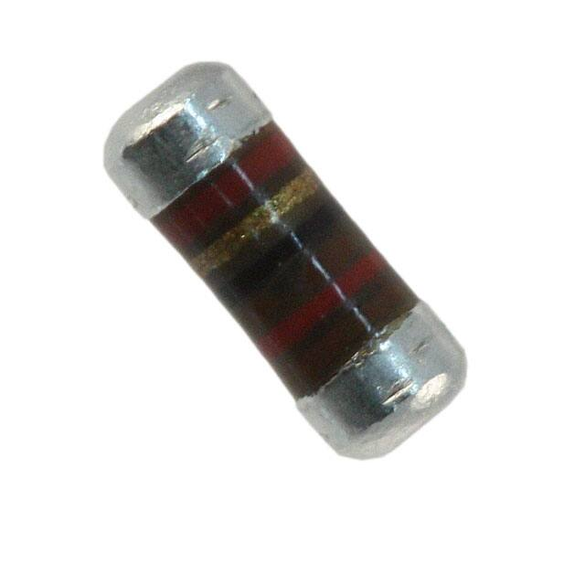

    贴片电阻 MELF_D1.4X3.5MM_SM 12Ω ±2% 2/5W
CMA02040X1209GB300 数据手册
CMA 0204 Vishay Beyschlag High Pulse Load MELF Resistors FEATURES • • • • • Special carbon film technology Up to 4 kV single pulse capability Up to 70 W continuous pulse load ESD capability: 6 kV, human body model Compatible with lead (Pb)-free and lead containing soldering processes • Compliant to RoHS directive 2002/95/EC CMA 0204 specialty MELF resistors with advanced pulse load capability are the perfect choice for the protection of circuitry with signal or mains input lines from surge pulses. The resistors are also suitable for circuits exposed to high levels of electromagnetic interference or electrostatic discharge. The applications are in all fields of automotive, telecommunication, industrial and medical equipment. APPLICATIONS • • • • Automotive Telecommunication Industrial Medical equipment METRIC SIZES DIN 0204 CECC RC 3715M TECHNICAL SPECIFICATIONS DESCRIPTION CMA 0204 Metric CECC size RC 3715M Resistance range 10 Ω to 100 kΩ Resistance tolerance ±2% Temperature coefficient See TCR graph Operation mode Standard Power Climatic category (LCT/UCT/days) 55/125/56 55/155/56 0.25 W 0.4 W Rated dissipation, P70 (1) Operating voltage, Umax. AC/DC Film 200 V 125 °C temperature (2) Max. resistance change at P70 for resistance range, ΔR/R after: 155 °C 10 Ω to 100 kΩ 1000 h ≤1% ≤2% 8000 h ≤2% ≤4% Permissible voltage against ambient (insulation): 1 min; Uins 300 V Continuous 75 V ≤ 0.1 x 10-9/h Failure rate: FITobserved Notes • These resistors do not feature a limited lifetime when operated within the permissible limits. However, resistance value drift increasing over operating time may result in exceeding a limit acceptable to the specific application, thereby establishing a functional lifetime. (1) The power dissipation on the resistor generates a temperature rise against the local ambient, depending on the heatflow support of the printed-circuit board (thermal resistance). The rated dissipation applies only if the permitted film temperature is not exceeded. Furthermore, a high level of ambient temperature or of power dissipation may raise the temperature of the solder joint, hence special solder alloys or board materials may be required to maintain the reliability of the assembly. (2) Film temperatures above the specified range may be permissible, e.g. 175 °C. Please contact the factory for details. ** Please see document “Vishay Material Category Policy”: www.vishay.com/doc?99902 www.vishay.com 58 For technical questions, contact: melf@vishay.com Document Number: 28717 Revision: 01-Mar-10 CMA 0204 High Pulse Load MELF Resistors Vishay Beyschlag DIMENSIONS L K L1 D D1 DIMENSIONS AND MASS L (mm) D (mm) L1 min. (mm) D1 (mm) K (mm) MASS (mg) 3.6 + 0/- 0.2 1.4 + 0/- 0.1 1.8 D + 0/- 0.15 0.8 ± 0.1 19 TYPE CMA 0204 Note • Color code marking is applied according to IEC 60062 (3) in four bands (E24 series). Each color band appears as a single solid line, voids are permissible if at least 2/3 of the band is visible from each radial angle of view. The last color band for tolerance is approximately 50 % wider than the other bands. An interrupted band between the 2nd and 3rd full band identifies the special carbon film. PATTERN STYLES FOR MELF RESISTORS X G Y Z RECOMMENDED SOLDER PAD DIMENSIONS WAVE SOLDERING TYPE REFLOW SOLDERING G (mm) Y (mm) X (mm) Z (mm) G (mm) Y (mm) X (mm) Z (mm) 1.5 1.5 1.8 4.5 1.7 1.2 1.6 4.1 CMA 0204 Note • The given solder pad dimensions reflect the considerations for board design and assembly as outlined e.g. in standards IEC 61188-5-x, or in publication IPC-7351. They do not guarantee any supposed thermal properties, however, they will be found adequate for most general applications. Document Number: 28717 Revision: 01-Mar-10 For technical questions, contact: melf@vishay.com www.vishay.com 59 CMA 0204 High Pulse Load MELF Resistors Vishay Beyschlag PART NUMBER AND PRODUCT DESCRIPTION Part Number: CMA02040X4701GB300 C MODEL/SIZE CMA0204 M A 0 2 SPECIAL CHARACTER 0 = Neutral 0 4 0 TCR X = No indication X 4 7 0 1 G B 3 0 0 VALUE 3 digit value 1 digit multiplier Multiplier 9 = *10-1 0 = *100 1 = *101 2 = *102 3 = *103 TOLERANCE G=±2% PACKAGING SPECIAL B3 Up to 2 digits B0 00 = Standard Product Description: CMA 0204 2 % BL 4K7 CMA 0204 2% BL 4K7 MODEL SIZE TOLERANCE PACKAGING RESISTANCE VALUE CMA 0204 ±2% BL B0 100R = 100 Ω 4K7 = 4.7 kΩ Note • Products can be ordered using either the PART NUMBER or the PRODUCT DESCRIPTION. PACKAGING BLISTER TAPE ON REEL ACC. IEC 60286-3 MODEL DIAMETER PIECES/REEL CODE 180 mm/7" 3000 B3 = BL 330 mm/13" 10 000 B0 CMA 0204 www.vishay.com 60 For technical questions, contact: melf@vishay.com Document Number: 28717 Revision: 01-Mar-10 CMA 0204 High Pulse Load MELF Resistors Vishay Beyschlag DESCRIPTION APPROVALS Production of the CMA 0204 specialty MELF resistors with advanced pulse load capability is strictly controlled and follows an extensive set of instructions established for reproducibility. A homogeneous and dense carbon film is deposited on a high grade ceramic body (85 % Al2O3). Nickel plated steel termination caps are firmly pressed on the coated rods. A special laser is used to achieve the target value by smoothly cutting a helical groove in the resistive layer without damaging the ceramics. The resistors are covered by protective coating designed for electrical, mechanical and climatic protection.The terminations receive a final pure tin on nickel plating. Four color code rings designate the resistance value and tolerance in accordance with IEC 60 062 (3). Where applicable the resistors are tested in accordance with EN 140401-803 (superseding CECC 40401-803) which refers to EN 60115-1, EN 140400 and the variety of enviromental text procedures of the IEC 60068 (3) series. Vishay BEYSCHLAG has achieved “Approval of Manufacturer” in accordance with IEC QC 001002-3, clause 2. The release certificate for “Technology Approval Schedule” in accordance with CECC 240001 based on IEC QC 001002-3, clause 6 is granted for the Vishay BEYSCHLAG manufacturing process. The result of the determined production is verified by an extensive testing procedure performed on 100 % of the individual resistors. Only accepted products are laid directly into the blister tape in accordance with IEC 60 286-3 (3). ASSEMBLY The resistors are suitable for processing on automatic SMD assembly systems. They are suitable for automatic soldering using wave, reflow or vapour phase as shown in IEC 61760-1(3). Excellent solderability is proven, even after extended storage in excess of 10 years. The encapsulation is resistant to all cleaning solvents commonly used in the electronics industry, including alcohols, esters and aqueous solutions. The resistors are completely lead (Pb)-free, the pure tin plating provides compatibility with lead (Pb)-free soldering processes. The immunity of the plating against tin whisker growth has been proven under extensive testing. All products comply with the GADSL (1) and the CEFIC-EECA-EICTA (2) list of legal restrictions on hazardous substances. This includes full compliance with the following directives: • 2000/53/EC End of Vehicle life Directive (ELV) and Annex II (ELV II) • 2002/95/EC Restriction of the Substances Directive (RoHS) use of Hazardous • 2002/96/EC Waste Electrical and Electronic Equipment Directive (WEEE) Notes (1) Global Automotive Declarable Substance List, see www.gadsl.org. (2) CEFIC (European Chemical Industry Council), EECA (European Electronic Component Manufacturers Association), EICTA (European trade organisation representing the information and communications technology and consumer electronics), see www.eicta.org/index.php?id=995 → issues → environment policy → chemicals → chemicals for electronics. (3) The quoted IEC standards are also released as EN standards with the same number and identical contents. Document Number: 28717 Revision: 01-Mar-10 For technical questions, contact: melf@vishay.com www.vishay.com 61 CMA 0204 High Pulse Load MELF Resistors Vishay Beyschlag Power Dissipation P FUNCTIONAL PERFORMANCE 1 CMA 0204 W 0.5 0 - 50 0 50 70 100 °C 150 Ambient Temperature ϑamb Power Dissipation P Derating - Standard Operation 1 CMA 0204 W 0.5 0 - 50 0 50 70 100 °C 150 Ambient Temperature ϑamb Pulse Load Pmax. Derating - Standard Operation CMA 0204 100 W 10 1 0.1 10 µs 100 µs 1 ms 10 ms 100 ms 1s 10 s Pulse Duration ti Single www.vishay.com 62 Maximum pulse load, single pulse; applicable if P 0 and n ≤ 1000 and U ≤ Umax.; for permissible resistance change equivalent to 8000 h operation Pulse For technical questions, contact: melf@vishay.com Document Number: 28717 Revision: 01-Mar-10 CMA 0204 High Pulse Load MELF Resistors Vishay Beyschlag Continuous Pulse Load Pmax. FUNCTIONAL PERFORMANCE CMA 0204 100 W 10 1 0. 1 10 µs 100 µs 1 ms 10 ms 100 ms 1s 10 s Pulse Duration ti Maximum pulse load, continuous pulses; applicable if P ≤ P (ϑ amb) and U ≤ Umax.; for permissible resistance change equivalent to 8000 h operation Pulse Voltage Umax Continuous Pulses CMA 0204 1 kV 100 V 10 µs 100 µs 1 ms 10 ms 100 ms 1s 10 s Pulse Duration ti Maximum pulse voltage, single and continuous pulses; applicable if P ≤ Pmax; for permissible resistance change equivalent to 8000 h operation Pulse Voltage U Pulse Voltage 1 kV 100 V CMA 0204 10 V 10 Ω 100 Ω 1 kΩ 10 kΩ 100 kΩ 1 MΩ Resistance Value R Pulse load rating in accordance with IEC 60115-1, 4.27; 1,2 µs/50 µs; 5 pulses at 12 s intervals; for permissible resistance change 0.5 % 1.2/50 Pulse Document Number: 28717 Revision: 01-Mar-10 For technical questions, contact: melf@vishay.com www.vishay.com 63 CMA 0204 High Pulse Load MELF Resistors Vishay Beyschlag Pulse Voltage U FUNCTIONAL PERFORMANCE CMA 0204 1 kV 100 V 10 V 100 Ω 10 Ω 1 kΩ 10 kΩ 100 kΩ 1 MΩ Resistance Value R Pulse load rating in accordance with IEC 60115-1, 4.27; 10 µs/700 µs; 10 pulses at 1 minute intervals; for permissible resistance change 0.5 % Temperature Coefficient 10/700 Pulse CMA 0204 - 100 ppm/K - 200 - 300 - 400 - 500 10 Ω 100 Ω 1 kΩ 10 kΩ 1 MΩ 100 kΩ 10 MΩ Resistance Value R Temperature coefficient of resistance Current Noise A1 Temperature Coefficient (TCR) (Typical Curve) CMA 0204 1 µV/V 0.1 0.01 100 Ω 1 kΩ 10 kΩ 100 kΩ 1 MΩ Resistance Value R In accordance with IEC 60 195 Current Noise - A1 www.vishay.com 64 For technical questions, contact: melf@vishay.com Document Number: 28717 Revision: 01-Mar-10 CMA 0204 High Pulse Load MELF Resistors Vishay Beyschlag TESTS AND REQUIREMENTS upper category temperature; damp heat, long term, 56 days) is valid. Unless otherwise specified the following values apply: Temperature: 15 °C to 35 °C Relative humidity: 45 % to 75 % Air pressure: 86 kPa to 106 kPa (860 mbar to 1060 mbar). The components are mounted for testing on printed-circuit boards in accordance with EN 140400, 2.3.3, unless otherwise specified. The requirements stated in the Test Procedures and Requirements table are based on the required tests and permitted limits of EN 140401-803. Essentially all tests are carried out in accordance with the following specifications: EN 60115-1, generic specification EN 140400, sectional specification EN 140401-803, detail specification The Test Procedures and Requirements table contains the applicable tests selected from the documents listed above. The tests are carried out in accordance with IEC 60068 (1) and under standard atmospheric conditions in accordance with IEC 60068-1, 5.3 (1). Climatic category LCT/UCT/56 (rated temperature range: Lower category temperature, TEST PROCEDURES AND REQUIREMENTS EN 60115-1 CLAUSE IEC 60068-2 (1) TEST METHOD TEST REQUIREMENTS PERMISSIBLE CHANGE (ΔR) PROCEDURE Stability for product types: CMA 0204 4.5 4.8.4.2 4.25.1 4.25.1 4.25.3 4.24 Resistance - ±2%R - Temperature coefficient At (20/- 55/20) °C and (20/125/20) °C See Temperature Coefficient graph - Endurance at 70 °C: standard operation mode - - Endurance at 70 °C: power operation mode U = P 70 x R ≤ Umax.; 1.5 h on; 0.5 h off; 70 °C; 1000 h ± (1 % R + 0.05 Ω) 70 °C; 8000 h ± (2 % R + 0.05 Ω) U = P 70 x R ≤ Umax.; 1.5 h on; 0.5 h off; 70 °C; 1000 h ± (4 % R + 0.05 Ω) - 125 °C; 1000 h ± (2 % R + 0.05 Ω) 155 °C; 1000 h ± (4 % R + 0.05 Ω) 78 (Cab) Damp heat, steady state (40 ± 2) °C; 56 days; (93 ± 3) % RH ± (1 % R + 0.1 Ω) Climatic sequence: 4.23.2 2 (Ba) dry heat UCT; 16 h 4.23.3 30 (Db) damp heat, cyclic 55 °C; 24 h; ≥ 90 % RH; 1 cycle 4.23.4 1 (Aa) cold LCT; 2 h 4.23.5 13 (M) low air pressure 8.5 kPa; 2 h; (25 ± 10) °C 4.23.6 30 (Db) damp heat, cyclic 55 °C; 24 h; ≥ 90 % RH; 5 cycles 4.23.7 - DC load 4.19 4.13 4.40 ± (2 % R + 0.05 Ω) 70 °C; 8000 h Endurance at upper category temperature 4.23 - 10 Ω to 100 kΩ U= P 70 x R ≤ Umax.; 1 min LCT = - 55 °C; UCT = 155 °C ± (1 % R + 0.1 Ω) 1 (Aa) Cold - 55 °C; 2 h ± (0.5 % R + 0.1 Ω) 14 (Na) Rapid change of temperature 30 min at - 55 °C; 30 min at + 125 °C; 5 cycles ± (0.5 % R + 0.1 Ω) - - Document Number: 28717 Revision: 01-Mar-10 Short time overload; standard operation mode U = 2.5 x P 70 x R ≤ 2 x Umax.; 5 s ± (0.25 % R + 0.1 Ω) Short time overload; power operation mode U = 2.5 x P 70 x R ≤ 2 x Umax.; 5 s ± (0.25 % R + 0.1 Ω) Electrostatic discharge (human body model) IEC 61340-3-1 (1); 3 pos. + 3 neg. discharges CMA 0204: 6 kV For technical questions, contact: melf@vishay.com ± (0.5 % R + 50 mΩ) www.vishay.com 65 CMA 0204 High Pulse Load MELF Resistors Vishay Beyschlag TEST PROCEDURES AND REQUIREMENTS EN 60115-1 CLAUSE IEC 60068-2 (1) TEST METHOD TEST REQUIREMENTS PERMISSIBLE CHANGE (ΔR) PROCEDURE Stability for product types: 10 Ω to 100 kΩ CMA 0204 4.29 45 (XA) Component solvent resistance Isopropyl alcohol; 50 °C; method 2 No visible damage 4.30 45 (XA) Solvent resistance of marking Isopropyl alcohol; 50 °C; method 1, toothbrush Marking legible; no visible damage Solder bath method; SnPb40; non-activated flux; (215 ± 3) °C; (3 ± 0.3) s Good tinning (≥ 95 % covered); no visible damage Solder bath method; SnAg3Cu0.5 or SnAg3.5; non-activated flux; (235 ± 3) °C; (2 ± 0.2) s Good tinning (≥ 95 % covered); no visible damage 4.17.2 58 (Td) Solderability 4.18.2 58 (Td) Resistance to soldering heat Solder bath method ; (260 ± 5) °C; (10 ± 1) s ± (0.5 % R + 0.1 Ω) 4.32 21 (Ue3) Shear (adhesion) 45 N No visible damage 4.7 - Voltage proof URMS = Uins; 60 s No flashover or breakdown Flammability IEC 60 695-11-5 (1), needle flame test; 10 s No burning after 30 s 4.35 - Note (1) The quoted IEC standards are also released as EN standards with the same number and identical contents. Last Digit of 12NC Indicating Resistance Decade HISTORICAL 12NC INFORMATION • The resistors have a 12-digit numeric code starting with 2312. RESISTANCE DECADE LAST DIGIT 10 Ω to 99.9 Ω 9 • The subsequent 4 digits indicate the resistor type, specification and packaging; see the 12NC table. 100 Ω to 999 Ω 1 • The remaining 4 digits indicate the resistance value: - The first 3 digits indicate the resistance value. 1 kΩ to 9.99 kΩ 2 10 kΩ to 99.9 kΩ 3 100 kΩ to 999 kΩ 4 Historical 12NC Example - The last digit indicates the resistance decade in accordance with the 12NC Indicating Resistance Decade table. The 12NC of a CMA 0204 resistor, value 47 kΩ with ± 2 % tolerance, supplied in blister tape of 3000 units per reel is: 2312 159 24703. HISTORICAL 12NC - Resistor type and packaging ORDERING CODE 2312 ... ..... DESCRIPTION BLISTER TAPE ON REEL TYPE CMA 0204 www.vishay.com 66 TOL. BL 3000 UNITS B0 10 000 UNITS ±2% 159 2.... 149 2.... For technical questions, contact: melf@vishay.com Document Number: 28717 Revision: 01-Mar-10 Legal Disclaimer Notice www.vishay.com Vishay Disclaimer ALL PRODUCT, PRODUCT SPECIFICATIONS AND DATA ARE SUBJECT TO CHANGE WITHOUT NOTICE TO IMPROVE RELIABILITY, FUNCTION OR DESIGN OR OTHERWISE. Vishay Intertechnology, Inc., its affiliates, agents, and employees, and all persons acting on its or their behalf (collectively, “Vishay”), disclaim any and all liability for any errors, inaccuracies or incompleteness contained in any datasheet or in any other disclosure relating to any product. Vishay makes no warranty, representation or guarantee regarding the suitability of the products for any particular purpose or the continuing production of any product. To the maximum extent permitted by applicable law, Vishay disclaims (i) any and all liability arising out of the application or use of any product, (ii) any and all liability, including without limitation special, consequential or incidental damages, and (iii) any and all implied warranties, including warranties of fitness for particular purpose, non-infringement and merchantability. Statements regarding the suitability of products for certain types of applications are based on Vishay’s knowledge of typical requirements that are often placed on Vishay products in generic applications. Such statements are not binding statements about the suitability of products for a particular application. It is the customer’s responsibility to validate that a particular product with the properties described in the product specification is suitable for use in a particular application. Parameters provided in datasheets and/or specifications may vary in different applications and performance may vary over time. All operating parameters, including typical parameters, must be validated for each customer application by the customer’s technical experts. Product specifications do not expand or otherwise modify Vishay’s terms and conditions of purchase, including but not limited to the warranty expressed therein. Except as expressly indicated in writing, Vishay products are not designed for use in medical, life-saving, or life-sustaining applications or for any other application in which the failure of the Vishay product could result in personal injury or death. Customers using or selling Vishay products not expressly indicated for use in such applications do so at their own risk. Please contact authorized Vishay personnel to obtain written terms and conditions regarding products designed for such applications. No license, express or implied, by estoppel or otherwise, to any intellectual property rights is granted by this document or by any conduct of Vishay. Product names and markings noted herein may be trademarks of their respective owners. Material Category Policy Vishay Intertechnology, Inc. hereby certifies that all its products that are identified as RoHS-Compliant fulfill the definitions and restrictions defined under Directive 2011/65/EU of The European Parliament and of the Council of June 8, 2011 on the restriction of the use of certain hazardous substances in electrical and electronic equipment (EEE) - recast, unless otherwise specified as non-compliant. Please note that some Vishay documentation may still make reference to RoHS Directive 2002/95/EC. We confirm that all the products identified as being compliant to Directive 2002/95/EC conform to Directive 2011/65/EU. Vishay Intertechnology, Inc. hereby certifies that all its products that are identified as Halogen-Free follow Halogen-Free requirements as per JEDEC JS709A standards. Please note that some Vishay documentation may still make reference to the IEC 61249-2-21 definition. We confirm that all the products identified as being compliant to IEC 61249-2-21 conform to JEDEC JS709A standards. Revision: 02-Oct-12 1 Document Number: 91000
