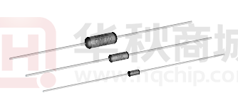

CMF Industrial www.vishay.com Vishay Dale Metal Film Resistors, Axial, Industrial, Precision FEATURES • • • • • • • Small size - conformal coated Flame retardant epoxy coating Controlled temperature coefficient Excellent high frequency characteristics Exceptionally low noise; typically 0.10 μV/V Low voltage coefficient to ± 5 ppm/V Special tolerance and or TC matching available on request • Material categorization: for definitions of compliance please see www.vishay.com/doc?99912 Available Available Note * This datasheet provides information about parts that are RoHS-compliant and / or parts that are non RoHS-compliant. For example, parts with lead (Pb) terminations are not RoHS-compliant. Please see the information / tables in this datasheet for details Vishay Dale Model CMF is also available as Military Qualified Styles RN and RL. See Vishay Dale’s CMF (Military RN and RL) datasheet (www.vishay.com/doc?31027) for the MIL-SPEC ratings / attributes. (Except for marking, the Industrial and Military versions are exactly the same). STANDARD ELECTRICAL SPECIFICATIONS HISTORICAL MODEL MAXIMUM WORKING VOLTAGE (1) V POWER RATING P70 °C (2) W POWER RATING P125 °C (2) W CMF50 CMF-50 200 0.25 0.125 CMF55 CMF-55 250 0.5 0.25 CMF60 CMF-60 500 1 0.5 CMF65 CMF-65 500 1.5 1 CMF70 CMF-70 500 1.75 1.25 CMF07 CMF-07 250 0.5 - CMF20 CMF-20 500 1 - GLOBAL MODEL RESISTANCE RANGE  TOLERANCE ±% TEMPERATURE COEFFICIENT ± ppm/°C 10 to 2.5M 10 to 2.5M 10 to 2.5M 10 to 22M 10 to 2.5M 10 to 2.5M 10 to 5M 1 to 22.1M 0.5 to 50M 0.5 to 50M 0.1 to 50M 0.2 to 50M 10 to 2.5M 10 to 2.5M 10 to 10M 1 to 10M 0.5 to 10M 0.5 to 10M 0.1 to 10M 0.2 to 50M 10 to 2.5M 10 to 2.5M 10 to 10M 1 to 15M 0.5 to 22M 0.5 to 22M 0.1 to 22M 0.2 to 50M 10 to 2.5M 10 to 2.5M 10 to 10M 1 to 15M 1 to 22M 5 to 5M 1 to 5M 5 to 10M 1 to 10M 0.1, 0.25, 0.5, 1 0.1, 0.25, 0.5, 1, 2, 5 1, 2, 5 1, 2, 5 0.1, 0.25, 0.5, 1 0.1, 0.25, 0.5 1, 2, 5 1, 2, 5 1, 2, 5 1 2, 5 2, 5 0.1, 0.25, 0.5, 1 0.1, 0.25, 0.5 1, 2, 5 1, 2, 5 1, 2, 5 1 2, 5 2, 5 0.1, 0.25, 0.5, 1 0.1, 0.25, 0.5 1, 2, 5 1, 2, 5 1, 2, 5 1 2, 5 2, 5 0.1, 0.25, 0.5, 1 0.1, 0.25, 0.5 1, 2, 5 1, 2, 5 1, 2, 5 2, 5 2, 5 2, 5 2, 5 25 50 100 150, 200 25 50 50 100 150 200 300 200 25 50 50 100 150 200 300 200 25 50 50 100 150 200 300 200 25 50 50 100 150, 200 100 150, 200 100 150, 200 Notes (1) Continuous working voltage shall be P x R or maximum working voltage, whichever is less (2) See the load life shift due to power and derating table for a summary of the more common combinations of power rating, case size and ambient operating temperature that prevail in various industrial and military resistor specifications. The “performance” table quantifies the load life stability under these combinations Revision: 10-Nov-2020 Document Number: 31018 1 For technical questions, contact: ff2aresistors@vishay.com THIS DOCUMENT IS SUBJECT TO CHANGE WITHOUT NOTICE. THE PRODUCTS DESCRIBED HEREIN AND THIS DOCUMENT ARE SUBJECT TO SPECIFIC DISCLAIMERS, SET FORTH AT www.vishay.com/doc?91000 CMF Industrial www.vishay.com Vishay Dale GLOBAL PART NUMBER INFORMATION New Global Part Numbering: CMF55301R00FKRE (preferred part numbering format) C M F 5 5 3 0 1 R 0 0 GLOBAL MODEL RESISTANCE VALUE TOLERANCE CODE TEMPERATURE COEFFICIENT (1) (See Standard Electrical Specifications table) R= K = k M = M R10000 = 0.1  680K00 = 680 k 1M0000 = 1.0 M B = ± 0.1 % C = ± 0.25 % D = ± 0.5 % F=±1% G=±2% J=±5% E = 25 ppm H = 50 ppm K = 100 ppm L = 150 ppm N = 200 ppm M = 300 ppm F K R E PACKAGING SPECIAL EK = lead (Pb)-free, bulk EA = lead (Pb)-free, T/R (full) EB = lead (Pb)-free, T/R (1000 pieces) Blank = standard (Dash number) (Up to 3 digits) From 1 to 999 as applicable 70 = color banded, 5 bands ( 1 %) 80 = color banded, 4 bands ( 2 %) 88 = hot solder dip BF = tin / lead, bulk RE = tin / lead, T/R (full) R6 = tin / lead, T/R (1000 pieces) Historical Part Number Example: CMF-553010FT-1 (will continue to be accepted) CMF-55 3010 F T-1 R36 HISTORICAL MODEL RESISTANCE VALUE TOLERANCE CODE TEMPERATURE COEFFICIENT PACKAGING Notes • For additional information on packaging, refer to the Through-Hole Resistor Packaging document (www.vishay.com/doc?31544) (1) Tolerances of ± 0.5 % (D), ± 0.25 % (C) and ± 0.1 % (B) are available only in 50 ppm and 25 ppm temperature coefficients DIMENSIONS in inches (millimeters) 1.500 ± 0.125 (1) (38.10 ± 3.18) A C (Max.) GLOBAL MODEL CMF50 CMF55 CMF60 CMF65 CMF70 CMF07 CMF20 A B 0.150 ± 0.020 (3.81 ± 0.51) 0.240 ± 0.020 (3) (6.10 ± 0.51) 0.344 ± 0.031 (8.74 ± 0.79) 0.562 ± 0.031 (14.27 ± 0.79) 0.562 ± 0.031 (14.27 ± 0.79) 0.240 ± 0.020 (6.10 ± 0.51) 0.375 ± 0.040 (9.53 ± 1.02) 0.065 ± 0.015 (1.65 ± 0.38) 0.090 ± 0.008 (2.29 ± 0.20) 0.145 ± 0.015 (3.68 ± 0.38) 0.180 ± 0.015 (4.57 ± 0.38) 0.180 ± 0.015 (4.57 ± 0.38) 0.090 ± 0.008 (2.29 ± 0.20) 0.145 ± 0.015 (3.68 ± 0.38) B D C (Max.) 0.187 (4.75) 0.290 (7.37) 0.425 (10.80) 0.687 (17.45) 0.687 (17.45) 0.290 (7.37) 0.425 (10.80) D 0.016 ± 0.002 (2) (0.41 ± 0.05) 0.025 ± 0.002 (0.64 ± 0.05) 0.025 ± 0.002 (4) (0.64 ± 0.05) 0.025 ± 0.002 (0.64 ± 0.05) 0.032 ± 0.002 (0.81 ± 0.05) 0.025 ± 0.002 (0.64 ± 0.05) 0.032 ± 0.002 (0.81 ± 0.05) Notes (1) Lead length for product in bulk pack. For product supplied in tape and reel, the actual lead length would be based on the body size, tape spacing and lead trim. (2) Available with 0.020" (0.51 mm) lead [CMF50..38] (3) 0.260" ± 0.020" (6.60 mm ± 0.51 mm) for values > 5 M (4) Available with 0.032" (0.813 mm) lead [CMF60..95] TECHNICAL SPECIFICATIONS PARAMETER Maximum Working Voltage Insulation Voltage (1 Min) Voltage Coefficient (Max.) Dielectric Strength Insulation Resistance Operating Temperature Range Terminal Strength (Pull Test) Noise Weight (Max.) Revision: 10-Nov-2020 UNIT V Veff ppm/V VAC  °C lb dB g CMF50 200 CMF55  250 CMF07  250 CMF60 CMF20 CMF65 CMF70  500 500  500  500 > 500 ± 5 (measured between 10 % and full rated voltage) 450 450 450 750 750 900 900 1011 -55 to +175 2 2 5 2 5 2 5 0.10 μV/V over a decade of frequency, with low and intermediate resistance values typically below 0.05 μV/V 0.12 0.28 0.28 0.50 0.60 1.00 1.10 Document Number: 31018 2 For technical questions, contact: ff2aresistors@vishay.com THIS DOCUMENT IS SUBJECT TO CHANGE WITHOUT NOTICE. THE PRODUCTS DESCRIBED HEREIN AND THIS DOCUMENT ARE SUBJECT TO SPECIFIC DISCLAIMERS, SET FORTH AT www.vishay.com/doc?91000 CMF Industrial www.vishay.com Vishay Dale TEMPERATURE COEFFICIENT CODES GLOBAL TC CODE HISTORICAL TC CODE TEMPERATURE COEFFICIENT E T-9 25 ppm/°C H T-2 50 ppm/°C K T-1 100 ppm/°C L T-0 150 ppm/°C N T-00 200 ppm/°C M M 300 ppm/°C LOAD LIFE SHIFT DUE TO POWER AND DERATING (AT +70 °C AND AT +125 °C) The power rating for the CMF parts is tied to the derating temperature, the heat rise of the parts, and the R for the load life performance. When the tables/graphs below are used together they show that when the parts are run at their higher power ratings, the parts will run hotter, which has the potential of causing the resistance of the parts to shift more over the life of the part. LOAD LIFE SHIFT VS. POWER RATING MAXIMUM R (TYPICAL TEST LOTS) LOAD LIFE ± 0.15 % MODEL ± 0.5 % ± 1.0 % ± 0.15 % POWER RATING AT +70 °C ± 0.5 % ± 1.0 % POWER RATING AT +125 °C CMF50 1/20 W and 1/10 W 1/8 W 1/4 W 1/20 W 1/10 W 1/8 W CMF55, CMF07 1/10 W and 1/8 W 1/4 W 1/2 W 1/10 W 1/8 W 1/4 W CMF60, CMF20 1/8 W and 1/4 W 1/2 W 3/4 W and 1 W 1/8 W 1/4 W 1/2 W CMF65 1/4 W and 1/2 W 3/4 W 1 W and 1-1/2 W 1/4 W 1/2 W 3/4 W and 1 W CMF70 1/4 W and 1/2 W 3/4 W 1 W and 1-3/4 W 1/4 W 1/2 W 3/4 W and 1-1/4 W 120 HEAT RISE (°C ABOVE AMBIENT) RATED POWER IN % CMF resistors have an operating temperature range of -55 °C to +175 °C. They must be derated at high ambient temperatures according to the derating curve. 100 80 60 40 20 0 - 55 - 50 - 25 0 DERATING 25 50 70 75 100 125 150 165 175 200 AMBIENT TEMPERATURE IN °C 120 CMF50 100 CMF55, CMF07 CMF60, CMF20 80 CMF65, CMF70 60 40 20 0 0 0.125 0.25 0.375 0.5 0.625 0.75 0.875 1 1.125 APPLIED POWER IN W THERMAL RESISTANCE Example: When a CMF55 part is run at 1/8 W in a 70 °C ambient environment, the resistor will generate enough heat that the surface temperature of the part will reach about 19 °C over the ambient temperature, and over the life of the part this could cause the resistance value to shift up to ± 0.15 %. If the same resistor was instead run at 1/4 W in a 70 °C environment, the element will heat up to about 30 °C over ambient, and over the life of the part the resistance value could shift roughly ± 0.5 %. And if the resistor was run at it maximum power rating of 1/2 W in a 70 °C environment, it will heat up to about 58 °C over ambient, and you could see the resistance value shift roughly ± 1 % over the life of the part. MATERIAL SPECIFICATIONS Element Core Revision: 10-Nov-2020 Vacuum-deposited nickel-chrome alloy Fire-cleaned high purity ceramic Coating Flame retardant epoxy, formulated for superior moisture protection Solderability Continuous satisfactory coverage when tested in accordance with MIL-R-10509 Document Number: 31018 3 For technical questions, contact: ff2aresistors@vishay.com THIS DOCUMENT IS SUBJECT TO CHANGE WITHOUT NOTICE. THE PRODUCTS DESCRIBED HEREIN AND THIS DOCUMENT ARE SUBJECT TO SPECIFIC DISCLAIMERS, SET FORTH AT www.vishay.com/doc?91000 CMF Industrial www.vishay.com Vishay Dale SPECIAL MODIFICATIONS 1. Terminals may be supplied in any commercial material with several type finishes. 2. Special pre-conditioning (power aging, temperature cycling, etc.) to customer specifications. 3. Non-helixed resistors can be supplied for critical high frequency applications. 4. Fusible, flameproof versions available. MARKING Temperature coefficient: T00 = 200 ppm, T0 = 150 ppm, T1 = 100 ppm, T2 = 50 ppm, T9 = 25 ppm, M = 300 ppm CMF50: (3 lines) CMF55, CMF60, CMF65, CMF70: (5 lines) 3.01 Value DALE Manufacturer’s name K1% Ohm, K or M sign and Tolerance CMF55 Style and size 1208 4-digit date code 49.9 k Value 1 % T2 Tolerance and TC 1208 4-digit date code Note • CMF07 and CMF20 parts are marked with color bands, either per MIL-PRF-22684 (with a wide white band) or using commercial color bands. CMFxx..70 and CMFxx..80 parts are marked using commercial color bands PERFORMANCE TEST  (TEST METHODS - MIL-STD-202) AT +70 °C Short Time Overload ± 0.05 % ± 0.05 % Low Temperature Operation ± 0.05 % ± 0.05 % Moisture Resistance ± 0.05 % ± 0.05 % Shock ± 0.01 % ± 0.01 % Vibration ± 0.04 % ± 0.04 % ± 0.15 % ± 0.15 % Temperature Cycling Load Life AT +125 °C MAXIMUM R (TYPICAL TEST LOTS) Varies based on power rating used; see load life shift due to power and derating table Dielectric Withstanding Voltage ± 0.01 % ± 0.01 % Effect of Solder ± 0.03 % ± 0.03 % Revision: 10-Nov-2020 Document Number: 31018 4 For technical questions, contact: ff2aresistors@vishay.com THIS DOCUMENT IS SUBJECT TO CHANGE WITHOUT NOTICE. THE PRODUCTS DESCRIBED HEREIN AND THIS DOCUMENT ARE SUBJECT TO SPECIFIC DISCLAIMERS, SET FORTH AT www.vishay.com/doc?91000 Legal Disclaimer Notice www.vishay.com Vishay Disclaimer ALL PRODUCT, PRODUCT SPECIFICATIONS AND DATA ARE SUBJECT TO CHANGE WITHOUT NOTICE TO IMPROVE RELIABILITY, FUNCTION OR DESIGN OR OTHERWISE. Vishay Intertechnology, Inc., its affiliates, agents, and employees, and all persons acting on its or their behalf (collectively, “Vishay”), disclaim any and all liability for any errors, inaccuracies or incompleteness contained in any datasheet or in any other disclosure relating to any product. Vishay makes no warranty, representation or guarantee regarding the suitability of the products for any particular purpose or the continuing production of any product. To the maximum extent permitted by applicable law, Vishay disclaims (i) any and all liability arising out of the application or use of any product, (ii) any and all liability, including without limitation special, consequential or incidental damages, and (iii) any and all implied warranties, including warranties of fitness for particular purpose, non-infringement and merchantability. Statements regarding the suitability of products for certain types of applications are based on Vishay’s knowledge of typical requirements that are often placed on Vishay products in generic applications. Such statements are not binding statements about the suitability of products for a particular application. It is the customer’s responsibility to validate that a particular product with the properties described in the product specification is suitable for use in a particular application. Parameters provided in datasheets and / or specifications may vary in different applications and performance may vary over time. All operating parameters, including typical parameters, must be validated for each customer application by the customer’s technical experts. Product specifications do not expand or otherwise modify Vishay’s terms and conditions of purchase, including but not limited to the warranty expressed therein. Except as expressly indicated in writing, Vishay products are not designed for use in medical, life-saving, or life-sustaining applications or for any other application in which the failure of the Vishay product could result in personal injury or death. Customers using or selling Vishay products not expressly indicated for use in such applications do so at their own risk. Please contact authorized Vishay personnel to obtain written terms and conditions regarding products designed for such applications. No license, express or implied, by estoppel or otherwise, to any intellectual property rights is granted by this document or by any conduct of Vishay. Product names and markings noted herein may be trademarks of their respective owners. © 2021 VISHAY INTERTECHNOLOGY, INC. ALL RIGHTS RESERVED Revision: 01-Jan-2021 1 Document Number: 91000

物料型号:文档中提到了多个型号,例如CMF50, CMF55, CMF07, CMF60, CMF20, CMF65, CMF70。
器件简介:Vishay Dale品牌的金属膜电阻器,具有小型化、阻燃环氧涂层、控制温度系数、高频特性优异、低噪声等特点。
引脚分配:文档中没有提供具体的引脚分配信息,但提到了电阻器的尺寸和引线长度。
参数特性:包括最大工作电压、功率等级、电阻范围、容差、温度系数等。例如CMF50型号的最大工作电压为200V,功率等级在70°C时为0.25W,在125°C时为0.125W。
功能详解:文档提供了详细的电阻器规格和技术规格,包括操作温度范围、终端强度、噪声水平、重量等。
应用信息:文档中没有明确提供应用信息,但根据电阻器的特性,可以推断它们适用于需要精密和高稳定性电阻值的工业应用。
封装信息:文档提供了详细的封装信息,包括尺寸和标记方法。
