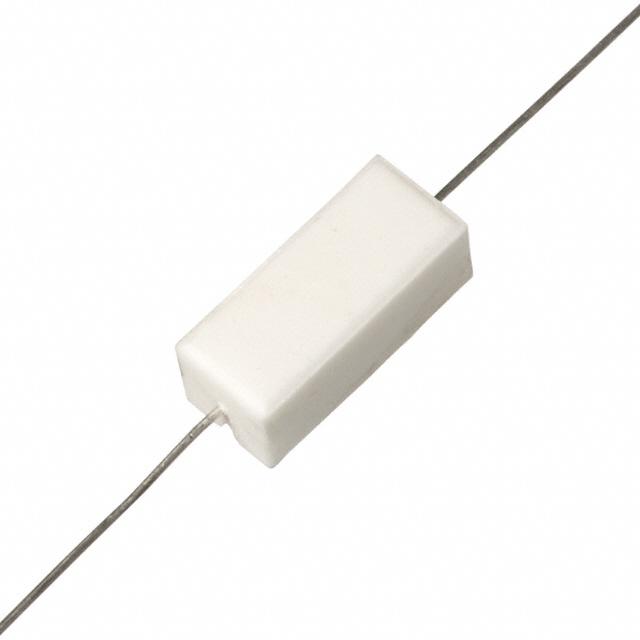

    820 mOhms ±5% 5W 轴向 通孔电阻器 耐燃,安全 绕线
CP0005R8200JB14 数据手册
CP www.vishay.com Vishay Dale Wirewound Resistors, Commercial Power, Axial Lead FEATURES • High performance for low cost • Meets or exceeds requirements of EIA Standard RS-344 • High power to size ratio • Ceramic cases are available with circuit board stand-offs (designated with a -3 model ending) • Special inorganic potting compound and ceramic case provide high thermal conductivity in a fireproof package • Material categorization: for definitions of compliance please see www.vishay.com/doc?99912 Available Available Available STANDARD ELECTRICAL SPECIFICATIONS POWER RATING P40 °C W RESISTANCE RANGE  TOLERANCE ±% WEIGHT (TYPICAL) g CP0002 2 0.1 to 1K 5, 10 2.0 CP0002...3 2 0.1 to 1K 5, 10 2.2 CP0003 3 0.1 to 2K 5, 10 3.4 CP0003...3 3 0.1 to 2K 5, 10 3.6 CP0005 5 0.1 to 2.4K 5, 10 4.8 CP0005...3 5 0.1 to 2.4K 5, 10 5.0 CP0007 7 0.1 to 7K 5, 10 6.8 CP0007...3 7 0.1 to 7K 5, 10 7.0 CP0010 10 0.1 to 11K 5, 10 9.5 GLOBAL MODEL CP0010...3 10 0.1 to 11K 5, 10 9.9 CP0015 15 0.1 to 11K 5, 10 16.8 CP0015...3 15 0.1 to 11K 5, 10 17.4 CP0020 20 0.1 to 16K 5, 10 22.8 CP0020...3 20 0.1 to 16K 5, 10 23.6 CP0022 22 0.1 to 16K 5, 10 24.5 CP0022...3 22 0.1 to 16K 5, 10 25.3 CP0025 25 0.1 to 16K 5, 10 37.0 TECHNICAL SPECIFICATIONS PARAMETER UNIT CHARACTERISTICS ppm/°C ± 300 1  and above; ± 600 below 1  Short Time Overload - 5 x rated power for 5 s Terminal Strength lb 10 minimum Operating Temperature Range °C -65 to +275 Dielectric Withstanding Voltage VAC 1000 V (P x R)1/2 Temperature Coefficient Maximum Working Voltage Note • Wirewound CP resistors can reliably function as a fuse and as a resistor. Such components involve compromise between fusing and resistive functions; therefore, each design should be tailored to the application to ensure optimum performance. Contact factory by using the e-mail address at the bottom of this page for design assistance Revision: 01-Oct-2020 Document Number: 30213 1 For technical questions, contact: ww2aresistors@vishay.com THIS DOCUMENT IS SUBJECT TO CHANGE WITHOUT NOTICE. THE PRODUCTS DESCRIBED HEREIN AND THIS DOCUMENT ARE SUBJECT TO SPECIFIC DISCLAIMERS, SET FORTH AT www.vishay.com/doc?91000 CP www.vishay.com Vishay Dale GLOBAL PART NUMBER INFORMATION Global Part Numbering Example: CP000515R00JE143 C P 0 0 0 5 1 5 R 0 0 J E 1 4 3 GLOBAL MODEL VALUE TOLERANCE PACKAGING SPECIAL (See Standard Electrical Specifications Global Model column for options) R = decimal K = thousand R1500 = 0.15  1K500 = 1500  J = ± 5.0 % K = ± 10.0 % E14 = lead (Pb)-free bulk pack E31 = lead (Pb)-free four layer bulk pack (Dash number) (Up to 3 digits) From 1 to 999 as applicable B14 = bulk pack B31 = four layer bulk pack Historical Part Numbering Example: CP-5-3 15  5 % B14 CP-5-3 15  5% B14 HISTORICAL MODEL RESISTANCE VALUE TOLERANCE CODE PACKAGING DIMENSIONS in inches [millimeters] CPxxxx CPxxxx...3 F typical A E F typical B A C D C 0.125 [3.18] typical E B DIMENSIONS in inches [millimeters] GLOBAL MODEL A (1) ± 0.031 [0.794] B ± 0.031 [0.794] C ± 0.031 [0.794] D ± 0.031 [0.794] E ± 0.002 [0.050] F ± 0.125 [3.175] CP0002 0.688 [17.46] 0.250 [6.35] 0.250 [6.35] - 0.032 [0.813] 1.500 [38.10] CP0002...3 0.688 [17.46] 0.250 [6.35] 0.250 [6.35] 0.313 [7.94] 0.032 [0.813] 1.500 [38.10] CP0003 0.875 [22.22] 0.313 [7.94] 0.313 [7.94] - 0.036 [0.914] 1.500 [38.10] CP0003...3 0.875 [22.22] 0.313 [7.94] 0.313 [7.94] 0.375 [9.52] 0.036 [0.914] 1.500 [38.10] CP0005 0.875 [22.22] 0.375 [9.52] 0.344 [8.73] - 0.036 [0.914] 1.500 [38.10] CP0005...3 0.875 [22.22] 0.375 [9.52] 0.344 [8.73] 0.406 [10.32] 0.036 [0.914] 1.500 [38.10] CP0007 1.391 [35.32] 0.375 [9.52] 0.344 [8.73] - 0.036 [0.914] 1.500 [38.10] CP0007...3 1.391 [35.32] 0.375 [9.52] 0.344 [8.73] 0.469 [11.91] 0.036 [0.914] 1.500 [38.10] CP0010 1.875 [47.62] 0.375 [9.52] 0.344 [8.73] - 0.036 [0.914] 1.500 [38.10] CP0010...3 1.875 [47.62] 0.375 [9.52] 0.344 [8.73] 0.469 [11.91] 0.036 [0.914] 1.500 [38.10] CP0015 1.875 [47.62] 0.500 [12.70] 0.500 [12.70] - 0.036 [0.914] 1.500 [38.10] 1.875 [47.62] 0.500 [12.70] 0.500 [12.70] 0.625 [15.87] 0.036 [0.914] 1.500 [38.10] CP0015...3 CP0020 (2) 2.500 [63.50] 0.500 [12.70] 0.500 [12.70] - 0.036 [0.914] 1.500 [38.10] CP0020...3 2.500 [63.50] 0.500 [12.70] 0.500 [12.70] 0.625 [15.87] 0.036 [0.914] 1.500 [38.10] CP0022 2.500 [63.50] 0.500 [12.70] 0.500 [12.70] - 0.036 [0.914] 1.500 [38.10] CP0022...3 2.500 [63.50] 0.500 [12.70] 0.500 [12.70] 0.625 [15.87] 0.036 [0.914] 1.500 [38.10] CP0025 2.500 [63.50] 0.625 [15.87] 0.625 [15.87] - 0.040 [1.016] 1.500 [38.10] Note (1) Potting compound may extend outside of ceramic case up to 0.060 [1.52] maximum per side Revision: 01-Oct-2020 Document Number: 30213 2 For technical questions, contact: ww2aresistors@vishay.com THIS DOCUMENT IS SUBJECT TO CHANGE WITHOUT NOTICE. THE PRODUCTS DESCRIBED HEREIN AND THIS DOCUMENT ARE SUBJECT TO SPECIFIC DISCLAIMERS, SET FORTH AT www.vishay.com/doc?91000 CP www.vishay.com Vishay Dale DERATING Element: copper-nickel alloy or nickel-chrome alloy, depending on resistance value Core: woven fiberglass Body: steatite ceramic case with inorganic potting compound End Caps: tin plated steel RATED POWER IN % MATERIAL SPECIFICATIONS 120 100 80 60 Terminals: tinned copper 40 Part Marking: Dale, model, wattage, value, tolerance, date code 20 0 -55 -25 25 75 40 125 175 275 225 AMBIENT TEMPERATURE IN °C PERFORMANCE TEST Thermal Shock CONDITIONS OF TEST TEST LIMITS (EIA-344) -55 °C to +275 °C, 5 cycles, 30 min dwell time ± (5.0 % + 0.05 ) R Short Time Overload 5 x rated power for 5 s ± (4.0 % + 0.05 ) R Dielectric Withstanding Voltage 1000 VRMS, for 1 min ± (2.0 % + 0.05 ) R Low Temperature Storage -65 °C, full rated working voltage for 45 min ± (3.0 % + 0.05 ) R Humidity 75 °C, 90 % to 100 % RH, 240 h ± (5.0 % + 0.05 ) R Load Life 1000 h at rated power, + 25 °C, 1.5 h “ON”, 0.5 h “OFF” ± (10.0 % + 0.05 ) R Terminal Strength 5 pounds for 30 s; body twisted about axis, 3 x 360° rotations ± (2.0 % + 0.05 ) R Resistance to Solder Heat Terminal immersed 3.5 s in molten solder at 1/8" to 3/16" from body ± (4.0 % + 0.05 ) R Revision: 01-Oct-2020 Document Number: 30213 3 For technical questions, contact: ww2aresistors@vishay.com THIS DOCUMENT IS SUBJECT TO CHANGE WITHOUT NOTICE. THE PRODUCTS DESCRIBED HEREIN AND THIS DOCUMENT ARE SUBJECT TO SPECIFIC DISCLAIMERS, SET FORTH AT www.vishay.com/doc?91000 Legal Disclaimer Notice www.vishay.com Vishay Disclaimer ALL PRODUCT, PRODUCT SPECIFICATIONS AND DATA ARE SUBJECT TO CHANGE WITHOUT NOTICE TO IMPROVE RELIABILITY, FUNCTION OR DESIGN OR OTHERWISE. Vishay Intertechnology, Inc., its affiliates, agents, and employees, and all persons acting on its or their behalf (collectively, “Vishay”), disclaim any and all liability for any errors, inaccuracies or incompleteness contained in any datasheet or in any other disclosure relating to any product. Vishay makes no warranty, representation or guarantee regarding the suitability of the products for any particular purpose or the continuing production of any product. To the maximum extent permitted by applicable law, Vishay disclaims (i) any and all liability arising out of the application or use of any product, (ii) any and all liability, including without limitation special, consequential or incidental damages, and (iii) any and all implied warranties, including warranties of fitness for particular purpose, non-infringement and merchantability. Statements regarding the suitability of products for certain types of applications are based on Vishay’s knowledge of typical requirements that are often placed on Vishay products in generic applications. Such statements are not binding statements about the suitability of products for a particular application. It is the customer’s responsibility to validate that a particular product with the properties described in the product specification is suitable for use in a particular application. Parameters provided in datasheets and / or specifications may vary in different applications and performance may vary over time. All operating parameters, including typical parameters, must be validated for each customer application by the customer’s technical experts. Product specifications do not expand or otherwise modify Vishay’s terms and conditions of purchase, including but not limited to the warranty expressed therein. Except as expressly indicated in writing, Vishay products are not designed for use in medical, life-saving, or life-sustaining applications or for any other application in which the failure of the Vishay product could result in personal injury or death. Customers using or selling Vishay products not expressly indicated for use in such applications do so at their own risk. Please contact authorized Vishay personnel to obtain written terms and conditions regarding products designed for such applications. No license, express or implied, by estoppel or otherwise, to any intellectual property rights is granted by this document or by any conduct of Vishay. Product names and markings noted herein may be trademarks of their respective owners. © 2021 VISHAY INTERTECHNOLOGY, INC. ALL RIGHTS RESERVED Revision: 01-Jan-2021 1 Document Number: 91000
