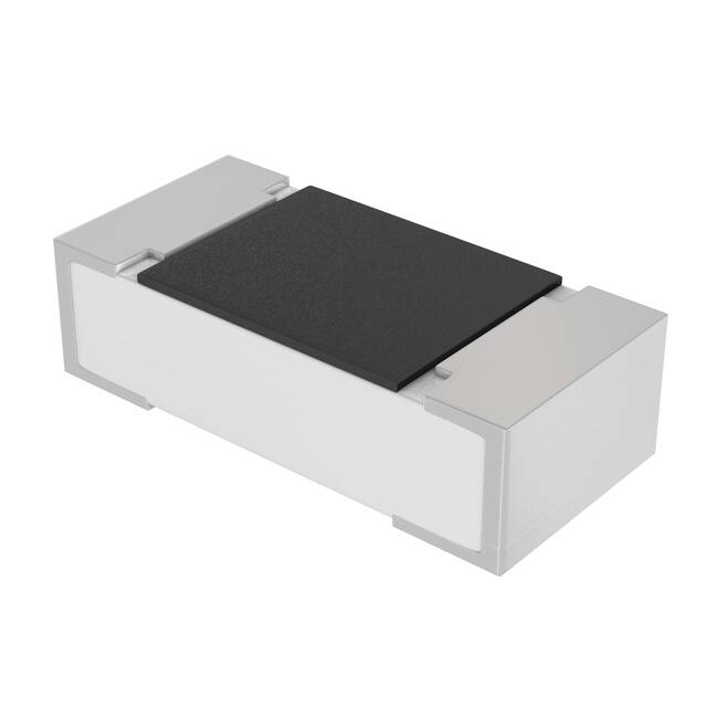

CRCW-HP e3 www.vishay.com Vishay Draloric Pulse Proof, High Power Thick Film Chip Resistors FEATURES • Excellent pulse load capability • Enhanced power rating • Double side printed resistor element • AEC-Q200 qualified • Material categorization: for definitions of compliance please see www.vishay.com/doc?99912 LINKS TO ADDITIONAL RESOURCES 3D 3D 3D Models The pulse proof, high power thick film chip resistors series is the perfect choice for most fields of power measurement electronics where reliability, stability, high power rating and excellent pulse load performance are of major concern. Typical applications include battery management systems in automotive appliances. APPLICATIONS • Automotive • Industrial • Commercial • High power TECHNICAL SPECIFICATIONS CRCW0402- CRCW0603- CRCW0805- CRCW1206- CRCW1210- CRCW1218- CRCW2010- CRCW2512HP e3 HP e3 HP e3 HP e3 HP e3 HP e3 HP e3 HP e3 Imperial size 0402 0603 0805 1206 1210 1218 2010 2512 RR3216M RR3225M RR3246M RR5025M RR6332M Metric size code RR1005M RR1608M RR2012M Resistance range 1 Ω to 1 MΩ; jumper (0 Ω) Resistance tolerance ± 5 %; ± 1 %; ± 0.5 % Temperature coefficient ± 200 ppm/K; ± 100 ppm/K Rated dissipation, P70 (1) 0.2 W (2) 0.33 W 0.5 W 0.75 W (3) 0.75 W 1.5 W 1.0 W 1.5 W Operating voltage, 50 V 75 V 150 V 200 V 200 V 200 V 400 V 500 V Umax. ACRMS/DC Permissible film 155 °C temperature, ϑF max. (1) Operating temperature -55 °C to +155 °C range Max. resistance change at P70 for resistance range, |ΔR/R| after: 1000 h ≤ 2.0 % 8000 h ≤ 4.0 % Permissible voltage against ambient (insulation): 1 min, Uins 75 V 100 V 200 V 300 V 300 V 300 V 300 V 300 V ≤ 0.1 x 10-9/h Failure rate: FIT observed DESCRIPTION Notes (1) Please refer to APPLICATION INFORMATION below (2) CRCW0402-HP resistors feature a single side printed resistive layer only, except jumpers (3) Specified power rating requires a thermal resistance of R ≤ 110 K/W th APPLICATION INFORMATION When the resistor dissipates power, a temperature rise above the ambient temperature occurs, dependent on the thermal resistance of the assembled resistor together with the printed circuit board. The rated dissipation applies only if the permitted film temperature is not exceeded. These resistors do not feature a limited lifetime when operated within the permissible limits. However, resistance value drift increasing over operating time may result in exceeding a limit acceptable to the specific application, thereby establishing a functional lifetime. Revision: 08-Sep-2021 Document Number: 20043 1 For technical questions, contact: thickfilmchip@vishay.com THIS DOCUMENT IS SUBJECT TO CHANGE WITHOUT NOTICE. THE PRODUCTS DESCRIBED HEREIN AND THIS DOCUMENT ARE SUBJECT TO SPECIFIC DISCLAIMERS, SET FORTH AT www.vishay.com/doc?91000 CRCW-HP e3 www.vishay.com Vishay Draloric TEMPERATURE COEFFICIENT AND RESISTANCE RANGE TYPE / SIZE CRCW0402-HP e3 TCR ± 200 ppm/K ± 100 ppm/K Jumper, Imax. = 3 A ± 200 ppm/K CRCW0603-HP e3 ± 100 ppm/K Jumper, Imax. = 5 A ± 200 ppm/K CRCW0805-HP e3 ± 100 ppm/K Jumper, Imax. = 6 A ± 200 ppm/K CRCW1206-HP e3 ± 100 ppm/K Jumper, Imax. = 10 A ± 200 ppm/K CRCW1210-HP e3 ± 100 ppm/K Jumper, Imax. = 12 A ± 200 ppm/K CRCW1218-HP e3 ± 100 ppm/K Jumper, Imax. = 20 A ± 200 ppm/K CRCW2010-HP e3 ± 100 ppm/K Jumper, Imax. = 12 A ± 200 ppm/K CRCW2512-HP e3 ± 100 ppm/K TOLERANCE ±5% ±1% ± 0.5 % ≤ 10 mΩ ±5% ±1% ± 0.5 % ≤ 8 mΩ ±5% ±1% ± 0.5 % ≤ 5 mΩ ±5% ±1% ± 0.5 % ≤ 5 mΩ ±5% ±1% ± 0.5 % ≤ 4 mΩ ±5% ±1% ± 0.5 % ≤ 4 mΩ ±5% ±1% ± 0.5 % ≤ 5 mΩ ±5% ±1% ± 0.5 % ≤ 5 mΩ Jumper, Imax. = 16 A Note • The temperature coefficient of resistance (TCR) is not specified for 0 Ω jumpers RESISTANCE 1 Ω to 1 MΩ E-SERIES E24 1 Ω to 1 MΩ E24; E96 0Ω 1 Ω to 1 MΩ E24 1 Ω to 1 MΩ E24; E96 0Ω 1 Ω to 1 MΩ E24 1 Ω to 1 MΩ E24; E96 0Ω 1 Ω to 1 MΩ E24 1 Ω to 1 MΩ E24; E96 0Ω 1 Ω to 1 MΩ E24 1 Ω to 1 MΩ E24; E96 0Ω 1 Ω to 1 MΩ E24 1 Ω to 1 MΩ E24; E96 0Ω 1 Ω to 1 MΩ E24 1 Ω to 1 MΩ E24; E96 0Ω 1 Ω to 1 MΩ E24 1 Ω to 1 MΩ E24; E96 0Ω - PACKAGING TYPE / SIZE CRCW0402-HP e3 CRCW0603-HP e3 CRCW0805-HP e3 CRCW1206-HP e3 CRCW1210-HP e3 CRCW1218-HP e3 CRCW2010-HP e3 CRCW2512-HP e3 Revision: 08-Sep-2021 CODE QUANTITY ED = ET7 EE = EF4 EI = ET2 ED = ET3 EL = ET4 EE = ET8 EA = ET1 EB = ET5 EC = ET6 EA = ET1 EB = ET5 EC = ET6 EA = ET1 EB = ET5 EC = ET6 EA = ET1 EB = ET5 EC = ET6 EK = ET9 EF = E02 EJ = E08 EG = E67 EH = E82 10 000 50 000 5000 10 000 20 000 20 000 5000 10 000 20 000 5000 10 000 20 000 5000 10 000 20 000 5000 10 000 20 000 4000 4000 16 000 2000 4000 PACKAGING STYLE WIDTH PITCH 2 mm 2 mm 4 mm Paper tape acc. to IEC 60286-3, type 1a 8 mm 4 mm 4 mm 4 mm Blister tape acc. to IEC 60286-3, type 2a 12 mm 4 mm 4 mm 4 mm 8 mm 4 mm PACKAGING DIMENSIONS Ø 180 mm / 7" Ø 330 mm / 13" Ø 180 mm / 7" Ø 180 mm / 7" Ø 285 mm / 11.25" Ø 330 mm / 13" Ø 180 mm / 7" Ø 285 mm / 11.25" Ø 330 mm / 13" Ø 180 mm / 7" Ø 285 mm / 11.25" Ø 330 mm / 13" Ø 180 mm / 7" Ø 285 mm / 11.25" Ø 330 mm / 13" Ø 180 mm / 7" Ø 285 mm / 11.25" Ø 330 mm / 13" Ø 180 mm / 7" Ø 180 mm / 7" Ø 330 mm / 13" Ø 180 mm / 7" Document Number: 20043 2 For technical questions, contact: thickfilmchip@vishay.com THIS DOCUMENT IS SUBJECT TO CHANGE WITHOUT NOTICE. THE PRODUCTS DESCRIBED HEREIN AND THIS DOCUMENT ARE SUBJECT TO SPECIFIC DISCLAIMERS, SET FORTH AT www.vishay.com/doc?91000 CRCW-HP e3 www.vishay.com Vishay Draloric PART NUMBER AND PRODUCT DESCRIPTION Part Number: CRCW0603562RFKEAHP Part Number: CRCW06030000Z0EAHP C R C TYPE / SIZE CRCW0402 CRCW0603 CRCW0805 CRCW1206 CRCW1210 CRCW1218 CRCW2010 CRCW2512 W 0 6 VALUE R = decimal K = thousand M = million 0000 = jumper 0 3 5 TOLERANCE D = ± 0.5 % F=±1% J=±5% Z = jumper 6 2 R F TCR K = ± 100 ppm/K N = ± 200 ppm/K 0 = jumper K E A PACKAGING EA EB EC ED EE EF EG EI EJ EH EK EL H P SPECIAL Up to 2 digits HP = pulse proof, high power Product Description: CRCW0603-HP 100 562R 1 % ET1 e3 Product Description: CRCW0603-HP 0R0 ET1 e3 CRCW0603-HP 100 562R 1% ET1 e3 TYPE / SIZE CRCW0402-HP CRCW0603-HP CRCW0805-HP CRCW1206-HP CRCW1210-HP CRCW1218-HP CRCW2010-HP CRCW2512-HP TCR ± 100 ppm/K ± 200 ppm/K RESISTANCE VALUE 10R = 10 Ω 562R = 562 Ω 10K = 10 kΩ 1M = 1 MΩ 0R0 = jumper TOLERANCE ± 0.5 % ±1% ±5% PACKAGING ET1, ET2, ET3, ET4, ET5, ET6, ET7, ET8, ET9, EF4, E02, E08, E67, E82 LEAD e3 = pure tin termination finish Revision: 08-Sep-2021 Document Number: 20043 3 For technical questions, contact: thickfilmchip@vishay.com THIS DOCUMENT IS SUBJECT TO CHANGE WITHOUT NOTICE. THE PRODUCTS DESCRIBED HEREIN AND THIS DOCUMENT ARE SUBJECT TO SPECIFIC DISCLAIMERS, SET FORTH AT www.vishay.com/doc?91000 CRCW-HP e3 www.vishay.com DESCRIPTION Production is strictly controlled and follows an extensive set of instructions established for reproducibility. A cermet film layer and a glass-over are deposited on both sides of a high grade (Al2O3) ceramic substrate with its prepared inner contacts on both sides. A special laser is used to achieve the target value by smoothly fine trimming the resistive layer without damaging the ceramics. The resistor elements are covered by a protective coating designed for electrical, mechanical and climatic protection. The terminations receive a final pure tin on nickel plating. The result of the determined production is verified by an extensive testing procedure on 100 % of the individual chip resistors. Only accepted products are laid directly into the tape in accordance with IEC 60286-3 Type 1a and Type 2a (1). ASSEMBLY The resistors are suitable for processing on automatic SMD assembly systems. They are suitable for automatic soldering wave, reflow or vapor phase as shown in IEC 61760-1 (1). The encapsulation is resistant to all cleaning solvents commonly used in the electronics industry, including alcohols, esters and aqueous solutions. The suitability of conformal coatings, potting compounds and their processes, if applied, shall be qualified by appropriate means to ensure the long-term stability of the whole system. The resistors are RoHS-compliant, the pure tin plating provides compatibility with lead (Pb)-free and lead-containing soldering processes. Solderability is specified for 2 years after production or requalification. The permitted storage time is 20 years. The immunity of the plating against tin whisker growth has been proven under extensive testing. MATERIALS Vishay acknowledges the following systems for the regulation of hazardous substances: • IEC 62474, Material Declaration for Products of and for the Electrotechnical Industry, with the list of declarable substances given therein (2) • The Global Automotive Declarable Substance List (GADSL) (3) • The REACH regulation (1907/2006/EC) and the related list of substances with very high concern (SVHC) (4) for its supply chain Vishay Draloric The products do not contain any of the banned substances as per IEC 62474, GADSL, or the SVHC list, see www.vishay.com/how/leadfree. Hence the products fully comply with the following directives: • 2000/53/EC End-of-Life Vehicle Directive (ELV) and Annex II (ELV II) • 2011/65/EU Restriction of the Use of Hazardous Substances Directive (RoHS) with amendment 2015/863/EU • 2012/19/EU Waste Electrical and Electronic Equipment Directive (WEEE) Vishay pursues the elimination of conflict minerals from its supply chain, see the Conflict Minerals Policy at www.vishay.com/doc?49037. APPROVALS The resistors are qualified according to AEC-Q200. Where applicable, the resistors are tested in accordance with EN 140401-802 which refers to EN 60115-1, EN 60115-8 and the variety of environmental test procedures of the IEC 60068 (1) series. RELATED PRODUCTS For more information about products with superior surge and pulse performance please refer to datasheet: D/CRCW-IF e3, Pulse Proof Thick Film Chip Resistors www.vishay.com/doc?20024. For thick film resistors with standard requirements for power rating, please refer to datasheet: D/CRCW e3, Standard Thick Film Chip www.vishay.com/doc?20035. For anti-surge products and high power rating, please refer to datasheet: RCS e3, Anti-Surge High Power Thick Film Chip Resistors www.vishay.com/doc?20065. Notes (1) The quoted IEC standards are also released as EN standards with the same number and identical contents (2) The IEC 62474 list of declarable substances is maintained in a dedicated database, which is available at http://std.iec.ch/iec62474 (3) The Global Automotive Declarable Substance List (GADSL) is maintained by the American Chemistry Council and available at www.gadsl.org (4) The SVHC list is maintained by the European Chemical Agency (ECHA) and available at http://echa.europa.eu/candidate-list-table Revision: 08-Sep-2021 Document Number: 20043 4 For technical questions, contact: thickfilmchip@vishay.com THIS DOCUMENT IS SUBJECT TO CHANGE WITHOUT NOTICE. THE PRODUCTS DESCRIBED HEREIN AND THIS DOCUMENT ARE SUBJECT TO SPECIFIC DISCLAIMERS, SET FORTH AT www.vishay.com/doc?91000 CRCW-HP e3 www.vishay.com Vishay Draloric FUNCTIONAL PERFORMANCE Single Pulse Axis Title CRCW2512-HP CRCW1218-HP CRCW2010-HP CRCW1210-HP CRCW1206-HP CRCW0805-HP CRCW0603-HP CRCW0402-HP 2nd line ^ Pmax. - Pulse Load (W) 1000 100 10000 1000 1st line 2nd line 10 000 10 100 1 0.1 0.01 0.000001 10 0.00001 0.0001 0.001 0.01 0.1 1 10 100 ti - Pulse Duration (s) Maximum pulse load, single pulse; applicable if P → 0 and n < 1000 and Û ≤ Ûmax.; for permissible resistance change equivalent to 8000 h operation Continuous Pulse Axis Title CRCW2512-HP CRCW1218-HP CRCW2010-HP CRCW1210-HP CRCW1206-HP CRCW0805-HP CRCW0603-HP CRCW0402-HP 2nd line ^ Pmax. - Pulse Load (W) 1000 100 10000 1000 1st line 2nd line 10 000 10 100 1 0.1 0.01 0.000001 10 0.00001 0.0001 0.001 0.01 0.1 1 10 100 ti - Pulse Duration (s) Maximum pulse load, continuous pulses; applicable if P ≤ P (ϑamb) and Û ≤ Ûmax.; for permissible resistance change equivalent to 8000 h operation Revision: 08-Sep-2021 Document Number: 20043 5 For technical questions, contact: thickfilmchip@vishay.com THIS DOCUMENT IS SUBJECT TO CHANGE WITHOUT NOTICE. THE PRODUCTS DESCRIBED HEREIN AND THIS DOCUMENT ARE SUBJECT TO SPECIFIC DISCLAIMERS, SET FORTH AT www.vishay.com/doc?91000 CRCW-HP e3 www.vishay.com Vishay Draloric Pulse Voltage Axis Title 2000 1800 10000 CRCW2512-HP CRCW2010-HP 1400 1000 1200 1st line 2nd line 2nd line ^ Umax. - Pulse Voltage (V) 1600 1000 800 CRCW1206-HP, CRCW1210-HP, CRCW1218-HP 600 CRCW0805-HP 400 CRCW0603-HP 100 200 CRCW0402-HP 10 0 0.000001 0.00001 0.0001 0.001 0.01 0.1 1 10 ti - Pulse Duration (s) Maximum pulse voltage, single and continuous pulses; applicable if Pˆ ≤ Pˆ max . ; for permissible resistance change equivalent to 8000 h operation Derating Axis Title 10000 1.8 CRCW1218-HP, CRCW2512-HP 1.4 1000 1.2 CRCW2010-HP 1st line 2nd line 2nd line P - Power Dissipation (W) 1.6 1.0 0.8 CRCW1206-HP, CRCW1210-HP 0.6 CRCW0805-HP 0.4 CRCW0603-HP 0.2 100 CRCW0402-HP 10 0 -70 -60 -50 -40 -30 -20 -10 0 10 20 30 40 50 60 70 80 90 100 110 120 130 140 150 160 ϑamb - Ambient Temperature (°C) Revision: 08-Sep-2021 Document Number: 20043 6 For technical questions, contact: thickfilmchip@vishay.com THIS DOCUMENT IS SUBJECT TO CHANGE WITHOUT NOTICE. THE PRODUCTS DESCRIBED HEREIN AND THIS DOCUMENT ARE SUBJECT TO SPECIFIC DISCLAIMERS, SET FORTH AT www.vishay.com/doc?91000 CRCW-HP e3 www.vishay.com Vishay Draloric TESTS AND REQUIREMENTS All executed tests are carried out in accordance with the following specifications: The testing also covers most of the requirements specified by EIA/IS-703 and JIS-C-5201-1. EN 60115-1, generic specification The tests are carried out under standard atmospheric conditions in accordance with IEC 60068-1, 4.3, whereupon the following values are applied: EN 60115-8 (successor specification of EN 140400), sectional EN 140401-802, detail specification Temperature: 15 °C to 35 °C IEC 60068-2-xx, test methods Relative humidity: 25 % to 75 % The parameters stated in the Test Procedures and Requirements table are based on the required tests and permitted limits of EN 140401-802. The table presents only the most important tests, for the full test schedule refer to the documents listed above. However, some additional tests and a number of improvements against those minimum requirements have been included. Air pressure: 86 kPa to 106 kPa (860 mbar to 1060 mbar). A climatic category LCT / UCT / 56 is applied, defined by the lower category temperature (LCT), the upper category temperature (UCT), and the duration of exposure in the damp heat, steady state test (56 days). The components are mounted for testing on boards in accordance with EN 60115-8, 2.4.2 unless otherwise specified. TEST PROCEDURES AND REQUIREMENTS IEC EN 60115-1 60068-2 (1) CLAUSE TEST METHOD TEST PROCEDURE Stability for product types: CRCW-HP e3 REQUIREMENTS PERMISSIBLE CHANGE (ΔR) STABILITY CLASS 2 OR BETTER 1 Ω to 1 MΩ 4.5 - Resistance - ± 0.5 %; ± 1 %; ± 5 % 4.8 - Temperature coefficient (20 / -55 / 20) °C and (20 / 155 / 20) °C ± 100 ppm/K; ± 200 ppm/K 4.25.1 - Endurance at 70 °C U = P 70 x R or U = Umax.; whichever is the less severe; 1.5 h on; 0.5 h off 70 °C; 1000 h ± (2 % R + 0.1 Ω) 70 °C; 8000 h ± (4 % R + 0.1 Ω) - Endurance at upper category temperature 155 °C, 1000 h ± (2 % R + 0.1 Ω) 4.24 78 (Cab) Damp heat, steady state (40 ± 2) °C; 56 days; (93 ± 3) % RH; ± (1 % R + 0.05 Ω) 4.37 67 (Cy) Damp heat, steady state, accelerated (85 ± 2) °C; (85 ± 5) % RH; U = 0.1 x P 85 x R ≤ 100 V; 1000 h ± (2 % R + 0.1 Ω) 4.25.3 - Climatic sequence: - 4.23.2 4.23 2 (Bb) dry heat 125 °C; 16 h 4.23.3 30 (Db) damp heat, cyclic 55 °C; 24 h; ≥ 90 % RH; 1 cycle 4.23.4 1 (Ab) cold -55 °C; 2 h 4.23.5 13 (M) low air pressure 8.5 kPa; 2 h; (25 ± 10) °C 4.23.6 30 (Db) damp heat, cyclic 55 °C; 24 h; ≥ 90 % RH; 5 cycles 4.23.7 - DC load 1 (Aa) Cold - Revision: 08-Sep-2021 U= ± (2 % R + 0.1 Ω) P 70 x R ≤ Umax.; 1 min -55 °C; 2 h ± (0.5 % R + 0.05 Ω) Document Number: 20043 7 For technical questions, contact: thickfilmchip@vishay.com THIS DOCUMENT IS SUBJECT TO CHANGE WITHOUT NOTICE. THE PRODUCTS DESCRIBED HEREIN AND THIS DOCUMENT ARE SUBJECT TO SPECIFIC DISCLAIMERS, SET FORTH AT www.vishay.com/doc?91000 CRCW-HP e3 www.vishay.com Vishay Draloric TEST PROCEDURES AND REQUIREMENTS IEC EN 60115-1 60068-2 (1) CLAUSE TEST METHOD TEST PROCEDURE Stability for product types: CRCW-HP e3 REQUIREMENTS PERMISSIBLE CHANGE (ΔR) STABILITY CLASS 2 OR BETTER 1 Ω to 1 MΩ 4.19 14 (Na) Rapid change of temperature 30 min at -55 °C and 30 min at 125 °C; 1000 cycles ± (1 % R + 0.05 Ω) no visible damage 4.13 - Short time overload U = 2.5 x P 70 x R ≤ 2 x Umax.; whichever is the less severe; 5s ± (2 % R + 0.05 Ω) - Single pulse high voltage overload Severity no. 4: U = 10 x P 70 x R or U = 2 x Umax.; whichever is the less severe; 10 pulses 10 μs/700 μs ± (1 % R + 0.05 Ω) no visible damage 4.39 - Periodic electric overload 15 x P 70 x R or U = 2 x Umax.; whichever is the less severe; 0.1 s on; 2.5 s off; 1000 cycles ± (1 % R + 0.05 Ω) no visible damage 4.38 - Electrostatic discharge (human body model) IEC 61340-3-1 (1); 3 pos. + 3 neg. discharges; ESD voltage acc. to the size ± (1 % R + 0.05 Ω) Vibration Endurance by sweeping; 10 Hz to 2000 Hz; no resonance; amplitude ≤ 1.5 mm or ≤ 200 m/s2; 7.5 h ± (0.5 % R + 0.05 Ω) no visible damage 4.27 U= 4.22 4.17 6 (Fc) 58 (Td) Solderability Solder bath method; Sn60Pb40 non-activated flux; (235 ± 5) °C; (2 ± 0.2) s Solder bath method; Sn96.5Ag3Cu0.5 non-activated flux; (245 ± 5) °C; (3 ± 0.3) s Good tinning (≥ 95 % covered) no visible damage 4.18 58 (Td) Resistance to soldering heat Solder bath method (260 ± 5) °C; (10 ± 1) s ± (0.5 % R + 0.05 Ω) 4.29 45 (XA) Component solvent resistance Isopropyl alcohol; +50 °C; method 2 No visible damage 4.32 21 (Uu3) Shear (adhesion) 4.33 21 (Uu1) Substrate bending Depth 2 mm; 3 times ± (0.25 % R + 0.05 Ω) no visible damage, no open circuit in bent position 4.7 - Voltage proof U = 1.4 x Uins; 60 s No flashover or breakdown Flammability, needle flame test IEC 60695-11-5 (1); 10 s No burning after 30 s 4.35 - CRCW0402-HP and CRCW0603-HP: 9 N CRCW0805-HP to CRCW2512-HP: 45 N No visible damage Note (1) The quoted IEC standards are also released as EN standards with the same number and identical contents Revision: 08-Sep-2021 Document Number: 20043 8 For technical questions, contact: thickfilmchip@vishay.com THIS DOCUMENT IS SUBJECT TO CHANGE WITHOUT NOTICE. THE PRODUCTS DESCRIBED HEREIN AND THIS DOCUMENT ARE SUBJECT TO SPECIFIC DISCLAIMERS, SET FORTH AT www.vishay.com/doc?91000 CRCW-HP e3 www.vishay.com Vishay Draloric DIMENSIONS DIMENSIONS AND MASS TYPE / SIZE L (mm) W (mm) H (mm) T1 (mm) T2 (mm) MASS (mg) CRCW0402-HP e3 1.0 ± 0.05 0.5 ± 0.05 0.3 ± 0.10 0.25 ± 0.10 0.2 ± 0.10 0.65 CRCW0603-HP e3 1.6 ± 0.10 0.85 ± 0.10 0.45 ± 0.10 0.3 ± 0.20 0.3 ± 0.20 2 CRCW0805-HP e3 2.0 ± 0.15 1.25 ± 0.15 0.5 ± 0.10 0.4 ± 0.20 0.35 ± 0.20 5.5 CRCW1206-HP e3 3.1 ± 0.20 1.6 ± 0.15 0.5 ± 0.15 0.5 ± 0.20 0.45 ± 0.20 10 CRCW1210-HP e3 3.2 ± 0.20 2.5 ± 0.20 0.6 ± 0.10 0.45 ± 0.20 0.4 ± 0.20 18 CRCW1218-HP e3 3.1 ± 0.20 4.6 ± 0.20 0.6 ± 0.10 0.45 ± 0.20 0.4 ± 0.20 31 CRCW2010-HP e3 5.0 ± 0.15 2.5 ± 0.15 0.6 ± 0.10 0.6 ± 0.20 0.6 ± 0.20 25.5 CRCW2512-HP e3 6.3 ± 0.20 3.15 ± 0.15 0.6 ± 0.10 0.6 ± 0.20 0.6 ± 0.20 42 SOLDER PAD DIMENSIONS X G Y Z RECOMMENDED SOLDER PAD DIMENSIONS WAVE SOLDERING TYPE / SIZE REFLOW SOLDERING G (mm) Y (mm) X (mm) Z (mm) G (mm) Y (mm) X (mm) Z (mm) CRCW0402-HP e3 - - - - 0.45 0.6 0.6 1.65 CRCW0603-HP e3 0.65 1.10 1.25 2.85 0.75 0.75 1.00 2.25 CRCW0805-HP e3 0.90 1.30 1.60 3.50 1.00 0.95 1.45 2.90 CRCW1206-HP e3 1.40 1.40 1.95 4.20 1.50 1.05 1.8 3.60 CRCW1210-HP e3 1.80 1.45 2.95 4.70 1.70 1.10 2.80 3.90 CRCW1218-HP e3 1.60 1.50 5.10 4.60 1.70 1.10 4.90 3.90 CRCW2010-HP e3 3.60 1.65 2.85 6.90 3.70 1.20 2.70 6.10 CRCW2512-HP e3 4.90 1.60 3.50 8.10 5.00 1.25 3.35 7.50 Notes • The given solder pad dimensions reflect the considerations for board design and assembly as outlined e.g in standards IEC 61188-5-x (1) or in publication IPC-7351. Still, the given solder pad dimensions will be found adequate for most general applications (1) The quoted IEC standards are also released as EN standards with the same number and identical contents Revision: 08-Sep-2021 Document Number: 20043 9 For technical questions, contact: thickfilmchip@vishay.com THIS DOCUMENT IS SUBJECT TO CHANGE WITHOUT NOTICE. THE PRODUCTS DESCRIBED HEREIN AND THIS DOCUMENT ARE SUBJECT TO SPECIFIC DISCLAIMERS, SET FORTH AT www.vishay.com/doc?91000 Legal Disclaimer Notice www.vishay.com Vishay Disclaimer ALL PRODUCT, PRODUCT SPECIFICATIONS AND DATA ARE SUBJECT TO CHANGE WITHOUT NOTICE TO IMPROVE RELIABILITY, FUNCTION OR DESIGN OR OTHERWISE. Vishay Intertechnology, Inc., its affiliates, agents, and employees, and all persons acting on its or their behalf (collectively, “Vishay”), disclaim any and all liability for any errors, inaccuracies or incompleteness contained in any datasheet or in any other disclosure relating to any product. Vishay makes no warranty, representation or guarantee regarding the suitability of the products for any particular purpose or the continuing production of any product. To the maximum extent permitted by applicable law, Vishay disclaims (i) any and all liability arising out of the application or use of any product, (ii) any and all liability, including without limitation special, consequential or incidental damages, and (iii) any and all implied warranties, including warranties of fitness for particular purpose, non-infringement and merchantability. Statements regarding the suitability of products for certain types of applications are based on Vishay's knowledge of typical requirements that are often placed on Vishay products in generic applications. Such statements are not binding statements about the suitability of products for a particular application. It is the customer's responsibility to validate that a particular product with the properties described in the product specification is suitable for use in a particular application. Parameters provided in datasheets and / or specifications may vary in different applications and performance may vary over time. All operating parameters, including typical parameters, must be validated for each customer application by the customer's technical experts. Product specifications do not expand or otherwise modify Vishay's terms and conditions of purchase, including but not limited to the warranty expressed therein. Hyperlinks included in this datasheet may direct users to third-party websites. These links are provided as a convenience and for informational purposes only. Inclusion of these hyperlinks does not constitute an endorsement or an approval by Vishay of any of the products, services or opinions of the corporation, organization or individual associated with the third-party website. Vishay disclaims any and all liability and bears no responsibility for the accuracy, legality or content of the third-party website or for that of subsequent links. Except as expressly indicated in writing, Vishay products are not designed for use in medical, life-saving, or life-sustaining applications or for any other application in which the failure of the Vishay product could result in personal injury or death. Customers using or selling Vishay products not expressly indicated for use in such applications do so at their own risk. Please contact authorized Vishay personnel to obtain written terms and conditions regarding products designed for such applications. No license, express or implied, by estoppel or otherwise, to any intellectual property rights is granted by this document or by any conduct of Vishay. Product names and markings noted herein may be trademarks of their respective owners. © 2021 VISHAY INTERTECHNOLOGY, INC. ALL RIGHTS RESERVED Revision: 09-Jul-2021 1 Document Number: 91000

物料型号: - 型号包括CRCW0402-HP e3、CRCW0603-HP e3、CRCW0805-HP e3、CRCW1206-HP e3、CRCW1210-HP e3、CRCW1218-HP e3、CRCW2010-HP e3和CRCW2512-HP e3。
器件简介: - 这些电阻器专为高可靠性、稳定性、高功率等级和出色的脉冲负载性能而设计,适用于汽车电子、工业和商业领域的电池管理系统等高功率测量电子领域。
引脚分配: - 文档中未明确提供引脚分配信息,但通常这类电阻器为表面贴装器件,具有两个端子用于连接。
参数特性: - 提供了不同尺寸的电阻,包括0402、0603、0805、1206、1210、1218、2010和2512。 - 电阻范围从1欧姆到1兆欧,包括跳线(0欧姆)。 - 电阻公差有±5%、±1%和±0.5%。 - 温度系数有±200 ppm/K和±100 ppm/K。 - 额定耗散功率和最大工作电压根据不同尺寸有所变化。
功能详解: - 电阻器具有优异的脉冲负载能力,增强的功率等级,并且符合RoHS标准,无卤素。 - 电阻元件双面印刷,通过了AEC-Q200认证。
应用信息: - 当电阻器耗散功率时,会根据组装电阻器与印刷电路板的热阻产生高于环境温度的温度升高。 - 这些电阻器在允许的极限范围内运行时没有有限的使用寿命。
封装信息: - 提供了不同尺寸的封装信息,包括宽度、间距和封装尺寸。
