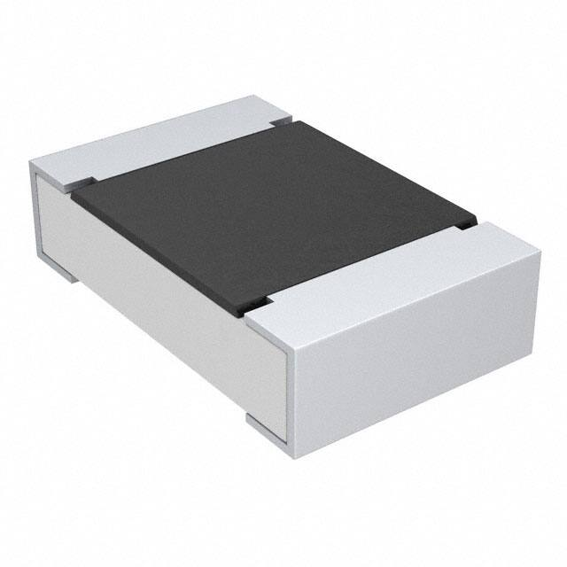

    贴片电阻 0805 560Ω ±1% 1/8W ±100ppm/℃
CRCW0805560RFKEA 数据手册
D/CRCW e3 Vishay Standard Thick Film Chip Resistors FEATURES  Stability R/R = 1 % for 1000 h at 70 ° C  2 mm pitch packaging option for 0603 size  Pure tin solder contacts on Ni barrier layer provides compatibility with lead (Pb)-free and lead containing soldering processes  Metal glaze on high quality ceramic  AEC-Q200 qualified  Material categorization: For definitions of compliance please see www.vishay.com/doc?99912 STANDARD ELECTRICAL SPECIFICATIONS SIZE MODEL D10/CRCW0402 INCH METRIC 0402 RR 1005M RATED DISSIPATION P70 °C W 0.063 LIMITING ELEMENT TEMPERATURE TOLERANCE RESISTANCE RANGE COEFFICIENT % VOLTAGE  ppm/K Umax. AC/DC 50 ± 100 ± 200 SERIES ±1 ±5 1R0 to 10M E24; E96 E24 ±1 ±5 1R0 to 10M E24; E96 E24 ±1 ±5 1R0 to 10M E24; E96 E24 ±1 ±5 1R0 to 10M E24; E96 E24 ±1 ±5 1R0 to 10M E24; E96 E24 ±1 ±5 1R0 to 2M2 E24; E96 E24 ±1 ±5 1R0 to 10M E24; E96 E24 ±1 ±5 1R0 to 10M E24; E96 E24 Zero-Ohm-Resistor: Rmax. = 20 m, Imax. at 70 °C = 1.5 A D11/CRCW0603 0603 RR 1608M 0.10 75 ± 100 ± 200 Zero-Ohm-Resistor: Rmax. = 20 m, Imax. at 70 °C = 2.0 A D12/CRCW0805 0805 RR 2012M 0.125 150 ± 100 ± 200 Zero-Ohm-Resistor: Rmax. = 20 m, Imax. at 70 °C = 2.5 A D25/CRCW1206 1206 RR 3216M 0.25 200 ± 100 ± 200 Zero-Ohm-Resistor: Rmax. = 20 m, Imax. at 70 °C = 3.5 A CRCW1210 1210 RR 3225M 0.5 200 ± 100 ± 200 Zero-Ohm-Resistor: Rmax. = 20 m, Imax. at 70 °C = 5.0 A CRCW1218 1218 RR 3246M 1.0 200 ± 100 ± 200 Zero-Ohm-Resistor: Rmax. = 20 m, Imax. at 70 °C = 7.0 A CRCW2010 2010 RR 5025M 0.75 400 ± 100 ± 200 Zero-Ohm-Resistor: Rmax. = 20 m, Imax. at 70 °C = 6.0 A CRCW2512 2512 RR 6332M 1.0 500 ± 100 ± 200 Zero-Ohm-Resistor: Rmax. = 20 m, Imax. at 70 °C = 7.0 A Notes  These resistors do not feature a limited lifetime when operated within the permissible limits. However, resistance value drift increasing over operating time may result in exceeding a limit acceptable to the specific application, thereby establishing a functional lifetime.  Marking: See data sheet “Surface Mount Resistor Marking” (document number 20020).  Power rating depends on the max. temperature at the solder point, the component placement density and the substrate material. www.vishay.com Document Number: 20035 For technical questions, contact: thickfilmchip@vishay.com Revision: 04-Jun-12 125 THIS DOCUMENT IS SUBJECT TO CHANGE WITHOUT NOTICE. THE PRODUCTS DESCRIBED HEREIN AND THIS DOCUMENT ARE SUBJECT TO SPECIFIC DISCLAIMERS, SET FORTH AT www.vishay.com/doc?91000 D/CRCW e3 Standard Thick Film Chip Resistors Vishay TECHNICAL SPECIFICATIONS D10/ D11/ D12/ D25/ UNIT CRCW0402 CRCW0603 CRCW0805 CRCW1206 CRCW1210 CRCW1218 CRCW2010 CRCW2512 PARAMETER Rated dissipation P70 (1) W 0.063 0.1 0.125 0.25 0.5 1.0 0.75 1.0 Limiting element voltage Umax. AC/DC V 50 75 150 200 200 200 400 500 Insulation voltage Uins (1 min) V > 75 > 100 > 200 > 300 > 300 > 300 > 300 > 300 Insulation resistance  > 109 Category temperature range °C - 55 to + 155 Failure rate h-1 < 0.1 x 10- 9 Weight mg 29.5 25.5 40.5 0.65 2 5.5 10 16 Note (1) The power dissipation on the resistor generates a temperature rise against the local ambient, depending on the heat flow support of the printed-circuit board (thermal resistance). The rated dissipation applies only if the permitted film temperature of 155 °C is not exceeded. PART NUMBER AND PRODUCT DESCRIPTION Part Number: CRCW0603562RFKEC C R C W 0 6 0 3 5 6 2 R F K E C MODEL VALUE TOLERANCE TCR PACKAGING SPECIAL CRCW0402 CRCW0603 CRCW0805 CRCW1206 CRCW1210 CRCW1218 CRCW2010 CRCW2512 R = Decimal K = Thousand M = Million 0000 = Jumper F = ± 1.0 % J = ± 5.0 % Z = Jumper K = ± 100 ppm/K N = ± 200 ppm/K 0 = Jumper EA, EB, EC, ED, EE, EF, EG, EH, EI, EL, EK Up to 2 digits Product Description: D11/CRCW0603 100 562R 1 % ET6 e3 D11/CRCW0603 100 562R 1% ET6 e3 MODEL TCR RESISTANCE VALUE TOLERANCE PACKAGING LEAD (Pb)-FREE D10/CRCW0402 D11/CRCW0603 D12/CRCW0805 D25/CRCW1206 CRCW1210 CRCW1218 CRCW2010 CRCW2512 ± 200 ppm/K ± 100 ppm/K 10R = 10  562R = 562  10K = 10 k 1M0 = 1 M 0R0 = Jumper ±5% ±1% ET1, ET2, ET3, ET4, ET5, ET6, ET7, ET8, ET9, EF4, E02, E67, E82 e3 = Pure tin termination finish Document Number: 20035 www.vishay.com For technical questions, contact: thickfilmchip@vishay.com 126 Revision: 04-Jun-12 THIS DOCUMENT IS SUBJECT TO CHANGE WITHOUT NOTICE. THE PRODUCTS DESCRIBED HEREIN AND THIS DOCUMENT ARE SUBJECT TO SPECIFIC DISCLAIMERS, SET FORTH AT www.vishay.com/doc?91000 D/CRCW e3 Standard Thick Film Chip Resistors Vishay PACKAGING MODEL CODE CRCW0402 CRCW0603 CRCW0805 CRCW1206 CRCW1210 QUANTITY ED = ET7 10 000 EE = EF4 50 000 WIDTH PITCH 8 mm 2 mm REEL DIAMETER 180 mm/7" 330 mm/13" EI = ET2 5000 ED = ET3 10 000 EL = ET4 20 000 EE = ET8 50 000 EA = ET1 5000 EB = ET5 10 000 EC = ET6 20 000 EA = ET1 5000 EB = ET5 10 000 EC = ET6 20 000 EA = ET1 5000 EB = ET5 10 000 EC = ET6 20 000 330 mm/13" EA = ET1 5000 180 mm/7" EB = ET5 10 000 EC = ET6 20 000 CRCW1218 EK = ET9 4000 CRCW2010 EF = E02 4000 EG = E67 2000 EH = E82 4000 CRCW2512 CARRIER TAPE 180 mm/7" 8 mm 180 mm/7" 2 mm 285 mm/11.25" 330 mm/13" 180 mm/7" 8 mm 4 mm 285 mm/11.25" Paper tape acc. to IEC 60068-3 Type I 330 mm/13" 180 mm/7" 8 mm 4 mm 285 mm/11.25" 330 mm/13" 180 mm/7" 8 mm 4 mm 285 mm/11.25" 8 mm 4 mm 285 mm/11.25" 12 mm 4 mm 180 mm/7" 12 mm 4 mm 180 mm/7" 330 mm/13" Blister tape acc. to IEC 60068-3 Type II 8 mm 12 mm 180 mm/7" 4 mm DIMENSIONS SIZE INCH METRIC SOLDER PAD DIMENSIONS in millimeters DIMENSIONS in millimeters L W T2 a b l 0402 1005 1.0 ± 0.05 0.5 ± 0.05 0.35 ± 0.05 0.25 ± 0.05 0.2 ± 0.1 0.4 0.6 0.5 0603 1608 1.55 + 0.10 - 0.05 0.85 ± 0.1 0.45 ± 0.05 0.3 ± 0.2 0.5 0.9 0805 2012 2.0 + 0.20 - 0.10 1.25 ± 0.15 0.45 ± 0.05 + 0.20 - 0.10 0.3 ± 0.2 0.7 1206 3216 3.2 + 0.10 - 0.20 1.6 ± 0.15 0.55 ± 0.05 0.45 ± 0.2 0.4 ± 0.2 1210 3225 3.2 ± 0.2 3.2 H T1 REFLOW SOLDERING 0.3 ± 0.2 0.3 WAVE SOLDERING a b l 1.0 0.9 0.9 1.0 1.3 1.2 0.9 1.3 1.3 0.9 1.7 2.0 1.1 1.7 2.3 2.5 ± 0.2 0.55 ± 0.05 0.45 ± 0.2 0.4 ± 0.2 0.9 2.5 2.0 1.1 2.5 2.2 + 0.10 - 0.20 4.6 ± 0.15 0.55 ± 0.05 0.45 ± 0.2 0.4 ± 0.2 1.05 4.9 1.9 1.25 4.8 1.9 1218 3246 2010 5025 5.0 ± 0.15 2.5 ± 0.15 0.6 ± 0.1 0.6 ± 0.2 0.6 ± 0.2 1.0 2.5 3.9 1.2 2.5 3.9 2512 6332 6.3 ± 0.2 3.15 ± 0.15 0.6 ± 0.1 0.6 ± 0.2 0.6 ± 0.2 1.0 3.2 5.2 1.2 3.2 5.2 www.vishay.com Document Number: 20035 For technical questions, contact: thickfilmchip@vishay.com Revision: 04-Jun-12 127 THIS DOCUMENT IS SUBJECT TO CHANGE WITHOUT NOTICE. THE PRODUCTS DESCRIBED HEREIN AND THIS DOCUMENT ARE SUBJECT TO SPECIFIC DISCLAIMERS, SET FORTH AT www.vishay.com/doc?91000 D/CRCW e3 Standard Thick Film Chip Resistors Vishay Pulse Load Pmax. (W) FUNCTIONAL PERFORMANCE Single Pulse 1000 2512 1218 2010 1210 1206 0805 0603 0402 100 10 1 0.1 0.01 10-6 10-5 10-4 10-3 10-2 10-1 1 10 100 Pulse Duration t i (s) Maximum pulse load, single pulse; applicable if P 0 and n < 1000 and Û ≤ Ûmax.; for permissible resistance change equivalent to 8000 h operation Continuous Pulse Load Pmax. (W) Continuous Pulse 1000 2512 1218 2010 1210 1206 0805 0603 0402 100 10 1 0.1 0.01 10-6 10-5 10-4 10-3 10-2 10-1 1 10 100 Pulse Duration t i (s) Pulse Voltage Û max. (V) Maximum pulse load, continuous pulses; applicable if P ≤ P (ϑamb) and Û ≤ Ûmax.; for permissible resistance change equivalent to 8000 h operation 2000 1800 2512 1600 1400 2010 1200 1000 800 1206/1210/1218 600 400 0805 0603 200 0402 0 -6 10- 5 10 10- 4 10- 3 10- 2 10- 1 1 10 Pulse Duration t i (s) Maximum pulse voltage, single and continuous pulses; applicable if P ≤ Pmax.; for permissible resistance change equivalent to 8000 h operation Document Number: 20035 www.vishay.com For technical questions, contact: thickfilmchip@vishay.com 128 Revision: 04-Jun-12 THIS DOCUMENT IS SUBJECT TO CHANGE WITHOUT NOTICE. THE PRODUCTS DESCRIBED HEREIN AND THIS DOCUMENT ARE SUBJECT TO SPECIFIC DISCLAIMERS, SET FORTH AT www.vishay.com/doc?91000 D/CRCW e3 Standard Thick Film Chip Resistors Vishay Fraction of Rated Dissipation P70 Derating 100 % 50 0 Attenuation of 3rd Harmonic A3 in dB - 50 0 50 100 °C 150 70 Ambient Temperature ϑamb 120 100 80 1206, 2010 0805 60 0603 0402 40 20 0 10 100 1K 10K 100K 1M 10M Current Noise A1 in µV/V Resistance Value R in Ω 100 2 040 3 0 6 0 5 080 6 120 0 201 10 1 0.1 0.01 100 1K 10K 100K 1M 10M Resistance Value R in Ω www.vishay.com Document Number: 20035 For technical questions, contact: thickfilmchip@vishay.com Revision: 04-Jun-12 129 THIS DOCUMENT IS SUBJECT TO CHANGE WITHOUT NOTICE. THE PRODUCTS DESCRIBED HEREIN AND THIS DOCUMENT ARE SUBJECT TO SPECIFIC DISCLAIMERS, SET FORTH AT www.vishay.com/doc?91000 D/CRCW e3 Standard Thick Film Chip Resistors Vishay TEST PROCEDURES AND REQUIREMENTS EN 60115-1 CLAUSE IEC 60068-2 TEST METHOD REQUIREMENTS PERMISSIBLE CHANGE (R) TEST SIZE 0402 to 2512 PROCEDURE STABILITY CLASS 2 OR BETTER STABILITY CLASS 1 OR BETTER Stability for product types: 1  to 10 M D/CRCW e3 4.5 - Resistance 4.7 - Voltage proof U = 1.4 x Uins; 60 s Short time overload U = 2.5 x P 70 x R  2 x Umax.; duration: Acc. to style 4.13 4.17.2 - 58 (Td) Solderability - 21 (Uu3) Shear (adhesion) RR 1608 and smaller: 9 N RR 2012 and larger: 45 N 4.33 21 (Uu1) Substrate bending Depth 2 mm; 3 times 14 (Na) Rapid change of temperature No visible damage No visible damage, no open circuit in bent position ± (0.25 % R + 0.05 ) 5 cycles ± (0.25 % R + 0.05 ) ± (0.5 % R + 0.05 ) ± (1 % R + 0.05 ) ± (1 % R + 0.05 ) ± (1 % R + 0.05 ) ± (2 % R + 0.1 ) Climatic sequence: 2 (Ba) Dry heat 125 °C; 16 h - 4.23.3 30 (Db) Damp heat, cyclic 4.23.4 1 (Aa) Cold - 55 °C; 2 h 4.23.5 13 (M) Low air pressure 1 kPa; (25 ± 10) °C; 1 h 4.23.6 30 (Db) Damp heat, cyclic 55 °C;  90 % RH; 24 h; 5 cycles 4.23.7 - DC load Endurance at 70 °C ± 200 ppm/K 1000 cycles - - ± 100 ppm/K 30 min. at - 55 °C; 30 min. at 125 °C 55 °C;  90 % RH; 24 h; 1 cycle 4.25.1 ±0.5 % R + 0.05) Good tinning ( 95 % covered) no visible damage 4.32 4.23.2 ±0.25 % R + 0.05) Solder bath method; Sn96.5Ag3Cu0.5 non-activated flux; (245 ± 5) C (3 ± 0.3) s (20/- 55/20) C and (20/125/20) C 4.23 No flashover or breakdown Good tinning ( 95 % covered) no visible damage Temperature coefficient 4.19 ±5% Solder bath method; Sn60Pb40 non activated flux; (235 ± 5) °C (2 ± 0.2) s - 4.8.4.2 ±1% U = P 70 x R U = P 70 x R  Umax.; 1.5 h on; 0.5 h off; 70 °C; 1000 h ± (1 % R + 0.05 ) ± (2 % R + 0.1 ) 70 °C; 8000 h ± (2 % R + 0.1 ) ± (4 % R + 0.1 ) Document Number: 20035 www.vishay.com For technical questions, contact: thickfilmchip@vishay.com 130 Revision: 04-Jun-12 THIS DOCUMENT IS SUBJECT TO CHANGE WITHOUT NOTICE. THE PRODUCTS DESCRIBED HEREIN AND THIS DOCUMENT ARE SUBJECT TO SPECIFIC DISCLAIMERS, SET FORTH AT www.vishay.com/doc?91000 D/CRCW e3 Standard Thick Film Chip Resistors Vishay TEST PROCEDURES AND REQUIREMENTS IEC EN 60068-2 60115-1 TEST CLAUSE METHOD REQUIREMENTS PERMISSIBLE CHANGE (R) TEST SIZE 0402 to 2512 PROCEDURE STABILITY CLASS 2 OR BETTER STABILITY CLASS 1 OR BETTER Stability for product types: 1  to 10 M D/CRCW e3 58 (Td) Resistance to soldering heat Solder bath method (260 ± 5) C; (10 ± 1) s 4.35 - Flamability, needle flame test IEC 60695-11-5; 10 s No burning after 30 s 4.24 78 (Cab) Damp heat, steady state (40 ± 2) °C; (93 ± 3) % RH; 56 days ± (1 % R + 0.05 ) 4.25.3 - Endurance at upper category temperature 155 °C, 1000 h 4.40 - Electrostatic discharge (human body model) IEC 61340-3-1; 3 pos. + 3 neg. discharges; ESD voltage acc. to size ± (1 % R + 0.05 ) 4.29 45 (XA) Component solvent resistance Isopropyl alcohol; 50 °C; method 2 No visible damage 4.30 45 (XA) Solvent resistance of marking Isopropyl alcohol; 50 °C; method 1, toothbrush Marking legible, no visible damage 4.22 6 (Fc) Vibration, endurance by sweeping f = 10 Hz to 2000 Hz; x, y, z  1.5 mm; A  200 m/s2; 10 sweeps per axis 4.37 - Periodic electric overload 4.27 - Single pulse high voltage overload, 10 µs/700 µs 4.18.2 ± (0.25 % R + 0.05 ) ± (1 % R + 0.05 ) ± (0.25 % R + 0.05 ) ± (0.5 % R + 0.05 ) ± (2 % R + 0.1 ) ± (0.5 % R + 0.05 ) U= 15 x P 70 x R  2 x Umax.; 0.1 s on; 2.5 s off; 1000 cycles Û = 10 x P 70 x R  2 x Umax.; 10 pulses ± (1 % R + 0.05 ) ± (1 % R + 0.05 ) All tests are carried out in accordance with the following specifications:  EN 60115-1, generic specification  EN 140400, sectional specification  EN 140401-802, detail specification  IEC 60068-2-x, environmental test procedures Packaging of components is done in paper or blister tapes according to IEC 60286-3. www.vishay.com Document Number: 20035 For technical questions, contact: thickfilmchip@vishay.com Revision: 04-Jun-12 131 THIS DOCUMENT IS SUBJECT TO CHANGE WITHOUT NOTICE. THE PRODUCTS DESCRIBED HEREIN AND THIS DOCUMENT ARE SUBJECT TO SPECIFIC DISCLAIMERS, SET FORTH AT www.vishay.com/doc?91000 Legal Disclaimer Notice www.vishay.com Vishay Disclaimer  ALL PRODUCT, PRODUCT SPECIFICATIONS AND DATA ARE SUBJECT TO CHANGE WITHOUT NOTICE TO IMPROVE RELIABILITY, FUNCTION OR DESIGN OR OTHERWISE. Vishay Intertechnology, Inc., its affiliates, agents, and employees, and all persons acting on its or their behalf (collectively, “Vishay”), disclaim any and all liability for any errors, inaccuracies or incompleteness contained in any datasheet or in any other disclosure relating to any product. Vishay makes no warranty, representation or guarantee regarding the suitability of the products for any particular purpose or the continuing production of any product. To the maximum extent permitted by applicable law, Vishay disclaims (i) any and all liability arising out of the application or use of any product, (ii) any and all liability, including without limitation special, consequential or incidental damages, and (iii) any and all implied warranties, including warranties of fitness for particular purpose, non-infringement and merchantability. Statements regarding the suitability of products for certain types of applications are based on Vishay’s knowledge of typical requirements that are often placed on Vishay products in generic applications. Such statements are not binding statements about the suitability of products for a particular application. It is the customer’s responsibility to validate that a particular product with the properties described in the product specification is suitable for use in a particular application. Parameters provided in datasheets and / or specifications may vary in different applications and performance may vary over time. All operating parameters, including typical parameters, must be validated for each customer application by the customer’s technical experts. Product specifications do not expand or otherwise modify Vishay’s terms and conditions of purchase, including but not limited to the warranty expressed therein. Except as expressly indicated in writing, Vishay products are not designed for use in medical, life-saving, or life-sustaining applications or for any other application in which the failure of the Vishay product could result in personal injury or death. Customers using or selling Vishay products not expressly indicated for use in such applications do so at their own risk. Please contact authorized Vishay personnel to obtain written terms and conditions regarding products designed for such applications. No license, express or implied, by estoppel or otherwise, to any intellectual property rights is granted by this document or by any conduct of Vishay. Product names and markings noted herein may be trademarks of their respective owners. © 2017 VISHAY INTERTECHNOLOGY, INC. ALL RIGHTS RESERVED Revision: 08-Feb-17 1 Document Number: 91000
