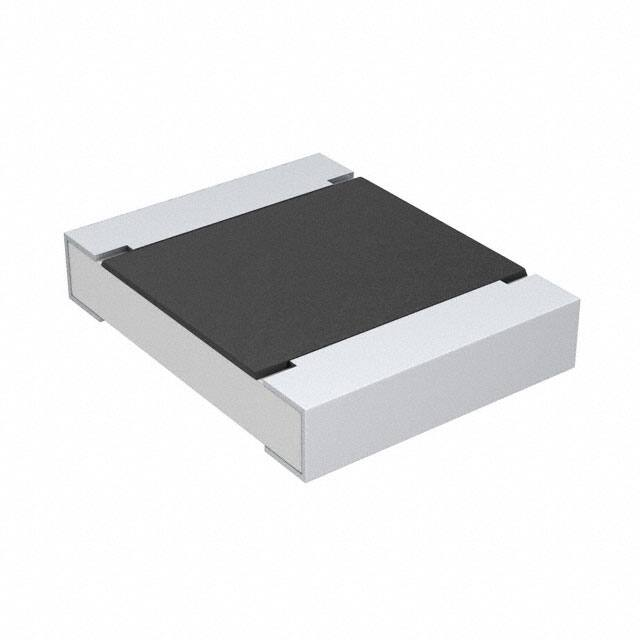

CRCW12100000ZSTB 数据手册
D/CRCW Vishay Lead (Pb)-Bearing Thick Film, Rectangular Chip Resistors FEATURES • Stability ΔR/R = 1 % for 1000 h at 70 °C • Lead (Pb)-bearing termination plating on Ni barrier layer • Metal glaze on high quality ceramic • Halogen-free according to IEC 61249-2-21 definiton • AEC-Q200 qualified, rev. C compliant STANDARD ELECTRICAL SPECIFICATIONS SIZE MODEL D10/CRCW0402 INCH METRIC 0402 RR 1005M RATED DISSIPATION P70 W 0.063 LIMITING RESISTANCE TEMPERATURE ELEMENT TOLERANCE RANGE COEFFICIENT VOLTAGE % Ω ppm/K Umax. AC/DC 50 ± 100 ± 200 SERIES ±1 ±5 1R0 to 10M E24; E96 E24 ±1 ±5 1R0 to 10M E24; E96 E24 ±1 ±5 1R0 to 10M E24; E96 E24 ±1 ±5 1R0 to 10M E24; E96 E24 ±1 ±5 1R0 to 10M E24; E96 E24 ±1 ±5 1R0 to 2M2 E24; E96 E24 ±1 ±5 1R0 to 10M E24; E96 E24 ±1 ±5 1R0 to 10M E24; E96 E24 Zero-Ohm-Resistor: Rmax. = 20 mΩ, Imax. = 1.5 A D11/CRCW0603 0603 RR 1608M 0.10 75 ± 100 ± 200 Zero-Ohm-Resistor: Rmax. = 20 mΩ, Imax. = 2.0 A D12/CRCW0805 0805 RR 2012M 0.125 150 ± 100 ± 200 Zero-Ohm-Resistor: Rmax. = 20 mΩ, Imax. = 2.5 A D25/CRCW1206 1206 RR 3216M 0.25 200 ± 100 ± 200 Zero-Ohm-Resistor: Rmax. = 20 mΩ, Imax. = 3.5 A CRCW1210 1210 RR 3225M 0.50 200 ± 100 ± 200 Zero-Ohm-Resistor: Rmax. = 20 mΩ, Imax. = 5.0 A CRCW1218 1218 RR 3246M 1.0 200 ± 100 ± 200 Zero-Ohm-Resistor: Rmax. = 20 mΩ, Imax. = 7.0 A CRCW2010 2010 RR 5025M 0.75 400 ± 100 ± 200 Zero-Ohm-Resistor: Rmax. = 20 mΩ, Imax. = 6.0 A CRCW2512 2512 RR 6332M 1.0 500 ± 100 ± 200 Zero-Ohm-Resistor: Rmax. = 20 mΩ, Imax. = 7.0 A Notes • These resistors do not feature a limited lifetime when operated within the permissible limits. However, resistance value drift increasing over operating time may result in exceeding a limit acceptable to the specific application, thereby establishing a functional lifetime. • Marking: See datasheet “Surface Mount Resistor Marking” (document number 20020). • Power rating depends on the max. temperature at the solder point, the component placement density and the substrate material. www.vishay.com 118 For technical questions, contact: thickfilmchip@vishay.com Document Number: 20008 Revision: 18-Nov-10 D/CRCW Lead (Pb)-Bearing Thick Film, Rectangular Chip Resistors Vishay TECHNICAL SPECIFICATIONS D10/ D11/ D12/ D25/ UNIT CRCW0402 CRCW0603 CRCW0805 CRCW1206 CRCW1210 CRCW1218 CRCW2010 CRCW2512 PARAMETER Rated dissipation at 70 °C (1) W 0.063 0.1 0.125 0.25 0.5 1.0 0.75 1.0 Limiting element voltage UMAX. AC/DC V 50 75 150 200 200 200 400 500 Insulation voltage UINS. (1 min) V > 75 > 100 > 200 > 300 > 300 > 300 > 300 > 300 Insulation resistance Ω > 109 Category temperature range °C - 55 to + 155 Failure rate h-1 < 0.1 x 10-9 Weight mg 29.5 25.5 40.5 0.65 2 5.5 10 16 Note (1) The power dissipation on the resistor generates a temperature rise against the local ambient, depending on the heat flow support of the printed-circuit board (thermal resistance). The rated dissipation applies only if the permitted film temperature of 155 °C is not exceeded. PART NUMBER AND PRODUCT DESCRIPTION Part Number: CRCW0805562RFKTA (2) C R C MODEL CRCW0402 CRCW0603 CRCW0805 CRCW1206 CRCW1210 CRCW1218 CRCW2010 CRCW2512 W 0 8 0 VALUE R = Decimal K = Thousand M = Million 0000 = Jumper 5 5 6 2 TOLERANCE F=±1% J=±5% Z = Jumper R F K TCR K = ± 100 ppm/K N = ± 200 ppm/K S = Jumper or special T A PACKAGING TA TB TC TD TE TF TG TH TK SPECIAL Up to 2 digits Product Description: CRCW0805 100 562R 1 % RT1 CRCW0805 MODEL CRCW0402 CRCW0603 CRCW0805 CRCW1206 CRCW1210 CRCW1218 CRCW2010 CRCW2512 100 562R 1% RT1 TCR RESISTANCE VALUE TOLERANCE PACKAGING ± 100 ppm/K ± 200 ppm/K 10R = 10 Ω 562R = 562 Ω 10K = 10.0 kΩ 1M = 1 MΩ 0R0 = Jumper ±1% ±5% RT1 RT5 RT6 RT7 RF4 R02 R67 R82 RT9 Note (2) Preferred way for ordering products is by use of the PART NUMBER. Document Number: 20008 Revision: 18-Nov-10 For technical questions, contact: thickfilmchip@vishay.com www.vishay.com 119 D/CRCW Lead (Pb)-Bearing Thick Film, Rectangular Chip Resistors Vishay PACKAGING MODEL PAPER TAPE ACC. IEC 60286-3, TYPE I UNIT BLISTER TAPE ACC. IEC 60286-3, TYPE II QUANTITY PART NUMBER PRODUCT DESC. QUANTITY PART NUMBER PRODUCT DESC. D10/CRCW0402 180 mm/7" 10 000 TD RT7 330 mm/13" 50 000 TE RF4 180 mm/7" 5000 TA RT1 10 000 TB RT5 330 mm/13" 20 000 TC RT6 180 mm/7" 5000 TA RT1 10 000 TB RT5 330 mm/13" 20 000 TC RT6 180 mm/7" 5000 TA RT1 RT5 D11/CRCW0603 285 mm/11.25" D12/CRCW0805 285 mm/11.25" D25/CRCW1206 285 mm/11.25" CRCW1210 10 000 TB 330 mm/13" 20 000 TC RT6 180 mm/7" 5000 TA RT1 285 mm/11.25" 10 000 TB RT5 330 mm/13" 20 000 TC RT6 CRCW1218 180 mm/7" 4000 CRCW2010 180 mm/7" CRCW2512 180 mm/7" TK RT9 4000 TF R02 2000 TG R67 4000 TH R82 DIMENSIONS SOLDER PAD DIMENSIONS in millimeters SIZE DIMENSIONS in millimeters REFLOW SOLDERING INCH METRIC L 0402 1005 1.0 ± 0.05 W H T1 T2 a b l WAVE SOLDERING a b l 0.5 ± 0.05 0.35 ± 0.05 0.25 ± 0.05 0.2 ± 0.1 0.4 0.6 0.5 0.85 ± 0.1 0.45 ± 0.05 0.3 ± 0.2 0.3 ± 0.2 0.5 0.9 1.0 0.9 0.9 1.0 0.3 0.3 ± 0.2 0.7 1.3 1.2 0.9 1.3 1.3 0603 1608 1.55 + 0.10 - 0.05 0805 2012 2.0 + 0.20 - 0.10 1.25 ± 0.15 0.45 ± 0.05 1206 3216 3.2 + 0.10 - 0.20 1.6 ± 0.15 0.55 ± 0.05 0.45 ± 0.2 0.4 ± 0.2 0.9 1.7 2.0 1.1 1.7 2.3 1210 3225 3.2 ± 0.2 2.5 ± 0.2 0.55 ± 0.05 0.45 ± 0.2 0.4 ± 0.2 0.9 2.5 2.0 1.1 2.5 2.2 1218 3246 3.2 4.6 ± 0.15 0.55 ± 0.05 0.45 ± 0.2 0.4 ± 0.2 1.05 4.9 1.9 1.25 4.8 1.9 2010 5025 5.0 ± 0.15 2.5 ± 0.15 0.6 ± 0.1 0.6 ± 0.2 0.6 ± 0.2 1.0 2.5 3.9 1.2 2.5 3.9 2512 6332 6.3 ± 0.2 3.15 ± 0.15 0.6 ± 0.1 0.6 ± 0.2 0.6 ± 0.2 1.0 3.2 5.2 1.2 3.2 5.2 www.vishay.com 120 + 0.10 - 0.20 + 0.20 - 0.10 For technical questions, contact: thickfilmchip@vishay.com Document Number: 20008 Revision: 18-Nov-10 D/CRCW Lead (Pb)-Bearing Thick Film, Rectangular Chip Resistors Vishay Pulse Load Pmax. (W) FUNCTIONAL PERFORMANCE Single Pulse 1000 2512 1218 2010 1210 1206 0805 0603 0402 100 10 1 0.1 0.01 10-6 10-5 10-4 10-3 10-2 10-1 1 10 100 Pulse Duration t i (s) Maximum pulse load, single pulse; applicable if P 0 and n < 1000 and Û ≤ Ûmax.; for permissible resistance change equivalent to 8000 h operation Continuous Pulse Load Pmax. (W) Continuous Pulse 1000 2512 1218 2010 1210 1206 0805 0603 0402 100 10 1 0.1 0.01 10-6 10-5 10-4 10-3 10-2 10-1 1 10 100 Pulse Duration t i (s) Maximum pulse load, continuous pulses; applicable if P ≤ P (ϑamb) and Û ≤ Ûmax.; for permissible resistance change equivalent to 8000 h operation Pulse Voltage Û max. (V) Pulse Voltage 2000 1800 2512 1600 1400 2010 1200 1000 800 1206/1210/1218 600 400 0805 0603 200 0402 0 -6 10- 5 10 10- 4 10- 3 10- 2 10- 1 1 10 Pulse Duration t i (s) Maximum pulse voltage, single and continuous pulses; applicable if P ≤ Pmax.; for permissible resistance change equivalent to 8000 h operation Document Number: 20008 Revision: 18-Nov-10 For technical questions, contact: thickfilmchip@vishay.com www.vishay.com 121 D/CRCW Vishay Lead (Pb)-Bearing Thick Film, Rectangular Chip Resistors Fraction of Rated Dissipation in % Derating 120 100 80 60 40 20 0 - 55 - 25 0 25 50 75 70 100 125 155 175 Ambient Temperature in °C Attenuation of 3rd Harmonic A3 in dB Non-Linearity 120 100 80 1206, 2010 0805 60 0603 0402 40 20 0 10 100 1K 10K 100K 1M 10M Resistance Value R in Ω Current Noise A1 in µV/V Current Noise 100 2 040 3 0 6 0 5 080 6 120 0 201 10 1 0.1 0.01 100 1K 10K 100K 1M 10M Resistance Value R in Ω www.vishay.com 122 For technical questions, contact: thickfilmchip@vishay.com Document Number: 20008 Revision: 18-Nov-10 D/CRCW Lead (Pb)-Bearing Thick Film, Rectangular Chip Resistors Vishay TEST PROCEDURES AND REQUIREMENTS EN 60115-1 CLAUSE PROCEDURE IEC 60082-2 TEST METHOD TEST Stability for product types: D/CRCW REQUIREMENTS PERMISSIBLE CHANGE (ΔR) STABILITY CLASS 1 OR BETTER STABILITY CLASS 2 OR BETTER 1 Ω to 10 MΩ 1 Ω to 10 MΩ ±1% ±5% 4.5 - Resistance - 4.7 - Voltage proof U = 1.4 · Uins; 60 s 4.13 - Short time overload U = 2.5 x P 70 x R ≤ 2 x Umax.; duration: Acc. to style ± (0.25 % R + 0.05 Ω) 4.17.2 58 (Td) Solderability Solder bath method; Sn60Pb40; non-activated flux; (235 ± 5) °C, (2 ± 0.2) s Good tinning (≥ 95 % covered); no visible damage 4.8.4.2 - Temperature coefficient (20/- 55/20) °C and (20/125/20) °C ± 100 ppm/K 4.32 21 (Uu3) Shear (adhesion) RR 1608 and smaller: 9 N RR 2012 and larger: 45 N No visible damage 4.33 21 (Uu1) Substrate bending Depth 2 mm; 3 times No visible damage, no open circuit in bent position ± (0.25 % R + 0.05 Ω) ± (0.5 % R + 0.05 Ω) ± 200 ppm/K 30 min. at - 55 °C; 30 min. at 125°C 4.19 14 (Na) Rapid change of temperature 4.23 - Climatic sequence: 2 (Ba) Dry heat 125 °C; 16 h 4.23.2 No flashover or breakdown 5 cycles 1000 cycles ± (0.25 % R + 0.05 Ω) ± (1 % R + 0.05 Ω) ± (0.5 % R + 0.05 Ω) ± (1 % R + 0.05 Ω) ± (1 % R + 0.05 Ω) ± (2 % R + 0.1 Ω) - 4.23.3 30 (Db) Damp heat, cyclic 55 °C; ≥ 90 % RH; 24 h; 1 cycle 4.23.4 1 (Aa) Cold - 55 °C; 2 h 4.23.5 13 (M) Low air pressure 1 kPa; (25 ± 10) °C; 1 h 4.23.6 30 (Db) Damp heat, cyclic 55 °C; ≥ 90 % RH; 24 h; 5 cycles 4.23.7 - DC load U = P 70 x R ± (1 % R + 0.05 Ω) ± (2 % R + 0.1 Ω) ± (2 % R + 0.1 Ω) ± (4 % R + 0.1 Ω) ± (0.25 % R + 0.05 Ω) ± (0.5 % R + 0.05 Ω) 4.25.1 - Endurance at 70 °C U = √(P70 x R) ≤ Umax. 1.5 h on; 0.5 h off; 70 °C; 1000 h 70 °C; 8000 h 4.18.2 58 (Td) Resistance to soldering heat Solder bath method (260 ± 5) °C; (10 ± 1) s 4.35 - Flamability, needle flame test IEC 60695-11-5; 10 s No burning after 30 s 4.24 78 (Cab) Damp heat, steady state (40 ± 2) °C; (93 ± 3) % RH; 56 days ± (1 % R + 0.05 Ω) 4.25.3 - Endurance at upper category temperature 155 °C; 1000 h 4.40 - Electrostatic discharge (human body model) IEC 61340-3-1; 3 pos. + 3 neg. discharges; ESD test voltage acc. to size ± (1 % R + 0.05 Ω) 4.29 45 (XA) Component solvent resistance Isopropyl alcohol; 50 °C; method 2 No visible damage 4.30 45 (XA) Solvent resistance of marking Isopropyl alcohol; 50 °C; method 1, toothbrush Marking legible, no visible damage Document Number: 20008 Revision: 18-Nov-10 ± (1 % R + 0.05 Ω) For technical questions, contact: thickfilmchip@vishay.com ± (2 % R + 0.1 Ω) www.vishay.com 123 D/CRCW Lead (Pb)-Bearing Thick Film, Rectangular Chip Resistors Vishay TEST PROCEDURES AND REQUIREMENTS EN 60115-1 CLAUSE IEC 60082-2 TEST METHOD PROCEDURE TEST REQUIREMENTS PERMISSIBLE CHANGE (ΔR) STABILITY CLASS 1 OR BETTER STABILITY CLASS 2 OR BETTER 1 Ω to 10 MΩ 1 Ω to 10 MΩ ± (0.25 % R + 0.05 Ω) ± (0.5 % R + 0.05 Ω) Stability for product types: D/CRCW 4.22 6 (Fc) Vibration, endurance by sweeping 4.37 - Periodic electric overload 4.27 - Single pulse high voltage overload, 10 µs/700 µs f = 10 Hz to 2000 Hz; x, y, z ≤ 1.5 mm; A ≤ 200 m/s2; 10 sweeps per axis U= 15 x P 70 x R ≤ 2 x Umax.; 0.1 s on; 2.5 s off; 1000 cycles ± (1 % R + 0.05 Ω) P 70 x R ≤ 2 x Umax.; 10 pulses ± (1 % R + 0,05 Ω) Û = 10 x All tests are carried out in accordance with the following specifications: • EN 60115-1, generic specification • EN 140400, sectional specification • EN 140401-802, detail specification • IEC 60068-2, environmental test procedures Packaging of components is done in paper or blister tapes according to IEC 60286-3. www.vishay.com 124 For technical questions, contact: thickfilmchip@vishay.com Document Number: 20008 Revision: 18-Nov-10 Legal Disclaimer Notice www.vishay.com Vishay Disclaimer ALL PRODUCT, PRODUCT SPECIFICATIONS AND DATA ARE SUBJECT TO CHANGE WITHOUT NOTICE TO IMPROVE RELIABILITY, FUNCTION OR DESIGN OR OTHERWISE. Vishay Intertechnology, Inc., its affiliates, agents, and employees, and all persons acting on its or their behalf (collectively, “Vishay”), disclaim any and all liability for any errors, inaccuracies or incompleteness contained in any datasheet or in any other disclosure relating to any product. Vishay makes no warranty, representation or guarantee regarding the suitability of the products for any particular purpose or the continuing production of any product. To the maximum extent permitted by applicable law, Vishay disclaims (i) any and all liability arising out of the application or use of any product, (ii) any and all liability, including without limitation special, consequential or incidental damages, and (iii) any and all implied warranties, including warranties of fitness for particular purpose, non-infringement and merchantability. Statements regarding the suitability of products for certain types of applications are based on Vishay’s knowledge of typical requirements that are often placed on Vishay products in generic applications. Such statements are not binding statements about the suitability of products for a particular application. It is the customer’s responsibility to validate that a particular product with the properties described in the product specification is suitable for use in a particular application. Parameters provided in datasheets and / or specifications may vary in different applications and performance may vary over time. All operating parameters, including typical parameters, must be validated for each customer application by the customer’s technical experts. Product specifications do not expand or otherwise modify Vishay’s terms and conditions of purchase, including but not limited to the warranty expressed therein. Except as expressly indicated in writing, Vishay products are not designed for use in medical, life-saving, or life-sustaining applications or for any other application in which the failure of the Vishay product could result in personal injury or death. Customers using or selling Vishay products not expressly indicated for use in such applications do so at their own risk. Please contact authorized Vishay personnel to obtain written terms and conditions regarding products designed for such applications. No license, express or implied, by estoppel or otherwise, to any intellectual property rights is granted by this document or by any conduct of Vishay. Product names and markings noted herein may be trademarks of their respective owners. © 2021 VISHAY INTERTECHNOLOGY, INC. ALL RIGHTS RESERVED Revision: 01-Jan-2021 1 Document Number: 91000
CRCW12100000ZSTB
物料型号:D/CRCW系列,包括0402、0603、0805、1206、1210、1218、2010和2512等尺寸。
器件简介:这些电阻器具有含铅终止电镀、金属釉面、高质量陶瓷基板,符合AEC-Q200标准,并且是无卤素产品。
引脚分配:文档中没有明确提到引脚分配,但通常这类电阻器是无引脚的表面贴装元件。
参数特性:包括额定耗散功率、限制元件电压、温度系数、电阻范围和公差等。
功能详解:文档提供了电阻器的稳定性、功率评级、标记方法、尺寸和回流焊接等信息。
应用信息:适用于需要稳定性和可靠性的应用场合。
封装信息:提供了不同尺寸的电阻器的封装信息,包括尺寸、重量和包装方式。
