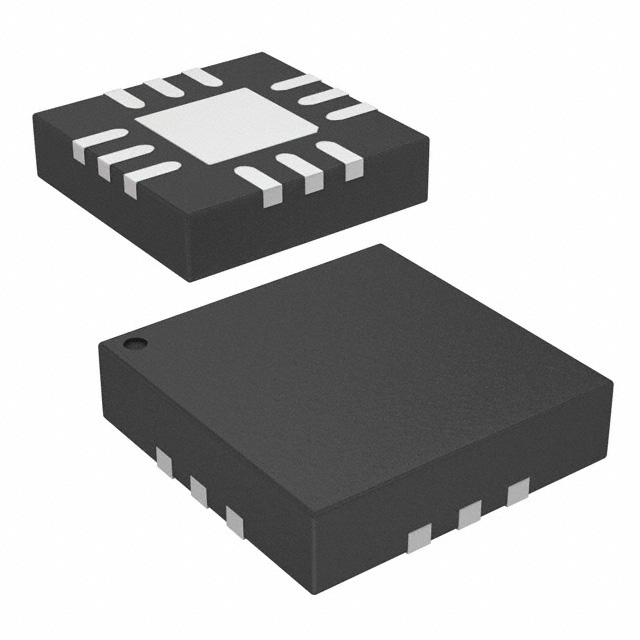

    1.8 V至5.5 V供电,2.5 Ω,四通道(4 1)多路复用器
DG2034EDN-T1-GE4 数据手册
DG2034E www.vishay.com Vishay Siliconix Power Down Fault Protected, 1.8 V to 5.5 V, 2.5 , 4-Channel (4:1) Multiplexer DESCRIPTION FEATURES The DG2034E is a four-channel multiplexer that operates with a single 1.8 V to 5.5 V power supply. It features power down fault protection that prevents excessive current flow when V+ is to ground. • 2.5  switch on-resistance The device’s low power dissipation and wide voltage range make it ideal for use in battery powered products. The ultra low capacitance and charge injection of the switch make it an ideal solution for data acquisition and sample and hold applications, where low glitch and fast settling are required. Low switch resistance and fast switching speeds, together with high signal bandwidth, make the DG2034E suitable for video signal switching. • 7 pF source-off capacitance • 27 pF comm-off capacitance • 33 pF comm-on capacitance • 13 ns turn-on time • -2 pC charge injection • -67 dB off-isolation at 1 MHz • -71 dB crosstalk at 1 MHz • 166 MHz bandwidth • 8 kV ESD / HBM The DG2034E switches one of four inputs to a common output as determined by the 3-bit binary address lines: A0, A1, and EN. Each switch conducts equally well in both directions when on, blocks input voltages up to the supply level when off, and exhibits break before make switching action. • 400 mA latch-up current The device’s high ESD and latch-up current capability make it more reliable in designs where the part sits close to the interface. • Wide operation voltage range The DG2034E is available in MSOP10 and QFN12 3 mm x 3 mm packages. APPLICATIONS BENEFITS • Power down fault protection • Low parasitic and charge injection • High ESD tolerance • Automatic test equipment • Process control and automation • Data acquisition systems • Meters and instruments • Medical and healthcare systems • Communication systems • Audio and video switching • Relay replacements   FUNCTIONAL BLOCK DIAGRAM AND PIN CONFIGURATION 12-Pin QFN (3 mm x 3 mm) A0 NC A1 12 11 10 MSOP-10 Logic S1 1 9 S2 GND 2 8 COM S3 3 7 S4 4 5 6 EN NC V+ 10 A1 2 9 S2 GND 3 8 COM S3 4 7 S4 EN 5 6 V+ A0 1 S1 Logic Top View Top View S17-0388-Rev. A, 20-Mar-17 Document Number: 73172 1 For technical questions, contact: powerictechsupport@vishay.com THIS DOCUMENT IS SUBJECT TO CHANGE WITHOUT NOTICE. THE PRODUCTS DESCRIBED HEREIN AND THIS DOCUMENT ARE SUBJECT TO SPECIFIC DISCLAIMERS, SET FORTH AT www.vishay.com/doc?91000 DG2034E www.vishay.com Vishay Siliconix TRUTH TABLE ORDERING INFORMATION A1 A0 EN ON SWITCH X X 0 None 0 0 1 S1 0 1 1 S2 1 0 1 S3 1 1 1 S4 TEMP. RANGE -40 °C to +85 °C PACKAGE PART NUMBER MSOP-10 DG2034EDQ-T1-GE3 12-pin QFN (3 mm x 3 mm) DG2034EDN-T1-GE4 ABSOLUTE MAXIMUM RATINGS PARAMETER LIMIT Referenced V+ to GND -0.3 to +6 AX, EN, SX, COM a -0.3 to (V+ + 0.3) Continuous current (any terminal) ± 50 Peak current (pulsed at 1 ms, 10 % duty cycle) ± 100 Power dissipation (package) b QFN-12 (3 mm x 3 mm) c 1295 MSOP-10 d 320 Storage temperature (D suffix) -65 to +150 ESD / HBM EIA / JESD22-A114-A 8k ESD / CDM EIA / JESD22-C101-A 2k JESD78 400 Latch up UNIT V mA mW °C V mA Notes a. Signals on SX, COM, EN or AX exceeding V+ or V- will be clamped by internal diodes. Limit forward diode current to maximum current ratings b. All leads welded or soldered to PC board c. Derate 16.2 mV/°C above 70 °C d. Derate 4 mV/°C above 70 °C S17-0388-Rev. A, 20-Mar-17 Document Number: 73172 2 For technical questions, contact: powerictechsupport@vishay.com THIS DOCUMENT IS SUBJECT TO CHANGE WITHOUT NOTICE. THE PRODUCTS DESCRIBED HEREIN AND THIS DOCUMENT ARE SUBJECT TO SPECIFIC DISCLAIMERS, SET FORTH AT www.vishay.com/doc?91000 DG2034E www.vishay.com Vishay Siliconix SPECIFICATIONS (V+ = 3 V) PARAMETER SYMBOL Analog Switch Analog signal range d TEST CONDITIONS OTHERWISE UNLESS SPECIFIED V+ = 3 V, ± 10 %, VAL = 0.5 V, VAH = 1.5 V e VANALOG V+ = 1.8 V, VS = 0.4 V / V+, IS = 8 mA Drain-source On-resistance RDS(on) V+ = 2.7 V, VCOM = 0.8 V / 1.8 V ICOM = 10 mA RDS(on) On-resistance matching On-resistance flatness d, f Off leakage current g COM off leakage current Rflat(on) IS(off) g Channel-on leakage current g Digital Control Input current d Input high voltage d Input low voltage d Digital input capacitance d Dynamic Characteristics ICOM(off) ICOM(on) IA or IEN VAH or VENH VAL or VENL CIN Turn-on time tON Turn-off time tOFF Break-before-make time d tBBM Transition time ttrans Charge injection d Bandwidth d QINJ BW Off-isolation d OIRR Channel-to-channel crosstalk d XTALK V+ = 2.7 V, VCOM = 0.8 V / 1.4 V / 1.8 V ICOM = 10 mA V+ = 3.3 V, VS = 1 V / 3 V VCOM = 3 V / 1 V, VEN = 0 V V+ = 3.3 V VCOM = VS = 1 V / 3 V VA/EN = 0 V or V+, see truth table VS = 1.5 V, CL = 35 pF, RL = 300  VS = 1.5 V / 0 V, VS = 0 V / 1.5 V, RL = 300  CL = 1 nF, Vgen = 1.5 V, Rgen = 0  CL = 5 pF (set up capacitance) f = 1 MHz RL = 50 , CL = 5 pF f = 10 MHz f = 1 MHz RL = 50 , CL = 5 pF f = 10 MHz LIMITS -40 to +85 °C TEMP. a MIN. c UNIT TYP. b MAX. c Full Room Full Room Full Room Full Room Full Room Full Room Full Room Full 0 -2 -5 -2 -5 -2 -5 7 4.6 0.02 0.62 0.01 0.01 0.01 - V+ 10 11 5.3 5.9 0.27 0.41 1 1.3 2 5 2 5 2 5 Full Full Full Room -1 1.5 - 0.05 1.25 1 3 1 0.5 - Room Full Room Full Room Full Room Full Room Room Room Room Room Room Room Room Room 7 5 - 19 16 12 26 -2 166 -67 -52 -71 -55 7 27 33 29 39 26 36 41 51 - V  nA μA V pF ns pC MHz dB Off capacitance d CS(off) COM off capacitance d CCOM(off) V+ = 2.7 V, f = 1 MHz pF COM on capacitance d CCOM(on) Power Supply Power supply range V+ Full 2.7 3.3 V Power supply current d I+ V+ = 2.7 V, VA/EN = 0 V or 2.7 V, see truth table Full 1 μA Notes a. Room = 25 °C, Full = as determined by the operating suffix b. Typical values are for design aid only, not guaranteed nor subject to production testing c. The algebraic convention whereby the most negative value is a minimum and the most positive a maximum, is used in this datasheet d. Guarantee by design, not subjected to production test e. VA, EN = input voltage to perform proper function f. Difference of min. and max. values g. Guaranteed by 5 V testing S17-0388-Rev. A, 20-Mar-17 Document Number: 73172 3 For technical questions, contact: powerictechsupport@vishay.com THIS DOCUMENT IS SUBJECT TO CHANGE WITHOUT NOTICE. THE PRODUCTS DESCRIBED HEREIN AND THIS DOCUMENT ARE SUBJECT TO SPECIFIC DISCLAIMERS, SET FORTH AT www.vishay.com/doc?91000 DG2034E www.vishay.com Vishay Siliconix SPECIFICATIONS (V+ = 5 V) PARAMETER Analog Switch Analog signal range d Drain-source On-resistance On-resistance matching On-resistance flatness d, f Off leakage current g SYMBOL TEST CONDITIONS OTHERWISE UNLESS SPECIFIED V+ = 5 V, ± 10 %, VAL = 0.5 V, VAH = 2 V e VANALOG RDS(on) RDS(on) Rflat(on) IS(off) V+ = 4.5 V, VCOM = 0.8 V / 3.5 V ICOM = 10 mA V+ = 4.5 V, VCOM = 0.8 V / 2.5 V / 3.5 V ICOM = 10 mA V+ = 5.5 V, VS = 1 V / 4.5 V VCOM = 4.5 V / 1 V, VEN = 0 V COM off leakage current g ICOM(off) Channel-on leakage current g ICOM(on) V+ = 5.5 V, VCOM = VS = 1 V / 4.5 V IPD V+ = 0 V, VD = 5.5 V, SX open V+ = 0 V, VS = 5.5 V, COM, open Power down leakage d Digital Control Input current d Input high voltage d Input low voltage d Digital input capacitance d Dynamic Characteristics IA or IEN VAH or VENH VAL or VENL CIN Turn-on time tON Turn-off time tOFF Break-before-make time d tBBM Transition time ttrans Propagation delay d Charge injection d Bandwidth d tPD QINJ BW Off-isolation d OIRR Channel-to-channel crosstalk d XTALK VA/EN = 0 V or V+, see truth table VS = 3 V, CL = 35 pF, RL = 300  VS = 3 V / 0 V, VS = 0 V / 3 V, RL = 300  V+ = 5 V, no RLOAD CL = 1 nF, Vgen = 2.5 V, Rgen = 0  CL = 5 pF (set up capacitance) f = 1 MHz RL = 50 , CL = 5 pF f = 10 MHz f = 1 MHz RL = 50 , CL = 5 pF f = 10 MHz TEMP. a LIMITS -40 to +85 °C UNIT MIN. c TYP. b MAX. c Full Room Full Room Full Room Full Room Full Room Full Room Full Full Full 0 -2 -8 -5 -15 -5 -15 - 2.5 0.02 0.6 0.17 0.77 0.61 0.01 0.01 V+ 3.1 4 0.29 0.42 0.9 1.2 2 8 5 15 5 15 5 5 Full Full Full Room 2 - 0.01 1.76 1.3 3 1 0.5 - Room Full Room Full Room Full Room Full Room Room Room Room Room Room Room Room Room Room 4 3 - 13 12 10 17 537 -2.6 166 -67 -52 -71 -55 7 27 36 25 35 20 30 32 42 - V  nA μA μA V pF ns ps pC MHz dB CS(off) Off capacitance d COM off capacitance d CCOM(off) V+ = 5 V, f = 1 MHz pF CCOM(on) COM on capacitance d Power Supply Power supply range V+ Full 4.5 5.5 V Power supply current d I+ V+ = 5.5 V, VA/EN = 0 V or 5.5 V, see truth table Full 1 μA Notes a. Room = 25 °C, Full = as determined by the operating suffix b. Typical values are for design aid only, not guaranteed nor subject to production testing c. The algebraic convention whereby the most negative value is a minimum and the most positive a maximum, is used in this datasheet d. Guarantee by design, not subjected to production test e. VA, EN = input voltage to perform proper function f. Difference of min. and max. values g. Guaranteed by 5 V testing Stresses beyond those listed under “Absolute Maximum Ratings” may cause permanent damage to the device. These are stress ratings only, and functional operation of the device at these or any other conditions beyond those indicated in the operational sections of the specifications is not implied. Exposure to absolute maximum rating conditions for extended periods may affect device reliability. S17-0388-Rev. A, 20-Mar-17 Document Number: 73172 4 For technical questions, contact: powerictechsupport@vishay.com THIS DOCUMENT IS SUBJECT TO CHANGE WITHOUT NOTICE. THE PRODUCTS DESCRIBED HEREIN AND THIS DOCUMENT ARE SUBJECT TO SPECIFIC DISCLAIMERS, SET FORTH AT www.vishay.com/doc?91000 DG2034E www.vishay.com Vishay Siliconix TYPICAL CHARACTERISTICS (25 °C, unless otherwise noted) Axis Title Axis Title 20 10000 1000 12 V+ = +2.7 V 10 8 V+ = +3 V 6 100 V+ = +4.5 V 4 -3000 ICOM(ON), VCOM = 1 V -5000 ICOM(OFF), VCOM = 1 V, VS = 4.5 V -7000 IS(OFF), VCOM = 1 V, VS = 4.5 V -9000 100 ICOM(ON), VCOM = 4.5 V -11000 ICOM(OFF), VCOM = 4.5 V, VS = 1 V -13000 V+ = +5 V 0 0 1 2 V+ = +5.5 V 10 3 4 -15000 5 10 -40 -20 0 80 Leakage Current vs. Temperature Axis Title +25 °C 1st line 2nd line 4 3 100 -40 °C V+ = +2.7 V IS = 10 mA 1.5 2 2.5 -400 1000 ICOM(OFF), VCOM = 1 V, VS = 3 V IS(OFF), VCOM = 1 V, VS = 3 V 100 ICOM(ON), VCOM = 3 V -600 ICOM(OFF), VCOM = 3 V, VS = 1 V V+ = +3.3 V 10 1 ICOM(ON), VCOM = 1 V -200 1st line 2nd line 1000 2nd line Leakage Current (pA) 0 5 0.5 10000 IS(OFF), VCOM = 3 V, VS = 1 V 6 0 -800 3 10 -40 -20 0 20 40 60 80 VCOM - Analog Voltage (V) 2nd line Temperature (°C) 2nd line On-Resistance vs. Analog Voltage Leakage Current vs. Temperature 10 9 +25 °C 1st line 2nd line 1000 2 100 -40 °C V+ = +4.5 V IS = 10 mA 10 1 1.5 8 V+ = +5.5 V 7 1000 6 5 4 100 3 V+ = +2.7 V 2 1 0 0.5 2nd line I+ - Supply Current (nA) +85 °C 10000 VA/EN = V+ 1st line 2nd line 10000 1 100 Axis Title Axis Title 4 3 100 200 +85 °C 0 60 On-Resistance vs. Analog Voltage 10000 1 40 Temperature (°C) 2nd line Axis Title 2 20 VCOM - Analog Voltage (V) 2nd line 7 2nd line RON - On-Resistance (Ω) 1000 1st line 2nd line 1000 2nd line Leakage Current (pA) 14 2 2nd line RON - On-Resistance (Ω) 10000 IS(OFF), VCOM = 4.5 V, VS = 1 V -1000 16 1st line 2nd line 2nd line RON - On-Resistance (Ω) IS = 10 mA V+ = +1.8 V 18 2 2.5 3 3.5 4 4.5 5 0 10 -40 -20 0 20 40 60 80 VCOM - Analog Voltage (V) 2nd line Temperature (°C) 2nd line On-Resistance vs. Analog Voltage Supply Current vs. Temperature S17-0388-Rev. A, 20-Mar-17 100 Document Number: 73172 5 For technical questions, contact: powerictechsupport@vishay.com THIS DOCUMENT IS SUBJECT TO CHANGE WITHOUT NOTICE. THE PRODUCTS DESCRIBED HEREIN AND THIS DOCUMENT ARE SUBJECT TO SPECIFIC DISCLAIMERS, SET FORTH AT www.vishay.com/doc?91000 DG2034E www.vishay.com Vishay Siliconix TYPICAL CHARACTERISTICS (25 °C, unless otherwise noted) 10000 1000 18 V+ = +3 V, tOFF 16 V+ = +5 V, tON 100 14 2nd line Loss, OIRR, XTALK (dB) V+ = +3 V, tON 20 1st line 2nd line 2nd line tON(EN), tOFF(EN) - Switching Time (ns) 22 12 V+ = +5 V, tOFF 10 10 -50 -25 0 25 50 75 100 Axis Title 10 Loss 0 -10 -20 -30 -40 OIRR -50 -60 XTALK -70 -80 -90 -100 V+ = +5 V -110 100K 1M 10M 100M 10000 1000 1st line 2nd line Axis Title 24 100 10 1G Temperature (°C) 2nd line Frequency (Hz) 2nd line Switching Time vs. Temperature Loss, OIRR, XTALK vs. Frequency Axis Title Axis Title 1000 10000 100 V+ = +3 V 1000 12 10 8 100 6 V+ = +5 V 4 2nd line I+ - Supply Current (μA) 16 1st line 2nd line 2nd line tBBM - Switching Time (ns) 18 14 10000 10 V+ = +5 V 1000 1 1st line 2nd line 20 0.1 V+ = +2.7 V 0.01 100 0.001 0.0001 2 0.00001 0 10 10 -50 -25 0 25 50 75 100 100 1000 10K 100K 1M 10 10M VA/EN Switching Frequency (Hz) 2nd line Temperature (°C) 2nd line Positive Supply Current vs. Switching Frequency Switching Time vs. Temperature Axis Title 35 V+ = +3 V 30 1000 25 20 15 100 V+ = +5 V 10 5 0 10 -50 -25 0 25 50 75 Temperature (°C) 2nd line 100 2nd line VT - Switching Threshold (V) 10000 1st line 2nd line 2nd line tTRANS - Switching Time (ns) 40 3.0 2.8 2.6 2.4 2.2 2.0 1.8 1.6 1.4 1.2 1.0 0.8 0.6 0.4 0.2 0 10000 -40 °C to +85 °C 1000 VIH = -40 °C 1st line 2nd line Axis Title 100 VIL = 85 °C 10 1 2 3 4 5 6 V+ - Supply Voltage (V) 2nd line Switching Threshold vs. Supply Voltage Switching Time vs. Temperature S17-0388-Rev. A, 20-Mar-17 Document Number: 73172 6 For technical questions, contact: powerictechsupport@vishay.com THIS DOCUMENT IS SUBJECT TO CHANGE WITHOUT NOTICE. THE PRODUCTS DESCRIBED HEREIN AND THIS DOCUMENT ARE SUBJECT TO SPECIFIC DISCLAIMERS, SET FORTH AT www.vishay.com/doc?91000 DG2034E www.vishay.com Vishay Siliconix TYPICAL CHARACTERISTICS (25 °C, unless otherwise noted) Axis Title Axis Title 10000 10000 10 000 1000 1000 -10 -20 100 V+ = 1.8 V -30 V+ = 3 V 10 1 2 V+ = 5 V 1000 10 1 V+ = 2.7 V 100 0.1 0.01 -40 0 100 1st line 2nd line V+ = 5 V 0 2nd line I+ - Supply Current (μA) 10 1st line 2nd line 2nd line QINJ - Charge Injection (pC) 20 3 4 5 0.001 6 10 0 0.5 1.0 1.5 2.0 2.5 3.0 3.5 4.0 4.5 5.0 VS - Analog Voltage (V) 2nd line VA/EN (V) 2nd line Charge Injection vs. Source Voltage Positive Supply Current vs. Logic Voltage 4000 2000 IS(off) Leakage Current (pA) 0 -2000 -4000 -6000 ICOM(on) -8000 -10 000 ICOM(off) -12 000 -14 000 V+ = +5.5 V -16 000 0 1 2 3 4 VD - Analog Voltage (V) 5 6 Leakage Current vs. Analog Voltage S17-0388-Rev. A, 20-Mar-17 Document Number: 73172 7 For technical questions, contact: powerictechsupport@vishay.com THIS DOCUMENT IS SUBJECT TO CHANGE WITHOUT NOTICE. THE PRODUCTS DESCRIBED HEREIN AND THIS DOCUMENT ARE SUBJECT TO SPECIFIC DISCLAIMERS, SET FORTH AT www.vishay.com/doc?91000 DG2034E www.vishay.com Vishay Siliconix TEST CIRCUITS V+ Logic Input VINH tr < 5 ns tf < 5 ns 50 % VINL Switch Input VIN Switch Output V+ NO or NC COM tOFF VOUT VOUT IN RL 300  GND CL 35 pF Note: RL VOUT = VIN 0V Switch Output CL (includes fixture and stray capacitance) 0.9 x VOUT 90 % tON Logic input waveform is inverted for switches that have the opposite logic sense control RL + rON Fig. 1 - Switching Time V+ V+ VNO VNC tr < 5 ns tf < 5 ns VINL COM NO VINH Logic Input VO NC RL 300  IN CL 35 pF GND VNC = VNO VO Switch Output 90 % 0V tD tD 50 % tr < 5 ns tf < 5 ns CL (includes fixture and stray capacitance) Fig. 2 - Break-Before-Make +15 V V+ NO or NC COM VS1 VS2 VO Logic VINH Input VINL NC or NO RL 300  IN tTRANS+ CL 35 pF tTRANS- VS1 V01 GND 90 % Switch Output CL (includes fixture and stray capacitance) VO = VS VS2 V02 10 % RL RL + rON Fig. 3 - Transition Time S17-0388-Rev. A, 20-Mar-17 Document Number: 73172 8 For technical questions, contact: powerictechsupport@vishay.com THIS DOCUMENT IS SUBJECT TO CHANGE WITHOUT NOTICE. THE PRODUCTS DESCRIBED HEREIN AND THIS DOCUMENT ARE SUBJECT TO SPECIFIC DISCLAIMERS, SET FORTH AT www.vishay.com/doc?91000 DG2034E www.vishay.com Vishay Siliconix TEST CIRCUITS VO V+ VO V+ Rg COM NO or NC IN Vg IN VO OFF ON CL 1 nF OFF Q = VO x CL GND IN dependent on switch configuration Input polarity determined by sense of switch. VIN = 0 - V+ Fig. 4 - Charge Injection V+ C V+ VS VIN NO or NC COM Rg = 50  50  IN 0 V or 2.4 V NC or NO VOUT GND VOUT XTALK Isolation = 20 log VIN C = RF bypass Fig. 5 - Crosstalk V+ V+ C C V+ COM NO or NC COM Meter Rg = 50  IN RL 50  IN 0 V, 2.4 V 0 V, 2.4 V NO or NC GND GND Off Isolation = 20 log C = RF Bypass Fig. 6 - Off Isolation S17-0388-Rev. A, 20-Mar-17 VCOM HP4192A Impedance Analyzer or Equivalent f = 1 MHz VNO/NC Fig. 7 - Source / Drain Capacitances Document Number: 73172 9 For technical questions, contact: powerictechsupport@vishay.com THIS DOCUMENT IS SUBJECT TO CHANGE WITHOUT NOTICE. THE PRODUCTS DESCRIBED HEREIN AND THIS DOCUMENT ARE SUBJECT TO SPECIFIC DISCLAIMERS, SET FORTH AT www.vishay.com/doc?91000 DG2034E www.vishay.com Vishay Siliconix TEST CIRCUITS V+ V+ NC, NO, Sx COM IN GND A 5.5 V + - V+ V+ 5.5 V A + - NC, NO, Sx COM IN GND Fig. 8 - Source / Drain Power Down Leakage                                  Vishay Siliconix maintains worldwide manufacturing capability. Products may be manufactured at one of several qualified locations. Reliability data for Silicon Technology and Package Reliability represent a composite of all qualified locations. For related documents such as package / tape drawings, part marking, and reliability data, see www.vishay.com/ppg?73172. S17-0388-Rev. A, 20-Mar-17 Document Number: 73172 10 For technical questions, contact: powerictechsupport@vishay.com THIS DOCUMENT IS SUBJECT TO CHANGE WITHOUT NOTICE. THE PRODUCTS DESCRIBED HEREIN AND THIS DOCUMENT ARE SUBJECT TO SPECIFIC DISCLAIMERS, SET FORTH AT www.vishay.com/doc?91000 Package Information Vishay Siliconix MSOP: 10−LEADS JEDEC Part Number: MO-187, (Variation AA and BA) (N/2) Tips) 2X 5 A B C 0.20 N N-1 0.60 0.48 Max Detail “B” (Scale: 30/1) Dambar Protrusion E 1 2 0.50 N/2 0.60 0.08 M C B S b A S 7 Top View b1 e1 With Plating e A See Detail “B” c1 0.10 C -H- A1 D 6 Seating Plane c Section “C-C” Scale: 100/1 (See Note 8) Base Metal -A- 3 See Detail “A” Side View 0.25 BSC C Parting Line 0.07 R. Min 2 Places C ς A2 Seating Plane 0.05 S E1 -B- L 4 T -C- 3 0.95 End View Detail “A” (Scale: 30/1) NOTES: 1. 2. Dimensioning and tolerances per ANSI.Y14.5M-1994. 3. Dimensions “D” and “E1” do not include mold flash or protrusions, and are measured at Datum plane -H- , mold flash or protrusions shall not exceed 0.15 mm per side. 4. Dimension is the length of terminal for soldering to a substrate. 5. Terminal positions are shown for reference only. 6. Formed leads shall be planar with respect to one another within 0.10 mm at seating plane. 7. N = 10L Die thickness allowable is 0.203"0.0127. The lead width dimension does not include Dambar protrusion. Allowable Dambar protrusion shall be 0.08 mm total in excess of the lead width dimension at maximum material condition. Dambar cannot be located on the lower radius or the lead foot. Minimum space between protrusions and an adjacent lead to be 0.14 mm. See detail “B” and Section “C-C”. 8. Section “C-C” to be determined at 0.10 mm to 0.25 mm from the lead tip. 9. Controlling dimension: millimeters. 10. This part is compliant with JEDEC registration MO-187, variation AA and BA. 11. Datums -A- and -B- to be determined Datum plane -H- . 12. Exposed pad area in bottom side is the same as teh leadframe pad size. Document Number: 71245 12-Jul-02 MILLIMETERS Dim Min Nom Max A A1 A2 b b1 c c1 D E E1 e e1 L N T - - 1.10 0.05 0.10 0.15 0.75 0.85 0.95 0.17 - 0.27 8 0.17 0.20 0.23 8 0.13 - 0.23 0.15 0.18 0.13 3.00 BSC Note 3 4.90 BSC 2.90 3.00 3.10 3 0.70 4 0.50 BSC 2.00 BSC 0.40 0.55 10 0_ 4_ 5 6_ ECN: T-02080—Rev. C, 15-Jul-02 DWG: 5867 www.vishay.com 1 Package Information Vishay Siliconix QFN−12 LEAD (3 X 3) D2 D D2/2 Terminal Tip 3 - B- D/2 L E2/2 E/2 e E E2 C 2xe 0.25 - A- AA DD BB Exposed Pad 4 4xb 0.10 CC Pin #1 Identifier M C A B 0.25 3 C 2xe TOP VIEW BOTTOM VIEW // 0.10 C 0.08 C A NX 4 A1 SEATING PLANE - C A3 SIDE VIEW MILLIMETERS NOTES: 1. All dimensions are in millimeters. 2. N is the total number of terminals. 3. Dimension b applies to metallized terminal and is measured between 0.25 and 0.30 mm from terminal tip. 4. Coplanarity applies to the exposed heat sink slug as well as the terminal. 5. The pin #1 identifier may be either a mold or marked feature, it must be located within the zone iindicated. INCHES Dim Min Nom Max Min Nom Max A b D D2 E E2 e L AA BB CC DD 0.80 0.90 1.00 0.032 0.035 0.039 0.18 0.23 0.30 0.007 0.009 0.012 3.00 BSC 1.00 1.15 0.118 BSC 1.25 0.039 3.00 BSC 1.00 1.15 1.25 0.039 0.50 BSC 0.45 0.55 0.045 0.049 0.118 BSC 0.045 0.049 0.02 BSC 0.65 0.018 0.022 0.435 0.017 0.435 0.017 0.18 0.007 0.18 0.007 0.026 ECN: C-03092—Rev. A, 14-Apr-03 DWG: 5898 Document Number: 72209 14-Apr-03 www.vishay.com 1 Legal Disclaimer Notice www.vishay.com Vishay Disclaimer  ALL PRODUCT, PRODUCT SPECIFICATIONS AND DATA ARE SUBJECT TO CHANGE WITHOUT NOTICE TO IMPROVE RELIABILITY, FUNCTION OR DESIGN OR OTHERWISE. Vishay Intertechnology, Inc., its affiliates, agents, and employees, and all persons acting on its or their behalf (collectively, “Vishay”), disclaim any and all liability for any errors, inaccuracies or incompleteness contained in any datasheet or in any other disclosure relating to any product. Vishay makes no warranty, representation or guarantee regarding the suitability of the products for any particular purpose or the continuing production of any product. To the maximum extent permitted by applicable law, Vishay disclaims (i) any and all liability arising out of the application or use of any product, (ii) any and all liability, including without limitation special, consequential or incidental damages, and (iii) any and all implied warranties, including warranties of fitness for particular purpose, non-infringement and merchantability. Statements regarding the suitability of products for certain types of applications are based on Vishay’s knowledge of typical requirements that are often placed on Vishay products in generic applications. Such statements are not binding statements about the suitability of products for a particular application. It is the customer’s responsibility to validate that a particular product with the properties described in the product specification is suitable for use in a particular application. Parameters provided in datasheets and / or specifications may vary in different applications and performance may vary over time. All operating parameters, including typical parameters, must be validated for each customer application by the customer’s technical experts. Product specifications do not expand or otherwise modify Vishay’s terms and conditions of purchase, including but not limited to the warranty expressed therein. Except as expressly indicated in writing, Vishay products are not designed for use in medical, life-saving, or life-sustaining applications or for any other application in which the failure of the Vishay product could result in personal injury or death. Customers using or selling Vishay products not expressly indicated for use in such applications do so at their own risk. Please contact authorized Vishay personnel to obtain written terms and conditions regarding products designed for such applications. No license, express or implied, by estoppel or otherwise, to any intellectual property rights is granted by this document or by any conduct of Vishay. Product names and markings noted herein may be trademarks of their respective owners. © 2017 VISHAY INTERTECHNOLOGY, INC. ALL RIGHTS RESERVED Revision: 08-Feb-17 1 Document Number: 91000
