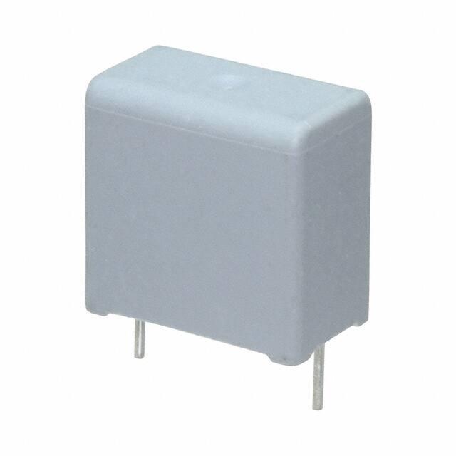

    CAP FILM 0.33UF 20% 630VDC RAD
F339X243330MFM2B0 数据手册
F339X2 305VAC www.vishay.com Vishay BCcomponents THB Interference Suppression Film Capacitors - Class X2 Radial MKP 305 VAC - Across the Line FEATURES • AEC-Q200 qualified (rev. D) • IEC 60384-14: 2013 / AMD1: 2016 grade IIB: 85 °C, 85 % RH, 500 h at URAC • Compliant with 85 °C, 85 % RH, 1000 h at 240 VAC • Material categorization: for definitions of compliance please see www.vishay.com/doc?99912 APPLICATIONS For standard across the line X2 applications. See also application note: www.vishay.com/doc?28153 QUICK REFERENCE DATA E12 series 0.1 μF to 4.7 μF (preferred values according to E12) ± 20 %; ± 10 % 305 VAC; 50 Hz to 60 Hz 630 VDC at 105 °C 40 / 105 / 56 / B 105 °C IEC 60384-14:2013 IEC 60384-14:2013 / AMD1:2016 EN 60384-14 IEC 60065 requires passive flammability class B UL 60384-14 (2nd edition) CSA-E60384-1:14 (3rd edition) CQC Polypropylene film Metallized Mono construction Rated capacitance range Capacitance tolerance Rated voltage range, URAC Permissible DC voltage Climatic testing class Rated temperature Reference standards Dielectric Electrodes Construction Plastic case, epoxy resin sealed, flame retardant UL-class 94 V-0 Tinned wire C-value; tolerance; rated voltage; sub-class; manufacturer’s type; code for dielectric material; manufacturer location, manufacturer logo; year and week; safety approvals Encapsulation Leads Marking Note • For more detailed data and test requirements, contact rfi@vishay.com DIMENSIONS in millimeters l w h lt P Revision: 27-Feb-18 Ø dt Document Number: 26072 1 For technical questions, contact: rfi@vishay.com THIS DOCUMENT IS SUBJECT TO CHANGE WITHOUT NOTICE. THE PRODUCTS DESCRIBED HEREIN AND THIS DOCUMENT ARE SUBJECT TO SPECIFIC DISCLAIMERS, SET FORTH AT www.vishay.com/doc?91000 F339X2 305VAC www.vishay.com Vishay BCcomponents COMPOSITION OF CATALOG NUMBER CODE Example: MULTIPLIER 0.1 2 410 100 nF 0.1 μF 510 1000 nF 1.0 μF 1 3 10 4 100 5 P1 (mm) PITCH CODE 15 F 22.5 I 27.5 K SPECIAL CODE FOR TERMINAL VOLTAGE 2 2 pins 30 = 305 VAC 4 4 pins 1 2 3 4 5 6 7 8 9 10 11 12 13 14 15 16 17 F 3 3 9 X 2 4 1 0 3 M F M 2 B 0 0 TOLERANCE CLASS M ± 20 % K ± 10 % SPECIAL 0 = Standard TYPE Other = Special L1 (mm) LEAD LENGTH CODE PITCH (mm) PACKING CODE 3.5 ± 0.3 P All B/T 5±1 M All W I All 25 ± 2 PACKING STYLE (1) REMARK Bulk / loose - Tape and reel (H: 18.5 mm; 500 mm) Pitch ≤ 22.5 mm 0: Space holder Notes • For detailed tape specifications refer to packaging information www.vishay.com/doc?28139 • Taped on reel pitch 27.5 mm is not available (1) Packaging will be bulk for all capacitors with pitch 15 mm. Capacitors with short leads up to 5 mm and pitch > 15 mm will be in tray and asking code will be “T” Revision: 27-Feb-18 Document Number: 26072 2 For technical questions, contact: rfi@vishay.com THIS DOCUMENT IS SUBJECT TO CHANGE WITHOUT NOTICE. THE PRODUCTS DESCRIBED HEREIN AND THIS DOCUMENT ARE SUBJECT TO SPECIFIC DISCLAIMERS, SET FORTH AT www.vishay.com/doc?91000 F339X2 305VAC www.vishay.com Vishay BCcomponents SPECIFIC REFERENCE DATA DESCRIPTION Rated voltage range, URAC Rated voltage range, URDC Tangent of loss angle: At 1 kHz C < 470 nF  20 x 10-4 470 nF  C  1 μF  30 x 10-4 C > 1 μF  40 x 10-4 Rated voltage pulse slope (dU/dt)R at 430 VDC Pitch = 15 mm Pitch = 22.5 mm Pitch = 27.5 mm R between leads, for C  0.33 μF at 100 V; 1 min RC between leads, for C > 0.33 μF at 100 V; 1 min R between leads and case; 100 V; 1 min Withstanding (DC) voltage (cut off current 10 mA) (1); rise time  1000 V/s: C  1 μF C > 1 μF Withstanding (AC) voltage between leads and case Note (1) See “Voltage Proof Test for Metalized Film Capacitors”: www.vishay.com/doc?28169 VALUE 305 VAC 630 VDC At 10 kHz  30 x 10-4  80 x 10-4 400 V/μs 150 V/μs 100 V/μs > 15 000 M > 5000 s > 30 000 M 2200 V; 1 min 1800 V; 1 min 2110 V; 1 min ELECTRICAL DATA AND ORDERING INFORMATION CATALOG NUMBER F339X2... AND PACKAGING URAC (V) CAP. (μF) DIMENSIONS (3) wxhxl (mm) MASS (g) (2) LOOSE IN BOX SHORT LEADS lt = 3.5 mm ± 0.3 mm lt = 5.0 mm ± 1.0 mm TAPED REEL (500 mm) (1) LONG LEADS SPQ lt = 25.0 mm ± 2.0 mm SPQ H = 18.5 mm; P0 = 12.7 mm SPQ PITCH = 15.0 mm ± 0.4 mm; dt = 0.80 mm ± 0.08 mm; C-TOL. = ± 20 % 0.10 7.0 x 13.5 x 17.5 1.8 41030MFP2B0 41030MFM2B0 750 41030MFI2B0 500 41030MF02W0 800 0.15 8.5 x 15.0 x 17.5 2.4 41530MFP2B0 41530MFM2B0 750 41530MFI2B0 500 41530MF02W0 650 0.22 10.0 x 16.5 x 17.5 3.0 42230MFP2B0 42230MFM2B0 500 42230MFI2B0 450 42230MF02W0 0.33 10.5 x 17.5 x 18.0 4.0 43330MFP2B0 43330MFM2B0 225 43330MFI2B0 400 43330MF02W0 0.47 13.5 x 22.5 x 18.0 6.5 44730MFP2B0 44730MFM2B0 185 44730MFI2B0 400 44730MF02W0 425 600 PITCH = 22.5 mm ± 0.4 mm; dt = 0.80 mm ± 0.08 mm; C-TOL. = ± 20 % 0.22 305 7.0 x 16.5 x 26.0 2.9 42230MIP2T0 42230MIM2T0 200 42230MII2B0 250 42230MI02W0 500 0.33 8.5 x 18.0 x 26.0 3.8 43330MIP2T0 43330MIM2T0 200 43330MII2B0 250 43330MI02W0 450 0.47 10.0 x 19.5 x 26.0 6.8 44730MIP2T0 44730MIM2T0 200 44730MII2B0 200 44730MI02W0 350 0.68 12.0 x 22.0 x 26.0 7.8 46830MIP2T0 46830MIM2T0 150 46830MII2B0 200 46830MI02W0 300 1.0 12.5 x 22.5 x 26.5 10.0 51030MIP2T0 51030MIM2T0 140 51030MII2B0 400 51030MI02W0 300 125 - - PITCH = 27.5 mm ± 0.4 mm; dt = 0.80 mm ± 0.08 mm; C-TOL. = ± 20 % 0.47 44730MKP2T0 44730MKM2T0 46830MKP2T0 46830MKM2T0 9.2 51030MKP2T0 51030MKM2T0 100 51030MKI2B0 125 - - 15.0 x 25.0 x 31.5 12.3 51530MKP2T0 51530MKM2T0 100 51530MKI2B0 125 - - 18.0 x 28.0 x 31.0 16.1 52230MKP2T0 52230MKM2T0 100 52230MKI2B0 100 - - 3.3 21.0 x 31.0 x 31.0 20.3 53330MKP2T0 53330MKM2T0 50 53330MKI2B0 75 - - 4.7 22.0 x 38.0 x 32.0 29.3 54730MKP2T0 54730MKM2T0 60 54730MKI2B0 60 - - 11.0 x 21.0 x 31.0 7.4 1.0 13.0 x 23.0 x 31.0 1.5 2.2 0.68 100 44730MKI2B0 46830MKI2B0 Notes • SPQ = Standard Packing Quantity (1) H = in-tape height; P = sprocket hole distance; for detailed specifications refer to “Packaging Information” 0 (2) Weight for short lead product only (3) For tolerances see chapter “Space Requirements for Printed-Circuit Board Applications and Dimension Tolerances” Revision: 27-Feb-18 Document Number: 26072 3 For technical questions, contact: rfi@vishay.com THIS DOCUMENT IS SUBJECT TO CHANGE WITHOUT NOTICE. THE PRODUCTS DESCRIBED HEREIN AND THIS DOCUMENT ARE SUBJECT TO SPECIFIC DISCLAIMERS, SET FORTH AT www.vishay.com/doc?91000 F339X2 305VAC www.vishay.com Vishay BCcomponents ELECTRICAL DATA AND ORDERING INFORMATION CATALOG NUMBER F339X2... AND PACKAGING URAC (V) CAP. (μF) DIMENSIONS (3) wxhxl (mm) MASS (g) (2) LOOSE IN BOX SHORT LEADS lt = 3.5 mm ± 0.3 mm lt = 5.0 mm ± 1.0 mm TAPED REEL (500 mm) (1) LONG LEADS SPQ lt = 25.0 mm ± 2.0 mm SPQ H = 18.5 mm; P0 = 12.7 mm SPQ 41030KF02W0 800 PITCH = 15.0 mm ± 0.4 mm; dt = 0.80 mm ± 0.08 mm; C-TOL. = ± 10 % 0.1 7.0 x 13.5 x 17.5 1.8 0.12 0.15 8.5 x 15.0 x 17.5 2.4 0.18 0.22 0.27 0.33 10.0 x 16.5 x 17.5 3.0 10.5 x 17.5 x 18.0 3.9 41030KFP2B0 41030KFM2B0 41230KFP2B0 41230KFM2B0 41530KFP2B0 41530KFM2B0 41830KFP2B0 41830KFM2B0 42230KFP2B0 42230KFM2B0 42730KFP2B0 42730KFM2B0 43330KFP2B0 43330KFM2B0 750 41030KFI2B0 500 41230KFI2B0 750 41530KFI2B0 41230KF02W0 500 41830KFI2B0 500 225 42230KFI2B0 42730KFI2B0 43330KFI2B0 41530KF02W0 650 41830KF02W0 450 400 42230KF02W0 42730KF02W0 600 43330KF02W0 0.39 11.0 x 18.5 x 18 4.1 43930KFP2B0 43930KFM2B0 225 43930KFI2B0 350 43930KF02W0 550 0.47 13.5 x 22.5 x 18.0 6.3 44730KFP2B0 44730KFM2B0 185 44730KFI2B0 400 44730KF02W0 425 0.22 7.0 x 16.5 x 26.0 42230KI02W0 500 PITCH = 22.5 mm ± 0.4 mm; dt = 0.80 mm ± 0.08 mm; C-TOL. = ± 10 % 2.9 0.27 0.33 8.5 x 18.0 x 26.0 3.8 0.39 0.47 305 0.56 0.68 0.82 1.0 10.0 x 19.5 x 26.0 6.8 12.0 x 22.0 x 26.0 7.8 12.5 x 22.5 x 26.5 10.0 42230KIP2T0 42230KIM2T0 42730KIP2T0 42730KIM2T0 43330KIP2T0 43330KIM2T0 43930KIP2T0 43930KIM2T0 44730KIP2T0 44730KIM2T0 45630KIP2T0 45630KIM2T0 46830KIP2T0 46830KIM2T0 48230KIP2T0 48230KIM2T0 51030KIP2T0 51030KIM2T0 200 42230KII2B0 250 42730KII2B0 200 43330KII2B0 42730KI02W0 250 43930KII2B0 200 150 140 44730KII2B0 45630KII2B0 46830KII2B0 48230KII2B0 51030KII2B0 43330KI02W0 450 43930KI02W0 200 200 400 44730KI02W0 45630KI02W0 46830KI02W0 48230KI02W0 350 300 51030KI02W0 300 - - - - PITCH = 27.5 mm ± 0.4 mm; dt = 0.80 mm ± 0.08 mm; C-TOL. = ± 10 % 0.47 0.56 11.0 x 21.0 x 31.0 7.4 0.68 0.82 1.0 1.2 1.5 1.8 2.2 2.7 3.3 3.9 4.7 13.0 x 23.0 x 31.0 9.2 15.0 x 25.0 x 31.5 12.3 18.0 x 28.0 x 31.0 16.1 21.0 x 31.0 x 31.0 20.3 22.0 x 38.0 x 32.0 29.2 44730KKP2T0 44730KKM2T0 45630KKP2T0 45630KKM2T0 46830KKP2T0 46830KKM2T0 48230KKP2T0 48230KKM2T0 51030KKP2T0 51030KKM2T0 51230KKP2T0 51230KKM2T0 51530KKP2T0 51530KKM2T0 51830KKP2T0 51830KKM2T0 52230KKP2T0 52230KKM2T0 52730KKP2T0 52730KKM2T0 53330KKP2T0 53330KKM2T0 53930KKP2T0 53930KKM2T0 54730KKP2T0 54730KKM2T0 44730KKI2B0 100 45630KKI2B0 125 46830KKI2B0 100 100 100 50 60 48230KKI2B0 51030KKI2B0 51230KKI2B0 51530KKI2B0 51830KKI2B0 52230KKI2B0 52730KKI2B0 53330KKI2B0 53930KKI2B0 54730KKI2B0 125 125 100 75 60 - - - - - - - - - - - - Notes • SPQ = Standard Packing Quantity (1) H = in-tape height; P = sprocket hole distance; for detailed specifications refer to “Packaging Information” 0 (2) Weight for short lead product only (3) For tolerances see chapter “Space Requirements for Printed-Circuit Board Applications and Dimension Tolerances” Revision: 27-Feb-18 Document Number: 26072 4 For technical questions, contact: rfi@vishay.com THIS DOCUMENT IS SUBJECT TO CHANGE WITHOUT NOTICE. THE PRODUCTS DESCRIBED HEREIN AND THIS DOCUMENT ARE SUBJECT TO SPECIFIC DISCLAIMERS, SET FORTH AT www.vishay.com/doc?91000 F339X2 305VAC www.vishay.com Vishay BCcomponents APPROVALS VOLTAGE VALUE FILE NUMBERS LINK EN 60384-14 (ENEC) (= IEC 60384-14 ed-4 (2013)) SAFETY APPROVALS X2 305 VAC 100 nF to 4.7 μF ENEC/FI 2017049 www.vishay.com/doc?28243 UL 60384-14 (2nd edition) 305 VAC 100 nF to 4.7 μF E354331 www.vishay.com/doc?28242 CSA-E60384-1:14 (3rd edition) 305 VAC 100 nF to 4.7 μF E354331 www.vishay.com/doc?28242 CQC 305 VAC 100 nF to 4.7 μF Pending - CB-test certificate 305 VAC 100 nF to 4.7 μF CB FI-34417 www.vishay.com/doc?28241 The ENEC-approval together with the CB-certificate replace all national marks of the following countries (they have already signed the ENEC-agreement): Austria; Belgium; Czech Republic; Denmark; Finland; France; Germany; Greece; Hungary; Ireland; Italy; Luxembourg; Netherlands; Norway; Portugal; Slovenian; Spain; Sweden, Switzerland, and United Kingdom. MOUNTING Normal Use The capacitor unit is designed for mounting on a printed circuit board. The capacitors packed in bandoliers are designed for mounting in printed-circuit boards by means of automatic insertion machines. For detailed tape specifications refer to packaging information www.vishay.com/docs?28139 Specific Method of Mounting to Withstand Vibration and Shock The capacitors are designed for mounting on printed-circuit boards. In order to withstand vibration and shock tests, it must be ensured that the stand-off pips are in good contact with the printed-circuit board. The capacitor shall be mechanically fixed by the leads and the body clamped. • For pitches  15 mm capacitors shall be mechanically fixed by the leads • For larger pitches the capacitors shall be mounted in the same way and the body clamped Space Requirements for Printed-Circuit Board Applications and Dimension Tolerances For the maximum product dimensions and maximum space requirements for length (lmax.), width (wmax.), and height (hmax.) following tolerances must be taken in account in the envelopment of the components as shown in the drawings below. • For products with pitch  15 mm, w = l = 0.3 mm, and h = 0.1 mm • For products with 15 mm < pitch < 27.5 mm, w = l = 0.5 mm, and h = 0.1 mm • For products with pitch = 27.5 mm, w = l = h = 0.7 mm Eccentricity defined as in drawing. The maximum eccentricity is smaller than or equal to the lead diameter of the product concerned. wmax. = w + Δw Eccentricity Imax. = I + ΔI CBA116 hmax. = h + Δh Seating plane For the minimum product dimensions for length (lmin.), width (wmin.), and height (hmin.) following tolerances of the components are valid: lmin. = l - l, wmin. = w - w, and hmin. = h - h following • For products with pitch = 15 mm, l = 0.5 mm, and w = h = 0.5 mm • For products with 15 mm < pitch < 27.5 mm, l = 1.0 mm, and w = h = 0.5 mm • For products with pitch = 27.5 mm, w = l = h = 1.0 mm Revision: 27-Feb-18 Document Number: 26072 5 For technical questions, contact: rfi@vishay.com THIS DOCUMENT IS SUBJECT TO CHANGE WITHOUT NOTICE. THE PRODUCTS DESCRIBED HEREIN AND THIS DOCUMENT ARE SUBJECT TO SPECIFIC DISCLAIMERS, SET FORTH AT www.vishay.com/doc?91000 F339X2 305VAC www.vishay.com Vishay BCcomponents SOLDERING CONDITIONS For general soldering conditions and wave soldering profile we refer to the document “Soldering Guidelines for Film Capacitors”: www.vishay.com/doc?28171 STORAGE TEMPERATURE Tstg = -25 °C to +35 °C with RH maximum 75 % without condensation RATINGS AND CHARACTERISTICS REFERENCE CONDITIONS Unless otherwise specified. all electrical values apply to an ambient temperature of 23 °C ± 1°C. an atmospheric pressure of 86 kPa to 106 kPa and a relative humidity of 50 % ± 2 %. For reference testing. a conditioning period shall be applied over 96 hours ± 4 hours by heating the products in a circulating air oven at the rated temperature and a relative humidity not exceeding 20 %. CHARACTERISTICS Axis Title Axis Title 10000 100 1000 0 Maximum -2 100 -4 2nd line Impedance (I) Typical Minimum 10 0 470 nF 10 50 1 4.7 μF 0.1 100 0.001 100 10 100 1000 10 000 10 100 000 Ambient Temperature (°C) Frequency (kHz) Capacitance as a function of ambient temperature (typical curve) Impedance as a function of frequency (typical curve) Axis Title Axis Title 10000 1000 100 10000 10 1000 4.7 μF 100 10 1st line 2nd line 1000 3.3 μF 2nd line Frequency (MHz) 1 μF 100 1st line 2nd line 2nd line Dissipation Factor (x 10-4) 1000 1 μF 0.01 -6 -50 100 nF 1st line 2nd line 2 10000 1000 1st line 2nd line 2nd line Change in Capacitance (%) 4 X2 100 1 100 nF 470 nF 1 0.01 10 0.1 1 10 100 0.1 10 100 1000 10 10 000 Frequency (kHz) Capacitance (nF) Tangent of loss angle as a function of frequency (typical curve) Resonant frequency as a function of capacitance (typical curve) Revision: 27-Feb-18 Document Number: 26072 6 For technical questions, contact: rfi@vishay.com THIS DOCUMENT IS SUBJECT TO CHANGE WITHOUT NOTICE. THE PRODUCTS DESCRIBED HEREIN AND THIS DOCUMENT ARE SUBJECT TO SPECIFIC DISCLAIMERS, SET FORTH AT www.vishay.com/doc?91000 F339X2 305VAC www.vishay.com Vishay BCcomponents Axis Title Axis Title 10 000 1000 10000 10000 1 μF 4.7 μF 470 nF 100 1000 1st line 2nd line 100 nF 100 2nd line AC Voltage (V) 1000 1st line 2nd line 2nd line AC Current (mA) 1000 100 100 10 Tamb ≤ 110 °C 10 1000 1 1 10 100 10 0.01 0.1 1 10 10 100 Frequency (kHz) Frequency (kHz) Max. RMS current as a function of frequency Max. RMS voltage as a function of frequency Axis Title 10000 1000 1st line 2nd line Time Constant 2nd line MΩ x μF (s) 1 000 000 100 000 100 10 10 000 0 20 40 60 80 100 Ambient Temperature (°C) Insulation resistance as a function of ambient temperature (typical curve) APPLICATION NOTES • For X2 electromagnetic interference suppression in standard across the line applications (50 Hz / 60 Hz) with a maximum of 305 VAC rated voltage including fluctuation of the mains. It is recommended to use these components in a mains with maximum nominal voltage of 240 VAC. Higher continuous applied voltages will shorten the life time • For series impedance applications we refer to application note www.vishay.com/doc?28153 • To ensure withstanding high humidity requirements in the application the epoxy adhesion at the leads shall not be damaged. Therefore the leads may not be damaged or not be bent before soldering • For capacitors connected in parallel, normally the proof voltage and possibly the rated voltage must be reduced. For information depending of the capacitance value and the number of parallel connections contact: rfi@vishay.com • These capacitors are not intended for continuous pulse application. For these situations capacitors of the AC and pulse programs must be used. • The maximum ambient temperature must not exceed 105 °C • Rated voltage pulse slope: if the pulse voltage is lower than the rated voltage, the values of the specific reference data can be multiplied by 430 VDC and divided by the applied voltage Revision: 27-Feb-18 Document Number: 26072 7 For technical questions, contact: rfi@vishay.com THIS DOCUMENT IS SUBJECT TO CHANGE WITHOUT NOTICE. THE PRODUCTS DESCRIBED HEREIN AND THIS DOCUMENT ARE SUBJECT TO SPECIFIC DISCLAIMERS, SET FORTH AT www.vishay.com/doc?91000 F339X2 305VAC www.vishay.com Vishay BCcomponents INSPECTION REQUIREMENTS General Notes Sub-clause numbers of tests and performance requirements refer to the “Sectional Specification, Publication IEC 60384-14 ed-4 (2013) and Specific Reference Data”. INSPECTION REQUIREMENTS SUB-CLAUSE NUMBER AND TEST CONDITIONS PERFORMANCE REQUIREMENTS SUB-GROUP C1A PART OF SAMPLE OF SUB-GROUP C1 4.1 Dimensions (detail) As specified in chapters “General Data” of this specification Initial measurements Capacitance Tangent of loss angle: for C  1 μF at 10 kHz for C > 1 μF at 1 kHz 4.3 Robustness of terminations Tensile: load 10 N; 10 s Bending: load 5 N; 4 x 90° 4.4 Resistance to soldering heat No pre-drying Method: 1A Solder bath: 280 °C ± 5 °C Duration: 10 s No visible damage 4.19 Component solvent resistance Isopropylalcohol at room temperature Method: 2 Immersion time: 5 min ± 0.5 min Recovery time: min. 1 h, max. 2 h 4.4.2 Final measurements Visual examination No visible damage Legible marking Capacitance |C/C|  5 % of the value measured initially Tangent of loss angle Increase of tan :  0.008 for: C  1 μF or  0.005 for: C > 1 μF Compared to values measured initially Insulation resistance As specified in section “Insulation Resistance” of this specification SUB-GROUP C1B OTHER PART OF SAMPLE OF SUB-GROUP C1 Initial measurements Capacitance Tangent of loss angle: for C  1 μF at 10 kHz for C > 1 μF at 1 kHz 4.20 Solvent resistance of the marking Isopropyl alcohol at room temperature Method: 1 Rubbing material: cotton wool Immersion time: 5 min ± 0.5 min 4.6 A = -40 °C B = +105 °C 5 cycles Duration t = 30 min Rapid change of temperature 4.6.1 Inspection Visual examination 4.7 Mounting: see section “Mounting” of this specification Procedure B4: Frequency range: 10 Hz to 55 Hz Amplitude: 0.75 mm or Acceleration 98 m/s2 (whichever is less severe) Total duration 6 h Vibration Revision: 27-Feb-18 No visible damage Legible marking No visible damage Document Number: 26072 8 For technical questions, contact: rfi@vishay.com THIS DOCUMENT IS SUBJECT TO CHANGE WITHOUT NOTICE. THE PRODUCTS DESCRIBED HEREIN AND THIS DOCUMENT ARE SUBJECT TO SPECIFIC DISCLAIMERS, SET FORTH AT www.vishay.com/doc?91000 F339X2 305VAC www.vishay.com Vishay BCcomponents INSPECTION REQUIREMENTS SUB-CLAUSE NUMBER AND TEST CONDITIONS PERFORMANCE REQUIREMENTS SUB-GROUP C1B OTHER PART OF SAMPLE OF SUB-GROUP C1 4.7.2 Final inspection Visual examination 4.9 Mounting: see section “Mounting” for more information Pulse shape: half sine Acceleration: 490 m/s2 Duration of pulse: 11 ms Shock 4.9.2 Final measurements No visible damage Visual examination No visible damage Capacitance |C/C|  5 % of the value measured initially Tangent of loss angle Increase of tan :  0.008 for: C  1 μF or  0.005 for: C > 1 μF Compared to values measured initially Insulation resistance As specified in section “Insulation Resistance” of this specification SUB-GROUP C1 COMBINED SAMPLE OF SPECIMENS OF SUB-GROUPS C1A AND C1B 4.11 Climatic sequence 4.11.1 Initial measurements Capacitance Measured in 4.4.2 and 4.9.2 Tangent of loss angle: measured initially in C1A and C1B 4.11.2 Dry heat Temperature: 105 °C 4.11.3 Damp heat cyclic Test Db First cycle Duration: 16 h 4.11.4 Cold Temperature: -40 °C 4.11.5 Damp heat cyclic Test Db remaining cycles Duration: 2 h 4.11.6 Final measurements Visual examination No visible damage Legible marking Capacitance |C/C|  5 % of the value measured in 4.11.1. Tangent of loss angle Increase of tan :  0.008 for: C  1 μF or  0.005 for: C > 1 μF Compared to values measured in 4.11.1 Voltage proof 1350 VDC; 1 min between terminations No permanent breakdown or flash-over Insulation resistance  50 % of values specified in section “Insulation Resistance” of this specification Revision: 27-Feb-18 Document Number: 26072 9 For technical questions, contact: rfi@vishay.com THIS DOCUMENT IS SUBJECT TO CHANGE WITHOUT NOTICE. THE PRODUCTS DESCRIBED HEREIN AND THIS DOCUMENT ARE SUBJECT TO SPECIFIC DISCLAIMERS, SET FORTH AT www.vishay.com/doc?91000 F339X2 305VAC www.vishay.com Vishay BCcomponents INSPECTION REQUIREMENTS SUB-CLAUSE NUMBER AND TEST CONDITIONS PERFORMANCE REQUIREMENTS SUB-GROUP C2 4.12 Damp heat steady state 56 days, 40 °C, 90 % to 95 % RH, no load 4.12.1 Initial measurements Capacitance Tangent of loss angle: for C  1 μF at 10 kHz for C > 1 μF at 1 kHz 4.12.3 Final measurements Visual examination No visible damage Legible marking Capacitance |C/C|  5 % of the value measured in 4.12.1. Tangent of loss angle Increase of tan :  0.008 for: C  1 μF or  0.005 for: C > 1 μF Compared to values measured in 4.12.1. Voltage proof 1350 VDC; 1 min between terminations No permanent breakdown or flash-over Insulation resistance  50 % of values specified in section “Insulation Resistance” of this specification SUB-GROUP C2A 4.12A Damp heat steady state with load 85 °C, 85 % RH, load: 305 VAC Duration: 500 h 4.12.1A Initial measurements Capacitance Tangent of loss angle: for C  1 μF at 10 kHz for C > 1 μF at 1 kHz 4.12.3A Final measurements Visual examination No visible damage Legible marking Revision: 27-Feb-18 Capacitance |C/C|  10 % of the value measured in 4.12.1. Tangent of loss angle Increase of tan :  0.0240 for: C  1 μF or  0.0150 for: C > 1 μF Compared to values measured in 4.12.1. Voltage proof 1350 VDC; 1 min between terminations No permanent breakdown or flash-over Insulation resistance  50 % of values specified in section “Insulation Resistance” of this specification Document Number: 26072 10 For technical questions, contact: rfi@vishay.com THIS DOCUMENT IS SUBJECT TO CHANGE WITHOUT NOTICE. THE PRODUCTS DESCRIBED HEREIN AND THIS DOCUMENT ARE SUBJECT TO SPECIFIC DISCLAIMERS, SET FORTH AT www.vishay.com/doc?91000 F339X2 305VAC www.vishay.com Vishay BCcomponents INSPECTION REQUIREMENTS SUB-CLAUSE NUMBER AND TEST CONDITIONS PERFORMANCE REQUIREMENTS SUB-GROUP C3 4.13.1 Initial measurements Capacitance Tangent of loss angle: for C  1 μF at 10 kHz for C > 1 μF at 1 kHz 4.13 Impulse voltage 3 successive impulses, full wave, peak voltage: X2: 2.5 kV for C  1 μF X2: 2.5 kVC for C > 1 μF Max. 24 pulses 4.14 Endurance Duration: 1000 h 1.25 x URAC at 105 °C Once in every hour the voltage is increased to 1000 VRMS for 0.1 s via resistor of 47  ± 5 % 4.14.7 Final measurements No self healing breakdowns or flash-over Visual examination No visible damage Legible marking Capacitance |C/C|  10 % compared to values measured in 4.13.1. Tangent of loss angle Increase of tan :  0.008 for: C  1 μF or  0.005 for: C > 1 μF Compared to values measured in 4.13.1 Voltage proof 1350 VDC; 1 min between terminations 2120 VAC; 1 min between terminations and case No permanent breakdown or flash-over Insulation resistance  50 % of values specified in section “Insulation Resistance” of this specification SUB-GROUP C4 4.15 Charge and discharge 10 000 cycles Charged to 430 VDC Discharge resistance: 430 V DC R = -----------------------------------------1.25 x C (du/dt) 4.15.1 Initial measurements Capacitance Tangent of loss angle: for C  1 μF at 10 kHz for C > 1 μF at 1 kHz 4.15.3 Final measurements Capacitance |C/C|  10 % compared to values measured in 4.15.1. Tangent of loss angle Increase of tan :  0.008 for: C  1 μF or  0.005 for: C > 1 μF Compared to values measured in 4.15.1 Insulation resistance  50 % of values specified in section “Insulation Resistance” of this specification Revision: 27-Feb-18 Document Number: 26072 11 For technical questions, contact: rfi@vishay.com THIS DOCUMENT IS SUBJECT TO CHANGE WITHOUT NOTICE. THE PRODUCTS DESCRIBED HEREIN AND THIS DOCUMENT ARE SUBJECT TO SPECIFIC DISCLAIMERS, SET FORTH AT www.vishay.com/doc?91000 F339X2 305VAC www.vishay.com Vishay BCcomponents INSPECTION REQUIREMENTS SUB-CLAUSE NUMBER AND TEST CONDITIONS PERFORMANCE REQUIREMENTS SUB-GROUP C5 4.16 Radio frequency characteristic Resonance frequency  0.9 times the value as specified in section “Resonant Frequency” of this specification Bore of gas jet: Ø 0.5 mm Fuel: butane / propane Test duration for actual volume V in mm3: After removing test flame from capacitor, the capacitor must not continue to burn for more than 10 s for V > 1750 mm3. No burning particle must drop from the sample. SUB-GROUP C6 4.17 Passive flammability Class B Class B V > 1750 60 s One flame application: 12 mm ~ 8 mm 45.0 ° SUB-GROUP C7 4.18 Active flammability 20 cycles of 2.5 kV discharges on the test capacitor connected to URAC The cheese cloth around the capacitors shall not burn with a flame. No electrical measurements are required. AUTOMOTIVE AEC-Q200, REVISION D QUALIFICIATION STRESS REVISION CONDITION SAMPLE SIZE PERFORMANCE REQUIREMENTS 1. High temperature exposure (storage) D Temp.: 105 ºC; unpowered 250 h / 500 h / 1000 h 77 |C/C|  5 % Increase of tan :  0.008 for C  1 μF at 10 kHz Increase of tan :  0.005 for C > 1 μF at 1 kHz IR > 50 % of initial specified value 2. Temperature cycling D Total no. of cycles: 1000 cycles Lower temp.: -40 °C Upper temp: +105 °C 30 min dwell time at each temperature Transition time < 1 min 77 |C/C|  5 % Increase of tan :  0.008 for C  1 μF at 10 kHz IR > 50 % of initial specified value No. of cycle: 10 cycles t = 24 h/cycle 77 |C/C|  5 % Increase of tan :  0.008 for C  1 μF at 10 kHz IR > 50% of initial specified value 3. Moisture resistance 4. Biased humidity AC D Temp.: 40 °C; RH: 93 %; URAC 250 h / 500 h / 1000 h 77 |C/C|  10 % Increase of tan :  0.008 for C  1 μF at 10 kHz IR > 50 % of initial specified value 5. Operational life AC D Temp. = 105 °C; URAC 1000 h 77 |C/C|  10 % Increase of tan :  0.008 for C  1 μF at 10 kHz IR > 50 % of initial specified value 6. Terminal strength (leaded) D Test leaded device lead integrity only. - A (pull-test): 2.27 kg (10 s) - C (wire-lead bend test): 227 g (3 x 3 s) 30 No visual damage Revision: 27-Feb-18 Document Number: 26072 12 For technical questions, contact: rfi@vishay.com THIS DOCUMENT IS SUBJECT TO CHANGE WITHOUT NOTICE. THE PRODUCTS DESCRIBED HEREIN AND THIS DOCUMENT ARE SUBJECT TO SPECIFIC DISCLAIMERS, SET FORTH AT www.vishay.com/doc?91000 F339X2 305VAC www.vishay.com Vishay BCcomponents AUTOMOTIVE AEC-Q200, REVISION D QUALIFICIATION STRESS REVISION CONDITION SAMPLE SIZE PERFORMANCE REQUIREMENTS 7. Resistance to solvents D MIL-STD-202 method 215. - Also aqueous chemical - OKEM clean or equivalent. Do not use banned solvents. 5 No visual damage Legible marking 8. Mechanical shock D 100 g's ; 6 ms half-sine; 3.75 m/s 30 No visual damage 9. Vibration D 5 g's for 20 min 12 cycles x 3 directions 10 Hz to 2000 Hz 30 No visual damage 10. Resistance to soldering heat D Temp.: 280 °C; time: 10 s solder within 1.5 mm of device body 30 |C/C|  5 % Increase of tan :  0.008 for C  1 μF at 10 kHz IR > 50 % of initial specified value 11. Solderability D Leaded: method A at 235 °C, category 3 (245 °C / 3 s) 15 Good tinning as evidence by free flowing of the solder with wetting of terminations > 95 % 12. Electrical characterization - 30 - 13. Flammability One flame application Class B 15 V-0 or V-1 are acceptable. Class B or C according IEC is also acceptable Revision: 27-Feb-18 Document Number: 26072 13 For technical questions, contact: rfi@vishay.com THIS DOCUMENT IS SUBJECT TO CHANGE WITHOUT NOTICE. THE PRODUCTS DESCRIBED HEREIN AND THIS DOCUMENT ARE SUBJECT TO SPECIFIC DISCLAIMERS, SET FORTH AT www.vishay.com/doc?91000 Legal Disclaimer Notice www.vishay.com Vishay Disclaimer  ALL PRODUCT, PRODUCT SPECIFICATIONS AND DATA ARE SUBJECT TO CHANGE WITHOUT NOTICE TO IMPROVE RELIABILITY, FUNCTION OR DESIGN OR OTHERWISE. Vishay Intertechnology, Inc., its affiliates, agents, and employees, and all persons acting on its or their behalf (collectively, “Vishay”), disclaim any and all liability for any errors, inaccuracies or incompleteness contained in any datasheet or in any other disclosure relating to any product. Vishay makes no warranty, representation or guarantee regarding the suitability of the products for any particular purpose or the continuing production of any product. To the maximum extent permitted by applicable law, Vishay disclaims (i) any and all liability arising out of the application or use of any product, (ii) any and all liability, including without limitation special, consequential or incidental damages, and (iii) any and all implied warranties, including warranties of fitness for particular purpose, non-infringement and merchantability. Statements regarding the suitability of products for certain types of applications are based on Vishay’s knowledge of typical requirements that are often placed on Vishay products in generic applications. Such statements are not binding statements about the suitability of products for a particular application. It is the customer’s responsibility to validate that a particular product with the properties described in the product specification is suitable for use in a particular application. Parameters provided in datasheets and / or specifications may vary in different applications and performance may vary over time. All operating parameters, including typical parameters, must be validated for each customer application by the customer’s technical experts. Product specifications do not expand or otherwise modify Vishay’s terms and conditions of purchase, including but not limited to the warranty expressed therein. Except as expressly indicated in writing, Vishay products are not designed for use in medical, life-saving, or life-sustaining applications or for any other application in which the failure of the Vishay product could result in personal injury or death. Customers using or selling Vishay products not expressly indicated for use in such applications do so at their own risk. Please contact authorized Vishay personnel to obtain written terms and conditions regarding products designed for such applications. No license, express or implied, by estoppel or otherwise, to any intellectual property rights is granted by this document or by any conduct of Vishay. Product names and markings noted herein may be trademarks of their respective owners. © 2017 VISHAY INTERTECHNOLOGY, INC. ALL RIGHTS RESERVED Revision: 08-Feb-17 1 Document Number: 91000
