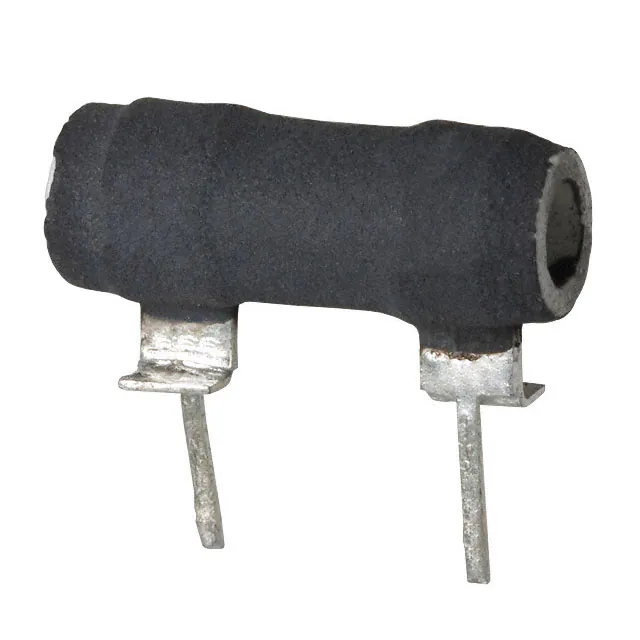

    插件电阻 500mΩ ±5% 10W ±400ppm/℃
FS-010CBER5000JE 数据手册
FS www.vishay.com Vishay Huntington Wirewound Resistors, Industrial Power, Silicone Coated, Printed Circuit Board Mount FEATURES • High temperature silicone coating • Eliminates lead forming to keep parts off of PC board • Built in standoffs provide PC board heat protection and opposing feet to avoid rocking • Available in non-inductive style (special “NI”) with Ayrton-Perry winding • Material categorization: for definitions of compliance please see www.vishay.com/doc?99912 STANDARD ELECTRICAL SPECIFICATIONS RESISTANCE RANGE  RESISTANCE RANGE  WEIGHT (typical) g HISTORICAL MODEL POWER RATING P25 °C W ±5% ± 10 % FS-003 FS-3 3 1.0 to 6K 0.1 to 6K 1.16 FS-05A FS-5A 5 1.0 to 15K 0.1 to 15K 2.12 FS-005 FS-5 7 1.0 to 17.5K 0.1 to 17.5K 3.36 FS-05S FS-5S 8 1.0 to 20.5K 0.1 to 20.5K 4.60 FS-010 FS-10 10 1.0 to 29K 0.1 to 29K 6.24 FS-10S FS-10S 12 1.0 to 58K 0.1 to 58K 6.60 FS-020 FS-20 20 1.0 to 60K 0.1 to 60K 8.82 FS-20S FS-20S 20 1.0 to 95K 0.1 to 95K 11.36 GLOBAL MODEL TECHNICAL SPECIFICATIONS PARAMETER Temperature Coefficient Short Time Overload Dielectric Withstanding Voltage UNIT FS RESISTOR CHARACTERISTICS ppm/°C ± 260 for 20  and above, ± 400 for 1  to 19.99 , special TC’s available please contact factory - 10 x rated power for 5 s VAC 1000, from terminal to mounting hardware Maximum Working Voltage V (P x R)1/2 Operating Temperature Range °C -55 to +350 GLOBAL PART NUMBER INFORMATION Global Part Numbering example: FS-010CBE1K000JE (visit www.vishay.net SAP parts manual for all options) F S - GLOBAL MODEL (6 digits) (see Standard Electrical Specifications Global Model column for options) 0 1 0 C TERMINAL DESIGNATION (2 digits) TERMINAL FINISH (1 digit) CB E = lead (Pb)-free B E 1 K 0 0 0 J E VALUE (5 digits) TOLERANCE (1 digit) PACKAGING CODE (1 digit) SPECIAL (up to 2 digits) R = decimal K = thousand 1R500 = 1.5  1K500 = 1.5 k J=±5% K = ± 10 % E = lead (Pb)-free cell and bulk pack (dash number) from 1 to 99 as applicable NI = non-inductive Historical Part Number example: FS-10-1K-5 % FS-10 1K  5% HISTORICAL MODEL RESISTANCE VALUE TOLERANCE Revision: 03-Apr-2019 SPECIAL Document Number: 31845 1 For technical questions, contact: ww2dresistors@vishay.com THIS DOCUMENT IS SUBJECT TO CHANGE WITHOUT NOTICE. THE PRODUCTS DESCRIBED HEREIN AND THIS DOCUMENT ARE SUBJECT TO SPECIFIC DISCLAIMERS, SET FORTH AT www.vishay.com/doc?91000 FS www.vishay.com Vishay Huntington DIMENSIONS in inches [millimeters] Note • Recommended mounting hole is 0.078 diameter. DIMENSIONS in inches [millimeters] MODEL FS-003 FS-002 FS-05A FS-005 FS-006 FS-05S FS-010 FS-10S FS-015 FS-020 FS-20S CORE A ± 0.062 [± 1.57] 1.000 [25.4] 1.125 [28.58] 1.000 [25.4] 1.125 [28.58] 1.750 [44.45] 2.125 [53.98] 2.000 [50.8] 2.375 [60.325] B ± 0.031 [± 0.78] 0.200 [5.08] 0.200 [5.08] 0.312 [7.94] 0.312 [7.94] 0.312 [7.94] 0.312 [7.94] 0.437 [11.11] 0.437 [11.11] C ± 0.062 [± 1.57] D MAX. E MAX. F MAX. STANDARD MOUNTING CENTERS ± 0.015 [± 0.381] 0.360 [9.14] 0.360 [9.14] 0.360 [9.14] 0.360 [9.14] 0.360 [9.14] 0.360 [9.14] 0.19 [4.82] 0.19 [4.82] 0.450 [11.43] 0.450 [11.43] 0.600 [15.24] 0.600 [15.24] 0.600 [15.24] 0.600 [15.24] 0.725 [18.41] 0.725 [18.41] 0.281 [7.14] 0.281 [7.14] 0.410 [10.41] 0.410 [10.41] 0.410 [10.41] 0.410 [10.41] 0.531 [13.49] 0.531 [13.49] 0.400 [10.16] 0.400 [10.16] 0.500 [12.7] 0.500 [12.7] 0.500 [12.7] 0.500 [12.7] 0.531 [13.49] 0.531 [13.49] 0.600 [15.24] 0.900 [22.86] 0.600 [15.24] 0.900 [22.86] 1.300 [33.02] 1.700 [43.18] 1.700 [43.18] 2.200 [55.88] Notes • The pin configuration on the terminals for the FS-10S and smaller products is on the center of the terminal. • The pin configuration on the terminals for the FS-015 and larger products is on the edge of the terminal Element: copper-nickel alloy or nickel-chrome alloy, depending on resistance value Core: ceramic, steatite Coating: special high temperature silicone Standard Terminals: tinned alloy 42 Terminal Bands: alloy 42 Part Marking: HEI, model, wattage, value, tolerance, date code NON-INDUCTIVE Models of equivalent physical and electrical specifications are available with non-inductive (Ayrton-Perry) winding. They are identified by adding the letters “NI” to the end of the part number in the special section. For non-inductive models the maximum resistance values are one-half the standard part. Revision: 03-Apr-2019 DERATING RATED POWER IN % MATERIAL SPECIFICATIONS 120 100 80 60 40 20 0 - 55 - 50 0 50 150 250 350 25 AMBIENT TEMPERATURE IN °C Document Number: 31845 2 For technical questions, contact: ww2dresistors@vishay.com THIS DOCUMENT IS SUBJECT TO CHANGE WITHOUT NOTICE. THE PRODUCTS DESCRIBED HEREIN AND THIS DOCUMENT ARE SUBJECT TO SPECIFIC DISCLAIMERS, SET FORTH AT www.vishay.com/doc?91000 Legal Disclaimer Notice www.vishay.com Vishay Disclaimer ALL PRODUCT, PRODUCT SPECIFICATIONS AND DATA ARE SUBJECT TO CHANGE WITHOUT NOTICE TO IMPROVE RELIABILITY, FUNCTION OR DESIGN OR OTHERWISE. Vishay Intertechnology, Inc., its affiliates, agents, and employees, and all persons acting on its or their behalf (collectively, “Vishay”), disclaim any and all liability for any errors, inaccuracies or incompleteness contained in any datasheet or in any other disclosure relating to any product. Vishay makes no warranty, representation or guarantee regarding the suitability of the products for any particular purpose or the continuing production of any product. To the maximum extent permitted by applicable law, Vishay disclaims (i) any and all liability arising out of the application or use of any product, (ii) any and all liability, including without limitation special, consequential or incidental damages, and (iii) any and all implied warranties, including warranties of fitness for particular purpose, non-infringement and merchantability. Statements regarding the suitability of products for certain types of applications are based on Vishay’s knowledge of typical requirements that are often placed on Vishay products in generic applications. Such statements are not binding statements about the suitability of products for a particular application. It is the customer’s responsibility to validate that a particular product with the properties described in the product specification is suitable for use in a particular application. Parameters provided in datasheets and / or specifications may vary in different applications and performance may vary over time. All operating parameters, including typical parameters, must be validated for each customer application by the customer’s technical experts. Product specifications do not expand or otherwise modify Vishay’s terms and conditions of purchase, including but not limited to the warranty expressed therein. Except as expressly indicated in writing, Vishay products are not designed for use in medical, life-saving, or life-sustaining applications or for any other application in which the failure of the Vishay product could result in personal injury or death. Customers using or selling Vishay products not expressly indicated for use in such applications do so at their own risk. Please contact authorized Vishay personnel to obtain written terms and conditions regarding products designed for such applications. No license, express or implied, by estoppel or otherwise, to any intellectual property rights is granted by this document or by any conduct of Vishay. Product names and markings noted herein may be trademarks of their respective owners. © 2021 VISHAY INTERTECHNOLOGY, INC. ALL RIGHTS RESERVED Revision: 01-Jan-2021 1 Document Number: 91000
