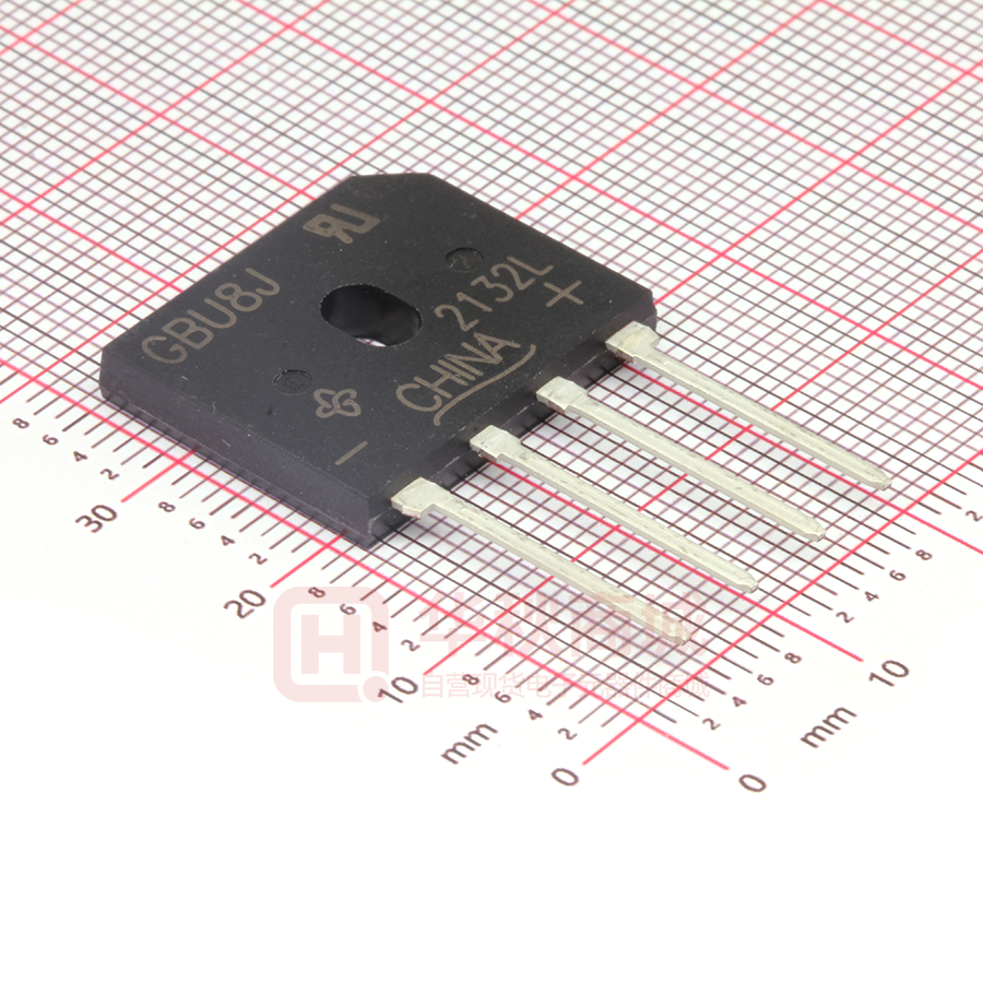

    桥式整流器/整流桥 Vr=600V Ir=5μA VF=1V IF=3.9A GBU
GBU8J-E3/51 数据手册
GBU8A, GBU8B, GBU8D, GBU8G, GBU8J, GBU8K, GBU8M www.vishay.com Vishay General Semiconductor Glass Passivated Single-Phase Bridge Rectifier FEATURES • UL recognition file number E54214 • Ideal for printed circuit boards • High surge current capability ~ ~ • High case dielectric strength of 1500 VRMS + - - ~ ~ • Solder dip 275 °C max. 10 s, per JESD 22-B106 + • Material categorization: for definitions of compliance please see www.vishay.com/doc?99912 Case Style GBU Case Style GBU TYPICAL APPLICATIONS General purpose use in AC/DC bridge full wave rectification for monitor, TV, printer, power supply, switching mode power supply, adapter, audio equipment, and home appliances applications. PRIMARY CHARACTERISTICS Package GBU IF(AV) 8.0 A VRRM 50 V, 100 V, 200 V, 400 V, 600 V, 800 V, 1000 V IFSM 200 A IR 5 μA VF at IF = 8.0 A 1.0 V TJ max. 150 °C Diode variations In-Line MECHANICAL DATA Case: GBU Molding compound meets UL 94 V-0 flammability rating Base P/N-E3 - RoHS-compliant, commercial grade Terminals: Matte tin plated leads, solderable J-STD-002 and JESD 22-B102 E3 suffix meets JESD 201 class 1A whisker test per Polarity: As marked on body Mounting Torque: 10 cm-kg (8.8 inches-lbs) max. Recommended Torque: 5.7 cm-kg (5 inches-lbs) MAXIMUM RATINGS (TA = 25 °C unless otherwise noted) PARAMETER SYMBOL GBU8A GBU8B GBU8D GBU8G GBU8J GBU8K GBU8M UNIT Maximum repetitive peak reverse voltage VRRM 50 100 200 400 600 800 1000 V Maximum RMS voltage VRMS 35 70 140 280 420 560 700 V Maximum DC blocking voltage VDC 50 100 200 400 600 800 1000 V Maximum average forward rectified output current at TC = 60 °C IF(AV) (1) 8.0 TA = 40 °C IF(AV) (2) 3.9 IFSM 200 A I2t 166 A2s TJ, TSTG -55 to +150 °C Peak forward surge current single sine-wave super-imposed on rated load Rating for fusing (t < 8.3 ms) Operating junction and storage temperature range A Notes (1) Unit case mounted on aIuminum plate heatsink (2) Units mounted on PCB with 0.5" x 0.5" (12 mm x 12 mm) copper pads and 0.375" (9.5 mm) lead length Revision: 02-Apr-15 Document Number: 88616 1 For technical questions within your region: DiodesAmericas@vishay.com, DiodesAsia@vishay.com, DiodesEurope@vishay.com THIS DOCUMENT IS SUBJECT TO CHANGE WITHOUT NOTICE. THE PRODUCTS DESCRIBED HEREIN AND THIS DOCUMENT ARE SUBJECT TO SPECIFIC DISCLAIMERS, SET FORTH AT www.vishay.com/doc?91000 GBU8A, GBU8B, GBU8D, GBU8G, GBU8J, GBU8K, GBU8M www.vishay.com Vishay General Semiconductor ELECTRICAL CHARACTERISTICS (TA = 25 °C unless otherwise noted) PARAMETER TEST CONDITIONS SYMBOL Maximum instantaneous forward voltage drop per diode 8.0 A Maximum DC reverse current at rated DC blocking voltage per diode Typical junction  capacitance per diode GBU8A GBU8B GBU8D GBU8G VF GBU8J GBU8K GBU8M UNIT 1.0 V 5.0 TA = 25 °C μA IR TA = 125 °C 500 4 V, 1 MHz CJ 68 pF THERMAL CHARACTERISTICS (TA = 25 °C unless otherwise noted) PARAMETER SYMBOL Typical thermal resistance GBU8A GBU8B GBU8D GBU8G RJA (2) 20 RJC (1)(3) 4.0 GBU8J GBU8K GBU8M UNIT °C/W Notes (1) Units case mounted on aIuminum plate heatsink (2) Units mounted in free air, no heatsink on PCB, 0.5" x 0.5" (12 mm x 12 mm) copper pads, 0.375" (9.5 mm) lead length (3) Recommended mounting position is to bolt down on heatsink with silicone thermal compound for maximum heat transfer with #6 screws ORDERING INFORMATION PREFERRED P/N UNIT WEIGHT (g) PREFERRED PACKAGE CODE BASE QUANTITY DELIVERY MODE GBU8J-E3/45 3.857 45 20 Tube GBU8J-E3/51 3.857 51 250 Paper tray RATINGS AND CHARACTERISTICS CURVES (TA = 25 °C unless otherwise noted) 250 Heatsink Mounting, TC Peak Forward Surge Current (A) Average Forw ard Output Current (A) 8.0 6.0 4.0 2.0 PCB Mounting, TA 0.47" x 0.47" (12 mm x 12 mm) Copper Pads 0.375" (9.5 mm) Lead Length 60 Hz Resistive or Inductive Load TJ = 150 °C 8.3 ms Single Half Sine-Wave 200 150 100 50 0 0 0 25 50 75 100 125 150 1 10 100 Temperature (°C) Number of Cycles at 60 Hz Fig. 1 - Derating Curve Output Rectified Current Fig. 2 - Maximum Non-Repetitive Peak Forward Surge Current Per Diode Revision: 02-Apr-15 Document Number: 88616 2 For technical questions within your region: DiodesAmericas@vishay.com, DiodesAsia@vishay.com, DiodesEurope@vishay.com THIS DOCUMENT IS SUBJECT TO CHANGE WITHOUT NOTICE. THE PRODUCTS DESCRIBED HEREIN AND THIS DOCUMENT ARE SUBJECT TO SPECIFIC DISCLAIMERS, SET FORTH AT www.vishay.com/doc?91000 GBU8A, GBU8B, GBU8D, GBU8G, GBU8J, GBU8K, GBU8M www.vishay.com Vishay General Semiconductor 10 000 10 1 0.1 TJ = 25 °C f = 1.0 MHz Vsig = 50 mVp-p Junction Capacitance (pF) Instantaneous Forward Current (A) 100 TJ = 25 °C Pulse Width = 300 μs 1 % Duty Cycle 1000 100 10 0.01 0.4 0.6 1.2 1.0 0.8 1.4 0.1 1.6 1 Instantaneous Forward Voltage (V) Fig. 5 - Typical Junction Capacitance Per Diode 100 TA = 150 °C Transient Thermal Impedance (°C/W) Instantaneous Reverse Current (μA) 1000 TA = 125 °C TA = 100 °C 10 1 TA = 25 °C 0.1 10 1 0.01 10 20 30 40 50 100 Reverse Voltage (V) Fig. 3 - Typical Forward Characteristics Per Diode 100 10 60 70 80 90 0.1 0.01 100 1 0.1 10 100 t - Heating Time (s) Percent of Rated Peak Reverse Voltage (%) Fig. 4 - Typical Reverse Leakage Characteristics Per Diode Fig. 6 - Typical Transient Thermal Impedance Per Diode PACKAGE OUTLINE DIMENSIONS in inches (millimeters) Case Type GBU 0.020 R (TYP.) 0.310 (7.9) 0.290 (7.4) 0.085 (2.16) 0.065 (1.65) 0.140 (3.56) 0.130 (3.30) 0.880 (22.3) 0.860 (21.8) 0.125 (3.2) x 45° Chamfer 0.160 (4.1) 0.140 (3.5) 0.075 (1.9) R . 9° TYP. 0.740 (18.8) 0.720 (18.3) 0.080 (2.03) 0.060 (1.52) 5° TYP. 0.100 (2.54) 0.085 (2.16) 0.080 (2.03) 0.065 (1.65) 0.050 (1.27) 0.040 (1.02) 0.190 (4.83) 0.210 (5.33) 0.710 (18.0) 0.690 (17.5) 0.085 (2.16) 0.075 (1.90) 0.026 (0.66) 0.020 (0.51) Polarity shown on front side of case, positive lead by beveled corner Revision: 02-Apr-15 Document Number: 88616 3 For technical questions within your region: DiodesAmericas@vishay.com, DiodesAsia@vishay.com, DiodesEurope@vishay.com THIS DOCUMENT IS SUBJECT TO CHANGE WITHOUT NOTICE. THE PRODUCTS DESCRIBED HEREIN AND THIS DOCUMENT ARE SUBJECT TO SPECIFIC DISCLAIMERS, SET FORTH AT www.vishay.com/doc?91000 Legal Disclaimer Notice www.vishay.com Vishay Disclaimer ALL PRODUCT, PRODUCT SPECIFICATIONS AND DATA ARE SUBJECT TO CHANGE WITHOUT NOTICE TO IMPROVE RELIABILITY, FUNCTION OR DESIGN OR OTHERWISE. Vishay Intertechnology, Inc., its affiliates, agents, and employees, and all persons acting on its or their behalf (collectively, “Vishay”), disclaim any and all liability for any errors, inaccuracies or incompleteness contained in any datasheet or in any other disclosure relating to any product. Vishay makes no warranty, representation or guarantee regarding the suitability of the products for any particular purpose or the continuing production of any product. To the maximum extent permitted by applicable law, Vishay disclaims (i) any and all liability arising out of the application or use of any product, (ii) any and all liability, including without limitation special, consequential or incidental damages, and (iii) any and all implied warranties, including warranties of fitness for particular purpose, non-infringement and merchantability. Statements regarding the suitability of products for certain types of applications are based on Vishay’s knowledge of typical requirements that are often placed on Vishay products in generic applications. Such statements are not binding statements about the suitability of products for a particular application. It is the customer’s responsibility to validate that a particular product with the properties described in the product specification is suitable for use in a particular application. Parameters provided in datasheets and / or specifications may vary in different applications and performance may vary over time. All operating parameters, including typical parameters, must be validated for each customer application by the customer’s technical experts. Product specifications do not expand or otherwise modify Vishay’s terms and conditions of purchase, including but not limited to the warranty expressed therein. Except as expressly indicated in writing, Vishay products are not designed for use in medical, life-saving, or life-sustaining applications or for any other application in which the failure of the Vishay product could result in personal injury or death. Customers using or selling Vishay products not expressly indicated for use in such applications do so at their own risk. Please contact authorized Vishay personnel to obtain written terms and conditions regarding products designed for such applications. No license, express or implied, by estoppel or otherwise, to any intellectual property rights is granted by this document or by any conduct of Vishay. Product names and markings noted herein may be trademarks of their respective owners. © 2019 VISHAY INTERTECHNOLOGY, INC. ALL RIGHTS RESERVED Revision: 01-Jan-2019 1 Document Number: 91000
