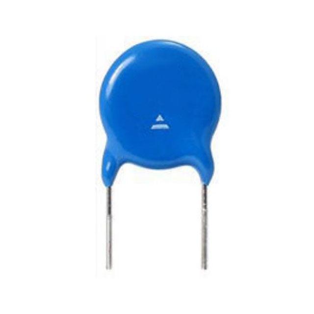

HBU, HBZ, HBE, HBX Series www.vishay.com Vishay Draloric Ceramic Singlelayer DC Disc Capacitors, 2 kVDC General Purpose FEATURES • High capacitance in small sizes • Low losses • Wide range of different lead styles • Material categorization: for definitions of compliance please see www.vishay.com/doc?99912 APPLICATIONS • Lighting ballasts • SMPS DESIGN The capacitors consist of a ceramic disc which is silver plated on both sides. Connection leads are made of tinned copper having diameters of 0.6 mm or 0.8 mm. QUICK REFERENCE DATA DESCRIPTION VALUE Ceramic Class 1 Ceramic Dielectric N750, Y5T, Y5U, Y5V Voltage (VDC) 2 2000 Min. Capacitance (pF) 10 Max. Capacitance (pF) 470 Mounting 56 22 000 Radial The capacitors may be supplied with straight or kinked leads having a lead spacing of 7.5 mm. Coating is made of blue colored flame retardant epoxy resin in accordance with UL 94 V-0. CAPACITANCE RANGE 10 pF to 22 nF RATED VOLTAGE 2 kVDC MARKING Marking indicates, capacitance, tolerance code, and rated voltage. DIELECTRIC STRENGTH OPERATING TEMPERATURE RANGE INSULATION RESISTANCE AT 500 VDC -40 °C to +85 °C 3000 VDC, 2 s Component test 10 000 M (60 s) TEMPERATURE CHARACTERISTICS TOLERANCE ON CAPACITANCE Class 1 N750 (U2J) ± 10 %, ± 20 %, - 20 % / + 50 % Class 2 Y5T, Y5U, Y5V DISSIPATION FACTOR SECTIONAL SPECIFICATIONS Climatic category (according to EN 60068-1): 40/085/21 Class 1: -4 100 pF C < 30 pF:  ------------------- + 0.7 x 10 max.  1 MHz   C  C  30 pF: max. 0.1 % (1 MHz) Class 2: Revision: 16-Sep-14 max. 2.5 % (1 kHz) Document Number: 22152 1 For technical questions, contact: slcap@vishay.com THIS DOCUMENT IS SUBJECT TO CHANGE WITHOUT NOTICE. THE PRODUCTS DESCRIBED HEREIN AND THIS DOCUMENT ARE SUBJECT TO SPECIFIC DISCLAIMERS, SET FORTH AT www.vishay.com/doc?91000 HBU, HBZ, HBE, HBX Series www.vishay.com Vishay Draloric DIMENSIONS in millimeters Smax. 3.0 max. Dmax. V F 30 - 3 or 10 ± 1 Ø d ± 0.05 ORDERING INFORMATION CAPACITANCE (pF) TOLERANCE (%) BODY DIAMETER Dmax. (mm) BODY THICKNESS Smax. (mm) LEAD SPACING (1) F (mm) ± 1 mm LEAD DIAMETER (1) d (mm) ± 0.05 mm WIDTH (1) V (mm) ± 0.5 mm ORDERING CODE MISSING DIGITS SEE ORDERING CODE BELOW N750 (U2J) 10 HBU100KBB###KR 15 1.2 22 HBU150KBB###KR HBU220KBB###KR 7.0 4.0 33 1.3 47 HBU330KBB###KR HBU470KBB###KR 68 HBU680KBB###KR ± 10 8.0 7.5 82 0.6 HBU820KBB###KR 100 HBU101KBB###KR 10.0 1.4 150 HBU151KBB###KR 4.2 220 12.0 HBU221KBB###KR 330 15.0 HBU331KBB###KR 470 17.0 HBU471KBB###KR Y5T (2D3) 56 HBZ560#BB###KR 68 HBZ680#BB###KR 82 HBZ820#BB###KR 100 HBZ101#BB###KR 7.0 150 HBZ151#BB###KR 220 HBZ221#BB###KR 330 HBZ331#BB###KR ± 10, ± 20 3.0 470 7.5 0.6 1.4 HBZ471#BB###KR 680 HBZ681#BB###KR 9.0 1000 HBZ102#BB###KR 1500 11.0 HBZ152#BB###KR 2200 13.0 HBZ222#BB###KR 3300 15.0 HBZ332#BB###KR 4700 17.0 HBZ472#BB###KR Revision: 16-Sep-14 Document Number: 22152 2 For technical questions, contact: slcap@vishay.com THIS DOCUMENT IS SUBJECT TO CHANGE WITHOUT NOTICE. THE PRODUCTS DESCRIBED HEREIN AND THIS DOCUMENT ARE SUBJECT TO SPECIFIC DISCLAIMERS, SET FORTH AT www.vishay.com/doc?91000 HBU, HBZ, HBE, HBX Series www.vishay.com Vishay Draloric ORDERING INFORMATION CAPACITANCE (pF) TOLERANCE (%) BODY DIAMETER Dmax. (mm) BODY THICKNESS Smax. (mm) LEAD DIAMETER (1) d (mm) ± 0.05 mm LEAD SPACING (1) F (mm) ± 1 mm WIDTH (1) V (mm) ± 0.5 mm ORDERING CODE MISSING DIGITS SEE ORDERING CODE BELOW Y5U (2E3) 680 HBE681MBB###KR 7.0 1000 1500 HBE102MBB###KR HBE152MBB###KR 9.0 2200 ± 20 3300 3.0 11.0 7.5 0.6 HBE222MBB###KR 1.4 HBE332MBB###KR 4700 13.0 HBE472MBB###KR 6800 15.0 HBE682MBB###KR 10 000 17.0 HBE103MBB###KR 1500 7.0 HBX152#BB###KR 2200 9.0 HBX222#BB###KR Y5V (2F3) 3300 HBX332#BB###KR 4700 11.0 - 20 / + 50 (2) 6800 3.0 7.5 0.6 HBX472#BB###KR 1.2 HBX682#BB###KR 10 000 15.0 HBX103#BB###KR 15 000 17.0 HBX153#BB###KR 22 000 20.0 HBX223#BB###KR Notes (1) Standard lead configuration, other lead spacing and diameter available on request (2) ± 20 % available on request ORDERING CODE # 7th digit Capacitance tolerance ± 10 % = K, ± 20 % = M, - 20 % / + 50 % = S ### 10th to 12th digit Lead configuration see “General Information” Example HBX 223 S BB CRU K R Series Capacitance value Tolerance code Voltage code Lead configuration Internal code RoHS compliant MARKING 56p K 2 kV U  3n3 K 3n3 M 2 kV HBU 10 pF to 220 pF HBU 330 pF to 470 pF HBX 1.5 nF to 4.7 nF HBZ 56 pF to 2.2 nF HBE 680 pF to 4.7 nF HBZ 3.3 nF to 4.7 nF HBE 6.8 nF to 10 nF  HBX 10n S HBX 6.8 nF to 22 nF RELATED DOCUMENTS General Information Revision: 16-Sep-14 www.vishay.com/doc?22001 Document Number: 22152 3 For technical questions, contact: slcap@vishay.com THIS DOCUMENT IS SUBJECT TO CHANGE WITHOUT NOTICE. THE PRODUCTS DESCRIBED HEREIN AND THIS DOCUMENT ARE SUBJECT TO SPECIFIC DISCLAIMERS, SET FORTH AT www.vishay.com/doc?91000 Legal Disclaimer Notice www.vishay.com Vishay Disclaimer ALL PRODUCT, PRODUCT SPECIFICATIONS AND DATA ARE SUBJECT TO CHANGE WITHOUT NOTICE TO IMPROVE RELIABILITY, FUNCTION OR DESIGN OR OTHERWISE. Vishay Intertechnology, Inc., its affiliates, agents, and employees, and all persons acting on its or their behalf (collectively, “Vishay”), disclaim any and all liability for any errors, inaccuracies or incompleteness contained in any datasheet or in any other disclosure relating to any product. Vishay makes no warranty, representation or guarantee regarding the suitability of the products for any particular purpose or the continuing production of any product. To the maximum extent permitted by applicable law, Vishay disclaims (i) any and all liability arising out of the application or use of any product, (ii) any and all liability, including without limitation special, consequential or incidental damages, and (iii) any and all implied warranties, including warranties of fitness for particular purpose, non-infringement and merchantability. Statements regarding the suitability of products for certain types of applications are based on Vishay’s knowledge of typical requirements that are often placed on Vishay products in generic applications. Such statements are not binding statements about the suitability of products for a particular application. It is the customer’s responsibility to validate that a particular product with the properties described in the product specification is suitable for use in a particular application. Parameters provided in datasheets and / or specifications may vary in different applications and performance may vary over time. All operating parameters, including typical parameters, must be validated for each customer application by the customer’s technical experts. Product specifications do not expand or otherwise modify Vishay’s terms and conditions of purchase, including but not limited to the warranty expressed therein. Except as expressly indicated in writing, Vishay products are not designed for use in medical, life-saving, or life-sustaining applications or for any other application in which the failure of the Vishay product could result in personal injury or death. Customers using or selling Vishay products not expressly indicated for use in such applications do so at their own risk. Please contact authorized Vishay personnel to obtain written terms and conditions regarding products designed for such applications. No license, express or implied, by estoppel or otherwise, to any intellectual property rights is granted by this document or by any conduct of Vishay. Product names and markings noted herein may be trademarks of their respective owners. © 2021 VISHAY INTERTECHNOLOGY, INC. ALL RIGHTS RESERVED Revision: 01-Jan-2021 1 Document Number: 91000

物料型号:HBU, HBZ, HBE, HBX系列
器件简介:这些电容器是用于一般用途的2kV直流电容器,具有高电容、小尺寸、低损耗等特点,符合RoHS标准。
引脚分配:电容器由涂有银的陶瓷圆盘构成,连接引脚由直径为0.6mm或0.8mm的镀锡铜制成,可提供直引脚或弯曲引脚,引脚间距为7.5mm。
参数特性: - 电容范围:10pF至22nF - 额定电压:2kV直流 - 介质强度:3000V直流,持续2秒 - 电容公差:±10%,±20%,-20%/+50% - 绝缘电阻:在500V直流下,最小10,000MΩ(60秒) - 介电损耗角正切(Dissipation Factor):Class 1的最大值为0.1%(1MHz),Class 2的最大值为2.5%(1kHz)
功能详解:电容器由蓝色阻燃环氧树脂涂层包裹,符合UL 94 V-0标准,适用于照明镇流器和开关电源等应用。
应用信息:适用于照明镇流器、开关电源等。
封装信息:提供了详细的订购信息,包括电容值、公差、最大直径、最大厚度、引脚间距、引脚直径和宽度,以及订购代码。
