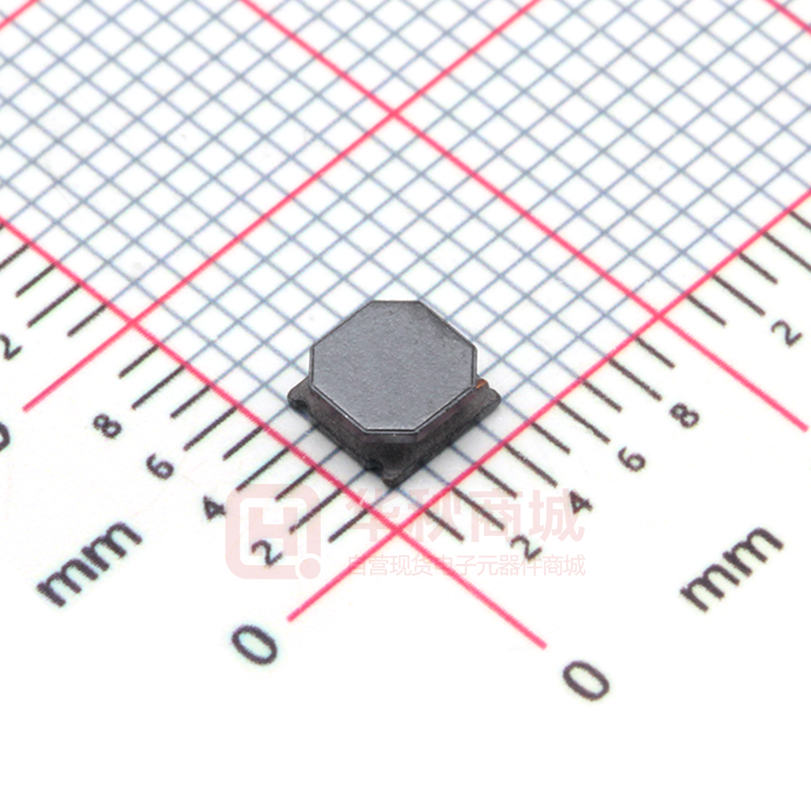

    功率电感 10µH ±20% IND_4X4MM_SM 1.80mm 4.00 x 4.00mm 169mΩ 1.35A
IFSC1515AHER100M01 数据手册
IFSC-1515AH-01 www.vishay.com Vishay Dale Low Profile, High Current Inductors FEATURES • Shielded construction • Frequency range up to 5.0 MHz • Handles high transient current spikes without saturation • Material categorization: for definitions of compliance please see www.vishay.com/doc?99912 APPLICATIONS STANDARD ELECTRICAL SPECIFICATIONS L0 INDUCTANCE ± 20 % AT 100 kHz, 0.25 V, 0 A (μH) 0.47 0.56 0.68 1.0 1.2 1.5 1.8 2.2 3.3 4.7 6.8 8.2 10.0 15.0 22.0 33.0 47.0 68.0 100.0 220.0 330.0 HEAT RATING DCR CURRENT 25 °C DC (m) IDC (A) (3) TYP. MAX. TYP. MAX. 15 18 5.5 5.00 17 22 5.40 4.90 19 25 5.00 4.50 20 25 4.30 3.80 25 30 3.80 3.40 33 40 3.40 3.05 34 41 3.20 2.85 35 45 3.10 2.80 45 56 2.75 2.50 69 89 2.30 2.07 90 115 2.10 1.90 105 132 1.80 1.60 134 169 1.50 1.35 185 222 1.45 1.30 250 315 1.20 1.08 405 486 0.90 0.81 495 594 0.80 0.72 885 1062 0.58 0.52 1545 1854 0.52 0.47 3150 3780 0.30 0.27 4200 5040 0.29 0.26 • PDA/notebook/desktop/server applications SATURATION CURRENT DC ISAT (A) (4) TYP. MAX. 5.70 5.10 5.60 5.05 5.50 5.00 3.85 3.50 3.70 3.30 3.60 3.20 3.20 2.90 3.10 2.80 2.45 2.20 2.05 1.85 1.75 1.60 1.65 1.44 1.55 1.40 1.10 1.00 0.95 0.85 0.70 0.63 0.58 0.52 0.48 0.43 0.46 0.41 0.33 0.30 0.26 0.23 • High current POL converters • Low profile, high current power supplies • Battery powered devices • DC/DC converters in distributed power systems • DC/DC converter for field programmable gate array (FPGA) DIMENSIONS in inches [millimeters] 100 0.071 ± 0.004 [1.8 ± 0.1] 0.157 ± 0.008 [4.0 ± 0.2] 0.071 (1.8) 0.157 ± 0.008 [4.0 ± 0.2] 0.142 (3.6) Notes (1) All test data is referenced to 25 °C ambient (2) Operating temperature range -55 °C to +125 °C (3) DC current (A) that will cause an approximate T of 40 °C (4) DC current (A) that will cause L to drop approximately 30 % 0 (5) The part temperature (ambient + temp. rise) should not exceed 125 °C under worst case operating conditions. Circuit design, component placement, PWB trace size and thickness, airflow and other cooling provisions all affect the part temperature. Part temperature should be verified in the end application 0.118 ± 0.014 [3.0 ± 0.35] 0.043 ± 0.014 [1.1 ± 0.35] 0.161 (4.1) DESCRIPTION IFSC-1515AH-01 MODEL 3.3 μH ± 20 % INDUCTANCE VALUE ER INDUCTANCE TOLERANCE e3 PACKAGE CODE JEDEC® LEAD (Pb)-FREE STANDARD GLOBAL PART NUMBER I F S PRODUCT FAMILY Revision: 04-Oct-17 C 1 5 1 5 SIZE A H E R PACKAGE CODE 3 R INDUCTANCE VALUE 3 M TOL. 0 1 SERIES Document Number: 34295 1 For technical questions, contact: magnetics@vishay.com THIS DOCUMENT IS SUBJECT TO CHANGE WITHOUT NOTICE. THE PRODUCTS DESCRIBED HEREIN AND THIS DOCUMENT ARE SUBJECT TO SPECIFIC DISCLAIMERS, SET FORTH AT www.vishay.com/doc?91000 Legal Disclaimer Notice www.vishay.com Vishay Disclaimer ALL PRODUCT, PRODUCT SPECIFICATIONS AND DATA ARE SUBJECT TO CHANGE WITHOUT NOTICE TO IMPROVE RELIABILITY, FUNCTION OR DESIGN OR OTHERWISE. Vishay Intertechnology, Inc., its affiliates, agents, and employees, and all persons acting on its or their behalf (collectively, “Vishay”), disclaim any and all liability for any errors, inaccuracies or incompleteness contained in any datasheet or in any other disclosure relating to any product. Vishay makes no warranty, representation or guarantee regarding the suitability of the products for any particular purpose or the continuing production of any product. To the maximum extent permitted by applicable law, Vishay disclaims (i) any and all liability arising out of the application or use of any product, (ii) any and all liability, including without limitation special, consequential or incidental damages, and (iii) any and all implied warranties, including warranties of fitness for particular purpose, non-infringement and merchantability. Statements regarding the suitability of products for certain types of applications are based on Vishay's knowledge of typical requirements that are often placed on Vishay products in generic applications. Such statements are not binding statements about the suitability of products for a particular application. It is the customer's responsibility to validate that a particular product with the properties described in the product specification is suitable for use in a particular application. Parameters provided in datasheets and / or specifications may vary in different applications and performance may vary over time. All operating parameters, including typical parameters, must be validated for each customer application by the customer's technical experts. Product specifications do not expand or otherwise modify Vishay's terms and conditions of purchase, including but not limited to the warranty expressed therein. Hyperlinks included in this datasheet may direct users to third-party websites. These links are provided as a convenience and for informational purposes only. Inclusion of these hyperlinks does not constitute an endorsement or an approval by Vishay of any of the products, services or opinions of the corporation, organization or individual associated with the third-party website. Vishay disclaims any and all liability and bears no responsibility for the accuracy, legality or content of the third-party website or for that of subsequent links. Except as expressly indicated in writing, Vishay products are not designed for use in medical, life-saving, or life-sustaining applications or for any other application in which the failure of the Vishay product could result in personal injury or death. Customers using or selling Vishay products not expressly indicated for use in such applications do so at their own risk. Please contact authorized Vishay personnel to obtain written terms and conditions regarding products designed for such applications. No license, express or implied, by estoppel or otherwise, to any intellectual property rights is granted by this document or by any conduct of Vishay. Product names and markings noted herein may be trademarks of their respective owners. © 2023 VISHAY INTERTECHNOLOGY, INC. ALL RIGHTS RESERVED Revision: 01-Jan-2023 1 Document Number: 91000
IFSC1515AHER100M01
物料型号:IFSC-1515AH-01
器件简介:这是Vishay Dale品牌的低轮廓、高电流电感器,符合RoHS标准且无卤素。
引脚分配:文档中未提供具体的引脚分配信息,但通常这类电感器会有至少两个引脚用于连接电路。
参数特性:电感值范围从0.47μH到330μH,电感公差为±20%。直流电流承载能力从1.20A到15A不等,具体数值取决于电感值。
功能详解:电感器具有屏蔽构造,频率范围可达5.0MHz,能够承受高瞬态电流尖峰而不饱和。
应用信息:适用于PDA/笔记本电脑/桌面/服务器应用、高电流点对点(POL)转换器、低轮廓高电流电源、电池供电设备、分布式电源系统中的DC/DC转换器、现场可编程门阵列(FPGA)的DC/DC转换器。
封装信息:提供了详细的尺寸信息,包括电感器的长、宽、高,单位为英寸和毫米。
此外,文档还包含了一些注意事项,如所有测试数据都是以25°C环境温度为基准,工作温度范围为-55°C至+125°C,以及在最坏情况下操作条件下部件温度不应超过125°C。还强调了电路设计、组件布局、PCB走线尺寸和厚度、气流和其他冷却措施都会影响部件温度,应在最终应用中验证部件温度。
