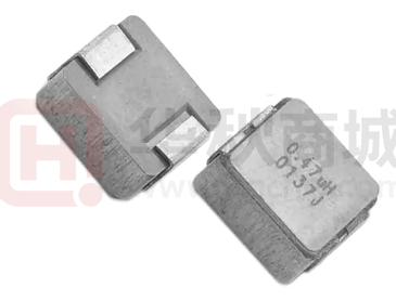

    固定电感器 IND_6.86X6.47MM_SM 100nH ±20% 32.5A 6.86 x 6.47mm -
IHLP2525CZERR10M01 数据手册
For Automotive Grade / Higher Temperature Upgrade to IHLP-2525CZ-5A IHLP-2525CZ-01 www.vishay.com Vishay Dale IHLP® Commercial Inductors, High Saturation Series FEATURES • Lowest height (3.0 mm) in this package footprint • Shielded construction • Excellent DC/DC energy storage up to 5 MHz. Filter inductor applications up to SRF (see “Standard Electrical Specifications” table) • Lowest DCR/μH, in this package size • Handles high transient current spikes without saturation • Ultra low buzz noise, due to composite construction • IHLP design; PATENT(S): www.vishay.com/patents • Material categorization: for definitions of compliance please see www.vishay.com/doc?99912 LINKS TO ADDITIONAL RESOURCES 3D 3D 3D Models Design Tools STANDARD ELECTRICAL SPECIFICATIONS L0 INDUCTANCE HEAT ± 20 % DCR DCR RATING SATURATION AT 100 kHz, TYP. MAX. CURRENT CURRENT SRF 0.25 V, 0 A 25 °C 25 °C DC TYP. DC TYP. TYP. (1) (2) (A) (μH) (mΩ) (mΩ) (A) (MHz) 0.10 1.5 1.7 32.5 60 400 0.15 1.9 2.5 26 52 180 0.20 2.4 3.0 24 41 150 0.22 2.5 2.8 23 40 126 0.33 3.5 3.9 20 30 100 0.47 4 4.2 17.5 26 75 0.68 5 5.5 15.5 25 62 0.82 6.7 8 13 24 60 1.0 9 10 11 22 55 1.5 14 15 9 18 40 2.2 18 20 8 14 38 3.3 28 30 6 13.5 30 4.7 37 40 5.5 10 25 6.8 54 60 4.5 8 21 8.2 64 68 4 7.5 17 10 102 105 3 7.0 16 Notes • All test data is referenced to 25 °C ambient • Operating temperature range -55 °C to +125 °C • The part temperature (ambient + temp. rise) should not exceed 125 °C under worst case operating conditions. Circuit design, component placement, PWB trace size and thickness, airflow and other cooling provisions all affect the part temperature. Part temperature should be verified in the end application. • Rated operating voltage (across inductor) = 75 V (1) DC current (A) that will cause an approximate ΔT of 40 °C (2) DC current (A) that will cause L to drop approximately 20 % 0 APPLICATIONS • • • • • • PDA / notebook / desktop / server applications High current POL converters Low profile, high current power supplies Battery powered devices DC/DC converters in distributed power systems DC/DC converter for field programmable gate array (FPGA) DIMENSIONS in inches [millimeters] 0.255 ± 0.010 [6.47 ± 0.254] Typical Pad Layout (Min.) 0.255 ± 0.010 [6.47 ± 0.254] 0.125 ± 0.01 [3.18 ± 0.3] 0.135 [3.429] 0.135 [3.429] 0.325 [8.255] 0.270 ± 0.015 [6.86 ± 0.381] 0.118 [3.0] Max. 0.050 ± 0.012 [1.27 ± 0.30] DESCRIPTION 1.0 μH IHLP-2525CZ-01 MODEL ± 20 % INDUCTANCE VALUE ER INDUCTANCE TOLERANCE e3 PACKAGE CODE JEDEC® LEAD (Pb)-FREE STANDARD GLOBAL PART NUMBER I H L PRODUCT FAMILY P 2 5 2 5 SIZE C Z E R PACKAGE CODE 1 R 0 INDUCTANCE VALUE M TOL. 0 1 SERIES PATENT(S): www.vishay.com/patents This Vishay product is protected by one or more United States and international patents. Revision: 16-Oct-2020 Document Number: 34104 1 For technical questions, contact: magnetics@vishay.com THIS DOCUMENT IS SUBJECT TO CHANGE WITHOUT NOTICE. THE PRODUCTS DESCRIBED HEREIN AND THIS DOCUMENT ARE SUBJECT TO SPECIFIC DISCLAIMERS, SET FORTH AT www.vishay.com/doc?91000 For Automotive Grade / Higher Temperature Upgrade to IHLP-2525CZ-5A IHLP-2525CZ-01 www.vishay.com Vishay Dale PERFORMANCE GRAPHS 0.15 µH 0.10 µH 0.120 100 0.16 100 ΔT °C 80 L 0.080 60 0.060 40 0.040 20 0.020 L 0.12 0.10 80 60 0.08 40 0.06 0.04 20 TEMPERATURE (°C) 0.100 INDUCTANCE (µH) 0.14 TEMPERATURE (°C) INDUCTANCE (µH) ΔT °C 0.02 30 20 40 50 60 0 0.00 0 10 0 20 DC CURRENT (A) 30 40 DC CURRENT (A) 0.20 µH 0.22 µH 100 0.25 100 0.25 80 0.20 L 0.15 60 0.10 40 0.05 20 0 0 10 5 15 20 25 80 0.20 L 0.15 60 0.10 40 0.05 20 0.00 40 35 30 INDUCTANCE (µH) ΔT °C TEMPERATURE (°C) INDUCTANCE (µH) ΔT °C 0.00 0 5 10 15 20 25 30 0 40 35 DC CURRENT (A) DC CURRENT (A) 0.33 µH 0.47 µH 0.50 0.6 100 0.45 80 0.35 0.30 60 L 0.25 0.20 40 0.15 0.10 20 INDUCTANCE (µH) ΔT °C 0.40 100 ΔT °C TEMPERATURE (°C) INDUCTANCE (µH) 50 TEMPERATURE (°C) 10 0 0.5 80 L 0.4 60 0.3 40 0.2 20 0.1 TEMPERATURE (°C) 0.000 0.05 0.00 5 15 10 20 0.0 0 30 25 0 5 10 0.68 µH 25 0 0.82 µH ΔT °C 80 0.6 L 0.5 60 0.4 40 0.3 0.2 20 0.1 100 ΔT °C 0.8 INDUCTANCE (µH) 0.7 0.9 100 TEMPERATURE (°C) 0.8 INDUCTANCE (µH) 20 DC CURRENT (A) DC CURRENT (A) 0.0 15 L 0.7 80 0.6 60 0.5 0.4 40 0.3 0.2 20 TEMPERATURE (°C) 0 0.1 0 5 10 15 DC CURRENT (A) Revision: 16-Oct-2020 20 25 0 0.0 0 5 10 15 20 0 25 DC CURRENT (A) Document Number: 34104 2 For technical questions, contact: magnetics@vishay.com THIS DOCUMENT IS SUBJECT TO CHANGE WITHOUT NOTICE. THE PRODUCTS DESCRIBED HEREIN AND THIS DOCUMENT ARE SUBJECT TO SPECIFIC DISCLAIMERS, SET FORTH AT www.vishay.com/doc?91000 For Automotive Grade / Higher Temperature Upgrade to IHLP-2525CZ-5A IHLP-2525CZ-01 www.vishay.com Vishay Dale PERFORMANCE GRAPHS 1.00 µH 1.5 µH 1.2 1.6 100 ΔT °C 60 0.6 40 0.4 20 0.2 L 80 1.2 1.0 60 0.8 40 0.6 0.4 20 TEMPERATURE (°C) 0.8 INDUCTANCE (µH) 80 L TEMPERATURE (°C) INDUCTANCE (µH) 1.0 0.0 100 ΔT °C 1.4 0.2 5 0 15 10 0.0 0 20 0 2 4 6 12 10 8 14 16 18 0 DC CURRENT (A) DC CURRENT (A) 2.2 µH 3.3 µH 2.5 ΔT °C 100 3.5 100 ΔT °C 60 1.0 40 20 0.5 60 2.0 1.5 40 1.0 20 0.5 0.0 0 2 0 6 4 8 10 12 14 0 2 4 6 4.7 µH 6.8 µH 5.0 9.0 100 ΔT °C 4.5 100 ΔT °C 80 L 3.5 3.0 60 2.5 2.0 40 1.5 1.0 20 80 7.0 6.0 L 60 5.0 4.0 40 3.0 2.0 20 TEMPERATURE (°C) 4.0 INDUCTANCE (µH) 8.0 TEMPERATURE (°C) INDUCTANCE (µH) 0 12 10 DC CURRENT (A) DC CURRENT (A) 1.0 0.5 0 0.0 0 1 4 3 2 6 5 7 8 9 0.0 10 0 1 2 3 4 6 5 8 7 0 DC CURRENT (A) DC CURRENT (A) 10.0 µH 8.2 µH 100 ΔT °C 100 ΔT °C L 7.0 80 6.0 60 5.0 4.0 40 3.0 2.0 20 INDUCTANCE (µH) 8.0 10.0 TEMPERATURE (°C) 9.0 INDUCTANCE (µH) 8 8.0 80 L 6.0 60 4.0 40 2.0 20 TEMPERATURE (°C) 0.0 80 L 2.5 TEMPERATURE (°C) 1.5 INDUCTANCE (µH) L TEMPERATURE (°C) INDUCTANCE (µH) 3.0 80 2.0 1.0 0.0 0 1 2 3 4 5 6 DC CURRENT (A) Revision: 16-Oct-2020 7 8 9 0 0.0 0 1 2 3 4 5 6 7 0 DC CURRENT (A) Document Number: 34104 3 For technical questions, contact: magnetics@vishay.com THIS DOCUMENT IS SUBJECT TO CHANGE WITHOUT NOTICE. THE PRODUCTS DESCRIBED HEREIN AND THIS DOCUMENT ARE SUBJECT TO SPECIFIC DISCLAIMERS, SET FORTH AT www.vishay.com/doc?91000 For Automotive Grade / Higher Temperature Upgrade to IHLP-2525CZ-5A IHLP-2525CZ-01 www.vishay.com Vishay Dale PERFORMANCE GRAPHS: INDUCTANCE AND Q VS. FREQUENCY 80 Q 0.12 60 L 0.08 40 0.04 20 0 10 75 L 0.2 50 0.1 25 0 0 1000 100 0.3 0.1 1 FREQUENCY (MHz) 0.2 40 0.1 20 0 0.1 1 10 Q 0.4 0.3 60 0.2 40 0.1 20 0.1 1 FREQUENCY (MHz) 60 0.5 40 0.25 20 0 10 INDUCTANCE (μH) 80 Q Q INDUCTANCE (μH) L 1 80 40 0.5 20 0 0.1 1 50 1 25 0 0 10 FREQUENCY (MHz) Revision: 16-Oct-2020 100 INDUCTANCE (μH) L Q INDUCTANCE (μH) 75 Q 1 100 0.82 µH 4 100 3 0.1 10 FREQUENCY (MHz) 0.68 µH 2 60 L Q 1 0 0 1000 100 100 1.5 FREQUENCY (MHz) 4 0 1000 100 0.47 µH 2 100 0.75 0.1 10 FREQUENCY (MHz) 0.33 µH 1 80 0 0 1000 100 100 L Q 60 Q INDUCTANCE (μH) 0.3 Q INDUCTANCE (μH) 80 L 0.22 µH 0.5 100 0.4 0 1000 100 FREQUENCY (MHz) 0.20 µH 0.5 10 Q 1 100 Q 100 3 75 Q 2 L 50 1 Q 0.1 INDUCTANCE (μH) 0.16 0.15 µH 0.4 Q INDUCTANCE (μH) 100 Q 0.10 µH 0.2 25 0 0 0.1 1 10 100 FREQUENCY (MHz) Document Number: 34104 4 For technical questions, contact: magnetics@vishay.com THIS DOCUMENT IS SUBJECT TO CHANGE WITHOUT NOTICE. THE PRODUCTS DESCRIBED HEREIN AND THIS DOCUMENT ARE SUBJECT TO SPECIFIC DISCLAIMERS, SET FORTH AT www.vishay.com/doc?91000 For Automotive Grade / Higher Temperature Upgrade to IHLP-2525CZ-5A IHLP-2525CZ-01 www.vishay.com Vishay Dale PERFORMANCE GRAPHS: INDUCTANCE AND Q VS. FREQUENCY 1.0 µH 5 1.5 µH 5 100 100 60 L Q 2 40 1 20 0 10 60 2 40 1 20 100 0 0.1 1 FREQUENCY (MHz) 4 20 0 10 15 60 Q L 10 40 5 20 0 0 1 0 0.1 100 FREQUENCY (MHz) 20 2.5 10 0 INDUCTANCE (μH) 30 Q INDUCTANCE (μH) L 5 1 10 6.8 µH L 20 40 10 20 0 0.1 15 30 10 20 5 10 0 0 10 FREQUENCY (MHz) Revision: 16-Oct-2020 100 INDUCTANCE (μH) 40 Q INDUCTANCE (μH) L 1 10 100 10 µH 80 60 50 0.1 1 FREQUENCY (MHz) 25 20 60 Q 100 8.2 µH Q 80 30 FREQUENCY (MHz) 30 100 0 0 0.1 10 40 40 Q 7.5 1 FREQUENCY (MHz) 4.7 µH 10 80 Q 40 INDUCTANCE (μH) L 8 Q INDUCTANCE (μH) 60 Q 3.3 µH 20 80 12 0.1 100 FREQUENCY (MHz) 2.2 µH 16 10 Q 1 3 0 0 0.1 80 Q 80 60 60 Q L 40 40 20 20 0 Q 3 4 Q 80 INDUCTANCE (μH) 4 Q INDUCTANCE (μH) L 0 0.1 1 10 100 FREQUENCY (MHz) Document Number: 34104 5 For technical questions, contact: magnetics@vishay.com THIS DOCUMENT IS SUBJECT TO CHANGE WITHOUT NOTICE. THE PRODUCTS DESCRIBED HEREIN AND THIS DOCUMENT ARE SUBJECT TO SPECIFIC DISCLAIMERS, SET FORTH AT www.vishay.com/doc?91000 Legal Disclaimer Notice www.vishay.com Vishay Disclaimer ALL PRODUCT, PRODUCT SPECIFICATIONS AND DATA ARE SUBJECT TO CHANGE WITHOUT NOTICE TO IMPROVE RELIABILITY, FUNCTION OR DESIGN OR OTHERWISE. Vishay Intertechnology, Inc., its affiliates, agents, and employees, and all persons acting on its or their behalf (collectively, “Vishay”), disclaim any and all liability for any errors, inaccuracies or incompleteness contained in any datasheet or in any other disclosure relating to any product. Vishay makes no warranty, representation or guarantee regarding the suitability of the products for any particular purpose or the continuing production of any product. To the maximum extent permitted by applicable law, Vishay disclaims (i) any and all liability arising out of the application or use of any product, (ii) any and all liability, including without limitation special, consequential or incidental damages, and (iii) any and all implied warranties, including warranties of fitness for particular purpose, non-infringement and merchantability. Statements regarding the suitability of products for certain types of applications are based on Vishay's knowledge of typical requirements that are often placed on Vishay products in generic applications. Such statements are not binding statements about the suitability of products for a particular application. It is the customer's responsibility to validate that a particular product with the properties described in the product specification is suitable for use in a particular application. Parameters provided in datasheets and / or specifications may vary in different applications and performance may vary over time. All operating parameters, including typical parameters, must be validated for each customer application by the customer's technical experts. Product specifications do not expand or otherwise modify Vishay's terms and conditions of purchase, including but not limited to the warranty expressed therein. Hyperlinks included in this datasheet may direct users to third-party websites. These links are provided as a convenience and for informational purposes only. Inclusion of these hyperlinks does not constitute an endorsement or an approval by Vishay of any of the products, services or opinions of the corporation, organization or individual associated with the third-party website. Vishay disclaims any and all liability and bears no responsibility for the accuracy, legality or content of the third-party website or for that of subsequent links. Except as expressly indicated in writing, Vishay products are not designed for use in medical, life-saving, or life-sustaining applications or for any other application in which the failure of the Vishay product could result in personal injury or death. Customers using or selling Vishay products not expressly indicated for use in such applications do so at their own risk. Please contact authorized Vishay personnel to obtain written terms and conditions regarding products designed for such applications. No license, express or implied, by estoppel or otherwise, to any intellectual property rights is granted by this document or by any conduct of Vishay. Product names and markings noted herein may be trademarks of their respective owners. © 2022 VISHAY INTERTECHNOLOGY, INC. ALL RIGHTS RESERVED Revision: 01-Jan-2022 1 Document Number: 91000
