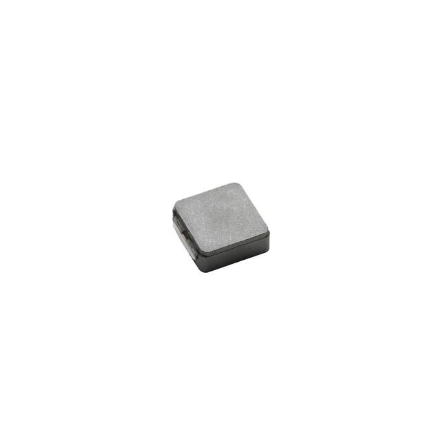

IHLP-4040DZ-01 www.vishay.com Vishay Dale IHLP® Commercial Inductors, High Saturation Series FEATURES • • • • Shielded construction Frequency range up to 5.0 MHz Lowest DCR/μH, in this package size Handles high transient current spikes without saturation • Ultra low buzz noise, due to composite construction • IHLP design; PATENT(S): www.vishay.com/patents • Material categorization: for definitions of compliance please see www.vishay.com/doc?99912 LINKS TO ADDITIONAL RESOURCES 3D 3D 3D Models Design Tools APPLICATIONS • • • • • • STANDARD ELECTRICAL SPECIFICATIONS L0 INDUCTANCE ± 20 % AT 100 kHz, 0.25 V, 0 A (μH) DCR TYP. 25 °C (mΩ) HEAT RATING SATURATION DCR MAX. CURRENT CURRENT 25 °C DC TYP. DC TYP. (A) (1) (mΩ) (A) (2) 0.19 0.875 0.95 40.0 90.0 0.36 1.30 1.40 31.5 60.0 0.56 1.80 1.95 27.5 49.0 1.0 3.70 4.10 17.5 36.0 1.5 5.30 5.80 15.0 27.5 2.2 8.20 9.00 12.0 25.6 3.3 13.70 14.40 10.0 18.6 4.7 15.00 16.50 9.5 17.0 5.6 17.60 19.30 8.5 16.0 6.8 21.20 23.30 8.0 13.5 10 33.20 36.50 6.8 12.0 22 74.3 79.90 4.6 10.0 PDA / notebook / desktop / server applications High current POL converters Low profile, high current power supplies Battery powered devices DC/DC converters in distributed power systems DC/DC converter for field programmable gate array (FPGA) DIMENSIONS in inches [millimeters] 0.400 ± 0.005 [10.160 ± 0.127] 0.400 ± 0.005 [10.160 ± 0.127] 0.158 [4.0] max. 0.158 [4.0] max. 0.079 ± 0.01 [2.0 ± 0.3] 0.400 ± 0.005 [10.160 ± 0.127] 0.425 ± 0.01 [10.795 ± 0.3] Notes • All test data is referenced to 25 °C ambient • Operating temperature range -55 °C to +125 °C • The part temperature (ambient + temp. rise) should not exceed 125 °C under worst case operating conditions. Circuit design, component placement, PWB trace size and thickness, airflow and other cooling provisions all affect the part temperature. Part temperature should be verified in the end application • Rated operating voltage (across inductor) = 75 V (1) DC current (A) that will cause an approximate ΔT of 40 °C (2) DC current (A) that will cause L to drop approximately 20 % 0 0.079 ± 0.01 [2.0 ± 0.3] 0.400 ± 0.005 [10.160 ± 0.127] 0.425 ± 0.01 [10.795 ± 0.3] 0.118 ± 0.01 [3.0 ± 0.3] Typical Pad Layout 0.475 [12.065] 0.128 [3.251] 0.185 ± 0.01 [4.7 ± 0.3] Typical Pad Layout 0.480 [12.192] 0.195 [4.953] 0.229 [5.817] The diagram above applies to values 1.0 μH and above. 0.230 [5.842] The diagram above applies to values 0.56 μH and below. DESCRIPTION IHLP-4040DZ-01 6.8 μH ± 20 % ER e3 MODEL INDUCTANCE VALUE INDUCTANCE TOLERANCE PACKAGE CODE JEDEC® LEAD (Pb)-FREE STANDARD GLOBAL PART NUMBER I H L PRODUCT FAMILY P 4 0 4 0 SIZE D Z E R PACKAGE CODE 6 R INDUCTANCE VALUE 8 M TOL. 0 1 SERIES PATENT(S): www.vishay.com/patents This Vishay product is protected by one or more United States and international patents. Revision: 27-Aug-2021 Document Number: 34193 1 For technical questions, contact: magnetics@vishay.com THIS DOCUMENT IS SUBJECT TO CHANGE WITHOUT NOTICE. THE PRODUCTS DESCRIBED HEREIN AND THIS DOCUMENT ARE SUBJECT TO SPECIFIC DISCLAIMERS, SET FORTH AT www.vishay.com/doc?91000 IHLP-4040DZ-01 www.vishay.com Vishay Dale PERFORMANCE GRAPHS 0.19 μH 0.36 μH 100 ΔT °C 75 50 0.10 0.05 25 0 10 15 20 25 30 35 40 45 50 55 60 65 70 75 0.2 40 0.1 20 0.0 0 10 20 30 1.25 80 1.00 60 L 0.30 40 0.15 20 30 40 50 INDUCTANCE (μH) 0.45 TEMPERATURE (°C) INDUCTANCE (μH) 0.60 20 80 0.75 60 0.50 40 0.25 20 0.00 0 0 10 20 ΔT °C L 60 1.0 50 0.8 40 0.6 30 0.4 20 0.2 10 15 20 25 30 INDUCTANCE (μH) 70 1.2 100 2.5 TEMPERATURE (°C) INDUCTANCE (μH) 80 1.4 0 2.0 80 ΔT °C 60 1.0 40 0.5 20 0.0 0 5 10 15 100 5 2 50 1 25 15 DC CURRENT (A) Revision: 27-Aug-2021 20 25 0 INDUCTANCE (μH) L TEMPERATURE (°C) INDUCTANCE (μH) 75 3 100 ΔT °C ΔT °C 10 0 30 25 4.7 μH 3.3 μH 5 20 DC CURRENT (A) 4 0 L 1.5 DC CURRENT (A) 0 0 50 40 90 1.6 10 30 2.2 μH 100 5 100 L 1.5 μH 0 0 DC CURRENT (A) 2.0 0.0 70 ΔT °C DC BIAS (A) 1.8 60 TEMPERATURE (°C) 100 ΔT °C 10 50 1.0 μH 0.56 μH 0.75 0 40 DC BIAS (A) DC CURRENT (A) 0.00 60 L TEMPERATURE (°C) 5 0.3 80 4 L 3 60 2 40 1 20 0 0 2 4 6 8 10 12 14 16 18 20 22 24 TEMPERATURE (°C) 0 80 0.4 TEMPERATURE (°C) L INDUCTANCE (μH) ΔT °C 0.15 0.00 100 0.5 TEMPERATURE (°C) INDUCTANCE (μH) 0.20 0 DC CURRENT (A) Document Number: 34193 2 For technical questions, contact: magnetics@vishay.com THIS DOCUMENT IS SUBJECT TO CHANGE WITHOUT NOTICE. THE PRODUCTS DESCRIBED HEREIN AND THIS DOCUMENT ARE SUBJECT TO SPECIFIC DISCLAIMERS, SET FORTH AT www.vishay.com/doc?91000 IHLP-4040DZ-01 www.vishay.com Vishay Dale PERFORMANCE GRAPHS 5.6 μH 6.0 80 6.0 4.5 60 L 3.0 40 1.5 20 0 5 10 15 20 80 L 4.5 60 3.0 40 1.5 20 0.0 0 0 2 4 10 μH 8 30 80 24 L 6 60 4 40 2 20 2 4 6 8 DC CURRENT (A) Revision: 27-Aug-2021 10 12 0 14 INDUCTANCE (µH) ΔT °C 100 TEMPERATURE (°C) INDUCTANCE (μH) 10 0 6 8 10 12 14 0 16 DC CURRENT (A) DC CURRENT (A) 0 100 ΔT °C 22 µH 100 ΔT °C 80 L 18 60 12 40 6 20 0 0 2 4 6 8 10 TEMPERATURE (°C) 0.0 INDUCTANCE (μH) ΔT °C TEMPERATURE (°C) 7.5 TEMPERATURE (°C) INDUCTANCE (μH) 6.8 μH 100 7.5 0 DC CURRENT (A) Document Number: 34193 3 For technical questions, contact: magnetics@vishay.com THIS DOCUMENT IS SUBJECT TO CHANGE WITHOUT NOTICE. THE PRODUCTS DESCRIBED HEREIN AND THIS DOCUMENT ARE SUBJECT TO SPECIFIC DISCLAIMERS, SET FORTH AT www.vishay.com/doc?91000 Legal Disclaimer Notice www.vishay.com Vishay Disclaimer ALL PRODUCT, PRODUCT SPECIFICATIONS AND DATA ARE SUBJECT TO CHANGE WITHOUT NOTICE TO IMPROVE RELIABILITY, FUNCTION OR DESIGN OR OTHERWISE. Vishay Intertechnology, Inc., its affiliates, agents, and employees, and all persons acting on its or their behalf (collectively, “Vishay”), disclaim any and all liability for any errors, inaccuracies or incompleteness contained in any datasheet or in any other disclosure relating to any product. Vishay makes no warranty, representation or guarantee regarding the suitability of the products for any particular purpose or the continuing production of any product. To the maximum extent permitted by applicable law, Vishay disclaims (i) any and all liability arising out of the application or use of any product, (ii) any and all liability, including without limitation special, consequential or incidental damages, and (iii) any and all implied warranties, including warranties of fitness for particular purpose, non-infringement and merchantability. Statements regarding the suitability of products for certain types of applications are based on Vishay's knowledge of typical requirements that are often placed on Vishay products in generic applications. Such statements are not binding statements about the suitability of products for a particular application. It is the customer's responsibility to validate that a particular product with the properties described in the product specification is suitable for use in a particular application. Parameters provided in datasheets and / or specifications may vary in different applications and performance may vary over time. All operating parameters, including typical parameters, must be validated for each customer application by the customer's technical experts. Product specifications do not expand or otherwise modify Vishay's terms and conditions of purchase, including but not limited to the warranty expressed therein. Hyperlinks included in this datasheet may direct users to third-party websites. These links are provided as a convenience and for informational purposes only. Inclusion of these hyperlinks does not constitute an endorsement or an approval by Vishay of any of the products, services or opinions of the corporation, organization or individual associated with the third-party website. Vishay disclaims any and all liability and bears no responsibility for the accuracy, legality or content of the third-party website or for that of subsequent links. Except as expressly indicated in writing, Vishay products are not designed for use in medical, life-saving, or life-sustaining applications or for any other application in which the failure of the Vishay product could result in personal injury or death. Customers using or selling Vishay products not expressly indicated for use in such applications do so at their own risk. Please contact authorized Vishay personnel to obtain written terms and conditions regarding products designed for such applications. No license, express or implied, by estoppel or otherwise, to any intellectual property rights is granted by this document or by any conduct of Vishay. Product names and markings noted herein may be trademarks of their respective owners. © 2021 VISHAY INTERTECHNOLOGY, INC. ALL RIGHTS RESERVED Revision: 09-Jul-2021 1 Document Number: 91000
IHLP4040DZET2R2M01
物料型号:IHLP-4040DZ-01
器件简介:Vishay Dale的IHLP®商用电感器,高饱和系列,具有屏蔽构造,频率范围高达5.0 MHz,具有该封装尺寸中最低的直流电阻/微亨比,能够处理高瞬态电流尖峰而不饱和,由于复合构造而具有超低的噪音。
引脚分配:文档中没有提供具体的引脚分配信息。
参数特性: - 电感值范围从0.19μH到22μH,公差为±20%。 - 在25°C时的典型直流电阻(DCR)从0.875 mΩ到74.3 mΩ不等。 - 最大直流电阻(DCR)从0.95 mΩ到79.90 mΩ不等。 - 热额定电流从9.5A到40A不等。 - 饱和电流从12A到90A不等。
功能详解:电感器设计用于多种应用,包括PDA、笔记本电脑、台式机、服务器应用、高电流点对点(POL)转换器、低剖面高电流电源、电池供电设备和分布式电源系统中的DC/DC转换器。
应用信息:适用于FPGA的DC/DC转换器。
封装信息:尺寸以英寸和毫米为单位提供,包括电感器的长、宽、高以及典型焊盘布局。
