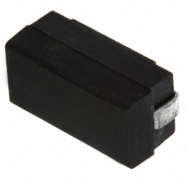

    固定电感器 Nonstandard 15µH ±20% 12.5A 19.9mΩ
IHLP6767GZER150M01 数据手册
IHLP-6767GZ-1A www.vishay.com Vishay Dale IHLP® Automotive Inductors, Low DCR Series FEATURES • Shielded construction • Excellent DC/DC energy storage up to 1 MHz to 2 MHz. Filter inductor applications up to SRF (see “Standard Electrical Specifications” table) LINKS TO ADDITIONAL RESOURCES • Lowest DCR/μH, in this package size 3D 3D 3D Models • Handles high transient current spikes without saturation Design Tools • Ultra low buzz noise, due to composite construction STANDARD ELECTRICAL SPECIFICATIONS L0 INDUCTANCE ± 20 % AT 100 kHz, 0.25 V, 0 A (μH) DCR TYP. 25 °C (mΩ) DCR MAX. 25 °C (mΩ) 0.33 0.47 0.56 0.82 1.0 1.5 2.2 3.3 4.7 5.6 6.8 8.2 10.0 15.0 22.0 33.0 47.0 56.0 68.0 82.0 100.0 0.67 0.78 0.83 0.98 1.21 1.54 1.85 2.79 3.98 4.23 5.86 7.71 8.89 13.7 20.0 35.1 40.7 55 72.1 87.3 105 0.73 0.87 0.91 1.08 1.27 1.62 1.98 2.93 4.18 4.44 6.15 8.10 9.33 14.4 21.0 37.0 42.7 57.8 75.7 91.7 110 HEAT RATING SATURATION CURRENT CURRENT SRF DC TYP. DC TYP. TYP. (A) (1) (A) (2) (MHz) 75.5 72 61 56.5 55.5 48 43.5 35 30 28 22.5 21 19 14 12 10.7 8.7 7.2 6.1 5.5 5.0 55 57 66 45 32 31 28 27 21 21 18.5 18 17 12 9.5 9 8.6 4.2 4.5 4.5 4.0 78 60 40 36 34 26 19 16 10.7 11.8 10.0 10.0 8.0 7.5 4.3 4.8 4.1 2.9 3.0 2.6 2.1 Notes • All test data is referenced to 25 °C ambient • Operating temperature range -55 °C to +125 °C • The part temperature (ambient + temp. rise) should not exceed 125 °C under worst case operating conditions. Circuit design, component placement, PWB trace size and thickness, airflow and other cooling provisions all affect the part temperature. Part temperature should be verified in the end application • Rated operating voltage (across inductor) = 50 V (1) DC current (A) that will cause an approximate ΔT of 40 °C (2) DC current (A) that will cause L to drop approximately 20 % 0 Revision: 22-Apr-2025 • AEC-Q200 qualified • Material categorization: for definitions of compliance please see www.vishay.com/doc?99912 APPLICATIONS • Engine and transmission control units • Diesel injection drivers • DC/DC converters for entertainment / navigation systems • Noise suppression for motors: windshield wipers / power seats / power mirrors / heating and ventilation blower / HID lighting • LED drivers DIMENSIONS in inches [millimeters] Typical pad layout 0.715 [18.16] 0.490 [12.45] 0.675 [17.15] max. 0.489 [12.41] 0.276 [7.00] max. 0.083 ± 0.010 [2.108 ± 0.254] 0.520 ± 0.010 [13.208 ± 0.254] 0.470 ± 0.010 [11.938 ± 0.254] 0.675 ± 0.010 [17.150 ± 0.254 ] Document Number: 34310 1 For technical questions, contact: magnetics@vishay.com THIS DOCUMENT IS SUBJECT TO CHANGE WITHOUT NOTICE. THE PRODUCTS DESCRIBED HEREIN AND THIS DOCUMENT ARE SUBJECT TO SPECIFIC DISCLAIMERS, SET FORTH AT www.vishay.com/doc?91000 IHLP-6767GZ-1A www.vishay.com Vishay Dale DESCRIPTION IHLP-6767GZ-1A MODEL 4.7 μH ± 20 % INDUCTANCE VALUE EK INDUCTANCE TOLERANCE e3 PACKAGE CODE JEDEC® LEAD (Pb)-FREE STANDARD GLOBAL PART NUMBER I H L P 6 PRODUCT FAMILY 7 6 7 G SIZE Z E K 4 R 7 M PACKAGE CODE INDUCTANCE VALUE INDUCTANCE TOLERANCE EK = tape and reel 4R7 = 4.7 μH M = ± 20 % N = ± 30 % 1 A SERIES PACKAGE CODE OPTIONS EK = tape and reel packaging (250 pcs on 13-inch reel) ER = tape and reel packaging (200 pcs on 13-inch reel) Note • For additional packaging details see “Packaging Methods” Revision: 22-Apr-2025 Document Number: 34310 2 For technical questions, contact: magnetics@vishay.com THIS DOCUMENT IS SUBJECT TO CHANGE WITHOUT NOTICE. THE PRODUCTS DESCRIBED HEREIN AND THIS DOCUMENT ARE SUBJECT TO SPECIFIC DISCLAIMERS, SET FORTH AT www.vishay.com/doc?91000 IHLP-6767GZ-1A www.vishay.com Vishay Dale PERFORMANCE GRAPHS 0.33 µH 100 ΔT °C 40 0.1 20 60 80 100 120 0 0.4 40 0.2 20 0.0 0 30 DC CURRENT (A) 60 0.6 L 40 20 0.2 0 20 40 60 80 100 INDUCTANCE (μH) 80 0.8 0.0 0 L 0.8 80 0.6 60 0.4 40 0.2 20 0.0 0 10 20 0.6 60 0.4 40 0.2 20 10 20 30 40 50 60 70 80 90 INDUCTANCE (μH) 80 0 0 60 1.0 40 0.5 20 0.0 0 30 40 50 DC CURRENT (A) Revision: 22-Apr-2025 60 70 INDUCTANCE (μH) 1.5 20 80 90 0 100 ΔT °C 80 60 0.8 40 0.4 20 0 20 40 60 80 3.3 µH 5.0 TEMPERATURE (°C) INDUCTANCE (μH) 80 10 70 1.2 0.0 100 ΔT °C 2.0 0 60 0 DC CURRENT (A) 2.2 µH L 50 L 1.6 DC CURRENT (A) 2.5 40 1.5 µH 2.0 TEMPERATURE (°C) INDUCTANCE (μH) 100 ΔT °C 0.8 0.0 30 DC CURRENT (A) 1.0 µH L 0 100 ΔT °C DC CURRENT (A) 1.0 120 0.82 µH 1.0 TEMPERATURE (°C) INDUCTANCE (μH) 100 ΔT °C 0.4 90 DC CURRENT (A) 0.56 µH 1.0 60 TEMPERATURE (°C) 40 L TEMPERATURE (°C) 20 60 0.6 100 ΔT °C 80 4.0 L 3.0 60 2.0 40 1.0 20 0.0 0 10 20 30 40 50 60 TEMPERATURE (°C) 0 80 0.8 TEMPERATURE (°C) 60 INDUCTANCE (μH) 80 L 0.2 0.0 100 ΔT °C 0.4 0.3 0.47 µH 1.0 TEMPERATURE (°C) INDUCTANCE (μH) 0.5 0 DC CURRENT (A) Document Number: 34310 3 For technical questions, contact: magnetics@vishay.com THIS DOCUMENT IS SUBJECT TO CHANGE WITHOUT NOTICE. THE PRODUCTS DESCRIBED HEREIN AND THIS DOCUMENT ARE SUBJECT TO SPECIFIC DISCLAIMERS, SET FORTH AT www.vishay.com/doc?91000 IHLP-6767GZ-1A www.vishay.com Vishay Dale PERFORMANCE GRAPHS 4.7 µH 100 80 3.0 60 2.0 40 1.0 20 20 30 40 50 0 4.0 40 2.0 20 0.0 0 10 20 DC CURRENT (A) 100 8.2 µH 10.0 60 4.0 40 2.0 20 0.0 0 5 10 15 20 25 30 35 INDUCTANCE (μH) 6.0 TEMPERATURE (°C) INDUCTANCE (μH) 80 ΔT °C L 0 8.0 80 6.0 60 4.0 40 2.0 20 0.0 0 5 10 DC CURRENT (A) 6.0 60 4.0 40 2.0 20 0 5 10 15 20 25 30 INDUCTANCE (μH) 80 TEMPERATURE (°C) INDUCTANCE (μH) 8.0 0.0 25 16 60 8 40 4 20 0 5 10 15 20 40 10 20 DC CURRENT (A) Revision: 22-Apr-2025 15 20 0 INDUCTANCE (μH) 60 L 10 20 33 µH 50 TEMPERATURE (°C) INDUCTANCE (μH) 80 5 80 L 12 0 0 100 40 0 0 100 0 100 ΔT °C ΔT °C 0 35 DC CURRENT (A) 22 µH 30 30 ΔT °C DC CURRENT (A) 50 20 15 µH 20 100 ΔT °C L 15 DC CURRENT (A) 10 µH 10.0 0 100 ΔT °C L 8.0 40 DC CURRENT (A) 6.8 µH 10.0 30 TEMPERATURE (°C) 10 60 L TEMPERATURE (°C) 0 6.0 80 40 L 30 60 20 40 10 20 0 0 2 4 6 8 10 12 14 TEMPERATURE (°C) 0.0 80 8.0 TEMPERATURE (°C) ΔT °C 4.0 100 ΔT °C INDUCTANCE (μH) INDUCTANCE (μH) L 5.6 µH 10.0 TEMPERATURE (°C) 5.0 0 DC CURRENT (A) Document Number: 34310 4 For technical questions, contact: magnetics@vishay.com THIS DOCUMENT IS SUBJECT TO CHANGE WITHOUT NOTICE. THE PRODUCTS DESCRIBED HEREIN AND THIS DOCUMENT ARE SUBJECT TO SPECIFIC DISCLAIMERS, SET FORTH AT www.vishay.com/doc?91000 IHLP-6767GZ-1A www.vishay.com Vishay Dale PERFORMANCE GRAPHS 47 µH 30 60 20 40 10 20 6 8 10 12 14 0 60 60 40 40 20 20 0 0 2 4 DC CURRENT (A) 60 40 40 20 20 2 4 6 8 10 INDUCTANCE (μH) 80 L 0 0 80 80 60 60 40 40 20 20 0 0 1 2 3 4 5 6 7 8 0 DC CURRENT (A) 100 µH 200 INDUCTANCE (μH) 0 100 L DC CURRENT (A) 100 ΔT °C 80 160 60 120 L 80 40 20 40 0 12 ΔT °C 60 0 10 82 µH 100 TEMPERATURE (°C) INDUCTANCE (μH) 100 ΔT °C 80 8 DC CURRENT (A) 68 µH 100 6 TEMPERATURE (°C) 4 L 0 1 2 3 4 5 6 7 8 TEMPERATURE (°C) 2 80 80 TEMPERATURE (°C) 80 0 100 ΔT °C 40 0 56 µH 100 INDUCTANCE (μH) L INDUCTANCE (μH) 100 ΔT °C TEMPERATURE (°C) 50 0 DC CURRENT (A) Revision: 22-Apr-2025 Document Number: 34310 5 For technical questions, contact: magnetics@vishay.com THIS DOCUMENT IS SUBJECT TO CHANGE WITHOUT NOTICE. THE PRODUCTS DESCRIBED HEREIN AND THIS DOCUMENT ARE SUBJECT TO SPECIFIC DISCLAIMERS, SET FORTH AT www.vishay.com/doc?91000 IHLP-6767GZ-1A www.vishay.com Vishay Dale PERFORMANCE GRAPHS: INDUCTANCE AND Q VS. FREQUENCY 0.3 60 0.2 40 0.1 20 1 10 100 0.8 0.6 40 0.2 20 0.1 1 0.56 µH 0.4 40 0.2 20 0.1 1 10 100 INDUCTANCE (μH) 60 Q INDUCTANCE (μH) 80 Q 0.6 0 Q 40 0.5 20 5 80 4 0.1 1 60 Q 1 40 0.5 20 0.1 1 10 100 2 40 10 FREQUENCY (MHz) Revision: 22-Apr-2025 100 0 INDUCTANCE (μH) 80 Q INDUCTANCE (μH) L Q 1 80 Q L 60 2 40 1 20 0.1 1 10 100 3.3 µH 12 120 0.1 100 3 0 0 160 6 0 0 0 FREQUENCY (MHz) 2.2 µH 4 100 1.5 µH FREQUENCY (MHz) 8 10 Q L INDUCTANCE (μH) 100 Q INDUCTANCE (μH) 2 0 60 1 0 0 L FREQUENCY (MHz) 1.0 µH 1.5 0 80 1.5 FREQUENCY (MHz) 2.5 100 0.82 µH 2 100 L 0.8 10 FREQUENCY (MHz) FREQUENCY (MHz) 1 60 L 0.4 0 0 80 Q 0.1 100 Q 10 120 Q 100 L 8 80 6 60 4 40 2 20 0 0.1 1 10 100 Q 0 INDUCTANCE (μH) 80 L Q Q INDUCTANCE (μH) 0.4 0.47 µH 1 100 Q 0.33 µH 0.5 0 FREQUENCY (MHz) Document Number: 34310 6 For technical questions, contact: magnetics@vishay.com THIS DOCUMENT IS SUBJECT TO CHANGE WITHOUT NOTICE. THE PRODUCTS DESCRIBED HEREIN AND THIS DOCUMENT ARE SUBJECT TO SPECIFIC DISCLAIMERS, SET FORTH AT www.vishay.com/doc?91000 IHLP-6767GZ-1A www.vishay.com Vishay Dale PERFORMANCE GRAPHS: INDUCTANCE AND Q VS. FREQUENCY 12 60 8 40 4 20 1 10 100 60 8 40 4 20 0.1 1 FREQUENCY (MHz) 120 10 40 0.1 1 10 100 0 10 µH 40 10 20 0.1 20 40 10 20 0 0.1 1 10 INDUCTANCE (μH) 60 Q INDUCTANCE (μH) 30 1 40 40 20 20 0.1 1 40 20 0.1 1 FREQUENCY (MHz) Revision: 22-Apr-2025 10 0 INDUCTANCE (μH) L Q INDUCTANCE (μH) 60 40 0 10 33 µH 160 80 Q 80 60 0 FREQUENCY (MHz) 22 µH 120 0 80 L FREQUENCY (MHz) 160 100 Q 60 0 0 10 FREQUENCY (MH ) 15 µH 80 80 Q 60 20 L 40 80 Q 30 0 100 100 L 40 FREQUENCY (MHz) 50 0 Q 80 INDUCTANCE (μH) L 20 0 100 8.2 µH 50 Q INDUCTANCE (μH) Q 10 FREQUENCY (MHz) 6.8 µH 30 80 12 0 0 Q 16 Q 0.1 100 L 80 L Q 120 60 80 40 40 20 0 0.1 1 10 Q 0 INDUCTANCE (μH) 80 L Q INDUCTANCE (μH) Q 16 5.6 µH 20 100 Q 4.7 µH 20 0 FREQUENCY (MHz) Document Number: 34310 7 For technical questions, contact: magnetics@vishay.com THIS DOCUMENT IS SUBJECT TO CHANGE WITHOUT NOTICE. THE PRODUCTS DESCRIBED HEREIN AND THIS DOCUMENT ARE SUBJECT TO SPECIFIC DISCLAIMERS, SET FORTH AT www.vishay.com/doc?91000 IHLP-6767GZ-1A www.vishay.com Vishay Dale PERFORMANCE GRAPHS: INDUCTANCE AND Q VS. FREQUENCY Q 60 100 40 50 20 0.1 1 10 50 Q L 200 150 30 100 20 50 10 0 0 0.1 1 FREQUENCY (MHz) 40 150 30 100 20 50 10 0 0.1 INDUCTANCE (μH) Q 1 10 Q INDUCTANCE (μH) 200 50 L 82 µH 400 60 250 0 80 300 60 L Q 200 40 100 0 0 20 0.1 1 FREQUENCY (MHz) 10 0 FREQUENCY (MHz) 100 µH 400 INDUCTANCE (μH) 10 FREQUENCY (MHz) 68 µH 300 40 Q 0 250 60 80 L 300 60 Q 200 40 100 20 0 0.1 1 10 Q 150 80 L INDUCTANCE (μH) 200 56 µH 300 Q INDUCTANCE (μH) 100 Q 47 µH 250 0 FREQUENCY (MHz) Revision: 22-Apr-2025 Document Number: 34310 8 For technical questions, contact: magnetics@vishay.com THIS DOCUMENT IS SUBJECT TO CHANGE WITHOUT NOTICE. THE PRODUCTS DESCRIBED HEREIN AND THIS DOCUMENT ARE SUBJECT TO SPECIFIC DISCLAIMERS, SET FORTH AT www.vishay.com/doc?91000 Legal Disclaimer Notice www.vishay.com Vishay Disclaimer ALL PRODUCT, PRODUCT SPECIFICATIONS AND DATA ARE SUBJECT TO CHANGE WITHOUT NOTICE TO IMPROVE RELIABILITY, FUNCTION OR DESIGN OR OTHERWISE. Vishay Intertechnology, Inc., its affiliates, agents, and employees, and all persons acting on its or their behalf (collectively, “Vishay”), disclaim any and all liability for any errors, inaccuracies or incompleteness contained in any datasheet or in any other disclosure relating to any product. Vishay makes no warranty, representation or guarantee regarding the suitability of the products for any particular purpose or the continuing production of any product. To the maximum extent permitted by applicable law, Vishay disclaims (i) any and all liability arising out of the application or use of any product, (ii) any and all liability, including without limitation special, consequential or incidental damages, and (iii) any and all implied warranties, including warranties of fitness for particular purpose, non-infringement and merchantability. Statements regarding the suitability of products for certain types of applications are based on Vishay's knowledge of typical requirements that are often placed on Vishay products in generic applications. Such statements are not binding statements about the suitability of products for a particular application. It is the customer's responsibility to validate that a particular product with the properties described in the product specification is suitable for use in a particular application. Parameters provided in datasheets and / or specifications may vary in different applications and performance may vary over time. All operating parameters, including typical parameters, must be validated for each customer application by the customer's technical experts. Product specifications do not expand or otherwise modify Vishay's terms and conditions of purchase, including but not limited to the warranty expressed therein. Hyperlinks included in this datasheet may direct users to third-party websites. These links are provided as a convenience and for informational purposes only. Inclusion of these hyperlinks does not constitute an endorsement or an approval by Vishay of any of the products, services or opinions of the corporation, organization or individual associated with the third-party website. Vishay disclaims any and all liability and bears no responsibility for the accuracy, legality or content of the third-party website or for that of subsequent links. Vishay products are not designed for use in life-saving or life-sustaining applications or any application in which the failure of the Vishay product could result in personal injury or death unless specifically qualified in writing by Vishay. Customers using or selling Vishay products not expressly indicated for use in such applications do so at their own risk. Please contact authorized Vishay personnel to obtain written terms and conditions regarding products designed for such applications. No license, express or implied, by estoppel or otherwise, to any intellectual property rights is granted by this document or by any conduct of Vishay. Product names and markings noted herein may be trademarks of their respective owners. © 2026 VISHAY INTERTECHNOLOGY, INC. ALL RIGHTS RESERVED Revision: 01-Jan-2026 1 Document Number: 91000 THIS DOCUMENT IS SUBJECT TO CHANGE WITHOUT NOTICE. THE PRODUCTS DESCRIBED HEREIN AND THIS DOCUMENT ARE SUBJECT TO SPECIFIC DISCLAIMERS, SET FORTH AT www.vishay.com/doc?91000
