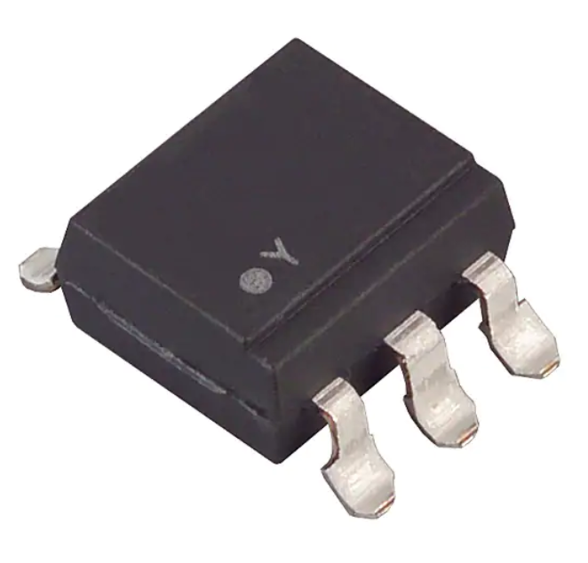

    光耦,光电双向晶闸管输出,过零, 高dV/dt,低输入电流
IL4108 数据手册
IL410, IL4108 Vishay Semiconductors Optocoupler, Phototriac Output, Zero Crossing, High dV/dt, Low Input Current A 1 6 MT2 C 2 5 NC FEATURES • High input sensitivity NC 3 ZCC* • IFT = 2 mA, PF = 1.0 4 MT1 • IFT = 5 mA, PF 1.0 *Zero crossing circuit i179030_4 21842-1 • 300 mA on-state current V D E DESCRIPTION • Zero voltage crossing detector The IL410 and IL4108 consists of a GaAs IRLED optically coupled to a photosensitive zero crossing TRIAC network. The TRIAC consists of two inverse parallel connected monolithic SCRs. These three semiconductors are assembled in a six pin dual in-line package. High input sensitivity is achieved by using an emitter follower phototransistor and a cascaded SCR predriver resulting in an LED trigger current of less than 2 mA (DC). The use of a proprietary dV/dt clamp results in a static dV/dt of greater than 10 kV/ms. This clamp circuit has a MOSFET that is enhanced when high dV/dt spikes occur between MT1 and MT2 of the TRIAC. When conducting, the FET clamps the base of the phototransistor, disabling the first stage SCR predriver. The zero cross line voltage detection circuit consists of two enhancement MOSFETS and a photodiode. The inhibit voltage of the network is determined by the enhancement voltage of the N-channel FET. The P-channel FET is enabled by a photocurrent source that permits the FET to conduct the main voltage to gate on the N-channel FET. Once the main voltage can enable the N-channel, it clamps the base of the phototransistor, disabling the first stage SCR predriver. The 600 V, 800 V blocking voltage permits control of off-line voltages up to 240 VAC, with a safety factor of more than two, and is sufficient for as much as 380 VAC. The IL410, IL4108 isolates low-voltage logic from 120 VAC, 240 VAC, and 380 VAC lines to control resistive, inductive, or capacitive loads including motors, solenoids, high current thyristors or TRIAC and relays. • 600 V, 800 V blocking voltage • High static dV/dt 10 kV/μs • Very low leakage < 10 A • Isolation test voltage 5300 VRMS • Small 6 pin DIP package • Compliant to RoHS Directive 2002/95/EC and in accordance to WEEE 2002/96/EC APPLICATIONS • Solid-state relays • Industrial controls • Office equipment • Consumer appliances AGENCY APPROVALS • UL1577, file no. E52744 system code H, double protection • CSA 93751 • DIN EN 60747-5-2 (VDE 0884)/DIN EN 60747-5-5 (pending), available with option 1 ORDERING INFORMATION DIP-# I L 4 1 0 # - X 0 # # T 7.62 mm Option 7 Option 6 PART NUMBER PACKAGE OPTION TAPE AND REEL 10.16 mm > 0.7 mm Option 9 Option 8 9.27 mm AGENCY CERTIFIED/PACKAGE UL DIP-6 DIP-6, 400 mil, option 6 SMD-6, option 7 SMD-6, option 8 SMD-6, option 9 VDE, UL DIP-6 DIP-6, 400 mil, option 6 SMD-6, option 7 SMD-6, option 9 Note (1) Also available in tubes, do not put T on the end. Document Number: 83627 Rev. 2.0, 29-Mar-11 > 0.1 mm BLOCKING VOLTAGE VDRM (V) 600 IL410 IL410-X006 IL410-X007T (1) IL410-X008T IL410-X009T (1) 600 IL410-X001 IL410-X016 IL410-X017 IL410-X019T (1) For technical questions, contact: optocoupleranswers@vishay.com 800 IL4108 IL4108-X006 IL4108-X007T (1) IL4108-X009T (1) 800 IL4108-X001 IL4108-X016 IL4108-X017 - www.vishay.com 1 This document is subject to change without notice. THE PRODUCTS DESCRIBED HEREIN AND THIS DOCUMENT ARE SUBJECT TO SPECIFIC DISCLAIMERS, SET FORTH AT www.vishay.com/doc?91000 IL410, IL4108 Vishay Semiconductors Optocoupler, Phototriac Output, Zero Crossing, High dV/dt, Low Input Current ABSOLUTE MAXIMUM RATINGS (Tamb = 25 °C, unless otherwise specified) PARAMETER TEST CONDITION PART SYMBOL VALUE UNIT VR IF 6 60 2.5 100 1.33 V mA A mW mW/°C 600 800 300 3 500 6.6 V V mA A mW mW/°C 5300 VRMS INPUT Reverse voltage Forward current Surge current Power dissipation Derate from 25 °C OUTPUT IFSM Pdiss IL410 IL4108 Peak off-state voltage RMS on-state current Single cycle surge current Total power dissipation Derate from 25 °C COUPLER VDRM VDRM ITM Pdiss Isolation test voltage between emitter and detector t=1s VISO Pollution degree (DIN VDE 0109) 2 Creepage distance 7 mm Clearance distance 7 mm Comparative tracking index per DIN IEC112/VDE 0303 part 1, group IIIa per DIN VDE 6110 Isolation resistance CTI  175 VIO = 500 V, Tamb = 25 °C RIO  1012 VIO = 500 V, Tamb = 100 °C RIO  1011  Tstg - 55 to + 150 °C Tamb - 55 to + 100 °C Tsld 260 °C Storage temperature range Ambient temperature Soldering temperature (1) max. 10 s dip soldering  0.5 mm from case bottom  Notes • Stresses in excess of the absolute maximum ratings can cause permanent damage to the device. Functional operation of the device is not implied at these or any other conditions in excess of those given in the operational sections of this document. Exposure to absolute maximum ratings for extended periods of the time can adversely affect reliability. (1) Refer to reflow profile for soldering conditions for surface mounted devices (SMD). Refer to wave profile for soldering conditions for through hole devices (DIP). www.vishay.com 2 For technical questions, contact: optocoupleranswers@vishay.com Document Number: 83627 Rev. 2.0, 29-Mar-11 This document is subject to change without notice. THE PRODUCTS DESCRIBED HEREIN AND THIS DOCUMENT ARE SUBJECT TO SPECIFIC DISCLAIMERS, SET FORTH AT www.vishay.com/doc?91000 IL410, IL4108 Optocoupler, Phototriac Output, Zero Crossing, Vishay Semiconductors High dV/dt, Low Input Current ELECTRICAL CHARACTERISTICS (Tamb = 25 °C, unless otherwise specified) PARAMETER TEST CONDITION PART SYMBOL MIN. TYP. MAX. UNIT INPUT Forward voltage IF = 10 mA VF 1.16 1.35 V Reverse current VR = 6 V IR 0.1 10 μA VF = 0 V, f = 1 MHz CIN 25 pF Rthja 750 °C/W Input capacitance Thermal resistance, junction to ambient OUTPUT Off-state current VD = VDRM, Tamb = 100 °C, IF = 0 mA IDRM 10 100 μA On-state voltage IT = 300 mA VTM 1.7 3 V Surge (non-repetitive), on-state current f = 50 Hz ITSM 3 A Trigger current 1 VD = 5 V IFT1 2 mA Trigger current 2 VD = 220 VRMS, f = 50 Hz, Tj = 100 °C, tpIF > 10 ms IFT2 6 mA 7 14 μA/°C 14 IFT1/Tj Trigger current temp. gradient Inhibit voltage temp. gradient Off-state current in inhibit state IF = IFT1, VD = VDRM Holding current Latching current Zero cross inhibit voltage Critical rate of rise of off-state voltage Critical rate of rise of voltage at current commutation Critical rate of rise of on-state current commutation IFT2/Tj 7 VDINH/Tj - 20 IDINH 50 200 μA IH 65 500 μA 500 μA μA/°C mV/°C VT = 2.2 V IL IF = rated IFT VIH VD = 0.67 VDRM, Tj = 25 °C dV/dtcr 10 000 V/μs VD = 0.67 VDRM, Tj = 80 °C dV/dtcr 5000 V/μs VD = 230 VRMS, ID = 300 mARMS, TJ = 25 °C dV/dtcrq 8 V/μs VD = 230 VRMS, ID = 300 mARMS, TJ = 85 °C dV/dtcrq 7 V/μs VD = 230 VRMS, ID = 300 mARMS, TJ = 25 °C dI/dtcrq 12 A/ms Rthja 150 °C/W Thermal resistance, junction to ambient 15 25 V COUPLER Critical rate of rise of coupled input/output voltage IT = 0 A, VRM = VDM = VDRM dVIO/dt Common mode coupling capacitance Capacitance (input to output) Isolation resistance 10 000 V/μs CCM 0.01 pF f = 1 MHz, VIO = 0 V CIO 0.8 pF VIO = 500 V, Tamb = 25 °C RIO  1012  VIO = 500 V, Tamb = 100 °C RIO  1011  Note • Minimum and maximum values are testing requirements. Typical values are characteristics of the device and are the result of engineering evaluation. Typical values are for information only and are not part of the testing requirements. SWITCHING CHARACTERISTICS (Tamb = 25 °C, unless otherwise specified) PARAMETER TEST CONDITION Turn-on time VRM = VDM = VDRM Document Number: 83627 Rev. 2.0, 29-Mar-11 PART SYMBOL ton For technical questions, contact: optocoupleranswers@vishay.com MIN. TYP. 35 MAX. UNIT μs www.vishay.com 3 This document is subject to change without notice. THE PRODUCTS DESCRIBED HEREIN AND THIS DOCUMENT ARE SUBJECT TO SPECIFIC DISCLAIMERS, SET FORTH AT www.vishay.com/doc?91000 IL410, IL4108 Vishay Semiconductors Optocoupler, Phototriac Output, Zero Crossing, High dV/dt, Low Input Current TYPICAL CHARACTERISTICS (Tamb = 25 °C, unless otherwise specified) 103 5 1.3 TA = - 55 °C 1.2 TA = 25 °C 1.1 1.0 TA = 85 °C 5 0.8 100 1 10 0 100 IF - Forward Current (mA) iil410_03 1 2 400 τ ITRMS = f(VT), RthJA = 150 K/W Device switch soldered in pcb or base plate. Duty Factor 300 t ITRMS (mA) 100 0.005 0.01 0.02 0.05 0.1 0.2 4 Fig. 4 - Typical Output Characteristics 10 000 1000 3 VT (V) iil410_06 Fig. 1 - Forward Voltage vs. Forward Current DF = τ/t 0.5 200 100 10 10-6 10-5 10-4 10-3 10-2 10-1 10 0 iil410_04 0 101 0 20 40 60 80 100 TA (°C) iil410_07 t - LED Pulse Duration (s) Fig. 2 - Peak LED Current vs. Duty Factor,  Fig. 5 - Current Reduction 150 400 300 100 ITRMS (mA) LED - LED Power (mW) IT = f(VT), Parameter: Tj 5 101 0.9 0.7 0.1 If(pk) - Peak LED Current (mA) Tj = 25 °C 100 °C 102 IT (mA) VF - Forward Voltage (V) 1.4 50 200 100 0 - 60 - 40 - 20 iil410_05 0 20 40 60 80 TA - Ambient Temperature (°C) Fig. 3 - Maximum LED Power Dissipation www.vishay.com 4 0 50 100 ITRMS = f(TPIN5), RthJ-PIN5 = 16.5 K/W Thermocouple measurement must be performed potentially separated to A1 and A2. Measuring junction as near as possible at the case. 60 70 80 90 100 TPIN5 (°C) iil410_08 Fig. 6 - Current Reduction For technical questions, contact: optocoupleranswers@vishay.com Document Number: 83627 Rev. 2.0, 29-Mar-11 This document is subject to change without notice. THE PRODUCTS DESCRIBED HEREIN AND THIS DOCUMENT ARE SUBJECT TO SPECIFIC DISCLAIMERS, SET FORTH AT www.vishay.com/doc?91000 IL410, IL4108 Optocoupler, Phototriac Output, Zero Crossing, Vishay Semiconductors High dV/dt, Low Input Current 103 0.6 tgd = f (IF/IFT 25 °C), VD = 200 V f = 40 to 60 Hz, Parameter: Tj 40 to 60 Hz Line operation, Ptot = f(ITRMS) 0.5 Ptot (W) fgd (µs) 0.4 102 Tj = 25 °C 100 °C 5 0.3 0.2 0.1 101 100 101 5 5 0 102 0 IF/IFT25 °C iil410_09 Fig. 7 - Typical Trigger Delay Time 12 300 Tj = 25 °C 100 °C V Tj = 25 °C 100 °C 10 VDINH min. (V) 102 5 101 5 200 ITRMS (mA) Fig. 9 - Power Dissipation 40 Hz to 60 Hz Line Operation 103 IDINH (µA) 100 iil410_11 8 VDINH min = f (IF/IFT25°C), parameter: Tj Device zero voltage switch can be triggered only in hatched are below Tj curves. 6 IDINH = f (IF /IFT 25 °C), VD = 600 V, Parameter: Tj 4 6 100 100 0 2 4 8 10 12 14 16 18 20 IF/IFT25 °C iil410_10 iil410_12 5 101 5 102 IF/IFT25 °C Fig. 10 - Typical Static Inhibit Voltage Limit Fig. 8 - Off-State Current in Inhibited State vs. IF/IFT 25 °C TRIGGER CURRENT VS. TEMPERATURE AND VOLTAGE The trigger current of the IL410, 4108 has a positive temperature gradient and also is dependent on the terminal voltage as shown as the fig. 11. For the operating voltage 250 VRMS over the temperature range - 40 °C to 85 °C, the IF should be at least 2.3 x of the IFT1 (2 mA, max.). Considering - 30 % degradation over time, the trigger current minimum is IF = 2 x 2.3 x 130 % = 6 mA 3.5 3.0 100 °C IFT (mA) 2.5 85 °C 2.0 1.5 25 °C 50 °C 1.0 0.5 0.0 0 50 100 21602 150 200 250 300 350 VRMS (V) Fig. 11 - Trigger Current vs. Temperature and Operating Voltage (50 Hz) Document Number: 83627 Rev. 2.0, 29-Mar-11 For technical questions, contact: optocoupleranswers@vishay.com www.vishay.com 5 This document is subject to change without notice. THE PRODUCTS DESCRIBED HEREIN AND THIS DOCUMENT ARE SUBJECT TO SPECIFIC DISCLAIMERS, SET FORTH AT www.vishay.com/doc?91000 IL410, IL4108 Vishay Semiconductors Optocoupler, Phototriac Output, Zero Crossing, High dV/dt, Low Input Current INDUCTIVE AND RESISTIVE LOADS For inductive loads, there is phase shift between voltage and current, shown in the fig. 12. IF(on) IF(on) IF(off) IF(off) AC line voltage AC line voltage AC current through triac AC current through triac Commutating dV/dt Commutating dV/dt Voltage across triac 21607 Voltage across triac Resistive load Inductive load Fig. 12 - Waveforms of Resistive and Inductive Loads Lost control to turn off Cs (µF) = 0.0032 (µF)*10^0.0066 IL (mA) 0.1 TA = 25 °C, PF = 0.3 IF = 2.0 mA 0.01 In order to achieve control with certain inductive loads of power factors is less than 0.8, the rate of rise in voltage (dV/dt) must be limited by a series RC network placed in parallel with the power handling triac. The RC network is called snubber circuit. Note that the value of the capacitor increases as a function of the load current as shown in fig. 13. Failed to keep on As a zero-crossing phototriac, the commutating dV/dt spikes can inhibit one half of the TRIAC from keeping on If the spike potential exceeds the inhibit voltage of the zero cross detection circuit, even if the LED drive current IF is on. This hold-off condition can be eliminated by using a snubber and also by providing a higher level of LED drive current. The higher LED drive provides a larger photocurrent which causes the triac to turn-on before the commutating spike has activated the zero cross detection circuit. Fig. 14 shows the relationship of the LED current for power factors of less than 1.0. The curve shows that if a device requires 1.5 mA for a resistive load, then 1.8 times (2.7 mA) that amount would be required to control an inductive load whose power factor is less than 0.3 without the snubber to dump the spike. 0.001 0 iil410_01 50 100 150 200 250 300 350 400 IL - Load Current (mARMS) Fig. 13 - Shunt Capacitance vs. Load Current 2.0 NIFth - Normalized LED Trigger Current If the commutating dV/dt is too high, more than its critical rate (dV/dtcrq), the triac may resume conduction even if the LED drive current IF is off and control is lost. www.vishay.com 6 1 Cs - Shunt Capacitance (µF) The voltage across the triac will rise rapidly at the time the current through the power handling triac falls below the holding current and the triac ceases to conduct. The rise rate of voltage at the current commutation is called commutating dV/dt. There would be two potential problems for ZC phototriac control if the commutating dV/dt is too high. One is lost control to turn off, another is failed to keep the triac on. 1.8 IFth Normalized to IFth at PF = 1.0 TA = 25 °C 1.6 1.4 1.2 1.0 0.8 0.0 iil410_02 0.2 0.4 0.6 0.8 1.0 1.2 PF - Power Factor Fig. 14 - Normalized LED Trigger Current vs. Power Factor For technical questions, contact: optocoupleranswers@vishay.com Document Number: 83627 Rev. 2.0, 29-Mar-11 This document is subject to change without notice. THE PRODUCTS DESCRIBED HEREIN AND THIS DOCUMENT ARE SUBJECT TO SPECIFIC DISCLAIMERS, SET FORTH AT www.vishay.com/doc?91000 IL410, IL4108 Optocoupler, Phototriac Output, Zero Crossing, Vishay Semiconductors High dV/dt, Low Input Current APPLICATIONS Indirect switching operation: Direct switching operation: The IL410, IL4108 isolated switch is mainly suited to control synchronous motors, valves, relays and solenoids. Fig. 15 shows a basic driving circuit. For resistive load the snubber circuit RS CS can be omitted due to the high static dV/dt characteristic. The IL410, IL4108 switch acts here as an isolated driver and thus enables the driving of power thyristors and power triacs by microprocessors. Fig. 16 shows a basic driving circuit of inductive load. The resister R1 limits the driving current pulse which should not exceed the maximum permissible surge current of the IL410, IL4108. The resister RG is needed only for very sensitive thyristors or triacs from being triggered by noise or the inhibit current. IL410 1 Hot 6 Control IL410 RS 2 220/240 VAC 5 CS ZC R1 360 1 Hot 6 Control 3 4 2 U1 5 Nutral 21608 3 4 CS RG 330 U1 Fig. 15 - Basic Direct Load Driving Circuit 220/240 VAC RS ZC Inductive load Inductive load Nutral 21609 Fig. 16 - Basic Power Triac Driver Circuit PACKAGE DIMENSIONS in millimeters 3 2 1 4 5 6 Pin one ID 6.30 6.50 ISO method A 8.50 8.70 7.62 typ. 1.22 1.32 1 min. 3.30 3.81 4° typ. 18° 0.84 typ. 0.46 0.51 i178014 Document Number: 83627 Rev. 2.0, 29-Mar-11 0.84 typ. 3.30 3.81 3° to 9° 0.20 0.30 7.62 to 8.81 2.54 typ. For technical questions, contact: optocoupleranswers@vishay.com www.vishay.com 7 This document is subject to change without notice. THE PRODUCTS DESCRIBED HEREIN AND THIS DOCUMENT ARE SUBJECT TO SPECIFIC DISCLAIMERS, SET FORTH AT www.vishay.com/doc?91000 IL410, IL4108 Vishay Semiconductors Optocoupler, Phototriac Output, Zero Crossing, High dV/dt, Low Input Current Option 6 Option 7 Option 8 Option 9 7.62 typ. 7.62 typ. 7.62 typ. 10.3 max. 7.62 typ. 3.5 ± 0.3 0.7 min. 4.3 ± 0.3 0.25 ± 0.1 0.1 ± 0.1 3.5 ± 0.3 3.6 ± 0.3 0.1 min. 8 min. 2.55 ± 0.25 9.27 min. 0.6 min. 10.3 max. 0.6 min. 12.1 max. 8 min. 10.16 typ. 0.76 2.54 R 0.25 0.76 2.54 R 0.25 1.78 20802-25 8 min. 11.05 0.76 2.54 R 0.25 1.78 1.52 8 min. 11.05 1.52 1.78 8 min. 11.05 1.52 PACKAGE MARKING (example) IL4108 V YWW H 68 Notes • Only options 1, 7, and 8 are reflected in the package marking. • The VDE Logo is only marked on option 1 parts. • Tape and reel suffix (T) is not part of the package marking. www.vishay.com 8 For technical questions, contact: optocoupleranswers@vishay.com Document Number: 83627 Rev. 2.0, 29-Mar-11 This document is subject to change without notice. THE PRODUCTS DESCRIBED HEREIN AND THIS DOCUMENT ARE SUBJECT TO SPECIFIC DISCLAIMERS, SET FORTH AT www.vishay.com/doc?91000 Legal Disclaimer Notice www.vishay.com Vishay Disclaimer  ALL PRODUCT, PRODUCT SPECIFICATIONS AND DATA ARE SUBJECT TO CHANGE WITHOUT NOTICE TO IMPROVE RELIABILITY, FUNCTION OR DESIGN OR OTHERWISE. Vishay Intertechnology, Inc., its affiliates, agents, and employees, and all persons acting on its or their behalf (collectively, “Vishay”), disclaim any and all liability for any errors, inaccuracies or incompleteness contained in any datasheet or in any other disclosure relating to any product. Vishay makes no warranty, representation or guarantee regarding the suitability of the products for any particular purpose or the continuing production of any product. To the maximum extent permitted by applicable law, Vishay disclaims (i) any and all liability arising out of the application or use of any product, (ii) any and all liability, including without limitation special, consequential or incidental damages, and (iii) any and all implied warranties, including warranties of fitness for particular purpose, non-infringement and merchantability. Statements regarding the suitability of products for certain types of applications are based on Vishay’s knowledge of typical requirements that are often placed on Vishay products in generic applications. Such statements are not binding statements about the suitability of products for a particular application. It is the customer’s responsibility to validate that a particular product with the properties described in the product specification is suitable for use in a particular application. Parameters provided in datasheets and / or specifications may vary in different applications and performance may vary over time. All operating parameters, including typical parameters, must be validated for each customer application by the customer’s technical experts. Product specifications do not expand or otherwise modify Vishay’s terms and conditions of purchase, including but not limited to the warranty expressed therein. Except as expressly indicated in writing, Vishay products are not designed for use in medical, life-saving, or life-sustaining applications or for any other application in which the failure of the Vishay product could result in personal injury or death. Customers using or selling Vishay products not expressly indicated for use in such applications do so at their own risk. Please contact authorized Vishay personnel to obtain written terms and conditions regarding products designed for such applications. No license, express or implied, by estoppel or otherwise, to any intellectual property rights is granted by this document or by any conduct of Vishay. Product names and markings noted herein may be trademarks of their respective owners. © 2017 VISHAY INTERTECHNOLOGY, INC. ALL RIGHTS RESERVED Revision: 08-Feb-17 1 Document Number: 91000
