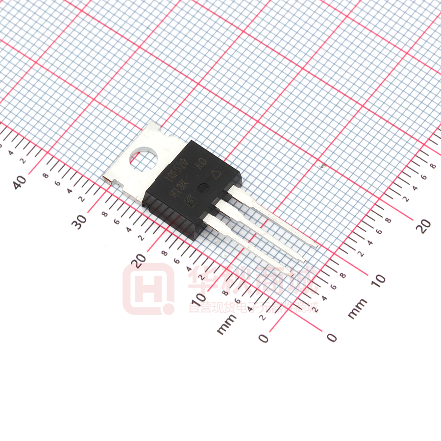

    MOS管 N-Channel VDS=100V VGS=±20V ID=9.2A RDS(ON)=270mΩ@10V TO220AB
IRF520PBF 数据手册
IRF520, SiHF520 Vishay Siliconix Power MOSFET FEATURES PRODUCT SUMMARY VDS (V) • • • • • • • 100 RDS(on) () VGS = 10 V 0.27 Qg (Max.) (nC) 16 Qgs (nC) 4.4 Qgd (nC) 7.7 Configuration Single Dynamic dV/dt Rating Repetitive Avalanche Rated 175 °C Operating Temperature Fast Switching Ease of Paralleling Simple Drive Requirements Compliant to RoHS Directive 2002/95/EC Available RoHS* COMPLIANT D DESCRIPTION TO-220AB Third generation Power MOSFETs from Vishay provide the designer with the best combination of fast switching, ruggedized device design, low on-resistance and cost-effectiveness. The TO-220AB package is universally preferred for all commercial-industrial applications at power dissipation levels to approximately 50 W. The low thermal resistance and low package cost of the TO-220AB contribute to its wide acceptance throughout the industry. G G D S S N-Channel MOSFET ORDERING INFORMATION Package TO-220AB IRF520PbF SiHF520-E3 IRF520 SiHF520 Lead (Pb)-free SnPb ABSOLUTE MAXIMUM RATINGS (TC = 25 °C, unless otherwise noted) PARAMETER SYMBOL LIMIT Drain-Source Voltage VDS 100 Gate-Source Voltage VGS ± 20 Continuous Drain Current VGS at 10 V TC = 25 °C TC = 100 °C Pulsed Drain Currenta ID IDM Linear Derating Factor UNIT V 9.2 6.5 A 37 0.40 W/°C Single Pulse Avalanche Energyb EAS 200 mJ Repetitive Avalanche Currenta IAR 9.2 A Repetitive Avalanche Energya EAR 6.0 mJ Maximum Power Dissipation TC = 25 °C Peak Diode Recovery dV/dtc Operating Junction and Storage Temperature Range Soldering Recommendations (Peak Temperature) Mounting Torque for 10 s 6-32 or M3 screw PD 60 W dV/dt 5.5 V/ns TJ, Tstg - 55 to + 175 300d °C 10 lbf · in 1.1 N·m Notes a. Repetitive rating; pulse width limited by maximum junction temperature (see fig. 11). b. VDD = 25 V, starting TJ = 25 °C, L = 3.5 mH, Rg = 25 , IAS = 9.2 A (see fig. 12). c. ISD  9.2 A, dI/dt  110 A/μs, VDD  VDS, TJ  175 °C. d. 1.6 mm from case. * Pb containing terminations are not RoHS compliant, exemptions may apply Document Number: 91017 S11-0511-Rev. B, 21-Mar-11 www.vishay.com 1 This datasheet is subject to change without notice. THE PRODUCT DESCRIBED HEREIN AND THIS DATASHEET ARE SUBJECT TO SPECIFIC DISCLAIMERS, SET FORTH AT www.vishay.com/doc?91000 IRF520, SiHF520 Vishay Siliconix THERMAL RESISTANCE RATINGS PARAMETER SYMBOL TYP. MAX. Maximum Junction-to-Ambient RthJA - 62 Case-to-Sink, Flat, Greased Surface RthCS 0.50 - Maximum Junction-to-Case (Drain) RthJC - 2.5 UNIT °C/W SPECIFICATIONS (TJ = 25 °C, unless otherwise noted) PARAMETER SYMBOL TEST CONDITIONS MIN. TYP. MAX. UNIT Static Drain-Source Breakdown Voltage VDS Temperature Coefficient VDS VGS = 0 V, ID = 250 μA 100 - - V VDS/TJ Reference to 25 °C, ID = 1 mA - 0.13 - V/°C VGS(th) VDS = VGS, ID = 250 μA 2.0 - 4.0 V Gate-Source Leakage IGSS VGS = ± 20 V - - ± 100 nA Zero Gate Voltage Drain Current IDSS VDS = 100 V, VGS = 0 V - - 25 VDS = 80 V, VGS = 0 V, TJ = 150 °C - - 250 Gate-Source Threshold Voltage μA - - 0.27  gfs VDS = 50 V, ID = 5.5 Ab 2.7 - - S Input Capacitance Ciss VGS = 0 V, - 360 - Output Capacitance Coss VDS = 25 V, - 150 - Reverse Transfer Capacitance Crss f = 1.0 MHz, see fig. 5 - 34 - Total Gate Charge Qg - - 16 Gate-Source Charge Qgs - - 4.4 Drain-Source On-State Resistance Forward Transconductance RDS(on) ID = 5.5 Ab VGS = 10 V Dynamic VGS = 10 V ID = 9.2 A, VDS = 80 V, see fig. 6 and 13b Gate-Drain Charge Qgd - - 7.7 Turn-On Delay Time td(on) - 8.8 - Rise Time Turn-Off Delay Time pF nC tr VDD = 50 V, ID = 9.2 A, - 30 - td(off) Rg = 18 , RD = 5.2, see fig. 10b - 19 - - 20 - - 4.5 - - 7.5 - - - 9.2 - - 37 - - 1.8 V - 110 260 ns - 0.53 1.3 μC Fall Time tf Internal Drain Inductance LD Internal Source Inductance LS Between lead, 6 mm (0.25") from package and center of die contact D ns nH G S Drain-Source Body Diode Characteristics Continuous Source-Drain Diode Current IS Pulsed Diode Forward Currenta ISM Body Diode Voltage VSD Body Diode Reverse Recovery Time trr Body Diode Reverse Recovery Charge Qrr Forward Turn-On Time ton MOSFET symbol showing the integral reverse p - n junction diode D A G S TJ = 25 °C, IS = 9.2 A, VGS = 0 Vb TJ = 25 °C, IF = 9.2 A, dI/dt = 100 A/μsb Intrinsic turn-on time is negligible (turn-on is dominated by LS and LD) Notes a. Repetitive rating; pulse width limited by maximum junction temperature (see fig. 11). b. Pulse width  300 μs; duty cycle  2 %. www.vishay.com 2 Document Number: 91017 S11-0511-Rev. B, 21-Mar-11 This datasheet is subject to change without notice. THE PRODUCT DESCRIBED HEREIN AND THIS DATASHEET ARE SUBJECT TO SPECIFIC DISCLAIMERS, SET FORTH AT www.vishay.com/doc?91000 IRF520, SiHF520 Vishay Siliconix TYPICAL CHARACTERISTICS (25 °C, unless otherwise noted) VGS 15 V 10 V 8.0 V 7.0 V 6.0 V 5.5 V 5.0 V Bottom 4.5 V Top 25 °C 101 4.5 V 100 ID, Drain Current (A) ID, Drain Current (A) 101 175 °C 100 20 µs Pulse Width VDS = 50 V 20 µs Pulse Width TC = 25 °C 10-1 100 101 4 VDS, Drain-to-Source Voltage (V) 91017_01 Fig. 1 - Typical Output Characteristics, TC = 25 °C ID, Drain Current (A) 101 4.5 V 100 20 µs Pulse Width TC = 175 °C 10-1 91017_02 100 101 VDS, Drain-to-Source Voltage (V) Fig. 2 - Typical Output Characteristics, TC = 175 °C Document Number: 91017 S11-0511-Rev. B, 21-Mar-11 6 7 8 9 10 Fig. 3 - Typical Transfer Characteristics RDS(on), Drain-to-Source On Resistance (Normalized) VGS 15 V 10 V 8.0 V 7.0 V 6.0 V 5.5 V 5.0 V Bottom 4.5 V Top 5 VGS, Gate-to-Source Voltage (V) 91017_03 3.0 2.5 ID = 9.2 A VGS = 10 V 2.0 1.5 1.0 0.5 0.0 - 60 - 40 - 20 0 91017_04 20 40 60 80 100 120 140 160 180 TJ, Junction Temperature (°C) Fig. 4 - Normalized On-Resistance vs. Temperature www.vishay.com 3 This datasheet is subject to change without notice. THE PRODUCT DESCRIBED HEREIN AND THIS DATASHEET ARE SUBJECT TO SPECIFIC DISCLAIMERS, SET FORTH AT www.vishay.com/doc?91000 IRF520, SiHF520 Vishay Siliconix VGS = 0 V, f = 1 MHz Ciss = Cgs + Cgd, Cds Shorted Crss = Cgd Coss = Cds + Cgd Capacitance (pF) 600 450 Ciss 300 Coss 150 Crss 101 ISD, Reverse Drain Current (A) 750 0 100 0.8 VDS = 80 V VDS = 20 V 8 4 91017_06 4 8 12 16 5 1.2 10 µs 2 100 µs 10 5 1 ms 2 10 ms 1 QG, Total Gate Charge (nC) TC = 25 °C TJ = 175 °C Single Pulse 2 0.1 0.1 20 Fig. 6 - Typical Gate Charge vs. Gate-to-Source Voltage www.vishay.com 4 1.1 102 5 For test circuit see figure 13 0 1.0 2 VDS = 50 V 0 0.9 Operation in this area limited by RDS(on) 5 16 0.7 VSD, Source-to-Drain Voltage (V) 103 ID, Drain Current (A) VGS, Gate-to-Source Voltage (V) 0.6 Fig. 7 - Typical Source-Drain Diode Forward Voltage ID = 9.2 A 12 VGS = 0 V 91017_07 Fig. 5 - Typical Capacitance vs. Drain-to-Source Voltage 20 25 °C 100 10-1 0.5 101 VDS, Drain-to-Source Voltage (V) 91017_05 175 °C 91017_08 2 5 1 2 5 10 2 5 102 2 5 103 VDS, Drain-to-Source Voltage (V) Fig. 8 - Maximum Safe Operating Area Document Number: 91017 S11-0511-Rev. B, 21-Mar-11 This datasheet is subject to change without notice. THE PRODUCT DESCRIBED HEREIN AND THIS DATASHEET ARE SUBJECT TO SPECIFIC DISCLAIMERS, SET FORTH AT www.vishay.com/doc?91000 IRF520, SiHF520 Vishay Siliconix RD VDS 10 VGS ID, Drain Current (A) D.U.T. RG 8 + - VDD 10 V 6 Pulse width ≤ 1 µs Duty factor ≤ 0.1 % 4 Fig. 10a - Switching Time Test Circuit 2 VDS 0 25 50 75 100 125 150 90 % 175 TC, Case Temperature (°C) 91017_09 10 % VGS td(on) Fig. 9 - Maximum Drain Current vs. Case Temperature td(off) tf tr Fig. 10b - Switching Time Waveforms Thermal Response (ZthJC) 10 1 0 - 0.5 0.2 PDM 0.1 0.05 0.1 t1 0.02 0.01 10-2 10-5 91017_11 Single Pulse (Thermal Response) 10-4 10-3 t2 Notes: 1. Duty Factor, D = t1/t2 2. Peak Tj = PDM x ZthJC + TC 10-2 0.1 1 10 t1, Rectangular Pulse Duration (s) Fig. 11 - Maximum Effective Transient Thermal Impedance, Junction-to-Case Document Number: 91017 S11-0511-Rev. B, 21-Mar-11 www.vishay.com 5 This datasheet is subject to change without notice. THE PRODUCT DESCRIBED HEREIN AND THIS DATASHEET ARE SUBJECT TO SPECIFIC DISCLAIMERS, SET FORTH AT www.vishay.com/doc?91000 IRF520, SiHF520 Vishay Siliconix L VDS VDS Vary tp to obtain required IAS tp VDD D.U.T RG + - IAS V DD VDS A 10 V 0.01 Ω tp IAS Fig. 12a - Unclamped Inductive Test Circuit Fig. 12b - Unclamped Inductive Waveforms EAS, Single Pulse Energy (mJ) 600 ID 3.8 A 6.5 A Bottom 9.2 A Top 500 400 300 200 100 VDD = 25 V 0 25 91017_12c 50 75 100 125 175 150 Starting TJ, Junction Temperature (°C) Fig. 12c - Maximum Avalanche Energy vs. Drain Current Current regulator Same type as D.U.T. 50 kΩ QG 10 V 12 V 0.2 µF 0.3 µF QGS QGD + D.U.T. VG - VDS VGS 3 mA Charge IG ID Current sampling resistors Fig. 13a - Basic Gate Charge Waveform www.vishay.com 6 Fig. 13b - Gate Charge Test Circuit Document Number: 91017 S11-0511-Rev. B, 21-Mar-11 This datasheet is subject to change without notice. THE PRODUCT DESCRIBED HEREIN AND THIS DATASHEET ARE SUBJECT TO SPECIFIC DISCLAIMERS, SET FORTH AT www.vishay.com/doc?91000 IRF520, SiHF520 Vishay Siliconix Peak Diode Recovery dV/dt Test Circuit + D.U.T. Circuit layout considerations • Low stray inductance • Ground plane • Low leakage inductance current transformer + - - Rg • • • • + dV/dt controlled by Rg Driver same type as D.U.T. ISD controlled by duty factor “D” D.U.T. - device under test + - VDD Driver gate drive P.W. Period D= P.W. Period VGS = 10 Va D.U.T. lSD waveform Reverse recovery current Body diode forward current dI/dt D.U.T. VDS waveform Diode recovery dV/dt Re-applied voltage Inductor current VDD Body diode forward drop Ripple ≤ 5 % ISD Note a. VGS = 5 V for logic level devices Fig. 14 - For N-Channel Vishay Siliconix maintains worldwide manufacturing capability. Products may be manufactured at one of several qualified locations. Reliability data for Silicon Technology and Package Reliability represent a composite of all qualified locations. For related documents such as package/tape drawings, part marking, and reliability data, see www.vishay.com/ppg?91017. Document Number: 91017 S11-0511-Rev. B, 21-Mar-11 www.vishay.com 7 This datasheet is subject to change without notice. THE PRODUCT DESCRIBED HEREIN AND THIS DATASHEET ARE SUBJECT TO SPECIFIC DISCLAIMERS, SET FORTH AT www.vishay.com/doc?91000 Package Information www.vishay.com Vishay Siliconix TO-220AB MILLIMETERS A E F D H(1) Q ØP 3 2 L(1) 1 M* L b(1) INCHES DIM. MIN. MAX. MIN. MAX. A 4.25 4.65 0.167 0.183 b 0.69 1.01 0.027 0.040 b(1) 1.20 1.73 0.047 0.068 c 0.36 0.61 0.014 0.024 D 14.85 15.49 0.585 0.610 D2 12.19 12.70 0.480 0.500 E 10.04 10.51 0.395 0.414 e 2.41 2.67 0.095 0.105 e(1) 4.88 5.28 0.192 0.208 F 1.14 1.40 0.045 0.055 H(1) 6.09 6.48 0.240 0.255 0.115 J(1) 2.41 2.92 0.095 L 13.35 14.02 0.526 0.552 L(1) 3.32 3.82 0.131 0.150 ØP 3.54 3.94 0.139 0.155 Q 2.60 3.00 0.102 0.118 ECN: T14-0413-Rev. P, 16-Jun-14 DWG: 5471 Note * M = 1.32 mm to 1.62 mm (dimension including protrusion) Heatsink hole for HVM C b e J(1) e(1) D2 Document Number: 71195 1 For technical questions, contact: hvm@vishay.com THIS DOCUMENT IS SUBJECT TO CHANGE WITHOUT NOTICE. THE PRODUCTS DESCRIBED HEREIN AND THIS DOCUMENT ARE SUBJECT TO SPECIFIC DISCLAIMERS, SET FORTH AT www.vishay.com/doc?91000 Revison: 16-Jun-14 Legal Disclaimer Notice www.vishay.com Vishay Disclaimer ALL PRODUCT, PRODUCT SPECIFICATIONS AND DATA ARE SUBJECT TO CHANGE WITHOUT NOTICE TO IMPROVE RELIABILITY, FUNCTION OR DESIGN OR OTHERWISE. Vishay Intertechnology, Inc., its affiliates, agents, and employees, and all persons acting on its or their behalf (collectively, “Vishay”), disclaim any and all liability for any errors, inaccuracies or incompleteness contained in any datasheet or in any other disclosure relating to any product. Vishay makes no warranty, representation or guarantee regarding the suitability of the products for any particular purpose or the continuing production of any product. To the maximum extent permitted by applicable law, Vishay disclaims (i) any and all liability arising out of the application or use of any product, (ii) any and all liability, including without limitation special, consequential or incidental damages, and (iii) any and all implied warranties, including warranties of fitness for particular purpose, non-infringement and merchantability. Statements regarding the suitability of products for certain types of applications are based on Vishay’s knowledge of typical requirements that are often placed on Vishay products in generic applications. Such statements are not binding statements about the suitability of products for a particular application. It is the customer’s responsibility to validate that a particular product with the properties described in the product specification is suitable for use in a particular application. Parameters provided in datasheets and/or specifications may vary in different applications and performance may vary over time. All operating parameters, including typical parameters, must be validated for each customer application by the customer’s technical experts. Product specifications do not expand or otherwise modify Vishay’s terms and conditions of purchase, including but not limited to the warranty expressed therein. Except as expressly indicated in writing, Vishay products are not designed for use in medical, life-saving, or life-sustaining applications or for any other application in which the failure of the Vishay product could result in personal injury or death. Customers using or selling Vishay products not expressly indicated for use in such applications do so at their own risk. Please contact authorized Vishay personnel to obtain written terms and conditions regarding products designed for such applications. No license, express or implied, by estoppel or otherwise, to any intellectual property rights is granted by this document or by any conduct of Vishay. Product names and markings noted herein may be trademarks of their respective owners. Material Category Policy Vishay Intertechnology, Inc. hereby certifies that all its products that are identified as RoHS-Compliant fulfill the definitions and restrictions defined under Directive 2011/65/EU of The European Parliament and of the Council of June 8, 2011 on the restriction of the use of certain hazardous substances in electrical and electronic equipment (EEE) - recast, unless otherwise specified as non-compliant. Please note that some Vishay documentation may still make reference to RoHS Directive 2002/95/EC. We confirm that all the products identified as being compliant to Directive 2002/95/EC conform to Directive 2011/65/EU. Vishay Intertechnology, Inc. hereby certifies that all its products that are identified as Halogen-Free follow Halogen-Free requirements as per JEDEC JS709A standards. Please note that some Vishay documentation may still make reference to the IEC 61249-2-21 definition. We confirm that all the products identified as being compliant to IEC 61249-2-21 conform to JEDEC JS709A standards. Revision: 02-Oct-12 1 Document Number: 91000
