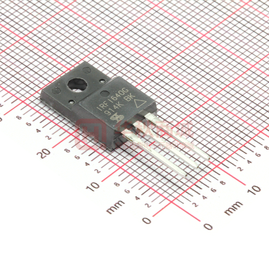

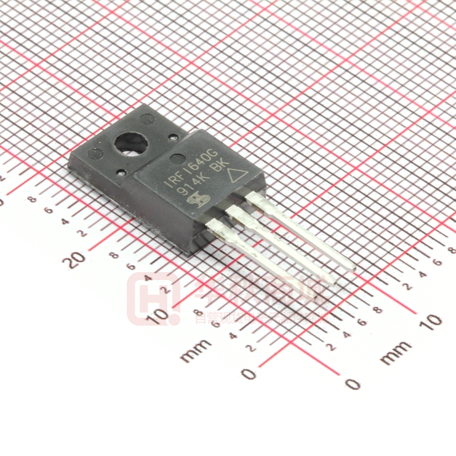

IRFI640G www.vishay.com Vishay Siliconix Power MOSFET FEATURES D TO-220 FULLPAK • Isolated package • High voltage isolation = 2.5 kVRMS (t = 60 s; f = 60 Hz) • Sink to lead creepage distance = 4.8 mm G • Dynamic dV/dt rating • Low thermal resistance G D S S • Material categorization: for definitions of compliance please see www.vishay.com/doc?99912 N-Channel MOSFET DESCRIPTION PRODUCT SUMMARY VDS (V) RDS(on) (Ω) Third generation power MOSFETs from Vishay provide the designer with the best combination of fast switching, ruggedized device design, low on-resistance and cost-effectiveness. 200 VGS = 10 V 0.18 Qg max. (nC) 70 Qgs (nC) 13 Qgd (nC) Configuration The TO-220 FULLPAK eliminates the need for additional insulating hardware in commercial-industrial applications. The molding compound used provides a high isolation capability and a low thermal resistance between the tab and external heatsink. The isolation is equivalent to using a 100 micron mica barrier with standard TO-220 product. The FULLPAK is mounted to a heatsink using a single clip or by a single screw fixing. 39 Single ORDERING INFORMATION Package TO-220 FULLPAK Lead (Pb)-free IRFI640GPbF ABSOLUTE MAXIMUM RATINGS (TC = 25 °C, unless otherwise noted) PARAMETER SYMBOL LIMIT Drain-source voltage VDS 200 Gate-source voltage VGS ± 20 Continuous drain current VGS at 10 V TC = 25 °C TC = 100 °C Pulsed drain current a ID IDM Linear derating factor UNIT V 9.8 6.2 A 39 0.32 W/°C Single pulse avalanche energy b EAS 430 mJ Repetitive avalanche current a IAR 9.8 A Repetitive avalanche energy a EAR 4.0 mJ Maximum power dissipation TC = 25 °C Peak diode recovery dV/dt c Operating junction and storage temperature range Soldering recommendations (peak temperature) d Mounting torque PD 40 W dV/dt 5.0 V/ns TJ, Tstg -55 to +150 For 10 s 300 M3 screw 0.6 °C Nm Notes a. Repetitive rating; pulse width limited by maximum junction temperature (see fig. 11) b. VDD = 50 V, starting TJ = 25 °C, L = 6.7 mH, Rg = 25 Ω, IAS = 9.8 A (see fig. 12) c. ISD ≤ 18 A, dI/dt ≤ 150 A/μs, VDD ≤ VDS, TJ ≤ 150 °C d. 1.6 mm from case S21-0973-Rev. C, 11-Oct-2021 Document Number: 91150 1 For technical questions, contact: hvm@vishay.com THIS DOCUMENT IS SUBJECT TO CHANGE WITHOUT NOTICE. THE PRODUCTS DESCRIBED HEREIN AND THIS DOCUMENT ARE SUBJECT TO SPECIFIC DISCLAIMERS, SET FORTH AT www.vishay.com/doc?91000 IRFI640G www.vishay.com Vishay Siliconix THERMAL RESISTANCE RATINGS PARAMETER SYMBOL TYP. MAX. Maximum junction-to-ambient RthJA - 65 Maximum junction-to-case (drain) RthJC - 3.1 UNIT °C/W SPECIFICATIONS (TJ = 25 °C, unless otherwise noted) PARAMETER SYMBOL TEST CONDITIONS MIN. TYP. MAX. UNIT Static Drain-ssource breakdown voltage VDS temperature coefficient Gate-source threshold voltage Gate-source leakage Zero gate voltage drain current Drain-source on-state resistance Forward transconductance VDS VGS = 0 V, ID = 250 μA 200 - - V ΔVDS/TJ Reference to 25 °C, ID = 1 mA - 0.29 - V/°C VGS(th) VDS = VGS, ID = 250 μA 2.0 - 4.0 V nA IGSS IDSS VGS = ± 20 V - - ± 100 VDS = 200 V, VGS = 0 V - - 25 VDS = 160 V, VGS = 0 V, TJ = 125 °C - - 250 μA - - 0.18 Ω gfs VDS = 50 V, ID = 5.9 A b 5.2 - - S VGS = 0 V, VDS = 25 V, f = 1.0 MHz, see fig. 5 - 1300 - - 400 - - 130 - RDS(on) ID = 5.9 A b VGS = 10 V Dynamic Input capacitance Ciss Output capacitance Coss Reverse transfer capacitance Crss Drain to sink capacitance C Total gate charge Qg Gate-source charge Qgs Gate-drain charge Qgd Turn-on delay time td(on) Rise time Turn-off delay time tr td(off) Fall time tf Gate input resistance Rg Internal drain inductance LD Internal source inductance LS f = 1.0 MHz VGS = 10 V ID = 18 A, VDS = 160 V, see fig. 6 and 13 b - 12 - - - 70 - - 13 - - 39 - 14 - VDD = 100 V, ID = 18 A, Rg = 9.1 Ω, RD= 5.4 Ω, see fig. 10 b - 51 - - 45 - - 36 - f = 1 MHz, open drain 0.2 - 1.1 - 4.5 - - 7.5 - - - 9.8 - - 39 Between lead, 6 mm (0.25") from package and center of die contact D pF nC ns Ω nH G S Drain-Source Body Diode Characteristics Continuous source-drain diode current IS Pulsed diode forward current a ISM Body diode voltage VSD Body diode reverse recovery time trr Body diode reverse recovery charge Qrr Forward turn-on time ton MOSFET symbol showing the integral reverse p - n junction diode D A G S TJ = 25 °C, IS = 9.8 A, VGS = 0 V b TJ = 25 °C, IF = 18 A, dI/dt = 100 A/μs b - - 2.0 V - 300 610 ns - 3.4 7.1 μC Intrinsic turn-on time is negligible (turn-on is dominated by LS and LD) Notes a. Repetitive rating; pulse width limited by maximum junction temperature (see fig. 11) b. Pulse width ≤ 300 μs; duty cycle ≤ 2 % S21-0973-Rev. C, 11-Oct-2021 Document Number: 91150 2 For technical questions, contact: hvm@vishay.com THIS DOCUMENT IS SUBJECT TO CHANGE WITHOUT NOTICE. THE PRODUCTS DESCRIBED HEREIN AND THIS DOCUMENT ARE SUBJECT TO SPECIFIC DISCLAIMERS, SET FORTH AT www.vishay.com/doc?91000 IRFI640G www.vishay.com Vishay Siliconix TYPICAL CHARACTERISTICS (25 °C, unless otherwise noted) Fig. 1 - Typical Output Characteristics, TC= 25 °C Fig. 3 - Typical Transfer Characteristics Fig. 2 - Typical Output Characteristics, TC= 150 °C Fig. 4 - Normalized On-Resistance vs. Temperature S21-0973-Rev. C, 11-Oct-2021 Document Number: 91150 3 For technical questions, contact: hvm@vishay.com THIS DOCUMENT IS SUBJECT TO CHANGE WITHOUT NOTICE. THE PRODUCTS DESCRIBED HEREIN AND THIS DOCUMENT ARE SUBJECT TO SPECIFIC DISCLAIMERS, SET FORTH AT www.vishay.com/doc?91000 IRFI640G www.vishay.com Vishay Siliconix Fig. 5 - Typical Capacitance vs. Drain-to-Source Voltage Fig. 7 - Typical Source-Drain Diode Forward Voltage Fig. 6 - Typical Gate Charge vs. Gate-to-Source Voltage Fig. 8 - Maximum Safe Operating Area S21-0973-Rev. C, 11-Oct-2021 Document Number: 91150 4 For technical questions, contact: hvm@vishay.com THIS DOCUMENT IS SUBJECT TO CHANGE WITHOUT NOTICE. THE PRODUCTS DESCRIBED HEREIN AND THIS DOCUMENT ARE SUBJECT TO SPECIFIC DISCLAIMERS, SET FORTH AT www.vishay.com/doc?91000 IRFI640G www.vishay.com Vishay Siliconix RD VDS VGS D.U.T. RG + - VDD 10 V Pulse width ≤ 1 µs Duty factor ≤ 0.1 % Fig. 10a - Switching Time Test Circuit VDS 90 % 10 % VGS td(on) Fig. 9 - Maximum Drain Current vs. Case Temperature td(off) tf tr Fig. 10b - Switching Time Waveforms Fig. 11 - Maximum Effective Transient Thermal Impedance, Junction-to-Case L Vary tp to obtain required IAS VDS VDS tp VDD D.U.T RG + - I AS V DD VDS 10 V tp 0.01 Ω Fig. 12a - Unclamped Inductive Test Circuit S21-0973-Rev. C, 11-Oct-2021 IAS Fig. 12b - Unclamped Inductive Waveforms Document Number: 91150 5 For technical questions, contact: hvm@vishay.com THIS DOCUMENT IS SUBJECT TO CHANGE WITHOUT NOTICE. THE PRODUCTS DESCRIBED HEREIN AND THIS DOCUMENT ARE SUBJECT TO SPECIFIC DISCLAIMERS, SET FORTH AT www.vishay.com/doc?91000 IRFI640G www.vishay.com Vishay Siliconix Fig. 12c - Maximum Avalanche Energy vs. Drain Current Current regulator Same type as D.U.T. 50 kΩ QG 10 V 12 V 0.2 µF 0.3 µF QGS QGD + D.U.T. VG - VDS VGS 3 mA Charge IG ID Current sampling resistors Fig. 13a - Basic Gate Charge Waveform S21-0973-Rev. C, 11-Oct-2021 Fig. 13b - Gate Charge Test Circuit Document Number: 91150 6 For technical questions, contact: hvm@vishay.com THIS DOCUMENT IS SUBJECT TO CHANGE WITHOUT NOTICE. THE PRODUCTS DESCRIBED HEREIN AND THIS DOCUMENT ARE SUBJECT TO SPECIFIC DISCLAIMERS, SET FORTH AT www.vishay.com/doc?91000 IRFI640G www.vishay.com Vishay Siliconix Peak Diode Recovery dV/dt Test Circuit + D.U.T. Circuit layout considerations • Low stray inductance • Ground plane • Low leakage inductance current transformer + + - - Rg • • • • dV/dt controlled by Rg Driver same type as D.U.T. ISD controlled by duty factor “D” D.U.T. - device under test + - VDD Driver gate drive P.W. Period D= P.W. Period VGS = 10 Va D.U.T. lSD waveform Reverse recovery current Body diode forward current dI/dt D.U.T. VDS waveform Diode recovery dV/dt Re-applied voltage Inductor current VDD Body diode forward drop Ripple ≤ 5 % ISD Note a. VGS = 5 V for logic level devices Fig. 14 - For N-Channel Vishay Siliconix maintains worldwide manufacturing capability. Products may be manufactured at one of several qualified locations. Reliability data for Silicon Technology and Package Reliability represent a composite of all qualified locations. For related documents such as package/tape drawings, part marking, and reliability data, see www.vishay.com/ppg?91150. S21-0973-Rev. C, 11-Oct-2021 Document Number: 91150 7 For technical questions, contact: hvm@vishay.com THIS DOCUMENT IS SUBJECT TO CHANGE WITHOUT NOTICE. THE PRODUCTS DESCRIBED HEREIN AND THIS DOCUMENT ARE SUBJECT TO SPECIFIC DISCLAIMERS, SET FORTH AT www.vishay.com/doc?91000 Package Information www.vishay.com Vishay Siliconix TO-220 FULLPAK (High Voltage) OPTION 1: FACILITY CODE = 9 A F G Q1 E D ØR A3 L1 3 x b2 3 x b1 Mold flash bleeding Q L Exposed Cu 3xb 2xe C Bottom view MILLIMETERS DIM. MIN. NOM. A 4.60 4.70 4.80 b 0.70 0.80 0.91 b1 1.20 1.30 1.47 b2 1.10 1.20 1.30 C 0.45 0.50 0.63 D 15.80 15.87 15.97 e MAX. 2.54 BSC E 10.00 10.10 F 2.44 2.54 10.30 2.64 G 6.50 6.70 6.90 L 12.90 13.10 13.30 L1 3.13 3.23 3.33 Q 2.65 2.75 2.85 Q1 3.20 3.30 3.40 ØR 3.08 3.18 3.28 Notes 1. To be used only for process drawing 2. These dimensions apply to all TO-220 FULLPAK leadframe versions 3 leads 3. All critical dimensions should C meet Cpk > 1.33 4. All dimensions include burrs and plating thickness 5. No chipping or package damage 6. Facility code will be the 1st character located at the 2nd row of the unit marking Revision: 08-Apr-2019 Document Number: 91359 1 For technical questions, contact: hvmos.techsupport@vishay.com THIS DOCUMENT IS SUBJECT TO CHANGE WITHOUT NOTICE. THE PRODUCTS DESCRIBED HEREIN AND THIS DOCUMENT ARE SUBJECT TO SPECIFIC DISCLAIMERS, SET FORTH AT www.vishay.com/doc?91000 Package Information www.vishay.com Vishay Siliconix OPTION 2: FACILITY CODE = Y A A1 E ØP n d1 d3 D u L1 V L b3 A2 b2 c b MILLIMETERS INCHES DIM. MIN. MAX. MIN. MAX. A 4.570 4.830 0.180 0.190 A1 2.570 2.830 0.101 0.111 A2 2.510 2.850 0.099 0.112 b 0.622 0.890 0.024 0.035 b2 1.229 1.400 0.048 0.055 b3 1.229 1.400 0.048 0.055 c 0.440 0.629 0.017 0.025 D 8.650 9.800 0.341 0.386 d1 15.88 16.120 0.622 0.635 d3 12.300 12.920 0.484 0.509 E 10.360 10.630 0.408 e 2.54 BSC 0.419 0.100 BSC L 13.200 13.730 0.520 0.541 L1 3.100 3.500 0.122 0.138 n 6.050 6.150 0.238 0.242 ØP 3.050 3.450 0.120 0.136 u 2.400 2.500 0.094 0.098 V 0.400 0.500 0.016 0.020 ECN: E19-0180-Rev. D, 08-Apr-2019 DWG: 5972 Notes 1. To be used only for process drawing 2. These dimensions apply to all TO-220 FULLPAK leadframe versions 3 leads 3. All critical dimensions should C meet Cpk > 1.33 4. All dimensions include burrs and plating thickness 5. No chipping or package damage 6. Facility code will be the 1st character located at the 2nd row of the unit marking Revision: 08-Apr-2019 Document Number: 91359 2 For technical questions, contact: hvmos.techsupport@vishay.com THIS DOCUMENT IS SUBJECT TO CHANGE WITHOUT NOTICE. THE PRODUCTS DESCRIBED HEREIN AND THIS DOCUMENT ARE SUBJECT TO SPECIFIC DISCLAIMERS, SET FORTH AT www.vishay.com/doc?91000 Legal Disclaimer Notice www.vishay.com Vishay Disclaimer ALL PRODUCT, PRODUCT SPECIFICATIONS AND DATA ARE SUBJECT TO CHANGE WITHOUT NOTICE TO IMPROVE RELIABILITY, FUNCTION OR DESIGN OR OTHERWISE. Vishay Intertechnology, Inc., its affiliates, agents, and employees, and all persons acting on its or their behalf (collectively, “Vishay”), disclaim any and all liability for any errors, inaccuracies or incompleteness contained in any datasheet or in any other disclosure relating to any product. Vishay makes no warranty, representation or guarantee regarding the suitability of the products for any particular purpose or the continuing production of any product. To the maximum extent permitted by applicable law, Vishay disclaims (i) any and all liability arising out of the application or use of any product, (ii) any and all liability, including without limitation special, consequential or incidental damages, and (iii) any and all implied warranties, including warranties of fitness for particular purpose, non-infringement and merchantability. Statements regarding the suitability of products for certain types of applications are based on Vishay's knowledge of typical requirements that are often placed on Vishay products in generic applications. Such statements are not binding statements about the suitability of products for a particular application. It is the customer's responsibility to validate that a particular product with the properties described in the product specification is suitable for use in a particular application. Parameters provided in datasheets and / or specifications may vary in different applications and performance may vary over time. All operating parameters, including typical parameters, must be validated for each customer application by the customer's technical experts. Product specifications do not expand or otherwise modify Vishay's terms and conditions of purchase, including but not limited to the warranty expressed therein. Hyperlinks included in this datasheet may direct users to third-party websites. These links are provided as a convenience and for informational purposes only. Inclusion of these hyperlinks does not constitute an endorsement or an approval by Vishay of any of the products, services or opinions of the corporation, organization or individual associated with the third-party website. Vishay disclaims any and all liability and bears no responsibility for the accuracy, legality or content of the third-party website or for that of subsequent links. Except as expressly indicated in writing, Vishay products are not designed for use in medical, life-saving, or life-sustaining applications or for any other application in which the failure of the Vishay product could result in personal injury or death. Customers using or selling Vishay products not expressly indicated for use in such applications do so at their own risk. Please contact authorized Vishay personnel to obtain written terms and conditions regarding products designed for such applications. No license, express or implied, by estoppel or otherwise, to any intellectual property rights is granted by this document or by any conduct of Vishay. Product names and markings noted herein may be trademarks of their respective owners. © 2022 VISHAY INTERTECHNOLOGY, INC. ALL RIGHTS RESERVED Revision: 01-Jan-2022 1 Document Number: 91000
