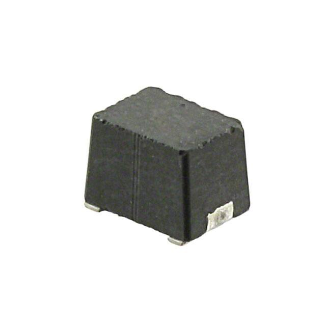

    固定电感器 1812 1mH ±5% 66mA 16Ω 2MHz 30@252KHz
ISC1812RV102J 数据手册
ISC-1812 www.vishay.com Vishay Dale Wirewound, Surface-Mount, Molded, Shielded Inductors FEATURES • Molded construction provides superior strength and moisture resistance • Tape and reel packaging for automatic handling, 2000/reel, EIA-481 STANDARD ELECTRICAL SPECIFICATIONS IND. (μH) TOL. 0.10 0.12 0.15 0.18 0.22 0.33 0.39 0.47 0.56 0.68 0.82 0.8 1.0 1.2 1.5 1.8 2.2 2.7 3.3 3.9 4.7 5.6 6.8 8.2 10.0 12.0 15.0 18.0 22.0 27.0 33.0 39.0 47.0 56.0 68.0 82.0 100.0 120.0 150.0 180.0 220.0 270.0 330.0 390.0 470.0 560.0 680.0 820.0 1000.0 ± 20 % ± 20 % ± 20 % ± 20 % ± 20 % ± 20 % ± 20 % ± 20 % ± 20 % ± 20 % ± 20 % ± 20 % ± 10 % ± 10 % ± 10 % ± 10 % ± 10 % ± 10 % ± 10 % ± 10 % ± 10 % ± 10 % ± 10 % ± 10 % ± 10 % ± 10 % ± 10 % ± 10 % ± 10 % ± 10 % ± 10 % ± 10 % ± 10 % ± 10 % ± 10 % ± 10 % ± 10 % ± 10 % ± 10 % ± 10 % ± 10 % ± 10 % ± 10 % ± 10 % ± 10 % ± 10 % ± 10 % ± 10 % ± 10 % TEST FREQ. (MHz) Q MIN. L&Q 25.2 25.2 25.2 25.2 25.2 25.2 25.2 25.2 25.2 25.2 25.2 25.2 7.96 7.96 7.96 7.96 7.96 7.96 7.96 7.96 7.96 7.96 7.96 7.96 2.52 2.52 2.52 2.52 2.52 2.52 2.52 2.52 2.52 2.52 2.52 2.52 0.796 0.796 0.796 0.796 0.796 0.796 0.796 0.796 0.796 0.796 0.796 0.796 0.252 30 30 30 30 30 30 30 30 30 30 30 30 30 30 30 30 30 30 30 30 30 30 30 30 50 50 50 50 50 40 40 40 40 40 40 40 40 40 40 40 40 40 40 40 40 30 40 30 30 SRF DCR MIN. MAX. (MHz) () 460 400 390 350 310 280 240 215 205 195 165 155 140 120 100 90.0 80.0 67.0 61.0 56.0 50.0 40.0 32.0 30.0 25.0 22.0 18.0 15.0 14.0 13.0 12.0 11.0 9.0 8.0 7.6 7.2 7.0 6.0 5.0 4.5 4.2 4.0 3.7 3.5 3.3 2.8 2.6 2.2 2.0 0.23 0.26 0.29 0.32 0.36 0.40 0.45 0.60 0.75 0.80 0.95 1.20 0.35 0.38 0.40 0.43 0.46 0.49 0.55 0.59 0.62 0.69 0.75 0.82 0.90 1.00 1.10 1.24 1.36 1.56 1.72 1.89 2.10 2.34 2.60 2.86 3.25 3.64 4.16 5.72 6.30 6.90 7.54 8.20 9.20 10.50 12.00 13.50 16.00 RATED DC CURRENT (mA) (1) 552 519 491 468 441 418 394 342 306 296 271 242 447 429 418 403 390 378 357 344 336 333 306 292 279 265 252 238 227 212 202 192 183 173 164 156 147 139 130 111 105 101 96 92 87 82 76 72 66 Note (1) Rated DC current based on the maximum temperature rise, not to exceed 40 °C at +85 °C ambient Revision: 10-Sep-2019 • Compatible with vapor phase and infrared reflow soldering • Shielded construction minimizes coupling to other components • Material categorization: for definitions of compliance please see www.vishay.com/doc?99912 ELECTRICAL SPECIFICATIONS Inductance range: 0.10 μH to 1000 μH Special tolerances available upon request Operating temperature: -55 °C to +125 °C Coilform material: non-magnetic for 0.10 μH to 0.82 μH; powdered iron for 1.0 μH to 22 μH; ferrite for 27 μH to 1000 μH TEST EQUIPMENT • H/P 4342A Q meter with Vishay Dale test fixture or equivalent • H/P 4191A RF impedance analyzer (for SRF measurements) • Wheatstone bridge DIMENSIONS in inches [millimeters] 0.037 ± 0.008 [0.940 ± 0.203] 0.126 ± 0.008 [3.200 ± 0.203] 0.006 [0.152] Ref. Typ. 0.177 ± 0.008 [4.500 ± 0.203] + 0.004 - 0.008 + 0.102 [1.270 - 0.203 ] 0.050 0.126 ± 0.008 [3.200 ± 0.203] Typ. 0.030 ± 0.004 [0.762 ± 0.102] Typ. 0.124 [3.15] Ref. Guidelines for Parallel Component Printed Circuit Mounting Pads on ISC-1812 Chip Inductors 0.158 [4.0] 0.181 [4.6] 0.024 (1) [0.6] 0.059 [1.5] 0.158 [4.0] 0.059 [1.5] 0.118 [3.0] Note (1) Recommended minimum spacing between components PART MARKING - Vishay Dale - Inductance code - Date code Document Number: 34061 1 For technical questions, contact: magnetics@vishay.com THIS DOCUMENT IS SUBJECT TO CHANGE WITHOUT NOTICE. THE PRODUCTS DESCRIBED HEREIN AND THIS DOCUMENT ARE SUBJECT TO SPECIFIC DISCLAIMERS, SET FORTH AT www.vishay.com/doc?91000 ISC-1812 www.vishay.com Vishay Dale COUPLING SPECIFICATIONS (maximum) COUPLING (%) 10 5 1 0.5 1 5 10 50 100 5001000 INDUCTANCE (µH) DESCRIPTION ISC-1812 10 μH ± 10 % ER e3 MODEL INDUCTANCE VALUE INDUCTANCE TOLERANCE PACKAGE CODE JEDEC® LEAD (Pb)-FREE STANDARD E 1 GLOBAL PART NUMBER I S PRODUCT FAMILY Revision: 10-Sep-2019 C 1 8 1 SIZE 2 R PACKAGE CODE 0 INDUCTANCE VALUE 0 K TOL. Document Number: 34061 2 For technical questions, contact: magnetics@vishay.com THIS DOCUMENT IS SUBJECT TO CHANGE WITHOUT NOTICE. THE PRODUCTS DESCRIBED HEREIN AND THIS DOCUMENT ARE SUBJECT TO SPECIFIC DISCLAIMERS, SET FORTH AT www.vishay.com/doc?91000 Legal Disclaimer Notice www.vishay.com Vishay Disclaimer ALL PRODUCT, PRODUCT SPECIFICATIONS AND DATA ARE SUBJECT TO CHANGE WITHOUT NOTICE TO IMPROVE RELIABILITY, FUNCTION OR DESIGN OR OTHERWISE. Vishay Intertechnology, Inc., its affiliates, agents, and employees, and all persons acting on its or their behalf (collectively, “Vishay”), disclaim any and all liability for any errors, inaccuracies or incompleteness contained in any datasheet or in any other disclosure relating to any product. Vishay makes no warranty, representation or guarantee regarding the suitability of the products for any particular purpose or the continuing production of any product. To the maximum extent permitted by applicable law, Vishay disclaims (i) any and all liability arising out of the application or use of any product, (ii) any and all liability, including without limitation special, consequential or incidental damages, and (iii) any and all implied warranties, including warranties of fitness for particular purpose, non-infringement and merchantability. Statements regarding the suitability of products for certain types of applications are based on Vishay's knowledge of typical requirements that are often placed on Vishay products in generic applications. Such statements are not binding statements about the suitability of products for a particular application. It is the customer's responsibility to validate that a particular product with the properties described in the product specification is suitable for use in a particular application. Parameters provided in datasheets and / or specifications may vary in different applications and performance may vary over time. All operating parameters, including typical parameters, must be validated for each customer application by the customer's technical experts. Product specifications do not expand or otherwise modify Vishay's terms and conditions of purchase, including but not limited to the warranty expressed therein. Hyperlinks included in this datasheet may direct users to third-party websites. These links are provided as a convenience and for informational purposes only. Inclusion of these hyperlinks does not constitute an endorsement or an approval by Vishay of any of the products, services or opinions of the corporation, organization or individual associated with the third-party website. Vishay disclaims any and all liability and bears no responsibility for the accuracy, legality or content of the third-party website or for that of subsequent links. Except as expressly indicated in writing, Vishay products are not designed for use in medical, life-saving, or life-sustaining applications or for any other application in which the failure of the Vishay product could result in personal injury or death. Customers using or selling Vishay products not expressly indicated for use in such applications do so at their own risk. Please contact authorized Vishay personnel to obtain written terms and conditions regarding products designed for such applications. No license, express or implied, by estoppel or otherwise, to any intellectual property rights is granted by this document or by any conduct of Vishay. Product names and markings noted herein may be trademarks of their respective owners. © 2021 VISHAY INTERTECHNOLOGY, INC. ALL RIGHTS RESERVED Revision: 09-Jul-2021 1 Document Number: 91000

物料型号:ISC-1812
器件简介:这是Vishay Dale生产的表面贴装、模制、屏蔽电感器,适用于自动处理,采用胶带和卷轴包装。
引脚分配:文档中没有提供具体的引脚分配信息,但提到了适用于自动贴装的EIA-481标准。
参数特性: - 电感范围:0.10 μH 至 1000 μH - 特殊公差可按需提供 - 工作温度:-55 °C 至 +125 °C - 线圈材料:0.10 μH 至 0.82 μH 为非磁性材料;1.0 μH 至 22 μH 为粉末铁;27 μH 至 1000 μH 为铁氧体 - 测试设备包括H/P 4342A Q表、Vishay Dale测试夹具或同等设备、H/P 4191A射频阻抗分析仪(用于SRF测量)和惠斯通电桥
功能详解: - 模制结构提供优越的强度和防潮性能 - 符合RoHS标准,无卤素 - 屏蔽结构最小化与其他组件的耦合 - 兼容蒸汽相位和红外回流焊接
应用信息:适用于需要自动处理和表面贴装的应用,如电源管理、信号调节等。
封装信息:提供了详细的尺寸信息,包括电感器的长、宽和高,以及推荐的最小间距。
