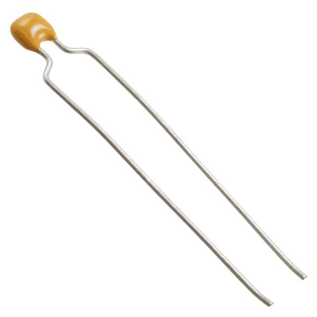

    39 pF ±10% 200V 陶瓷电容器 C0G,NP0 径向
K390K15C0GK53H5 数据手册
K Series www.vishay.com Vishay BCcomponents Radial Leaded Multilayer Ceramic Capacitors for General Purpose Class 1 and Class 2, 50 VDC, 100 VDC, 200 VDC, 500 VDC FEATURES • High capacitance with small size • High reliability • Crimp and straight leadstyles • Material categorization: for definitions of compliance please see www.vishay.com/doc?99912 APPLICATIONS • Temperature compensation • Coupling and decoupling QUICK REFERENCE DATA DESCRIPTION VALUE Ceramic Class Ceramic Dielectric 1 2 C0G X7R Voltage (VDC) 50 100 200 500 50 100 200 500 Min. Capacitance (pF) 10 10 33 33 100 100 100 100 Max. Capacitance (pF) 10 000 5600 3900 1800 1 000 000 560 000 220 000 47 000 Mounting Radial MARKING CAPACITANCE RANGE Marking indicates capacitance value and tolerance in accordance with “EIA 198” and voltage marks. 10 pF to 1 μF OPERATING TEMPERATURE RANGE ± 5 %, ± 10 %, ± 20 % C0G, X7R: - 55 °C to + 125 °C TEMPERATURE CHARACTERISTICS Class 1: C0G Class 2: X7R SECTIONAL SPECIFICATIONS Climatic category (acc. to EN 60058-1) Class 1 and 2: 55/125/21 APPROVALS EIA 198 IEC 60384-9 DESIGN • The capacitors consist of a general purpose MLCC • The lead wires are 0.5 mm and are made of 100 % tinned copper clad steel wire • The capacitors may be supplied with straight or kinked leads having a lead spacing of 2.5 mm and 5.0 mm • Coating is made of yellow colored flame retardant epoxy resin in accordance with UL 94 V-0 Revision: 16-Oct-2023 TOLERANCE ON CAPACITANCE RATED VOLTAGE 50 VDC, 100 VDC, 200 VDC, 500 VDC TEST VOLTAGE • 50 VDC and 100 VDC: 250 % of rated voltage • 200 VDC: 150 % of rated voltage + 100 VDC • 500 VDC: 130 % of rated voltage + 100 VDC INSULATION RESISTANCE AT RATED VOLTAGE • 50 VDC and 100 VDC: 100 GΩ or 1000 ΩF, whichever is less at rated voltage within 2 min of charging • 200 VDC, 500 VDC, and size 10: 10 GΩ or 100 ΩF, whichever is less at rated voltage within 2 min of charging DISSIPATION FACTOR Class 1 Class 2 0.1 % max. when C ≥ 30 pF (at 1 MHz; 1 V where C ≤ 1000 pF, and at 1 kHz; 1 V where C > 1000 pF) For C < 30 pF: DF = 100/(400 + 20 x C) DF = dissipation factor in %; C = capacitance value in pF 2.5 % max. (at 1 kHz; 1 V) Document Number: 45171 1 For technical questions, contact: cmll@vishay.com THIS DOCUMENT IS SUBJECT TO CHANGE WITHOUT NOTICE. THE PRODUCTS DESCRIBED HEREIN AND THIS DOCUMENT ARE SUBJECT TO SPECIFIC DISCLAIMERS, SET FORTH AT www.vishay.com/doc?91000 K Series www.vishay.com Vishay BCcomponents LEAD CONFIGURATION AND DIMENSIONS (in millimeters) Wb Wb H H H H T Wb Wb SH SH SH SH L L L L 5.0 ± 0.8 2.5 ± 0.8 L2 Component outline for lead spacing 2.5 mm ± 0.8 mm (straight leads) 5.0 ± 0.8 2.5 ± 0.8 H5 Component outline for lead spacing 5.0 mm ± 0.8 mm (flat bent leads) SIZE CODE WbMAX. HMAX. TMAX. 10 3.6 3.6 15 4.0 20 5.0 K2 Component outline for lead spacing 2.5 mm ± 0.8 mm (outside kink) K5 Component outline for lead spacing 5.0 mm ± 0.8 mm (outside kink) MAXIMUM SEATING HEIGHT (SH) L2 H5 K2 K5 2.3 1.6 2.6 3.5 - 4.0 2.6 1.6 2.6 3.5 3.5 5.0 3.2 1.6 2.6 3.5 3.5 Notes • Bulk packed types have a standard lead length L = 30 mm ± 5 mm • The K5 lead style is not available for size 10 • L2 and H5 are preferred styles MARKING SIZE 10 AND 15 CAPACITANCE VALUE < 100 pF SIZE 10 AND 15 CAPACITANCE VALUE ≥ 100 pF t Vishay logo or BC logo Vishay logo or BC logo Vishay logo or BC logo X X SIZE 20 t: Tolerance code X X X X X X t XXX: Capacitance code XXX: Capacitance code XX: Capacitance code t: Tolerance code Notes • The capacitance code indicates actual capacitance in pF when capacitance value < 100 pF • Two significant digits followed by one digit for the multiplier as given following: 1 = * 10, 2 = * 100, 3 = * 1000, 4 = * 10 000, 5 = * 100 000 • The tolerance codes are J = 5 %, K = 10 %, M = 20 % ORDERING CODE INFORMATION K 104 K 15 X7R F 5 3 H 5 1 234 5 67 8 9 10 11 12 13 14 15 Product Type Capacitance (pF) Capacitance Tolerance Size Code T.C. Code Rated Voltage Lead Diameter Packaging / Lead Length Lead Style Lead Spacing 3 = bulk T = tape and reel U = ammo H = flat crimp L= straight K= outside crimp 2 = 2.5 mm 5 = 5.0 mm K = radial The first two digits leaded MLCC are the significant figures of capacitance and the last digit is a multiplier as follows: 0=*1 1 = * 10 2 = * 100 3 = * 1000 4 = * 10 000 5 = * 100 000 Revision: 16-Oct-2023 J=±5% K = ± 10 % M = ± 20 % Please Please F = 50 VDC 5 = 0.50 mm refer to refer to H = 100 VDC ± 0.05 mm relevant relevant K = 200 VDC datasheet datasheet L = 500 VDC Document Number: 45171 2 For technical questions, contact: cmll@vishay.com THIS DOCUMENT IS SUBJECT TO CHANGE WITHOUT NOTICE. THE PRODUCTS DESCRIBED HEREIN AND THIS DOCUMENT ARE SUBJECT TO SPECIFIC DISCLAIMERS, SET FORTH AT www.vishay.com/doc?91000 K Series www.vishay.com Vishay BCcomponents ORDERING CODES DIELECTRIC C0G CAP. (pF) 50 VDC SMALLER SIZE NORMAL SIZE 100 VDC SMALLER SIZE NORMAL SIZE 200 VDC 500 VDC NORMAL SIZE NORMAL SIZE 10 K100#10C0GF5### K100#15C0GF5### K100#10C0GH5### K100#15C0GH5### - - 12 K120#10C0GF5### K120#15C0GF5### K120#10C0GH5### K120#15C0GH5### - - 15 K150#10C0GF5### K150#15C0GF5### K150#10C0GH5### K150#15C0GH5### - - 18 K180#10C0GF5### K180#15C0GF5### K180#10C0GH5### K180#15C0GH5### - - 22 K220#10C0GF5### K220#15C0GF5### K220#10C0GH5### K220#15C0GH5### - - 27 K270#10C0GF5### K270#15C0GF5### K270#10C0GH5### K270#15C0GH5### - - 33 K330#10C0GF5### K330#15C0GF5### K330#10C0GH5### K330#15C0GH5### K330#15C0GK5### K330#15C0GL5##5 39 K390#10C0GF5### K390#15C0GF5### K390#10C0GH5### K390#15C0GH5### K390#15C0GK5### K390#15C0GL5##5 47 K470#10C0GF5### K470#15C0GF5### K470#10C0GH5### K470#15C0GH5### K470#15C0GK5### K470#15C0GL5##5 56 K560#10C0GF5### K560#15C0GF5### K560#10C0GH5### K560#15C0GH5### K560#15C0GK5### K560#15C0GL5##5 68 K680#10C0GF5### K680#15C0GF5### K680#10C0GH5### K680#15C0GH5### K680#15C0GK5### K680#15C0GL5##5 82 K820#10C0GF5### K820#15C0GF5### K820#10C0GH5### K820#15C0GH5### K820#15C0GK5### K820#15C0GL5##5 100 K101#10C0GF5### K101#15C0GF5### K101#10C0GH5### K101#15C0GH5### K101#15C0GK5### K101#15C0GL5##5 120 K121#10C0GF5### K121#15C0GF5### K121#10C0GH5### K121#15C0GH5### K121#15C0GK5### K121#15C0GL5##5 150 K151#10C0GF5### K151#15C0GF5### K151#10C0GH5### K151#15C0GH5### K151#15C0GK5### K151#15C0GL5##5 180 K181#10C0GF5### K181#15C0GF5### K181#10C0GH5### K181#15C0GH5### K181#15C0GK5### K181#15C0GL5##5 220 K221#10C0GF5### K221#15C0GF5### K221#10C0GH5### K221#15C0GH5### K221#15C0GK5### K221#15C0GL5##5 270 K271#10C0GF5### K271#15C0GF5### K271#10C0GH5### K271#15C0GH5### K271#15C0GK5### K271#15C0GL5##5 330 K331#10C0GF5### K331#15C0GF5### K331#10C0GH5### K331#15C0GH5### K331#15C0GK5### K331#15C0GL5##5 390 K391#10C0GF5### K391#15C0GF5### K391#10C0GH5### K391#15C0GH5### K391#15C0GK5### K391#15C0GL5##5 470 K471#10C0GF5### K471#15C0GF5### K471#10C0GH5### K471#15C0GH5### K471#15C0GK5### K471#20C0GL5##5 560 K561#10C0GF5### K561#15C0GF5### K561#10C0GH5### K561#15C0GH5### K561#15C0GK5### K561#20C0GL5##5 680 K681#10C0GF5### K681#15C0GF5### - K681#15C0GH5### K681#15C0GK5### K681#20C0GL5##5 820 K821#10C0GF5### K821#15C0GF5### - K821#15C0GH5### K821#15C0GK5### K821#20C0GL5##5 1000 K102#10C0GF5### K102#15C0GF5### - K102#20C0GH5### K102#20C0GK5### K102#20C0GL5##5 1200 - K122#15C0GF5### - K122#20C0GH5### K122#20C0GK5### K122#20C0GL5##5 1500 - K152#15C0GF5### - K152#20C0GH5### K152#20C0GK5### K152#20C0GL5##5 1800 - K182#15C0GF5### - K182#20C0GH5### K182#20C0GK5### K182#20C0GL5##5 2200 - K222#15C0GF5### - K222#20C0GH5### K222#20C0GK5### - 2700 - K272#20C0GF5### - K272#20C0GH5### K272#20C0GK5### - 3300 - K332#20C0GF5### - K332#20C0GH5### K332#20C0GK5### - 3900 - K392#20C0GF5### - K392#20C0GH5### K392#20C0GK5### - 4700 - K472#20C0GF5### - K472#20C0GH5### - - 5600 - K562#20C0GF5### - K562#20C0GH5### - - 6800 - K682#20C0GF5### - - - - 8200 - K822#20C0GF5### - - - - 10 000 - K103#20C0GF5### - - - - Notes • Lead diameter is 0.5 mm • # 5th digit is capacitance tolerance code: ± 5 % = J; ± 10 % = K • # 13th digit is packaging code: bulk = 3; reel = T; ammo = U • # 14th digit is lead style code: L; H; K (L and H are preferred lead configuration) • # 15th digit is lead spacing code: 2.5 mm = 2; 5.0 mm = 5 Revision: 16-Oct-2023 Document Number: 45171 3 For technical questions, contact: cmll@vishay.com THIS DOCUMENT IS SUBJECT TO CHANGE WITHOUT NOTICE. THE PRODUCTS DESCRIBED HEREIN AND THIS DOCUMENT ARE SUBJECT TO SPECIFIC DISCLAIMERS, SET FORTH AT www.vishay.com/doc?91000 K Series www.vishay.com Vishay BCcomponents DIELECTRIC X7R 50 VDC CAP. (pF) 200 VDC 500 VDC SMALLER SIZE NORMAL SIZE SMALLER SIZE 100 VDC NORMAL SIZE NORMAL SIZE NORMAL SIZE 100 120 150 180 220 270 330 390 470 560 680 820 1000 1200 1500 1800 2200 2700 3300 3900 4700 5600 6800 8200 10 000 12 000 15 000 18 000 22 000 27 000 33 000 39 000 47 000 56 000 68 000 82 000 100 000 150 000 220 000 330 000 470 000 560 000 680 000 1 000 000 K101#10X7RF5### K121#10X7RF5### K151#10X7RF5### K181#10X7RF5### K221#10X7RF5### K271#10X7RF5### K331#10X7RF5### K391#10X7RF5### K471#10X7RF5### K561#10X7RF5### K681#10X7RF5### K821#10X7RF5### K102#10X7RF5### K122#10X7RF5### K152#10X7RF5### K182#10X7RF5### K222#10X7RF5### K272#10X7RF5### K332#10X7RF5### K392#10X7RF5### K472#10X7RF5### K562#10X7RF5### K682#10X7RF5### K822#10X7RF5### K103#10X7RF5### K123#10X7RF5### K153#10X7RF5### K183#10X7RF5### K223#10X7RF5### K273#10X7RF5### K333#10X7RF5### K393#10X7RF5### K473#10X7RF5### K563#10X7RF5### K683#10X7RF5### K823#10X7RF5### K104#10X7RF5### - K101#15X7RF5### K121#15X7RF5### K151#15X7RF5### K181#15X7RF5### K221#15X7RF5### K271#15X7RF5### K331#15X7RF5### K391#15X7RF5### K471#15X7RF5### K561#15X7RF5### K681#15X7RF5### K821#15X7RF5### K102#15X7RF5### K122#15X7RF5### K152#15X7RF5### K182#15X7RF5### K222#15X7RF5### K272#15X7RF5### K332#15X7RF5### K392#15X7RF5### K472#15X7RF5### K562#15X7RF5### K682#15X7RF5### K822#15X7RF5### K103#15X7RF5### K123#15X7RF5### K153#15X7RF5### K183#15X7RF5### K223#15X7RF5### K273#15X7RF5### K333#15X7RF5### K393#15X7RF5### K473#15X7RF5### K563#15X7RF5### K683#15X7RF5### K823#15X7RF5### K104#15X7RF5### K154#20X7RF5### K224#20X7RF5### K334#20X7RF5### K474#20X7RF5### K564#20X7RF5### K684#20X7RF5### K105#20X7RF5### K101#10X7RH5### K121#10X7RH5### K151#10X7RH5### K181#10X7RH5### K221#10X7RH5### K271#10X7RH5### K331#10X7RH5### K391#10X7RH5### K471#10X7RH5### K561#10X7RH5### K681#10X7RH5### K821#10X7RH5### K102#10X7RH5### K122#10X7RH5### K152#10X7RH5### K182#10X7RH5### K222#10X7RH5### K272#10X7RH5### K332#10X7RH5### K392#10X7RH5### K472#10X7RH5### K562#10X7RH5### K682#10X7RH5### K822#10X7RH5### K103#10X7RH5### - K101#15X7RH5### K121#15X7RH5### K151#15X7RH5### K181#15X7RH5### K221#15X7RH5### K271#15X7RH5### K331#15X7RH5### K391#15X7RH5### K471#15X7RH5### K561#15X7RH5### K681#15X7RH5### K821#15X7RH5### K102#15X7RH5### K122#15X7RH5### K152#15X7RH5### K182#15X7RH5### K222#15X7RH5### K272#15X7RH5### K332#15X7RH5### K392#15X7RH5### K472#15X7RH5### K562#15X7RH5### K682#15X7RH5### K822#15X7RH5### K103#15X7RH5### K123#15X7RH5### K153#15X7RH5### K183#15X7RH5### K223#15X7RH5### K273#20X7RH5### K333#20X7RH5### K393#20X7RH5### K473#20X7RH5### K563#20X7RH5### K683#20X7RH5### K823#20X7RH5### K104#20X7RH5### K154#20X7RH5### K224#20X7RH5### K334#20X7RH5### K474#20X7RH5### K564#20X7RH5### - K101#15X7RK5### K121#15X7RK5### K151#15X7RK5### K181#15X7RK5### K221#15X7RK5### K271#15X7RK5### K331#15X7RK5### K391#15X7RK5### K471#15X7RK5### K561#15X7RK5### K681#15X7RK5### K821#15X7RK5### K102#15X7RK5### K122#15X7RK5### K152#15X7RK5### K182#15X7RK5### K222#15X7RK5### K272#15X7RK5### K332#15X7RK5### K392#15X7RK5### K472#15X7RK5### K562#15X7RK5### K682#15X7RK5### K822#15X7RK5### K103#15X7RK5### K123#15X7RK5### K153#15X7RK5### K183#15X7RK5### K223#15X7RK5### K273#20X7RK5### K333#20X7RK5### K393#20X7RK5### K473#20X7RK5### K563#20X7RK5### K683#20X7RK5### K823#20X7RK5### K104#20X7RK5### K154#20X7RK5### K224#20X7RK5### - K101#15X7RL5##5 K121#15X7RL5##5 K151#15X7RL5##5 K181#15X7RL5##5 K221#15X7RL5##5 K271#15X7RL5##5 K331#15X7RL5##5 K391#15X7RL5##5 K471#15X7RL5##5 K561#15X7RL5##5 K681#15X7RL5##5 K821#15X7RL5##5 K102#15X7RL5##5 K122#15X7RL5##5 K152#15X7RL5##5 K182#15X7RL5##5 K222#15X7RL5##5 K272#15X7RL5##5 K332#20X7RL5##5 K392#20X7RL5##5 K472#20X7RL5##5 K562#20X7RL5##5 K682#20X7RL5##5 K822#20X7RL5##5 K103#20X7RL5##5 K123#20X7RL5##5 K153#20X7RL5##5 K183#20X7RL5##5 K223#20X7RL5##5 K273#20X7RL5##5 K333#20X7RL5##5 K393#20X7RL5##5 K473#20X7RL5##5 - Notes • Lead diameter is 0.5 mm • # 5th digit is capacitance tolerance code: ± 10 % = K; ± 20 % = M • # 13th digit is packaging code: bulk = 3; reel = T; ammo = U • # 14th digit is lead style code: L; H; K (L and H are preferred lead configuration) • # 15th digit is lead spacing code: 2.5 mm = 2; 5.0 mm = 5 Revision: 16-Oct-2023 Document Number: 45171 4 For technical questions, contact: cmll@vishay.com THIS DOCUMENT IS SUBJECT TO CHANGE WITHOUT NOTICE. THE PRODUCTS DESCRIBED HEREIN AND THIS DOCUMENT ARE SUBJECT TO SPECIFIC DISCLAIMERS, SET FORTH AT www.vishay.com/doc?91000 K Series www.vishay.com Vishay BCcomponents TAPING AND PACKAGING LABELLING For example: Each reel is provided with a label showing the following details: Manufacturer, K style, capacitance, tolerance, batch number, quantity of components, rated voltage, dielectric. On special request other designations can be shown. PACKAGING QUANTITIES AND BOX DIMENSIONS PACKAGING SIZE CODE SMALLEST PACKAGING QUANTITY (SPQ) BOX DIMENSIONS L x W x H (mm) 10, 15 4000 20 3000 Ammopack 10, 15, 20 2500 335 x 290 x 50 Bulk (1) 10, 15, 20 5000 245 x 120 x 65 Tape on reel 370 x 370 x 60 Note (1) SPQ contains one or a multiple of poly-bags, 1000 units per bag Revision: 16-Oct-2023 Document Number: 45171 5 For technical questions, contact: cmll@vishay.com THIS DOCUMENT IS SUBJECT TO CHANGE WITHOUT NOTICE. THE PRODUCTS DESCRIBED HEREIN AND THIS DOCUMENT ARE SUBJECT TO SPECIFIC DISCLAIMERS, SET FORTH AT www.vishay.com/doc?91000 K Series www.vishay.com Vishay BCcomponents CAPACITORS ON TAPE P Dh Seating plane F P1 H1 H0 H L W1 W A W0 L1 P0 d D0 PARAMETER SYMBOL t DIMENSIONS mm INCH Cut-off length L ≤ 11.0 ≤ 0.443 Lead end protrusion L1 ≤ 1.0 ≤ 0.039 Height to seating plane (straight leads) H ≥ 18.0 ≥ 0.709 Height to seating plane (crimp leads) H0 16.0 ± 0.5 0.630 ± 0.020 Top of component height H1 ≤ 32 ≤ 1.26 Body inclination Δh 0.0 ± 1.0 0.000 ± 0.039 Carrier tape width W 18.0 + 1.0/- 0.5 0.709 + 0.039/- 0.020 Hold down tape width W0 15.0 REF. 0.591 REF. Sprocket hole position W1 9.00 + 0.075/- 0.50 0.354 + 0.030/- 0.020 2.50 + 0.60/- 0.40 0.100 + 0.024/- 0.016 5.00 + 0.60/- 0.40 0.200 + 0.024/- 0.016 12.70 ± 0.3 0.500 ± 0.012 5.08 ± 0.7 0.200 ± 0.028 Lead space F Sprocket hole pitch P0 Sprocket hole center to lead center at F = 2.5 mm Sprocket hole center to lead center at F = 5 mm P1 3.85 ± 0.7 0.150 ± 0.028 Sprocket hole diameter D0 4.00 ± 0.30 0.157 ± 0.012 Overall tape thickness t ≤ 0.90 ≤ 0.035 Wire lead diameter d 0.50 ± 0.05 0.020 ± 0.002 Taping pitch P 12.7 REF. 0.50 REF. Revision: 16-Oct-2023 Document Number: 45171 6 For technical questions, contact: cmll@vishay.com THIS DOCUMENT IS SUBJECT TO CHANGE WITHOUT NOTICE. THE PRODUCTS DESCRIBED HEREIN AND THIS DOCUMENT ARE SUBJECT TO SPECIFIC DISCLAIMERS, SET FORTH AT www.vishay.com/doc?91000 K Series www.vishay.com Vishay BCcomponents REEL REEL DATA 55.1 Max. 0 48 +- 2 A maximum of 0.5 % of the total number of capacitors per reel may be missing. A maximum of 1 consecutive vacant positions is followed by 6 consecutive components. 355.6 max. Tape begins and ends with a minimum of 4 empty positions (50 mm tape). Maximum of 5 splicers per reel. Direction of unreeling Arbor hole Ø 28 ± 1 REEL DIMENSIONS A K H1 H2 L REEL SIZE A (mm) Outer diameter 355.6 max. 28 ± 1.5 L Hole diameter K Core diameter 90 H1 Internal width 48 + 0/- 2 H2 External width 55 max. AMMOPACK DATA AMMOPACK A maximum of 0.5 % of the total number of capacitors per box may be missing. A maximum of 2 consecutive vacant positions is followed by 6 consecutive components. Tape begins and ends with a minimum of 4 empty positions (50 mm tape). 290 Maximum of 5 splicers per reel. The cumulative pitch tolerance over 20 consecutive units is not to exceed ± 1.0 mm. 335 50 Lead space (F) shall be measured at (3.6 ± 0.5) mm from the capacitor seating plane. RELATED DOCUMENTS General Information Revision: 16-Oct-2023 www.vishay.com/doc?45163 Document Number: 45171 7 For technical questions, contact: cmll@vishay.com THIS DOCUMENT IS SUBJECT TO CHANGE WITHOUT NOTICE. THE PRODUCTS DESCRIBED HEREIN AND THIS DOCUMENT ARE SUBJECT TO SPECIFIC DISCLAIMERS, SET FORTH AT www.vishay.com/doc?91000 Legal Disclaimer Notice www.vishay.com Vishay Disclaimer ALL PRODUCT, PRODUCT SPECIFICATIONS AND DATA ARE SUBJECT TO CHANGE WITHOUT NOTICE TO IMPROVE RELIABILITY, FUNCTION OR DESIGN OR OTHERWISE. Vishay Intertechnology, Inc., its affiliates, agents, and employees, and all persons acting on its or their behalf (collectively, “Vishay”), disclaim any and all liability for any errors, inaccuracies or incompleteness contained in any datasheet or in any other disclosure relating to any product. Vishay makes no warranty, representation or guarantee regarding the suitability of the products for any particular purpose or the continuing production of any product. To the maximum extent permitted by applicable law, Vishay disclaims (i) any and all liability arising out of the application or use of any product, (ii) any and all liability, including without limitation special, consequential or incidental damages, and (iii) any and all implied warranties, including warranties of fitness for particular purpose, non-infringement and merchantability. Statements regarding the suitability of products for certain types of applications are based on Vishay's knowledge of typical requirements that are often placed on Vishay products in generic applications. Such statements are not binding statements about the suitability of products for a particular application. It is the customer's responsibility to validate that a particular product with the properties described in the product specification is suitable for use in a particular application. Parameters provided in datasheets and / or specifications may vary in different applications and performance may vary over time. All operating parameters, including typical parameters, must be validated for each customer application by the customer's technical experts. Product specifications do not expand or otherwise modify Vishay's terms and conditions of purchase, including but not limited to the warranty expressed therein. Hyperlinks included in this datasheet may direct users to third-party websites. These links are provided as a convenience and for informational purposes only. Inclusion of these hyperlinks does not constitute an endorsement or an approval by Vishay of any of the products, services or opinions of the corporation, organization or individual associated with the third-party website. Vishay disclaims any and all liability and bears no responsibility for the accuracy, legality or content of the third-party website or for that of subsequent links. Except as expressly indicated in writing, Vishay products are not designed for use in medical, life-saving, or life-sustaining applications or for any other application in which the failure of the Vishay product could result in personal injury or death. Customers using or selling Vishay products not expressly indicated for use in such applications do so at their own risk. Please contact authorized Vishay personnel to obtain written terms and conditions regarding products designed for such applications. No license, express or implied, by estoppel or otherwise, to any intellectual property rights is granted by this document or by any conduct of Vishay. Product names and markings noted herein may be trademarks of their respective owners. © 2023 VISHAY INTERTECHNOLOGY, INC. ALL RIGHTS RESERVED Revision: 01-Jan-2023 1 Document Number: 91000

- 物料型号:Vishay BCcomponents K系列 - 器件简介:这些电容器是用于一般用途的径向引线多层陶瓷电容器,符合RoHS标准,具有高电容、小尺寸、高可靠性,提供卷带和直引脚样式。 - 引脚分配:电容器可能提供直引脚或弯曲引脚,引脚间距为2.5 mm或5.0 mm。 - 参数特性: - 电容范围:10 pF至1 μF - 公差:± 5 %,± 10 %,± 20 % - 额定电压:50 VDC,100 VDC,200 VDC,500 VDC - 测试电压根据额定电压有不同的标准 - 绝缘电阻在额定电压下也有不同的标准 - 耗散因数:Class 1最大0.1%,Class 2最大2.5% - 功能详解:适用于温度补偿、耦合和去耦 - 应用信息:文档提供了详细的应用信息,包括电容器的一般用途和特定的电气特性。 - 封装信息:提供了详细的封装尺寸和标记信息,包括引脚配置和尺寸。
