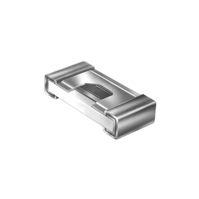

    贴片电阻 0603 100mΩ ±2% 125mW ±300ppm/℃
L0603MR100GNW 数据手册
L www.vishay.com Vishay Sfernice SMD Wraparound Ultra Low Value Thin Film Resistors FEATURES • NiCr + Ta2O5 resistive layer • Pre-soldered or gold terminations • No inductance for high frequency applications Available • Alumina substrates for high power handling capability Available • Resistance range: 0.1  to 9.99  • TCR down to 50 ppm/°C Available • Power rating: up to 2 W at +70 °C • Withstand AEC-Q200 humidity test ADDITIONAL RESOURCES • Material categorization: for definitions of compliance please see www.vishay.com/doc?99912 3D 3D 3D Models Note * This datasheet provides information about parts that are RoHS-compliant and / or parts that are non RoHS-compliant. For example, parts with lead (Pb) terminations are not RoHS-compliant. Please see the information / tables in this datasheet for details With extremely low resistance and high power capabilities, these ultra low value resistors are available with solderable or weldable terminations. STANDARD ELECTRICAL SPECIFICATIONS MODEL SIZE RESISTANCE RANGE  RATED POWER P70 °C W LIMITING ELEMENT VOLTAGE V TOLERANCE ±% TEMPERATURE COEFFICIENT ± ppm/°C L0603 0603 0.1 to 9.99 0.125 50 1, 2, 3, 5, 10 50, 100, 200, 300 L0805 0805 0.1 to 9.99 0.2 50 1, 2, 3, 5, 10 50, 100, 200, 300 L1206 1206 0.1 to 9.99 0.33 50 1, 2, 3, 5, 10 50, 100, 200, 300 L1505 1505 0.1 to 9.99 0.5 50 1, 2, 3, 5, 10 50, 100, 200, 300 L2010 2010 0.1 to 9.99 1.0 50 1, 2, 3, 5, 10 50, 100, 200, 300 L2512 2512 0.1 to 9.99 2.0 (1) 50 1, 2, 3, 5, 10 50, 100, 200, 300 Note (1) With special assembly care CLIMATIC SPECIFICATIONS TOLERANCE AND TCR VS. OHMIC VALUE Operating temperature range TIGHTEST BEST OHMIC VALUE TOLERANCE TCR RANGE in  (%) (ppm/°C) -55 °C; +155 °C 0R1 < 0R25 TERMINATIONS 1 300 N or B 0R25 < 0R5 1 200 N or B 0R5 < 2R5 1 100 N or B 1 50 N or B 5 300 G MECHANICAL SPECIFICATIONS Substrate Alumina NiCr + Ta2O5 2R5 < 9R99 Silicone 0R1 < 0R25 Solderable B type: SnPb over nickel barrier N type: SnAg over nickel barrier G type: Gold over nickel barrier 0R25 < 0R5 5 200 G 0R < 1R 5 100 G 1R < 2R5 3 100 G 2R5 to 9R99 3 50 G Technology Coating Terminations Note • Refer to Application Note “Guidelines for Vishay Sfernice Resistive and Inductive Components” (document number: 52029) for recommended reflow profile. Profile #3 applies Revision: 31-Jan-2020 Document Number: 53018 1 For technical questions, contact: sferthinfilm@vishay.com THIS DOCUMENT IS SUBJECT TO CHANGE WITHOUT NOTICE. THE PRODUCTS DESCRIBED HEREIN AND THIS DOCUMENT ARE SUBJECT TO SPECIFIC DISCLAIMERS, SET FORTH AT www.vishay.com/doc?91000 L www.vishay.com Vishay Sfernice DIMENSIONS in millimeters (inches) A B C D E A B C D/E ± 0.152 (± 0.006) ± 0.127 (± 0.005) ± 0.127 (+ 0.005) ± 0.127 (± 0.005) 0603 1.52 (0.060) 0.85 (0.033) 0805 1.91 (0.075) 1.27 (0.050) 1206 3.06 (0.120) 1.60 (0.063) CASE SIZE 0.38 (0.015) 0.40 (0.016) 0.5 (0.020) 1505 3.81 (0.150) 1.32 (0.052) 2010 5.08 (0.200) 2.54 (0.100) 2512 6.30 (0.248) 3.30 (0.129) 0.48 (0.019) SUGGESTED LAND PATTERN in millimeters (inches) (to IPC-7351A) Gmin. Xmax. Zmax. CASE SIZE Zmax. Gmin. Xmax. 0603 2.37 (0.093) 0.35 (0.014) 0.98 (0.039) 0805 2.76 (0.109) 0.74 (0.029) 1.40 (0.055) 1206 3.91 (0.154) 1.85 (0.073) 1.73 (0.068) 1505 4.66 (0.183) 2.44 (0.096) 1.45 (0.057) 2010 5.93 (0.233) 3.71 (0.146) 2.67 (0.105) 2512 7.15 (0.281) 4.93 (0.194) 3.43 (0.135)  Option: Enlarged Terminations: 0063 For stringent and special power dissipation requirements, the thermal resistance between the resistive layer and the solder joint can be reduced using enlarged terminations chip resistors which are soldered on large and thick copper pads acting as heat sinks (see application note: “Power Dissipation in High Precision Vishay Sfernice Chip Resistors and Arrays (P Thin Film, PRA Arrays, CHP Thick Film)”: www.vishay.com/doc?53048). For enlarged terminations: Please consult Vishay Sfernice. Revision: 31-Jan-2020 Document Number: 53018 2 For technical questions, contact: sferthinfilm@vishay.com THIS DOCUMENT IS SUBJECT TO CHANGE WITHOUT NOTICE. THE PRODUCTS DESCRIBED HEREIN AND THIS DOCUMENT ARE SUBJECT TO SPECIFIC DISCLAIMERS, SET FORTH AT www.vishay.com/doc?91000 L www.vishay.com Vishay Sfernice Rated Power (%) POWER DERATING CURVE PACKAGING Several types of packaging are proposed: waffle-pack and tape and reel 100 NUMBER OF PIECES PER PACKAGE 80 SIZE MOQ 60 WAFFLE PACK 2" × 2" 0603 40 0 1206 1505 0 20 40 60 70 80 100 120 140 155 Ambient Temperature in °C MIN. 140 100 TAPE WIDTH MAX. 5000 100 0805 20 TAPE AND REEL 100 4000 8 mm 60 2010 2512 2000 50 PACKAGING RULES Waffle Pack Can be filled up to maximum quantity indicated in the table here above, taking into account the minimum order quantity. When quantity ordered exceeds maximum quantity of a single waffle pack, the waffle packs are stacked up on the top of each other and closed by one single cover. To get “not stacked up” waffle pack in case of ordered quantity > maximum number of pieces per package: Please consult Vishay Sfernice for specific ordering code. Tape and Reel Can be filled up to maximum quantity indicated in the table here above, taking into account the minimum order quantity. When quantity ordered is between the MOQ and the maximum reel capacity, only one reel is provided. When several reels are needed for ordered quantity within MOQ and maximum reel capacity: Please consult Vishay Sfernice for specific ordering code. PERFORMANCE VALUES AND DRIFT TESTS Thermal shock Short time overload Low temperature operation Resistance to solder heat Moisture resistance High temperature Load life Revision: 31-Jan-2020 CONDITIONS MIL-R-55342 REQUIREMENTS TYPICAL PERFORMANCES MIL-R-55342 C MIL-STD-702, method 107 ± 0.25 % ± 0.02 % MIL-R-55342 C PARA 3.10.4.7.5 ± 0.10 % ± 0.01 % MIL-R-55342 C PARA 3.9 and 4.7.4 ± 0.25 % ± 0.01 % MIL-R-55342 C PARA 3.12, 4.7.7, 4.7.1.2 ± 0.25 % ± 0.04 % MIL-R-55342 C PARA 3.13 and 4.7.8 MIL-STD-202, method 106 ± 0.40 % ± 0.01 % AEC-Q200 85 °C / 85 % RH / 0.1 Pn 1000 h - Max. < 0.5 % + 0.05  MIL-R-55342 C PARA 3.11 and 4.7.6 ± 0.20 % ± 0.075 % MIL-R-55342 C 2000 h Pn at 70 °C MIL-STD-202, method 108 ± 0.50 % ± 0.15 % Document Number: 53018 3 For technical questions, contact: sferthinfilm@vishay.com THIS DOCUMENT IS SUBJECT TO CHANGE WITHOUT NOTICE. THE PRODUCTS DESCRIBED HEREIN AND THIS DOCUMENT ARE SUBJECT TO SPECIFIC DISCLAIMERS, SET FORTH AT www.vishay.com/doc?91000 L www.vishay.com Vishay Sfernice GLOBAL PART NUMBER INFORMATION New Global Part Numbering: L0805K1R00FBT0099 L 0 GLOBAL MODEL L 8 0 5 K 1 R 0 0 F B T 0 0 9 9 SIZE TCR VALUE TOLERANCE TERMINATION (1) PACKAGING OPTION 0603 0805 1206 1505 2010 2512 H = ± 50 ppm K = ± 100 ppm L = ± 200 ppm M = ± 300 ppm R designated decimal point For values under 1R Rxxx F=±1% G=±2% H=±3% J=±5% K = ± 10 % B: SnPb over nickel barrier N: SnAg over nickel barrier G: gold over nickel barrier For more information see Codification of Packaging table Leave blank if no option Historical Part Number Example: L 0805 K 1R00 1 % B T R0099 L 0805 K 1R00 1% B T R0099 MODEL SIZE TCR VALUE TOLERANCE TERMINATION PACKAGING OPTION Note (1) B: lead bearing version N and G: lead (Pb)-free / RoHS version CODIFICATION OF PACKAGING CODE 18 PACKAGING WAFFLE PACK W 100 min., 1 mult. WA 100 min., 100 mult. (available only in size 1206) PLASTIC TAPE (Standard for all sizes) T 100 min., 1 mult. TA 100 min., 100 mult. TB 250 min., 250 mult. TC 500 min., 500 mult. TD 1000 min., 1000 mult. TE 2500 min., 2500 mult. TF Full tape (quantity depending on size of chips) PAPER TAPE (Available for 0603, 0805, and 1206. Please consult Vishay Sfernice for other sizes) PT 100 min., 1 mult. PA 100 min., 100 mult. PB 250 min., 250 mult. PC 500 min., 500 mult. PD 1000 min., 1000 mult. PE 2500 min., 2500 mult. PF Full tape (quantity depending on size of chips) Revision: 31-Jan-2020 Document Number: 53018 4 For technical questions, contact: sferthinfilm@vishay.com THIS DOCUMENT IS SUBJECT TO CHANGE WITHOUT NOTICE. THE PRODUCTS DESCRIBED HEREIN AND THIS DOCUMENT ARE SUBJECT TO SPECIFIC DISCLAIMERS, SET FORTH AT www.vishay.com/doc?91000 Legal Disclaimer Notice www.vishay.com Vishay Disclaimer ALL PRODUCT, PRODUCT SPECIFICATIONS AND DATA ARE SUBJECT TO CHANGE WITHOUT NOTICE TO IMPROVE RELIABILITY, FUNCTION OR DESIGN OR OTHERWISE. Vishay Intertechnology, Inc., its affiliates, agents, and employees, and all persons acting on its or their behalf (collectively, “Vishay”), disclaim any and all liability for any errors, inaccuracies or incompleteness contained in any datasheet or in any other disclosure relating to any product. Vishay makes no warranty, representation or guarantee regarding the suitability of the products for any particular purpose or the continuing production of any product. To the maximum extent permitted by applicable law, Vishay disclaims (i) any and all liability arising out of the application or use of any product, (ii) any and all liability, including without limitation special, consequential or incidental damages, and (iii) any and all implied warranties, including warranties of fitness for particular purpose, non-infringement and merchantability. Statements regarding the suitability of products for certain types of applications are based on Vishay's knowledge of typical requirements that are often placed on Vishay products in generic applications. Such statements are not binding statements about the suitability of products for a particular application. It is the customer's responsibility to validate that a particular product with the properties described in the product specification is suitable for use in a particular application. Parameters provided in datasheets and / or specifications may vary in different applications and performance may vary over time. All operating parameters, including typical parameters, must be validated for each customer application by the customer's technical experts. Product specifications do not expand or otherwise modify Vishay's terms and conditions of purchase, including but not limited to the warranty expressed therein. Hyperlinks included in this datasheet may direct users to third-party websites. These links are provided as a convenience and for informational purposes only. Inclusion of these hyperlinks does not constitute an endorsement or an approval by Vishay of any of the products, services or opinions of the corporation, organization or individual associated with the third-party website. Vishay disclaims any and all liability and bears no responsibility for the accuracy, legality or content of the third-party website or for that of subsequent links. Except as expressly indicated in writing, Vishay products are not designed for use in medical, life-saving, or life-sustaining applications or for any other application in which the failure of the Vishay product could result in personal injury or death. Customers using or selling Vishay products not expressly indicated for use in such applications do so at their own risk. Please contact authorized Vishay personnel to obtain written terms and conditions regarding products designed for such applications. No license, express or implied, by estoppel or otherwise, to any intellectual property rights is granted by this document or by any conduct of Vishay. Product names and markings noted herein may be trademarks of their respective owners. © 2021 VISHAY INTERTECHNOLOGY, INC. ALL RIGHTS RESERVED Revision: 09-Jul-2021 1 Document Number: 91000
