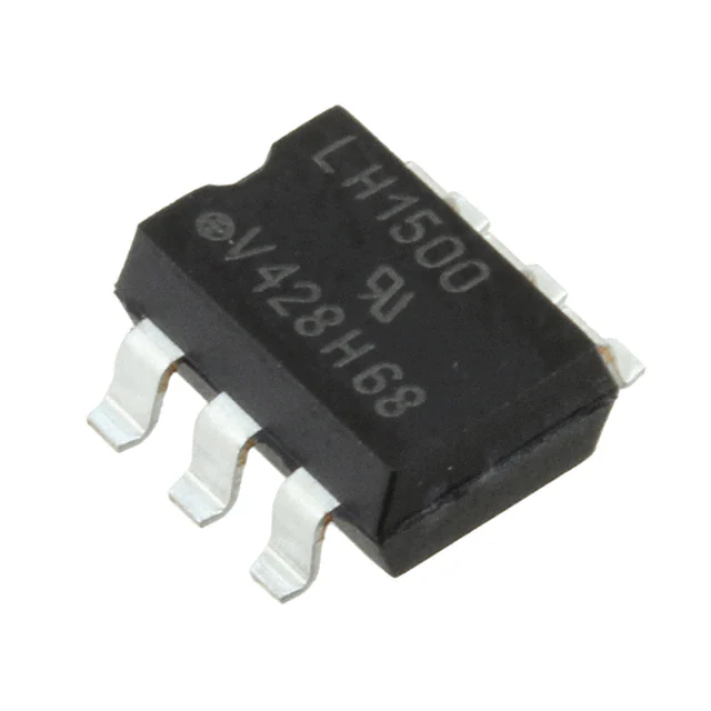

    光继电器 单刀单掷/常开 SPST-NO 1.36VDC 贴片 140mA/350VAC 140mA/350VDC 250mA/350VDC
LH1500AABTR 数据手册
LH1500AAB, LH1500AABTR, LH1500AT www.vishay.com Vishay Semiconductors 1 Form A Solid-State Relay (Normally Open) FEATURES • Current limit protection • Isolation test voltage 5300 VRMS • Typical RON 22 Ω 6 S1 A 1 • Load voltage 350 V C 2 5 DC • Load current 140 mA / 250 mA • High surge capability 3 4 S2 • Clean bounce free switching • Low power consumption • Material categorization: for definitions of compliance please see www.vishay.com/doc?99912 APPLICATIONS DESCRIPTION • General telecom switching The LH1500 is robust, ideal for telecom and ground fault applications. It is an SPST normally open switch (1 Form A) that replaces electromechanical relays in many applications. It is constructed using a GaAlAs LED for actuation control and MOSFETs for the switch output. In addition, it employs current-limiting circuitry to provide overvoltage protection. • Security equipment • Instrumentation • Industrial controls AGENCY APPROVALS • UL1577, file no. E52744 ORDERING INFORMATION L H 1 5 PART NUMBER PACKAGE SMD-6, tube SMD-6, tape and reel DIP-6, tube Rev. 2.1, 05-Jul-2018 0 0 # ELECTR. VARIATION # # PACKAGE CONFIG. T DIP-6 R TAPE AND REEL 7.62 mm SMD-6 > 0.1 mm UL LH1500AAB LH1500AABTR LH1500AT Document Number: 83804 1 For technical questions, contact: optocoupleranswers@vishay.com THIS DOCUMENT IS SUBJECT TO CHANGE WITHOUT NOTICE. THE PRODUCTS DESCRIBED HEREIN AND THIS DOCUMENT ARE SUBJECT TO SPECIFIC DISCLAIMERS, SET FORTH AT www.vishay.com/doc?91000 LH1500AAB, LH1500AABTR, LH1500AT www.vishay.com Vishay Semiconductors ABSOLUTE MAXIMUM RATINGS (Tamb = 25 °C, unless otherwise specified) PARAMETER CONDITION SYMBOL VALUE UNIT IRED continuous forward current IF 50 mA IRED reverse voltage VR 5 V Pdiss 80 mW DC or peak AC load voltage VL 350 V Continuous load current (AC/DC configuration) IL 140 mA IL 250 mA Pdiss 550 mW INPUT Input power dissipation OUTPUT Continuous load current (DC only configuration) SSR output power dissipation (continuous) SSR Ambient temperature range Tamb -40 to +85 °C Storage temperature range Tstg -40 to +150 °C Tsld 260 °C Soldering temperature t = 10 s max. Note • Stresses in excess of the absolute maximum ratings can cause permanent damage to the device. Functional operation of the device is not implied at these or any other conditions in excess of those given in the operational sections of this document. Exposure to absolute maximum ratings for extended periods of the time can adversely affect reliability ELECTRICAL CHARACTERISTICS (Tamb = 25 °C, unless otherwise specified) PARAMETER TEST CONDITION SYMBOL MIN. TYP. MAX. UNIT INPUT IRED forward current, switch turn-on IL = 100 mA, t = 10 ms IFon - 0.3 2 mA IRED forward current, switch turn-off VL = 350 V IFoff 0.05 0.15 - mA IRED forward voltage IF = 10 mA VF - 1.36 1.45 V On-resistance (AC/DC configuration) IF = 5 mA, IL = 50 mA RON - 22 27 Ω On-resistance (DC only configuration) IF = 5 mA, IL = 100 mA RON - 5.2 7 Ω OUTPUT Off-resistance Off-state leakage current Output capacitance (AC/DC configuration) Current limit (AC/DC configuration) (1) IF = 0 mA, VL = ± 100 V ROFF 0.5 5000 - GΩ IF = 0 mA, VL = ± 100 V IO - 5 mA 0 50 T = 85 °C 40 T = 25 °C 30 20 T = -40 °C 10 0 -40 -20 0 20 40 60 80 100 0 0.5 Tamb - Ambient Temperature (°C) Fig. 5 - Maximum Load Current vs. Ambient Temperature 1.5 2.0 Fig. 7 - Forward Current vs. Forward Voltage 1.7 2.5 1.6 Normalized Forward Current for Switch Turn-On VF - Forward Voltage (V) 1.0 VF - Forward Voltage (V) 1.5 IF = 10 mA 1.4 1.3 IF = 2 mA 1.2 IF = 5 mA 1.1 1.0 IL = 100 mA 2.0 1.5 1.0 0.5 Normalized to Tamb = 25 °C 0 -40 -20 0 20 40 60 80 100 Tamb - Ambient Temperature (°C) Fig. 6 - Forward Voltage vs. Ambient Temperature Rev. 2.1, 05-Jul-2018 -40 -20 0 20 40 60 80 100 Tamb - Ambient Temperature (°C) Fig. 8 - Normalized Forward Current for Switch Turn-On vs. Ambient Temperature Document Number: 83804 4 For technical questions, contact: optocoupleranswers@vishay.com THIS DOCUMENT IS SUBJECT TO CHANGE WITHOUT NOTICE. THE PRODUCTS DESCRIBED HEREIN AND THIS DOCUMENT ARE SUBJECT TO SPECIFIC DISCLAIMERS, SET FORTH AT www.vishay.com/doc?91000 LH1500AAB, LH1500AABTR, LH1500AT www.vishay.com Vishay Semiconductors 2.0 IL = 50 mA IF = 5.0 mA IL = 50 mA 1.5 Turn-On Time (ms) Normalized On-Resistance 2.0 1.0 0.5 1.5 T = 85 °C 1.0 T = 25 °C 0.5 T = -40 °C Normalized to Tamb = 25 °C 0 0 -40 -20 0 20 40 60 80 100 0 Tamb - Ambient Temperature (°C) Fig. 9 - Normalized On-Resistance vs. Ambient Temperature 30 40 50 2.0 IF = 0 mA f = 1 MHz 50 Normalized Turn-On Time Switch Capacitance (pF) 20 Fig. 12 - Turn-On Time vs. Forward Current 60 40 30 20 10 1.8 IF = 5 mA 1.6 1.4 1.2 1.0 0.8 0.6 0.4 0.2 Normalized to Tamb = 25 °C 0 0 0 10 20 30 40 50 -40 60 -20 0 20 40 60 80 100 Tamb - Ambient Temperature (°C) Applied Voltage (V) Fig. 10 - Switch Capacitance vs. Applied Voltage Fig. 13 - Normalized Turn-On Time vs. Ambient Temperature 100 0.20 IF = 0 mA IL = 50 mA T = 85 °C T = 85 °C 0.16 10 Turn-Off Time (ms) Off-State Leakage Current (nA) 10 IF - Forward Current (mA) T = 25 °C 1 T = -40 °C 0.1 0.01 0.12 T = 25 °C 0.08 T = -40 °C 0.04 0 0 100 200 300 VL - Load Voltage (V) Fig. 11 - Off-State Leakage Current vs. Load Voltage Rev. 2.1, 05-Jul-2018 0 10 20 30 40 50 IF - Forward Current (mA) Fig. 14 - Turn-Off Time vs. Forward Current Document Number: 83804 5 For technical questions, contact: optocoupleranswers@vishay.com THIS DOCUMENT IS SUBJECT TO CHANGE WITHOUT NOTICE. THE PRODUCTS DESCRIBED HEREIN AND THIS DOCUMENT ARE SUBJECT TO SPECIFIC DISCLAIMERS, SET FORTH AT www.vishay.com/doc?91000 LH1500AAB, LH1500AABTR, LH1500AT www.vishay.com Vishay Semiconductors Normalized Turn-Off Time 2.0 1.8 IF = 5.0 mA 1.6 1.4 1.2 1.0 0.8 0.6 0.4 0.2 Normalized to Tamb = 25 °C 0 -40 -20 0 20 40 60 80 100 Tamb - Ambient Temperature (°C) Fig. 15 - Normalized Turn-Off Time vs. Ambient Temperature PACKAGE DIMENSIONS (in millimeters) SMD-6 9.80 ± 0.25 7.62 typ. 7.25 ± 0.10 6.65 ± 0.15 0.25 ± 0.20 1.00 ± 0.10 2.54 nom. 2 x 2.54 = 5.08 6 5 0.25 ± 0.10 3.55 ± 0.25 0.79 typ. 7.60 max. 0.60 min. 8.00 min. Leads coplanarity 0.1 max. 4 2.54 1.50 5.08 Recommended footprint Pin one I.D. 8.0 min. 1.50 11.00 1 Rev. 2.1, 05-Jul-2018 2 3 Document Number: 83804 6 For technical questions, contact: optocoupleranswers@vishay.com THIS DOCUMENT IS SUBJECT TO CHANGE WITHOUT NOTICE. THE PRODUCTS DESCRIBED HEREIN AND THIS DOCUMENT ARE SUBJECT TO SPECIFIC DISCLAIMERS, SET FORTH AT www.vishay.com/doc?91000 LH1500AAB, LH1500AABTR, LH1500AT www.vishay.com Vishay Semiconductors DIP-6 7.60 max. 7.25 ± 0.10 6.09 ± 0.25 1.00 ± 0.10 3.04 ± 0.25 0.70 ± 0.20 3.55 ± 0.25 0.79 typ. 7.62 typ. 6.65 ± 0.15 0.50 ± 0.10 3° to 9 ° 2.54 nom. 2 x 2.54 = 5.08 6 5 4 1 2 3 10 0.25 ± 0. Pin one I.D. Fig. 16 - Package Drawings PACKAGE MARKING LH1500 V YWW 68 Fig. 17 - LH1500 Note • Tape and reel suffix (TR) is not part of the package marking Rev. 2.1, 05-Jul-2018 Document Number: 83804 7 For technical questions, contact: optocoupleranswers@vishay.com THIS DOCUMENT IS SUBJECT TO CHANGE WITHOUT NOTICE. THE PRODUCTS DESCRIBED HEREIN AND THIS DOCUMENT ARE SUBJECT TO SPECIFIC DISCLAIMERS, SET FORTH AT www.vishay.com/doc?91000 LH1500AAB, LH1500AABTR, LH1500AT www.vishay.com Vishay Semiconductors PACKING INFORMATION (in millimeters) 2.0 ± 0.1 4.0 ± 0.1 0.35 ± 0.05 1.75 ± 0.1 1.5 ± 0.1 PIN 1 7.5 ± 0.1 16.0 ± 0.3 CL 7.77 ± 0.1 7.77 ± 0.1 12.0 ± 0.1 10.3 ± 0.1 3.9 ± 0.1 4.4 ± 0.1 1.5 ± 0.1 Note: • Cummulative tolerance of 10 spocket holes is 0.20 mm Fig. 18 - Tape and Reel Packing TAPE AND REEL PACKING TYPE UNITS/REEL SMD-6 1000 TUBE PACKING TYPE UNITS/TUBE TUBES/BOX UNITS/BOX SMD-6 50 40 2000 DIP-6 50 40 2000 SOLDER PROFILES Axis Title Axis Title 10000 5s 10000 300 Lead temperature 1000 ca. 2 K/s ca. 200 K/s 150 Full line: typical Dotted lines: process limits Second wave 100 °C to 130 °C 100 100 2 K/s 50 2nd line Temperature (°C) 200 10 100 150 200 Max. 30 s 150 Max. 120 s 100 Max. 100 s Max. ramp down 6 °C/s 100 Max. ramp up 3 °C/s Fig. 19 - Wave Soldering Double Wave Profile According to J-STD-020 for DIP Devices 10 0 0 250 Time (s) 948626 1000 200 50 0 50 245 °C ca. 5 K/s Forced cooling 0 255 °C 240 °C 217 °C 250 235 °C to 260 °C First wave 1st line 2nd line 2nd line Temperature (°C) 250 Max. 260 °C 1st line 2nd line 300 19841 50 100 150 200 250 300 Time (s) Fig. 20 - Lead (Pb)-free Reflow Solder Profile According to J-STD-020 for SMD Devices HANDLING AND STORAGE CONDITIONS ESD level: HBM class 2 Floor life: unlimited Conditions: Tamb < 30 °C, RH < 60 % Moisture sensitivity level 1, according to J-STD-020 Rev. 2.1, 05-Jul-2018 Document Number: 83804 8 For technical questions, contact: optocoupleranswers@vishay.com THIS DOCUMENT IS SUBJECT TO CHANGE WITHOUT NOTICE. THE PRODUCTS DESCRIBED HEREIN AND THIS DOCUMENT ARE SUBJECT TO SPECIFIC DISCLAIMERS, SET FORTH AT www.vishay.com/doc?91000 Legal Disclaimer Notice www.vishay.com Vishay Disclaimer ALL PRODUCT, PRODUCT SPECIFICATIONS AND DATA ARE SUBJECT TO CHANGE WITHOUT NOTICE TO IMPROVE RELIABILITY, FUNCTION OR DESIGN OR OTHERWISE. Vishay Intertechnology, Inc., its affiliates, agents, and employees, and all persons acting on its or their behalf (collectively, “Vishay”), disclaim any and all liability for any errors, inaccuracies or incompleteness contained in any datasheet or in any other disclosure relating to any product. Vishay makes no warranty, representation or guarantee regarding the suitability of the products for any particular purpose or the continuing production of any product. To the maximum extent permitted by applicable law, Vishay disclaims (i) any and all liability arising out of the application or use of any product, (ii) any and all liability, including without limitation special, consequential or incidental damages, and (iii) any and all implied warranties, including warranties of fitness for particular purpose, non-infringement and merchantability. Statements regarding the suitability of products for certain types of applications are based on Vishay’s knowledge of typical requirements that are often placed on Vishay products in generic applications. Such statements are not binding statements about the suitability of products for a particular application. It is the customer’s responsibility to validate that a particular product with the properties described in the product specification is suitable for use in a particular application. Parameters provided in datasheets and / or specifications may vary in different applications and performance may vary over time. All operating parameters, including typical parameters, must be validated for each customer application by the customer’s technical experts. Product specifications do not expand or otherwise modify Vishay’s terms and conditions of purchase, including but not limited to the warranty expressed therein. Except as expressly indicated in writing, Vishay products are not designed for use in medical, life-saving, or life-sustaining applications or for any other application in which the failure of the Vishay product could result in personal injury or death. Customers using or selling Vishay products not expressly indicated for use in such applications do so at their own risk. Please contact authorized Vishay personnel to obtain written terms and conditions regarding products designed for such applications. No license, express or implied, by estoppel or otherwise, to any intellectual property rights is granted by this document or by any conduct of Vishay. Product names and markings noted herein may be trademarks of their respective owners. © 2019 VISHAY INTERTECHNOLOGY, INC. ALL RIGHTS RESERVED Revision: 01-Jan-2019 1 Document Number: 91000
