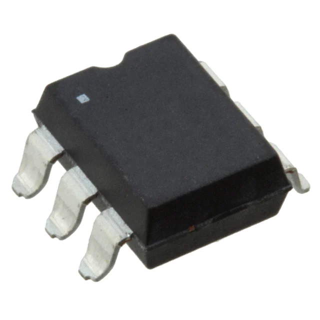

LH1511BAB, LH1511BABTR, LH1511BT Vishay Semiconductors 1 Form B Solid State Relay SMD S' FEATURES S' S 6 DC 5 S' 4 1 2 3 • • • • • • • DIP Isolation test voltage 3750 VRMS Typical RON 10  Load voltage 200 V Clean bounce free switching Low power consumption SMD lead available on tape and reel Compliant ot RoHS Directive 2002/95/EC and in accordance to WEEE 2002/96/EC APPLICATIONS i179041-2 • • • • DESCRIPTION The LH1511 relays are SPST normally closed switches (1 form B) that can replace electromechanical relays in many applications. The relays are constructed as a multi-chip hybrid device. Actuation control is via an infrared LED. The output switch is a combination of a photodiode array with MOSFET switches and control circuity. The relays can be configured for AC/DC or DC only operation. General telecom switching Security equipment Instrumentation Industrial controls AGENCY APPROVALS UL1577: file no. E52744 CSA: certification 093751 ORDERING INFORMATION L H 1 5 1 PART NUMBER 1 B ELECTR. VARIATION # # T PACKAGE CONFIG. DIP R TAPE AND REEL PACKAGE SMD-6, gullwing, tubes SMD-6, gullwing, tape and reel DIP-6, tubes 7.62 mm SMD > 0.1 mm UL, CSA LH1511BAB LH1511BABTR LH1511BT ABSOLUTE MAXIMUM RATINGS (Tamb = 25 °C, unless otherwise specified) PARAMETER INPUT LED continuous forward current LED reverse voltage OUTPUT DC or peak AC load voltage Continuous DC load current - bidirectional Continuous DC load current - unidirectional Peak load current (single shot) SSR Ambient temperature range Storage temperature range Pin soldering temperature (1) Input to output isolation voltage Output power dissipation (continuous) TEST CONDITION SYMBOL VALUE UNIT IR  10 μA IF VR 50 8 mA V VL IL IL IP 200 200 300 400 V mA mA mA Tamb Tstg Tsld VISO Pdiss - 40 to + 85 - 40 to + 125 260 3750 550 °C °C °C VRMS mW IL  50 μA t = 100 ms t = 10 s max. t = 1 s, IISO = 10 μA max. Notes • Stresses in excess of the absolute maximum ratings can cause permanent damage to the device. Functional operation of the device is not implied at these or any other conditions in excess of those given in the operational sections of this document. Exposure to absolute maximum ratings for extended periods of the time can adversely affect reliability. (1) Refer to reflow profile for soldering conditions for surface mounted devices (SMD). Refer to wave profile for soldering conditions for through hole devices (DIP). Document Number: 83811 Rev. 1.6, 20-May-11 For technical questions, contact: optocoupleranswers@vishay.com www.vishay.com 1 This document is subject to change without notice. THE PRODUCTS DESCRIBED HEREIN AND THIS DOCUMENT ARE SUBJECT TO SPECIFIC DISCLAIMERS, SET FORTH AT www.vishay.com/doc?91000 LH1511BAB, LH1511BABTR, LH1511BT 1 Form B Solid State Relay Vishay Semiconductors ELECTRICAL CHARACTERISTICS (Tamb = 25 °C, unless otherwise specified) PARAMETER TEST CONDITION SYMBOL MIN. TYP. 0.2 0.9 MAX. UNIT INPUT LED forward current, switch turn-on IL = ± 200 mA, t = 10 ms IFon LED forward current, switch turn-off VL = ± 150 V IFoff IF = 10 mA VF LED forward voltage 1.15 mA 1 2 mA 1.26 1.45 V  OUTPUT On-resistance, AC/DC: pin 4, 6 (+) to 5 (-) IF = 0 mA, IL = 50 mA RON 10 15 On-resistance, DC: pin 4, 6 (+) to 5 (-) IF = 0 mA, IL = 100 mA RON 2.5 3.75 Off-resistance IF = 5 mA, VL = ± 100 V ROFF Off-state leakage current IF = 5 mA, VL = ± 200 V IO 0.07 IF = 5 mA, VL = 50 V CO 50 pF VISO = 1 V CIO 3 pF Output capacitance 0.1 1.4  G 1 μA TRANSFER Capacitance (input to output) Note • Minimum and maximum values are testing requirements. Typical values are characteristics of the device and are the result of engineering evaluations. Typical values are for information only and are not part of the testing requirements. SWITCHING CHARACTERISTICS (Tamb = 25 °C, unless otherwise specified) PARAMETER TEST CONDITION SYMBOL TYP. MAX. UNIT Turn-on time IF = 10 mA, IL = 50 mA ton MIN. 1.2 3 ms Turn-off time IF = 10 mA, IL = 50 mA toff 1 3 ms TYPICAL CHARACTERISTICS (Tamb = 25 °C, unless otherwise specified) 150 Load Current (mA) 120 90 60 30 0 - 40 - 20 0 20 40 60 80 Ambient Temperature (°C) ilh1511bt_00 Fig. 1 - Recommended Operating Conditions www.vishay.com 2 For technical questions, contact: optocoupleranswers@vishay.com Document Number: 83811 Rev. 1.6, 20-May-11 This document is subject to change without notice. THE PRODUCTS DESCRIBED HEREIN AND THIS DOCUMENT ARE SUBJECT TO SPECIFIC DISCLAIMERS, SET FORTH AT www.vishay.com/doc?91000 LH1511BAB, LH1511BABTR, LH1511BT 1 Form B Solid State Relay Vishay Semiconductors PACKAGE DIMENSIONS in millimeters DIP 8.38 2.54 6.35 9.14 ISO method A 0.46 6 to 0.80 dia. 2.54 7.62 3.30 6.35 7.24 typ. 9.14 9.14 5.08 i178015-1 SMD 8.38 2.54 2.54 6.35 8.31 9.53 1.90 0.46 1.50 7.62 3.30 4.45 ISO method A 0.64 typ. i178016-1 0.25 typ. PACKAGE MARKING (example) LH1511 V YWW 68 Note • Tape and reel suffix (TR) is not part of the package marking. Document Number: 83811 Rev. 1.6, 20-May-11 For technical questions, contact: optocoupleranswers@vishay.com www.vishay.com 3 This document is subject to change without notice. THE PRODUCTS DESCRIBED HEREIN AND THIS DOCUMENT ARE SUBJECT TO SPECIFIC DISCLAIMERS, SET FORTH AT www.vishay.com/doc?91000 Footprint and Schematic Information www.vishay.com Vishay Semiconductors Footprint and Schematic Information for LH1511BAB, LH1511BABTR, LH1511BT The footprint and schematic symbols for the following parts can be accessed using the associated links. They are available in Eagle, Altium, KiCad, OrCAD / Allegro, Pulsonix, and PADS. Note that the 3D models for these parts can be found on the Vishay product page. PART NUMBER FOOTPRINT / SCHEMATIC LH1511BAB LH1511BABTR www.snapeda.com/parts/LH1511BAB/Vishay/view-part www.snapeda.com/parts/LH1511BABTR/Vishay/view-part LH1511BT www.snapeda.com/parts/LH1511BT/Vishay/view-part For technical issues and product support, please contact optocoupleranswers@vishay.com. SMD DIP i179041-2 Rev. 1.0, 09-May-17 Document Number: 84474 1 For technical questions, contact: optocoupleranswers@vishay.com THIS DOCUMENT IS SUBJECT TO CHANGE WITHOUT NOTICE. THE PRODUCTS DESCRIBED HEREIN AND THIS DOCUMENT ARE SUBJECT TO SPECIFIC DISCLAIMERS, SET FORTH AT www.vishay.com/doc?91000 Legal Disclaimer Notice www.vishay.com Vishay Disclaimer ALL PRODUCT, PRODUCT SPECIFICATIONS AND DATA ARE SUBJECT TO CHANGE WITHOUT NOTICE TO IMPROVE RELIABILITY, FUNCTION OR DESIGN OR OTHERWISE. Vishay Intertechnology, Inc., its affiliates, agents, and employees, and all persons acting on its or their behalf (collectively, “Vishay”), disclaim any and all liability for any errors, inaccuracies or incompleteness contained in any datasheet or in any other disclosure relating to any product. Vishay makes no warranty, representation or guarantee regarding the suitability of the products for any particular purpose or the continuing production of any product. To the maximum extent permitted by applicable law, Vishay disclaims (i) any and all liability arising out of the application or use of any product, (ii) any and all liability, including without limitation special, consequential or incidental damages, and (iii) any and all implied warranties, including warranties of fitness for particular purpose, non-infringement and merchantability. Statements regarding the suitability of products for certain types of applications are based on Vishay’s knowledge of typical requirements that are often placed on Vishay products in generic applications. Such statements are not binding statements about the suitability of products for a particular application. It is the customer’s responsibility to validate that a particular product with the properties described in the product specification is suitable for use in a particular application. Parameters provided in datasheets and / or specifications may vary in different applications and performance may vary over time. All operating parameters, including typical parameters, must be validated for each customer application by the customer’s technical experts. Product specifications do not expand or otherwise modify Vishay’s terms and conditions of purchase, including but not limited to the warranty expressed therein. Except as expressly indicated in writing, Vishay products are not designed for use in medical, life-saving, or life-sustaining applications or for any other application in which the failure of the Vishay product could result in personal injury or death. Customers using or selling Vishay products not expressly indicated for use in such applications do so at their own risk. Please contact authorized Vishay personnel to obtain written terms and conditions regarding products designed for such applications. No license, express or implied, by estoppel or otherwise, to any intellectual property rights is granted by this document or by any conduct of Vishay. Product names and markings noted herein may be trademarks of their respective owners. © 2019 VISHAY INTERTECHNOLOGY, INC. ALL RIGHTS RESERVED Revision: 01-Jan-2019 1 Document Number: 91000
