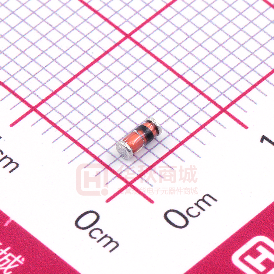

    开关二极管(小信号) VR=75V IF=300mA Trr=8ns P=500mW SOD80
LL4448-GS08 数据手册
LL4148, LL4448 www.vishay.com Vishay Semiconductors Small Signal Fast Switching Diodes FEATURES • Silicon epitaxial planar diode • Electrical data identical with the devices 1N4148 and 1N4448 respectively • Material categorization: for definitions of compliance www.vishay.com/doc?99912 please see APPLICATIONS ADDITIONAL RESOURCES • Extreme fast switches 3D 3D 3D Models MECHANICAL DATA Case: MiniMELF (SOD-80) Weight: approx. 31 mg Cathode band color: black Packaging codes / options: GS18/10K per 13" reel (8 mm tape), 10K/box GS08/2.5K per 7" reel (8 mm tape), 12.5K/box PARTS TABLE TYPE DIFFERENTIATION ORDERING CODE TYPE MARKING CIRCUIT CONFIGURATION REMARKS LL4148 VRRM = 100 V, VF = max. 1000 mV at IF = 50 mA LL4148-GS08 or LL4148-GS18 - Single Tape and reel LL4448 VRRM = 100 V, LL4448-GS08 or LL4448-GS18 VF = max. 1000 mV at IF = 100 mA - Single Tape and reel PART ABSOLUTE MAXIMUM RATINGS (Tamb = 25 °C, unless otherwise specified) PARAMETER TEST CONDITION Repetitive peak reverse voltage Reverse voltage Peak forward surge current tp = 1 μs Repetitive peak forward current Forward continuous current Average forward current VR = 0 Power dissipation (1) SYMBOL VALUE UNIT VRRM 100 V VR 75 V IFSM 2 A IFRM 500 mA mA IF 300 IF(AV) 150 mA Ptot 500 mW SYMBOL VALUE UNIT RthJA 300 K/W TJ 175 °C Tstg -65 to +175 °C Note (1) Valid provided that electrodes are kept at ambient temperature THERMAL CHARACTERISTICS (Tamb = 25 °C, unless otherwise specified) PARAMETER TEST CONDITION Thermal resistance junction to ambient air (1) Junction temperature Storage temperature range Note (1) Valid provided that electrodes are kept at ambient temperature Rev. 2.1, 25-Feb-2020 Document Number: 85557 1 For technical questions within your region: DiodesAmericas@vishay.com, DiodesAsia@vishay.com, DiodesEurope@vishay.com THIS DOCUMENT IS SUBJECT TO CHANGE WITHOUT NOTICE. THE PRODUCTS DESCRIBED HEREIN AND THIS DOCUMENT ARE SUBJECT TO SPECIFIC DISCLAIMERS, SET FORTH AT www.vishay.com/doc?91000 LL4148, LL4448 www.vishay.com Vishay Semiconductors ELECTRICAL CHARACTERISTICS (Tamb = 25 °C, unless otherwise specified) PARAMETER Forward voltage TEST CONDITION PART SYMBOL MIN. IF = 5 mA LL4448 VF 0.620 TYP. IF = 50 mA LL4148 VF 0.860 IF = 100 mA LL4448 VF 0.930 MAX. UNIT 0.720 V 1 V 1 V VR = 20 V IR 25 nA VR = 20 V, Tj = 150 °C IR 50 μA VR = 75 V IR 5 μA Breakdown voltage IR = 100 μA, tp/T = 0.01, tp = 0.3 ms V(BR) Diode capacitance VR = 0 V, f = 1 MHz, VHF = 50 mV CD Reverse current IF = IR = 10 mA, iR = 1 mA Reverse recovery time 100 V 4 pF 8 IF = 10 mA, VR = 6 V, iR = 0.1 x IR, RL = 100 Ω ns trr 4 TYPICAL CHARACTERISTICS (Tamb = 25 °C, unless otherwise specified) 1000 1000 IR- Reverse Current (nA) IF - Forward Current (mA) LL4148 100 Scattering Limit 10 1 Tj = 25 °C 0.4 0.8 1.2 1.6 1 2.0 Fig. 1 - Forward Current vs. Forward Voltage 100 Fig. 3 - Reverse Current vs. Reverse Voltage 3.0 1000 CD - Diode Capacitance (pF) LL4448 IF - Forward Current (mA) 10 VR- Reverse Voltage (V) 94 9098 V F - Forward Voltage (V) 94 9096 Scattering Limit 10 1 0.1 0 Tj = 25 °C 100 100 Scattering Limit 10 1 f = 1 MHz Tj = 25 °C 2.5 2.0 1.5 1.0 0.5 Tj = 25 ° C 0 0.1 0 94 9097 0.4 0.8 1.2 1.6 0.1 2.0 V F - Forward Voltage (V) Fig. 2 - Forward Current vs. Forward Voltage 94 9099 1 10 100 VR - Reverse Voltage (V) Fig. 4 - Diode Capacitance vs. Reverse Voltage Rev. 2.1, 25-Feb-2020 Document Number: 85557 2 For technical questions within your region: DiodesAmericas@vishay.com, DiodesAsia@vishay.com, DiodesEurope@vishay.com THIS DOCUMENT IS SUBJECT TO CHANGE WITHOUT NOTICE. THE PRODUCTS DESCRIBED HEREIN AND THIS DOCUMENT ARE SUBJECT TO SPECIFIC DISCLAIMERS, SET FORTH AT www.vishay.com/doc?91000 LL4148, LL4448 www.vishay.com Vishay Semiconductors PACKAGE DIMENSIONS in millimeters (inches): MiniMELF (SOD-80) 1.6 (0.063) 1.4 (0.055) Cathode indentification * 0.47 (0.019) max. 3.7 (0.146) 3.3 (0.130) * The gap between plug and glass can be either on cathode or anode side 2.5 (0.098) max. 1.25 (0.49) min. 2 (0.079) min. Foot print recommendation: 5 (0.197) ref. Document no.:6.560-5005.01-4 Rev. 8 - Date: 07.June.2006 96 12070 Rev. 2.1, 25-Feb-2020 Document Number: 85557 3 For technical questions within your region: DiodesAmericas@vishay.com, DiodesAsia@vishay.com, DiodesEurope@vishay.com THIS DOCUMENT IS SUBJECT TO CHANGE WITHOUT NOTICE. THE PRODUCTS DESCRIBED HEREIN AND THIS DOCUMENT ARE SUBJECT TO SPECIFIC DISCLAIMERS, SET FORTH AT www.vishay.com/doc?91000 Legal Disclaimer Notice www.vishay.com Vishay Disclaimer ALL PRODUCT, PRODUCT SPECIFICATIONS AND DATA ARE SUBJECT TO CHANGE WITHOUT NOTICE TO IMPROVE RELIABILITY, FUNCTION OR DESIGN OR OTHERWISE. Vishay Intertechnology, Inc., its affiliates, agents, and employees, and all persons acting on its or their behalf (collectively, “Vishay”), disclaim any and all liability for any errors, inaccuracies or incompleteness contained in any datasheet or in any other disclosure relating to any product. Vishay makes no warranty, representation or guarantee regarding the suitability of the products for any particular purpose or the continuing production of any product. To the maximum extent permitted by applicable law, Vishay disclaims (i) any and all liability arising out of the application or use of any product, (ii) any and all liability, including without limitation special, consequential or incidental damages, and (iii) any and all implied warranties, including warranties of fitness for particular purpose, non-infringement and merchantability. Statements regarding the suitability of products for certain types of applications are based on Vishay's knowledge of typical requirements that are often placed on Vishay products in generic applications. Such statements are not binding statements about the suitability of products for a particular application. It is the customer's responsibility to validate that a particular product with the properties described in the product specification is suitable for use in a particular application. Parameters provided in datasheets and / or specifications may vary in different applications and performance may vary over time. All operating parameters, including typical parameters, must be validated for each customer application by the customer's technical experts. Product specifications do not expand or otherwise modify Vishay's terms and conditions of purchase, including but not limited to the warranty expressed therein. Hyperlinks included in this datasheet may direct users to third-party websites. These links are provided as a convenience and for informational purposes only. Inclusion of these hyperlinks does not constitute an endorsement or an approval by Vishay of any of the products, services or opinions of the corporation, organization or individual associated with the third-party website. Vishay disclaims any and all liability and bears no responsibility for the accuracy, legality or content of the third-party website or for that of subsequent links. Except as expressly indicated in writing, Vishay products are not designed for use in medical, life-saving, or life-sustaining applications or for any other application in which the failure of the Vishay product could result in personal injury or death. Customers using or selling Vishay products not expressly indicated for use in such applications do so at their own risk. Please contact authorized Vishay personnel to obtain written terms and conditions regarding products designed for such applications. No license, express or implied, by estoppel or otherwise, to any intellectual property rights is granted by this document or by any conduct of Vishay. Product names and markings noted herein may be trademarks of their respective owners. © 2022 VISHAY INTERTECHNOLOGY, INC. ALL RIGHTS RESERVED Revision: 01-Jan-2022 1 Document Number: 91000
