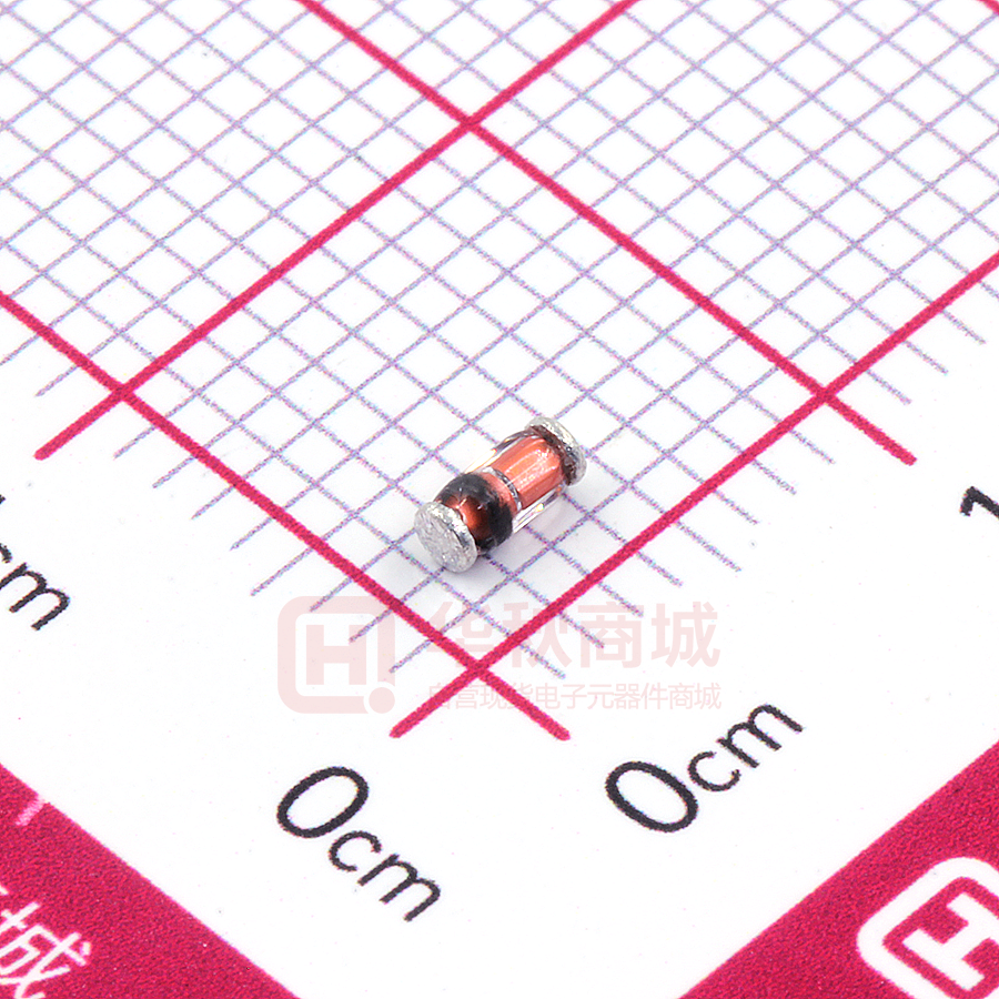

    开关二极管(小信号) P:500mW Vr:75V IF:300mA trr:8ns SOD80
LS4148-GS08 数据手册
LS4148, LS4448 www.vishay.com Vishay Semiconductors Small Signal Fast Switching Diodes FEATURES • Silicon epitaxial planar diodes • Electrical data identical with the devices 1N4148 and 1N4448 respectively • QuadroMELF package • AEC-Q101 qualified • Material categorization: for definitions of compliance please see www.vishay.com/doc?99912 APPLICATIONS DESIGN SUPPORT TOOLS click logo to get started • Extremely fast switches Models Available MECHANICAL DATA Case: QuadroMELF (SOD-80) Weight: approx. 34 mg Cathode band color: black Packaging codes / options: GS18/10K per 13" reel (8 mm tape), 10K/box GS08/2.5K per 7" reel (8 mm tape), 12.5K/box PARTS TABLE TYPE DIFFERENTIATION ORDERING CODE TYPE MARKING CIRCUIT CONFIGURATION REMARKS LS4148 VF = max. 1000 mV at IF = 50 mA LS4148-GS18 or LS4148-GS08 - Single Tape and reel LS4448 VF = max. 1000 mV at IF = 100 mA LS4448GS18 or LS4448GS08 - Single Tape and reel PART ABSOLUTE MAXIMUM RATINGS (Tamb = 25 °C, unless otherwise specified) PARAMETER TEST CONDITION Repetitive peak reverse voltage Reverse voltage Peak forward surge current tp = 1 μs Repetitive peak forward current Forward continuous current Average forward current VR = 0 Power dissipation SYMBOL VALUE UNIT VRRM 100 V VR 75 V IFSM 2 A IFRM 500 mA IF 300 mA IF(AV) 150 mA Ptot 500 mW THERMAL CHARACTERISTICS (Tamb = 25 °C, unless otherwise specified) PARAMETER Thermal resistance junction to ambient air Junction temperature Storage temperature range TEST CONDITION SYMBOL VALUE UNIT On PC board 50 mm x 50 mm x 1.6 mm RthJA 300 K/W Tj 175 °C Tstg -65 to +175 °C Rev. 2.0, 14-Jul-17 Document Number: 85561 1 For technical questions within your region: DiodesAmericas@vishay.com, DiodesAsia@vishay.com, DiodesEurope@vishay.com THIS DOCUMENT IS SUBJECT TO CHANGE WITHOUT NOTICE. THE PRODUCTS DESCRIBED HEREIN AND THIS DOCUMENT ARE SUBJECT TO SPECIFIC DISCLAIMERS, SET FORTH AT www.vishay.com/doc?91000 LS4148, LS4448 www.vishay.com Vishay Semiconductors ELECTRICAL CHARACTERISTICS (Tamb = 25 °C, unless otherwise specified) PARAMETER Forward voltage Reverse current TEST CONDITION PART SYMBOL MIN. IF = 5 mA LS4448 VF 0.620 TYP. IF = 50 mA LS4148 VF 0.860 IF = 100 mA LS4448 VF 0.930 MAX. UNIT 0.720 V 1 V 1 V VR = 20 V IR 25 nA VR = 20 V, Tj = 150 °C IR 50 μA 5 μA VR = 75 V IR Breakdown voltage IR = 100 μA, tp/T = 0.01, tp = 0.3 ms V(BR) Diode capacitance VR = 0, f = 1 MHz, VHF = 50 mV CD 4 pF IF = IR = 10 mA, iR = 1 mA trr 8 ns IF = 10 mA, VR = 6 V, iR = 0.1 x IR, RL = 100 Ω trr 4 ns Reverse recovery time 100 V TYPICAL CHARACTERISTICS (Tamb = 25 °C, unless otherwise specified) 1000 1000 IR- Reverse Current (nA) IF - Forward Current (mA) LS4148 100 Scattering Limit 10 1 Tj = 25 °C 0.1 0 0.4 0.8 1.2 1.6 Scattering Limit 10 1 1 2.0 Fig. 1 - Forward Current vs. Forward Voltage 10 Fig. 3 - Reverse Current vs. Reverse Voltage 1000 3.0 CD - Diode Capacitance (pF) IF - Forward Current (mA) LS4448 100 Scattering Limit 10 1 Tj = 25 °C 0 0.4 0.8 1.2 1.6 f = 1 MHz Tj = 25 °C 2.5 2.0 1.5 1.0 0.5 0 0.1 16642 100 VR- Reverse Voltage (V) 94 9098 VF - Forward Voltage (V) 16640 Tj = 25 °C 100 0.1 2.0 VF - Forward Voltage (V) Fig. 2 - Forward Current vs. Forward Voltage 94 9099 1 10 100 VR - Reverse Voltage (V) Fig. 4 - Diode Capacitance vs. Reverse Voltage Rev. 2.0, 14-Jul-17 Document Number: 85561 2 For technical questions within your region: DiodesAmericas@vishay.com, DiodesAsia@vishay.com, DiodesEurope@vishay.com THIS DOCUMENT IS SUBJECT TO CHANGE WITHOUT NOTICE. THE PRODUCTS DESCRIBED HEREIN AND THIS DOCUMENT ARE SUBJECT TO SPECIFIC DISCLAIMERS, SET FORTH AT www.vishay.com/doc?91000 LS4148, LS4448 www.vishay.com Vishay Semiconductors PACKAGE DIMENSIONS in millimeters (inches): QuadroMELF (SOD-80) 1.6 (0.063) 1.4 (0.055) 1. 7 (0 .0 gl as 6 7 ) s Cathode identification > R3 (R0.118) glass 0.47 (0.019) max. 3.7 (0.146) 3.3 (0.130) The gap between plug and glass can be either on cathode or anode side Foot print recommendation: 2.5 (0.098) max. 2 (0.079) min. 1.25 (0.049) min. 5 (0.197) ref. 96 12071 Rev. 2.0, 14-Jul-17 Document Number: 85561 3 For technical questions within your region: DiodesAmericas@vishay.com, DiodesAsia@vishay.com, DiodesEurope@vishay.com THIS DOCUMENT IS SUBJECT TO CHANGE WITHOUT NOTICE. THE PRODUCTS DESCRIBED HEREIN AND THIS DOCUMENT ARE SUBJECT TO SPECIFIC DISCLAIMERS, SET FORTH AT www.vishay.com/doc?91000 Legal Disclaimer Notice www.vishay.com Vishay Disclaimer  ALL PRODUCT, PRODUCT SPECIFICATIONS AND DATA ARE SUBJECT TO CHANGE WITHOUT NOTICE TO IMPROVE RELIABILITY, FUNCTION OR DESIGN OR OTHERWISE. Vishay Intertechnology, Inc., its affiliates, agents, and employees, and all persons acting on its or their behalf (collectively, “Vishay”), disclaim any and all liability for any errors, inaccuracies or incompleteness contained in any datasheet or in any other disclosure relating to any product. Vishay makes no warranty, representation or guarantee regarding the suitability of the products for any particular purpose or the continuing production of any product. To the maximum extent permitted by applicable law, Vishay disclaims (i) any and all liability arising out of the application or use of any product, (ii) any and all liability, including without limitation special, consequential or incidental damages, and (iii) any and all implied warranties, including warranties of fitness for particular purpose, non-infringement and merchantability. Statements regarding the suitability of products for certain types of applications are based on Vishay’s knowledge of typical requirements that are often placed on Vishay products in generic applications. Such statements are not binding statements about the suitability of products for a particular application. It is the customer’s responsibility to validate that a particular product with the properties described in the product specification is suitable for use in a particular application. Parameters provided in datasheets and / or specifications may vary in different applications and performance may vary over time. All operating parameters, including typical parameters, must be validated for each customer application by the customer’s technical experts. Product specifications do not expand or otherwise modify Vishay’s terms and conditions of purchase, including but not limited to the warranty expressed therein. Except as expressly indicated in writing, Vishay products are not designed for use in medical, life-saving, or life-sustaining applications or for any other application in which the failure of the Vishay product could result in personal injury or death. Customers using or selling Vishay products not expressly indicated for use in such applications do so at their own risk. Please contact authorized Vishay personnel to obtain written terms and conditions regarding products designed for such applications. No license, express or implied, by estoppel or otherwise, to any intellectual property rights is granted by this document or by any conduct of Vishay. Product names and markings noted herein may be trademarks of their respective owners. © 2017 VISHAY INTERTECHNOLOGY, INC. ALL RIGHTS RESERVED Revision: 08-Feb-17 1 Document Number: 91000

物料型号: - LS4148 - LS4448
器件简介: - Vishay Semiconductors生产的小型信号快速开关二极管。
引脚分配: - 引脚分配信息在文档中未明确说明,但通常QuadroMELF (SOD-80)封装的二极管有一个阳极和一个阴极,可通过颜色带或标记识别。
参数特性: - LS4148和LS4448的电气数据分别与1N4148和1N4448相同。 - 重复峰值反向电压(VRRM)为100V。 - 反向电压(VR)为75V。 - 峰值正向浪涌电流(IFSM)为2A。 - 重复峰值正向电流(IFRM)为500mA。 - 正向连续电流(IF)为300mA。 - 平均正向电流(IF(AV))为150mA。 - 总功耗(Ptot)为500mW。
功能详解: - 这些二极管是极快速的开关,适用于需要快速切换的应用。
应用信息: - 用于极快速开关。
封装信息: - 封装类型为QuadroMELF (SOD-80)。 - 重量约为34毫克。 - 阴极带颜色为黑色。 - 包装代码/选项包括GS18/10K每13英寸卷(8毫米胶带),10K/箱;GS08/2.5K每7英寸卷(8毫米胶带),12.5K/箱。
