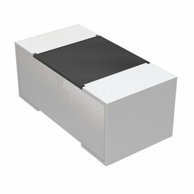

    贴片电阻 0402 100Ω ±1% 1/20W ±100ppm/℃
M55342K11B100DRS3 数据手册
RCWPM (Military M/D55342) www.vishay.com Vishay Dale Thick Film Chip Resistors, Military / Established Reliability MIL-PRF-55342 Qualified, Type RM FEATURES MATERIAL SPECIFICATIONS Resistive element Encapsulation Substrate Termination Solder finish Ruthenium oxide Epoxy 96 % alumina Solder-coated nickel barrier Tin / lead solder alloy • Fully conforms to the requirements of MIL-PRF-55342 • Established reliability - verified failure rate; M, P, R, U, S, V, and T levels • Construction is sulfur impervious against a high sulfur environment (ASTM B 809-95 test method) • 100 % group A screening per MIL-PRF-55342 • Termination style B - tin / lead wraparound over nickel barrier • Operating temperature range is -65 °C to +150 °C • For MIL-PRF-32159 zero ohm jumpers, see Vishay Dale’s RCWPM Jumper (Military M32159) datasheet (www.vishay.com/doc?31028) • Material categorization: for definitions of compliance please see www.vishay.com/doc?99912 STANDARD ELECTRICAL SPECIFICATIONS VISHAY DALE MODEL MIL MIL-PRF-55342 SPEC. TERM. STYLE SHEET CASE SIZE RCWPM-0502, RCWPM-0502-98 RM0502 01 B 0502 RCWPM-550, RCWPM-550-98 RM0505 02 B 0505 RCWPM-5100, RCWPM-5100-98 RM1005 03 B 1005 RCWPM-5150, RCWPM-5150-98 RM1505 04 B 1505 RCWPM-7225, RCWPM-7225-98 RM2208 05 B 2208 RCWPM-575, RCWPM-575-98 RM0705 06 B 0705 (3) RCWPM-1206, RCWPM-1206-98 RM1206 07 B 1206 RCWPM-2010, RCWPM-2010-98 RM2010 08 B 2010 RCWPM-2512, RCWPM-2512-98 RM2512 09 B 2512 RCWPM-1100, RCWPM-1100-98 RM1010 10 B 1010 RCWPM-0402, RCWPM-0402-98 RM0402 11 B 0402 Revision: 02-Sep-2021 POWER MAX. TEMPERATURE RESISTANCE RATING WORKING TOLERANCE COEFFICIENT (2) RANGE P70 °C VOLTAGE (1) ±% Ω ± ppm/°C W V 1 to 9.1 2, 5, 10 200, 300 0.05 40 10 to 22M 1, 2, 5, 10 100, 200, 300 10 to 10M 0.5 100, 200, 300 1 to 9.1 2, 5, 10 200, 300 0.125 40 10 to 22M 1, 2, 5, 10 100, 200, 300 10 to 10M 0.5 100, 200, 300 1 to 5.1 2, 5, 10 200, 300 0.20 75 5.6 to 22M 1, 2, 5, 10 100, 200, 300 5.62 to 10M 0.5 100, 200, 300 1 to 5.1 2, 5, 10 200, 300 0.15 125 5.6 to 22M 1, 2, 5, 10 100, 200, 300 5.62 to 10M 0.5 100, 200, 300 1 to 5.1 2, 5, 10 200, 300 0.225 175 5.6 to 22M 1, 2, 5, 10 100, 200, 300 5.62 to 10M 0.5 100, 200, 300 1 to 5.1 2, 5, 10 200, 300 0.15 50 5.6 to 22M 1, 2, 5, 10 100, 200, 300 5.62 to 10M 0.5 100, 200, 300 1 to 5.1 2, 5, 10 200, 300 0.25 100 5.6 to 22M 1, 2, 5, 10 100, 200, 300 5.62 to 10M 0.5 100, 200, 300 1 to 5.1 2, 5, 10 200, 300 0.80 150 5.6 to 22M 1, 2, 5, 10 100, 200, 300 5.62 to 10M 0.5 100, 200, 300 1 to 5.1 2, 5, 10 200, 300 1.0 200 5.6 to 22M 1, 2, 5, 10 100, 200, 300 5.62 to 10M 0.5 100, 200, 300 1 to 5.1 2, 5, 10 200, 300 0.50 75 5.6 to 22M 1, 2, 5, 10 100, 200, 300 5.62 to 10M 0.5 100, 200, 300 1 to 9.1 2, 5, 10 200, 300 0.05 30 10 to 22M 1, 2, 5, 10 100, 200, 300 10 to 10M 0.5 100, 200, 300 Document Number: 31010 1 For technical questions, contact: ff2aresistors@vishay.com THIS DOCUMENT IS SUBJECT TO CHANGE WITHOUT NOTICE. THE PRODUCTS DESCRIBED HEREIN AND THIS DOCUMENT ARE SUBJECT TO SPECIFIC DISCLAIMERS, SET FORTH AT www.vishay.com/doc?91000 RCWPM (Military M/D55342) www.vishay.com Vishay Dale STANDARD ELECTRICAL SPECIFICATIONS MIL-PRF-55342 MIL SPEC. TERM. STYLE SHEET VISHAY DALE MODEL CASE SIZE RCWPM-0603, RCWPM-0603-98 RM0603 12 B 0603 RCWPM-0302, RCWPM-0302-98 RM0302 13 B 0302 POWER MAX. RATING WORKING RESISTANCE TOLERANCE TEMPERATURE COEFFICIENT (2) RANGE P70 °C VOLTAGE (1) ±% Ω ± ppm/°C W V 1 to 5.1 2, 5, 10 200, 300 0.10 50 5.6 to 22M 1, 2, 5, 10 100, 200, 300 5.62 to 10M 0.5 100, 200, 300 1 to 9.1 2, 5, 10 200, 300 0.04 15 10 to 22M 1, 2, 5, 10 100, 200, 300 10 to 10M 0.5 100, 200, 300 Notes • DSCC has created a series of drawings to support the need for 0201-sized product. Vishay Dale is listed as a resource on this drawing as follows: POWER RATING MAX. WORKING DSCC DRAWING VISHAY DALE TERM. RES. RANGE RES. TOL. TEMP. COEF. P70 °C VOLTAGE (1) NUMBER MODEL Ω ±% ± ppm/°C W V 200 10 to 46.4 30 1, 5 07009 RCWP-0201 B 0.05 100 47 to 1M This drawing can be viewed at: www.landandmaritime.dla.mil/Programs/MilSpec/ListDwgs.aspx?DocTYPE=DSCCdwg (1) Continuous working voltage shall be P x R or maximum working voltage, whichever is less (2) Characteristics: K = ± 100 ppm/°C; L = ± 200 ppm/°C; M = ± 300 ppm/°C (3) MIL case size 0705 and EIA case size 0805 are dimensionally the same GLOBAL PART NUMBER INFORMATION New Global Part Numbering: M55342M02B10E0RWB (preferred part number format) M MIL STYLE D55342 applies to Style 07 (RM1206) only. 5 5 3 CHARACTERISTICS K = 100 ppm L = 200 ppm M = 300 ppm 4 2 SPEC. SHEET M 0 TERMINATION STYLE 2 B 1 VALUE AND TOLERANCE (see Standard B = pre-tinned (see Tolerance Electrical nickel barrier, and Multipliers Specifications wraparound table) table) M55342 applies to all other styles. 0 E FAILURE RATE 0 R W PACKAGING (1) B SPECIAL C = non-ER Blank = TP = tin / lead, M = 1.0 %/1000 h T/R (full) standard P = 0.1 %/1000 h (dash number) TN = tin / lead, R = 0.01 %/1000 h (up to 1 digits) T/R (full), w/ESD U = 0.01 %/1000 h (2) UL = tin / lead, T/R D = 0.5 % tolerance (3) S = 0.001 %/1000 h single lot date code (2) V = 0.001 %/1000 h S3 = tin / lead, S= T/R (1000 pieces) space level T = space level SV = tin / lead, T/R w/option 1 part (1000 pieces), w/ESD marking (-97) (4) WB = tin / lead, T= waffle tray space level (-98) 2= WA = tin / lead, option 1 waffle tray, part marking w/ESD (-20) (4) WL = tin / lead, waffle tray, 3= single lot date code options 2 and 3 part marking S2 = tin / lead, (-30) (4) T/R (500 pieces) SU = tin / lead, T/R (500 pieces), w/ESD S6 = tin / lead, T/R (300 pieces) ST = tin / lead, T/R (300 pieces), w/ESD Historical Part Numbering: M55342M02B10E0R (will continue to be accepted) M55342 M 02 B 10E0 R WB MIL STYLE CHARACTERISTICS SPEC. SHEET TERMINATION STYLE VALUE AND TOLERANCE FAILURE RATE PACKAGING CODE Notes • For additional information on packaging, refer to the Surface Mount Resistor Packaging document (www.vishay.com/doc?31543) (1) Products with space level failure rates are only offered in packaging codes with ESD overpack and labeling. For all other failure rates, the ESD pack codes are an optional type of packaging (2) Failure rates U and V require group A and B inspection ran on each production lot (3) Add a “D” after the packaging code at the end of the global part number to specify Vishay Dale Thick Film product with a tolerance of 0.5 % (4) MIL spec option 1, 2, and 3 part marking is not offered for the slash sheet 01, 02, 11, and 13 sizes Revision: 02-Sep-2021 Document Number: 31010 2 For technical questions, contact: ff2aresistors@vishay.com THIS DOCUMENT IS SUBJECT TO CHANGE WITHOUT NOTICE. THE PRODUCTS DESCRIBED HEREIN AND THIS DOCUMENT ARE SUBJECT TO SPECIFIC DISCLAIMERS, SET FORTH AT www.vishay.com/doc?91000 RCWPM (Military M/D55342) www.vishay.com Vishay Dale RESISTANCE TOLERANCE AND MULTIPLIERS TOLERANCE MULTIPLIER VALUE RANGE (Ω) M 1 1 to 9xx K N 1000 1K to 9xxK L P 1 000 000 1M to 22M ± 0.5 % ±1% ±2% ±5% ± 10 % W D G J Y E H Z F T 15J0 = 15 Ω ± 5 % 10K0 = 10 kΩ ± 5 % 560K = 560 kΩ ± 5 % 8L20 = 8.2 MΩ ± 5 % 10M0 = 10 Ω ± 10 % 10N0 = 10 kΩ ± 10 % 2P70 = 2.7 MΩ ± 10 % 8P20 = 8.2 MΩ ± 10 % 11D3 = 11.3 Ω ± 1 % 10E0 = 10 kΩ ± 1 % 332D = 332 Ω ± 1 % 2F21 = 2.21 MΩ ± 1 % 51G0 = 51 Ω ± 2 % 10H0 = 10 kΩ ± 2 % 33H0 = 33 kΩ ± 2 % 22T0 = 22 MΩ ± 2 % Examples: 38W8 = 38.8 Ω ± 0.5 % 10Y0 = 10 kΩ ± 0.5 % 988W = 988 Ω ± 0.5 % 2Z13 = 2.13 MΩ ± 0.5 % DIMENSIONS in inches (millimeters) D C B A E VISHAY DALE MODEL MIL-PRF-55342 STYLE MIL SPEC. SHEET A (LENGTH) B (WIDTH) C (HEIGHT) D (TOP TERM) E (BOTTOM TERM) RCWPM-0502 RM0502 01 0.055 ± 0.005 (1.40 ± 0.13) 0.023 ± 0.003 (0.58 ± 0.08) 0.015 ± 0.003 (0.38 ± 0.08) 0.010 ± 0.005 (0.25 ± 0.13) 0.015 ± 0.005 (0.38 ± 0.13) RCWPM-550 RM0505 02 0.055 ± 0.005 (1.40 ± 0.13) 0.050 ± 0.005 (1.27 ± 0.13) 0.020 ± 0.005 (0.51 ± 0.13) 0.010 ± 0.005 (0.25 ± 0.13) 0.015 ± 0.005 (0.38 ± 0.13) RCWPM-5100 RM1005 03 0.105 ± 0.005 (2.67 ± 0.13) 0.050 ± 0.005 (1.27 ± 0.13) 0.020 ± 0.005 (0.51 ± 0.13) 0.015 ± 0.005 (0.38 ± 0.13) 0.015 ± 0.005 (0.38 ± 0.13) RCWPM-5150 RM1505 04 0.155 ± 0.005 (3.94 ± 0.13) 0.050 ± 0.005 (1.27 ± 0.13) 0.020 ± 0.005 (0.51 ± 0.13) 0.015 ± 0.005 (0.38 ± 0.13) 0.015 ± 0.005 (0.38 ± 0.13) RCWPM-7225 RM2208 05 0.230 ± 0.005 (5.84 ± 0.13) 0.075 ± 0.005 (1.91 ± 0.13) 0.020 ± 0.005 (0.51 ± 0.13) 0.020 ± 0.005 (0.51 ± 0.13) 0.020 ± 0.005 (0.51 ± 0.13) RCWPM-575 RM0705 06 0.080 ± 0.005 (2.03 ± 0.13) 0.050 ± 0.005 (1.27 ± 0.13) 0.020 ± 0.005 (0.51 ± 0.13) 0.016 ± 0.008 (0.41 ± 0.20) 0.015 ± 0.005 (0.38 ± 0.13) RCWPM-1206 RM1206 07 0.125 ± 0.005 (3.18 ± 0.13) 0.063 ± 0.005 (1.60 ± 0.13) 0.020 ± 0.005 (0.51 ± 0.13) 0.015 ± 0.005 (0.38 ± 0.13) 0.015 ± 0.005 (0.38 ± 0.13) RCWPM-2010 RM2010 08 0.197 ± 0.006 (5.00 ± 0.15) 0.098 ± 0.005 (2.49 ± 0.13) 0.020 ± 0.005 (0.51 ± 0.13) 0.020 ± 0.005 (0.51 ± 0.13) 0.020 ± 0.005 (0.51 ± 0.13) RCWPM-2512 RM2512 09 0.250 ± 0.005 (6.35 ± 0.13) 0.124 ± 0.005 (3.15 ± 0.13) 0.020 ± 0.005 (0.51 ± 0.13) 0.020 ± 0.005 (0.51 ± 0.13) 0.020 ± 0.005 (0.51 ± 0.13) RCWPM-1100 RM1010 10 0.105 ± 0.005 (2.67 ± 0.13) 0.100 ± 0.005 (2.54 ± 0.13) 0.020 ± 0.005 (0.51 ± 0.13) 0.015 ± 0.005 (0.38 ± 0.13) 0.015 ± 0.005 (0.38 ± 0.13) RCWPM-0402 RM0402 11 0.039 ± 0.003 (0.99 ± 0.08) 0.020 ± 0.003 (0.51 ± 0.08) 0.013 ± 0.003 (0.33 ± 0.08) 0.010 ± 0.005 (0.25 ± 0.13) 0.010 ± 0.005 (0.25 ± 0.13) RCWPM-0603 RM0603 12 0.063 ± 0.005 (1.60 ± 0.13) 0.032 ± 0.005 (0.81 ± 0.13) 0.018 ± 0.005 (0.46 ± 0.13) 0.012 ± 0.005 (0.30 ± 0.13) 0.015 ± 0.005 (0.38 ± 0.13) RCWPM-0302 RM0302 13 0.034 ± 0.004 (0.86 ± 0.10) 0.021 ± 0.003 (0.53 ± 0.08) 0.013 ± 0.003 (0.33 ± 0.08) 0.007 ± 0.005 (0.18 ± 0.13) 0.008 ± 0.005 (0.20 ± 0.13) 0.024 ± 0.002 (0.61 ± 0.05) 0.012 ± 0.002 (0.30 ± 0.05) 0.009 ± 0.002 (0.23 ± 0.05) 0.006 ± 0.003 (0.15 ± 0.08) 0.006 + 0.002 - 0.004 (0.15 + 0.05 - 0.10) RCWP-0201 Revision: 02-Sep-2021 Document Number: 31010 3 For technical questions, contact: ff2aresistors@vishay.com THIS DOCUMENT IS SUBJECT TO CHANGE WITHOUT NOTICE. THE PRODUCTS DESCRIBED HEREIN AND THIS DOCUMENT ARE SUBJECT TO SPECIFIC DISCLAIMERS, SET FORTH AT www.vishay.com/doc?91000 RCWPM (Military M/D55342) www.vishay.com Vishay Dale Rated Power in % DERATING CURVE 120 100 80 60 40 20 0 - 55 - 25 0 25 50 75 100 125 150 175 70 Ambient Temperature in °C CAGE CODE: 91637 and 2799A (formerly SH903) Revision: 02-Sep-2021 Document Number: 31010 4 For technical questions, contact: ff2aresistors@vishay.com THIS DOCUMENT IS SUBJECT TO CHANGE WITHOUT NOTICE. THE PRODUCTS DESCRIBED HEREIN AND THIS DOCUMENT ARE SUBJECT TO SPECIFIC DISCLAIMERS, SET FORTH AT www.vishay.com/doc?91000 Legal Disclaimer Notice www.vishay.com Vishay Disclaimer ALL PRODUCT, PRODUCT SPECIFICATIONS AND DATA ARE SUBJECT TO CHANGE WITHOUT NOTICE TO IMPROVE RELIABILITY, FUNCTION OR DESIGN OR OTHERWISE. Vishay Intertechnology, Inc., its affiliates, agents, and employees, and all persons acting on its or their behalf (collectively, “Vishay”), disclaim any and all liability for any errors, inaccuracies or incompleteness contained in any datasheet or in any other disclosure relating to any product. Vishay makes no warranty, representation or guarantee regarding the suitability of the products for any particular purpose or the continuing production of any product. To the maximum extent permitted by applicable law, Vishay disclaims (i) any and all liability arising out of the application or use of any product, (ii) any and all liability, including without limitation special, consequential or incidental damages, and (iii) any and all implied warranties, including warranties of fitness for particular purpose, non-infringement and merchantability. Statements regarding the suitability of products for certain types of applications are based on Vishay's knowledge of typical requirements that are often placed on Vishay products in generic applications. Such statements are not binding statements about the suitability of products for a particular application. It is the customer's responsibility to validate that a particular product with the properties described in the product specification is suitable for use in a particular application. Parameters provided in datasheets and / or specifications may vary in different applications and performance may vary over time. All operating parameters, including typical parameters, must be validated for each customer application by the customer's technical experts. Product specifications do not expand or otherwise modify Vishay's terms and conditions of purchase, including but not limited to the warranty expressed therein. Hyperlinks included in this datasheet may direct users to third-party websites. These links are provided as a convenience and for informational purposes only. Inclusion of these hyperlinks does not constitute an endorsement or an approval by Vishay of any of the products, services or opinions of the corporation, organization or individual associated with the third-party website. Vishay disclaims any and all liability and bears no responsibility for the accuracy, legality or content of the third-party website or for that of subsequent links. Except as expressly indicated in writing, Vishay products are not designed for use in medical, life-saving, or life-sustaining applications or for any other application in which the failure of the Vishay product could result in personal injury or death. Customers using or selling Vishay products not expressly indicated for use in such applications do so at their own risk. Please contact authorized Vishay personnel to obtain written terms and conditions regarding products designed for such applications. No license, express or implied, by estoppel or otherwise, to any intellectual property rights is granted by this document or by any conduct of Vishay. Product names and markings noted herein may be trademarks of their respective owners. © 2021 VISHAY INTERTECHNOLOGY, INC. ALL RIGHTS RESERVED Revision: 09-Jul-2021 1 Document Number: 91000
