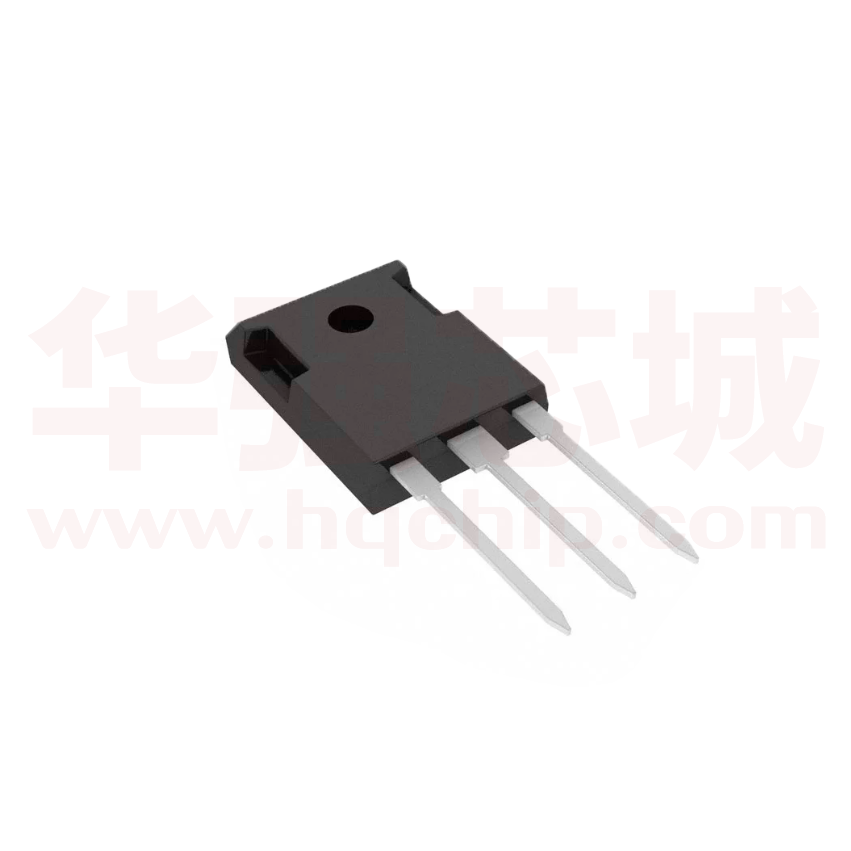

    肖特基二极管 Dual,Com,Cath VR=60V IF=30A IR=240μA CJ=1090pF TO247AD
M6060P-E3/45GI 数据手册
M6035P, M6045P, M6060P www.vishay.com Vishay General Semiconductor Dual Common Cathode Schottky Rectifier FEATURES • Power pack • Guardring for overvoltage protection • Low power losses, high efficiency • Low forward voltage drop 3 • High forward surge capability 2 • High frequency operation 1 TO-247AD (TO-3P) PIN 1 PIN 2 PIN 3 CASE • Solder dip 275 °C max.10 s, per JESD 22-B106 • Material categorization: for definitions of compliance please see www.vishay.com/doc?99912 TYPICAL APPLICATIONS For use in low voltage, high frequency rectifier of switching mode power supplies, freewheeling diodes, DC/DC converters, or polarity protection application. PRIMARY CHARACTERISTICS IF(AV) 2 x 30 A VRRM 35 V, 45 V, 60 V MECHANICAL DATA IFSM 350 A Case: TO-247AD (TO-3P) VF at IF = 30 A 0.50 V, 0.56 V TJ max. 150 °C Package TO-247AD Diode variations Common cathode Molding compound meets UL 94 V-0 flammability rating Base P/N-E3 - RoHS-compliant, commercial grade Terminals: Matte tin plated leads, solderable J-STD-002 and JESD 22-B102 E3 suffix meets JESD 201 class 1A whisker test per Polarity: As marked Mounting Torque: 10 in-lbs maximum MAXIMUM RATINGS (TA = 25 °C unless otherwise noted) PARAMETER Maximum repetitive peak reverse voltage Maximum average forward rectified current at (fig.1) total device per diode SYMBOL M6035P M6045P M6060P UNIT VRRM 35 45 60 V IF(AV) 60 30 A Peak forward surge current 8.3 ms single half sine-wave superimposed on rated load per diode IFSM 350 A Peak repetitive reverse current at tp = 2 μs, 1 kHz per diode IRRM 2.0 A dV/dt 10 000 V/μs TJ, TSTG -65 to +150 °C Voltage rate of change (rated VR) Operating junction and storage temperature range Revision: 17-Aug-15 Document Number: 88980 1 For technical questions within your region: DiodesAmericas@vishay.com, DiodesAsia@vishay.com, DiodesEurope@vishay.com THIS DOCUMENT IS SUBJECT TO CHANGE WITHOUT NOTICE. THE PRODUCTS DESCRIBED HEREIN AND THIS DOCUMENT ARE SUBJECT TO SPECIFIC DISCLAIMERS, SET FORTH AT www.vishay.com/doc?91000 M6035P, M6045P, M6060P www.vishay.com Vishay General Semiconductor ELECTRICAL CHARACTERISTICS (TA = 25 °C unless otherwise noted) PARAMETER SYMBOL TEST CONDITIONS M6035P M6045P TYP. MAX. IF = 10 A VF (1) - 0.43 - 0.52 - IF = 30 A 0.54 0.60 0.59 0.64 IF = 10 A 0.31 - 0.33 - 0.42 - 0.47 - 0.50 0.55 0.56 0.60 TJ = 25 °C TJ = 125 °C IF = 30 A IR (2) Typical junction capacitance CJ - 0.42 IF = 20 A Reverse current per diode UNIT MAX. 0.49 IF = 20 A Instantaneous forward voltage per diode M6060P TYP. VR V TJ = 25 °C 135 600 240 600 μA TJ = 125 °C 110 160 140 160 mA 1150 - 1090 - pF 4.0 V, 1 MHz Notes (1) Pulse test: 300 μs pulse width, 1 % duty cycle (2) Pulse test: Pulse width  40 ms THERMAL CHARACTERISTICS (TA = 25 °C unless otherwise noted) PARAMETER SYMBOL Typical thermal resistance per diode M6035P M6045P RJC M6060P UNIT 2.0 °C/W ORDERING INFORMATION (Example) PREFERRED P/N UNIT WEIGHT (g) PREFERRED PACKAGE CODE BASE QUANTITY DELIVERY MODE M6045P-E3/45 6.14 45 30/tube Tube M6060P-E3/45 6.14 45 30/tube Tube RATINGS AND CHARACTERISTICS CURVES (TA = 25 °C unless otherwise noted) 70 16 M6035P & M6045P D = 0.8 14 60 Average Power Loss (W) Average Forward Current (A) Resistive or Inductive Load 50 40 30 20 10 T 4 0 75 100 125 150 175 D = 0.1 6 0 50 D = 1.0 D = 0.2 8 2 25 D = 0.3 12 10 0 D = 0.5 D = tp/T 0 5 10 15 20 25 tp 30 35 Case Temperature (°C) Average Forward Current (A) Fig. 1 - Forward Current Derating Curve Fig. 2 - Forward Power Loss Characteristics Per Diode Revision: 17-Aug-15 Document Number: 88980 2 For technical questions within your region: DiodesAmericas@vishay.com, DiodesAsia@vishay.com, DiodesEurope@vishay.com THIS DOCUMENT IS SUBJECT TO CHANGE WITHOUT NOTICE. THE PRODUCTS DESCRIBED HEREIN AND THIS DOCUMENT ARE SUBJECT TO SPECIFIC DISCLAIMERS, SET FORTH AT www.vishay.com/doc?91000 M6035P, M6045P, M6060P www.vishay.com Vishay General Semiconductor 100 16 M6060P Average Power Loss (W) 14 Instantaneous Forward Current (A) D = 0.8 D = 0.5 D = 0.3 12 D = 1.0 10 D = 0.2 8 D = 0.1 6 T 4 2 D = tp/T tp TJ = 125 °C 10 1 TJ = 25 °C M6060P 0.1 0 0 5 10 15 20 25 30 0 35 0.1 0.2 0.3 0.4 0.5 0.6 0.7 0.8 Average Forward Current (A) Instantaneous Forward Voltage (V) Fig. 3 - Forward Power Loss Characteristics Per Diode Fig. 6 - Typical Instantaneous Forward Characteristics Per Diode 400 1000 TJ = TJ Max. 8.3 ms Single Half Sine-Wave Instantaneous Reverse Current (mA) Peak Forward Surge Current (A) TJ = 150 °C 300 200 TJ = 150 °C 100 TJ = 125 °C 10 M6035P, M6045P 1 0.1 TJ = 25 °C 0.01 100 1 10 100 10 20 30 40 50 60 70 80 90 100 Number of Cycles at 60 Hz Percent of Rated Peak Reverse Voltage (%) Fig. 4 - Maximum Non-Repetitive Peak Forward Surge Current Per Diode Fig. 7 - Typical Reverse Characteristics Per Diode 1000 Instantaneous Reverse Current (mA) Instantaneous Forward Current (A) 100 TJ = 150 °C TJ = 125 °C 10 TJ = 25 °C 1 M6035P, M6045P TJ = 150 °C 100 TJ = 125 °C 10 M6060P 1 0.1 TJ = 25 °C 0.01 0.1 0 0.1 0.2 0.3 0.4 0.5 0.6 0.7 0.8 10 20 30 40 50 60 70 80 90 100 Instantaneous Forward Voltage (V) Percent of Rated Peak Reverse Voltage (%) Fig. 5 - Typical Instantaneous Forward Characteristics Per Diode Fig. 8 - Typical Reverse Characteristics Per Diode Revision: 17-Aug-15 Document Number: 88980 3 For technical questions within your region: DiodesAmericas@vishay.com, DiodesAsia@vishay.com, DiodesEurope@vishay.com THIS DOCUMENT IS SUBJECT TO CHANGE WITHOUT NOTICE. THE PRODUCTS DESCRIBED HEREIN AND THIS DOCUMENT ARE SUBJECT TO SPECIFIC DISCLAIMERS, SET FORTH AT www.vishay.com/doc?91000 M6035P, M6045P, M6060P www.vishay.com Vishay General Semiconductor 10 TJ = 25 °C f = 1.0 MHz Vsig = 50 mVp-p Transient Thermal Impedance (°C/W) Junction Capacitance (pF) 10 000 1000 M6035P, M6045P M6060P 100 0.1 1 10 Junction to Case 1 M6035P, M6045P, M6060P 0.1 0.01 100 0.1 1 10 100 Reverse Voltage (V) t - Pulse Duration (s) Fig. 9 - Typical Junction Capacitance Per Diode Fig. 10 - Typical Transient Thermal Impedance Per Diode PACKAGE OUTLINE DIMENSIONS in inches (millimeters) TO-247AD (TO-3P) 0.645 (16.4) 0.625 (15.9) 0.245 (6.2) 0.225 (5.7) 0.323 (8.2) 0.313 (7.9) 0.203 (5.16) 0.193 (4.90) 30° 0.078 (1.98) REF. 10 0.170 (4.3) 0.840 (21.3) 0.142 (3.6) 0.138 (3.5) 0.820 (20.8) 1 2 10° TYP. Both Sides 3 1° REF. Both Sides 0.086 (2.18) 0.076 (1.93) 0.127 (3.22) 0.160 (4.1) 0.140 (3.5) 0.117 (2.97) 0.118 (3.0) 0.108 (2.7) 0.795 (20.2) 0.775 (19.6) 0.048 (1.22) 0.044 (1.12) 0.225 (5.7) 0.205 (5.2) 0.030 (0.76) 0.020 (0.51) PIN 1 PIN 2 PIN 3 CASE Revision: 17-Aug-15 Document Number: 88980 4 For technical questions within your region: DiodesAmericas@vishay.com, DiodesAsia@vishay.com, DiodesEurope@vishay.com THIS DOCUMENT IS SUBJECT TO CHANGE WITHOUT NOTICE. THE PRODUCTS DESCRIBED HEREIN AND THIS DOCUMENT ARE SUBJECT TO SPECIFIC DISCLAIMERS, SET FORTH AT www.vishay.com/doc?91000 Legal Disclaimer Notice www.vishay.com Vishay Disclaimer  ALL PRODUCT, PRODUCT SPECIFICATIONS AND DATA ARE SUBJECT TO CHANGE WITHOUT NOTICE TO IMPROVE RELIABILITY, FUNCTION OR DESIGN OR OTHERWISE. Vishay Intertechnology, Inc., its affiliates, agents, and employees, and all persons acting on its or their behalf (collectively, “Vishay”), disclaim any and all liability for any errors, inaccuracies or incompleteness contained in any datasheet or in any other disclosure relating to any product. Vishay makes no warranty, representation or guarantee regarding the suitability of the products for any particular purpose or the continuing production of any product. To the maximum extent permitted by applicable law, Vishay disclaims (i) any and all liability arising out of the application or use of any product, (ii) any and all liability, including without limitation special, consequential or incidental damages, and (iii) any and all implied warranties, including warranties of fitness for particular purpose, non-infringement and merchantability. Statements regarding the suitability of products for certain types of applications are based on Vishay’s knowledge of typical requirements that are often placed on Vishay products in generic applications. Such statements are not binding statements about the suitability of products for a particular application. It is the customer’s responsibility to validate that a particular product with the properties described in the product specification is suitable for use in a particular application. Parameters provided in datasheets and / or specifications may vary in different applications and performance may vary over time. All operating parameters, including typical parameters, must be validated for each customer application by the customer’s technical experts. Product specifications do not expand or otherwise modify Vishay’s terms and conditions of purchase, including but not limited to the warranty expressed therein. Except as expressly indicated in writing, Vishay products are not designed for use in medical, life-saving, or life-sustaining applications or for any other application in which the failure of the Vishay product could result in personal injury or death. Customers using or selling Vishay products not expressly indicated for use in such applications do so at their own risk. Please contact authorized Vishay personnel to obtain written terms and conditions regarding products designed for such applications. No license, express or implied, by estoppel or otherwise, to any intellectual property rights is granted by this document or by any conduct of Vishay. Product names and markings noted herein may be trademarks of their respective owners. © 2017 VISHAY INTERTECHNOLOGY, INC. ALL RIGHTS RESERVED Revision: 08-Feb-17 1 Document Number: 91000
