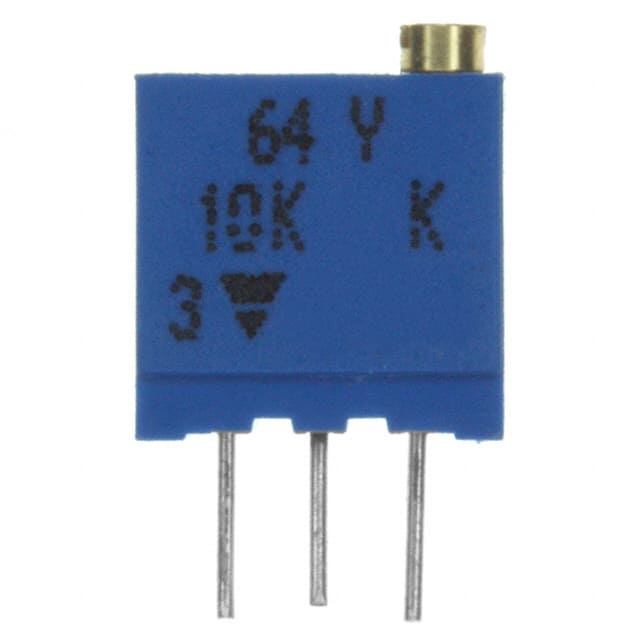

M64Y103KB40
M64Y103KB40
    TFUNK(威世)
    插件,9.7x5mm
    可调电阻/电位器 10KΩ ±10% 500mW 插件 ±100ppm/℃
M64Y103KB40 数据手册
64 www.vishay.com Vishay Spectrol 3/8" Square (10 mm) Multi-Turn Cermet Trimmer FEATURES • Industrial grade • 0.5 W at 70 °C • Tests according to CECC 41000 or IEC 60393-1 • Contact resistance variation < 2 % • Material categorization: for definitions of compliance please see www.vishay.com/doc?99912 DESIGN SUPPORT TOOLS click logo to get started Models Available The Model 64 is a small size trimmer - 3/8" x 3/8" x 3/16" - answering PC board mounting requirements. Five versions are available which differ by the position of the control screw in relation to the PC board plane and by the spacing of the terminals. Excellent operational stability is provided by the use of a cermet element. DIMENSIONS in millimeters (± 0.5 mm) 9.8 max. 5 ± 1 64X a b c 2.54 2.54 Terminal Spacing on a 2.54 PCB 5 max. 2.3 ± 0.2 (1) 9.7 max. Ø 0.5 a b c 1.3 0.5 Ø 2.2 Slot 0.6 x 0.6 1.2 ± 0.2 7.9 ± 0.2 64Z 9.8 max. 5 ± 1 0.6 ± 0.2 (1) 5 max. a b c 2.54 2.54 (1) 2.54 (1) a b c 9.7 max. Ø 0.5 1.3 0.5 Ø 2.2 1.2 ± 0.2 Slot 0.6 x 0.6 7.9 ± 0.2 64W 1.3 2.3 ± 0.2 (1) 1.2 ± 0.1 9.8 max. 5 ± 1 1.6 ± 0.1 Ø 2.2 a b c 2.54 (1) 2.54 (1) a b c 9.7 max. Ø 0.5 Slot 0.6 x 0.6 0.5 64Y 0.6 ± 0.2 (1) 1.3 5 max. 1.2 ± 0.1 9.8 max. 5 ± 1 2.54 Ø 2.2 2.54 (1) 2.54 (1) a b c Slot 0.6 x 0.6 1.6 ± 0.1 Ø 0.5 5 max. 0.5 64P 4.8 ± 0.2 a b c 9.7 max. 5.2 max. (1) 5±1 2.54 (1) Slot 0.6 x 0.6 c b a 9.7 max. 2.54 2.54 (1) Ø 0.5 (1) Ø 2.2 c b a Base level 0.5 1.3 9.7 max. 1.3 ± 0.1 1.2 ± 0.1 Note Revision: 26-Jan-18 Document Number: 57028 1 For technical questions, contact: sferpottrimmers@vishay.com THIS DOCUMENT IS SUBJECT TO CHANGE WITHOUT NOTICE. THE PRODUCTS DESCRIBED HEREIN AND THIS DOCUMENT ARE SUBJECT TO SPECIFIC DISCLAIMERS, SET FORTH AT www.vishay.com/doc?91000 64 www.vishay.com (1) Vishay Spectrol To be measured at base level ELECTRICAL SPECIFICATIONS Resistive element Cermet Electrical travel 21 turns ± 2 10  to 2.2 M Resistance range Standard series E3 Tolerance 1 - 2 - 2.5 - 5 Standard 10 % On request 5% linear 0.5 W at +70 °C Power rating POWER IN W 0.5 0 0 25 50 70 125 100 155 AMBIENT TEMPERATURE IN °C c a Circuit diagram (3) (1) cw b (2) Temperature coefficient Limiting element voltage (linear law) Contact resistance variation End resistance (typical) See Standard Resistance Element table 250 V 2 % Rn or 2  1 Dielectric strength (RMS) 1000 V Insulation resistance (500 VDC) 106 M MECHANICAL SPECIFICATIONS Mechanical travel Operating torque (max. Ncm) End stop torque Net weight Wiper (actual travel) Terminals 23 turns ± 5 1.5 Clutch action Approx. 0.82 g Positioned at approx. 50 % Pure Sn (code e3) ENVIRONMENTAL SPECIFICATIONS Temperature range Climatic category Sealing Revision: 26-Jan-18 -55 °C to +125 °C 55/125/56 Fully sealed - IP67 Document Number: 57028 2 For technical questions, contact: sferpottrimmers@vishay.com THIS DOCUMENT IS SUBJECT TO CHANGE WITHOUT NOTICE. THE PRODUCTS DESCRIBED HEREIN AND THIS DOCUMENT ARE SUBJECT TO SPECIFIC DISCLAIMERS, SET FORTH AT www.vishay.com/doc?91000 64 www.vishay.com Vishay Spectrol STANDARD RESISTANCE ELEMENT DATA STANDARD RESISTANCE VALUES LINEAR LAW MAX. POWER AT 70 °C MAX. WORKING VOLTAGE MAX. CURRENT THROUGH WIPER TYPICAL TCR -55 °C +125 °C  W V mA ppm/°C 10 20 50 100 200 250 500 1K 2K 2.5K 5K 10K 20K 25K 50K 100K 200K 250K 500K 1M 2M 0.5 0.5 0.5 0.5 0.5 0.5 0.5 0.5 0.5 0.5 0.5 0.5 0.5 0.5 0.5 0.5 0.31 0.25 0.125 0.063 0.031 2.2 3.2 5 7.1 10 11.2 15.8 22.4 31.6 35.4 50 70.7 100 112 158 224 250 250 250 250 250 224 158 100 71 50 45 32 22 16 14 10 7.1 5 4.5 3.2 2.2 1.3 1 0.5 0.25 0.13 ± 100 PERFORMANCES TESTS Load life Climatic sequence Long term damp heat Rapid temperature change Shock Vibration Rotational life TYPICAL VALUES AND DRIFTS CONDITIONS RT/RT (%) R1-2/R1-2 (%) 1000 h at rated power 90'/30' - ambient temp. 70 °C ±1% Contact res. variation: < 1 % Rn ±2% Phase A dry heat 125 °C - 30 % Pr Phase B damp heat Phase C cold -55 °C Phase D damp heat 5 cycles ± 0.5 % ±1% 56 days 40 °C, 93 % RH ± 0.5 % Dielectric strength: 1000 VRMS Insulation resistance: > 104 M ±1% 5 cycles -55 °C to +125 °C ± 0.5 % V1-2/V1-3  ± 1 % 50 g at 11 ms 3 successive shocks in 3 directions ± 0.1 % ± 0.2 % 10 Hz to 55 Hz 0.75 mm or 10 g during 6 h ± 0.1 % V1-2/V1-3  ± 0.2 % 200 cycles ±4% Contact res. variation: < 1 % Rn - Note • Nothing stated herein shall be construed as a guarantee of quality or durability MARKING • • • • • • • Vishay trademark Model Style Ohmic value (in , k, M) Tolerance (in %) Manufacturing date Marking of terminal 3 Revision: 26-Jan-18 Document Number: 57028 3 For technical questions, contact: sferpottrimmers@vishay.com THIS DOCUMENT IS SUBJECT TO CHANGE WITHOUT NOTICE. THE PRODUCTS DESCRIBED HEREIN AND THIS DOCUMENT ARE SUBJECT TO SPECIFIC DISCLAIMERS, SET FORTH AT www.vishay.com/doc?91000 64 www.vishay.com Vishay Spectrol PACKAGING • In box of 200 pieces code B40 (BO200) On request: • In box of 100 pieces code B30 (BO100) • In tube of 50 pieces code T20 (TU50) ORDERING INFORMATION (part number) M 6 4 P 2 2 4 K B 4 0 Model STYLE OHMIC VALUE TOLERANCE PACKAGING M64 P W X Y Z From 10  to 2.2 M 224 = 220 k K = 10 % On request J=5% B40 = box 200 pieces On request: B30 = box 100 pieces T20 = tube 50 pieces SPECIAL NUMBER (If applicable) Given by Vishay for custom design DESCRIPTION (for information only) 64 P 220K 10 % MODEL STYLE VALUE TOLERANCE SPECIAL BO200 e3 PACKAGING LEAD FINISH RELATED DOCUMENTS APPLICATION NOTES Potentiometers and Trimmers www.vishay.com/doc?51001 Guidelines for Vishay Sfernice Resistive and Inductive Components www.vishay.com/doc?52029 Revision: 26-Jan-18 Document Number: 57028 4 For technical questions, contact: sferpottrimmers@vishay.com THIS DOCUMENT IS SUBJECT TO CHANGE WITHOUT NOTICE. THE PRODUCTS DESCRIBED HEREIN AND THIS DOCUMENT ARE SUBJECT TO SPECIFIC DISCLAIMERS, SET FORTH AT www.vishay.com/doc?91000 Legal Disclaimer Notice www.vishay.com Vishay Disclaimer ALL PRODUCT, PRODUCT SPECIFICATIONS AND DATA ARE SUBJECT TO CHANGE WITHOUT NOTICE TO IMPROVE RELIABILITY, FUNCTION OR DESIGN OR OTHERWISE. Vishay Intertechnology, Inc., its affiliates, agents, and employees, and all persons acting on its or their behalf (collectively, “Vishay”), disclaim any and all liability for any errors, inaccuracies or incompleteness contained in any datasheet or in any other disclosure relating to any product. Vishay makes no warranty, representation or guarantee regarding the suitability of the products for any particular purpose or the continuing production of any product. To the maximum extent permitted by applicable law, Vishay disclaims (i) any and all liability arising out of the application or use of any product, (ii) any and all liability, including without limitation special, consequential or incidental damages, and (iii) any and all implied warranties, including warranties of fitness for particular purpose, non-infringement and merchantability. Statements regarding the suitability of products for certain types of applications are based on Vishay's knowledge of typical requirements that are often placed on Vishay products in generic applications. Such statements are not binding statements about the suitability of products for a particular application. It is the customer's responsibility to validate that a particular product with the properties described in the product specification is suitable for use in a particular application. Parameters provided in datasheets and / or specifications may vary in different applications and performance may vary over time. All operating parameters, including typical parameters, must be validated for each customer application by the customer's technical experts. Product specifications do not expand or otherwise modify Vishay's terms and conditions of purchase, including but not limited to the warranty expressed therein. Hyperlinks included in this datasheet may direct users to third-party websites. These links are provided as a convenience and for informational purposes only. Inclusion of these hyperlinks does not constitute an endorsement or an approval by Vishay of any of the products, services or opinions of the corporation, organization or individual associated with the third-party website. Vishay disclaims any and all liability and bears no responsibility for the accuracy, legality or content of the third-party website or for that of subsequent links. Except as expressly indicated in writing, Vishay products are not designed for use in medical, life-saving, or life-sustaining applications or for any other application in which the failure of the Vishay product could result in personal injury or death. Customers using or selling Vishay products not expressly indicated for use in such applications do so at their own risk. Please contact authorized Vishay personnel to obtain written terms and conditions regarding products designed for such applications. No license, express or implied, by estoppel or otherwise, to any intellectual property rights is granted by this document or by any conduct of Vishay. Product names and markings noted herein may be trademarks of their respective owners. © 2022 VISHAY INTERTECHNOLOGY, INC. ALL RIGHTS RESERVED Revision: 01-Jan-2022 1 Document Number: 91000
