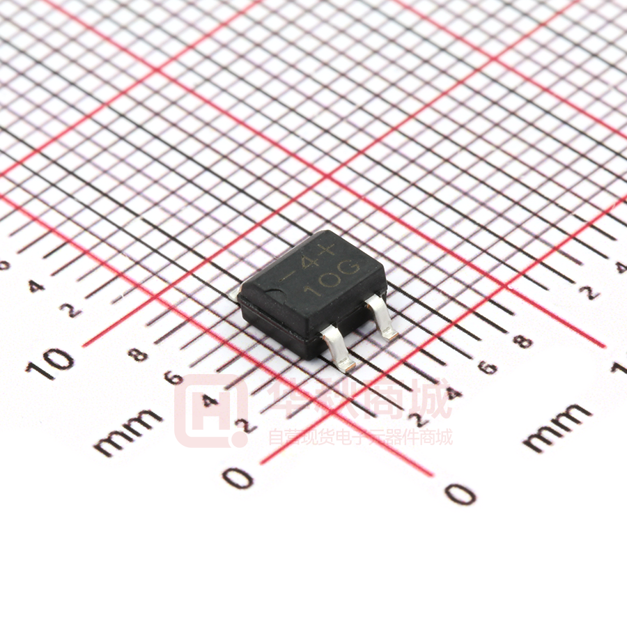

    小型玻璃钝化快速恢复表面贴装桥式整流器 Vr=400V Ir=5μA VF=1V MBS
MB4S-E3/80 数据手册
MB2S, MB4S, MB6S www.vishay.com Vishay General Semiconductor Miniature Glass Passivated Fast Recovery Surface-Mount Bridge Rectifier FEATURES • UL recognition, file number E54214 ~ • Saves space on printed circuit boards ~ • Ideal for automated placement • High surge current capability • Meets MSL level 1, per J-STD-020, LF maximum peak of 260 °C • Material categorization: for definitions of compliance please see www.vishay.com/doc?99912 ~ TYPICAL APPLICATIONS General purpose use in AC/DC bridge full wave rectification for power supply, lighting ballaster, battery charger, home appliances, office equipment, and telecommunication applications. ~ MBS (TO-269AA) LINKS TO ADDITIONAL RESOURCES MECHANICAL DATA 3D 3D Case: MBS (TO-269AA) 3D Models Molding compound meets UL 94 V-0 flammability rating Base P/N-E3 - RoHS-compliant, commercial grade Terminals: matte tin plated leads, solderable J-STD-002 and JESD22-B102 E3 suffix meets JESD 201 class 1A whisker test PRIMARY CHARACTERISTICS IF(AV) 0.5 A VRRM 200 V, 400 V, 600 V IFSM 35 A IR 5 μA VF at IF = 0.4 A 1.0 V TJ max. 150 °C Package MBS (TO-269AA) Circuit configuration Quad per Polarity: as marked on body   MAXIMUM RATINGS (TA = 25 °C unless otherwise noted) PARAMETER SYMBOL Device marking code MB2S MB4S MB6S 2 4 6 UNIT Maximum repetitive peak reverse voltage VRRM 200 400 600 V Maximum RMS voltage VRMS 140 280 420 V VDC 200 400 600 V Maximum DC blocking voltage Maximum average forward output rectified current (fig. 1) on glass-epoxy PCB (1) on aluminum substrate (2) Peak forward surge current 8.3 ms single half sine-wave superimposed on rated load Rating for fusing (t < 8.3 ms) Operating junction and storage temperature range IF(AV) 0.5 A 0.8 IFSM 35 A I2t 5.0 A2s TJ, TSTG -55 to +150 °C Notes (1) On glass epoxy PCB mounted on 0.05" x 0.05" (1.3 mm x 1.3 mm) pads (2) On aluminum substrate PCB with an area of 0.8" x 0.8" (20 mm x 20 mm) mounted on 0.05" x 0.05" (1.3 mm x 1.3 mm) solder pad Revision: 04-Aug-2020 Document Number: 88661 1 For technical questions within your region: DiodesAmericas@vishay.com, DiodesAsia@vishay.com, DiodesEurope@vishay.com THIS DOCUMENT IS SUBJECT TO CHANGE WITHOUT NOTICE. THE PRODUCTS DESCRIBED HEREIN AND THIS DOCUMENT ARE SUBJECT TO SPECIFIC DISCLAIMERS, SET FORTH AT www.vishay.com/doc?91000 MB2S, MB4S, MB6S www.vishay.com Vishay General Semiconductor ELECTRICAL CHARACTERISTICS (TA = 25 °C unless otherwise noted) PARAMETER TEST CONDITIONS Maximum instantaneous forward voltage per diode IF = 0.4 A Maximum DC reverse current at rated DC blocking voltage per diode TA = 125 °C Typical junction capacitance per diode 4.0 V, 1 MHz SYMBOL MB2S VF TA = 25 °C MB4S MB6S UNIT 1.0 V 5.0 IR μA 100 CJ 13 pF THERMAL CHARACTERISTICS (TA = 25 °C unless otherwise noted) PARAMETER SYMBOL Typical thermal resistance MB2S MB4S RJA (1) 85 RJA (2) 70 RJL (1) 20 MB6S UNIT °C/W Notes (1) On glass epoxy PCB mounted on 0.05" x 0.05" (1.3 mm x 1.3 mm) pads (2) On aluminum substrate PCB with an area of 0.8" x 0.8" (20 mm x 20 mm) mounted on 0.05" x 0.05" (1.3 mm x 1.3 mm) solder pad ORDERING INFORMATION (Example) PREFERRED P/N UNIT WEIGHT (g) PREFERRED PACKAGE CODE BASE QUANTITY MB2S-E3/45 0.22 45 100 DELIVERY MODE Tube MB2S-E3/80 0.22 80 3000 13" diameter paper tape and reel Revision: 04-Aug-2020 Document Number: 88661 2 For technical questions within your region: DiodesAmericas@vishay.com, DiodesAsia@vishay.com, DiodesEurope@vishay.com THIS DOCUMENT IS SUBJECT TO CHANGE WITHOUT NOTICE. THE PRODUCTS DESCRIBED HEREIN AND THIS DOCUMENT ARE SUBJECT TO SPECIFIC DISCLAIMERS, SET FORTH AT www.vishay.com/doc?91000 MB2S, MB4S, MB6S www.vishay.com Vishay General Semiconductor RATINGS AND CHARACTERISTICS CURVES (TA = 25 °C unless otherwise noted) 100 Aluminum Substrate Instantaneous Reverse Leakage Current (µA) Average Forward Rectified Current (A) 0.8 0.7 0.6 0.5 Glass Epoxy PCB 0.4 0.3 0.2 Resistive or Inductive Load 0.1 1 0.1 TJ = 25 °C 0.01 0 0 20 40 60 80 100 120 140 160 0 20 40 80 60 100 Ambient Temperature (°C) Percent of Rated Peak Reverse Voltage (%) Fig. 1 - Derating Curve for Output Rectified Current Fig. 4 - Typical Reverse Leakage Characteristics Per Diode 35 30 TA = 40 °C Single Half Sine-Wave 30 Junction Capacitance (pF) Peak Forward Surge Current (A) TJ = 125 °C 10 25 20 f = 50 Hz f = 60 Hz 15 10 5 TJ = 25 °C f = 1.0 MHz Vsig = 50 mVp-p 25 20 15 10 5 1.0 Cycle 0 0 1 10 100 0.1 1 10 100 1000 Number of Cycles Reverse Voltage (V) Fig. 2 - Maximum Non-Repetitive Peak Forward Surge Current Per Diode Fig. 5 - Typical Junction Capacitance Per Diode Instantaneous Forward Current (A) 10 TJ = 150 °C TJ = 25 °C 1 0.1 Pulse Width = 300 µs 1 % Duty Cycle 0.01 0.3 0.5 0.7 0.9 1.1 1.3 1.5 Instantaneous Forward Voltage (V) Fig. 3 - Typical Forward Voltage Characteristics Per Diode Revision: 04-Aug-2020 Document Number: 88661 3 For technical questions within your region: DiodesAmericas@vishay.com, DiodesAsia@vishay.com, DiodesEurope@vishay.com THIS DOCUMENT IS SUBJECT TO CHANGE WITHOUT NOTICE. THE PRODUCTS DESCRIBED HEREIN AND THIS DOCUMENT ARE SUBJECT TO SPECIFIC DISCLAIMERS, SET FORTH AT www.vishay.com/doc?91000 MB2S, MB4S, MB6S www.vishay.com Vishay General Semiconductor PACKAGE OUTLINE DIMENSIONS in inches (millimeters) 0.029 (0.74) 0.017 (0.43) MBS (TO-269AA) Mounting Pad Layout 0.023 MIN. (0.58 MIN.) 0.161 (4.10) 0.144 (3.65) 0.272 (6.90) 0.252 (6.40) 0.272 MAX. (6.91 MAX.) 0.030 MIN. (0.76 MIN.) 0.105 (2.67) 0.095 (2.41) 0.195 (4.95) 0.179 (4.55) 0 to 8° 0.205 (5.21) 0.195 (4.95) 0.049 (1.24) 0.039 (0.99) 0.062 (1.57) 0.058 (1.47) 0.106 (2.70) 0.090 (2.30) 0.114 (2.90) 0.094 (2.40) 0.0075 (0.19) 0.0065 (0.16) 0.038 (0.96) 0.019 (0.48) 0.008 (0.20) 0.004 (0.10) 0.114 (2.90) 0.110 (2.80) 0.058 (1.47) 0.054 (1.37) 0.105 (2.67) 0.095 (2.41) 0.016 (0.41) 0.006 (0.15) 0.018 (0.46) 0.014 (0.36) Revision: 04-Aug-2020 Document Number: 88661 4 For technical questions within your region: DiodesAmericas@vishay.com, DiodesAsia@vishay.com, DiodesEurope@vishay.com THIS DOCUMENT IS SUBJECT TO CHANGE WITHOUT NOTICE. THE PRODUCTS DESCRIBED HEREIN AND THIS DOCUMENT ARE SUBJECT TO SPECIFIC DISCLAIMERS, SET FORTH AT www.vishay.com/doc?91000 Legal Disclaimer Notice www.vishay.com Vishay Disclaimer ALL PRODUCT, PRODUCT SPECIFICATIONS AND DATA ARE SUBJECT TO CHANGE WITHOUT NOTICE TO IMPROVE RELIABILITY, FUNCTION OR DESIGN OR OTHERWISE. Vishay Intertechnology, Inc., its affiliates, agents, and employees, and all persons acting on its or their behalf (collectively, “Vishay”), disclaim any and all liability for any errors, inaccuracies or incompleteness contained in any datasheet or in any other disclosure relating to any product. Vishay makes no warranty, representation or guarantee regarding the suitability of the products for any particular purpose or the continuing production of any product. To the maximum extent permitted by applicable law, Vishay disclaims (i) any and all liability arising out of the application or use of any product, (ii) any and all liability, including without limitation special, consequential or incidental damages, and (iii) any and all implied warranties, including warranties of fitness for particular purpose, non-infringement and merchantability. Statements regarding the suitability of products for certain types of applications are based on Vishay's knowledge of typical requirements that are often placed on Vishay products in generic applications. Such statements are not binding statements about the suitability of products for a particular application. It is the customer's responsibility to validate that a particular product with the properties described in the product specification is suitable for use in a particular application. Parameters provided in datasheets and / or specifications may vary in different applications and performance may vary over time. All operating parameters, including typical parameters, must be validated for each customer application by the customer's technical experts. Product specifications do not expand or otherwise modify Vishay's terms and conditions of purchase, including but not limited to the warranty expressed therein. Hyperlinks included in this datasheet may direct users to third-party websites. These links are provided as a convenience and for informational purposes only. Inclusion of these hyperlinks does not constitute an endorsement or an approval by Vishay of any of the products, services or opinions of the corporation, organization or individual associated with the third-party website. Vishay disclaims any and all liability and bears no responsibility for the accuracy, legality or content of the third-party website or for that of subsequent links. Except as expressly indicated in writing, Vishay products are not designed for use in medical, life-saving, or life-sustaining applications or for any other application in which the failure of the Vishay product could result in personal injury or death. Customers using or selling Vishay products not expressly indicated for use in such applications do so at their own risk. Please contact authorized Vishay personnel to obtain written terms and conditions regarding products designed for such applications. No license, express or implied, by estoppel or otherwise, to any intellectual property rights is granted by this document or by any conduct of Vishay. Product names and markings noted herein may be trademarks of their respective owners. © 2022 VISHAY INTERTECHNOLOGY, INC. ALL RIGHTS RESERVED Revision: 01-Jan-2022 1 Document Number: 91000
