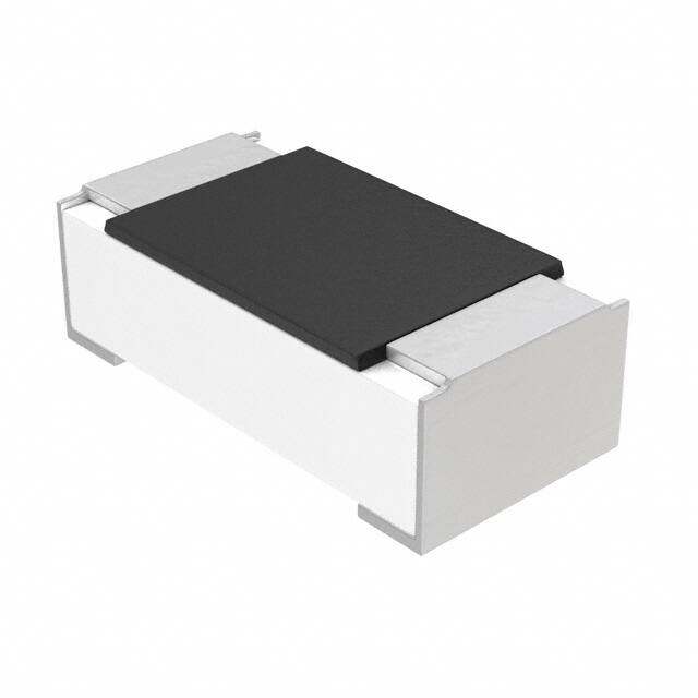

MCS 0402, MCT 0603, MCU 0805, MCA 1206 - Professional www.vishay.com Vishay Beyschlag Professional Thin Film Chip Resistors FEATURES • Approved to EN 140401-801 • Excellent overall stability: class 0.5 • Professional tolerance of resistance: ± 0.5 % and ± 1 % • Rated dissipation P70 up to 0.4 W for size 1206 • Sulfur resistance verified according to ASTM B 809 MCS 0402, MCT 0603, MCU 0805, and MCA 1206 professional thin film flat chip resistors are the perfect choice for most fields of modern professional electronics where reliability and stability are of major concern. Typical applications include telecommunication, medical equipment, high-end computer and audio / video electronics. • Material categorization: for definitions of compliance please see www.vishay.com/doc?99912 APPLICATIONS • Automotive • Telecommunication • Medical equipment • Industrial equipment TECHNICAL SPECIFICATIONS DESCRIPTION MCS 0402 MCT 0603 MCU 0805 MCA 1206 0402 0603 0805 1206 Metric size code RR1005M RR1608M RR2012M RR3216M Resistance range 10  to 4.99 M; 0  1  to 10 M; 0  1  to 10 M; 0  1  to 2 M; 0  Imperial size Resistance tolerance ± 1 %; ± 0.5 % Temperature coefficient ± 50 ppm/K; ± 25 ppm/K Rated dissipation, P70 (1) Operating voltage, Umax. ACRMS/DC 0.100 W 0.125 W 0.200 W 0.400 W 50 V 75 V 150 V 200 V 200 V 300 V Permissible film temperature, F max. (1) 155 °C Operating temperature range -55 °C to 155 °C Permissible voltage against ambient (insulation): 1 min; Uins 75 V Failure rate: FITobserved 100 V  0.1 x 10-9/h Note (1) Please refer to APPLICATION INFORMATION below. APPLICATION INFORMATION When the resistor dissipates power, a temperature rise above the ambient temperature occurs, dependent on the thermal resistance of the assembled resistor together with the printed circuit board. The rated dissipation applies only if the permitted film temperature is not exceeded. These resistors do not feature a limited lifetime when operated within the permissible limits. However, resistance value drift increasing over operating time may result in exceeding a limit acceptable to the specific application, thereby establishing a functional lifetime. Revision: 16-Aug-16 Document Number: 28705 1 For technical questions, contact: thinfilmchip@vishay.com THIS DOCUMENT IS SUBJECT TO CHANGE WITHOUT NOTICE. THE PRODUCTS DESCRIBED HEREIN AND THIS DOCUMENT ARE SUBJECT TO SPECIFIC DISCLAIMERS, SET FORTH AT www.vishay.com/doc?91000 MCS 0402, MCT 0603, MCU 0805, MCA 1206 - Professional www.vishay.com Vishay Beyschlag MAXIMUM RESISTANCE CHANGE AT RATED DISSIPATION OPERATION MODE STANDARD POWER 0.063 W 0.100 W MCS 0402 Rated dissipation, P70 MCT 0603 0.100 W 0.125 W MCU 0805 0.125 W 0.200 W MCA 1206 Operating temperature range 0.250 W 0.400 W -55 °C to 125 °C -55 °C to 155 °C Permissible film temperature, F max. MCS 0402 Max. resistance change at P70 for resistance range, |R/R| after: 125 °C 155 °C 10  to 4.99 M 10  to 4.99 M MCT 0603 1  to 10 M 1  to 10 M MCU 0805 1  to 10 M 1  to 10 M MCA 1206 1  to 2 M 1  to 2 M 1000 h  0.25 %  0.5 % 8000 h  0.5 %  1.0 % 225 000 h  1.5 % - Note • The presented operation modes do not refer to different types of resistors, but actually show examples of different loads, that lead to different film temperatures and different achievable load-life stability (drift) of the resistance value. A suitable low thermal resistance of the circuit board assembly must be safeguarded in order to maintain the film temperature of the resistors within the specified limits. Please consider the application note “Thermal Management in Surface-Mounted Resistor Applications” (www.vishay.com/doc?28844) for information on the general nature of thermal resistance. TEMPERATURE COEFFICIENT AND RESISTANCE RANGE TYPE / SIZE TCR TOLERANCE RESISTANCE ±1% 10  to 4.99 M E24; E96 ± 0.5 % 10  to 221 k E24; E192 ± 25 ppm/K ± 0.5 % 10  to 221 k E24; E192 Jumper, Imax. = 0.63 A  20 m 0 - ±1% 1  to 10 M E24; E96 ± 50 ppm/K MCS 0402 ± 50 ppm/K MCT 0603 ± 0.5 % 10  to 511 k E24; E192 ± 25 ppm/K ± 0.5 % 10  to 511 k E24; E192 Jumper, Imax. = 1 A  20 m 0 - ±1% 1  to 10 M E24; E96 ± 50 ppm/K MCU 0805 ± 0.5 % 10  to 1.5 M E24; E192 ± 25 ppm/K ± 0.5 % 10  to 1.5 M E24; E192 Jumper, Imax. = 1.5 A  20 m 0 - ±1% 1  to 2 M E24; E96 ± 50 ppm/K MCA 1206 E-SERIES ± 0.5 % 10  to 2 M E24; E192 ± 25 ppm/K ± 0.5 % 10  to 2 M E24; E192 Jumper, Imax. = 2 A  20 m 0 - Note • Resistance ranges printed in bold are preferred TCR / tolerance combinations with optimized availability. PACKAGING TYPE / SIZE MCS 0402 MCT 0603 MCU 0805 MCA 1206 Revision: 16-Aug-16 CODE QUANTITY E5 5000 E0 10 000 P5 5000 PW 20 000 PACKAGING STYLE WIDTH PITCH PACKAGING DIMENSIONS 2 mm Ø 180 mm/7" Ø 180 mm/7" Paper tape acc. IEC 60286-3, Type 1a 8 mm Ø 330 mm/13" P5 5000 PW 20 000 4 mm Ø 330 mm/13" Ø 180 mm/7" P5 5000 Ø 180 mm/7" Document Number: 28705 2 For technical questions, contact: thinfilmchip@vishay.com THIS DOCUMENT IS SUBJECT TO CHANGE WITHOUT NOTICE. THE PRODUCTS DESCRIBED HEREIN AND THIS DOCUMENT ARE SUBJECT TO SPECIFIC DISCLAIMERS, SET FORTH AT www.vishay.com/doc?91000 MCS 0402, MCT 0603, MCU 0805, MCA 1206 - Professional www.vishay.com Vishay Beyschlag PART NUMBER AND PRODUCT DESCRIPTION Part Number: MCT06030D4641DPW00 Part Number: MCT06030Z0000ZP500 M C T 0 6 0 3 0 D 4 6 4 1 D P W 0 TYPE / SIZE VERSION TCR RESISTANCE TOLERANCE PACKAGING MCS0402 MCT0603 MCU0805 MCA1206 0 = neutral D = ± 25 ppm/K C = ± 50 ppm/K Z = jumper 3 digit value 1 digit multiplier D = ± 0.5 % F=±1% Z = jumper E5 E0 P5 PW 0 Multiplier 8 = *10-2 9 = *10-1 0 = *100 1 = *101 2 = *102 3 = *103 4 = *104 5 = *105 0000 = jumper Product Description: MCT 0603-25 0.5 % PW 4K64 Product Description: MCT 0603 P5 0R0 MCT 0603 -25 0.5 % PW 4K64 TYPE SIZE TCR TOLERANCE PACKAGING RESISTANCE MCS MCT MCU MCA 0402 0603 0805 1206 ± 25 ppm/K ± 50 ppm/K ± 0.5 % ±1% E5 E0 P5 PW 4K64 = 4.64 k 50R1 = 50.1  0R0 = jumper Note • Products can be ordered using either the PART NUMBER or PRODUCT DESCRIPTION. Revision: 16-Aug-16 Document Number: 28705 3 For technical questions, contact: thinfilmchip@vishay.com THIS DOCUMENT IS SUBJECT TO CHANGE WITHOUT NOTICE. THE PRODUCTS DESCRIBED HEREIN AND THIS DOCUMENT ARE SUBJECT TO SPECIFIC DISCLAIMERS, SET FORTH AT www.vishay.com/doc?91000 MCS 0402, MCT 0603, MCU 0805, MCA 1206 - Professional www.vishay.com DESCRIPTION Production is strictly controlled and follows an extensive set of instructions established for reproducibility. A homogeneous film of metal alloy is deposited on a high grade ceramic substrate (Al2O3) and conditioned to achieve the desired temperature coefficient. Specially designed inner contacts are deposited on both sides. A special laser is used to achieve the target value by smoothly cutting a meander groove in the resistive layer without damaging the ceramics. For the high and low ohmic range, optimized Cermet products provide comparable properties. The resistor elements are covered by a protective coating designed for electrical, mechanical and climatic protection. The terminations receive a final pure tin on nickel plating. The result of the determined production is verified by an extensive testing procedure and optical inspection performed on 100 % of the individual chip resistors. This includes full screening for the elimination of products with potential risk of early field failures (feasible for R  10 ). Only accepted products are laid directly into the paper tape in accordance with IEC 60286-3 Type 1a (1). ASSEMBLY The resistors are suitable for processing on automatic SMD assembly systems. They are suitable for automatic soldering using wave, reflow or vapor phase as shown in IEC 61760-1. The encapsulation is resistant to all cleaning solvents commonly used in the electronics industry, including alcohols, esters and aqueous solutions. The suitability of conformal coatings, potting compounds and their processes, if applied, shall be qualified by appropriate means to ensure the long-term stability of the whole system. The resistors are RoHS-compliant, the pure tin plating provides compatibility with lead (Pb)-free and lead-containing soldering processes. Solderability is specified for 2 years after production or requalification. The permitted storage time is 20 years. The immunity of the plating against tin whisker growth has been proven under extensive testing. MATERIALS Vishay acknowledges the following systems for the regulation of hazardous substances: • IEC 62474, Material Declaration for Products of and for the Electrotechnical Industry, with the list of declarable substances given therein (2) • The Global Automotive Declarable Substance List (GADSL) (3) • The REACH regulation (1907/2006/EC) and the related list of substances with very high concern (SVHC) (4) for its supply chain Vishay Beyschlag The products do not contain any of the banned substances as per IEC 62474, GADSL, or the SVHC list, see www.vishay.com/how/leadfree. Hence the products fully comply with the following directives: • 2000/53/EC End-of-Life Vehicle Directive (ELV) and Annex II (ELV II) • 2011/65/EU Restriction of the Use of Hazardous Substances Directive (RoHS) with amendment 2015/863/EU • 2012/19/EU Waste Electrical and Electronic Equipment Directive (WEEE) Vishay pursues the elimination of conflict minerals from its supply chain, see the Conflict Minerals Policy at www.vishay.com/doc?49037. APPROVALS The resistors are approved within the IECQ-CECC Quality Assessment System for Electronic Components to the detail specification EN 140401-801 which refers to EN 60115-1, EN 60115-8 and the variety of environmental test procedures of the IEC 60068 (1) series. The detail specification refers to the climatic category 55/125/56, which relates to the “standard operation mode” of this datasheet. Conformity is attested by the use of the CECC logo ( the mark of conformity on the package label. ) as Vishay Beyschlag has achieved “Approval of Manufacturer” in accordance with IECQ 03-1. The release certificate for “Technology Approval Schedule” in accordance with CECC 240001 based on IECQ 03-3-1 is granted for the Vishay BEYSCHLAG manufacturing process. RELATED PRODUCTS For more information about products with better TCR and tighter tolerance please refer to the Precision Thin Film Chip Resistors datasheet (www.vishay.com/doc?28700). Resistors are available with established reliability in accordance with EN 140401-801 version E. Please refer to the special datasheet (www.vishay.com/doc?28744) for information on failure rate level, available resistance ranges and order codes. Precision chip resistor arrays may be used in voltage divider applications or precision amplifiers where close matching between multiple resistors is necessary. ACAS 0612 chip arrays are specified by the following datasheets: • Professional type (www.vishay.com/doc?28754) • Precision type (www.vishay.com/doc?28751) Notes (1) The quoted IEC standards are also released as EN standards with the same number and identical contents. (2) The IEC 62474 list of declarable substances is maintained in a dedicated database, which is available at http://std.iec.ch/iec62474. (3) The Global Automotive Declarable Substance List (GADSL) is maintained by the American Chemistry Council and available at www.gadsl.org. (4) The SVHC list is maintained by the European Chemical Agency (ECHA) and available at http://echa.europa.eu/candidate-list-table. Revision: 16-Aug-16 Document Number: 28705 4 For technical questions, contact: thinfilmchip@vishay.com THIS DOCUMENT IS SUBJECT TO CHANGE WITHOUT NOTICE. THE PRODUCTS DESCRIBED HEREIN AND THIS DOCUMENT ARE SUBJECT TO SPECIFIC DISCLAIMERS, SET FORTH AT www.vishay.com/doc?91000 MCS 0402, MCT 0603, MCU 0805, MCA 1206 - Professional www.vishay.com Vishay Beyschlag FUNCTIONAL PERFORMANCE Power Dissipation P 0.3 MCS 0402 MCT 0603 MCU 0805 0.2 MCA 1206 W 0.1 0 -50 0 50 70 100 °C 150 Ambient Temperature ϑamb Derating - Standard Operation Power Dissipation P 0.5 MCS 0402 MCT 0603 0.4 MCU 0805 MCA 1206 0.3 W 0.2 0.1 -50 0 50 70 100 °C 150 Ambient Temperature ϑ amb MCS 0402 ^ Pulse Load Pmax. Derating - Power Operation 100 MCT 0603 MCU 0805 W MCA 1206 10 1 0.1 10 µs 100 µs 1 ms 10 ms 100 ms 1s 10 s Pulse Duration t i Maximum pulse load, single pulse; applicable if P  0 and n  1000 and Û  Ûmax.; for permissible resistance change equivalent to 8000 h operation in standard operation mode Single Pulse Revision: 16-Aug-16 Document Number: 28705 5 For technical questions, contact: thinfilmchip@vishay.com THIS DOCUMENT IS SUBJECT TO CHANGE WITHOUT NOTICE. THE PRODUCTS DESCRIBED HEREIN AND THIS DOCUMENT ARE SUBJECT TO SPECIFIC DISCLAIMERS, SET FORTH AT www.vishay.com/doc?91000 MCS 0402, MCT 0603, MCU 0805, MCA 1206 - Professional Vishay Beyschlag MCS 0402 ^ Continuous Pulse Load Pmax. www.vishay.com 100 MCT 0603 MCU 0805 W MCA 1206 10 1 0.1 10 µs 100 µs 1 ms 10 ms 100 ms 1s 10 s Pulse Duration t i Maximum pulse load, continuous pulses; applicable if P  P (amb) and Û  Ûmax.; for permissible resistance change equivalent to 8000 h operation in standard operation mode Pulse Voltage Ûmax. Continuous Pulse 1 kV 100 V MCS 0402 MCT 0603 MCU 0805 MCA 1206 10 V 10 µs 100 µs 1 ms 10 ms 100 ms 1s 10 s Pulse Duration t i Maximum pulse voltage, single and continuous pulses; applicable if Pˆ  Pˆ max.; for permissible resistance change equivalent to 8000 h operation in standard operation mode Test Voltage Pulse Voltage MCS 0402 10 kV MCT 0603 MCU 0805 MCA 1206 1 kV 100 V 10 V 10 Ω 100 Ω 1 kΩ 10 kΩ 100 kΩ 1 MΩ 10 MΩ Resistance Value R Pulse load rating in accordance with EN 60115-1 clause 4.27; 1.2 µs/50 µs; 5 pulses at 12 s interval; for permissible resistance change ± (0.5 % R + 0.05 ) 1.2/50 Pulse Revision: 16-Aug-16 Document Number: 28705 6 For technical questions, contact: thinfilmchip@vishay.com THIS DOCUMENT IS SUBJECT TO CHANGE WITHOUT NOTICE. THE PRODUCTS DESCRIBED HEREIN AND THIS DOCUMENT ARE SUBJECT TO SPECIFIC DISCLAIMERS, SET FORTH AT www.vishay.com/doc?91000 MCS 0402, MCT 0603, MCU 0805, MCA 1206 - Professional Test Voltage www.vishay.com Vishay Beyschlag MCS 0402 10 kV MCT 0603 MCU 0805 MCA 1206 1 kV 100 V 10 V 10 Ω 100 Ω 1 kΩ 10 kΩ 100 kΩ 1 MΩ 10 MΩ Resistance Value R Pulse load rating in accordance with EN 60115-1 clause 4.27; 10 µs/700 µs; 10 pulses at 1 min intervals; for permissible resistance change ± (0.5 % R + 0.05 ) 10/700 Pulse Current Noise Voltage Ratio 10 µV/V 1 0.1 MCS 0402 MCT 0603 MCU 0805 MCA 1206 0.01 100 Ω 1 kΩ 10 kΩ 100 kΩ 1 MΩ Resistance Value R In accordance with IEC 60195 |Z |/R Current Noise Voltage Ratio 2.0 1.5 1.0 MCT 0603 MCU 0805 0.5 0.1 0.3 1 3 10 GHz 20 Frequency f Relative impedance for 49.9  chip resistor RF-Behavior Revision: 16-Aug-16 Document Number: 28705 7 For technical questions, contact: thinfilmchip@vishay.com THIS DOCUMENT IS SUBJECT TO CHANGE WITHOUT NOTICE. THE PRODUCTS DESCRIBED HEREIN AND THIS DOCUMENT ARE SUBJECT TO SPECIFIC DISCLAIMERS, SET FORTH AT www.vishay.com/doc?91000 MCS 0402, MCT 0603, MCU 0805, MCA 1206 - Professional www.vishay.com Vishay Beyschlag TESTS AND REQUIREMENTS All tests are carried out in accordance with the following specifications: EN 60115-1, generic specification EN 60115-8 (successor of EN 140400), sectional specification EN 140401-801, detail specification The testing also covers most of the requirements specified by EIA/ECA-703 and JIS-C-5201-1. The tests are carried out under standard atmospheric conditions in accordance with IEC 60068-1, 4.3, whereupon the following values are applied: IEC 60068-2-xx, test methods The components are approved under the IECQ-CECC quality assessment system for electronic components. The parameters stated in the Test Procedures and Requirements table are based on the required tests and permitted limits of EN 140401-801. The table presents only the most important tests, for the full test schedule refer to the documents listed above. However, some additional tests and a number of improvements against those minimum requirements have been included. Relative humidity: 25 % to 75 % Air pressure: 86 kPa to 106 kPa (860 mbar to 1060 mbar) A climatic category LCT / UCT / 56 is applied, defined by the lower category temperature (LCT), the upper category temperature (UCT), and the duration of exposure in the damp heat, steady state test (56 days). The components are mounted for testing on printed circuit boards in accordance with EN 60115-8, 2.4.2, unless otherwise specified. Temperature: 15 °C to 35 °C TEST PROCEDURES AND REQUIREMENTS EN 60 115-1 CLAUSE IEC 60 068-2 (1) TEST METHOD TEST PROCEDURE REQUIREMENTS PERMISSIBLE CHANGE (R) STABILITY CLASS 0.5 STABILITY CLASS 1 MCS 0402 10  to 33.2 k > 33.2 kto 4.99 M MCT 0603 10  to 100 k 1  to < 10 ; > 100 k to 10 M MCU 0805 10  to 221 k 1  to < 10 ; > 221 k to 10 M MCA 1206 10  to 332 k 1  to < 10 ; > 332 k to 2 M Stability for product types: 4.5 - Resistance - ± 1 % R; ±0.5 % R 4.8 - Temperature coefficient At (20 / -55 / 20) °C and (20 / 125 / 20) °C ± 50 ppm/K; ± 25 ppm/K Endurance at 70 °C: standard operation mode 4.25.1 Endurance at 70 °C: power operation mode 70 °C; 1000 h ± (0.25 % R + 0.05 ) 70 °C; 8000 h ±(0.5 % R + 0.05 ) U = P 70 x R or U = Umax.; whichever is the less severe; 1.5 h on; 0.5 h off; 70 °C; 1000 h ± (0.5 % R + 0.05 ) 70 °C; 8000 h ±(1 % R + 0.05 ) Endurance at upper category temperature 125 °C; 1000 h ±(0.25 % R + 0.05 ) ± (0.5 % R + 0.05 ) - 155 °C; 1000 h ± (0.5 % R + 0.05 ) ±(1 % R + 0.05 ) 78 (Cab) Damp heat, steady state (40 ± 2) °C; 56 days; (93 ± 3) % RH ± (0.5 % R + 0.05 ) ±(1 % R + 0.05 ) 4.25.3 4.24 U = P 70 x R or U = Umax.; whichever is the less severe; 1.5 h on; 0.5 h off; Revision: 16-Aug-16 Document Number: 28705 8 For technical questions, contact: thinfilmchip@vishay.com THIS DOCUMENT IS SUBJECT TO CHANGE WITHOUT NOTICE. THE PRODUCTS DESCRIBED HEREIN AND THIS DOCUMENT ARE SUBJECT TO SPECIFIC DISCLAIMERS, SET FORTH AT www.vishay.com/doc?91000 MCS 0402, MCT 0603, MCU 0805, MCA 1206 - Professional www.vishay.com Vishay Beyschlag TEST PROCEDURES AND REQUIREMENTS EN 60 115-1 CLAUSE IEC 60 068-2 (1) TEST METHOD TEST PROCEDURE REQUIREMENTS PERMISSIBLE CHANGE (R) STABILITY CLASS 0.5 STABILITY CLASS 1 MCS 0402 10  to 33.2 k > 33.2 kto 4.99 M MCT 0603 10  to 100 k 1  to < 10 ; > 100 k to 10 M MCU 0805 10  to 221 k 1  to < 10 ; > 221 k to 10 M MCA 1206 10  to 332 k 1  to < 10 ; > 332 k to 2 M ± (0.5 % R + 0.05 ) ± (1 % R + 0.05 ) ± (0.1 % R + 0.01 ) ± (0.25 % R + 0.05 ) Stability for product types: Climatic sequence: standard operation mode: 4.23 4.23.2 2 (Bb) dry heat 125 °C; 16 h 4.23.3 30 (Db) damp heat, cyclic 55 °C; 24 h; > 90 % RH; 1 cycle 4.23.4 1 (Ab) cold -55 °C; 2 h 4.23.5 13 (M) low air pressure 8.5 kPa; 2 h; (25 ± 10) °C 4.23.6 30 (Db) damp heat, cyclic 55 °C; 24 h; > 90 % RH; 5 cycles 4.23.7 - DC load 1 (Aa) Cold -55 °C; 2 h Rapid change of temperature 30 min at LCT and 30 min at UCT; LCT = -55 °C; UCT = 125 °C; 5 cycles ± (0.1 % R + 0.01 ) no visible damage LCT = -55 °C; UCT = 125 °C; 1000 cycles ± (0.25 % R + 0.05 ) no visible damage - 4.19 14 (Na) 4.13 4.27 4.39 Revision: 16-Aug-16 - - U= P 70 x R Umax.; 1 min. Short time overload: standard operation mode U = 2.5 x P 70 x R or U = 2 x Umax.; whichever is the less severe; 5s ±(0.1 % R + 0.01 ) ±(0.25 % R + 0.05 ) Short time overload: power operation mode U = 2.5 x P 70 x R or U = 2 x Umax.; whichever is the less severe; 5s ±(0.25 % R + 0.05 ) ±(0.5 % R + 0.05 ) Severity no. 4: Single pulse high U = 10 x P 70 x R voltage overload: or U = 2 x Umax.; standard whichever is the less severe; operation mode 10 pulses 10 μs/700 μs ± (0.5 % R + 0.05 ) no visible damage Periodic electric overload: standard operation mode U = 15 x P 70 x R or U = 2 x Umax.; 0.1 s on; 2.5 s off; whichever is the less severe; 1000 cycles ± (0.5 % R + 0.05 ) no visible damage Periodic electric overload: power operation mode U = 15 x P 70 x R or U = 2 x Umax.; 0.1 s on; 2.5 s off; whichever is the less severe; 1000 cycles ± (1 % R + 0.05 ) no visible damage - Document Number: 28705 9 For technical questions, contact: thinfilmchip@vishay.com THIS DOCUMENT IS SUBJECT TO CHANGE WITHOUT NOTICE. THE PRODUCTS DESCRIBED HEREIN AND THIS DOCUMENT ARE SUBJECT TO SPECIFIC DISCLAIMERS, SET FORTH AT www.vishay.com/doc?91000 MCS 0402, MCT 0603, MCU 0805, MCA 1206 - Professional www.vishay.com Vishay Beyschlag TEST PROCEDURES AND REQUIREMENTS EN 60 115-1 CLAUSE IEC 60 068-2 (1) TEST METHOD TEST PROCEDURE REQUIREMENTS PERMISSIBLE CHANGE (R) STABILITY CLASS 0.5 STABILITY CLASS 1 MCS 0402 10  to 33.2 k > 33.2 kto 4.99 M MCT 0603 10  to 100 k 1  to < 10 ; > 100 k to 10 M MCU 0805 10  to 221 k 1  to < 10 ; > 221 k to 10 M MCA 1206 10  to 332 k 1  to < 10 ; > 332 k to 2 M Stability for product types: 4.38 4.22 4.17 - 6 (Fc) 58 (Td) Electro static discharge (human body model) IEC 61340-3-1 (1); 3 pos. + 3 neg. (equivalent to MIL-STD-883, method 3015) MCS 0402: 500 V MCT 0603: 1000 V MCU 0805: 1500 V MCA 1206: 2000 V ±(0.5 % R + 0.05 ) Vibration Endurance by sweeping; 10 Hz to 2000 Hz; no resonance; amplitude 1.5 mm or  200 m/s2; 7.5 h ± (0.1 % R + 0.01 ) no visible damage Solder bath method; SnPb40; non-activated flux; (215 ± 3) °C; (3 ± 0.3) s Good tinning ( 95 % covered); no visible damage Solder bath method; SnAg3Cu0.5 or SnAg3.5; non-activated flux; (235 ± 3) °C; (2 ± 0.2) s Good tinning ( 95 % covered); no visible damage Solderability 4.18 58 (Td) Resistance to soldering heat Solder bath method; (260 ± 5) °C; (10 ± 1) s 4.29 45 (XA) Component solvent resistance Isopropyl alcohol +50 °C; method 2 4.32 21 (Ue3) Shear (adhesion) ±(0.1 % R + 0.01 ) no visible damage ±(0.25 % R + 0.05 ) no visible damage No visible damage MCS 0402 and MCT 0603: 9N No visible damage MCU 0805 and MCA 1206: 45 N 4.33 21 (Ue1) Substrate bending Depth 2 mm, 3 times ±(0.1 % R + 0.01 ) no visible damage, no open circuit in bent position 4.7 - Voltage proof URMS = Uins; (60 ± 5) s No flashover or breakdown 4.35 - Flammability IEC 60695-11-5 (1), needle flame test; 10 s No burning after 30 s Note (1) The quoted IEC standards are also released as EN standards with the same number and identical contents. Revision: 16-Aug-16 Document Number: 28705 10 For technical questions, contact: thinfilmchip@vishay.com THIS DOCUMENT IS SUBJECT TO CHANGE WITHOUT NOTICE. THE PRODUCTS DESCRIBED HEREIN AND THIS DOCUMENT ARE SUBJECT TO SPECIFIC DISCLAIMERS, SET FORTH AT www.vishay.com/doc?91000 MCS 0402, MCT 0603, MCU 0805, MCA 1206 - Professional www.vishay.com Vishay Beyschlag DIMENSIONS Tt W WT H Tb L DIMENSIONS AND MASS H (mm) TYPE / SIZE L (mm) W (mm) WT (mm) Tt (mm) Tb (mm) MASS (mg) MCS 0402 0.32 ± 0.05 1.0 ± 0.05 0.5 ± 0.05 > 75 % of W 0.2 + 0.1 / - 0.15 0.2 ± 0.1 0.6 MCT 0603 0.45 + 0.1 / - 0.05 1.55 ± 0.05 0.85 ± 0.1 > 75 % of W 0.3 + 0.15 / - 0.2 0.3 + 0.15 / - 0.2 1.9 MCU 0805 0.45 + 0.1 / - 0.05 2.0 ± 0.1 1.25 ± 0.15 > 75 % of W 0.4 + 0.1 / - 0.2 0.4 + 0.1 / - 0.2 4.6 MCA 1206 0.55 ± 0.1 3.2 + 0.1 / - 0.2 1.6 ± 0.15 > 75 % of W 0.5 ± 0.25 0.5 ± 0.25 9.2 SOLDER PAD DIMENSIONS X G Y Z RECOMMENDED SOLDER PAD DIMENSIONS WAVE SOLDERING TYPE / SIZE G (mm) Y (mm) X (mm) REFLOW SOLDERING Z (mm) G (mm) Y (mm) X (mm) Z (mm) MCS 0402 - - - - 0.35 0.55 0.55 1.45 MCT 0603 0.55 1.10 1.10 2.75 0.65 0.70 0.95 2.05 MCU 0805 0.80 1.25 1.50 3.30 0.90 0.90 1.40 2.70 MCA 1206 1.40 1.50 1.90 4.40 1.50 1.15 1.75 3.80 Notes • The given solder pad dimensions reflect the considerations for board design and assembly as outlined e.g. in standards IEC 61188-5-x (1), or in publication IPC-7351. (1) The quoted IEC standards are also released as EN standards with the same number and identical contents. Revision: 16-Aug-16 Document Number: 28705 11 For technical questions, contact: thinfilmchip@vishay.com THIS DOCUMENT IS SUBJECT TO CHANGE WITHOUT NOTICE. THE PRODUCTS DESCRIBED HEREIN AND THIS DOCUMENT ARE SUBJECT TO SPECIFIC DISCLAIMERS, SET FORTH AT www.vishay.com/doc?91000 MCS 0402, MCT 0603, MCU 0805, MCA 1206 - Professional www.vishay.com Vishay Beyschlag HISTORICAL 12NC INFORMATION • The resistors had a 12-digit numeric code starting with 2312. Last Digit of 12NC Indicating Resistance Decade RESISTANCE DECADE LAST DIGIT 1  to 9.99  8 10  to 99.9  9 - The first 3 digits indicated the resistance value. 100  to 999  1 - The last digit indicated the resistance decade in accordance with the last digit of 12NC indicating resistance decade table. 1 k to 9.99 k 2 • The subsequent 4 digits indicated the resistor type, specification and packaging; see the 12NC table. • The remaining 4 digits indicated the resistance value: 10 k to 99.9 k 3 100 k to 999 k 4 1 M to 9.99 M 5 10 M to 99.9 M 6 Historical 12NC example The 12NC of a MCT 0603 resistor, value 47 k and TCR 50 with ± 1 % tolerance, supplied in cardboard tape of 5000 units per reel was: 2312 215 14703. HISTORICAL 12NC - Resistor type and packaging 2312... ..... DESCRIPTION CARDBOARD TAPE ON REEL TYPE TOL. P5 (5000 UNITS) E0 (10 000 UNITS) PW (20 000 UNITS) ±1% - 275 1.... - ± 0.5 % - 275 5.... - ± 25 ppm/K ± 0.5 % - 276 5.... - Jumper - - 275 90001 - ±1% 215 1.... - 205 1.. ± 0.5 % 215 5.... - 205 5.... ± 25 ppm/K ± 0.5 % 216 5.... - 206 5.... Jumper - 215 90001 - 205 90001 ± 50 ppm/K ± 0.5 % 255 5.... - 245 5.... ± 25 ppm/K ± 0.5 % 256 5.... - 246 5.... Jumper - 255 90001 - 245 90001 TCR ± 50 ppm/K MCS 0402 ± 50 ppm/K MCT 0603 MCU 0805 Revision: 16-Aug-16 Document Number: 28705 12 For technical questions, contact: thinfilmchip@vishay.com THIS DOCUMENT IS SUBJECT TO CHANGE WITHOUT NOTICE. THE PRODUCTS DESCRIBED HEREIN AND THIS DOCUMENT ARE SUBJECT TO SPECIFIC DISCLAIMERS, SET FORTH AT www.vishay.com/doc?91000 Legal Disclaimer Notice www.vishay.com Vishay Disclaimer ALL PRODUCT, PRODUCT SPECIFICATIONS AND DATA ARE SUBJECT TO CHANGE WITHOUT NOTICE TO IMPROVE RELIABILITY, FUNCTION OR DESIGN OR OTHERWISE. Vishay Intertechnology, Inc., its affiliates, agents, and employees, and all persons acting on its or their behalf (collectively, “Vishay”), disclaim any and all liability for any errors, inaccuracies or incompleteness contained in any datasheet or in any other disclosure relating to any product. Vishay makes no warranty, representation or guarantee regarding the suitability of the products for any particular purpose or the continuing production of any product. To the maximum extent permitted by applicable law, Vishay disclaims (i) any and all liability arising out of the application or use of any product, (ii) any and all liability, including without limitation special, consequential or incidental damages, and (iii) any and all implied warranties, including warranties of fitness for particular purpose, non-infringement and merchantability. Statements regarding the suitability of products for certain types of applications are based on Vishay's knowledge of typical requirements that are often placed on Vishay products in generic applications. Such statements are not binding statements about the suitability of products for a particular application. It is the customer's responsibility to validate that a particular product with the properties described in the product specification is suitable for use in a particular application. Parameters provided in datasheets and / or specifications may vary in different applications and performance may vary over time. All operating parameters, including typical parameters, must be validated for each customer application by the customer's technical experts. Product specifications do not expand or otherwise modify Vishay's terms and conditions of purchase, including but not limited to the warranty expressed therein. Hyperlinks included in this datasheet may direct users to third-party websites. These links are provided as a convenience and for informational purposes only. Inclusion of these hyperlinks does not constitute an endorsement or an approval by Vishay of any of the products, services or opinions of the corporation, organization or individual associated with the third-party website. Vishay disclaims any and all liability and bears no responsibility for the accuracy, legality or content of the third-party website or for that of subsequent links. Except as expressly indicated in writing, Vishay products are not designed for use in medical, life-saving, or life-sustaining applications or for any other application in which the failure of the Vishay product could result in personal injury or death. Customers using or selling Vishay products not expressly indicated for use in such applications do so at their own risk. Please contact authorized Vishay personnel to obtain written terms and conditions regarding products designed for such applications. No license, express or implied, by estoppel or otherwise, to any intellectual property rights is granted by this document or by any conduct of Vishay. Product names and markings noted herein may be trademarks of their respective owners. © 2021 VISHAY INTERTECHNOLOGY, INC. ALL RIGHTS RESERVED Revision: 09-Jul-2021 1 Document Number: 91000

1. 物料型号:包括MCS 0402, MCT 0603, MCU 0805, MCA 1206,这些型号代表不同尺寸的薄膜芯片电阻器。
2. 器件简介:这些电阻器适用于对可靠性和稳定性有高要求的现代专业电子领域,如通信、医疗设备、高端计算机和音视频电子产品。
3. 引脚分配:文档中没有明确提供引脚分配图,但通常这类电阻器是无引脚的表面贴装元件。
4. 参数特性: - 符合EN 140401-801标准。 - 优秀的整体稳定性,等级0.5。 - 专业公差等级:±0.5%和±1%。 - 额定耗散功率P70最高可达0.4W(对于1206尺寸)。 - 根据ASTM B 809验证的抗硫性。 - 材料分类定义请访问www.vishay.com/doc?99912。
5. 功能详解: - 电阻器在功率耗散时,会根据组装电阻器和印刷电路板的热阻产生高于环境温度的温度升高。 - 这些电阻器在允许的范围内操作时没有有限的使用寿命。
6. 应用信息:适用于汽车、通信、医疗设备和工业设备。
7. 封装信息:提供了不同尺寸的电阻器的英制尺寸、公制尺寸代码、电阻范围、公差、温度系数、额定耗散功率、最大工作电压、最大允许膜温度、操作温度范围等详细信息。
8. 技术规格:详细列出了不同型号电阻器的技术参数,包括尺寸、电阻范围、公差、温度系数、额定耗散功率、最大工作电压等。
9. 测试和要求:所有测试均按照EN 60115-1、EN 60115-8、EN 140401-801和IEC 60068-2-xx等规范进行。
10. 材料:Vishay遵守有关有害物质规定的系统,产品不含IEC 62474、GADSL或SVHC列表中的任何禁用物质。
11. 批准:电阻器在IECQ-CECC电子元件质量评估体系内获得批准,符合EN 140401-801详细规范。
12. 相关产品:文档还提到了具有更好TCR和更紧密公差的精密薄膜芯片电阻器,以及用于电压分压器应用或精密放大器的电阻器阵列。
