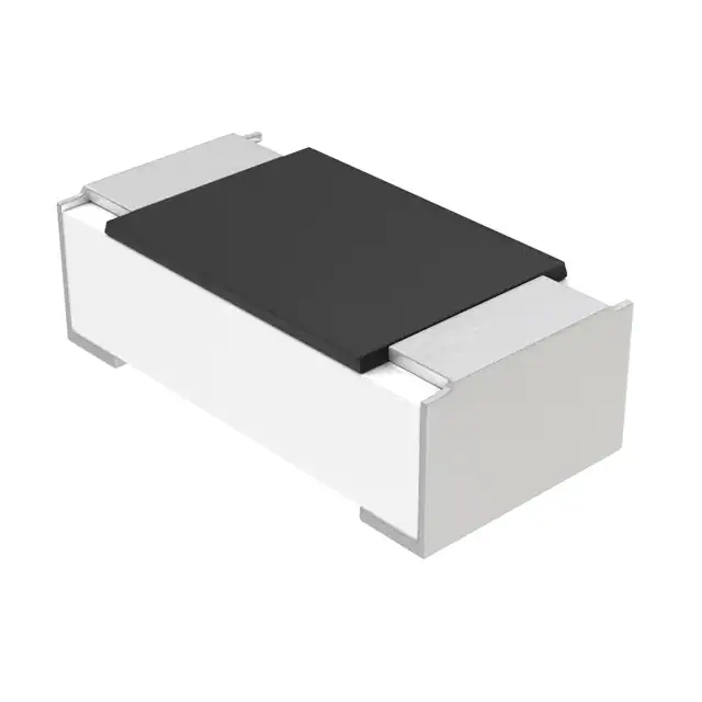

MCS 0402 AT, MCT 0603 AT, MCU 0805 AT, MCA 1206 AT - Precision www.vishay.com Vishay Beyschlag Precision Thin Film Chip Resistors FEATURES • Rated dissipation P70 up to 0.4 W for size 1206 • AEC-Q200 qualified • Approved to EN 140401-801 • Superior temperature cycling robustness • Superior moisture resistivity, |ΔR/R| < 0.5 % (85 °C; 85 % RH; 1000 h) • Advanced sulfur ASTM B 809 Vishay Automotive Grade MC AT precision thin film chip resistors are the perfect choice for most fields of modern precision electronics where reliability and stability is of major concern. Typical applications include automotive, industrial, telecommunication and medical equipment, as well as precision test and measuring equipment. resistance verified according to • Material categorization: for definitions of compliance please see www.vishay.com/doc?99912 APPLICATIONS • Automotive • Industrial equipment • Telecommunication • Medical equipment TECHNICAL SPECIFICATIONS MCS 0402 AT MCT 0603 AT (2) MCU 0805 AT MCA 1206 AT 0402 0603 0805 1206 Metric size code RR1005M RR1608M RR2012M RR3216M Resistance range 47 Ω to 1 MΩ 47 Ω to 2 MΩ 47 Ω to 1 MΩ 47 Ω to 10 MΩ DESCRIPTION Imperial size Resistance tolerance ± 0.1 % ± 25 ppm/K; ± 15 ppm/K; ± 25 ppm/K; ± 15 ppm/K; ± 10 ppm/K ± 10 ppm/K; ± 5 ppm/K Temperature coefficient Rated dissipation P70 (1) Operating voltage, Umax. ACRMS/DC 0.100 W 0.125 W 0.200 W 0.400 W 50 V 75 V 150 V 200 V Permissible film temperature, ϑF max. (1) 155 °C Operating temperature range Internal thermal resistance (1) ± 25 ppm/K; ± 15 ppm/K; ± 10 ppm/K -55 °C to 155 °C 90 K/W 63 K/W 38 K/W 32 K/W 75 V 100 V 200 V 300 V Permissible voltage against ambient (insulation): 1 min; Uins Failure rate: FITobserved ≤ 0.1 x 10-9/h Notes (1) Please refer to APPLICATION INFORMATION, see below (2) AEC-Q200 qualification for TCR ± 5 ppm/K pending, CECC not applicable for TCR ± 5 ppm/K Revision: 29-Mar-2021 Document Number: 28785 1 For technical questions, contact: thinfilmchip@vishay.com THIS DOCUMENT IS SUBJECT TO CHANGE WITHOUT NOTICE. THE PRODUCTS DESCRIBED HEREIN AND THIS DOCUMENT ARE SUBJECT TO SPECIFIC DISCLAIMERS, SET FORTH AT www.vishay.com/doc?91000 MCS 0402 AT, MCT 0603 AT, MCU 0805 AT, MCA 1206 AT - Precision www.vishay.com Vishay Beyschlag APPLICATION INFORMATION When the resistor dissipates power, a temperature rise above the ambient temperature occurs, dependent on the thermal resistance of the assembled resistor together with the printed circuit board. The rated dissipation applies only if the permitted film temperature is not exceeded. Please consider the application note “Thermal Management in Surface-Mounted (www.vishay.com/doc?28844) for information on the general nature of thermal resistance. Resistor Applications” These resistors do not feature a limited lifetime when operated within the permissible limits. However, resistance value drift increasing over operating time may result in exceeding a limit acceptable to the specific application, thereby establishing a functional lifetime. MAXIMUM RESISTANCE CHANGE AT RATED DISSIPATION OPERATION MODE STANDARD Rated dissipation, P70 MCS 0402 AT 0.063 W 0.100 W MCT 0603 AT 0.100 W 0.125 W MCU 0805 AT 0.125 W 0.200 W MCA 1206 AT Operating temperature range 0.250 W 0.400 W -55 °C to 125 °C -55 °C to 155 °C 125 °C 155 °C Permissible film temperature, ϑF max. Max. resistance change at P70 for resistance range, |ΔR/R| after: POWER MCS 0402 AT 47 Ω to 1 MΩ 47 Ω to 1 MΩ MCT 0603 AT 47 Ω to 2 MΩ 47 Ω to 2 MΩ MCU 0805 AT 47 Ω to 1 MΩ 47 Ω to 1 MΩ MCA 1206 AT 47 Ω to 10 MΩ 47 Ω to 10 MΩ 1000 h ≤ 0.1 % ≤ 0.2 % 8000 h ≤ 0.2 % ≤ 0.4 % 225 000 h ≤ 0.6 % - Note • The presented operation modes do not refer to different types of resistors, but actually show examples of different loads, that lead to different film temperatures and different achievable load-life stability (drift) of the resistance value. A suitable low thermal resistance of the circuit board assembly must be safeguarded in order to maintain the film temperature of the resistors within the specified limits. Please consider the application note “Thermal Management in Surface-Mounted Resistor Applications” (www.vishay.com/doc?28844) for information on the general nature of thermal resistance TEMPERATURE COEFFICIENT AND RESISTANCE RANGE TYPE / SIZE TCR TOLERANCE RESISTANCE ± 0.1 % 47 Ω to 100 kΩ 47 Ω to 1 MΩ ± 25 ppm/K MCS 0402 AT ± 15 ppm/K MCU 0805 AT MCA 1206 AT ± 25 ppm/K 47 Ω to 2 MΩ ± 15 ppm/K 47 Ω to 221 kΩ ± 10 ppm/K 47 Ω to 100 kΩ ± 5 ppm/K 3.9 kΩ to 100 kΩ 47 Ω to 1 MΩ ± 0.1 % 47 Ω to 332 kΩ ± 10 ppm/K 47 Ω to 33.2 kΩ ± 25 ppm/K 47 Ω to 10 MΩ ± 15 ppm/K ± 10 ppm/K Revision: 29-Mar-2021 ± 0.1 % ± 25 ppm/K ± 15 ppm/K E24; E192 47 Ω to 10 kΩ ± 10 ppm/K MCT 0603 AT E-SERIES ± 0.1 % 47 Ω to 511 kΩ E24; E192 E24; E192 E24; E192 47 Ω to 43.2 kΩ Document Number: 28785 2 For technical questions, contact: thinfilmchip@vishay.com THIS DOCUMENT IS SUBJECT TO CHANGE WITHOUT NOTICE. THE PRODUCTS DESCRIBED HEREIN AND THIS DOCUMENT ARE SUBJECT TO SPECIFIC DISCLAIMERS, SET FORTH AT www.vishay.com/doc?91000 MCS 0402 AT, MCT 0603 AT, MCU 0805 AT, MCA 1206 AT - Precision www.vishay.com Vishay Beyschlag PACKAGING TYPE / SIZE CODE QUANTITY E1 1000 E5 5000 E0 10 000 P1 1000 P5 5000 PW 20 000 P1 1000 P5 5000 PW 20 000 P1 1000 P5 5000 MCS 0402 AT PACKAGING STYLE WIDTH PITCH PACKAGING DIMENSIONS 2 mm Ø 180 mm / 7" Ø 180 mm / 7" MCT 0603 AT Paper tape acc. IEC 60286-3, type 1a 8 mm Ø 330 mm / 13" 4 mm MCU 0805 AT Ø 180 mm / 7" Ø 330 mm / 13" MCA 1206 AT Ø 180 mm / 7" PART NUMBER AND PRODUCT DESCRIPTION Part Number: MCT0603MD4641BPW00 M C T 0 6 0 3 M D 4 6 4 1 B P W 0 TYPE/SIZE VERSION TCR RESISTANCE TOLERANCE PACKAGING MCS0402 MCT0603 MCU0805 MCA1206 M = AT (automotive) G = ± 5 ppm/K F = ± 10 ppm/K E = ± 15 ppm/K D = ± 25 ppm/K 3 digit value 1 digit multiplier B = ± 0.1 % E1 E5 E0 P1 P5 PW Multiplier 9 = *10-1 0 = *100 1 = *101 2 = *102 3 = *103 4 = *104 5 = *105 0 Product Description: MCT 0603-25 0.1 % AT PW 4K64 MCT 0603 -25 0.1 % AT PW 4K64 TYPE SIZE TCR TOLERANCE VERSION PACKAGING RESISTANCE MCS MCT MCU MCA 0402 0603 0805 1206 ± 5 ppm/K ± 10 ppm/K ± 15 ppm/K ± 25 ppm/K ± 0.1 % AT = automotive E1 E5 E0 P1 P5 PW 4K64 = 4.64 kΩ Note • Products can be ordered using either the PART NUMBER or PRODUCT DESCRIPTION Revision: 29-Mar-2021 Document Number: 28785 3 For technical questions, contact: thinfilmchip@vishay.com THIS DOCUMENT IS SUBJECT TO CHANGE WITHOUT NOTICE. THE PRODUCTS DESCRIBED HEREIN AND THIS DOCUMENT ARE SUBJECT TO SPECIFIC DISCLAIMERS, SET FORTH AT www.vishay.com/doc?91000 MCS 0402 AT, MCT 0603 AT, MCU 0805 AT, MCA 1206 AT - Precision www.vishay.com DESCRIPTION Production is strictly controlled and follows an extensive set of instructions established for reproducibility. A homogeneous film of special metal alloy is deposited on a high grade ceramic substrate (Al2O3) and conditioned to achieve the desired temperature coefficient. Specially designed inner contacts are deposited on both sides. A special laser is used to achieve the target value by smoothly cutting a meander groove in the resistive layer without damaging the ceramics. The resistor elements are covered by a unique protective coating designed for electrical, mechanical and climatic protection. The terminations receive a final pure matte tin on nickel plating. The result of the determined production is verified by an extensive testing procedure and optical inspection performed on 100 % of the individual chip resistors. This includes full screening for the elimination of products with potential risk of early field failures (feasible for R ≥ 10 Ω). Only accepted products are laid directly into the paper tape in accordance with IEC 60286-3 Type 1a (1). ASSEMBLY The resistors are suitable for processing on automatic SMD assembly systems. They are suitable for automatic soldering using wave, reflow or vapour phase as shown in IEC 61760-1 (1). The encapsulation is resistant to all cleaning solvents commonly used in the electronics industry, including alcohols, esters and aqueous solutions. The suitability of conformal coatings, potting compounds and their processes, if applied, shall be qualified by appropriate means to ensure the long-term stability of the whole system. The resistors are RoHS-compliant; the pure matte tin plating provides compatibility with lead (Pb)-free and lead-containing soldering processes. Solderability is specified for 2 years after production or requalification. The permitted storage time is 20 years. The immunity of the plating against tin whisker growth has been proven under extensive testing. MATERIALS Vishay acknowledges the following systems for the regulation of hazardous substances: • IEC 62474, Material Declaration for Products of and for the Electrotechnical Industry, with the list of declarable substances given therein (2) • The Global Automotive Declarable Substance List (GADSL) (3) • The REACH regulation (1907/2006/EC) and the related list of substances with very high concern (SVHC) (4) for its supply chain Vishay Beyschlag The products do not contain any of the banned substances as per IEC 62474, GADSL, or the SVHC list, see www.vishay.com/how/leadfree. Hence the products fully comply with the following directives: • 2000/53/EC End-of-Life Vehicle Directive (ELV) and Annex II (ELV II) • 2011/65/EU Restriction of the Use of Hazardous Substances Directive (RoHS) with amendment 2015/863/EU • 2012/19/EU Waste Electrical and Electronic Equipment Directive (WEEE) Vishay pursues the elimination of conflict minerals from its supply chain, see the Conflict Minerals Policy at www.vishay.com/doc?49037. APPROVALS The resistors are approved within the IECQ-CECC Quality Assessment System for Electronic Components to the detail specification EN 140401-801 which refers to EN 60115-1, EN 60115-8 and the variety of environmental test procedures of the IEC 60068 (1) series. The detail specification refers to the climatic categories 55/125/56, which relates to the “standard operation mode” of this datasheet. Conformity is attested by the use of the CECC logo ( ) as the mark of conformity on the package label. Vishay Beyschlag has achieved “Approval of Manufacturer” in accordance with IECQ 03-1. The release certificate for “Technology Approval Schedule” in accordance with CECC 240001 based on IECQ 03-3-1 is granted for the Vishay Beyschlag manufacturing process. The resistors are qualified according to AEC-Q200. RELATED PRODUCTS For more information about products with higher operation temperature please refer to the MC AT - Professional datasheet (www.vishay.com/doc?28760). Chip resistor arrays may be used in sensing applications or precision amplifiers where close matching between multiple resistors is necessary. Please refer to the ACAS AT Precision datasheet (www.vishay.com/doc?28770). MC AT - Precision is also available with gold termination for conductive gluing: MC ATAU - Precision. Please refer to the datasheet (www.vishay.com/doc?28877). For high power and high temperature applications MCW AT wide terminal thin film chip resistors offer extremely high power ratings and extraordinary temperature cycling robustness. Please refer to the datasheets for precision (www.vishay.com/doc?28847) and professional (www.vishay.com/doc?28796) specification. These wide-terminal products are also available in low-ohmic values, NCW AT (www.vishay.com/doc?28849). Notes (1) The quoted IEC standards are also released as EN standards with the same number and identical contents (2) The IEC 62474 list of declarable substances is maintained in a dedicated database, which is available at http://std.iec.ch/iec62474 (3) The Global Automotive Declarable Substance List (GADSL) is maintained by the American Chemistry Council and available at www.gadsl.org (4) The SVHC list is maintained by the European Chemical Agency (ECHA) and available at http://echa.europa.eu/candidate-list-table Revision: 29-Mar-2021 Document Number: 28785 4 For technical questions, contact: thinfilmchip@vishay.com THIS DOCUMENT IS SUBJECT TO CHANGE WITHOUT NOTICE. THE PRODUCTS DESCRIBED HEREIN AND THIS DOCUMENT ARE SUBJECT TO SPECIFIC DISCLAIMERS, SET FORTH AT www.vishay.com/doc?91000 MCS 0402 AT, MCT 0603 AT, MCU 0805 AT, MCA 1206 AT - Precision www.vishay.com Vishay Beyschlag Power Dissipation P FUNCTIONAL PERFORMANCE 0.3 MCS 0402 AT MCT 0603 AT MCU 0805 AT 0.2 MCA 1206 AT W 0.1 0 -50 0 50 70 100 °C 150 Ambient Temperature ϑamb Power Dissipation P Derating - Standard Operation 0.5 MCS 0402 AT MCT 0603 AT 0.4 MCU 0805 AT MCA 1206 AT 0.3 W 0.2 0.1 -50 0 50 70 100 °C 150 Ambient Temperature ϑ amb Current Noise A1 Derating - Power Operation 10 MCS 0402 AT MCT 0603 AT MCU 0805 AT MCA 1206 AT 1 µV/V 0.1 0.01 10 Ω 100 Ω 1 kΩ 10 kΩ 100 kΩ 1 MΩ Resistance Value R Current noise A1 in accordance with IEC 60195 Current Noise Revision: 29-Mar-2021 Document Number: 28785 5 For technical questions, contact: thinfilmchip@vishay.com THIS DOCUMENT IS SUBJECT TO CHANGE WITHOUT NOTICE. THE PRODUCTS DESCRIBED HEREIN AND THIS DOCUMENT ARE SUBJECT TO SPECIFIC DISCLAIMERS, SET FORTH AT www.vishay.com/doc?91000 MCS 0402 AT, MCT 0603 AT, MCU 0805 AT, MCA 1206 AT - Precision www.vishay.com Vishay Beyschlag TESTS AND REQUIREMENTS All tests are carried out in accordance with the following specifications: EN 60115-1, generic specification EN 60115-8 (successor of EN 140400), sectional specification EN 140401-801, detail specification The testing also covers most of the requirements specified by EIA/ECA-703 and JIS-C-5201-1. The tests are carried out under standard atmospheric conditions in accordance with IEC 60068-1, 4.3, whereupon the following values are applied: IEC 60068-2-xx, test methods The components are approved under the IECQ-CECC quality assessment system for electronic components. The parameters stated in the Test Procedures and Requirements table are based on the required tests and permitted limits of EN 140401-801. The table presents only the most important tests, for the full test schedule refer to the documents listed above. However, some additional tests and a number of improvements against those minimum requirements have been included. Relative humidity: 25 % to 75 % Air pressure: 86 kPa to 106 kPa (860 mbar to 1060 mbar) A climatic category LCT / UCT / 56 is applied, defined by the lower category temperature (LCT), the upper category temperature (UCT), and the duration of exposure in the damp heat, steady state test (56 days). The components are mounted for testing on printed circuit boards in accordance with EN 60115-8, 2.4.2, unless otherwise specified. Temperature: 15 °C to 35 °C TEST PROCEDURES AND REQUIREMENTS EN 60115-1 CLAUSE IEC 60068-2 (1) TEST METHOD TEST PROCEDURE REQUIREMENTS PERMISSIBLE CHANGE (ΔR) STABILITY CLASS 0.25 OR BETTER (2) Stability for product types: MCS 0402 AT 47 Ω to 1 MΩ MCT 0603 AT 47 Ω to 2 MΩ MCU 0805 AT 47 Ω to 1 MΩ MCA 1206 AT 47 Ω to 10 MΩ ± 0.1 % R 4.5 - Resistance 4.8 - Temperature coefficient At (20 / -55 / 20) °C and (20 / 155 / 20) °C ± 25 ppm/K; ± 15 ppm/K; ± 10 ppm/K; ± 5 ppm/K Endurance at 70 °C: Standard operation mode U = P 70 x R or U = Umax.; whichever is the less severe; 1.5 h on; 0.5 h off; 70 °C; 1000 h 70 °C; 8000 h ± (0.1 % R + 0.02 Ω) ± (0.2 % R + 0.02 Ω) Endurance at 70 °C: Power operation mode U = P 70 x R or U = Umax.; whichever is the less severe; 1.5 h on; 0.5 h off; 70 °C; 1000 h 70 °C; 8000 h - Endurance at upper category temperature 125 °C; 1000 h 155 °C; 1000 h ± (0.15 % R + 0.02 Ω) ± (0.3 % R + 0.02 Ω) 78 (Cab) Damp heat, steady state (40 ± 2) °C; 56 days; (93 ± 3) % RH ± (0.1 % R + 0.02 Ω) 67 (Cy) Damp heat, steady state, accelerated Standard operation mode (85 ± 2) °C (85 ± 5) % RH U = 0.1 x P 70 x R ; U ≤ 0.3 x Umax.; 1000 h ± (0.5 % R + 0.05 Ω) 4.25.1 - 4.25.3 4.24 4.37 Revision: 29-Mar-2021 ± (0.2 % R + 0.02 Ω) ± (0.4 % R + 0.05 Ω) Document Number: 28785 6 For technical questions, contact: thinfilmchip@vishay.com THIS DOCUMENT IS SUBJECT TO CHANGE WITHOUT NOTICE. THE PRODUCTS DESCRIBED HEREIN AND THIS DOCUMENT ARE SUBJECT TO SPECIFIC DISCLAIMERS, SET FORTH AT www.vishay.com/doc?91000 MCS 0402 AT, MCT 0603 AT, MCU 0805 AT, MCA 1206 AT - Precision www.vishay.com Vishay Beyschlag TEST PROCEDURES AND REQUIREMENTS EN 60115-1 CLAUSE IEC 60068-2 (1) TEST METHOD TEST PROCEDURE REQUIREMENTS PERMISSIBLE CHANGE (ΔR) STABILITY CLASS 0.25 OR BETTER (2) Stability for product types: MCS 0402 AT 47 Ω to 1 MΩ MCT 0603 AT 47 Ω to 2 MΩ MCU 0805 AT 47 Ω to 1 MΩ MCA 1206 AT 47 Ω to 10 MΩ Climatic sequence: Standard operation mode 4.23 4.23.2 2 (Bb) Dry heat 125 °C; 16 h 4.23.3 30 (Db) Damp heat, cyclic 55 °C; 24 h; ≥ 90 % RH; 1 cycle 4.23.4 1 (Ab) Cold -55 °C; 2 h 4.23.5 13 (M) Low air pressure 8.5 kPa; 2 h; (25 ± 10) °C 4.23.6 30 (Db) Damp heat, cyclic 55 °C; 24 h; ≥ 90 % RH; 5 cycles 4.23.7 - DC load 1 (Aa) Storage at low temperature -55 °C; 2 h ± (0.05 % R + 0.01 Ω) Rapid change of temperature 30 min at -55 °C and 30 min at 155 °C; 1000 cycles ± (0.25 % R + 0.02 Ω) Extended rapid change of temperature 30 min at -40 °C; 30 min at 125 °C (3); MCS 0402 AT: 3000 cycles MCT 0603 AT: 2000 cycles MCU 0805 AT: 1500 cycles MCA 1206 AT: 1000 cycles ± (0.25 % R + 0.05 Ω); (≥ 50 % of initial shear force) - Short time overload: Standard operation mode U = 2.5 x P 70 x R or U = 2 × Umax.; whichever is the less severe; 5s ± (0.05 % R + 0.01 Ω) - Single pulse high voltage overload: Standard operation mode Severity no. 4: U = 10 x P 70 x R or U = 2 x Umax.; whichever is the less severe; 10 pulses 10 μs/700 μs ± (0.25 % R + 0.05 Ω) - Periodic electric overload: Standard operation mode 15 x P 70 x R or U = 2 x Umax. whichever is the less severe; 0.1 s on; 2.5 s off; 1000 cycles ± (0.5 % R + 0.05 Ω) Electro static discharge (human body model) IEC 61340-3-1 (1); 3 pos. + 3 neg. (equivalent to MIL-STD-883, method 3015) MCS 0402 AT: 500 V MCT 0603 AT: 1000 V MCU 0805 AT: 1500 V MCA 1206 AT: 2000 V ± (0.5 % R + 0.05 Ω) - 4.19 14 (Na) 4.13 4.27 U= ± (0.25 % R + 0.02 Ω) P 70 x R ≤ Umax.; 1 min U= 4.39 4.38 Revision: 29-Mar-2021 - Document Number: 28785 7 For technical questions, contact: thinfilmchip@vishay.com THIS DOCUMENT IS SUBJECT TO CHANGE WITHOUT NOTICE. THE PRODUCTS DESCRIBED HEREIN AND THIS DOCUMENT ARE SUBJECT TO SPECIFIC DISCLAIMERS, SET FORTH AT www.vishay.com/doc?91000 MCS 0402 AT, MCT 0603 AT, MCU 0805 AT, MCA 1206 AT - Precision www.vishay.com Vishay Beyschlag TEST PROCEDURES AND REQUIREMENTS EN 60115-1 CLAUSE IEC 60068-2 (1) TEST METHOD TEST PROCEDURE REQUIREMENTS PERMISSIBLE CHANGE (ΔR) STABILITY CLASS 0.25 OR BETTER (2) Stability for product types: 4.22 4.17 6 (Fc) 58 (Td) Vibration Solderability MCS 0402 AT 47 Ω to 1 MΩ MCT 0603 AT 47 Ω to 2 MΩ MCU 0805 AT 47 Ω to 1 MΩ MCA 1206 AT 47 Ω to 10 MΩ Endurance by sweeping; 10 Hz to 2000 Hz; no resonance; amplitude ≤ 1.5 mm or ≤ 200 m/s2; 7.5 h ± (0.05 % R + 0.01 Ω) no visible damage Solder bath method; SnPb40; non-activated flux (215 ± 3) °C; (3 ± 0.3) s Good tinning (≥ 95 % covered); no visible damage Solder bath method; SnAg3Cu0.5 or SnAg3.5; non-activated flux; (235 ± 3) °C; (2 ± 0.2) s Good tinning (≥ 95 % covered); no visible damage 4.18 58 (Td) Resistance to soldering heat Solder bath method; (260 ± 5) °C; (10 ± 1) s ± (0.05 % R + 0.01 Ω) (4) 4.29 45 (XA) Component solvent resistance Isopropyl alcohol +50 °C; method 2 No visible damage MCS 0402 AT and MCT 0603 AT; 9 N 4.32 21 (Ue3) Shear (adhesion) 4.33 21 (Ue1) Substrate bending Depth 2 mm, 3 times ± (0.05 % R + 0.01 Ω) no visible damage; no open circuit in bent position 4.7 - Voltage proof URMS = Uins; (60 ± 5) s No flashover or breakdown 4.35 - Flammability MCU 0805 AT and MCA 1206 AT; 45 N (1), IEC 60695-11-5 needle flame test; 10 s No visible damage No burning after 30 s Notes (1) The quoted IEC standards are also released as EN standards with the same number and identical contents (2) According to the detail specification EN 140401-801 the stability class applies to the category temperatures 85 °C and 125 °C and their respective test conditions (3) Tested on a 4-layer printed circuit board with SAC micro alloy (4) For resistance values above 221 kΩ in case size 0402: ± (0.10 % R + 0.01 Ω) For resistance values above 511 kΩ in case size 0603: ± (0.10 % R + 0.01 Ω) For resistance values above 1 MΩ in case size 1206: ± (0.10 % R + 0.01 Ω) Revision: 29-Mar-2021 Document Number: 28785 8 For technical questions, contact: thinfilmchip@vishay.com THIS DOCUMENT IS SUBJECT TO CHANGE WITHOUT NOTICE. THE PRODUCTS DESCRIBED HEREIN AND THIS DOCUMENT ARE SUBJECT TO SPECIFIC DISCLAIMERS, SET FORTH AT www.vishay.com/doc?91000 MCS 0402 AT, MCT 0603 AT, MCU 0805 AT, MCA 1206 AT - Precision www.vishay.com Vishay Beyschlag DIMENSIONS Tt W WT H Tb L DIMENSIONS AND MASS TYPE / SIZE H (mm) L (mm) W (mm) WT (mm) Tt (mm) Tb (mm) MASS (mg) MCS 0402 AT 0.32 ± 0.05 1.0 ± 0.05 0.5 ± 0.05 > 75 % of W 0.2 + 0.1/- 0.15 0.2 ± 0.1 0.6 MCT 0603 AT 0.45 + 0.1/- 0.05 1.55 ± 0.05 0.85 ± 0.1 > 75 % of W 0.3 + 0.15/- 0.2 0.3 + 0.15/- 0.2 1.9 MCU 0805 AT 0.52 ± 0.1 2.0 ± 0.1 1.25 ± 0.15 > 75 % of W 0.4 + 0.1/- 0.2 0.4 + 0.1/- 0.2 4.6 MCA 1206 AT 0.55 ± 0.1 3.2 + 0.1/- 0.2 1.6 ± 0.15 > 75 % of W 0.5 ± 0.25 0.5 ± 0.25 9.2 SOLDER PAD DIMENSIONS X G Y Z RECOMMENDED SOLDER PAD DIMENSIONS WAVE SOLDERING TYPE / SIZE REFLOW SOLDERING G (mm) Y (mm) X (mm) Z (mm) G (mm) Y (mm) X (mm) Z (mm) MCS 0402 AT - - - - 0.35 0.55 0.55 1.45 MCT 0603 AT 0.55 1.10 1.10 2.75 0.65 0.70 0.95 2.05 MCU 0805 AT 0.80 1.25 1.50 3.30 0.90 0.90 1.40 2.70 MCA 1206 AT 1.40 1.50 1.90 4.40 1.50 1.15 1.75 3.80 Notes • The given solder pad dimensions reflect the considerations for board design and assembly as outlined e.g. in standards IEC 61188-5-x (1), or in publication IPC-7351 (1) The quoted IEC standards are also released as EN standards with the same number and identical contents Revision: 29-Mar-2021 Document Number: 28785 9 For technical questions, contact: thinfilmchip@vishay.com THIS DOCUMENT IS SUBJECT TO CHANGE WITHOUT NOTICE. THE PRODUCTS DESCRIBED HEREIN AND THIS DOCUMENT ARE SUBJECT TO SPECIFIC DISCLAIMERS, SET FORTH AT www.vishay.com/doc?91000 Legal Disclaimer Notice www.vishay.com Vishay Disclaimer ALL PRODUCT, PRODUCT SPECIFICATIONS AND DATA ARE SUBJECT TO CHANGE WITHOUT NOTICE TO IMPROVE RELIABILITY, FUNCTION OR DESIGN OR OTHERWISE. Vishay Intertechnology, Inc., its affiliates, agents, and employees, and all persons acting on its or their behalf (collectively, “Vishay”), disclaim any and all liability for any errors, inaccuracies or incompleteness contained in any datasheet or in any other disclosure relating to any product. Vishay makes no warranty, representation or guarantee regarding the suitability of the products for any particular purpose or the continuing production of any product. To the maximum extent permitted by applicable law, Vishay disclaims (i) any and all liability arising out of the application or use of any product, (ii) any and all liability, including without limitation special, consequential or incidental damages, and (iii) any and all implied warranties, including warranties of fitness for particular purpose, non-infringement and merchantability. Statements regarding the suitability of products for certain types of applications are based on Vishay's knowledge of typical requirements that are often placed on Vishay products in generic applications. Such statements are not binding statements about the suitability of products for a particular application. It is the customer's responsibility to validate that a particular product with the properties described in the product specification is suitable for use in a particular application. Parameters provided in datasheets and / or specifications may vary in different applications and performance may vary over time. All operating parameters, including typical parameters, must be validated for each customer application by the customer's technical experts. Product specifications do not expand or otherwise modify Vishay's terms and conditions of purchase, including but not limited to the warranty expressed therein. Hyperlinks included in this datasheet may direct users to third-party websites. These links are provided as a convenience and for informational purposes only. Inclusion of these hyperlinks does not constitute an endorsement or an approval by Vishay of any of the products, services or opinions of the corporation, organization or individual associated with the third-party website. Vishay disclaims any and all liability and bears no responsibility for the accuracy, legality or content of the third-party website or for that of subsequent links. Except as expressly indicated in writing, Vishay products are not designed for use in medical, life-saving, or life-sustaining applications or for any other application in which the failure of the Vishay product could result in personal injury or death. Customers using or selling Vishay products not expressly indicated for use in such applications do so at their own risk. Please contact authorized Vishay personnel to obtain written terms and conditions regarding products designed for such applications. No license, express or implied, by estoppel or otherwise, to any intellectual property rights is granted by this document or by any conduct of Vishay. Product names and markings noted herein may be trademarks of their respective owners. © 2021 VISHAY INTERTECHNOLOGY, INC. ALL RIGHTS RESERVED Revision: 09-Jul-2021 1 Document Number: 91000

物料型号: - 型号包括MCS 0402 AT, MCT 0603 AT, MCU 0805 AT, MCA 1206 AT。
器件简介: - 这些电阻器适用于对可靠性和稳定性有严格要求的现代精密电子领域,如汽车、工业设备、电信和医疗设备,以及精密测试和测量设备。
引脚分配: - 文档中没有提供具体的引脚分配信息,但通常这类表面贴装电阻器的引脚分配遵循标准的SMD布局。
参数特性: - 包括额定耗散功率、AEC-Q200认证、EN 140401-801批准、卓越的温度循环稳定性、优越的抗湿性、先进的抗硫性等。 - 电阻范围从47欧姆到1兆欧不等,电阻公差、温度系数、额定耗散功率P70、最大工作电压、最大允许膜温度、内部热阻等参数随尺寸不同而有所变化。
功能详解: - 电阻器在功率耗散时会根据组装电阻器与印刷电路板的热阻产生高于环境温度的温度升高。 - 电阻器没有在允许限制内操作时的有限寿命,但长时间操作可能导致电阻值漂移,从而确定功能寿命。
应用信息: - 提供了关于电阻器在不同操作模式下的最大电阻变化信息,以及在额定耗散功率下不同电阻值范围的稳定性能。
封装信息: - 提供了不同型号的封装尺寸、包装风格、宽度、间距和包装尺寸等信息。
材料: - 产品不含IEC 62474、GADSL或SVHC列表中禁止的物质。
测试和要求: - 所有测试均按照EN 60115-1、EN 60115-8、EN 140401-801和IEC 60068-2-xx等规范进行。
