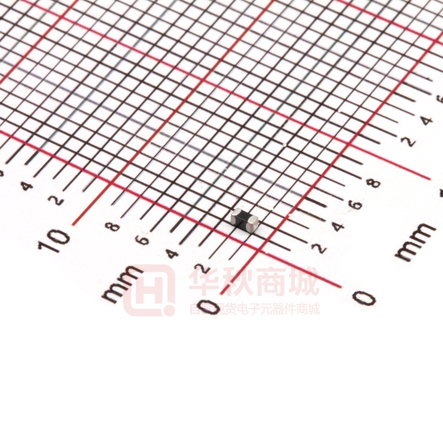

MLV0603E3 www.vishay.com Vishay BCcomponents SMD 0603 Multilayer Varistor FEATURES • Surface mount multilayer surge suppressor • Inherent bidirectional clamping • Excellent energy/volume ratio • Suitable for reflow soldering • Material categorization: for definitions of compliance please see www.vishay.com/doc?99912 APPLICATIONS Over-voltage and transient voltage protection: QUICK REFERENCE DATA PARAMETER VALUE UNIT • Data lines and I/O port protection • Protection against ESD transients Maximum continuous voltage DC 5.6 to 30.0 V • On-board protection of IC’s and transistors AC 4.0 to 25.0 V • Modem protection Maximum clamping voltage at 1 A 15.5 to 65 V • LCD protection Capacitance range (at 1 MHz) 150 to 825 pF DESCRIPTION Maximum energy (10/1000 μs) 0.1 J Maximum peak current 30 A -55 to 125 °C ± 0.005 g Operating temperature range Weight Size 0603 (1608M) multilayer chip varistor with NiSn terminations. PACKAGING Available in 8 mm paper tape, component pitch 4 mm on 180 mm reels containing 4000 pieces. ELECTRICAL DATA AND ORDERING INFORMATION WORKING VOLTAGE BREAKDOWN VOLTAGE MAXIMUM CLAMPING VOLTAGE TYPICAL CAPACITANCE PART NUMBER VRMS VDC Vb VC C SAP V V V V pF MLV0603E3 < 10 μA 1 mA 1 A, 8/20 μs 1 MHz 4.0 5.6 7.1 to 9.3 15.5 825 0403T 7.0 9.0 11.0 to 14.0 20.0 550 0703T 11.0 14.0 16.0 to 20.0 30.0 425 1103T 14.0 18.0 23.0 to 28.0 40.0 225 1403T 20.0 26.0 31.0 to 38.0 58.0 160 2003T 25.0 30.0 37.0 to 46.0 65.0 150 2503T Notes • Sinusoidal voltage assumed as normal operating condition. If a non-sinusoidal voltage is present, the crest voltage x 0.707 should be used for type selection. • Breakdown voltage at a current of 1 mA, measured according to 4.5 of IEC 61051-1. • Parts are not recommended for automotive applications. Revision: 22-Apr-15 Document Number: 29108 1 For technical questions, contact: nlr@vishay.com THIS DOCUMENT IS SUBJECT TO CHANGE WITHOUT NOTICE. THE PRODUCTS DESCRIBED HEREIN AND THIS DOCUMENT ARE SUBJECT TO SPECIFIC DISCLAIMERS, SET FORTH AT www.vishay.com/doc?91000 MLV0603E3 www.vishay.com Vishay BCcomponents DIMENSIONS in millimeters T L1 W T L2 and L3 1.6 ± 0.15 0.8 ± 0.15 0.9 max. 0.35 ± 0.15 W L2 L4 L1 L3   RECOMMENDED FOOTPRINT in millimeters C A B C 1.0 1.0 3.0 A B   V/I CHARACTERISTICS Max. clamping voltage Max. leakage current 100 025 020 VOLTAGE (V) 014 011 007 004 10 1 0.00001 0.0001 0.001 0.01 0.1 1 10 100 CURRENT (A) Revision: 22-Apr-15 Document Number: 29108 2 For technical questions, contact: nlr@vishay.com THIS DOCUMENT IS SUBJECT TO CHANGE WITHOUT NOTICE. THE PRODUCTS DESCRIBED HEREIN AND THIS DOCUMENT ARE SUBJECT TO SPECIFIC DISCLAIMERS, SET FORTH AT www.vishay.com/doc?91000 Legal Disclaimer Notice www.vishay.com Vishay Disclaimer ALL PRODUCT, PRODUCT SPECIFICATIONS AND DATA ARE SUBJECT TO CHANGE WITHOUT NOTICE TO IMPROVE RELIABILITY, FUNCTION OR DESIGN OR OTHERWISE. Vishay Intertechnology, Inc., its affiliates, agents, and employees, and all persons acting on its or their behalf (collectively, “Vishay”), disclaim any and all liability for any errors, inaccuracies or incompleteness contained in any datasheet or in any other disclosure relating to any product. Vishay makes no warranty, representation or guarantee regarding the suitability of the products for any particular purpose or the continuing production of any product. To the maximum extent permitted by applicable law, Vishay disclaims (i) any and all liability arising out of the application or use of any product, (ii) any and all liability, including without limitation special, consequential or incidental damages, and (iii) any and all implied warranties, including warranties of fitness for particular purpose, non-infringement and merchantability. Statements regarding the suitability of products for certain types of applications are based on Vishay’s knowledge of typical requirements that are often placed on Vishay products in generic applications. Such statements are not binding statements about the suitability of products for a particular application. It is the customer’s responsibility to validate that a particular product with the properties described in the product specification is suitable for use in a particular application. Parameters provided in datasheets and / or specifications may vary in different applications and performance may vary over time. All operating parameters, including typical parameters, must be validated for each customer application by the customer’s technical experts. Product specifications do not expand or otherwise modify Vishay’s terms and conditions of purchase, including but not limited to the warranty expressed therein. Except as expressly indicated in writing, Vishay products are not designed for use in medical, life-saving, or life-sustaining applications or for any other application in which the failure of the Vishay product could result in personal injury or death. Customers using or selling Vishay products not expressly indicated for use in such applications do so at their own risk. Please contact authorized Vishay personnel to obtain written terms and conditions regarding products designed for such applications. No license, express or implied, by estoppel or otherwise, to any intellectual property rights is granted by this document or by any conduct of Vishay. Product names and markings noted herein may be trademarks of their respective owners. © 2021 VISHAY INTERTECHNOLOGY, INC. ALL RIGHTS RESERVED Revision: 01-Jan-2021 1 Document Number: 91000
