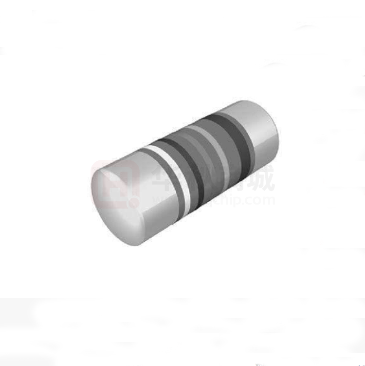

MMU 0102, MMA 0204, MMB 0207 - Professional www.vishay.com Vishay Beyschlag Professional Thin Film MELF Resistors FEATURES • Approved according to EN 140401-803 • AEC-Q200 qualified • Advanced metal film technology • Excellent overall stability: exceeds class 0.25 • Best in class pulse load capability • Intrinsic sulfur resistance • Material categorization: for definitions of compliance please see www.vishay.com/doc?99912 MMU 0102, MMA 0204, and MMB 0207 professional thin film MELF resistors are the perfect choice for most fields of modern professional electronics where reliability and stability is of major concern. The typical applications in the fields of automotive, telecommunication and medical equipment reflect the outstanding level of proven reliability. APPLICATIONS • Automotive • Telecommunication • Industrial • Medical equipment TECHNICAL SPECIFICATIONS DESCRIPTION MMU 0102 MMA 0204 MMB 0207 0102 0204 0207 Metric size code RC2211M RC3715M RC6123M Resistance range 0.22  to 2.21 M; 0 0.22  to 10 M; 0 0.1  to 15 M; 0  ±5 %; ± 2 %; ± 1 %; ± 0.5 % ±5 %; ± 1 %; ± 0.5 % ±5 %; ± 2 %; ± 1 %; ± 0.5 % DIN size Resistance tolerance Temperature coefficient ± 100 ppm/K; ± 50 ppm/K; ± 25 ppm/K ± 50 ppm/K; ± 25 ppm/K Rated dissipation, P70 (1) 0.3 W 0.4 W 1.0 W Operating voltage, Umax. ACRMS/DC 150 V 200 V 350 V Permissible film temperature, F max. (1) 155 °C Operating temperature range (1) -55 °C to 155 °C Permissible voltage against ambient (insulation): 1 min, Uins Failure rate: FITobserved 200 V 300 V 0.1 x 500 V 109/h Note (1) Please refer to APPLICATION INFORMATION below APPLICATION INFORMATION When the resistor dissipates power, a temperature rise above the ambient temperature occurs, dependent on the thermal resistance of the assembled resistor together with the printed circuit board. The rated dissipation applies only if the permitted film temperature is not exceeded. These resistors do not feature a limited lifetime when operated within the permissible limits. However, resistance value drift increasing over operating time may result in exceeding a limit acceptable to the specific application, thereby establishing a functional lifetime. Revision: 06-Apr-18 Document Number: 28713 1 For technical questions, contact: melf@vishay.com THIS DOCUMENT IS SUBJECT TO CHANGE WITHOUT NOTICE. THE PRODUCTS DESCRIBED HEREIN AND THIS DOCUMENT ARE SUBJECT TO SPECIFIC DISCLAIMERS, SET FORTH AT www.vishay.com/doc?91000 MMU 0102, MMA 0204, MMB 0207 - Professional www.vishay.com Vishay Beyschlag MAXIMUM RESISTANCE CHANGE AT RATED DISSIPATION OPERATION MODE Rated dissipation, P70 STANDARD POWER MMU 0102 0.2 W 0.3 W MMA 0204 0.25 W 0.4 W MMB 0207 0.4 W 1.0 W -55 °C to 125 °C -55 °C to 155 °C 125 °C 155 °C MMU 0102 0.22  to 2.21 M 0.22  to 2.21 M MMA 0204 0.22  to 10 M 0.22  to 10 M MMB 0207 0.1  to 15 M 0.1  to 15 M Operating temperature range Permissible film temperature, F max. Max. resistance change at P70 for resistance range, |R/R| after: 1000 h 0.15 %  0.25 % 8000 h 0.3 %  0.5 % 225 000 h 1.0 % - Note • The presented operation modes do not refer to different types of resistors, but actually show examples of different loads, that lead to different film temperatures and different achievable load-life stability (drift) of the resistance value. A suitable low thermal resistance of the circuit board assembly must be safeguarded in order to maintain the film temperature of the resistors within the specified limits. Please consider the application note “Thermal Management in Surface-Mounted Resistor Applications” (www.vishay.com/doc?28844) for information on the general nature of thermal resistance TEMPERATURE COEFFICIENT AND RESISTANCE RANGE TYPE/SIZE TCR ± 50 ppm/K MMU 0102 ± 25 ppm/K Jumper; Imax. = 2 A ± 50 ppm/K MMA 0204 ± 25 ppm/K Jumper; Imax. = 3 A ± 100 ppm/K MMB 0207 TOLERANCE RESISTANCE ±5% 0.22  to 0.91  E-SERIES ±2% 1  to 9.1  ±1% 10  to 2.21 M E24; E96 ± 0.5 % 10  to 221 k E24; E192 E24 ±1% 10  to 221 k E24; E96 ± 0.5 % 10  to 221 k E24; E192  10 m 0 - ±5% 0.22  to 0.91  ±1% 0.22  to 0.91  (1) E24 ±1% 1  to 10 M E24; E96 ± 0.5 % 10  to 2.21 M E24; E192 ±1% 10  to 511 k E24; E96 ± 0.5 % 10  to 511 k E24; E192  10 m 0 - ±5% 0.1  to 0.2  ±2% 0.1  to 0.2  (1) ±5% 0.22  to 0.91  E24 ±2% 0.22  to 0.91  ±1% 0.22  to 0.91  (1) ±1% 1  to 15 M E24; E96 ± 25 ppm/K ± 0.5 % 10  to 1 M E24; E192 Jumper; Imax. = 5 A  10 m 0 - ± 50 ppm/K Note (1) Approval according to EN 140401-803 not available Revision: 06-Apr-18 Document Number: 28713 2 For technical questions, contact: melf@vishay.com THIS DOCUMENT IS SUBJECT TO CHANGE WITHOUT NOTICE. THE PRODUCTS DESCRIBED HEREIN AND THIS DOCUMENT ARE SUBJECT TO SPECIFIC DISCLAIMERS, SET FORTH AT www.vishay.com/doc?91000 MMU 0102, MMA 0204, MMB 0207 - Professional www.vishay.com Vishay Beyschlag PACKAGING TYPE/SIZE MMU 0102 MMA 0204 CODE QUANTITY PACKAGING STYLE WIDTH PITCH B3 = BL 3000 Antistatic blister tape acc. IEC 60286-3, Type 2a 8 mm 4 mm Bulk case acc. IEC 60286-6 - - Antistatic blister tape acc. IEC 60286-3, Type 2a 8 mm 4 mm Bulk case acc. IEC 60286-6 - - Antistatic blister tape acc. IEC 60286-3, Type 2a 12 mm 4 mm B0 10 000 M8 8000 B3 = BL 3000 B0 10 000 M3 3000 B2 2000 MMB 0207 B7 7000 PACKAGING DIMENSIONS Ø 180 mm/7" Ø 330 mm/13" Ø 180 mm/7" Ø 330 mm/13" Ø 180 mm/7" Ø 330 mm/13" PART NUMBER AND PRODUCT DESCRIPTION Part Number: MMB02070D5620DB200 Part Number: MMB02070Z0000ZB200 M M B 0 2 0 7 0 D 5 6 2 0 D B 2 0 0 M M B 0 2 0 7 0 Z 0 0 0 0 Z B 2 0 0 TYPE/SIZE VERSION TCR RESISTANCE TOLERANCE PACKAGING MMU 0102 MMA 0204 MMB 0207 0= EN 140401-803, “Version A” D = ± 25 ppm/K C = ± 50 ppm/K B = ± 100 ppm/K Z = Jumper 3 digit value 1 digit multiplier D = ± 0.5 % F=±1% G=±2% J=±5% Z = Jumper B3 B0 B2 B7 M3 M8 Multiplier 7 = *10-3 8 = *10-2 9 = *10-1 0 = *100 1 = *101 2 = *102 3 = *103 4 = *104 5 = *105 0000 = Jumper Product Description: MMB 0207-25 0.5% B2 562R Product Description: MMB 0207 B2 0R0 MMB 0207 -25 0.5 % B2 562R MMB 0207 - - B2 0R0 TYPE SIZE TCR TOLERANCE PACKAGING RESISTANCE MMU MMA MMB 0102 0204 0207 ± 25 ppm/K ± 50 ppm/K ± 100 ppm/K ± 0.5 % ±1% ±2% ±5% BL B0 B2 B7 M3 M8 562R = 562  0R0 = Jumper Note • Products can be ordered using either the PART NUMBER or the PRODUCT DESCRIPTION Revision: 06-Apr-18 Document Number: 28713 3 For technical questions, contact: melf@vishay.com THIS DOCUMENT IS SUBJECT TO CHANGE WITHOUT NOTICE. THE PRODUCTS DESCRIBED HEREIN AND THIS DOCUMENT ARE SUBJECT TO SPECIFIC DISCLAIMERS, SET FORTH AT www.vishay.com/doc?91000 MMU 0102, MMA 0204, MMB 0207 - Professional www.vishay.com Vishay Beyschlag DESCRIPTION MATERIALS Production is strictly controlled and follows an extensive set of instructions established for reproducibility. A homogeneous film of metal alloy is deposited on a high grade ceramic body (Al2O3) and conditioned to achieve the desired temperature coefficient. Nickel plated steel termination caps are firmly pressed on the metallised rods. A special laser is used to achieve the target value by smoothly cutting a helical groove in the resistive layer without damaging the ceramics. The resistor elements are covered by a protective coating designed for electrical, mechanical and climatic protection. The terminations receive a final pure matte tin on nickel plating. Four or five color code rings designate the resistance value and tolerance in accordance with IEC 60062 (1). The result of the determined production is verified by an extensive testing procedure performed on 100 % of the individual resistors. This includes full screening for the elimination of products with a potential risk of early field failures (feasible for R  10 ) according to EN 140401-803, 2.1.2.2. Only accepted products are laid directly into the blister tape in accordance with IEC 60286-3, Type 2a (1) or bulk case in accordance with IEC 60286-6 (1). Vishay acknowledges the following systems for the regulation of hazardous substances: • IEC 62474, Material Declaration for Products of and for the Electrotechnical Industry, with the list of declarable substances given therein (2) • The Global Automotive Declarable Substance List (GADSL) (3) • The REACH regulation (1907/2006/EC) and the related list of substances with very high concern (SVHC) (4) for its supply chain The products do not contain any of the banned substances as per IEC 62474, GADSL, or the SVHC list, see www.vishay.com/how/leadfree. Hence the products fully comply with the following directives: • 2000/53/EC End-of-Life Vehicle Directive (ELV) and Annex II (ELV II) • 2011/65/EU Restriction of the Use of Hazardous Substances Directive (RoHS) with amendment 2015/863/EU • 2012/19/EU Waste Electrical and Electronic Equipment Directive (WEEE) Vishay pursues the elimination of conflict minerals from its supply chain, see the Conflict Minerals Policy at www.vishay.com/doc?49037. ASSEMBLY The resistors are suitable for processing on automatic SMD assembly systems. They are suitable for automatic soldering using wave, reflow or vapor phase as shown in IEC 61760-1 (1). The encapsulation is resistant to all cleaning solvents commonly used in the electronics industry, including alcohols, esters and aqueous solutions. The suitability of conformal coatings, potting compounds and their processes, if applied, shall be qualified by appropriate means to ensure the long term stability of the whole system. The resistors are completely lead (Pb)-free, the pure matte tin plating provides compatibility with lead (Pb)-free and lead containing soldering processes. Solderability is specified for 2 years after production or requalification, however, excellent solderability is proven after extended storage in excess of 10 years. The permitted storage time is 20 years. The immunity of the plating against tin whisker growth has been proven under extensive testing. APPROVALS The resistors are approved within the IECQ-CECC Quality Assessment System for Electronic Components according to table “Temperature Coefficient and Resistance Range” to the detail specification EN 140401-803 which refers to EN 60115-1, EN 60115-8 and the variety of environmental test procedures of the IEC 60068 (1) series. Conformity is attested by the use of the CECC logo ( ) as the mark of conformity on the package label. Vishay Beyschlag has achieved “Approval of Manufacturer” in accordance with IECQ 03-1. The release certificate for “Technology Approval Schedule” in accordance with CECC 240001 based on IECQ 03-3-1 is granted for the Vishay Beyschlag manufacturing process. The resistors are qualified according to AEC-Q200. RELATED PRODUCTS For products with precision specification see the datasheet: • “Precision Thin Film MELF Resistors”  (www.vishay.com/doc?28714) • “Ultra Precision Thin Film MELF Resistors”  (www.vishay.com/doc?28715) Resistors are available with established reliability in accordance with EN 140 401-803 Version E. Please refer to datasheet “MELF Resistors with Established Reliability”. (www.vishay.com/doc?28707) Notes (1) The quoted IEC standards are also released as EN standards with the same number and identical contents (2) The IEC 62474 list of declarable substances is maintained in a dedicated database, which is available at http://std.iec.ch/iec62474 (3) The Global Automotive Declarable Substance List (GADSL) is maintained by the American Chemistry Council and available at www.gadsl.org (4) The SVHC list is maintained by the European Chemical Agency (ECHA) and available at http://echa.europa.eu/candidate-list-table Revision: 06-Apr-18 Document Number: 28713 4 For technical questions, contact: melf@vishay.com THIS DOCUMENT IS SUBJECT TO CHANGE WITHOUT NOTICE. THE PRODUCTS DESCRIBED HEREIN AND THIS DOCUMENT ARE SUBJECT TO SPECIFIC DISCLAIMERS, SET FORTH AT www.vishay.com/doc?91000 MMU 0102, MMA 0204, MMB 0207 - Professional www.vishay.com Vishay Beyschlag Power Dissipation P FUNCTIONAL PERFORMANCE 1 MMB 0207 MMA 0204 MMU 0102 W 0.5 0 - 50 0 50 70 C 100 150 Ambient Temperature ϑ amb Power Dissipation P Derating - Standard Operation Mode 1 MMB 0207 MMA 0204 MMU 0102 W 0.5 0 - 50 0 50 70 100 C 150 Ambient Temperature ϑ amb Pulse Load Pmax. Derating - Power Operation Mode MMB 0207 MMA 0204 MMU 0102 100 W 10 1 0.1 1 µs 10 µs 100 µs 1 ms 10 ms 100 ms 1s 10 s Pulse Duration ti Maximum pulse load, single pulse; applicable if P 0 and n ≤ 1000 and U ≤ Umax.; for permissible resistance change ± (0.5 % R + 0.01 Ω) Single Pulse for R < 10 Ω Revision: 06-Apr-18 Document Number: 28713 5 For technical questions, contact: melf@vishay.com THIS DOCUMENT IS SUBJECT TO CHANGE WITHOUT NOTICE. THE PRODUCTS DESCRIBED HEREIN AND THIS DOCUMENT ARE SUBJECT TO SPECIFIC DISCLAIMERS, SET FORTH AT www.vishay.com/doc?91000 MMU 0102, MMA 0204, MMB 0207 - Professional Continuous Pulse Load Pmax. www.vishay.com Vishay Beyschlag MMB 0207 MMA 0204 MMU 0102 100 W 10 1 0.1 1 µs 10 µs 100 µs 1 ms 10 ms 100 ms 1s 10 s Pulse Duration ti Maximum pulse load, continuous pulse; applicable if P ≤ P (ϑamb) and U ≤ Umax.; for permissible resistance change ± (0.5 % R + 0.01 Ω) Pulse Load P Continuous Pulse for R < 10 Ω 1000 MMB 0207 MMA 0204 MMU 0102 W 100 10 1 0.1 1 µs 10 µs 100 µs 1 ms 10 ms 100 ms 1s 10 s Pulse Duration ti Maximum pulse load, single pulse; applicable if P 0 and n ≤ 1000 and U ≤ Umax.; for permissible resistance change ± (0.5 % R + 0.01 Ω) Continuous Pulse Load Pmax. Single Pulse for R ≥ 10 Ω 1000 MMB 0207 MMA 0204 MMU 0102 W 100 10 1 0.1 1 µs 10 µs 100 µs 1 ms 10 ms 100 ms 1s 10 s Pulse Duration ti Maximum pulse load, continuous pulse; applicable if P ≤ P (ϑamb) and U ≤ Umax.; for permissible resistance change ± (0.5 % R + 0.01 Ω) Continuous Pulse for R ≥ 10 Ω Revision: 06-Apr-18 Document Number: 28713 6 For technical questions, contact: melf@vishay.com THIS DOCUMENT IS SUBJECT TO CHANGE WITHOUT NOTICE. THE PRODUCTS DESCRIBED HEREIN AND THIS DOCUMENT ARE SUBJECT TO SPECIFIC DISCLAIMERS, SET FORTH AT www.vishay.com/doc?91000 MMU 0102, MMA 0204, MMB 0207 - Professional Pulse Voltage Umax. www.vishay.com Vishay Beyschlag MMB 0207 MMA 0204 MMU 0102 V 1000 100 1 µs 10 µs 100 µs 10 ms 1 ms 100 ms 1s 10 s Pulse Duration ti Maximum pulse voltage, single and continuous pulses; applicable if P ≤ Pmax.; for permissible resistance change ± (0.5 % R + 0.01 Ω) Pulse Voltage U Pulse Voltage 10 kV 1 kV 100 V MMB 0207 MMA 0204 MMU 0102 10 V 10 Ω 100 Ω 1 kΩ 10 kΩ 100 kΩ 1 MΩ 10 MΩ Resistance Value R Pulse load rating in accordance with IEC 60 115-1, 4.27; 1.2 μs / 50 μs; 5 pulses at 12 s intervals; for permissible resistance change ± (0.5 % R + 0.05 Ω) Pulse Voltage U 1.2 / 50 Pulse MMB 0207 MMA 0204 MMU 0102 10 kV 1 kV 100 V 10 V 10 Ω 100 Ω 1 kΩ 10 kΩ 100 kΩ 1 MΩ 10 MΩ Resistance Value R Pulse load rating in accordance with IEC 60115-1, 4.27; 10 μs / 700 μs; 10 pulses at 1 minute intervals; for permissible resistance change ± (0.5 % R + 0.05 Ω) 10 / 700 Pulse Revision: 06-Apr-18 Document Number: 28713 7 For technical questions, contact: melf@vishay.com THIS DOCUMENT IS SUBJECT TO CHANGE WITHOUT NOTICE. THE PRODUCTS DESCRIBED HEREIN AND THIS DOCUMENT ARE SUBJECT TO SPECIFIC DISCLAIMERS, SET FORTH AT www.vishay.com/doc?91000 MMU 0102, MMA 0204, MMB 0207 - Professional Current Noise Voltage Ratio www.vishay.com Vishay Beyschlag 1 µV/V 0.1 MMB 0207 MMA 0204 MMU 0102 0.01 100 Ω 1 kΩ 10 kΩ 100 kΩ 1 MΩ 10 MΩ Resistance Value R In accordance with IEC 60195 IZI/R Current Noise Voltage Ratio 2.0 1.5 1.0 MMB 0207 MMA 0204 MMU 0102 0.5 0.1 0.3 1 GHz 3 Frequency f |Z|/R for 49.9 Ω MELF resistors RF - Behavior Revision: 06-Apr-18 Document Number: 28713 8 For technical questions, contact: melf@vishay.com THIS DOCUMENT IS SUBJECT TO CHANGE WITHOUT NOTICE. THE PRODUCTS DESCRIBED HEREIN AND THIS DOCUMENT ARE SUBJECT TO SPECIFIC DISCLAIMERS, SET FORTH AT www.vishay.com/doc?91000 MMU 0102, MMA 0204, MMB 0207 - Professional www.vishay.com Vishay Beyschlag TESTS AND REQUIREMENTS All tests are carried out in accordance with the following specifications: EN 60115-1, generic specification EN 60115-8, sectional specification EN 140401-803, detail specification IEC 60068-2-xx, test methods The components are approved under the IECQ-CECC quality assessment system for electronic components according to table “Temperature Coefficient and Resistance Range”. The parameters stated in the Test Procedures and Requirements table are based on the required tests and permitted limits of EN 140401-803. The table presents only the most important tests, for the full test schedule refer to the documents listed above. However, some additional tests and a number of improvements against those minimum requirements have been included. The testing also covers most of the requirements specified by EIA/ECA-703 and JIS-C-5201-1. The tests are carried out under standard atmospheric conditions in accordance with IEC 60068-1, 4.3, whereupon the following values are applied: Temperature: 15 °C to 35 °C Relative humidity: 25 % to 75 % Air pressure: 86 kPa to 106 kPa (860 mbar to 1060 mbar) A climatic category LCT / UCT / 56 is applied, defined by the lower category temperature (LCT), the upper category temperature (UCT), and the duration of exposure in the damp heat, steady state test (56 days). The components are mounted for testing on printed circuit boards in accordance with EN 60115-8, 2.4.2, unless otherwise specified. TEST PROCEDURES AND REQUIREMENTS IEC EN 60 068-2 (1) 60 115-1 TEST CLAUSE METHOD TEST Stability for product types: 1  to < 10  221 k 1  to < 10  332 k MMB 0207 10  to 1 M 1  to < 10  > 1 M ± 1 % R; ±0.5 % R ± 2 % R; ±1 % R

物料型号: - MMU 0102 - MMA 0204 - MMB 0207
器件简介: 这些是Vishay Beyschlag生产的专业薄膜MELF电阻器,具有先进的金属膜技术,整体稳定性优秀,脉冲负载能力强,并且具有内在的抗硫性。它们适用于对可靠性和稳定性有严格要求的现代专业电子领域的大多数领域。
引脚分配: 文档中没有提供具体的引脚分配图,但通常MELF电阻器的引脚分配是对称的,两端分别为电阻器的两端。
参数特性: - 尺寸:DIN尺寸0102、0204和0207,公制尺寸代码分别为RC2211M、RC3715M和RC6123M。 - 电阻范围:0.22到2.21兆欧,0.22到10兆欧,0.1到15兆欧。 - 电阻公差:±5%、±2%、±1%、±0.5%。 - 温度系数:±50 ppm/K、±25 ppm/K、±100 ppm/K。 - 额定耗散功率:0.3瓦、0.4瓦、1.0瓦。 - 最大工作电压:150伏、200伏、350伏。 - 允许的膜温度:155°C。 - 工作温度范围:-55°C至155°C。 - 允许的抗环境电压(绝缘):1分钟,200伏、300伏、500伏。
功能详解: 这些电阻器在功率耗散时会产生温度上升,这取决于组装电阻器与印刷电路板的热阻。如果不超过允许的膜温度,则适用额定耗散功率。这些电阻器在允许的限值内操作时没有有限的使用寿命。但是,随着操作时间的增加,电阻值的漂移可能会导致超出特定应用可接受的限制,从而确定功能寿命。
应用信息: 这些电阻器适用于汽车、电信、工业和医疗设备等领域。
封装信息: 提供了不同尺寸的电阻器的封装风格、宽度、间距和封装尺寸。例如,MMU 0102的封装风格为防静电泡罩胶带,宽度为8毫米,间距为4毫米。
