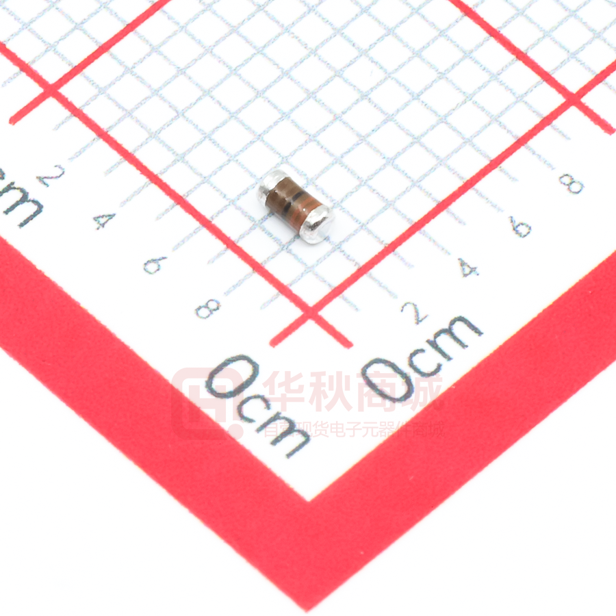

    贴片电阻 MELF_D1.1X2.2MM_SM 3.3KΩ ±1% 300mW ±50ppm/℃
