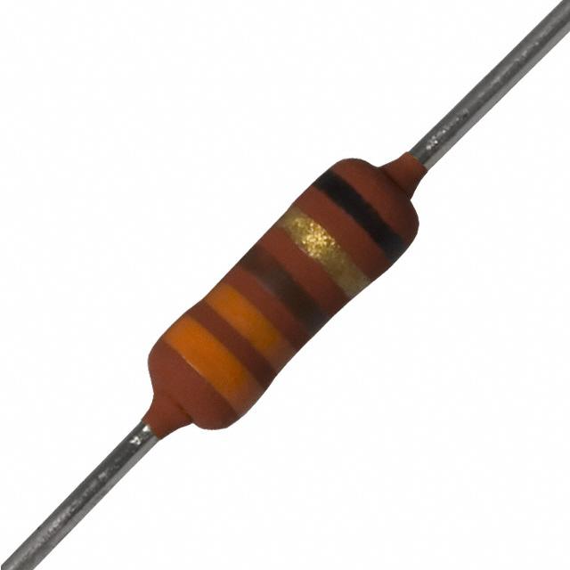

    47 Ohms ±5% 1W 轴向 通孔电阻器 耐燃,可熔,安全 金属薄膜
NFR0100004709JR500 数据手册
NFR01, NFR02, NFR03 Vishay BCcomponents Fusible Power Metal Film Leaded Resistors FEATURES • Metal film technology • High power (upto 3 W) in small package • Small standard sizes (0207/0414/0617) • High stability, reliability and uniformity characteristics • Defined interruption behaviour (fusing time) • Various forming styles • Non flammable A homogenous film of metal alloy is depositded on a high grade ceramic body. After a helical groove has been cut in the resistive layer, tinned electrolytic copper wires are welded to the end-caps. The resistors are coated with a red non-flammable lacquer, which provides electrical, mechanical, and climatic protection. The encapsulation is resistant to all cleaning solvents in accordance with “MIL-STD 202E, method 215” and “IEC 60068-2-45“. • Compatible with lead (Pb)-free and lead containing soldering processes • Lead (Pb)-free and RoHS compliant APPLICATIONS • Audio • Video TECHNICAL SPECIFICATIONS DESCRIPTION NFR01 NFR02 Resistance Range (1) 0.47 Ω to 1 kΩ Resistance Tolerance ± 5 %; E24 series Temperature Coefficient NFR03 ± 200 ppm/K Climatic Category (LCT/UCT/days) 55/155/56 Rated Dissipation P70 1W Maximum Permissible Voltage: DC or RMS 2W 350 V 3W 500 V 0.47 Ω to 10 Ω; ≥ 20 x Pn Fusing Power 10.1 Ω to 1 kΩ; ≥ 16 x Pn ≤ 60 s Fusing Time Maximum Resistance Change at P70 for Resistance Range, ΔR max., after: Load ± (5 % R + 0.1 Ω) Climatic Tests ± (3 % R + 0.1 Ω) Resistance to Soldering Heat ± (1 % R + 0.05 Ω) Note (1) Resistance values below 0.47 Ω with ± 10 % tolerance are available on request Document Number: 30256 Revision: 06-Dec-07 For technical questions, contact: filmresistors.leaded@vishay.com www.vishay.com 1 NFR01, NFR02, NFR03 Vishay BCcomponents Fusible Power Metal Film Leaded Resistors 12NC INFORMATION FOR HISTORICAL CODING REFERENCE ONLY Last Digit of 12NC Indicating Resistance Decade • The resistors have a 12 digit ordering code starting with 2306 RESISTANCE DECADE LAST DIGIT 0.47 Ω to 0.91 Ω 7 • The next 5 digits indicate the resistor type and packaging 1 Ω to 9.1 Ω 8 • The last 3 digits indicate the resistance value: 10 Ω to 91 Ω 9 100 Ω to 910 Ω 1 1 kΩ 2 – The first 2 digits indicate the actual resistance value – The last digit indicates the resistance decade in accordance with table 12NC Example NFR01, 1 Ω, ± 5 %, ammopack 1000 pieces is 2306 208 13108 12NC - resistor type and packaging ORDERING CODE 2306 ... ..... DESCRIPTION TYPE BANDOLIER ON REEL BANDOLIER IN AMMOPACK TAPE WIDTH TOL. 500 UNITS 1000 UNITS 5000 UNITS 5000 UNITS 52.5 ±5% - 208 13... 208 53... 208 23... NFR01 NFR02 52.5 ±5% - 209 13... - 209 23... NFR03 63.0 ±5% 210 13... - - - PART NUMBER AND PRODUCT DESCRIPTION PART NUMBER (1): NFR0100001008JA100 N F R 0 1 0 0 0 0 1 0 0 8 J A 1 0 0 MODEL/SIZE SPECIAL CHARACTER TCR/MATERIAL VALUE TOLERANCE PACKAGING (2) SPECIAL NFR0100 NFR0200 NFR0300 0 = neutral 0 = standard 3 digit value 1 digit multiplier Multiplier: 7 = *10-3 8 = *10-2 9 = *10-1 0 = *100 1 = *101 2 = *102 3 = *103 4 = *104 J=±5% A1 A5 R5 AC up to 2 digits 00 = standard PRODUCT DESCRIPTION: NFR01 5 % A1 1R0 NFR01 5% A1 1R0 MODEL TOLERANCE PACKAGING (2) RESISTANCE VALUE NFR01 NFR02 NFR03 ±5% A1 A5 R5 AC 1R0 = 1 Ω 470R = 470 Ω Notes (1) The PART NUMBER is shown to facilitate the introduction of the unified part numbering system (2) Please refer to table PACKAGING, see next page www.vishay.com 2 For technical questions, contact: filmresistors.leaded@vishay.com Document Number: 30256 Revision: 06-Dec-07 NFR01, NFR02, NFR03 Fusible Power Metal Film Leaded Resistors Vishay BCcomponents PACKAGING REEL BOX MODEL PIECES CODE PIECES CODE NFR01 5000 R5 1000 5000 A1 A5 NFR02 5000 R5 1000 A1 NFR03 - - 500 AC DIMENSIONS L1 ØD Ød L2 A DIMENSIONS - resistor types, mass and relevant physical dimensions L1 max. (mm) L2 max. (mm) Dmax. (mm) Ød (mm) A (mm) MASS (g)/ 100 pieces NFR01 6.5 8.5 2.5 0.58 ± 0.05 52.5 ± 1.5 22 NFR02 10 12 4 0.80 ± 0.03 52.5 ± 1.5 50 NFR03 16.7 19.5 5.3 0.80 ± 0.03 63.0 ± 1.5 120 TYPE MARKING The nominal resistance and tolerance are marked on the resistor using four colored bands in accordance with IEC 60062 “Color code for fixed resistors”. There is a fifth black band in order to indicate the type of resistor. Standard values of nominal resistance are taken from the E24 series for resistors with a tolerance of ± 5 %. Power Dissipation P FUNCTIONAL PERFORMANCE 100 0 - 55 0 70 155 Ambient temperature ϑ amb Derating - Standard Operation Maximum dissipation (Pmax.) in percentage of rated power as a function of ambient temperature (Tamb) Document Number: 30256 Revision: 06-Dec-07 For technical questions, contact: filmresistors.leaded@vishay.com www.vishay.com 3 NFR01, NFR02, NFR03 Fusible Power Metal Film Leaded Resistors Vishay BCcomponents APPLICATION INFORMATION NFR01 Hot Spot Solder Spot 160 60 Ø 0.58 mm Cu Ø 0.58 mm Cu 140 15 mm 50 20 mm 25 mm 120 40 100 ΔT 80 (°C) ΔT 30 0 (°C) 60 20 40 10 20 0 0 0.2 0.4 0.6 0.8 0 1.0 0 0.2 0.4 P (W) 0.6 0.8 1.0 1.2 P (W) Hot spot temperature rise (ΔT) as a function of dissipated power Temperature rise (ΔT) at the lead end (soldering point) as a function of dissipated power at various leads lengths after mounting Hot Spot Solder Spot NFR02 160 100 Ø 0.80 mm Cu Ø 0.80 mm Cu 15 mm 140 80 120 20 mm 100 60 ΔT 80 (°C) 25 mm ΔT (°C) 40 60 40 20 20 0 0 0.5 1.0 1.5 2.0 0 0 0.5 P (W) Hot spot temperature rise (ΔT) as a function of dissipated power www.vishay.com 4 1.0 1.5 2.0 P (W) Temperature rise (ΔT) at the lead end (soldering point) as a function of dissipated power at various leads lengths after mounting For technical questions, contact: filmresistors.leaded@vishay.com Document Number: 30256 Revision: 06-Dec-07 NFR01, NFR02, NFR03 Fusible Power Metal Film Leaded Resistors Vishay BCcomponents NFR03 Hot Spot Solder Spot 180 100 Ø 0.80 mm Cu Ø 0.80 mm Cu 15 mm 160 20 mm 80 140 120 25 mm 60 100 0 ΔT (°C) 80 ΔT (°C) 40 60 40 20 20 0 0 0.5 1.0 1.5 2.0 2.5 0 3.0 0 0.5 1.0 P (W) 1.5 2.0 2.5 3.0 P (W) Hot spot temperature rise (ΔT) as a function of dissipated power Temperature rise (ΔT) at the lead end (soldering point) as a function of dissipated power at various leads lengths after mounting FUSING CHARACTERISTIC The resistors will fuse without the risk of fire and within an indicated range of overload. Fusing means that the resistive value of the resistor increases at least 100 times. Resistance Range Power Overload Fusing Time 0.47 Ω - 10 Ω ≥ 20 x maximum dissipation at 70 °C (Pn) 10.1 Ω - 1 kΩ ≥ 16 x maximum dissipation at 70 °C (Pn) ≤ 60 s TESTS AND REQUIREMENTS Essentially all tests are carried out in accordance with the schedule of IEC 60115-1, category 55/155/56 (rated temperature range - 55 to + 155 °C; damp heat, long term, 56 days) and along the lines of IEC 60068-2; “Recommended basic climatic and mechanical robustness testing procedure for electronic components” and under standard atmosphere conditions according to IEC 60068-1 subclause 5.3, unless otherwise specified. In some instances deviations from IEC applications were necessary for our specified method. PERFORMANCE IEC 60068-2 TEST METHOD TEST PROCEDURE 4.8 - Temperature coefficient Between - 55 °C and + 155 °C ± 200 ppm/K 4.25.1 - Endurance at 70 °C 1000 h; loaded with Pn or Vmax.; 1.5 h ON; 0.5 h OFF ± (5 % R + 0.1 Ω) Accidental overload Overload of 5, 10, 16, 25, 40, 63 and 100 times the rated power, but the applied voltage shall not exceed four times the limiting voltage. Non-flammable IEC 60115-1 CLAUSE 4.26 - REQUIREMENTS PERMISSIBLE CHANGE (ΔR) NFR01 Document Number: 30256 Revision: 06-Dec-07 NFR02 For technical questions, contact: filmresistors.leaded@vishay.com NFR03 www.vishay.com 5 NFR01, NFR02, NFR03 Vishay BCcomponents Fusible Power Metal Film Leaded Resistors PERFORMANCE IEC 60115-1 CLAUSE IEC 60068-2 TEST METHOD TEST PROCEDURE 56 days; 40 °C; 90 to 95 % RH loaded with 0.01 Pn NFR01 4.24 3 (Ca) Damp heat, steady state 4.16 21 (U) Robustness of terminations: 4.16.2 21 (Ua1) Tensile all samples Load 10 N; 10 s 4.16.3 21 (Ub) Bending half number of samples Load 5 N; 4 x 90° 4.16.4 21 (Uc) Torsion other half of samples 3 x 360° in opposite direction Rapid change of temperature 30 min at LCT; 30 min at UCT; LCT = - 55 °C; UCT = 155 °C; 5 cycles 4.19 14 (Na) 4.23 4.23.2 REQUIREMENTS PERMISSIBLE CHANGE (ΔR) NFR02 NFR03 Rins min. 103 MΩ ± (3 % R + 0.1 Ω) No damage ± (0.5 % R + 0.05 Ω) ± (1 % R + 0.05 Ω) ± (1 % R + 0.05 Ω) ± (2 % R + 0.05 Ω) Climatic sequence 2 (Ba) Dry heat 16 h, 155 °C 4.23.3 30 (Db) Damp heat (accelerated) 24 h; 25 °C to 55 °C 90 % to 100 % RH; 1 cycle 4.23.4 1 (Aa) Cold 2 h, - 55 °C 4.23.6 30 (Db) Damp heat, (accelerated) remaining cycles 5 days; 25 °C to 55 °C 90 to 100 % RH Vibration Endurance by sweeping; 10 Hz to 500 Hz; displacement 1.5 mm or acceleration 10 g; 6 h (3 x 2 h) No visual damage ± (0.5 % R + 0.05 Ω) 20 (Ta) Solderability (after ageing) 16 h at 155 °C; immersed in flux 600, leads immersed 2 mm in solder bath at (235 ± 5) °C for (2 ± 0.5) s Good tinning (≥ 95% covered); no visible damage 4.18 20 (Tb) Resistance to soldering heat Solder bath method; (350 ± 10) °C; 6 mm from body; for 3 s ± (1 % R + 0.05 Ω) 4.29 45 (XA) Component solvent resistance Isopropyl alcohol; MIL STD 202E No visible damage 4.7 - Voltage proof on insulation 500 VRMS during 1 min, V-block method No flashover or breakdown 4.6.1.1 - Insulation resistance 500 VDC during 1 min, V-block method Rins min. 104 MΩ 4.22 4.17 6 (Fc) www.vishay.com 6 Rins min. 103 MΩ ± (3 % R + 0.1 Ω) For technical questions, contact: filmresistors.leaded@vishay.com Document Number: 30256 Revision: 06-Dec-07 Legal Disclaimer Notice Vishay Disclaimer ALL PRODUCT, PRODUCT SPECIFICATIONS AND DATA ARE SUBJECT TO CHANGE WITHOUT NOTICE TO IMPROVE RELIABILITY, FUNCTION OR DESIGN OR OTHERWISE. Vishay Intertechnology, Inc., its affiliates, agents, and employees, and all persons acting on its or their behalf (collectively, “Vishay”), disclaim any and all liability for any errors, inaccuracies or incompleteness contained in any datasheet or in any other disclosure relating to any product. Vishay makes no warranty, representation or guarantee regarding the suitability of the products for any particular purpose or the continuing production of any product. To the maximum extent permitted by applicable law, Vishay disclaims (i) any and all liability arising out of the application or use of any product, (ii) any and all liability, including without limitation special, consequential or incidental damages, and (iii) any and all implied warranties, including warranties of fitness for particular purpose, non-infringement and merchantability. Statements regarding the suitability of products for certain types of applications are based on Vishay’s knowledge of typical requirements that are often placed on Vishay products in generic applications. Such statements are not binding statements about the suitability of products for a particular application. It is the customer’s responsibility to validate that a particular product with the properties described in the product specification is suitable for use in a particular application. Parameters provided in datasheets and/or specifications may vary in different applications and performance may vary over time. All operating parameters, including typical parameters, must be validated for each customer application by the customer’s technical experts. Product specifications do not expand or otherwise modify Vishay’s terms and conditions of purchase, including but not limited to the warranty expressed therein. Except as expressly indicated in writing, Vishay products are not designed for use in medical, life-saving, or life-sustaining applications or for any other application in which the failure of the Vishay product could result in personal injury or death. Customers using or selling Vishay products not expressly indicated for use in such applications do so at their own risk and agree to fully indemnify and hold Vishay and its distributors harmless from and against any and all claims, liabilities, expenses and damages arising or resulting in connection with such use or sale, including attorneys fees, even if such claim alleges that Vishay or its distributor was negligent regarding the design or manufacture of the part. Please contact authorized Vishay personnel to obtain written terms and conditions regarding products designed for such applications. No license, express or implied, by estoppel or otherwise, to any intellectual property rights is granted by this document or by any conduct of Vishay. Product names and markings noted herein may be trademarks of their respective owners. Document Number: 91000 Revision: 11-Mar-11 www.vishay.com 1

物料型号:NFR01, NFR02, NFR03
器件简介: - 这些电阻器采用高等级陶瓷基体上沉积的均质金属合金膜制成。 - 电阻层上切割螺旋槽后,锡焊电镀铜线焊接到端盖。 - 电阻器涂有红色不可燃漆,提供电气、机械和气候保护。
引脚分配:文档中未明确提供引脚分配信息,但通常这类电阻器会有两端引脚用于连接。
参数特性: - 金属膜技术。 - 高功率(最高3W)在小尺寸封装中。 - 标准尺寸包括0207/0414/0617。 - 高稳定性、可靠性和一致性特性。 - 定义的中断行为(熔断时间)。 - 多种成型风格。 - 不可燃。 - 兼容无铅和含铅焊接工艺。 - 无铅和符合RoHS标准。
功能详解: - 这些电阻器设计用于在过载情况下安全熔断,不会引发火灾,熔断时电阻值至少增加100倍。
