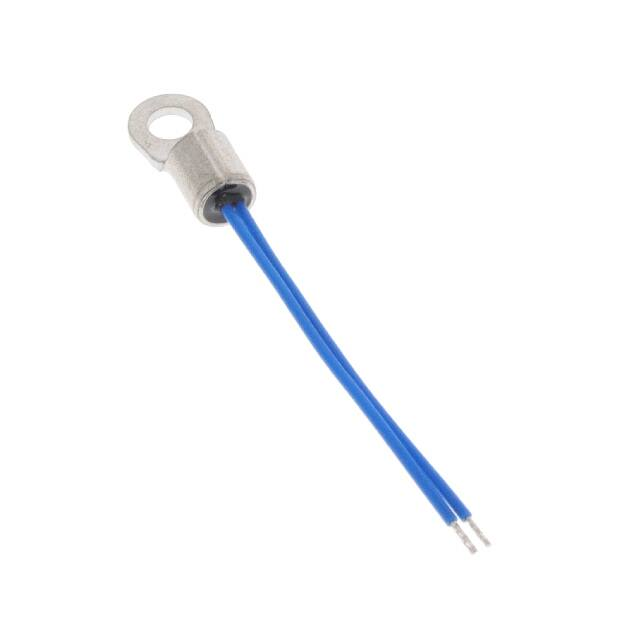

    TFUNK(威世)
    NTC热敏电阻 10KΩ ±2%
NTCALUG01T103G400 数据手册
NTCALUG01T www.vishay.com Vishay BCcomponents NTC Thermistors, Standard Lug Sensors, 150 °C FEATURES • 150 °C long term stability (5000 h dry heat) • Easy mounting using ring tongue terminal Available • Rugged construction • Cable with ETFE insulation according to NEMA HP-3, type Z, rated 600 VRMS, cable test voltage 3.4 kV • AEC-Q200 qualified (grade 1) • cULus recognized, file E148885 (UL category XGPU2/XGPU8) • Material categorization: for definitions of compliance please see www.vishay.com/doc?99912 LINKS TO ADDITIONAL RESOURCES 3D 3D 3D Models Design Tools Models APPLICATIONS Related Documents QUICK REFERENCE DATA PARAMETER Resistance value at 25 °C (1) Tolerance on R25-value (1) B25/85-value (1) Tolerance on B25/85-value Operating temperature range at zero dissipation Min. dielectric withstanding voltage between terminals and lug Min. insulation resistance between terminals and lug at 500 VDC Weight VALUE 10K ± 1 to ± 2 3435, 3984 ± 0.5 to ± 1 UNIT Ω % K % -40 to +150 °C 2700 VAC 100 MΩ 2.0 to 3.2 g Note (1) Other R -values, B 25 25/85-values, and tolerances are available upon request AGENCY APPROVALS • cUL certificate XGPU8.E148885 • ULus certificate XGPU2.E148885 Note • Agency approval documents, please see: www.vishay.com/ppg?29164&documents Suitable for surface sensing applications, especially when a good electrical insulation and a good thermal contact with the chassis is required for: • Automotive equipment • EV and battery management • Power electronics, heat sink • Consumer appliances DESCRIPTION A NTC thermistor chip is soldered to AWG#26 multi-stranded silver plated copper leads with ETFE insulation and insulated with epoxy coating. The insulated sensor is attached to a tin plated copper ring lug via a middle buffer layer. The lead wires are twisted. PACKAGING The thermistors are packed in cardboard boxes; the smallest packaging quantity is 200 units. CAUTIONS AND WARNINGS ON MOUNTING AND HANDLING Please read the special instructions: see www.vishay.com/doc?29221. DESIGN-IN SUPPORT • By means of M3 (stud #3, #4) or M3,5 (stud #5, #6) screw. Leads to be soldered or crimped • Other resistance curves and tolerances are available on request • The device is suitable for screwing e.g. on metal surface • Consult Vishay for other lead length, other connector crimping, or other features • The leads are suitable for soldering e.g. on PCB • 3D solid models: www.vishay.com/doc?29179 • NTC curve computation: www.vishay.com/thermistors/ntc-rt-calculator/ Revision: 13-Jul-2021 Document Number: 29164 1 For technical questions, contact: nlr@vishay.com THIS DOCUMENT IS SUBJECT TO CHANGE WITHOUT NOTICE. THE PRODUCTS DESCRIBED HEREIN AND THIS DOCUMENT ARE SUBJECT TO SPECIFIC DISCLAIMERS, SET FORTH AT www.vishay.com/doc?91000 NTCALUG01T www.vishay.com Vishay BCcomponents DIMENSIONS in millimeters T Ø D2 Ø D3 Ø D4 Ø D1 L2 E L3 L1 L1 L2 Ø D1 Ø D2 Ø D3 T L3 E D4 Refer to the ordering table 3.8 ± 1 3.7 +0.2 / -0 7.2 ± 0.2 5.6 +0.3 / -0.2 1.0 15.70 ± 0.3 6.2 ± 0.2 0.93 ± 0.1 ELECTRICAL DATA AND ORDERING INFORMATION R25 (Ω) R25B25/85B25/85 TOL. TOL. (K) (± %) (± %) L1 (mm) DESCRIPTION UL RECOG. SAP MATERIAL AND ORDERING NUMBER RoHS-COMPLIANT WITH EXEMPTION (1) RoHS-COMPLIANT 10 000 1 3984 0.5 150 ± 10 NTC Lug01T 10K 1 % 3984 K 150 °C ETFE AWG26 150 mm ✓ NTCALUG01T103F NTCALUG01T103FA 10 000 1 3435 1.0 150 ± 10 NTC Lug01T 10K 1 % 3435 K 150 °C ETFE AWG26 150 mm ✓ NTCALUG01T103FL NTCALUG01T103FLA 10 000 2 3984 0.5 40 ± 5 NTC Lug01T 10K 2 % 3984 K 150 °C ETFE AWG26 40 mm ✓ NTCALUG01T103G400 NTCALUG01T103G400A 10 000 2 3984 0.5 150 ± 10 NTC Lug01T 10K 2 % 3984 K 150 °C ETFE AWG26 150 mm ✓ NTCALUG01T103G NTCALUG01T103GA 10 000 2 3984 0.5 200 ± 10 NTC Lug01T 10K 2 % 3984 K 150 °C ETFE AWG26 200 mm ✓ NTCALUG01T103G201 NTCALUG01T103G201A 10 000 2 3984 0.5 500 ± 10 NTC Lug01T 10K 2 % 3984 K 150 °C ETFE AWG26 500 mm ✓ NTCALUG01T103G501 NTCALUG01T103G501A Notes Preferred versions for new designs (1) RoHS exemption 7(c)-I: electrical and electronic components containing lead in a glass or ceramic other than dielectric ceramic in capacitors, e.g. piezo-electronic devices, or in a glass or ceramic matrix compound Revision: 13-Jul-2021 Document Number: 29164 2 For technical questions, contact: nlr@vishay.com THIS DOCUMENT IS SUBJECT TO CHANGE WITHOUT NOTICE. THE PRODUCTS DESCRIBED HEREIN AND THIS DOCUMENT ARE SUBJECT TO SPECIFIC DISCLAIMERS, SET FORTH AT www.vishay.com/doc?91000 Legal Disclaimer Notice www.vishay.com Vishay Disclaimer ALL PRODUCT, PRODUCT SPECIFICATIONS AND DATA ARE SUBJECT TO CHANGE WITHOUT NOTICE TO IMPROVE RELIABILITY, FUNCTION OR DESIGN OR OTHERWISE. Vishay Intertechnology, Inc., its affiliates, agents, and employees, and all persons acting on its or their behalf (collectively, “Vishay”), disclaim any and all liability for any errors, inaccuracies or incompleteness contained in any datasheet or in any other disclosure relating to any product. Vishay makes no warranty, representation or guarantee regarding the suitability of the products for any particular purpose or the continuing production of any product. To the maximum extent permitted by applicable law, Vishay disclaims (i) any and all liability arising out of the application or use of any product, (ii) any and all liability, including without limitation special, consequential or incidental damages, and (iii) any and all implied warranties, including warranties of fitness for particular purpose, non-infringement and merchantability. Statements regarding the suitability of products for certain types of applications are based on Vishay's knowledge of typical requirements that are often placed on Vishay products in generic applications. Such statements are not binding statements about the suitability of products for a particular application. It is the customer's responsibility to validate that a particular product with the properties described in the product specification is suitable for use in a particular application. Parameters provided in datasheets and / or specifications may vary in different applications and performance may vary over time. All operating parameters, including typical parameters, must be validated for each customer application by the customer's technical experts. Product specifications do not expand or otherwise modify Vishay's terms and conditions of purchase, including but not limited to the warranty expressed therein. Hyperlinks included in this datasheet may direct users to third-party websites. These links are provided as a convenience and for informational purposes only. Inclusion of these hyperlinks does not constitute an endorsement or an approval by Vishay of any of the products, services or opinions of the corporation, organization or individual associated with the third-party website. Vishay disclaims any and all liability and bears no responsibility for the accuracy, legality or content of the third-party website or for that of subsequent links. Except as expressly indicated in writing, Vishay products are not designed for use in medical, life-saving, or life-sustaining applications or for any other application in which the failure of the Vishay product could result in personal injury or death. Customers using or selling Vishay products not expressly indicated for use in such applications do so at their own risk. Please contact authorized Vishay personnel to obtain written terms and conditions regarding products designed for such applications. No license, express or implied, by estoppel or otherwise, to any intellectual property rights is granted by this document or by any conduct of Vishay. Product names and markings noted herein may be trademarks of their respective owners. © 2021 VISHAY INTERTECHNOLOGY, INC. ALL RIGHTS RESERVED Revision: 09-Jul-2021 1 Document Number: 91000
