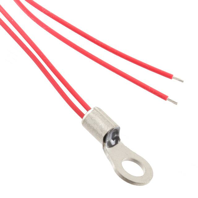

    NTC热敏电阻 10KΩ ±2%
NTCALUG54A103G351A 数据手册
NTCALUG54A M5 www.vishay.com Vishay BCcomponents NTC Thermistors, Standard Lug Sensors FEATURES • Easy mounting using ring tongue terminal • Rugged construction Available • Cable of PTFE insulation according to NEMA HP-3, type E, rated 600 VRMS (1) • AEC-Q200 qualified (grade 1) • cULus recognized, file E148885 (UL category XGPU2/XGPU8) LINKS TO ADDITIONAL RESOURCES • Material categorization: for definitions of compliance please see www.vishay.com/doc?99912 3D 3D 3D Models Design Tools Models Note Related Documents (1) QUICK REFERENCE DATA PARAMETER B25/85-value (1) Tolerance on B25/85-value UNIT 10K Ω ± 2 to ± 3 % 3435 to 3984 K DESCRIPTION ± 0.5 to ± 1 % A NTC thermistor chip is soldered to AWG#24 stranded silver plated copper leads with PTFE insulation and insulated with epoxy coating. The insulated sensor is attached to a tin plated copper ring lug. The lead wires are stripped. Operating temperature range at: °C Zero dissipation APPLICATIONS VALUE Resistance value at 25 °C (1) Tolerance on R25-value (1) Formerly MIL-W-16878/4, type E, cable test voltage 3.4 kV -40 to +150 Suitable for surface sensing applications, especially when a good electrical insulation and a good thermal contact with the chassis is required. Dissipation factor (2) ≈ 23 mW/K Thermal time constant (2) ≈ 7.5 s Min. dielectric withstanding voltage between terminals and lug 1500 VAC The thermistors are packed in cardboard boxes. Min. insulation resistance between terminals and lug at 500 VDC 100 MΩ CAUTIONS AND WARNINGS ON MOUNTING AND HANDLING Climatic category (LCT / UCT / days) Weight Please read the special instructions: see www.vishay.com/doc?29221 40 / 150 / 56 1.6 to 4.3 g Notes (1) Other R -values, B 25 25/85-values, and tolerances are available upon request (2) Measured with screw mounted on an aluminum heatsink of 100 cm2, thickness 1.5 mm, in still air at Tamb = 25 °C AGENCY APPROVALS • cUL certificate XGPU8.E148885 • ULus certificate XGPU2.E148885 Note • Agency approval documents, please see: www.vishay.com/ppg?29194&documents Revision: 25-Aug-2021 PACKAGING • By means of M5 (stud #10) screw. Leads to be soldered or crimped • The device is suitable for screwing e.g. on metal surface • The leads are suitable for soldering e.g. on PCB DESIGN-IN SUPPORT • Other resistance curves and tolerances are available on request • Consult Vishay for other lead length, other connector crimping, or other features • 3D solid models: www.vishay.com/doc?29199 • NTC curve computation: www.vishay.com/thermistors/ntc-rt-calculator/ Document Number: 29194 1 For technical questions, contact: nlr@vishay.com THIS DOCUMENT IS SUBJECT TO CHANGE WITHOUT NOTICE. THE PRODUCTS DESCRIBED HEREIN AND THIS DOCUMENT ARE SUBJECT TO SPECIFIC DISCLAIMERS, SET FORTH AT www.vishay.com/doc?91000 NTCALUG54A M5 www.vishay.com Vishay BCcomponents DIMENSIONS in millimeters T Ø D3 Ø D4 L2 Ø D2 Ø D1 E L1 L3 L1 L2 Ø D1 Ø D2 Ø D3 T L3 E D4 Refer to the ordering table 2.5 ± 1 5.3 +0.2 / -0 9.5 ± 0.2 5.6 +0.3 / -0.2 1.0 19.8 ± 0.4 6.8 ± 0.3 1.12 ± 0.1 ELECTRICAL DATA AND ORDERING INFORMATION R25 (Ω) R25TOL. (± %) B25/85 (K) B25/85-TOL. (± %) L1 (mm) DESCRIPTION 10 000 2 3984 0.5 38.1 ± 3.8 NTC Lug54 M5 10K 2 % 3984 K PTFE AWG#24 38 mm 10 000 2 3435 1 38.1 ± 3.8 10 000 2 3984 0.5 10 000 3 3984 0.5 UL RECOG. SAP MATERIAL AND ORDERING NUMBER RoHS-COMPLIANT WITH EXEMPTION (1) RoHS-COMPLIANT ✓ NTCALUG54A103G NTCALUG54A103GA NTC Lug54 M5 10K 2 % 3435 K PTFE AWG#24 38 mm ✓ NTCALUG54A103GL NTCALUG54A103GLA 350 +10 / -5 NTC Lug54 M5 10K 2 % 3984 K PTFE AWG#24 350 mm ✓ NTCALUG54A103G351 NTCALUG54A103G351A 150 +10 / -5 NTC Lug54 M5 10K 3 % 3984 K PTFE AWG#24 150 mm ✓ NTCALUG54A103H151 NTCALUG54A103H151A Notes Preferred versions for new designs (1) RoHS exemption 7(c)-I: electrical and electronic components containing lead in a glass or ceramic other than dielectric ceramic in capacitors, e.g. piezo-electronic devices, or in a glass or ceramic matrix compound Revision: 25-Aug-2021 Document Number: 29194 2 For technical questions, contact: nlr@vishay.com THIS DOCUMENT IS SUBJECT TO CHANGE WITHOUT NOTICE. THE PRODUCTS DESCRIBED HEREIN AND THIS DOCUMENT ARE SUBJECT TO SPECIFIC DISCLAIMERS, SET FORTH AT www.vishay.com/doc?91000 Legal Disclaimer Notice www.vishay.com Vishay Disclaimer ALL PRODUCT, PRODUCT SPECIFICATIONS AND DATA ARE SUBJECT TO CHANGE WITHOUT NOTICE TO IMPROVE RELIABILITY, FUNCTION OR DESIGN OR OTHERWISE. Vishay Intertechnology, Inc., its affiliates, agents, and employees, and all persons acting on its or their behalf (collectively, “Vishay”), disclaim any and all liability for any errors, inaccuracies or incompleteness contained in any datasheet or in any other disclosure relating to any product. Vishay makes no warranty, representation or guarantee regarding the suitability of the products for any particular purpose or the continuing production of any product. To the maximum extent permitted by applicable law, Vishay disclaims (i) any and all liability arising out of the application or use of any product, (ii) any and all liability, including without limitation special, consequential or incidental damages, and (iii) any and all implied warranties, including warranties of fitness for particular purpose, non-infringement and merchantability. Statements regarding the suitability of products for certain types of applications are based on Vishay's knowledge of typical requirements that are often placed on Vishay products in generic applications. Such statements are not binding statements about the suitability of products for a particular application. It is the customer's responsibility to validate that a particular product with the properties described in the product specification is suitable for use in a particular application. Parameters provided in datasheets and / or specifications may vary in different applications and performance may vary over time. All operating parameters, including typical parameters, must be validated for each customer application by the customer's technical experts. Product specifications do not expand or otherwise modify Vishay's terms and conditions of purchase, including but not limited to the warranty expressed therein. Hyperlinks included in this datasheet may direct users to third-party websites. These links are provided as a convenience and for informational purposes only. Inclusion of these hyperlinks does not constitute an endorsement or an approval by Vishay of any of the products, services or opinions of the corporation, organization or individual associated with the third-party website. Vishay disclaims any and all liability and bears no responsibility for the accuracy, legality or content of the third-party website or for that of subsequent links. Except as expressly indicated in writing, Vishay products are not designed for use in medical, life-saving, or life-sustaining applications or for any other application in which the failure of the Vishay product could result in personal injury or death. Customers using or selling Vishay products not expressly indicated for use in such applications do so at their own risk. Please contact authorized Vishay personnel to obtain written terms and conditions regarding products designed for such applications. No license, express or implied, by estoppel or otherwise, to any intellectual property rights is granted by this document or by any conduct of Vishay. Product names and markings noted herein may be trademarks of their respective owners. © 2021 VISHAY INTERTECHNOLOGY, INC. ALL RIGHTS RESERVED Revision: 09-Jul-2021 1 Document Number: 91000
