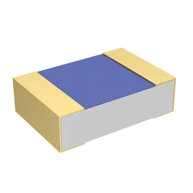

P www.vishay.com Vishay Sfernice High Precision Wraparound - Wide Ohmic Value Range Thin Film Chip Resistors, Sulfur Resistant FEATURES • Load life stability 0.02 % typical at 8000 h at 70 °C under Pd (0.033 % maximum) • Low temperature coefficient down to 5 ppm/°C Available (-55 °C; +155 °Cfie) • Very low noise < -35 dB and voltage coefficient Available < 0.01 ppm/V • Wide resistance range: 10 Ω to 86 MΩ Available depending on size • Tolerances to ± 0.01 % Available • In lot tracking ≤ 5 ppm/°C • Termination: thin film technology • Short circuits (jumpers) r < 50 mR, I < 2 A, see PZR datasheet (www.vishay.com/doc?53053) • Withstand moisture resistance test of AEC-Q200 • Sulfur resistant (per ASTM B809-95 humid vapor test) • Material categorization: for definitions of compliance please see www.vishay.com/doc?99912 LINKS TO ADDITIONAL RESOURCES 3D 3D 3D Models For low noise and precision applications, superior stability, low temperature coefficient of resistance, and low voltage coefficient, Vishay Sfernice’s proven precision thin film wraparound resistors exceed requirements of MIL-PRF-55342G characteristics Y ± 10 ppm/°C (-55 °C; +155 °C) down to ± 5 ppm/°C (-55 °C; +155 °C). Note * This datasheet provides information about parts that are RoHS-compliant and / or parts that are non RoHS-compliant. For example, parts with lead (Pb) terminations are not RoHS-compliant. Please see the information / tables in this datasheet for details STANDARD ELECTRICAL SPECIFICATIONS MODEL SIZE RESISTANCE RANGE (2) (Ω) RATED POWER W Pn (1) RATED POWER W Pd (1) LIMITING ELEMENT VOLTAGE V TOLERANCE ±% TEMPERATURE COEFFICIENT ± ppm/°C P0302 0302 10 to 420K 0.040 0.030 25 0.01, 0.02, 0.05, 0.1, 0.25, 0.5, 1, 2, 5 5, 10, 25, 50, 100 P0402 0402 10 to 1M 0.063 0.040 50 0.01, 0.02, 0.05, 0.1, 0.25, 0.5, 1, 2, 5 5, 10, 25, 50, 100 P0505 0505 10 to 4M 0.125 0.050 50 0.01, 0.02, 0.05, 0.1, 0.25, 0.5, 1, 2, 5 5, 10, 25, 50, 100 P0603 0603 10 to 3.2M 0.125 0.100 75 0.01, 0.02, 0.05, 0.1, 0.25, 0.5, 1, 2, 5 5, 10, 25, 50, 100 P0805 (3) 0805 10 to 8M 0.200 0.125 150 0.01, 0.02, 0.05, 0.1, 0.25, 0.5, 1, 2, 5 5, 10, 25, 50, 100 P1005 1005 10 to 7.5M 0.250 0.125 75 0.01, 0.02, 0.05, 0.1, 0.25, 0.5, 1, 2, 5 5, 10, 25, 50, 100 P1206 1206 10 to 22M 0.330 0.250 200 0.01, 0.02, 0.05, 0.1, 0.25, 0.5, 1, 2, 5 5, 10, 25, 50, 100 P1505 1505 10 to 13.8M 0.350 0.175 200 0.01, 0.02, 0.05, 0.1, 0.25, 0.5, 1, 2, 5 5, 10, 25, 50, 100 P2010 2010 10 to 62M 1 (4) 0.500 300 0.01, 0.02, 0.05, 0.1, 0.25, 0.5, 1, 2, 5 5, 10, 25, 50, 100 P2512 2512 10 to 86M 2 (4) 1 300 0.01, 0.02, 0.05, 0.1, 0.25, 0.5, 1, 2, 5 5, 10, 25, 50, 100 Notes (1) Pn = nominal power: Pd = derated power intended to improve stability (2) For ohmic range versus tolerance and TCR see detailed table on next page (3) Model P0805 having the same size than P0705 and the same performances, only codification of P0805 remains (4) With special assembly care CLIMATIC SPECIFICATIONS MECHANICAL SPECIFICATIONS Operating temperature range Substrate Alumina Technology Thin film -55 °C; +155 °C Note • For temperature up to 230 °C, see PHT datasheet (www.vishay.com/doc?53050) Film Protection PERFORMANCE VS. HUMID SULFUR VAPOR Test conditions Test results Revision: 18-Oct-2021 50 °C ± 2 °C, 85 % ± 4 % RH, exposure time 500 h Resistance drift < (0.05 % R + 0.05 Ω), no corrosion products observed Terminations Nickel chromium with mineral passivation or CrSi Epoxy + silicone B type: SnPb over nickel barrier for solder reflow N type: SnAg over nickel barrier G type: gold over nickel barrierfor other applications Document Number: 53017 1 For technical questions, contact: sferthinfilm@vishay.com THIS DOCUMENT IS SUBJECT TO CHANGE WITHOUT NOTICE. THE PRODUCTS DESCRIBED HEREIN AND THIS DOCUMENT ARE SUBJECT TO SPECIFIC DISCLAIMERS, SET FORTH AT www.vishay.com/doc?91000 P www.vishay.com Vishay Sfernice DIMENSIONS in millimeters (inches) A D D B C E CASE SIZE E A B MAX. TOL. +0.152 (+0.006) MIN. TOL. -0.152 (-0.006) MAX. TOL. +0.127 (+0.005) MIN. TOL. -0.127 (-0.005) NOMINAL NOMINAL D/E C NOMINAL TOLERANCE 0302 0.75 (0.029) 0.60 (0.024) 0.15 (0.006) 0.08 (0.003) 0402 1.00 (0.039) 0.60 (0.024) 0.25 (0.010) 0.1 (0.004) 0505 1.27 (0.005) 1.27 (0.050) 0603 1.52 (0.060) 0.85 (0.033) 0805 1.91 (0.075) 1.27 (0.050) 1005 2.54 (0.100) 1.27 (0.050) 1206 3.06 (0.120) 1.60 (0.063) 1505 3.81 (0.150) 1.32 (0.052) 2010 5.08 (0.200) 2.54 (0.100) 2512 6.30 (0.248) 3.30 (0.130) 0.38 (0.015) 0.5 (0.02) ± 0.127 (0.005) 0.40 (0.016) 0.13 (0.005) 0.48 (0.019) 0.48 (0.019) Note • Model P0805 having the same size than P0705 and the same performances, only codification of P0805 remains SUGGESTED LAND PATTERN (to IPC-7351A) Gmin. Xmax. Zmax. DIMENSIONS in millimeters (inches) CHIP SIZE Zmax. Gmin. Xmax. 0302 1.30 (0.051) 0.15 (0.006) 0.73 (0.029) 0402 1.55 (0.061) 0.15 (0.006) 0.73 (0.029) 0505 1.82 (0.072) 0.10 (0.004) 1.40 (0.055) 0603 2.37 (0.093) 0.35 (0.014) 0.98 (0.039) 0805 2.76 (0.109) 0.74 (0.029) 1.40 (0.055) 1005 3.39 (0.133) 1.37 (0.054) 1.40 (0.055) 1206 3.91 (0.154) 1.85 (0.073) 1.73 (0.068) 1505 4.66 (0.183) 2.44 (0.096) 1.45 (0.057) 2010 5.93 (0.233) 3.71 (0.146) 2.67 (0.105) 2512 7.15 (0.281) 4.93 (0.194) 3.43 (0.135) Revision: 18-Oct-2021 Document Number: 53017 2 For technical questions, contact: sferthinfilm@vishay.com THIS DOCUMENT IS SUBJECT TO CHANGE WITHOUT NOTICE. THE PRODUCTS DESCRIBED HEREIN AND THIS DOCUMENT ARE SUBJECT TO SPECIFIC DISCLAIMERS, SET FORTH AT www.vishay.com/doc?91000 P www.vishay.com Vishay Sfernice POWER DERATING CURVE TCR CODE FILM ± 5 ppm/°C C (-55 °C; +155 °C) NiCr ± 5 ppm/°C Z (0 °C; +70 °C) NiCr ± 10 ppm/°C Y NiCr ± 25 ppm/°C E NiCr ± 50 ppm/°C H NiCr or CrSi ± 100 ppm/°C K NiCr or CrSi Rated Power (%) TEMPERATURE COEFFICIENT 100 80 60 40 20 0 0 20 40 60 70 80 100 120 140 155 Ambient Temperature in °C BEST TOLERANCE AND TCR VS. OHMIC VALUE STYLE 0302 RANGE (Ω) TOLERANCE (± %) TCR CODE 10 to < 50 0.1; 0.25; 0.5; 1; 2; 5 C; Z; Y; E; H; K 50 to < 100 0.05; 0.1; 0.25; 0.5; 1; 2; 5 C; Z; Y; E; H; K 100 to < 250 0.02; 0.05; 0.1; 0.25; 0.5; 1; 2; 5 C; Z; Y; E; H; K 250 to 30K 0.01; 0.02; 0.05; 0.1; 0.25; 0.5; 1; 2; 5 C; Z; Y; E; H; K > 30K to 40K 0.01; 0.02; 0.05; 0.1; 0.25; 0.5; 1; 2; 5 Z; Y; E; H; K > 40K to 65K 0.05; 0.1; 0.25; 0.5; 1; 2; 5 E; H; K > 65K to 420K 0402 0505 0.1; 0.25; 0.5; 1; 2; 5 C; Z; Y; E; H; K 50 to < 100 0.05; 0.1; 0.25; 0.5; 1; 2; 5 C; Z; Y; E; H; K 100 to < 250 0.02; 0.05; 0.1; 0.25; 0.5; 1; 2; 5 C; Z; Y; E; H; K 250 to 67K 0.01; 0.02; 0.05; 0.1; 0.25; 0.5; 1; 2; 5 C; Z; Y; E; H; K > 67K to 200K 0.01; 0.02; 0.05; 0.1; 0.25; 0.5; 1; 2; 5 Z; Y; E; H; K > 200K to 341K 0.05; 0.1; 0.25; 0.5; 1; 2; 5 E; H; K > 341K to 1M 0.1; 0.25; 0.5; 1; 2; 5 (1) H; K 10 to < 50 0.1; 0.25; 0.5; 1; 2; 5 C; Z; Y; E; H; K 50 to < 100 0.05; 0.1; 0.25; 0.5; 1; 2; 5 C; Z; Y; E; H; K 100 to < 250 0.02; 0.05; 0.1; 0.25; 0.5; 1; 2; 5 C; Z; Y; E; H; K 250 to 187K 0.01; 0.02; 0.05; 0.1; 0.25; 0.5; 1; 2; 5 C; Z; Y; E; H; K > 187K to 260K 0.01; 0.02; 0.05; 0.1; 0.25; 0.5; 1; 2; 5 Z; Y; E; H; K > 260K to 400K 0.05; 0.1; 0.25; 0.5; 1; 2; 5 E; H; K 10 to < 50 0.1; 0.25; 0.5; 1; 2; 5 (1) H; K 0.1; 0.25; 0.5; 1; 2; 5 C; Z; Y; E; H; K 50 to < 100 0.05; 0.1; 0.25; 0.5; 1; 2; 5 C; Z; Y; E; H; K 100 to < 250 0.02; 0.05; 0.1; 0.25; 0.5; 1; 2; 5 C; Z; Y; E; H; K 250 to 160K 0.01; 0.02; 0.05; 0.1; 0.25; 0.5; 1; 2; 5 C; Z; Y; E; H; K > 160K to 332K 0.01; 0.02; 0.05; 0.1; 0.25; 0.5; 1; 2; 5 Z; Y; E; H; K > 332K to 500K 0.05; 0.1; 0.25; 0.5; 1; 2; 5 E; H; K > 500K to 3M2 Revision: 18-Oct-2021 H; K 10 to < 50 > 400K to 4M 0603 0.1; 0.25; 0.5; 1; 2; 5 (1) 0.1; 0.25; 0.5; 1; 2; 5 (1) H; K Document Number: 53017 3 For technical questions, contact: sferthinfilm@vishay.com THIS DOCUMENT IS SUBJECT TO CHANGE WITHOUT NOTICE. THE PRODUCTS DESCRIBED HEREIN AND THIS DOCUMENT ARE SUBJECT TO SPECIFIC DISCLAIMERS, SET FORTH AT www.vishay.com/doc?91000 P www.vishay.com Vishay Sfernice BEST TOLERANCE AND TCR VS. OHMIC VALUE STYLE 0805 1005 1206 RANGE (Ω) TOLERANCE (± %) TCR CODE 10 to < 50 0.1; 0.25; 0.5; 1; 2; 5 C; Z; Y; E; H; K 50 to < 100 0.05; 0.1; 0.25; 0.5; 1; 2; 5 C; Z; Y; E; H; K 100 to < 250 0.02; 0.05; 0.1; 0.25; 0.5; 1; 2; 5 C; Z; Y; E; H; K 250 to 360K 0.01; 0.02; 0.05; 0.1; 0.25; 0.5; 1; 2; 5 C; Z; Y; E; H; K > 360K to 511K 0.01; 0.02; 0.05; 0.1; 0.25; 0.5; 1; 2; 5 Z; Y; E; H; K > 511K to 750K 0.05; 0.1; 0.25; 0.5; 1; 2; 5 E; H; K > 750K to 8M 0.1; 0.25; 0.5; 1; 2; 5 (1) H; K 10 to < 50 0.1; 0.25; 0.5; 1; 2; 5 C; Z; Y; E; H; K 50 to < 100 0.05; 0.1; 0.25; 0.5; 1; 2; 5 C; Z; Y; E; H; K 100 to < 250 0.02; 0.05; 0.1; 0.25; 0.5; 1; 2; 5 C; Z; Y; E; H; K 250 to 400K 0.01; 0.02; 0.05; 0.1; 0.25; 0.5; 1; 2; 5 C; Z; Y; E; H; K > 400K to 550K 0.01; 0.02; 0.05; 0.1; 0.25; 0.5; 1; 2; 5 Z; Y; E; H; K > 550K to 810K 0.05; 0.1; 0.25; 0.5; 1; 2; 5 E; H; K > 810K to 7M5 0.1; 0.25; 0.5; 1; 2; 5 (1) H; K 10 to < 50 0.1; 0.25; 0.5; 1; 2; 5 C; Z; Y; E; H; K C; Z; Y; E; H; K 50 to < 100 0.05; 0.1; 0.25; 0.5; 1; 2; 5 100 to < 250 0.02; 0.05; 0.1; 0.25; 0.5; 1; 2; 5 C; Z; Y; E; H; K 250 to 1M3 0.01; 0.02; 0.05; 0.1; 0.25; 0.5; 1; 2; 5 C; Z; Y; E; H; K > 1M3 to 2M 0.01; 0.02; 0.05; 0.1; 0.25; 0.5; 1; 2; 5 Z; Y; E; H; K > 2M to 3M5 0.05; 0.1; 0.25; 0.5; 1; 2; 5 E; H; K > 3M5 to 22M 1505 2010 H; K 10 to < 50 0.1; 0.25; 0.5; 1; 2; 5 C; Z; Y; E; H; K 50 to < 100 0.05; 0.1; 0.25; 0.5; 1; 2; 5 C; Z; Y; E; H; K 100 to < 250 0.02; 0.05; 0.1; 0.25; 0.5; 1; 2; 5 C; Z; Y; E; H; K 250 to 720K 0.01; 0.02; 0.05; 0.1; 0.25; 0.5; 1; 2; 5 C; Z; Y; E; H; K > 720K to 1M 0.01; 0.02; 0.05; 0.1; 0.25; 0.5; 1; 2; 5 Z; Y; E; H; K > 1M to 1M5 0.05; 0.1; 0.25; 0.5; 1; 2; 5 E; H; K > 1M5 to 13M8 0.1; 0.25; 0.5; 1; 2; 5 (1) H; K 10 to < 50 0.1; 0.25; 0.5; 1; 2; 5 C; Z; Y; E; H; K 50 to < 100 0.05; 0.1; 0.25; 0.5; 1; 2; 5 C; Z; Y; E; H; K 100 to < 250 0.02; 0.05; 0.1; 0.25; 0.5; 1; 2; 5 C; Z; Y; E; H; K 250 to 3M8 0.01; 0.02; 0.05; 0.1; 0.25; 0.5; 1; 2; 5 C; Z; Y; E; H; K > 3M8 to 5M 0.01; 0.02; 0.05; 0.1; 0.25; 0.5; 1; 2; 5 Z; Y; E; H; K > 5M to 7M5 0.05; 0.1; 0.25; 0.5; 1; 2; 5 E; H; K > 7M5 to 62M 10 to < 50 2512 0.1; 0.25; 0.5; 1; 2; 5 (1) 0.1; 0.25; 0.5; 1; 2; 5 (1) H; K 0.1; 0.25; 0.5; 1; 2; 5 C; Z; Y; E; H; K C; Z; Y; E; H; K 50 to < 100 0.05; 0.1; 0.25; 0.5; 1; 2; 5 100 to < 250 0.02; 0.05; 0.1; 0.25; 0.5; 1; 2; 5 C; Z; Y; E; H; K 250 to 6M4 0.01; 0.02; 0.05; 0.1; 0.25; 0.5; 1; 2; 5 C; Z; Y; E; H; K > 6M4 to 8M6 0.01; 0.02; 0.05; 0.1; 0.25; 0.5; 1; 2; 5 Z; Y; E; H; K > 8M6 to 12M9 0.05; 0.1; 0.25; 0.5; 1; 2; 5 E; H; K > 12M9 to 86M 0.1; 0.25; 0.5; 1; 2; 5 (1) H; K Note (1) Tolerance 0.05 % on request Revision: 18-Oct-2021 Document Number: 53017 4 For technical questions, contact: sferthinfilm@vishay.com THIS DOCUMENT IS SUBJECT TO CHANGE WITHOUT NOTICE. THE PRODUCTS DESCRIBED HEREIN AND THIS DOCUMENT ARE SUBJECT TO SPECIFIC DISCLAIMERS, SET FORTH AT www.vishay.com/doc?91000 P www.vishay.com Vishay Sfernice POPULAR OPTIONS For any option it is recommended to consult Vishay Sfernice for availability first. Option: Enlarged Terminations For stringent and special power dissipation requirements, the thermal resistance between the resistive layer and the solder joint can be reduced using enlarged terminations chip resistors which are soldered on large and thick copper pads acting as heatsink (see application note: 53048 Power Dissipation in High Precision Vishay Sfernice Chip Resistors and Arrays (P Thin Film, PRA Arrays, CHP Thick Film) www.vishay.com/doc?53048. Option to order 0063: (applies to size 1206 / 1505 / 2010 / 2512). DIMENSIONS (Option 0063) in millimeters Bottom view for mounting Uncoatted ceramic A Enlarged termination B F D D E CASE SIZE E A B E D MAX. TOL. +0.152 MIN. TOL. -0.152 MAX. TOL. +0.127 MIN. TOL. -0.127 MAX. TOL. +0.13 MIN. TOL. -0.13 MAX. TOL. +0.13 MIN. TOL. -0.13 NOMINAL NOMINAL NOMINAL NOMINAL 1206 3.06 1.60 0.40 1.215 1505 3.81 1.32 2010 5.08 2.54 2512 6.30 3.30 1.59 0.48 2.215 F NOMINAL MIN. MAX. 0.63 0.50 0.76 2.835 SUGGESTED LAND PATTERN (Option 0063) Gmin. Xmax. Zmax. CHIP SIZE DIMENSIONS (IN MILLIMETER) Zmax. 1206 3.91 1505 4.66 2010 5.93 2512 7.15 Revision: 18-Oct-2021 Gmin. Xmax. 1.73 0.50 1.45 2.67 3.43 Document Number: 53017 5 For technical questions, contact: sferthinfilm@vishay.com THIS DOCUMENT IS SUBJECT TO CHANGE WITHOUT NOTICE. THE PRODUCTS DESCRIBED HEREIN AND THIS DOCUMENT ARE SUBJECT TO SPECIFIC DISCLAIMERS, SET FORTH AT www.vishay.com/doc?91000 P www.vishay.com Vishay Sfernice Option: Marking Option to order 0013: Marking of ohmic value and tolerance: Sizes: 0805 to 1005: 3 digits marking (according to EIA-96) Sizes: 1206 to 2512: 4 digits marking (same codification than in the ordering procedure) Tolerance indicated by a color dot. Option to order 0014: Marking of ohmic value: Sizes: 0805 to 1005: 3 digits marking (according to EIA-96) Sizes: 1206 to 2512: 4 digits marking (same codification than in the ordering procedure) No standard marking available for smaller sizes. A price adder will apply to the unit price of the parts for options 0013 and 0014. Option: AEC-Q200 For moisture resistance test only. Option to Order 0058: Specific production process to withstand 85 °C/85 % at Pn/10 PACKAGING PACKAGING RULES ESD packaging available: waffle-pack and plastic tape and reel (low conductivity). Paper tape available upon request (for sizes 0402, 0603, 0805 and 1206). Waffle Pack SIZE MOQ 0302 0402 0505 0603 0805 1005 1206 1505 2010 2512 NUMBER OF PIECES PER PACKAGE TAPE TAPE AND REEL WAFFLE PACK WIDTH 2" × 2" MIN. MAX. 250 100 340 5000 100 4000 5000 221 140 60 50 8 mm 100 4000 1000 2000 Can be filled up to maximum quantity indicated in the table here above, taking into account the minimum order quantity. When quantity ordered exceeds maximum quantity of a single waffle pack, the waffle packs are stacked up on the top of each other and closed by one single cover. To get “not stacked up” waffle pack in case of ordered quantity > maximum number of pieces per package: Please consult Vishay Sfernice for specific ordering code. Tape and Reel See Part Numbering information to get the quantity desired by tape. 12 mm PERFORMANCE TESTS Thermal shock Short time overload Low temperature operation Resistance to solder heat Moisture resistance High temperature Load life CONDITIONS MIL-PRF-55342G MIL-STD-202 F-Method 107 F MIL-PRF-55342G PARA 3.10.4.7.5 MIL-PRF-55342G PARA 3.9 and 4.7.4 MIL-PRF-55342G PARA 3.12, 4.7.7, 4.7.1.2 MIL-PRF-55342G PARA 3.13 and 4.7.8 MIL-STD-202 F-Method 106 E CECC 56 days/40 °C/93 % RH AEC-Q200 (1) 85 °C/85 % RH/Pn/10, 1000 h MIL-PRF-55342G PARA 3.11 and 4.7.6 MIL-PRF-55342G 8000 h Pn at 70 °C MIL-STD-202 F-Method 108 A MIL OR CECC REQUIREMENTS TYPICAL PERFORMANCES ± 0.05 % ± 0.02 % ± 0.05 % ± 0.01 % ± 0.05 % ± 0.01 % ± 0.05 % ± 0.03 % ± 0.10 % ± 0.01 % ± 0.10 % ± 0.01 % ± 0.5 % + 0.05 Ω Max. < 0.3 % + 0.05 Ω ± 0.05 % ± 0.05 % ± 0.5 % ± 0.1 % (2) Notes (1) Option to order 0058 (2) Typical drift ± 0.02 % at Pd Revision: 18-Oct-2021 Document Number: 53017 6 For technical questions, contact: sferthinfilm@vishay.com THIS DOCUMENT IS SUBJECT TO CHANGE WITHOUT NOTICE. THE PRODUCTS DESCRIBED HEREIN AND THIS DOCUMENT ARE SUBJECT TO SPECIFIC DISCLAIMERS, SET FORTH AT www.vishay.com/doc?91000 P www.vishay.com Vishay Sfernice Maximum permissible pulse load Pi max. for single pulse (1) Permissible Pulse Power P (W) 100 P2512 P2010 P1206 P0805 P0603 P0402 10 1 0.1 0.00001 0.0001 0.001 0.01 0.1 1 10 Pulse Duration t (s) Energy for single pulse (1) 100 Permissible Pulse Energy (J) 10 1 0.1 0.01 P2512 P2010 P1206 P0805 P0603 P0402 0.001 0.0001 0.00001 0.00001 0.0001 0.001 0.01 0.1 1 10 Pulse Duration t (s) Maximum permissible pulse voltage Ui max. for single pulse (1) Permissible Pulse Voltage (V) 10 000 P2512 P2010 P1206 P0805 P0603 P0402 1000 100 10 0.00001 0.0001 0.001 0.01 0.1 1 10 Pulse Duration t (s) Note (1) One should apply the data mentioned on the 3 curves together to get the right performances Revision: 18-Oct-2021 Document Number: 53017 7 For technical questions, contact: sferthinfilm@vishay.com THIS DOCUMENT IS SUBJECT TO CHANGE WITHOUT NOTICE. THE PRODUCTS DESCRIBED HEREIN AND THIS DOCUMENT ARE SUBJECT TO SPECIFIC DISCLAIMERS, SET FORTH AT www.vishay.com/doc?91000 P www.vishay.com Vishay Sfernice Maximum permissible pulse load Pi max. Permissible Pulse Power P (W) 100 P2512 P2010 P1206 P0805 P0603 P0402 10 1 0.1 0.00001 0.0001 0.001 0.01 0.1 1 10 Pulse Duration t (s) 1.2/50 μs lightning surge Test Voltage (V) 10 000 1000 100 P2512 P1206 P0805 P0603 10 10 100 1000 10 000 100 000 Resistor Value (Ω) 10/700 μs lightning surge Test Voltage (V) 10 000 1000 100 P2512 P2010 P1206 P0805 P0603 10 10 100 1000 10 000 100 000 Resistor Value (Ω) Revision: 18-Oct-2021 Document Number: 53017 8 For technical questions, contact: sferthinfilm@vishay.com THIS DOCUMENT IS SUBJECT TO CHANGE WITHOUT NOTICE. THE PRODUCTS DESCRIBED HEREIN AND THIS DOCUMENT ARE SUBJECT TO SPECIFIC DISCLAIMERS, SET FORTH AT www.vishay.com/doc?91000 P www.vishay.com Vishay Sfernice GLOBAL PART NUMBER INFORMATION New Global Part Numbering: P0505Y1003BBT0999 P 0 5 0 5 Y 1 0 0 3 B B T 9 9 9 GLOBAL MODEL SIZE TCR VALUE TOLERANCE TERMINATION PACKAGING OPTION P 0302 0402 0505 0603 0805 1005 1206 1505 2010 2512 K = ± 100 ppm/°C H = ± 50 ppm/°C E = ± 25 ppm/°C Y = ± 10 ppm/°C Z = ± 5 ppm (0 °C; +70 °C) C = ± 5 ppm (- 55 °C; + 155 °C) The first three digits are significant figures and the last digit specifies the number of zeros to follow, R designates decimal point L = ± 0.01 % P = ± 0.02 % W = ± 0.05 % B = ± 0.1 % C = ± 0.25 % D = ± 0.5 % F=±1% G=±2% J=±5% B: SnPb over nickel barrier N: SnAg over nickel barrier G: gold over nickel barrier For more information see “Codification of packaging” table From 1 to 3 digits, leave blank if no option 10R0 = 10 Ω 3901 = 3900 Ω 1004 = 1 MΩ B: lead bearing version N and G: lead (Pb)-free/RoHS version Historical Part Number Examples: P1206Y1001LNT100 (tapes of 100 pieces) P1206H7151FBT250 (tapes of 250 pieces) P1206Y1503WNT1K032 (tapes of 1000 pieces and option 32) P1206Y2372BG (waffle pack) Historical part numbers are not recommended, but can still be used for ordering. CODIFICATION OF PACKAGING CODE 18 PACKAGING WAFFLE PACK W 100 min., 1 mult. WA 100 min., 100 mult. (available only in size 1206) PLASTIC TAPE (in standard for all sizes) T 100 min., 1 mult. TA 100 min., 100 mult. TB 250 min., 250 mult. TC 500 min., 500 mult. TD 1000 min., 1000 mult. TE 2500 min., 2500 mult. TF Full tape (quantity depending on size of chips) PAPER TAPE (available for 0402, 0603, 0805, and 1206. Please consult Vishay Sfernice for other sizes) PT 100 min., 1 mult. PA 100 min., 100 mult. PB 250 min., 250 mult. PC 500 min., 500 mult. PD (not available for size 0402) 1000 min., 1000 mult. PE (not available for size 0402) 2500 min., 2500 mult. PF (not available for size 0402) Full tape (quantity depending on size of chips) Notes • For CECC qualified, see RV datasheet (www.vishay.com/doc?60022) • For ESCC qualified, see PHR datasheet (www.vishay.com/doc?53037) or PFRR datasheet (www.vishay.com/doc?53046) • For high temperature (230 °C), see PHT datasheet (www.vishay.com/doc?53050) • For very high temperature (270 °C), see PVHT datasheet (www.vishay.com/doc?53060) • For strap (0 Ω), see PZR datasheet (www.vishay.com/doc?53053) Revision: 18-Oct-2021 Document Number: 53017 9 For technical questions, contact: sferthinfilm@vishay.com THIS DOCUMENT IS SUBJECT TO CHANGE WITHOUT NOTICE. THE PRODUCTS DESCRIBED HEREIN AND THIS DOCUMENT ARE SUBJECT TO SPECIFIC DISCLAIMERS, SET FORTH AT www.vishay.com/doc?91000 Legal Disclaimer Notice www.vishay.com Vishay Disclaimer ALL PRODUCT, PRODUCT SPECIFICATIONS AND DATA ARE SUBJECT TO CHANGE WITHOUT NOTICE TO IMPROVE RELIABILITY, FUNCTION OR DESIGN OR OTHERWISE. Vishay Intertechnology, Inc., its affiliates, agents, and employees, and all persons acting on its or their behalf (collectively, “Vishay”), disclaim any and all liability for any errors, inaccuracies or incompleteness contained in any datasheet or in any other disclosure relating to any product. Vishay makes no warranty, representation or guarantee regarding the suitability of the products for any particular purpose or the continuing production of any product. To the maximum extent permitted by applicable law, Vishay disclaims (i) any and all liability arising out of the application or use of any product, (ii) any and all liability, including without limitation special, consequential or incidental damages, and (iii) any and all implied warranties, including warranties of fitness for particular purpose, non-infringement and merchantability. Statements regarding the suitability of products for certain types of applications are based on Vishay's knowledge of typical requirements that are often placed on Vishay products in generic applications. Such statements are not binding statements about the suitability of products for a particular application. It is the customer's responsibility to validate that a particular product with the properties described in the product specification is suitable for use in a particular application. Parameters provided in datasheets and / or specifications may vary in different applications and performance may vary over time. All operating parameters, including typical parameters, must be validated for each customer application by the customer's technical experts. Product specifications do not expand or otherwise modify Vishay's terms and conditions of purchase, including but not limited to the warranty expressed therein. Hyperlinks included in this datasheet may direct users to third-party websites. These links are provided as a convenience and for informational purposes only. Inclusion of these hyperlinks does not constitute an endorsement or an approval by Vishay of any of the products, services or opinions of the corporation, organization or individual associated with the third-party website. Vishay disclaims any and all liability and bears no responsibility for the accuracy, legality or content of the third-party website or for that of subsequent links. Except as expressly indicated in writing, Vishay products are not designed for use in medical, life-saving, or life-sustaining applications or for any other application in which the failure of the Vishay product could result in personal injury or death. Customers using or selling Vishay products not expressly indicated for use in such applications do so at their own risk. Please contact authorized Vishay personnel to obtain written terms and conditions regarding products designed for such applications. No license, express or implied, by estoppel or otherwise, to any intellectual property rights is granted by this document or by any conduct of Vishay. Product names and markings noted herein may be trademarks of their respective owners. © 2021 VISHAY INTERTECHNOLOGY, INC. ALL RIGHTS RESERVED Revision: 09-Jul-2021 1 Document Number: 91000

物料型号:Vishay Sfernice 提供的高精度环绕式薄膜芯片电阻器,具有较宽的电阻值范围和对硫的抵抗性。
器件简介:这些电阻器以其高稳定性、低温度系数、低噪声和电压系数而著称,符合MIL-PRF-55342G标准。
引脚分配:文档中没有明确提到引脚分配,但提到了不同的封装尺寸,如0302、0402、0505等。
参数特性: - 负载寿命稳定性:典型值0.02%,在70°C下8000小时 - 低温度系数:低至5 ppm/°C - 低噪声:< -35 dB,电压系数:< 0.01 ppm/V - 宽电阻范围:10 Ω至86 MΩ,取决于尺寸 - 公差:± 0.01%
功能详解: - 这些电阻器适用于低噪声和精密应用,具有出色的稳定性和低电压系数。 - 它们还通过了AEC-Q200的湿度抵抗力测试。
应用信息:适用于需要高稳定性、低温度系数和低噪声的精密应用。
封装信息:提供了不同尺寸的封装信息,包括0302、0402、0505等,以及相应的尺寸公差。
此外,文档还包含了详细的电气规格、气候规格、机械规格、尺寸信息、温度系数、功率降额曲线、标记选项、AEC-Q200测试选项、包装规则、性能测试、全球零件编号信息和包装编码等。
