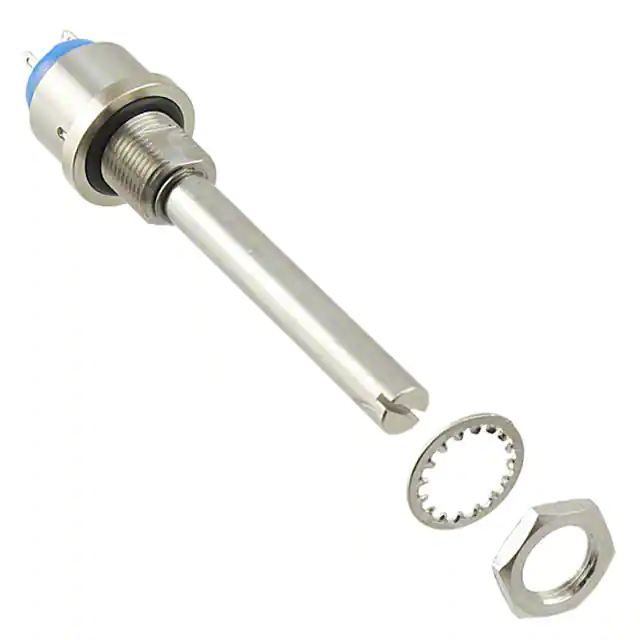

P13SM www.vishay.com Vishay Sfernice Fully Sealed Container Cermet Potentiometers Submarine Applications FEATURES • High power rating 1.5 W at 70 °C • Stainless steel shaft and bushing to endure sea salt water immersion • Fully sealed IP68 on panel • Tight temperature coefficient (± 75 ppm/°C typical) • Material categorization: for definitions of compliance please see www.vishay.com/doc?99912 P13SM is designed for applications which need to set electrical parameters with an immersed potentiometer in deep water conditions up to 30 m (100 feet). QUICK REFERENCE DATA Multiple module No Switch module n/a Detent module n/a Special electrical laws A: linear, L: logarithmic, F: reverse logarithmic Sealing level IP 68 Lifespan 25K cycles DIMENSIONS in millimeters (inches) ± 0.5 mm (± 0.02") P13SM N Thread M10 x 0.75 14.6 max. 10.3 Panel Cutout 1.6 Slot 1 x 1.8 deep 0.3 Ø6 Ø 16 Ø 14 Ø 10.5 2 5.08 6.9 ± 0.2 5.08 FG = 16 5 1.6 Ø 1.5 (1) 0.8 FL = 25 2.4 FR = 50 P13SM B 1 Panel Cutout 1/4-32 UNEF-2A 13.2 max. Ø 1.5 (1) 1.6 Slot 0.6 x 1 deep Ø 12.6 (0.5") Ø 3.17 (0.125") 9.52 5 BB = 12.7 BJ = 22.2 0.3 2 5.08 3.9 ± 0.2 5.08 Ø 6.5 1.6 0.8 2.4 Note (1) CAUTION: Ø 1.5 of panel cut out must not be fully through-hole Undergoes European Quality Insurance System Revision: 29-Jul-2021 Document Number: 51064 1 For technical questions, contact: sferpottrimmers@vishay.com THIS DOCUMENT IS SUBJECT TO CHANGE WITHOUT NOTICE. THE PRODUCTS DESCRIBED HEREIN AND THIS DOCUMENT ARE SUBJECT TO SPECIFIC DISCLAIMERS, SET FORTH AT www.vishay.com/doc?91000 P13SM www.vishay.com Vishay Sfernice ELECTRICAL SPECIFICATIONS Resistive element Cermet Electrical travel 270° ± 10° Linear taper 22 Ω to 10 MΩ Logarithmic taper 1 kΩ to 2.2 MΩ Resistance range Standard series E3 1, 2.2, 4.7, and on request 1, 2, 5 Standard ± 20 % Tolerance On request ± 10 % to ± 5 % Taper % TOTAL RESISTANCE 100 80 F 60 A L 40 20 0 0 20 40 60 80 100 % CLOCKWISE SHAFT ROTATION c a Circuit diagram (3) (1) cw b (2) 1.5 Linear 1.5 W at 70 °C Power rating Logarithmic 0.75 W at 70 °C POWER IN W LIN. TAPER A 1 LOG. TAPER L and F 0.5 0 0 20 40 60 70 80 100 120 140 AMBIENT TEMPERATURE IN °C Temperature coefficient (typical) Limiting element voltage (linear law) Contact resistance variation End resistance (typical) ± 150 ppm/°C For values ≥ 100 Ω and in temperature range +20 °C to +70 °C, the typical temperature coefficient is ± 75 ppm/°C 350 V 3 % Rn or 3 Ω 1Ω Dielectric strength (RMS) 2000 V Insulation resistance (300 VDC) 106 MΩ Independent linearity (typical) ±5% Revision: 29-Jul-2021 Document Number: 51064 2 For technical questions, contact: sferpottrimmers@vishay.com THIS DOCUMENT IS SUBJECT TO CHANGE WITHOUT NOTICE. THE PRODUCTS DESCRIBED HEREIN AND THIS DOCUMENT ARE SUBJECT TO SPECIFIC DISCLAIMERS, SET FORTH AT www.vishay.com/doc?91000 P13SM www.vishay.com Vishay Sfernice STANDARD RESISTANCE ELEMENT DATA LINEAR TAPER LOGS TAPED MAX. POWER AT 70 °C MAX. WORKING VOLTAGE MAX. CUR. THROUGH WIPER MAX. POWER AT 70 °C MAX. WORKING VOLTAGE MAX. CUR. THROUGH WIPER TYPICAL TCR -55 °C +125 °C W V mA W V mA ppm/°C 22 1.5 5.74 261 - - - 47 1.5 8.4 177 - - - 100 1.5 12.2 122 - - - 220 1.5 18.2 82.6 - - - 470 1.5 26.5 56.5 - - - STANDARD RESISTANCE VALUES Ω 1K 1.5 38.7 38.7 0.75 27 27 2.2K 1.5 57.5 26.1 0.75 40 18 4.7K 1.5 84 17.9 0.75 59 12 10K 1.5 122.5 12.2 0.75 87 8.7 22K 1.5 182 8.26 0.75 128 5.8 47K 1.5 265 5.65 0.75 187 3.9 100K 1.22 350 3.5 0.75 273 2.7 220K 0.56 350 1.6 0.56 350 1.6 470K 0.26 350 0.74 0.26 350 0.74 1M 0.12 350 0.35 0.12 350 0.35 2.2M 0.05 350 0.16 0.05 350 0.16 4.7M 0.026 350 0.074 - - - 10M 0.012 350 0.035 - - - ± 150 MECHANICAL SPECIFICATIONS Mechanical travel Style B 300° ± 5° Style N 310° ± 5° Operating torque (typical) 2 Ncm 2.85 oz. inch Style B 35 Ncm max. 3.1 lb inch max. Style N 80 Ncm max. 7.1 lb inch max. Style B 80 Ncm min., 150 Ncm max. 7 lb inch min., 13.3 lb inch max. Style N 80 Ncm min., 250 Ncm max. 7 lb inch min., 22.1 lb inch max. 8 g to 27 g 0.3 oz. to 1 oz. End stop torque Tightening torque of mounting nut Unit weight Terminals e3: pure Sn ENVIRONMENTAL SPECIFICATIONS Temperature range Climatic category Sealing Panel sealing Revision: 29-Jul-2021 -55 °C to +125 °C 55 / 125 / 56 Fully sealed - container IP68 Immersion at 30 m (100 feet) in sea salt water or clear water Document Number: 51064 3 For technical questions, contact: sferpottrimmers@vishay.com THIS DOCUMENT IS SUBJECT TO CHANGE WITHOUT NOTICE. THE PRODUCTS DESCRIBED HEREIN AND THIS DOCUMENT ARE SUBJECT TO SPECIFIC DISCLAIMERS, SET FORTH AT www.vishay.com/doc?91000 P13SM www.vishay.com Vishay Sfernice OPTIONS Special feature command shaft Length is measured from the mounting surface to the free end of the shaft. The screwdriver slot is aligned with the wiper within ± 10°. Special shafts are available, in accordance to drawings supplied by customers. We recommend that customers should not machine tool shafts, in order to avoid damage. Bending or torsion of terminals should also be avoided. MARKING Printed: • Vishay trademark • Part number (including ohmic value code, tolerance code and resistance law) • Manufacturing date • Marking of terminals a PACKAGING In box Packaging quantity depending on shafts: • Box of 5 pieces for shaft FR (code BO5) • Box of 10 pieces for shaft FG or FL (code BO10) • Box of 15 pieces for shaft BJ (code BO15) • Box of 25 pieces for shaft BB (code BO25) Hardware: nuts, washer, and O-ring are separately supplied (not mounted on the potentiometer), in a small bag placed in the packaging. PERFORMANCE TESTS CONDITIONS TYPICAL VALUES AND DRIFTS ΔRT/RT (%) ΔR1-2/R1-2 (%) OTHER 1000 h at rated power 90'/30' - ambient temperature 70 °C ±1% - Contact res. variation: < 3 % Rn Phase A dry heat 125 °C Phase B damp heat Phase C cold -55 °C Phase D damp heat 5 cycles ± 0.5 % ±1% - Damp heat, steady state 56 days 40 °C, 93 % HR ± 0.5 % ±1% Dielectric strength: 1000 V Insulation resistance: > 104 MΩ Change of temperature 5 cycles -55 °C at +125 °C ± 0.5 % - - Electrical endurance Climatic sequence Mechanical endurance Shock Vibration 25 000 cycles ±3% - Contact res. variation: < 2 % Rn 50 g’s at 11 ms 3 successive shocks in 3 directions ± 0.1 % ± 0.2 % - 10 Hz to 55 Hz 0.75 mm or 10 g’s during 6 h ± 0.1 % - ΔV1-2/V1-3 < ± 0.2 % Note • Nothing stated herein shall be construed as a guarantee of quality or durability Revision: 29-Jul-2021 Document Number: 51064 4 For technical questions, contact: sferpottrimmers@vishay.com THIS DOCUMENT IS SUBJECT TO CHANGE WITHOUT NOTICE. THE PRODUCTS DESCRIBED HEREIN AND THIS DOCUMENT ARE SUBJECT TO SPECIFIC DISCLAIMERS, SET FORTH AT www.vishay.com/doc?91000 P13SM www.vishay.com Vishay Sfernice ORDERING INFORMATION (Part Number) P 1 3 MODEL S M BUSHING P13SM Ø L N F SHAFT Ø L Shaft Ø BB 3.17 12.7 6 BJ 3.17 22.2 N 10 10.3 B 6.35 9.52 3.17 FG 6 16 FL 6 25 FR 6 50 AP Custom L S 1 0 SHAFT STYLE OHMIC VALUE S = slotted Linear law from 22 Ω to 10 MΩ On request: R = round F = flat D = custom Logarithmic law from 1 kΩ to 2.2 MΩ 3 M A E TOLERANCE TAPER SPECIAL M = 20 % A = linear L = clockwise logarithmic F = inverse clockwise logarithmic E= locating peg or special code given by Vishay On request: K = 10 % J=5% 103 = 10 kΩ PART NUMBER DESCRIPTION (for information only) P13SM N E FL MODEL BUSHING SPECIAL SHAFT S 10K 20 % A BO10 e3 SHAFT LEAD VALUE TOLERANCE TAPER SPECIAL PACKAGING SHAFT SPECIAL STYLE (Pb)-FREE RELATED DOCUMENTS APPLICATION NOTES Potentiometers and Trimmers www.vishay.com/doc?51001 Guidelines for Vishay Sfernice Resistive and Inductive Components www.vishay.com/doc?52029 Revision: 29-Jul-2021 Document Number: 51064 5 For technical questions, contact: sferpottrimmers@vishay.com THIS DOCUMENT IS SUBJECT TO CHANGE WITHOUT NOTICE. THE PRODUCTS DESCRIBED HEREIN AND THIS DOCUMENT ARE SUBJECT TO SPECIFIC DISCLAIMERS, SET FORTH AT www.vishay.com/doc?91000 Legal Disclaimer Notice www.vishay.com Vishay Disclaimer ALL PRODUCT, PRODUCT SPECIFICATIONS AND DATA ARE SUBJECT TO CHANGE WITHOUT NOTICE TO IMPROVE RELIABILITY, FUNCTION OR DESIGN OR OTHERWISE. Vishay Intertechnology, Inc., its affiliates, agents, and employees, and all persons acting on its or their behalf (collectively, “Vishay”), disclaim any and all liability for any errors, inaccuracies or incompleteness contained in any datasheet or in any other disclosure relating to any product. Vishay makes no warranty, representation or guarantee regarding the suitability of the products for any particular purpose or the continuing production of any product. To the maximum extent permitted by applicable law, Vishay disclaims (i) any and all liability arising out of the application or use of any product, (ii) any and all liability, including without limitation special, consequential or incidental damages, and (iii) any and all implied warranties, including warranties of fitness for particular purpose, non-infringement and merchantability. Statements regarding the suitability of products for certain types of applications are based on Vishay's knowledge of typical requirements that are often placed on Vishay products in generic applications. Such statements are not binding statements about the suitability of products for a particular application. It is the customer's responsibility to validate that a particular product with the properties described in the product specification is suitable for use in a particular application. Parameters provided in datasheets and / or specifications may vary in different applications and performance may vary over time. All operating parameters, including typical parameters, must be validated for each customer application by the customer's technical experts. Product specifications do not expand or otherwise modify Vishay's terms and conditions of purchase, including but not limited to the warranty expressed therein. Hyperlinks included in this datasheet may direct users to third-party websites. These links are provided as a convenience and for informational purposes only. Inclusion of these hyperlinks does not constitute an endorsement or an approval by Vishay of any of the products, services or opinions of the corporation, organization or individual associated with the third-party website. Vishay disclaims any and all liability and bears no responsibility for the accuracy, legality or content of the third-party website or for that of subsequent links. Except as expressly indicated in writing, Vishay products are not designed for use in medical, life-saving, or life-sustaining applications or for any other application in which the failure of the Vishay product could result in personal injury or death. Customers using or selling Vishay products not expressly indicated for use in such applications do so at their own risk. Please contact authorized Vishay personnel to obtain written terms and conditions regarding products designed for such applications. No license, express or implied, by estoppel or otherwise, to any intellectual property rights is granted by this document or by any conduct of Vishay. Product names and markings noted herein may be trademarks of their respective owners. © 2022 VISHAY INTERTECHNOLOGY, INC. ALL RIGHTS RESERVED Revision: 01-Jan-2022 1 Document Number: 91000
