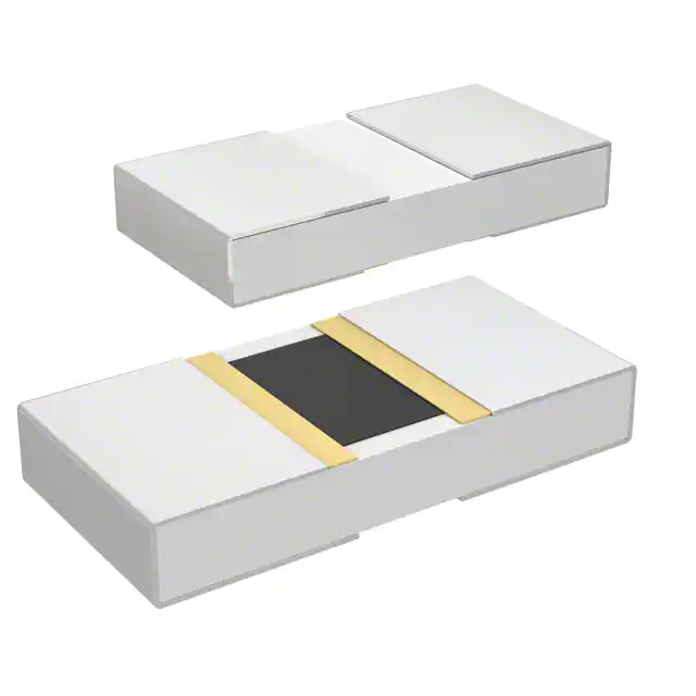

PHP www.vishay.com Vishay Dale Thin Film High Power Thin Film Wraparound Chip Resistor FEATURES • High purity ceramic substrate • Power rating to 2.5 W • Resistance range 10 Ω to 30.1 kΩ • Resistor tolerance to ± 0.1 % • TCR to ± 25 ppm/°C • Flame resistant UL 94 V-0 LINKS TO ADDITIONAL RESOURCES APPLICATIONS 3D 3D 3D Models • Power supplies • Power switching Infographics PHP series chip resistors are designed with enlarged backside terminations to reduce the thermal resistance between the topside resistor layer and the solder joint on the end users circuit board. Actual power handling capability is limited by the end user mounting process. As with any high power chip resistor the ability to remove the generated heat is critical to the overall performance of the device. • Braking system • Test and measurement equipment • Motor deflection circuits TYPICAL PERFORMANCE ABSOLUTE TCR 25 TOL. 0.1 STANDARD ELECTRICAL SPECIFICATIONS TEST SPECIFICATIONS CONDITIONS Nichrome - 10 Ω to 30.1 kΩ - 25 ppm/°C, 50 ppm/°C (standard) and, 100 ppm/°C -55 °C to +125 °C Material Resistance Range TCR: Absolute Tolerance: Absolute Power Rating: Resistor Stability: Absolute Stability: Ratio Voltage Coefficient Working Voltage 0.1 %, 0.5 %, 1.0 % and, 5.0 % +25 °C 0.375 W to 2.5 W (1) Maximum at +70 °C ΔR 0.1 % 2000 h at +70 °C Not applicable - < 0.1 ppm/V - 75 V to 200 V - Operating Temperature Range -55 °C to +155 °C - Storage Temperature Range -55 °C to +155 °C - Noise < -30 dB - Shelf Life Stability: Absolute ± 0.01 % 1 year at +25 °C COMPONENT RATINGS POWER RATING (mW) WORKING VOLTAGE (V) RESISTANCE RANGE (Ω) 0603 CASE SIZE 375 (1) 75 10 to 30.1K 0805 625 (1) 100 10 to 30.1K 1206 1000 (1) 200 10 to 30.1K 2512 2500 (1) 200 10 to 30.1K Note (1) Dependent on component mounting by user Revision: 08-Mar-2021 Document Number: 60076 1 For technical questions, contact: thinfilm@vishay.com THIS DOCUMENT IS SUBJECT TO CHANGE WITHOUT NOTICE. THE PRODUCTS DESCRIBED HEREIN AND THIS DOCUMENT ARE SUBJECT TO SPECIFIC DISCLAIMERS, SET FORTH AT www.vishay.com/doc?91000 PHP www.vishay.com Vishay Dale Thin Film ENVIRONMENTAL TESTS (Vishay Performance vs. MIL-PRF-55342 Requirements) ENVIRONMENTAL TEST LIMITS MIL-PRF-55342 CHARACTERISTIC “E” TYPICAL VISHAY PERFORMANCE ± 25 ppm/°C ± 15 ppm/°C Resistance Temperature Characteristic Maximum Ambient Temperature at Rated Wattage +70 °C +70 °C Maximum Ambient Temperature at Power Derating +150 °C +150 °C Thermal Shock ± 0.1 % ± 0.04 % Low Temperature Operation ± 0.1 % ± 0.001 % Short Time Overload ± 0.1 % ± 0.003 % High Temperature Exposure ± 0.1 % ± 0.030 % Resistance to Soldering Heat ± 0.2 % ± 0.007 % Moisture Resistance ± 0.2 % ± 0.002 % Life at +70 °C for 2000 h ± 0.5 % ± 0.100 % DIMENSIONS in inches D W T E L LENGTH WIDTH W (± 0.005) THICKNESS MIN./MAX. TOP PAD D (± 0.005) BOTTOM PAD E (± 0.005) 0603 0.064 ± 0.006 0805 0.080 ± 0.006 0.032 0.020 max. 0.012 0.021 0.050 0.015/0.033 0.016 1206 0.025 0.126 ± 0.008 0.063 0.015/0.033 0.020 + 0.005/- 0.010 2512 0.040 0.259 + 0.009/- 0.015 0.124 0.015/0.033 0.02 0.050 CASE SIZE LAND PATTERN DIMENSIONS in inches 0603 Land Pattern 1206 Land Pattern 0.0920 0.1730 0.0340 0.0710 0.0140 0.0390 0.0220 0.0755 0805 Land Pattern 2512 Land Pattern 0.2910 0.1050 0.0520 0.1260 0.0200 0.0425 0.1090 0.0910 Revision: 08-Mar-2021 Document Number: 60076 2 For technical questions, contact: thinfilm@vishay.com THIS DOCUMENT IS SUBJECT TO CHANGE WITHOUT NOTICE. THE PRODUCTS DESCRIBED HEREIN AND THIS DOCUMENT ARE SUBJECT TO SPECIFIC DISCLAIMERS, SET FORTH AT www.vishay.com/doc?91000 PHP www.vishay.com Vishay Dale Thin Film STANDARD MATERIAL SPECIFICATIONS Resistive Element Nichrome Substrate Material Alumina (Al2O3) Terminations (Tin/Lead) Tin/lead solder over nickel barrier Terminations (Lead (Pb)-free) Tin/silver/copper (Sn96.5Ag3.0Cu0.5) solder over nickel barrier 5.00 4.50 4.00 3.50 3.00 2.50 2.00 1.50 1.00 0.50 0.00 0603 - 100 Ω 0603 - 5 kΩ 0603 - 18.8 kΩ 70 PHP CHIP TEMP. VS. APPLIED POWER Applied Power (W) Applied Power (W) PHP CHIP TEMP. VS. APPLIED POWER 150 5.00 4.50 4.00 3.50 3.00 2.50 2.00 1.50 1.00 0.50 0.00 200 70 Chip Surface Temperature (°C) Note • Chip surface temperature measured using FLIR SC645 thermal imaging system with an approximate test card surface temperature of 85 °C 5.00 4.50 4.00 3.50 3.00 2.50 2.00 1.50 1.00 0.50 0.00 1206 - 100 Ω 1206 - 5 kΩ 1206 - 10 kΩ 70 150 Revision: 08-Mar-2021 200 Note • Chip surface temperature measured using FLIR SC645 thermal imaging system with an approximate test card surface temperature of 85 °C PHP CHIP TEMP. VS. APPLIED POWER 10.00 9.00 8.00 7.00 6.00 5.00 4.00 3.00 2.00 1.00 0.00 2512 - 10 Ω 2512 - 10 kΩ 2512 - 30 kΩ 70 200 Chip Surface Temperature (°C) Notes • Chip surface temperature measured using FLIR A40 thermal imaging system with an approximate test card surface temperature of 25 °C • Thermal imaging was conducted under ambient conditions resulting in a steady state test card surface temperature of 85 °C over the full range of power levels • Thermal imaging and load life testing was conducted mounting one device to 2" x 3" test cards with 2.5 mil copper plating on both surfaces. Thermal vias on 120 mil centers were utilized for heat transfer between surfaces of the test card 150 Chip Surface Temperature (°C) Applied Power (W) Applied Power (W) PHP CHIP TEMP. VS. APPLIED POWER 0805 - 100 Ω 0805 - 5 kΩ 0805 - 20 kΩ 150 200 Chip Surface Temperature (°C) Notes • Chip surface temperature measured using FLIR A40 thermal imaging system with an approximate test card surface temperature of 25 °C Case Size Resistance Value Temperature 2512 2512 2512 Up to 10 Ω Up to 10 kΩ Up to 30 kΩ 70 2.44 1.81 1.87 150 6.82 4.89 5.19 200 9.33 6.63 7.09 Power (W) Document Number: 60076 3 For technical questions, contact: thinfilm@vishay.com THIS DOCUMENT IS SUBJECT TO CHANGE WITHOUT NOTICE. THE PRODUCTS DESCRIBED HEREIN AND THIS DOCUMENT ARE SUBJECT TO SPECIFIC DISCLAIMERS, SET FORTH AT www.vishay.com/doc?91000 PHP www.vishay.com Vishay Dale Thin Film SINGLE PULSE CURVES Pulse Power (W) 1000 100 Ω - 2512 100 Ω - 1206 100 10 100 Ω - 0805 100 Ω - 0603 1 0.1 0.00001 0.0001 0.001 0.01 0.1 1 10 Pulse Duration (s) DERATING CURVE Percent of Rated Power 100 80 60 40 20 0 0 70 125 155 Ambient Temperature °C GLOBAL PART NUMBER INFORMATION P H P GLOBAL MODEL SUBSTRATE PHP 0 = alumina 0 CASE SIZE 0603 0805 1206 2512 1 2 0 6 1 TCR RESISTANCE TOLERANCE E= ± 25 ppm/°C H= ± 50 ppm/°C K= ± 100 ppm/°C The first 3 digits are significant figures and the last digit specifies the number of zeros to follow. “R” designates the decimal point. B = ± 0.1 % D = ± 0.5 % F = ± 1.0 % G = ± 2.0 % J = ± 5.0 % Example: 10R0 = 10 Ω 1000 = 100 Ω 1001 = 1 kΩ Revision: 08-Mar-2021 E 0 0 2 B TERMINATION B = wraparound Sn/Pb solder w/nickel barrier S = wraparound lead (Pb)-free solder SAC-305 RoHS-compliant - e1 B T 1 PACKAGING BS = BULK 100 min., 1 mult. WS = WAFFLE 100 min., 1 mult. WI = WAFFLE (item single lot day code) 100 min., 1 mult. TAPE AND REEL T1 = 1000 min., 1000 mult. T3 = 300 min., 300 mult. T5 = 500 min., 500 mult. TF = full reel TS = 100 min., 1 mult. TI = 100 min., 1 mult. (item single lot date code) TP = 100 min., 1 mult. (package unit single lot date) Document Number: 60076 4 For technical questions, contact: thinfilm@vishay.com THIS DOCUMENT IS SUBJECT TO CHANGE WITHOUT NOTICE. THE PRODUCTS DESCRIBED HEREIN AND THIS DOCUMENT ARE SUBJECT TO SPECIFIC DISCLAIMERS, SET FORTH AT www.vishay.com/doc?91000 Legal Disclaimer Notice www.vishay.com Vishay Disclaimer ALL PRODUCT, PRODUCT SPECIFICATIONS AND DATA ARE SUBJECT TO CHANGE WITHOUT NOTICE TO IMPROVE RELIABILITY, FUNCTION OR DESIGN OR OTHERWISE. Vishay Intertechnology, Inc., its affiliates, agents, and employees, and all persons acting on its or their behalf (collectively, “Vishay”), disclaim any and all liability for any errors, inaccuracies or incompleteness contained in any datasheet or in any other disclosure relating to any product. Vishay makes no warranty, representation or guarantee regarding the suitability of the products for any particular purpose or the continuing production of any product. To the maximum extent permitted by applicable law, Vishay disclaims (i) any and all liability arising out of the application or use of any product, (ii) any and all liability, including without limitation special, consequential or incidental damages, and (iii) any and all implied warranties, including warranties of fitness for particular purpose, non-infringement and merchantability. Statements regarding the suitability of products for certain types of applications are based on Vishay's knowledge of typical requirements that are often placed on Vishay products in generic applications. Such statements are not binding statements about the suitability of products for a particular application. It is the customer's responsibility to validate that a particular product with the properties described in the product specification is suitable for use in a particular application. Parameters provided in datasheets and / or specifications may vary in different applications and performance may vary over time. All operating parameters, including typical parameters, must be validated for each customer application by the customer's technical experts. Product specifications do not expand or otherwise modify Vishay's terms and conditions of purchase, including but not limited to the warranty expressed therein. Hyperlinks included in this datasheet may direct users to third-party websites. These links are provided as a convenience and for informational purposes only. Inclusion of these hyperlinks does not constitute an endorsement or an approval by Vishay of any of the products, services or opinions of the corporation, organization or individual associated with the third-party website. Vishay disclaims any and all liability and bears no responsibility for the accuracy, legality or content of the third-party website or for that of subsequent links. Except as expressly indicated in writing, Vishay products are not designed for use in medical, life-saving, or life-sustaining applications or for any other application in which the failure of the Vishay product could result in personal injury or death. Customers using or selling Vishay products not expressly indicated for use in such applications do so at their own risk. Please contact authorized Vishay personnel to obtain written terms and conditions regarding products designed for such applications. No license, express or implied, by estoppel or otherwise, to any intellectual property rights is granted by this document or by any conduct of Vishay. Product names and markings noted herein may be trademarks of their respective owners. © 2021 VISHAY INTERTECHNOLOGY, INC. ALL RIGHTS RESERVED Revision: 09-Jul-2021 1 Document Number: 91000

物料型号: PHP系列
器件简介: - 采用高纯度陶瓷基板 - 功率等级高达2.5W - 电阻范围从10Ω至30.1kΩ - 电阻公差达到±0.1% - 温度系数(TCR)为±25ppm/°C - 符合UL 94 V-0阻燃标准
引脚分配: - 引脚分配图未在文档中明确展示,但通常这类电阻为表面贴装元件,具有标准的焊盘布局。
参数特性: - 材料:NICHROME - 电阻范围:10Ω至30.1kΩ - TCR:标准为±50ppm/°C,也有±25ppm/°C和±100ppm/°C选项 - 公差:绝对值0.1%、0.5%、1.0%和5.0% - 功率等级:从0.375W至2.5W(取决于用户安装方式) - 工作电压:75V至200V - 工作温度范围:-55°C至+155°C - 存储温度范围:-55°C至+155°C - 噪音:<-30dB - 货架寿命稳定性:±0.01%(1年在+25°C)
功能详解: - 该系列芯片电阻设计有扩大的背面终止,以减少顶部电阻层与用户电路板上焊点之间的热阻。 - 实际功率处理能力受用户安装过程的限制,对于任何高功率芯片电阻来说,散热能力对设备的整体性能至关重要。
应用信息: - 适用于电源、功率开关、制动系统、测试和测量设备、电机偏转电路等。
封装信息: - 提供0603、0805、1206、2512等尺寸。 - 每种尺寸的功率等级、工作电压和电阻范围有所不同。
环境测试: - 与MIL-PRF-55342要求相比,Vishay的性能在多个环境测试中表现更佳。
尺寸信息: - 提供了详细的尺寸图表,包括长度、宽度、厚度、焊盘尺寸等。
材料规格: - 电阻元件材料为NICHROME,基板材料为氧化铝(Al2O3),端子材料包括含铅和无铅选项。
