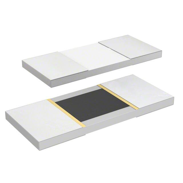

PHP www.vishay.com Vishay Dale Thin Film High Power Thin Film Wraparound Chip Resistor FEATURES • High purity ceramic substrate • Power rating to 2.5 W • Resistance range 10 Ω to 30.1 kΩ • Resistor tolerance to ± 0.1 % • TCR to ± 25 ppm/°C • Flame resistant UL 94 V-0 LINKS TO ADDITIONAL RESOURCES APPLICATIONS 3D 3D 3D Models • Power supplies • Power switching Infographics PHP series chip resistors are designed with enlarged backside terminations to reduce the thermal resistance between the topside resistor layer and the solder joint on the end users circuit board. Actual power handling capability is limited by the end user mounting process. As with any high power chip resistor the ability to remove the generated heat is critical to the overall performance of the device. • Braking system • Test and measurement equipment • Motor deflection circuits TYPICAL PERFORMANCE ABSOLUTE TCR 25 TOL. 0.1 STANDARD ELECTRICAL SPECIFICATIONS TEST SPECIFICATIONS CONDITIONS Nichrome - 10 Ω to 30.1 kΩ - 25 ppm/°C, 50 ppm/°C (standard) and, 100 ppm/°C -55 °C to +125 °C Material Resistance Range TCR: Absolute Tolerance: Absolute Power Rating: Resistor Stability: Absolute Stability: Ratio Voltage Coefficient Working Voltage 0.1 %, 0.5 %, 1.0 % and, 5.0 % +25 °C 0.375 W to 2.5 W (1) Maximum at +70 °C ΔR 0.1 % 2000 h at +70 °C Not applicable - < 0.1 ppm/V - 75 V to 200 V - Operating Temperature Range -55 °C to +155 °C - Storage Temperature Range -55 °C to +155 °C - Noise < -30 dB - Shelf Life Stability: Absolute ± 0.01 % 1 year at +25 °C COMPONENT RATINGS POWER RATING (mW) WORKING VOLTAGE (V) RESISTANCE RANGE (Ω) 0603 CASE SIZE 375 (1) 75 10 to 30.1K 0805 625 (1) 100 10 to 30.1K 1206 1000 (1) 200 10 to 30.1K 2512 2500 (1) 200 10 to 30.1K Note (1) Dependent on component mounting by user Revision: 08-Mar-2021 Document Number: 60076 1 For technical questions, contact: thinfilm@vishay.com THIS DOCUMENT IS SUBJECT TO CHANGE WITHOUT NOTICE. THE PRODUCTS DESCRIBED HEREIN AND THIS DOCUMENT ARE SUBJECT TO SPECIFIC DISCLAIMERS, SET FORTH AT www.vishay.com/doc?91000 PHP www.vishay.com Vishay Dale Thin Film ENVIRONMENTAL TESTS (Vishay Performance vs. MIL-PRF-55342 Requirements) ENVIRONMENTAL TEST LIMITS MIL-PRF-55342 CHARACTERISTIC “E” TYPICAL VISHAY PERFORMANCE ± 25 ppm/°C ± 15 ppm/°C Resistance Temperature Characteristic Maximum Ambient Temperature at Rated Wattage +70 °C +70 °C Maximum Ambient Temperature at Power Derating +150 °C +150 °C Thermal Shock ± 0.1 % ± 0.04 % Low Temperature Operation ± 0.1 % ± 0.001 % Short Time Overload ± 0.1 % ± 0.003 % High Temperature Exposure ± 0.1 % ± 0.030 % Resistance to Soldering Heat ± 0.2 % ± 0.007 % Moisture Resistance ± 0.2 % ± 0.002 % Life at +70 °C for 2000 h ± 0.5 % ± 0.100 % DIMENSIONS in inches D W T E L LENGTH WIDTH W (± 0.005) THICKNESS MIN./MAX. TOP PAD D (± 0.005) BOTTOM PAD E (± 0.005) 0603 0.064 ± 0.006 0805 0.080 ± 0.006 0.032 0.020 max. 0.012 0.021 0.050 0.015/0.033 0.016 1206 0.025 0.126 ± 0.008 0.063 0.015/0.033 0.020 + 0.005/- 0.010 2512 0.040 0.259 + 0.009/- 0.015 0.124 0.015/0.033 0.02 0.050 CASE SIZE LAND PATTERN DIMENSIONS in inches 0603 Land Pattern 1206 Land Pattern 0.0920 0.1730 0.0340 0.0710 0.0140 0.0390 0.0220 0.0755 0805 Land Pattern 2512 Land Pattern 0.2910 0.1050 0.0520 0.1260 0.0200 0.0425 0.1090 0.0910 Revision: 08-Mar-2021 Document Number: 60076 2 For technical questions, contact: thinfilm@vishay.com THIS DOCUMENT IS SUBJECT TO CHANGE WITHOUT NOTICE. THE PRODUCTS DESCRIBED HEREIN AND THIS DOCUMENT ARE SUBJECT TO SPECIFIC DISCLAIMERS, SET FORTH AT www.vishay.com/doc?91000 PHP www.vishay.com Vishay Dale Thin Film STANDARD MATERIAL SPECIFICATIONS Resistive Element Nichrome Substrate Material Alumina (Al2O3) Terminations (Tin/Lead) Tin/lead solder over nickel barrier Terminations (Lead (Pb)-free) Tin/silver/copper (Sn96.5Ag3.0Cu0.5) solder over nickel barrier 5.00 4.50 4.00 3.50 3.00 2.50 2.00 1.50 1.00 0.50 0.00 0603 - 100 Ω 0603 - 5 kΩ 0603 - 18.8 kΩ 70 PHP CHIP TEMP. VS. APPLIED POWER Applied Power (W) Applied Power (W) PHP CHIP TEMP. VS. APPLIED POWER 150 5.00 4.50 4.00 3.50 3.00 2.50 2.00 1.50 1.00 0.50 0.00 200 70 Chip Surface Temperature (°C) Note • Chip surface temperature measured using FLIR SC645 thermal imaging system with an approximate test card surface temperature of 85 °C 5.00 4.50 4.00 3.50 3.00 2.50 2.00 1.50 1.00 0.50 0.00 1206 - 100 Ω 1206 - 5 kΩ 1206 - 10 kΩ 70 150 Revision: 08-Mar-2021 200 Note • Chip surface temperature measured using FLIR SC645 thermal imaging system with an approximate test card surface temperature of 85 °C PHP CHIP TEMP. VS. APPLIED POWER 10.00 9.00 8.00 7.00 6.00 5.00 4.00 3.00 2.00 1.00 0.00 2512 - 10 Ω 2512 - 10 kΩ 2512 - 30 kΩ 70 200 Chip Surface Temperature (°C) Notes • Chip surface temperature measured using FLIR A40 thermal imaging system with an approximate test card surface temperature of 25 °C • Thermal imaging was conducted under ambient conditions resulting in a steady state test card surface temperature of 85 °C over the full range of power levels • Thermal imaging and load life testing was conducted mounting one device to 2" x 3" test cards with 2.5 mil copper plating on both surfaces. Thermal vias on 120 mil centers were utilized for heat transfer between surfaces of the test card 150 Chip Surface Temperature (°C) Applied Power (W) Applied Power (W) PHP CHIP TEMP. VS. APPLIED POWER 0805 - 100 Ω 0805 - 5 kΩ 0805 - 20 kΩ 150 200 Chip Surface Temperature (°C) Notes • Chip surface temperature measured using FLIR A40 thermal imaging system with an approximate test card surface temperature of 25 °C Case Size Resistance Value Temperature 2512 2512 2512 Up to 10 Ω Up to 10 kΩ Up to 30 kΩ 70 2.44 1.81 1.87 150 6.82 4.89 5.19 200 9.33 6.63 7.09 Power (W) Document Number: 60076 3 For technical questions, contact: thinfilm@vishay.com THIS DOCUMENT IS SUBJECT TO CHANGE WITHOUT NOTICE. THE PRODUCTS DESCRIBED HEREIN AND THIS DOCUMENT ARE SUBJECT TO SPECIFIC DISCLAIMERS, SET FORTH AT www.vishay.com/doc?91000 PHP www.vishay.com Vishay Dale Thin Film SINGLE PULSE CURVES Pulse Power (W) 1000 100 Ω - 2512 100 Ω - 1206 100 10 100 Ω - 0805 100 Ω - 0603 1 0.1 0.00001 0.0001 0.001 0.01 0.1 1 10 Pulse Duration (s) DERATING CURVE Percent of Rated Power 100 80 60 40 20 0 0 70 125 155 Ambient Temperature °C GLOBAL PART NUMBER INFORMATION P H P GLOBAL MODEL SUBSTRATE PHP 0 = alumina 0 CASE SIZE 0603 0805 1206 2512 1 2 0 6 1 TCR RESISTANCE TOLERANCE E= ± 25 ppm/°C H= ± 50 ppm/°C K= ± 100 ppm/°C The first 3 digits are significant figures and the last digit specifies the number of zeros to follow. “R” designates the decimal point. B = ± 0.1 % D = ± 0.5 % F = ± 1.0 % G = ± 2.0 % J = ± 5.0 % Example: 10R0 = 10 Ω 1000 = 100 Ω 1001 = 1 kΩ Revision: 08-Mar-2021 E 0 0 2 B TERMINATION B = wraparound Sn/Pb solder w/nickel barrier S = wraparound lead (Pb)-free solder SAC-305 RoHS-compliant - e1 B T 1 PACKAGING BS = BULK 100 min., 1 mult. WS = WAFFLE 100 min., 1 mult. WI = WAFFLE (item single lot day code) 100 min., 1 mult. TAPE AND REEL T1 = 1000 min., 1000 mult. T3 = 300 min., 300 mult. T5 = 500 min., 500 mult. TF = full reel TS = 100 min., 1 mult. TI = 100 min., 1 mult. (item single lot date code) TP = 100 min., 1 mult. (package unit single lot date) Document Number: 60076 4 For technical questions, contact: thinfilm@vishay.com THIS DOCUMENT IS SUBJECT TO CHANGE WITHOUT NOTICE. THE PRODUCTS DESCRIBED HEREIN AND THIS DOCUMENT ARE SUBJECT TO SPECIFIC DISCLAIMERS, SET FORTH AT www.vishay.com/doc?91000 Legal Disclaimer Notice www.vishay.com Vishay Disclaimer ALL PRODUCT, PRODUCT SPECIFICATIONS AND DATA ARE SUBJECT TO CHANGE WITHOUT NOTICE TO IMPROVE RELIABILITY, FUNCTION OR DESIGN OR OTHERWISE. Vishay Intertechnology, Inc., its affiliates, agents, and employees, and all persons acting on its or their behalf (collectively, “Vishay”), disclaim any and all liability for any errors, inaccuracies or incompleteness contained in any datasheet or in any other disclosure relating to any product. Vishay makes no warranty, representation or guarantee regarding the suitability of the products for any particular purpose or the continuing production of any product. To the maximum extent permitted by applicable law, Vishay disclaims (i) any and all liability arising out of the application or use of any product, (ii) any and all liability, including without limitation special, consequential or incidental damages, and (iii) any and all implied warranties, including warranties of fitness for particular purpose, non-infringement and merchantability. Statements regarding the suitability of products for certain types of applications are based on Vishay's knowledge of typical requirements that are often placed on Vishay products in generic applications. Such statements are not binding statements about the suitability of products for a particular application. It is the customer's responsibility to validate that a particular product with the properties described in the product specification is suitable for use in a particular application. Parameters provided in datasheets and / or specifications may vary in different applications and performance may vary over time. All operating parameters, including typical parameters, must be validated for each customer application by the customer's technical experts. Product specifications do not expand or otherwise modify Vishay's terms and conditions of purchase, including but not limited to the warranty expressed therein. Hyperlinks included in this datasheet may direct users to third-party websites. These links are provided as a convenience and for informational purposes only. Inclusion of these hyperlinks does not constitute an endorsement or an approval by Vishay of any of the products, services or opinions of the corporation, organization or individual associated with the third-party website. Vishay disclaims any and all liability and bears no responsibility for the accuracy, legality or content of the third-party website or for that of subsequent links. Except as expressly indicated in writing, Vishay products are not designed for use in medical, life-saving, or life-sustaining applications or for any other application in which the failure of the Vishay product could result in personal injury or death. Customers using or selling Vishay products not expressly indicated for use in such applications do so at their own risk. Please contact authorized Vishay personnel to obtain written terms and conditions regarding products designed for such applications. No license, express or implied, by estoppel or otherwise, to any intellectual property rights is granted by this document or by any conduct of Vishay. Product names and markings noted herein may be trademarks of their respective owners. © 2021 VISHAY INTERTECHNOLOGY, INC. ALL RIGHTS RESERVED Revision: 09-Jul-2021 1 Document Number: 91000

物料型号:PHP系列
器件简介:PHP系列芯片电阻器采用高纯度陶瓷基板,功率等级高达2.5W,电阻范围从10Ω至30.1kΩ,电阻公差为±0.1%,温度系数(TCR)为±25ppm/°C,并且具有UL94 V-0的阻燃等级。
引脚分配:PHP系列芯片电阻器设计有扩大的背面终止,以减少顶层电阻层与用户电路板上焊点之间的热阻。
参数特性: - 材料:镍铬合金 - 电阻范围:10Ω至30.1kΩ - TCR:绝对值为25ppm/°C,标准为50ppm/°C,还有100ppm/°C的选项 - 公差:绝对值为0.1%,0.5%,1.0%和5.0% - 功率等级:从0.375W至2.5W(取决于用户安装组件) - 工作电压:75V至200V - 工作温度范围:-55°C至+155°C - 存储温度范围:-55°C至+155°C - 噪音:<-30dB - 货架寿命稳定性:±0.01%,1年在+25°C
功能详解:PHP系列芯片电阻器适用于电源、功率开关、制动系统、测试和测量设备以及电机偏转电路等应用。
应用信息:实际的功率处理能力受到用户安装过程的限制。对于任何高功率芯片电阻器来说,散热能力对于设备的整体性能至关重要。
封装信息:提供了0603、0805、1206和2512等不同尺寸的封装,每种封装都有对应的功率等级、工作电压和电阻范围。
环境测试:展示了Vishay性能与MIL-PRF-55342要求的对比,包括电阻温度特性、最大环境温度、热冲击、低温运行、短时间过载、高温暴露、耐焊热性、耐湿性和在+70°C下2000小时的寿命。
尺寸信息:提供了0603、0805、1206和2512封装的详细尺寸,包括长度、宽度、厚度、顶垫和底垫的尺寸。
材料规格:电阻元件为镍铬合金,基板材料为氧化铝,端子材料包括锡/铅和无铅锡银铜焊料。
温度与功率曲线:提供了不同尺寸和电阻值的芯片在不同功率下的表面温度与功率的关系图。
全球零件编号信息:提供了零件编号的构成规则,包括材料、基板、封装尺寸、TCR、电阻公差、端子和包装方式。
