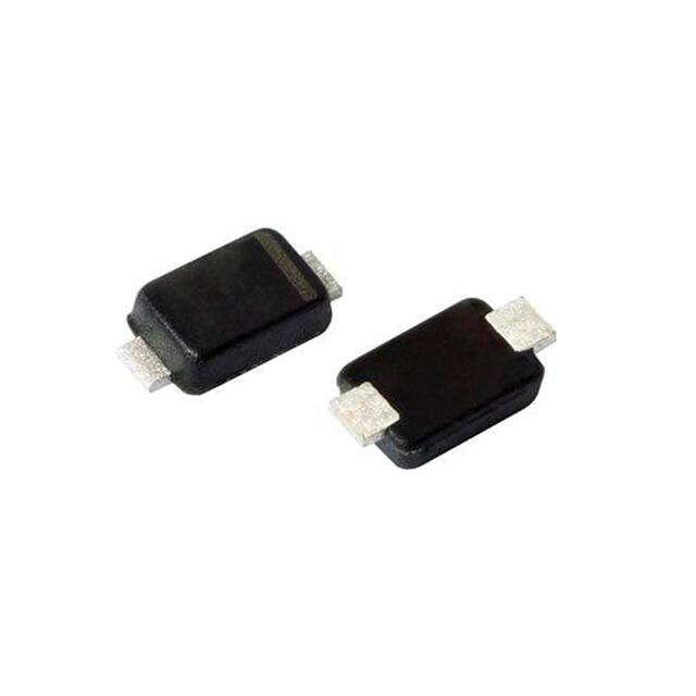

PLZ Series www.vishay.com Vishay Semiconductors Zener Diodes Permitting 500 mW Power Dissipation FEATURES eSMP® Series • • • • • 2 1 20278 • LINKS TO ADDITIONAL RESOURCES 3D 3D 3D Models Models • • Related Documents PRIMARY CHARACTERISTICS PARAMETER VZ range nom. Test current IZT VZ specification Circuit configuration VALUE 2.0 to 39 5 to 20 Pulse current Single • • • • UNIT V mA Available Sillicon planar Zener diodes, ultra small Low profile MicroSMF (DO-219AC) package Low leakage current Excellent stability High temperature soldering: 260 °C / 10 s at terminals Wave and reflow solderable (reflow as per JPC / JEDEC® J-STD 020) (double wave as per IEC 61760-1) AEC-Q101 qualified available Base P/N-G3 - RoHS-compliant, green, industrial grade Base P/N-HG3 - RoHS-compliant, green, AEC-Q101 qualified ESD immunity acc. IEC 61000-4-2 acc. to part table Surge performance acc. to part table Material categorization: for definitions of compliance please see www.vishay.com/doc?99912 ORDERING INFORMATION DEVICE NAME ORDERING CODE PLZ-Series Part number-G3/H PLZ-Series Part number-HG3_A/H TAPED UNITS PER REEL MINIMUM ORDER QUANTITY 4500 per 7" reel (8 mm tape) 22 500 / box PACKAGE PACKAGE NAME MicroSMF (DO-219AC) WEIGHT MOLDING COMPOUND FLAMMABILITY RATING MOISTURE SENSITIVITY LEVEL SOLDERING CONDITIONS 4.8 mg UL 94 V-0 MSL level 1 (according J-STD-020) 260 °C / 10 s at terminals ABSOLUTE MAXIMUM RATINGS (Tamb = 25 °C, unless otherwise specified) PARAMETER TEST CONDITION SYMBOL VALUE Power dissipation Mounted on FR4 board 50 mm x 50 mm x 1.6 mm, solder land 10 mm x 10 mm, Tamb = 85 °C Ptot 500 Power dissipation Mounted on FR4 board 50 mm x 50 mm x 1.6 mm, solder land 10 mm x 10 mm, Tamb = 25 °C Ptot 960 Power dissipation Mounted on FR4 board with recommended soldering footpads (reflow) Ptot 340 tp = 8/20 μs acc. IEC 61000-4-5 (PLZ5V1A to PLZ39D) PZSM 100 W tp = 8/20 μs acc. IEC 61000-4-5 (PLZ2V7A to PLZ4V7C) PZSM 70 W Z-current IZ Ptot/VZ mA Junction temperature Tj 150 Tstg -55 to +150 TEST CONDITION SYMBOL VALUE UNIT Mounted on FR4 board 50 mm x 50 mm x 1.6 mm, solder land 10 mm x 10 mm RthJA 130 K/W RthJL 40 K/W TYP. MAX. UNIT 0.8 0.9 V Non-repetitive peak surge power dissipation Storage temperature range UNIT mW °C THERMAL CHARACTERISTICS (Tamb = 25 °C, unless otherwise specified) PARAMETER Typ. thermal resistance junction to ambient air Typ. thermal resistance junction to lead ELECTRICAL SPECIFICATIONS (Tamb = 25 °C, unless otherwise specified) PARAMETER Forward Voltage TEST CONDITION SYMBOL IF = 10 mA VF MIN. Rev. 1.7, 27-May-2020 Document Number: 84830 1 For technical questions within your region: DiodesAmericas@vishay.com, DiodesAsia@vishay.com, DiodesEurope@vishay.com THIS DOCUMENT IS SUBJECT TO CHANGE WITHOUT NOTICE. THE PRODUCTS DESCRIBED HEREIN AND THIS DOCUMENT ARE SUBJECT TO SPECIFIC DISCLAIMERS, SET FORTH AT www.vishay.com/doc?91000 PLZ Series www.vishay.com Vishay Semiconductors ELECTRICAL CHARACTERISTICS (Tamb = 25 °C, unless otherwise specified) PART NUMBER MARKING CODE ZENER VOLTAGE RANGE (1) TEST CURRENT VZ at IZT IZT1 V mA MIN. MAX. PLZ2V0A 2A0 1.88 2.10 PLZ2V0B 2B0 2.02 2.20 PLZ2V2A 2A2 2.12 2.30 PLZ2V2B 2B2 2.22 2.41 PLZ2V4A 2A4 2.33 2.52 PLZ2V4B 2B4 2.43 2.63 PLZ2V7A 2A7 2.54 2.75 PLZ2V7B 2B7 2.69 2.91 PLZ3V0A 3A0 2.85 3.07 PLZ3V0B 3B0 3.01 3.22 PLZ3V3A 3A3 3.16 3.38 PLZ3V3B 3B3 3.32 3.53 PLZ3V6A 3A6 3.455 3.695 PLZ3V6B 3B6 3.60 3.845 PLZ3V9A 3A9 3.74 4.10 PLZ3V9B 3B9 3.89 4.16 PLZ4V3A 4A3 4.04 4.29 PLZ4V3B 4B3 4.17 4.43 PLZ4V3C 4C3 4.30 4.57 PLZ4V7A 4A7 4.44 4.68 PLZ4V7B 4B7 4.55 4.80 PLZ4V7C 4C7 4.68 4.93 PLZ5V1A 5A1 4.81 5.07 PLZ5V1B 5B1 4.94 5.20 PLZ5V1C 5C1 5.09 5.37 PLZ5V6A 5A6 5.28 5.55 PLZ5V6B 5B6 5.45 5.73 PLZ5V6C 5C6 5.61 5.91 PLZ6V2A 6A2 5.78 6.09 PLZ6V2B 6B2 5.96 6.27 PLZ6V2C 6C2 6.12 6.44 PLZ6V8A 6A8 6.29 6.63 PLZ6V8B 6B8 6.49 6.83 PLZ6V8C 6C8 6.66 7.01 PLZ7V5A 7A5 6.85 7.22 PLZ7V5B 7B5 7.07 7.45 PLZ7V5C 7C5 7.29 7.67 PLZ8V2A 8A2 7.53 7.92 PLZ8V2B 8B2 7.78 8.19 PLZ8V2C 8C2 8.03 8.45 PLZ9V1A 9A1 8.29 8.73 PLZ9V1B 9B1 8.57 9.01 PLZ9V1C 9C1 8.83 9.30 Notes (1) Pulse test: t  40 ms p (2) Pulse test: t = 8/20 μs acc. IEC 61000-4-5 p (3) Contact and air discharge acc. IEC 61000-4-2 REVERSE CURRENT DYNAMIC RESISTANCE PEAK PULSE CURRENT (2) REVERSE CLAMPING VOLTAGE AT IPPM ESD IMMUNITY (3) IR at VR ZZ at IZT IPPM VC VESD  A V kV MAX. MAX. 5.56 5.56 5.67 5.67 5.79 5.79 5.91 5.98 6.02 6.18 6.22 6.29 6.40 6.47 6.54 6.60 6.66 6.73 6.80 6.93 7.06 7.40 8.14 8.23 8.40 8.61 8.82 8.99 9.32 9.45 9.66 10.29 10.50 10.60 11.06 11.34 11.54 11.80 12.00 12.60 12.86 13.17 13.55 20 20 20 20  30  30  30  30  30  30  30  30  30  30  30  30  30  30  30  30  30  30  30  30  30  30  30  30  30  30  30  30  30  30  30  30  30  30  30  30  30  30  30 μA V MAX. 20 20 20 20 20 20 20 20 20 20 20 20 20 20 20 20 20 20 20 20 20 20 20 20 20 20 20 20 20 20 20 20 20 20 20 20 20 20 20 20 20 20 20 MAX. 120 0.5 140 120 0.7 120 120 1.0 100 100 1.0 100 20 1.0 80 10 1.0 70 5 1.0 60 5 1.0 50 5 1.0 40 5 1.0 25 5 1.5 20 5 2.5 13 5 3.0 10 2 3.5 8 0.5 4.0 8 0.5 5.0 8 0.5 6.0 8 9.9 9.9 9.7 9.7 9.5 9.5 11.8 11.7 11.6 11.3 11.2 11.1 10.9 10.8 10.7 10.6 10.5 10.4 10.3 10.1 9.9 9.4 12.3 12.1 11.9 11.6 11.3 11.1 10.7 10.5 10.3 9.7 9.5 9.4 9.0 8.8 8.6 8.4 8.3 7.9 7.8 7.6 7.4 Rev. 1.7, 27-May-2020 Document Number: 84830 2 For technical questions within your region: DiodesAmericas@vishay.com, DiodesAsia@vishay.com, DiodesEurope@vishay.com THIS DOCUMENT IS SUBJECT TO CHANGE WITHOUT NOTICE. THE PRODUCTS DESCRIBED HEREIN AND THIS DOCUMENT ARE SUBJECT TO SPECIFIC DISCLAIMERS, SET FORTH AT www.vishay.com/doc?91000 PLZ Series www.vishay.com Vishay Semiconductors ELECTRICAL CHARACTERISTICS (Tamb = 25 °C, unless otherwise specified) PART NUMBER MARKING CODE ZENER VOLTAGE RANGE (1) TEST CURRENT VZ at IZT IZT1 V mA REVERSE CURRENT DYNAMIC RESISTANCE PEAK PULSE CURRENT (2) REVERSE CLAMPING VOLTAGE AT IPPM ESD IMMUNITY (3) IR at VR ZZ at IZT IPPM VC VESD  A V kV MAX. MAX. μA V MIN. MAX. PLZ10A 10A 9.12 9.59 20 MAX. 7.09 14.1  30 PLZ10B 10B 9.41 9.90 20 6.90 14.5  30 PLZ10C 10C 9.70 10.20 20 6.75 14.8  30 PLZ10D 10D 9.94 10.44 20 6.58 15.2  30 0.2 MAX. 7.0 8 6.47 15.5  30 6.25 16.0  30 PLZ11A 11A 10.18 10.71 10 PLZ11B 11B 10.50 11.05 10 PLZ11C 11C 10.82 11.38 10 6.10 16.4  30 PLZ12A 12A 11.13 11.71 10 5.95 16.8  30 PLZ12B 12B 11.44 12.03 10 PLZ12C 12C 11.74 12.35 10 0.2 0.2 8.0 9.0 10 12 5.80 17.2  30 5.43 18.4  30 5.29 18.9  30 5.15 19.4  30 PLZ13A 13A 12.11 12.75 10 PLZ13B 13B 12.55 13.21 10 PLZ13C 13C 12.99 13.66 10 5.05 19.8  30 PLZ15A 15A 13.44 14.13 10 4.93 20.3  30 PLZ15B 15B 13.89 14.62 10 PLZ15C 15C 14.35 15.09 10 0.2 0.2 10 11 14 16 4.76 21.0  30 4.50 22.0  30 4.25 23.5  30 4.18 23.9  30 PLZ16A 16A 14.80 15.57 10 PLZ16B 16B 15.25 16.04 10 PLZ16C 16C 15.69 16.51 10 3.96 25.2  30 PLZ18A 18A 16.22 17.06 10 3.95 25.3  30 PLZ18B 18B 16.82 17.70 10 PLZ18C 18C 17.42 18.33 10 0.2 0.2 12 13 18 23 3.77 26.5  30 3.69 27.1  30 PLZ20A 20A 18.02 18.96 10 3.43 29.1  30 PLZ20B 20B 18.63 19.59 10 3.40 29.4  30 PLZ20C 20C 19.23 20.22 10 3.33 30.0  30 PLZ20D 20D 19.72 20.72 10 3.18 31.4  30 0.2 15 28 PLZ22A 22A 20.15 21.20 5 3.13 31.9  30 PLZ22B 22B 20.64 21.71 5 3.07 32.6  30 PLZ22C 22C 21.08 22.17 5 2.82 35.4 25 PLZ22D 22D 21.52 22.63 5 2.80 35.6 25 PLZ24A 24A 22.05 23.18 5 2.77 36.1 25 0.2 17 30 PLZ24B 24B 22.61 23.77 5 PLZ24C 24C 23.12 24.31 5 PLZ24D 24D 23.63 24.85 5 2.61 38.3 25 PLZ27A 27A 24.26 25.52 5 2.55 39.2 25 PLZ27B 27B 24.97 26.26 5 2.49 40.1 25 PLZ27C 27C 25.63 26.95 5 2.32 43.0 20 PLZ27D 27D 26.29 27.64 5 2.30 43.5 20 0.2 0.2 19 21 35 45 2.70 37.0 25 2.64 37.8 25 Notes (1) Pulse test: t  40 ms p (2) Pulse test: t = 8/20 μs acc. IEC 61000-4-5 p (3) Contact and air discharge acc. IEC 61000-4-2 Rev. 1.7, 27-May-2020 Document Number: 84830 3 For technical questions within your region: DiodesAmericas@vishay.com, DiodesAsia@vishay.com, DiodesEurope@vishay.com THIS DOCUMENT IS SUBJECT TO CHANGE WITHOUT NOTICE. THE PRODUCTS DESCRIBED HEREIN AND THIS DOCUMENT ARE SUBJECT TO SPECIFIC DISCLAIMERS, SET FORTH AT www.vishay.com/doc?91000 PLZ Series www.vishay.com Vishay Semiconductors ELECTRICAL CHARACTERISTICS (Tamb = 25 °C, unless otherwise specified) PART NUMBER MARKING CODE ZENER VOLTAGE RANGE (1) TEST CURRENT REVERSE CURRENT DYNAMIC RESISTANCE PEAK PULSE CURRENT (2) REVERSE CLAMPING VOLTAGE AT IPPM ESD IMMUNITY (3) VZ at IZT IZT1 IR at VR ZZ at IZT IPPM VC VESD V mA  A MIN. MAX. μA V MAX. MAX. V kV MAX. MAX. 20 PLZ30A 30A 26.99 28.39 5 2.28 43.7 PLZ30B 30B 27.70 29.13 5 2.21 45.2 20 PLZ30C 30C 28.36 29.82 5 2.21 45.5 20 PLZ30D 30D 29.02 30.51 5 2.20 46.3 20 PLZ33A 33A 29.68 31.22 5 2.10 47.6 20 0.2 23 55 PLZ33B 33B 30.32 31.88 5 PLZ33C 33C 30.90 32.50 5 1.94 51.6 15 1.91 52.2 15 PLZ33D 33D 31.49 33.11 5 1.91 52.2 15 PLZ36A 36A 32.14 PLZ36B 36B 32.79 33.79 5 1.88 53.1 15 34.49 5 1.78 55.9 PLZ36C 36C 33.40 15 35.13 5 1.76 56.7 15 PLZ36D 36D 34.01 35.77 5 1.75 56.9 15 PLZ39A 39A 34.68 36.47 5 1.74 57.2 15 PLZ39B 39B 35.36 37.19 5 PLZ39C 39C 36.00 37.85 5 PLZ39D 39D 36.63 38.20 5 0.2 25 0.2 65 27 0.2 75 30 85 1.74 57.4 15 1.70 58.7 15 1.67 59.9 15 Notes (1) Pulse test: t  40 ms p (2) Pulse test: t = 8/20 μs acc. IEC 61000-4-5 p (3) Contact and air discharge acc. IEC 61000-4-2 TYPICAL CHARACTERISTICS (Tamb = 25 °C, unless otherwise specified) Axis Title Axis Title 120 10000 10000 100 Rise time = 0.7 ns to 1 ns 8 µs to 100 % 100 80 1000 40 20 µs to 50 % 40 100 27 100 20 20 0 0 10 -10 0 20557 60 1st line 2nd line 53 2nd line IPPM (%) 60 2nd line 1000 1st line 2nd line 2nd line IESD (%) 80 t (ns) 2nd line Fig. 1 - ESD Discharge Current Wave Form acc. IEC 61000-4-2 (330 / 150 pF) 10 0 10 20 30 40 50 60 70 80 90 100 20548 10 20 30 40 t (µs) 2nd line Fig. 2 - 8/20 μs Peak Pulse Current Wave Form acc. IEC 61000-4-5 Rev. 1.7, 27-May-2020 Document Number: 84830 4 For technical questions within your region: DiodesAmericas@vishay.com, DiodesAsia@vishay.com, DiodesEurope@vishay.com THIS DOCUMENT IS SUBJECT TO CHANGE WITHOUT NOTICE. THE PRODUCTS DESCRIBED HEREIN AND THIS DOCUMENT ARE SUBJECT TO SPECIFIC DISCLAIMERS, SET FORTH AT www.vishay.com/doc?91000 PLZ Series www.vishay.com Vishay Semiconductors Axis Title 1000 900 1000 1000 100 f = 1 MHz 700 1st line 600 500 400 2nd line CD (pF) RthJA = 130 K/W 800 2nd line P (mW) 10000 10 100 300 200 RthJA = 370 K/W 100 1 0 0 50 100 0 150 TA (°C) 2nd line 22888 10 20 23150 Fig. 3 - Maximum Power Dissipation vs. Ambient Temperature 40 Fig. 6 - Typical Capacitance at VR = 0 V vs. Breakdown Voltage Axis Title Axis Title 10000 100 10000 90 PLZ10A PLZ10B PLZ10C PLZ10D PLZ11A PLZ11B PLZ11C PLZ12A PLZ12B PLZ12C 80 100 70 10 60 2nd line IZ (mA) 1st line 2nd line 1000 50 40 100 1000 1st line 2nd line 1000 2nd line IF (mA) 30 VZ (V) 2nd line 100 30 1 20 10 0.1 10 0 0.5 1 1.5 0 VF (V) 2nd line 22889 10 8 2 10 Fig. 7 - Breakdown Characteristics Axis Title Footprint in mm 100 80 2nd line IZ (mA) 1000 infinite heatsink PLZ13A PLZ13B PLZ13C PLZ15A PLZ15B PLZ15C PLZ16A PLZ16B PLZ16C 70 100 60 50 40 1000 1st line line 1st 2nd line line 2nd 10 10 100 30 20 10 1 0.001 22890 10000 90 1st line 2nd line 2nd line Zth - Thermal Impedance (K/W) Axis Title 10000 10 100 14 VZ (V) 2nd line 22891 Fig. 4 - Typical Forward Current vs. Forward Voltage 1000 12 0.01 0.1 1 10 100 0 10 1000 tp - Pulse Width (s) 2nd line Fig. 5 - Thermal Impedance vs. Time 10 10 22892 12 14 16 18 VZ (V) 2nd line Fig. 8 - Breakdown Characteristics Rev. 1.7, 27-May-2020 Document Number: 84830 5 For technical questions within your region: DiodesAmericas@vishay.com, DiodesAsia@vishay.com, DiodesEurope@vishay.com THIS DOCUMENT IS SUBJECT TO CHANGE WITHOUT NOTICE. THE PRODUCTS DESCRIBED HEREIN AND THIS DOCUMENT ARE SUBJECT TO SPECIFIC DISCLAIMERS, SET FORTH AT www.vishay.com/doc?91000 PLZ Series www.vishay.com Vishay Semiconductors Axis Title Axis Title 10000 60 20 20 100 15 10 10 1000 PLZ36A PLZ36B PLZ36C PLZ36D PLZ39A PLZ39B PLZ39C PLZ39D 1st line 2nd line 30 1000 1st line 2nd line 40 2nd line IZ (mA) 25 PLZ18A PLZ18B PLZ18C PLZ20A PLZ20B PLZ20C PLZ20D PLZ22A PLZ22B PLZ22C 2nd line IZ (mA) 50 10000 30 100 5 0 10 14 16 18 20 22 0 VZ (V) 2nd line 22893 10 30 24 22896 Fig. 9 - Breakdown Characteristics 32 34 36 38 40 VZ (V) 2nd line Fig. 12 - Breakdown Characteristics Axis Title 50 10000 PLZ24A PLZ24B PLZ24C PLZ24D PLZ27A PLZ27B PLZ27C PLZ27D 30 20 1000 1st line 2nd line 2nd line IZ (mA) 40 100 10 0 10 20 22 24 26 28 30 VZ (V) 2nd line 22894 Fig. 10 - Breakdown Characteristics Axis Title 40 10000 35 PLZ30A PLZ30B PLZ30C PLZ30D PLZ33A PLZ33B PLZ33C PLZ33D 25 20 15 1000 1st line 2nd 2nd line line 2nd line IZ (mA) 30 100 10 5 0 10 25 22895 27 29 31 33 35 VZ (V) 2ndline line 2nd Fig. 11 - Breakdown Characteristics Rev. 1.7, 27-May-2020 Document Number: 84830 6 For technical questions within your region: DiodesAmericas@vishay.com, DiodesAsia@vishay.com, DiodesEurope@vishay.com THIS DOCUMENT IS SUBJECT TO CHANGE WITHOUT NOTICE. THE PRODUCTS DESCRIBED HEREIN AND THIS DOCUMENT ARE SUBJECT TO SPECIFIC DISCLAIMERS, SET FORTH AT www.vishay.com/doc?91000 PLZ Series www.vishay.com Vishay Semiconductors 0.6 ± 0.1 0.5 0.3 1.9 ± 0.1 1.3 ± 0.1 0.15 + 0.1 0.6 - 0.05 PACKAGE DIMENSIONS in millimeters: MicroSMF (DO-219AC) cathode bar 2.5 ± 0.1 foot print recommendation for reflow soldering: foot print recommendation for wave soldering: 1.5 4.4 22741 Document no.: S8-V-3910.03-001 (4) Created - Date: 02.Dec.2010 Rev. 5 - Date: 06.May. 2014 0.9 1.2 0.8 3.1 Rev. 1.7, 27-May-2020 Document Number: 84830 7 For technical questions within your region: DiodesAmericas@vishay.com, DiodesAsia@vishay.com, DiodesEurope@vishay.com THIS DOCUMENT IS SUBJECT TO CHANGE WITHOUT NOTICE. THE PRODUCTS DESCRIBED HEREIN AND THIS DOCUMENT ARE SUBJECT TO SPECIFIC DISCLAIMERS, SET FORTH AT www.vishay.com/doc?91000 PLZ Series www.vishay.com Vishay Semiconductors CARRIER TAPE DIMENSIONS in millimeters: MicroSMF (DO-219AC) A +0.10 0.00 A 8 0.8 ±0.1 4 ±0.1 AX. B 5° M B +0.3 -0.1 +0.25 0.00 3.5 ±0.05 Ø1 0.229 ±0.02 Min. 6.25 Ø 1.5 4 ±0.1 2.7 ±0.1 2 ±0.05 1.75 ±0.1 A-A Section B-B Section 1.5 ±0.1 10 °M AX . 23166 Document no.: S8-V-3717.02-004 (4) Created date: 26-Mar-2020 Rev.2: 05.05.2020 Rev. 1.7, 27-May-2020 Document Number: 84830 8 For technical questions within your region: DiodesAmericas@vishay.com, DiodesAsia@vishay.com, DiodesEurope@vishay.com THIS DOCUMENT IS SUBJECT TO CHANGE WITHOUT NOTICE. THE PRODUCTS DESCRIBED HEREIN AND THIS DOCUMENT ARE SUBJECT TO SPECIFIC DISCLAIMERS, SET FORTH AT www.vishay.com/doc?91000 Legal Disclaimer Notice www.vishay.com Vishay Disclaimer ALL PRODUCT, PRODUCT SPECIFICATIONS AND DATA ARE SUBJECT TO CHANGE WITHOUT NOTICE TO IMPROVE RELIABILITY, FUNCTION OR DESIGN OR OTHERWISE. Vishay Intertechnology, Inc., its affiliates, agents, and employees, and all persons acting on its or their behalf (collectively, “Vishay”), disclaim any and all liability for any errors, inaccuracies or incompleteness contained in any datasheet or in any other disclosure relating to any product. Vishay makes no warranty, representation or guarantee regarding the suitability of the products for any particular purpose or the continuing production of any product. To the maximum extent permitted by applicable law, Vishay disclaims (i) any and all liability arising out of the application or use of any product, (ii) any and all liability, including without limitation special, consequential or incidental damages, and (iii) any and all implied warranties, including warranties of fitness for particular purpose, non-infringement and merchantability. Statements regarding the suitability of products for certain types of applications are based on Vishay's knowledge of typical requirements that are often placed on Vishay products in generic applications. Such statements are not binding statements about the suitability of products for a particular application. It is the customer's responsibility to validate that a particular product with the properties described in the product specification is suitable for use in a particular application. Parameters provided in datasheets and / or specifications may vary in different applications and performance may vary over time. All operating parameters, including typical parameters, must be validated for each customer application by the customer's technical experts. Product specifications do not expand or otherwise modify Vishay's terms and conditions of purchase, including but not limited to the warranty expressed therein. Hyperlinks included in this datasheet may direct users to third-party websites. These links are provided as a convenience and for informational purposes only. Inclusion of these hyperlinks does not constitute an endorsement or an approval by Vishay of any of the products, services or opinions of the corporation, organization or individual associated with the third-party website. Vishay disclaims any and all liability and bears no responsibility for the accuracy, legality or content of the third-party website or for that of subsequent links. Except as expressly indicated in writing, Vishay products are not designed for use in medical, life-saving, or life-sustaining applications or for any other application in which the failure of the Vishay product could result in personal injury or death. Customers using or selling Vishay products not expressly indicated for use in such applications do so at their own risk. Please contact authorized Vishay personnel to obtain written terms and conditions regarding products designed for such applications. No license, express or implied, by estoppel or otherwise, to any intellectual property rights is granted by this document or by any conduct of Vishay. Product names and markings noted herein may be trademarks of their respective owners. © 2021 VISHAY INTERTECHNOLOGY, INC. ALL RIGHTS RESERVED Revision: 09-Jul-2021 1 Document Number: 91000

物料型号:Vishay PLZ系列
器件简介:该系列是硅平面Zener二极管,具有超小型的AUTOMOTIVE可用的eSMP®系列,符合RoHS标准,无卤素,并且有低漏电流、高稳定性等特点。
引脚分配:文档中没有明确提供引脚分配图,但通常Zener二极管有阳极和阴极两个引脚。
参数特性: - 工作电压范围(Vz range nom.):2.0V至39V - 测试电流(Izr):5mA至20mA - 封装类型:MicroSMF (DO-219AC) - 重量:4.8 mg - 阻燃等级:UL 94V-0 - 湿度敏感等级:MSL level 1 - 焊接条件:260°C/10s
功能详解:这些Zener二极管具有优秀的稳定性和高温度焊接能力,适用于汽车和工业级应用,并且有AEC-Q101认证的选项。
应用信息:适用于需要稳定电压和保护电路免受过高电压损害的应用。
封装信息:MicroSMF (DO-219AC)封装,具有特定的重量和阻燃等级,适用于波峰焊和回流焊。
