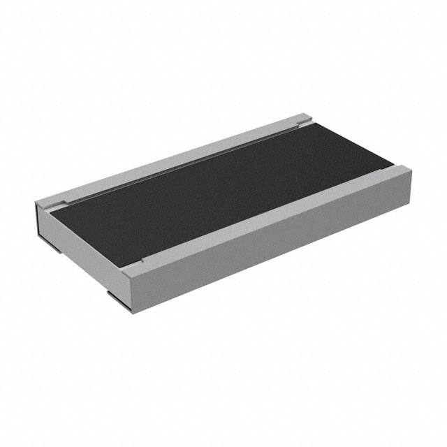

RCA-LS e3 www.vishay.com Vishay Draloric Sulfur Resistant, Long Side Termination Thick Film Chip Resistors FEATURES • Superior resistance against sulfur atmosphere (H2S), according to ASTM B809-95 • Enhanced power rating • Long side terminations • Enhanced thermal cycling performance • AEC-Q200 qualified LINKS TO ADDITIONAL RESOURCES • Material categorization: for definitions of compliance please see www.vishay.com/doc?99912 3D 3D 3D Models APPLICATIONS The sulfur resistant, long side termination thick film chip resistors series combines the capability to stand harsh environment operation with enhanced power rating performance compared to standard long side termination resistors. • Automotive • Industrial • Commercial TECHNICAL SPECIFICATIONS DESCRIPTION RCA0406-LS e3 RCA0612-LS e3 0406 0612 1020 1218 1225 RR1016M RR1632M RR2550M RR3246M RR3263M 1 Ω to 2.2 MΩ; jumper (0 Ω) 1 Ω to 1 MΩ; jumper (0 Ω) Imperial size Metric size code RCA1020-LS e3 RCA1218-LS e3 RCA1225-LS e3 1 Ω to 1 MΩ; 1 Ω to 39.2 kΩ; 1 Ω to 1 MΩ; 40.2 kΩ to 1 MΩ jumper (0 Ω) jumper (0 Ω) jumper (0 Ω) Resistance range Resistance tolerance ± 5 %; ± 1 % Temperature coefficient ± 200 ppm/K; ± 100 ppm/K Rated dissipation, P70 (1) Operating voltage, Umax. ACRMS/DC Permissible film temperature, ϑF max. 0.25 W 1.0 W (2) 1.0 W (2) 1.0 W 1.0 W 2.0 W (2) 50 V 200 V 75 V 200 V 200 V 200 V 300 V 300 V (1) 155 °C Operating temperature range -55 °C to +155 °C Max. resistance change at P70 for resistance range, |ΔR/R| after: 1000 h ≤ 1.0 % 8000 h ≤ 2.0 % Permissible voltage against ambient (insulation): 1 min, Uins Failure rate: FITobserved 100 V 100 V 100 V ≤ 0.1 x 300 V 10-9/h Notes (1) Please refer to APPLICATION INFORMATION below (2) Specified power rating requires dedicated mounting conditions to achieve the required thermal resistance APPLICATION INFORMATION When the resistor dissipates power, a temperature rise above the ambient temperature occurs, dependent on the thermal resistance of the assembled resistor together with the printed circuit board. The rated dissipation applies only if the permitted film temperature is not exceeded. These resistors do not feature a limited lifetime when operated within the permissible limits. However, resistance value drift increasing over operating time may result in exceeding a limit acceptable to the specific application, thereby establishing a functional lifetime. Revision: 14-Jun-2021 Document Number: 20060 1 For technical questions, contact: thickfilmchip@vishay.com THIS DOCUMENT IS SUBJECT TO CHANGE WITHOUT NOTICE. THE PRODUCTS DESCRIBED HEREIN AND THIS DOCUMENT ARE SUBJECT TO SPECIFIC DISCLAIMERS, SET FORTH AT www.vishay.com/doc?91000 RCA-LS e3 www.vishay.com Vishay Draloric TEMPERATURE COEFFICIENT AND RESISTANCE RANGE TYPE / SIZE RCA0406-LS e3 RCA0612-LS e3 RCA1020-LS e3 RCA1218-LS e3 RCA1225-LS e3 TCR TOLERANCE RESISTANCE E-SERIES ± 200 ppm/K ±5% 1 Ω to 1 MΩ E24 ± 100 ppm/K ±1% 1 Ω to 1 MΩ E24; E96 Jumper, Imax. = 4 A ≤ 10 mΩ 0Ω - ± 200 ppm/K ±5% 1 Ω to 1 MΩ E24 ± 100 ppm/K ±1% 1 Ω to 1 MΩ E24; E96 Jumper, Imax. = 6 A ≤ 10 mΩ 0Ω - ± 200 ppm/K ±5% 1 Ω to 1 MΩ E24 ± 100 ppm/K ±1% 1 Ω to 1 MΩ E24; E96 Jumper, Imax. = 10 A ≤ 10 mΩ 0Ω - ± 200 ppm/K ±5% 1 Ω to 2.2 MΩ E24 ± 100 ppm/K ±1% 1 Ω to 2.2 MΩ E24; E96 Jumper, Imax. = 7 A ≤ 20 mΩ 0Ω - ± 200 ppm/K ±5% 1 Ω to 1 MΩ E24 ± 100 ppm/K ±1% 1 Ω to 1 MΩ E24; E96 Jumper, Imax. = 12 A ≤ 10 mΩ 0Ω - Note • The temperature coefficient of resistance (TCR) is not specified for 0 Ω jumpers PACKAGING TYPE / SIZE RCA0406-LS e3 CODE QUANTITY EA = ET1 5000 EB = ET5 10 000 EC = ET6 20 000 EA = ET1 5000 EB = ET5 10 000 EC = ET6 20 000 RCA1020-LS e3 EF = E02 4000 RCA1218-LS e3 EK = ET9 4000 EG = E67 2000 EH = E82 4000 RCA0612-LS e3 PACKAGING STYLE WIDTH PITCH PACKAGING DIMENSIONS Ø 180 mm/7" 4 mm Paper tape acc. to IEC 60286-3, Type 1a Ø 285 mm/11.25" Ø 330 mm/13" 8 mm Ø 180 mm/7" 4 mm Ø 285 mm/11.25" Ø 330 mm/13" 4 mm Blister tape acc. to IEC 60286-3, Type 2a 12 mm Ø 180 mm/7" 8 mm RCA1225-LS e3 Revision: 14-Jun-2021 4 mm Document Number: 20060 2 For technical questions, contact: thickfilmchip@vishay.com THIS DOCUMENT IS SUBJECT TO CHANGE WITHOUT NOTICE. THE PRODUCTS DESCRIBED HEREIN AND THIS DOCUMENT ARE SUBJECT TO SPECIFIC DISCLAIMERS, SET FORTH AT www.vishay.com/doc?91000 RCA-LS e3 www.vishay.com Vishay Draloric PART NUMBER AND PRODUCT DESCRIPTION Part Number: RCA061210K0FKEALS Part Number: RCA06120000Z0EALS R C A 0 6 1 2 1 0 K 0 F K E A L S TYPE / SIZE VALUE TOLERANCE TCR PACKAGING SPECIAL RCA0406 RCA0612 RCA1020 RCA1218 RCA1225 R = decimal K = thousand M = million 0000 = jumper F=±1% J=±5% Z = jumper K = ± 100 ppm/K N = ± 200 ppm/K 0 = jumper EA EB EC EF EG EH EK Up to 2 digits LS = long side termination Product Description: RCA0612-LS 100 10K 1 % ET1 e3 Product Description: RCA0612-LS 0R0 ET1 e3 RCA0612-LS 100 10K 1% ET1 e3 TYPE / SIZE TCR RESISTANCE TOLERANCE PACKAGING LEAD (Pb)-FREE RCA0406-LS RCA0612-LS RCA1020-LS RCA1218-LS RCA1225-LS ± 100 ppm/K ± 200 ppm/K 10R = 10 Ω 1K = 10 Ω 10K = 10 kΩ 1M0 = 1 MΩ 0R0 = jumper ±1% ±5% ET1, ET5, ET6, ET9, E02, E67, E82 e3 = pure tin termination finish Revision: 14-Jun-2021 Document Number: 20060 3 For technical questions, contact: thickfilmchip@vishay.com THIS DOCUMENT IS SUBJECT TO CHANGE WITHOUT NOTICE. THE PRODUCTS DESCRIBED HEREIN AND THIS DOCUMENT ARE SUBJECT TO SPECIFIC DISCLAIMERS, SET FORTH AT www.vishay.com/doc?91000 RCA-LS e3 www.vishay.com DESCRIPTION Production is strictly controlled and follows an extensive set of instructions established for reproducibility. A cermet film layer and a glass-over are deposited on a high grade (Al2O3) ceramic substrate with its prepared inner contacts on both sides. A special laser is used to achieve the target value by smoothly fine trimming the resistive layer without damaging the ceramics. A special process is used to ensure resistor long term operation in harsh environment (sulfur atmosphere). The resistor elements are covered by a protective coating designed for electrical, mechanical and climatic protection. The terminations receive a final pure tin on nickel plating. The result of the determined production is verified by an extensive testing procedure on 100 % of the individual chip resistors. Only accepted products are laid directly into the tape in accordance with IEC 60286-3 Type 1a and Type 2a (1). ASSEMBLY The resistors are suitable for processing on automatic SMD assembly systems. They are suitable for automatic soldering using wave, reflow or vapor phase as shown in IEC 61760-1 (1). The encapsulation is resistant to all cleaning solvents commonly used in the electronics industry, including alcohols, esters and aqueous solutions. The suitability of conformal coatings, potting compounds and their processes, if applied, shall be qualified by appropriate means to ensure the long-term stability of the whole system. Vishay Draloric The products do not contain any of the banned substances as per IEC 62474, GADSL, or the SVHC list, see www.vishay.com/how/leadfree. Hence the products fully comply with the following directives: • 2000/53/EC End-of-Life Vehicle Directive (ELV) and Annex II (ELV II) • 2011/65/EU Restriction of the Use of Hazardous Substances Directive (RoHS) with amendment 2015/863/EU • 2012/19/EU Waste Electrical and Electronic Equipment Directive (WEEE) Vishay pursues the elimination of conflict minerals from its supply chain, see the Conflict Minerals Policy at www.vishay.com/doc?49037. APPROVALS The resistors are qualified according to AEC-Q200. Where applicable, the resistors are tested in accordance with EN 140401-802 which refers to EN 60115-1, EN 60115-8 and the variety of environmental test procedures of the IEC 60068 (1) series. RELATED PRODUCTS The RCL e3 series is not designed for sulfur-containing environment applications. For ordering RCL e3 products please refer to latest edition of datasheet: www.vishay.com/doc?20046 The resistors are RoHS-compliant, the pure tin plating provides compatibility with lead (Pb)-free and lead-containing soldering processes. Solderability is specified for 2 years after production or requalification. The permitted storage time is 20 years. The immunity of the plating against tin whisker growth has been proven under extensive testing. MATERIALS Vishay acknowledges the following systems for the regulation of hazardous substances: • IEC 62474, Material Declaration for Products of and for the Electrotechnical Industry, with the list of declarable substances given therein (2) • The Global Automotive Declarable Substance List (GADSL) (3) • The REACH regulation (1907/2006/EC) and the related list of substances with very high concern (SVHC) (4) for its supply chain Notes (1) The quoted IEC standards are also released as EN standards with the same number and identical contents (2) The IEC 62474 list of declarable substances is maintained in a dedicated database, which is available at http://std.iec.ch/iec62474 (3) The Global Automotive Declarable Substance List (GADSL) is maintained by the American Chemistry Council and available at www.gadsl.org (4) The SVHC list is maintained by the European Chemical Agency (ECHA) and available at http://echa.europa.eu/candidate-list-table Revision: 14-Jun-2021 Document Number: 20060 4 For technical questions, contact: thickfilmchip@vishay.com THIS DOCUMENT IS SUBJECT TO CHANGE WITHOUT NOTICE. THE PRODUCTS DESCRIBED HEREIN AND THIS DOCUMENT ARE SUBJECT TO SPECIFIC DISCLAIMERS, SET FORTH AT www.vishay.com/doc?91000 RCA-LS e3 www.vishay.com Vishay Draloric FUNCTIONAL PERFORMANCE PERFORMANCE IN SULFUR-CONTAINING AMBIANCE HUMID SULFUR VAPOR TEST HUMID SULFUR VAPOR TEST (Accelerated) Reference specification ASTM B809-95 ASTM B809-95 accelerated conditions Test conditions (temperature, humidity) 60 °C ± 2 °C 85 % ± 4 % RH 90 °C ± 2 °C 74 % ± 7 % RH Sulfur (saturated vapor) Sulfur (saturated vapor) TEST NAME Aggressive agent Failure criteria in VI under magnification No silver sulfide growth at the interface No silver sulfide growth at the interface between termination and protective overcoat. between termination and protective overcoat. No signs of mechanical damage. No signs of mechanical damage. Failure criteria in electrical test ≤ (± 1 % R + 0.05 Ω) ≤ (± 1 % R + 0.05 Ω) 8000 h 1000 h Time before failure Single Pulse (1) Axis Title 10000 1000 RCA1020-LS in work RCA1225-LS 1000 RCA1218-LS 10 1 RCA0612-LS 1st line 2nd line 2nd line ^ Pmax. - Pulse Load (W) 100 RCA0406-LS 100 0.1 0.01 0.000001 10 0.00001 0.0001 0.001 0.01 0.1 1 10 100 ti - Pulse Duration (s) Maximum pulse load, single pulse; applicable if P → 0 and n < 1000 and Uˆ ≤ Uˆ max.; for permissible resistance change equivalent to 8000 h operation Continuous Pulse (1) Axis Title RCA1020-LS in work 10000 100 1000 RCA1225-LS 10 RCA1218-LS 1st line 2nd line 2nd line ^ Pmax. - Continuous Pulse Load (W) 1000 1 RCA0612-LS 100 RCA0406-LS 0.1 0.01 0.000001 10 0.00001 0.0001 0.001 0.01 0.1 1 10 100 ti - Pulse Duration (s) Maximum pulse load, continuous pulses; applicable if P ≤ P (ϑamb) and Uˆ ≤ Uˆ max.; for permissible resistance change equivalent to 8000 h operation Revision: 14-Jun-2021 Document Number: 20060 5 For technical questions, contact: thickfilmchip@vishay.com THIS DOCUMENT IS SUBJECT TO CHANGE WITHOUT NOTICE. THE PRODUCTS DESCRIBED HEREIN AND THIS DOCUMENT ARE SUBJECT TO SPECIFIC DISCLAIMERS, SET FORTH AT www.vishay.com/doc?91000 RCA-LS e3 www.vishay.com Vishay Draloric Pulse Voltage (1) Axis Title 10000 800 RCA1020-LS, RCA1218-LS, RCA1225-LS 600 1000 500 1st line 2nd line 2nd line ^ Umax. - Pulse Voltage (V) 700 400 300 RCA0612-LS 100 200 100 RCA0406-LS 10 0 0.000001 0.00001 0.0001 0.001 0.01 0.1 1 10 ti - Pulse Duration (s) Maximum pulse voltage, single and continuous pulses; applicable if Pˆ ≤ Pˆ max.; for permissible resistance change equivalent to 8000 h operation Note Pulse diagrams under review to match upgraded rated dissipation and operating voltage (1) Derating Axis Title 10000 2.5 1000 1.5 1st line 2nd line 2nd line P - Power Dissipation (W) RCA1225-LS 2.0 RCA0612-LS, RCA1020-LS, RCA1218-LS 1.0 100 0.5 RCA0406-LS 10 0 -50 Revision: 14-Jun-2021 0 50 70 ϑamb - Ambient Temperature (°C) 100 150 Document Number: 20060 6 For technical questions, contact: thickfilmchip@vishay.com THIS DOCUMENT IS SUBJECT TO CHANGE WITHOUT NOTICE. THE PRODUCTS DESCRIBED HEREIN AND THIS DOCUMENT ARE SUBJECT TO SPECIFIC DISCLAIMERS, SET FORTH AT www.vishay.com/doc?91000 RCA-LS e3 www.vishay.com Vishay Draloric TESTS AND REQUIREMENTS All executed tests are carried out in accordance with the following specifications: The testing also covers most of the requirements specified by EIA/IS-703 and JIS-C-5201-1. EN 60115-1, generic specification EN 60115-8 (successor of EN 140400), sectional specification The tests are carried out under standard atmospheric conditions in accordance with IEC 60068-1, 4.3, whereupon the following values are applied: EN 140401-802, detail specification Temperature: 15 °C to 35 °C IEC 60068-2-xx, test methods Relative humidity: 25 % to 75 % The parameters stated in the Test Procedures and Requirements table are based on the required tests and permitted limits of EN 140401-802. The table presents only the most important tests, for the full test schedule refer to the documents listed above. However, some additional tests and a number of improvements against those minimum requirements have been included. Air pressure: 86 kPa to 106 kPa (860 mbar to 1060 mbar). TEST PROCEDURES AND REQUIREMENTS IEC EN 60115-1 60068-2 (1) CLAUSE TEST METHOD TEST PROCEDURE Stability for product types: REQUIREMENTS PERMISSIBLE CHANGE (ΔR) STABILITY CLASS 1 OR BETTER STABILITY CLASS 2 OR BETTER 1 Ω to 2.2 MΩ RCA-LS e3 4.5 - Resistance - ±1% ±5% 4.8 - Temperature coefficient (20 / -55 / 20) °C and (20 / 155 / 20) °C ± 100 ppm/K ± 200 ppm/K Endurance at 70 °C U = P 70 x R or U = Umax.; whichever is the less severe; 1.5 h on; 0.5 h off 4.25.1 - 70 °C; 1000 h ± (1 % R + 0.05 Ω) ± (2 % R + 0.1 Ω) 70 °C; 8000 h ± (2 % R + 0.1 Ω) ± (4 % R + 0.1 Ω) - Endurance at upper category temperature 155 °C, 1000 h ± (1 % R + 0.05 Ω) ± (2 % R + 0.1 Ω) 4.24 78 (Cab) Damp heat, steady state (40 ± 2) °C; 56 days; (93 ± 3) % RH; 4.37 67 (Cy) Damp heat, steady state, accelerated (85 ± 2) °C; (85 ± 5) % RH; U = 0.1 x P 85 x R ≤ 100 V; 1000 h 4.25.3 - Climatic sequence: - 4.23.2 4.23 2 (Bb) dry heat 125 °C; 16 h 4.23.3 30 (Db) damp heat, cyclic 55 °C; 24 h; ≥ 90 % RH; 1 cycle 4.23.4 1 (Ab) cold -55 °C; 2 h 4.23.5 13 (M) low air pressure 8.5 kPa; 2 h; (25 ± 10) °C 4.23.6 30 (Db) damp heat, cyclic 55 °C; 24 h; ≥ 90 % RH; 5 cycles 4.23.7 4.19 U= ± (1 % R + 0.05 Ω) ± (2 % R + 0.1 Ω) ± (1 % R + 0.05 Ω) ± (2 % R + 0.1 Ω) ± (0.25 % R + 0.05 Ω) ± (0.5 % R + 0.05 Ω) P 70 x R ≤ Umax.; 1 min; - DC load 1 (Aa) Cold -55 °C; 2 h 14 (Na) Rapid change of temperature 30 min at -55 °C and 30 min at 125 °C; 1000 cycles Revision: 14-Jun-2021 ± (1 % R + 0.05 Ω) ± (1 % R + 0.05 Ω) Document Number: 20060 7 For technical questions, contact: thickfilmchip@vishay.com THIS DOCUMENT IS SUBJECT TO CHANGE WITHOUT NOTICE. THE PRODUCTS DESCRIBED HEREIN AND THIS DOCUMENT ARE SUBJECT TO SPECIFIC DISCLAIMERS, SET FORTH AT www.vishay.com/doc?91000 RCA-LS e3 www.vishay.com Vishay Draloric TEST PROCEDURES AND REQUIREMENTS IEC EN 60115-1 60068-2 (1) CLAUSE TEST METHOD TEST PROCEDURE Stability for product types: RCA-LS e3 4.13 4.27 - - REQUIREMENTS PERMISSIBLE CHANGE (ΔR) STABILITY CLASS 1 OR BETTER STABILITY CLASS 2 OR BETTER 1 Ω to 2.2 MΩ Short time overload U = 2.5 x P 70 x R ≤ 2 x Umax.; whichever is the less severe; 5s ± (2 % R + 0.05 Ω) Single pulse high voltage overload Severity no. 4: U = 10 x P 70 x R ≤ U = 2 x Umax.; whichever is the less severe; 10 pulses 10 μs/700 μs ± (1 % R + 0.05 Ω) no visible damage U= 4.39 - Periodic electric overload 15 x P 70 x R ≤ U = 2 x Umax.; whichever is the less severe; 0.1 s on; 2.5 s off; 1000 cycles 4.38 - Electrostatic discharge (human body model) IEC 61340-3-1 (1); 3 pos. + 3 neg. discharges; ESD voltage acc. to the size Vibration Endurance by sweeping; 10 Hz to 2000 Hz; no resonance; amplitude ≤ 1.5 mm or ≤ 200 m/s2; 7.5 h 4.22 6 (Fc) Solder bath method; Sn60Pb40 non-activated flux; (235 ± 5) °C; (2 ± 0.2) s 4.17 58 (Td) Solderability Solder bath method; Sn96.5Ag3Cu0.5 non-activated flux; (245 ± 5) °C; (3 ± 0.3) s ± (1 % R + 0.05 Ω) no visible damage ± (1 % R + 0.05 Ω) ± (0.25 % R + 0.05 Ω) no visible damage ± (0.5 % R + 0.05 Ω) no visible damage Good tinning (≥ 95 % covered) no visible damage 4.18 58 (Td) Resistance to soldering heat Solder bath method (260 ± 5) °C; (10 ± 1) s 4.29 45 (XA) Component solvent resistance Isopropyl alcohol; +50 °C; method 2 No visible damage 4.32 21 (Uu3) Shear (adhesion) 17.7 N No visible damage 4.33 21 (Uu1) Substrate bending Depth 2 mm; 3 times ± (0.25 % R + 0.05 Ω) no visible damage, no open circuit in bent position 4.7 - Voltage proof U = 1.4 x Uins; 60 s No flashover or breakdown 4.35 - Flammability, needle flame test IEC 60695-11-5 (1); 10 s No burning after 30 s ± (0.25 % R + 0.05 Ω) ± (0.5 % R + 0.05 Ω) Note (1) The quoted IEC standards are also released as EN standards with the same number and identical contents. Revision: 14-Jun-2021 Document Number: 20060 8 For technical questions, contact: thickfilmchip@vishay.com THIS DOCUMENT IS SUBJECT TO CHANGE WITHOUT NOTICE. THE PRODUCTS DESCRIBED HEREIN AND THIS DOCUMENT ARE SUBJECT TO SPECIFIC DISCLAIMERS, SET FORTH AT www.vishay.com/doc?91000 RCA-LS e3 www.vishay.com Vishay Draloric DIMENSIONS T2 L H W T1 DIMENSIONS AND MASS L (mm) W (mm) H (mm) T1 (mm) T2 (mm) MASS (mg) RCA0406-LS e3 1.0 ± 0.10 1.6 ± 0.10 0.35 ± 0.10 0.2 +0.10 / -0.15 0.2 ± 0.10 2 RCA0612-LS e3 1.6 ± 0.20 3.2 ± 0.20 0.55 ± 0.10 0.35 ± 0.15 0.25 ± 0.15 11 RCA1020-LS e3 2.5 ± 0.20 5.0 ± 0.20 0.55 ± 0.10 0.38 ± 0.15 0.25 ± 0.15 25.5 RCA1218-LS e3 3.2 +0.10 / -0.20 4.6 ± 0.15 0.55 ± 0.05 0.45 ± 0.20 0.4 ± 0.20 29.5 RCA1225-LS e3 3.2 ± 0.20 6.3 ± 0.20 0.70 ± 0.10 0.8 ± 0.20 0.4 ± 0.20 55 TYPE / SIZE SOLDER PAD DIMENSIONS X G Y Z RECOMMENDED SOLDER PAD DIMENSIONS WAVE SOLDERING REFLOW SOLDERING TYPE / SIZE G (mm) Y (mm) X (mm) Z (mm) G (mm) Y (mm) X (mm) Z (mm) RCA0406-LS e3 0.30 0.80 1.95 1.90 0.35 0.60 1.75 1.55 RCA0612-LS e3 0.50 1.20 3.70 2.90 0.60 1.00 3.50 2.60 RCA1020-LS e3 1.30 1.25 5.50 3.80 1.30 1.10 5.25 3.50 RCA1218-LS e3 1.80 1.30 5.10 4.40 1.90 1.10 4.90 4.10 RCA1225-LS e3 1.10 1.80 6.80 4.70 1.20 1.60 6.60 4.40 Notes • The given solder pad dimensions reflect the considerations for board design and assembly as outlined e.g in standards IEC 61188-5-x (1) or in publication IPC-7351. Still, the given solder pad dimensions will be found adequate for most general applications (1) The quoted IEC standards are also released as EN standards with the same number and identical contents Revision: 14-Jun-2021 Document Number: 20060 9 For technical questions, contact: thickfilmchip@vishay.com THIS DOCUMENT IS SUBJECT TO CHANGE WITHOUT NOTICE. THE PRODUCTS DESCRIBED HEREIN AND THIS DOCUMENT ARE SUBJECT TO SPECIFIC DISCLAIMERS, SET FORTH AT www.vishay.com/doc?91000 Legal Disclaimer Notice www.vishay.com Vishay Disclaimer ALL PRODUCT, PRODUCT SPECIFICATIONS AND DATA ARE SUBJECT TO CHANGE WITHOUT NOTICE TO IMPROVE RELIABILITY, FUNCTION OR DESIGN OR OTHERWISE. Vishay Intertechnology, Inc., its affiliates, agents, and employees, and all persons acting on its or their behalf (collectively, “Vishay”), disclaim any and all liability for any errors, inaccuracies or incompleteness contained in any datasheet or in any other disclosure relating to any product. Vishay makes no warranty, representation or guarantee regarding the suitability of the products for any particular purpose or the continuing production of any product. To the maximum extent permitted by applicable law, Vishay disclaims (i) any and all liability arising out of the application or use of any product, (ii) any and all liability, including without limitation special, consequential or incidental damages, and (iii) any and all implied warranties, including warranties of fitness for particular purpose, non-infringement and merchantability. Statements regarding the suitability of products for certain types of applications are based on Vishay's knowledge of typical requirements that are often placed on Vishay products in generic applications. Such statements are not binding statements about the suitability of products for a particular application. It is the customer's responsibility to validate that a particular product with the properties described in the product specification is suitable for use in a particular application. Parameters provided in datasheets and / or specifications may vary in different applications and performance may vary over time. All operating parameters, including typical parameters, must be validated for each customer application by the customer's technical experts. Product specifications do not expand or otherwise modify Vishay's terms and conditions of purchase, including but not limited to the warranty expressed therein. Hyperlinks included in this datasheet may direct users to third-party websites. These links are provided as a convenience and for informational purposes only. Inclusion of these hyperlinks does not constitute an endorsement or an approval by Vishay of any of the products, services or opinions of the corporation, organization or individual associated with the third-party website. Vishay disclaims any and all liability and bears no responsibility for the accuracy, legality or content of the third-party website or for that of subsequent links. Except as expressly indicated in writing, Vishay products are not designed for use in medical, life-saving, or life-sustaining applications or for any other application in which the failure of the Vishay product could result in personal injury or death. Customers using or selling Vishay products not expressly indicated for use in such applications do so at their own risk. Please contact authorized Vishay personnel to obtain written terms and conditions regarding products designed for such applications. No license, express or implied, by estoppel or otherwise, to any intellectual property rights is granted by this document or by any conduct of Vishay. Product names and markings noted herein may be trademarks of their respective owners. © 2021 VISHAY INTERTECHNOLOGY, INC. ALL RIGHTS RESERVED Revision: 09-Jul-2021 1 Document Number: 91000
