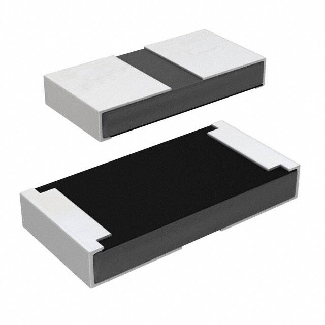

    电阻器 510Ω ±2% 2.4W ±150ppm/℃ 1206
RCP1206W510RGEA 数据手册
RCP www.vishay.com Vishay Dale Thick Film Chip Resistors, Industrial, High Power, Aluminum Nitride Substrate FEATURES • Thick film resistive element on an aluminum nitride (AlN) substrates Available • Very high thermal conductivity in a small package size • Termination: tin / lead wraparound termination over nickel barrier. Also available with lead (Pb)-free wraparound terminations Aluminum nitride over 3 x more power - same size Available • Capability to develop specific reliability programs designed to customer requirements LINKS TO ADDITIONAL RESOURCES • Operating temperature range: -65 °C to +155 °C S-Parameters • High frequency performance to 6 GHz • Material categorization: for definitions of compliance please see www.vishay.com/doc?99912 MATERIAL SPECIFICATIONS Resistive element Encapsulation Substrate Termination Solder finish Ruthenium oxide Epoxy Aluminum nitride Solder-coated nickel barrier Pure tin or tin / lead solder alloy Note * This datasheet provides information about parts that are RoHS-compliant and / or parts that are non RoHS-compliant. For example, parts with lead (Pb) terminations are not RoHS-compliant. Please see the information / tables in this datasheet for details STANDARD ELECTRICAL SPECIFICATIONS GLOBAL MODEL CASE SIZE RCP0505 RCP0603 RCP1206 RCP2512 0505 0603 1206 2512 POWER RATING (1) (Standard Board Mount) P25 °C W 1.4 1.5 2.4 3.5 POWER RATING (1) (Active Temperature Control) W 5.0 3.9 11 22 MAXIMUM WORKING VOLTAGE V P P P P RESISTANCE RANGE Ω TOLERANCE ±% TEMPERATURE COEFFICIENT ± ppm/°C 10 to 2K 10 to 2K 10 to 2K 10 to 2K 1, 2, 5 1, 2, 5 1, 2, 5 1, 2, 5 150 150 150 150 xR xR xR xR Notes • Consult factory for availability of additional case sizes (1) The power rating depends on the maximum temperature of the resistive element. The temperature of the resistive element and adjacent materials will rise due to the power dissipation of the resistor. The majority of this heat/energy is dissipated by conduction through the substrate, terminations, solder joints, and printed circuit board. The maximum power rating in a particular application only applies if the temperature of the resistive element is maintained at or below 155 °C GLOBAL PART NUMBER INFORMATION New Global Part Numbering: RCP1206W100RGWB (preferred part numbering format) R C P GLOBAL MODEL RCP0505 RCP0603 RCP1206 RCP2512 1 2 BOTTOM TERM. W = wide B = traditional 0 6 W 1 0 RESISTANCE VALUE TOLERANCE CODE R=Ω K = kΩ 10R0 = 10 Ω 1K30 = 1.3 kΩ F=±1% G=±2% J=±5% 0 R G W B PACKAGING CODE SPECIAL TP = tin / lead, T/R (full reel) S3 = tin / lead, T/R (1000 pieces) WB = tin / lead, tray S2 = tin / lead, T/R (500 pieces) S6 = tin / lead, T/R (300 pieces) Blank = standard (dash number) (up to 3 digits) from 1 to 999 as applicable EA = lead (Pb)-free, T/R (full reel) EB = lead (Pb)-free, T/R (1000 pieces) ET = lead (Pb)-free, tray EC = lead (Pb)-free, T/R (500 pieces) ED = lead (Pb)-free, T/R (300 pieces) Note • For additional information on packaging, refer to the Surface Mount Resistor Packaging document (www.vishay.com/doc?31543) Revision: 10-Aug-2021 Document Number: 31098 1 For technical questions, contact: ff2aresistors@vishay.com THIS DOCUMENT IS SUBJECT TO CHANGE WITHOUT NOTICE. THE PRODUCTS DESCRIBED HEREIN AND THIS DOCUMENT ARE SUBJECT TO SPECIFIC DISCLAIMERS, SET FORTH AT www.vishay.com/doc?91000 RCP www.vishay.com Vishay Dale PERFORMANCE TEST CONDITIONS OF TEST Resistance to soldering heat Resistance temperature characteristic Low temperature operation Short time overload 2 cycles; > 183 °C for 90 s to 120 s ≤ ± 0.20 % -55 °C to +125 °C ≤ ± 120 ppm -65 °C at rated voltage ≤ ± 0.02 % RCP0505 3.1 W applied for 5 s RCP0603 4.4 W applied for 5 s RCP1206 4.7 W applied for 5 s RCP2512 7.7 W applied for 5 s High temperature exposure Moisture resistance TEST RESULTS (TYPICAL TEST LOTS) ≤ ± 0.10 % +150 °C for 100 h ≤ ± 0.10 % 240 h at ≥ 80 % RH ≤ ± 0.15 % Life 1000 h at +70 °C ≤ ± 0.10 % Solderability J-STD-202, test B 95 % coverage Per MIL-PRF-55342: Solder mounting integrity RCP0505 1 kg force applied RCP0603 2 kg force applied RCP1206 2 kg force applied RCP2512 3 kg force applied No evidence of mechanical damage DIMENSIONS in inches (millimeters) D D C B A E WIDE BOTTOM TERMINAL (W) GLOBAL MODEL C A E TRADITIONAL TERMINAL (B) A (LENGTH) B (WIDTH) C (HEIGHT) D (TOP TERM) E (BOTTOM TERM) RCP0505W 0.055 ± 0.005 (1.40 ± 0.13) 0.050 ± 0.005 (1.27 ± 0.13) 0.020 ± 0.005 (0.51 ± 0.13) 0.010 ± 0.005 (0.25 ± 0.13) 0.020 ± 0.005 (0.51 ± 0.13) RCP0505B 0.055 ± 0.005 (1.40 ± 0.13) 0.050 ± 0.005 (1.27 ± 0.13) 0.020 ± 0.005 (0.51 ± 0.13) 0.010 ± 0.005 (0.25 ± 0.13) 0.015 ± 0.005 (0.38 ± 0.13) RCP0603W 0.063 ± 0.005 (1.60 ± 0.13) 0.032 ± 0.005 (0.81 ± 0.13) 0.018 ± 0.005 (0.46 ± 0.13) 0.012 ± 0.005 (0.30 ± 0.13) 0.023 ± 0.005 (0.58 ± 0.13) RCP0603B 0.063 ± 0.005 (1.60 ± 0.13) 0.032 ± 0.005 (0.81 ± 0.13) 0.018 ± 0.005 (0.46 ± 0.13) 0.012 ± 0.005 (0.30 ± 0.13) 0.015 ± 0.005 (0.38 ± 0.13) RCP1206W 0.122 ± 0.005 (3.10 ± 0.13) 0.060 ± 0.005 (1.52 ± 0.13) 0.020 ± 0.005 (0.51 ± 0.13) 0.015 ± 0.005 (0.38 ± 0.13) 0.048 ± 0.005 (1.22 ± 0.13) RCP1206B 0.122 ± 0.005 (3.10 ± 0.13) 0.060 ± 0.005 (1.52 ± 0.13) 0.020 ± 0.005 (0.51 ± 0.13) 0.015 ± 0.005 (0.38 ± 0.13) 0.015 ± 0.005 (0.38 ± 0.13) RCP2512W 0.250 ± 0.005 (6.35 ± 0.13) 0.124 ± 0.005 (3.15 ± 0.13) 0.020 ± 0.005 (0.51 ± 0.13) 0.020 ± 0.005 (0.51 ± 0.13) 0.113 ± 0.005 (2.87 ± 0.13) RCP2512B 0.250 ± 0.005 (6.35 ± 0.13) 0.124 ± 0.005 (3.15 ± 0.13) 0.020 ± 0.005 (0.51 ± 0.13) 0.020 ± 0.005 (0.51 ± 0.13) 0.020 ± 0.005 (0.51 ± 0.13) Revision: 10-Aug-2021 Document Number: 31098 2 For technical questions, contact: ff2aresistors@vishay.com THIS DOCUMENT IS SUBJECT TO CHANGE WITHOUT NOTICE. THE PRODUCTS DESCRIBED HEREIN AND THIS DOCUMENT ARE SUBJECT TO SPECIFIC DISCLAIMERS, SET FORTH AT www.vishay.com/doc?91000 RCP www.vishay.com Vishay Dale RECOMMENDED SOLDER PAD DIMENSIONS in inches (millimeters) a l a b a l a b WIDE BOTTOM TERMINAL (W) GLOBAL MODEL TRADITIONAL TERMINAL (B) a (LENGTH) b (WIDTH) l (SPACING) RCP0505W 0.040 (1.02) 0.055 (1.40) 0.015 (0.38) RCP0505B 0.035 (0.89) 0.055 (1.40) 0.025 (0.64) RCP0603W 0.043 (1.09) 0.037 (0.94) 0.018 (0.46) RCP0603B 0.035 (0.89) 0.037 (0.94) 0.033 (0.84) RCP1206W 0.068 (1.73) 0.066 (1.68) 0.018 (0.46) RCP1206B 0.037 (0.94) 0.066 (1.68) 0.081 (2.06) RCP2512W 0.133 (3.38) 0.129 (3.28) 0.024 (0.61) RCP2512B 0.040 (1.02) 0.129 (3.28) 0.210 (5.33) Revision: 10-Aug-2021 Document Number: 31098 3 For technical questions, contact: ff2aresistors@vishay.com THIS DOCUMENT IS SUBJECT TO CHANGE WITHOUT NOTICE. THE PRODUCTS DESCRIBED HEREIN AND THIS DOCUMENT ARE SUBJECT TO SPECIFIC DISCLAIMERS, SET FORTH AT www.vishay.com/doc?91000 Legal Disclaimer Notice www.vishay.com Vishay Disclaimer ALL PRODUCT, PRODUCT SPECIFICATIONS AND DATA ARE SUBJECT TO CHANGE WITHOUT NOTICE TO IMPROVE RELIABILITY, FUNCTION OR DESIGN OR OTHERWISE. Vishay Intertechnology, Inc., its affiliates, agents, and employees, and all persons acting on its or their behalf (collectively, “Vishay”), disclaim any and all liability for any errors, inaccuracies or incompleteness contained in any datasheet or in any other disclosure relating to any product. Vishay makes no warranty, representation or guarantee regarding the suitability of the products for any particular purpose or the continuing production of any product. To the maximum extent permitted by applicable law, Vishay disclaims (i) any and all liability arising out of the application or use of any product, (ii) any and all liability, including without limitation special, consequential or incidental damages, and (iii) any and all implied warranties, including warranties of fitness for particular purpose, non-infringement and merchantability. Statements regarding the suitability of products for certain types of applications are based on Vishay's knowledge of typical requirements that are often placed on Vishay products in generic applications. Such statements are not binding statements about the suitability of products for a particular application. It is the customer's responsibility to validate that a particular product with the properties described in the product specification is suitable for use in a particular application. Parameters provided in datasheets and / or specifications may vary in different applications and performance may vary over time. All operating parameters, including typical parameters, must be validated for each customer application by the customer's technical experts. Product specifications do not expand or otherwise modify Vishay's terms and conditions of purchase, including but not limited to the warranty expressed therein. Hyperlinks included in this datasheet may direct users to third-party websites. These links are provided as a convenience and for informational purposes only. Inclusion of these hyperlinks does not constitute an endorsement or an approval by Vishay of any of the products, services or opinions of the corporation, organization or individual associated with the third-party website. Vishay disclaims any and all liability and bears no responsibility for the accuracy, legality or content of the third-party website or for that of subsequent links. Except as expressly indicated in writing, Vishay products are not designed for use in medical, life-saving, or life-sustaining applications or for any other application in which the failure of the Vishay product could result in personal injury or death. Customers using or selling Vishay products not expressly indicated for use in such applications do so at their own risk. Please contact authorized Vishay personnel to obtain written terms and conditions regarding products designed for such applications. No license, express or implied, by estoppel or otherwise, to any intellectual property rights is granted by this document or by any conduct of Vishay. Product names and markings noted herein may be trademarks of their respective owners. © 2021 VISHAY INTERTECHNOLOGY, INC. ALL RIGHTS RESERVED Revision: 09-Jul-2021 1 Document Number: 91000
